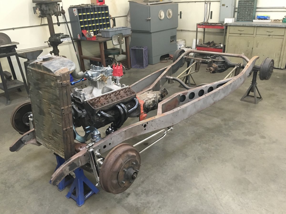

    Very true statement, in the mid 80's This 34 came with a 283, on a Cragar adapter and a 39 box. We swapped out the Cragar mount for a set of Temple City Pete & Jakes mounts that I had from right before the company headed to Grandveiw MO. IMG_5275.JPG
    I ended up doing the whole driveline in a contemporary fashion, which was plain easier to work on. If I drive it somewhere in BFE, I'd be able to grab a part anywhere as it "a common combination" kind of a dirty word theses days, but back when people wanted to drive these cars every where solutions were adapted for use. This car would be either a 3W or a roadster IMG_5162.JPG
    There are many options for engine choices, but if you're gonna drive em, go the route that you feel will fit you, your finances, peace of mind best.

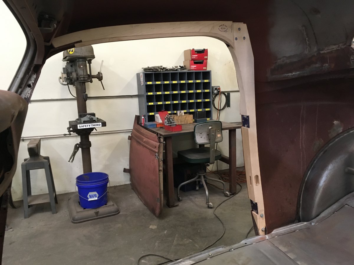

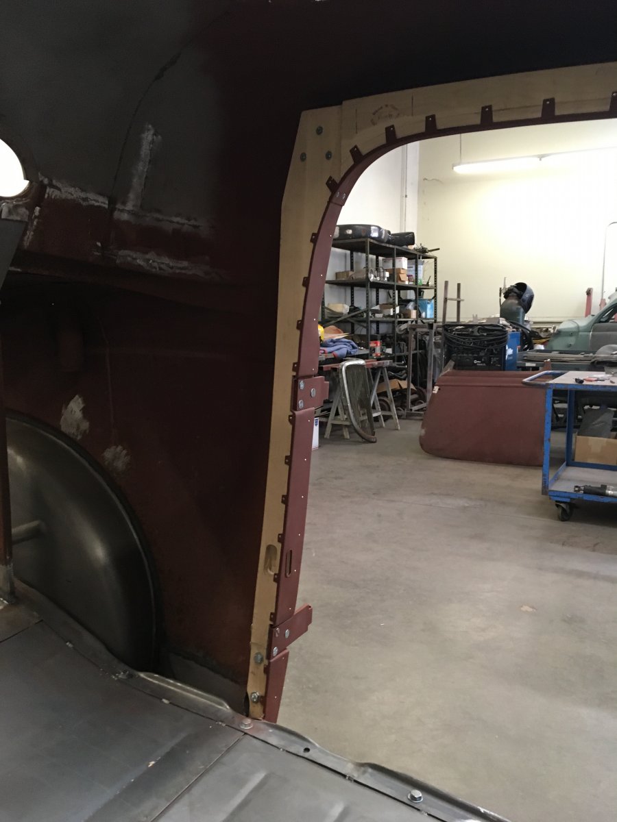

  3. Okay, so it's been a while since I posted something, but we have been busy on the car...we've had all of the custom woodwork produced and Rudy is currently installing it in the car. The original wood was long gone, so as the chop had already been done we had the wood built to fit the car. Once this is done the next job will be to finish the metal work.

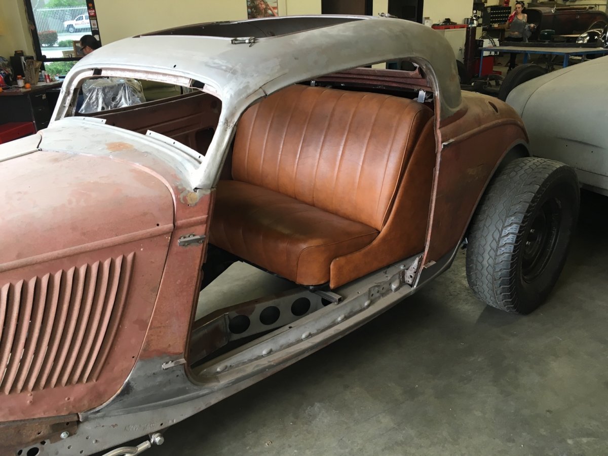

    You should be able to find or make a lower seat that puts you right on the floor.
    I have a friend with a chopped '34 and very comfortable to ride in. I'm 6'2". He is about 6'4"
    I suggest you change the seat.

  10. Yes, I sold that seat and we will now be adapting something else so I can sit in the car without having to drive with my head sticking out of the roof

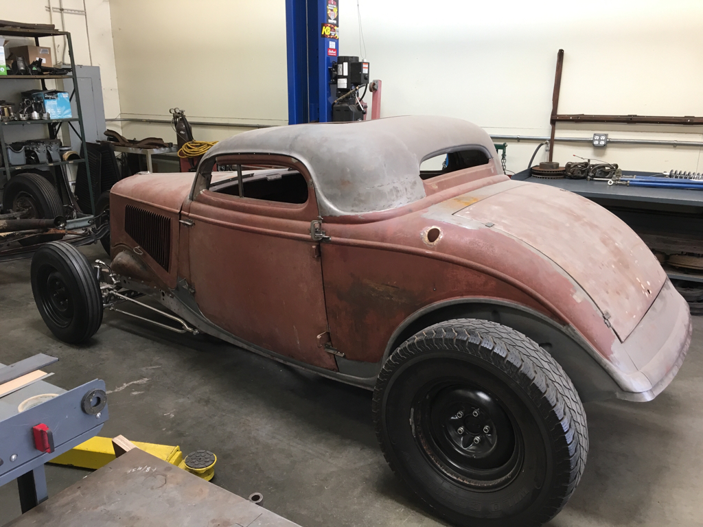

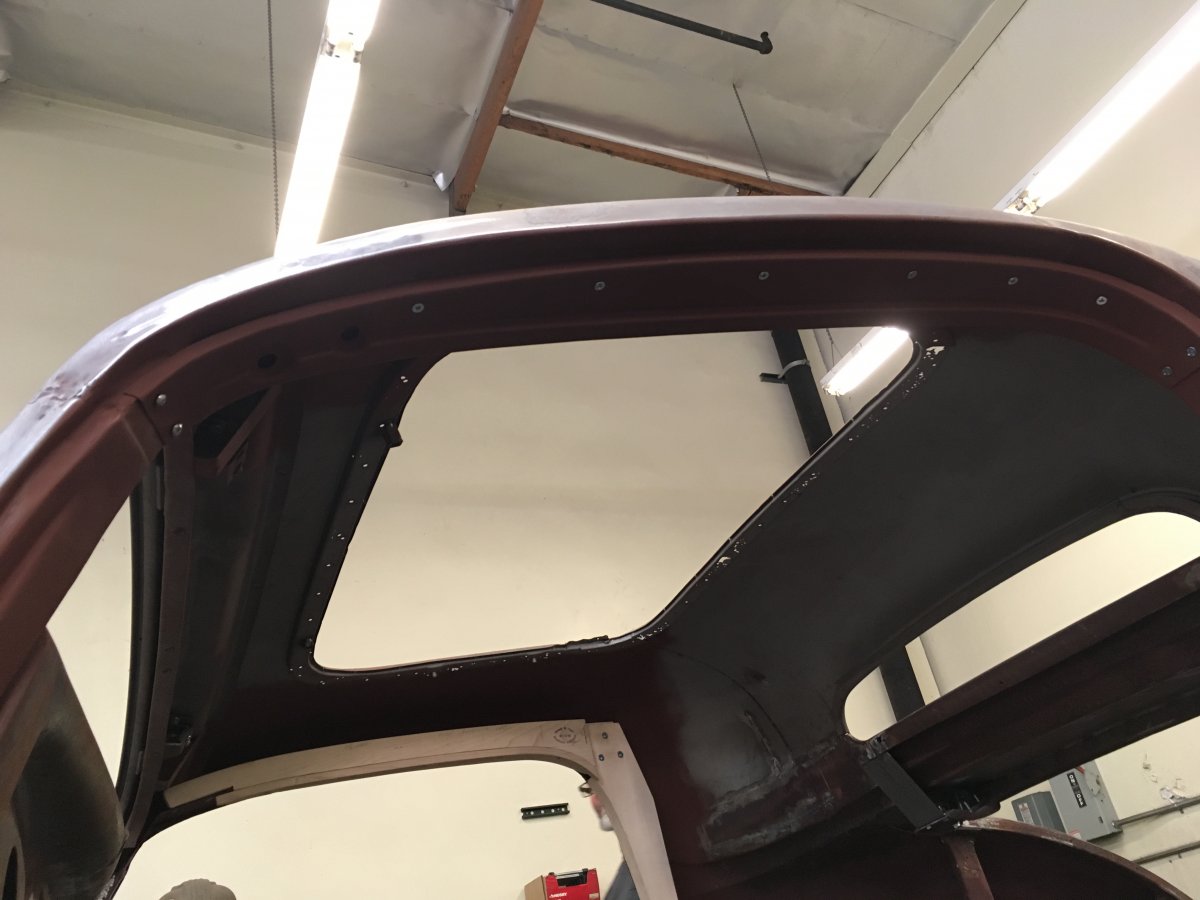

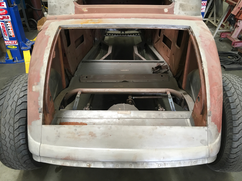

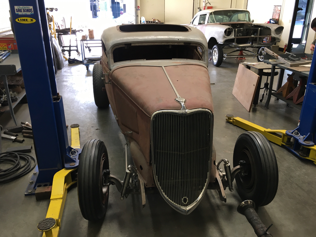

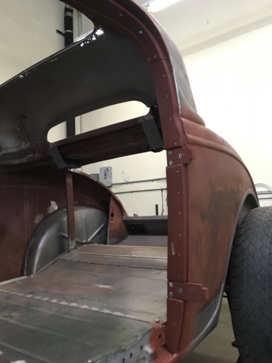

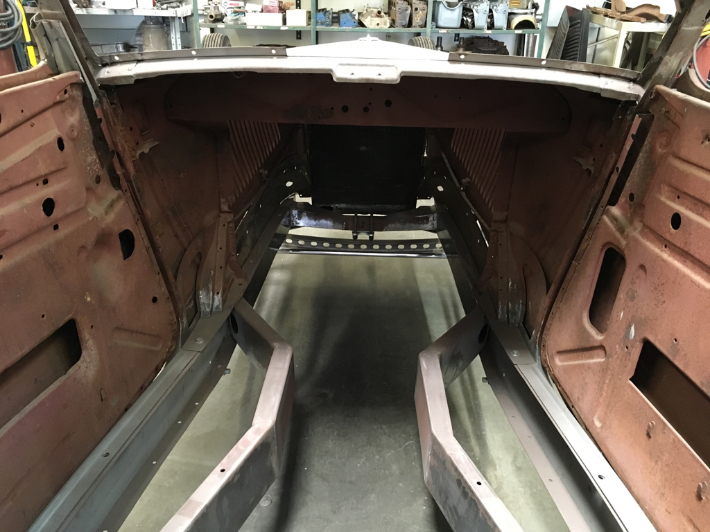

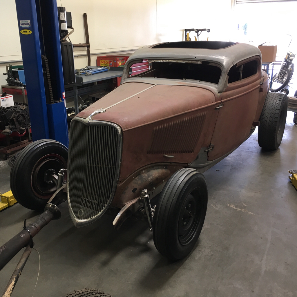

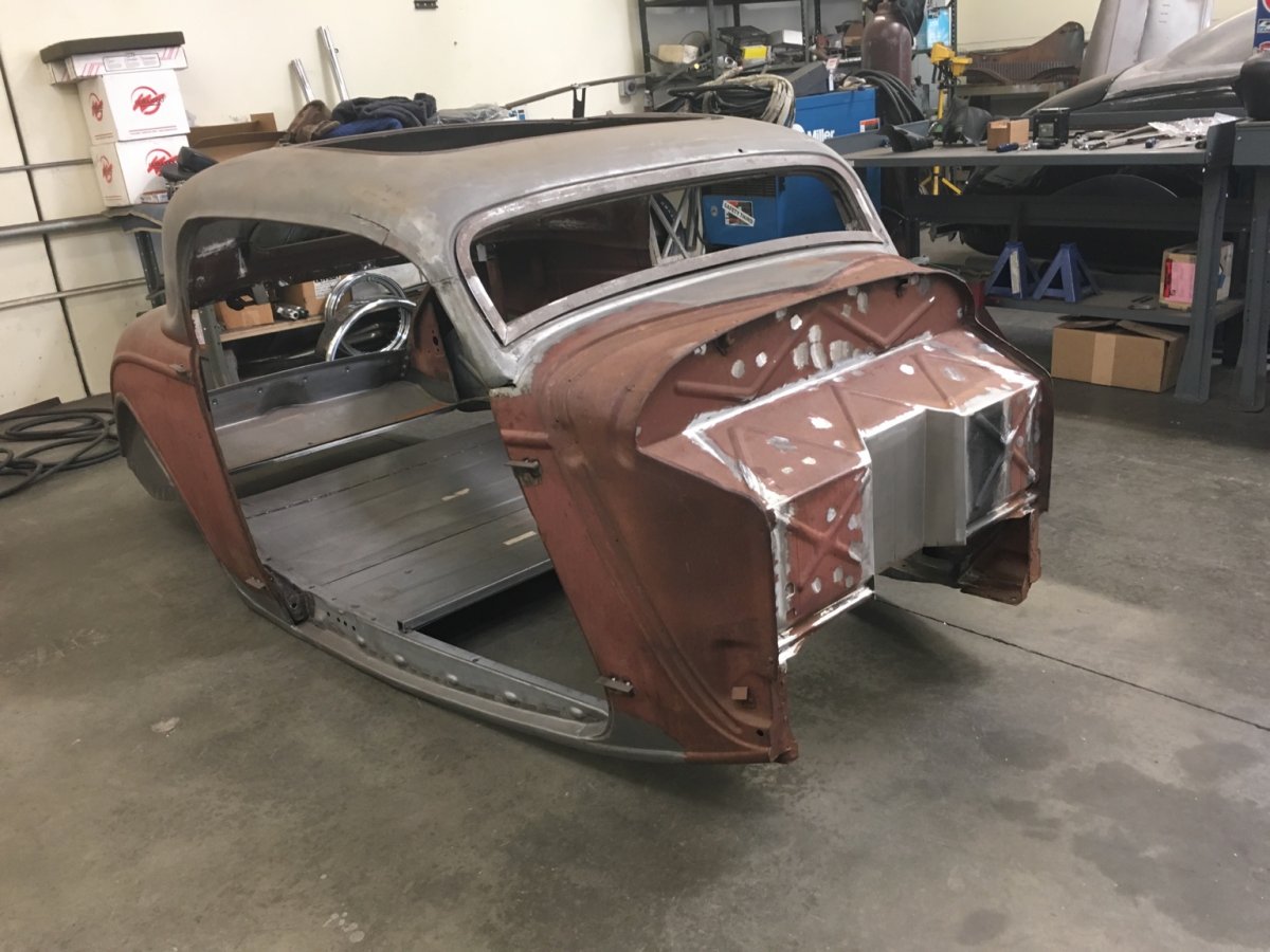

  14. Here are a few more photos from Rudy at Fullerton Fabrications on the build. He's been busy repairing both left and right door jamb tins, fabricate and weld in missing section on one door tin. He's also fabricate the right lower female hinge using a 5 window hinge and lengthening it to correct length, plus heat and straighten all four hinges back to correct shape. Installed all four wood sections in to body, shape to fit and install door tins and install both doors correctly.
    I'll be back in California at the end of May so will be able to post more photos of the car. Hopefully we can work out what we can do to the car so I can sit in it without my head sticking out of the roof.
