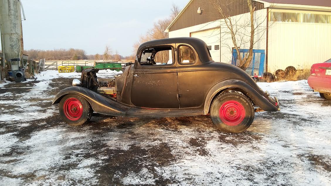

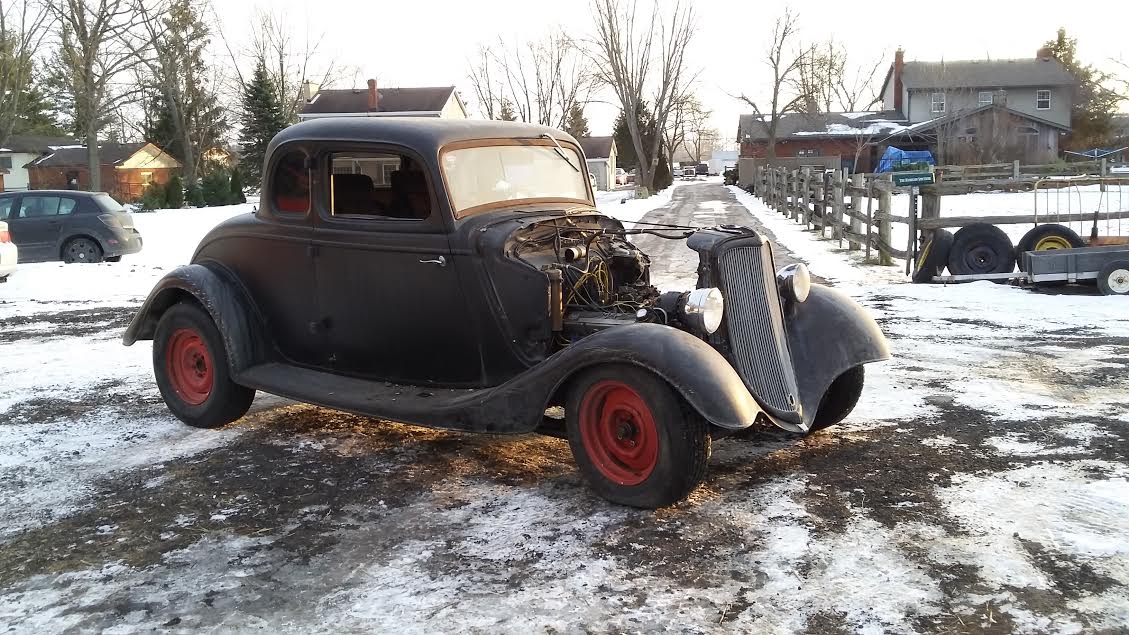

    To get this (with a wad of cash left over)
    All steel body, fibergl*** fenders, 1933 ford frame. Body is in great shape minus the inner doors being hacked to **** to install power windows. The roof insert was welded over the factory insert structure, which is a bonus as we want to run a custom vinyl insert. So far the plan will include, ditching the fenders, putting the roof insert back to stock, a Y-block for power, and im doing my best to convince him to give it a reasonable chop. I have a quick sketch started of the direction we are going to probably head:

    Body looks pretty damn solid. Nice score!

    Aj the body is super solid, the doors are solid with no patches and the quarters are good. It will need a new floor and subrails I think, and new wheel wells as they gl***ed the fenders to these ones. The firewall has been cut out to fit the Sbc so that will need to be replaced. But for the most part shes in good shape considering it spent the last couple years outside uncovered

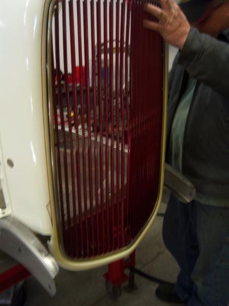

    The 33/34 wheelbase is 6" longer than the 32 (112" vs 106"). Off the bat, that'll give a little room over the 32.
    For my 34 frame, we pushed the front crossmember ahead 1.5" to make room for the Olds, giving a total wheelbase of approximately 113.5". It was an easy way to cheat, especially without a hood or fenders to worry about, and personally, I like the relation of the grille shell to the frame horns better. I know the 33 shell is different than the 33/34 commercial shell, but here's some pictures for reference:
    Sorry for the hijack. Just giving some ideas on making space for that Y block.

    Please don't take this the wrong way, and it certainly doesn't matter in the long run, but I think that may be a '34. At least it has '34 doors. Great score either way!
  22. ynottayblock
    Joined: Dec 23, 2005
    Posts: 1,954
    ynottayblock
    no offence taken, I have a feeling it is a mix of parts. It was registered as a 33 but I have a feeling it was originally a 34 body with 33 front sheet metal.
