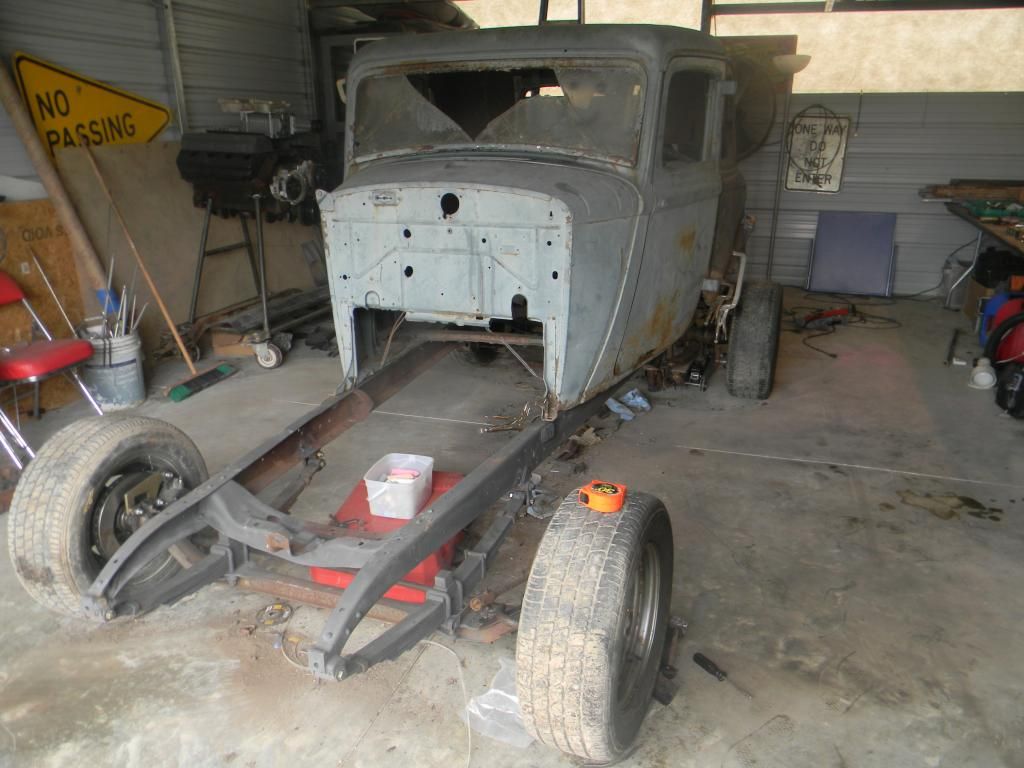

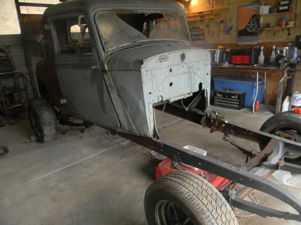

    damn. looks like im doing have to stretch a frame. got the body lined up over the axle. threw the body so far forward that the front fenders end in the middle of the doors. doesnt look very good sense the plymouth fenders usually end near the front of the door. so im going to stretch the frame roughly a foot inorder to get the correct foot print. right now axle to axle is 104.
  5. shtterbug8
    Joined: Jul 31, 2011
    Posts: 512
    shtterbug8
    stretched the frame a total of 18inches. dont have any pictures. im wore out completely and can barely stand up. i used 1/4 inch wall tubing and lined the inside of the original frame overlapping the cut joint 6inches on each side. this tube will then be boxed in with more plate when i box the entire frame for strength. might be a little over kill but looking at the gaint elephant thats going into the frame rails...its seems like just enough. going to mock up the engine in the frame then post pictures for everyone.

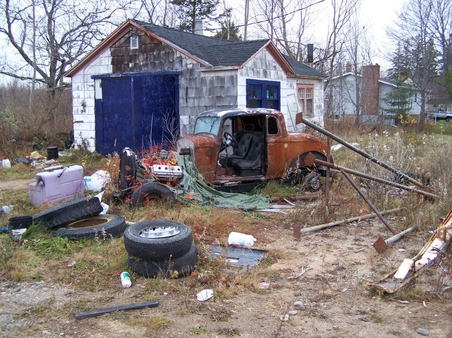

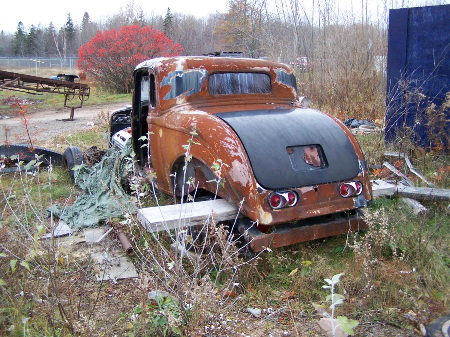

    Wow - I just posted these in another thread about projects sitting and rotting...
    May look a little familiar to you...
    Present owners got rid of the straight axle and clipped in a Volare front end.
    I knew this car back in the 70's and was surprised as hell when I ran across it like this a few years back.

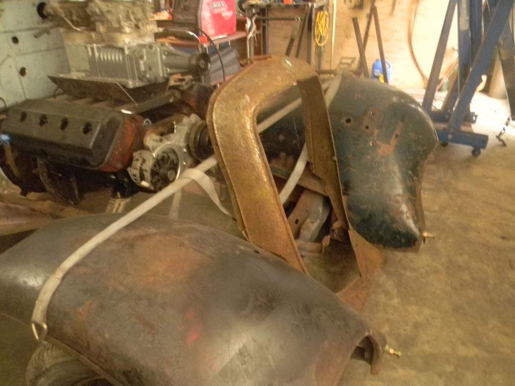

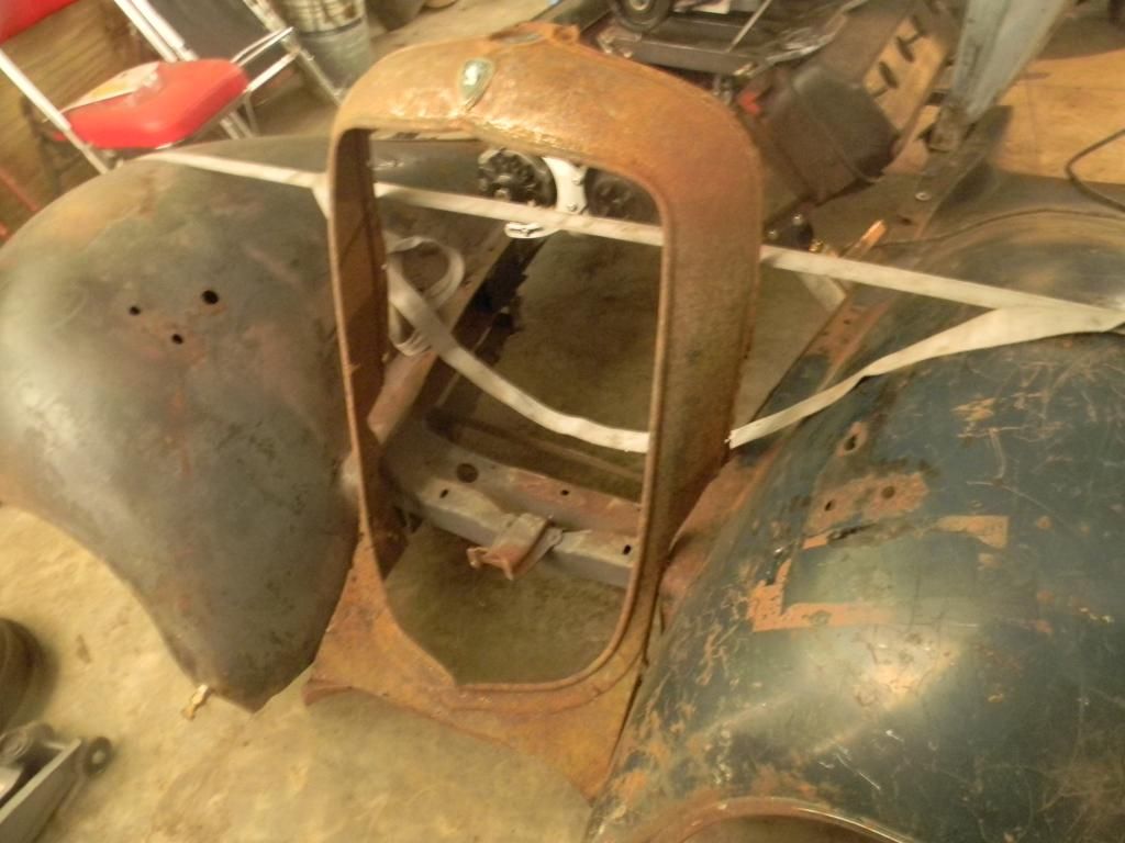

    very cool day today. my 33 plymouth grill came in today. i bought off a fellow hamber on here REMAN. looks freaking great. i beat out a few dents and layed it between the fenders. gotta do a little fitting because the fenders are acutally 32 chrylsers not 33plymouth. does not look bad though.

    Frame will be boxed and x'ed. Just mocking everthing up right now
