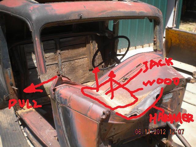

  20. Ruggie
    Joined: Sep 23, 2011
    Posts: 131
    Ruggie
    Hi i have fixed something like this in the past and this is how i did it.I put sideways tention on the A piller while jacking the cowl up(use some wood to spread the load of the jack) also hammering the crease in the firewall all the time makeing shure i keep the tention firm but not pulling too hard.In the end what you are trying to do is reverse the damage start at the worst part and ease the whole thing out,if you take your time there should be no need to cut anything.Remember to measure every thing on a regular basis so you know when everything is square.Hope this helps.

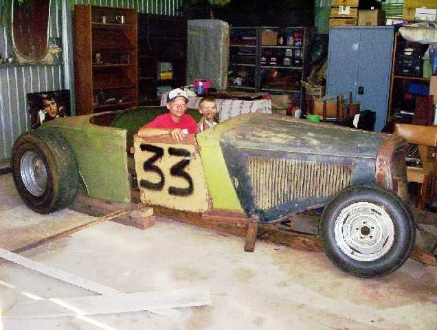

  21. raymay
    Joined: Mar 2, 2008
    Posts: 2,591
    raymay
    Currently helping a friend with a 33 Plymouth Coupe. Search for thread "uncle Ricks 33 Plymouth". We started out with a lot less parts than you, but I will say we had a lot less dents. Not an easy car to find steel parts for. They do make some of the lower body and cowl patch panels in steel. We used Ford rear wheel wells. You certainly can be creative with this one. I would start by getting your chassis set up. That was a big help or us and allowed us to figure out the proper dimentions for mounting the body.
    Good luck and have fun with this one.

  23. Ruggie
    Posts: 131
    Ruggie
    The above method will get the bulk out but there will still be alot of hammering and shrinking to be done after as the metal is already streched,also as you push the dent up make shure to watch the edge and corners of the wood so you dont end up stretching the metal in these areas as the damaged area rises.
