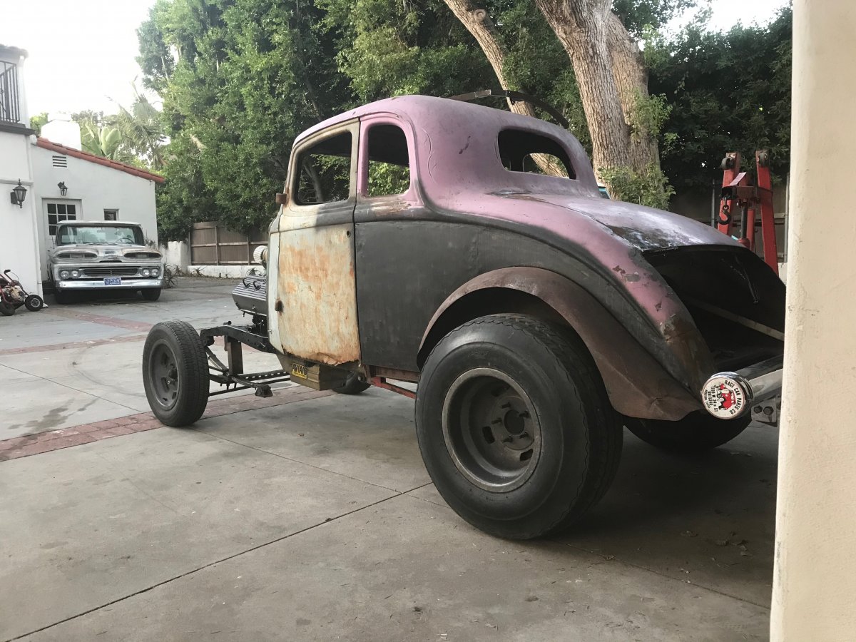

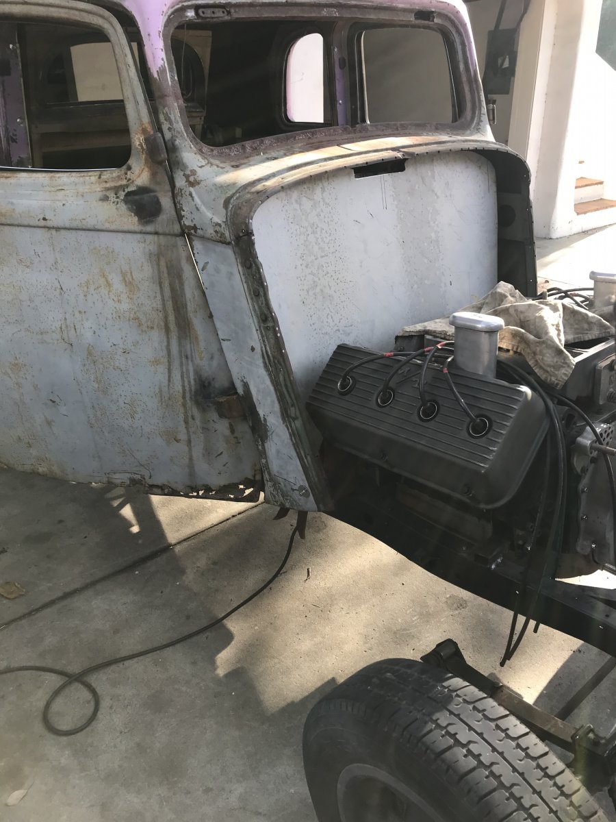

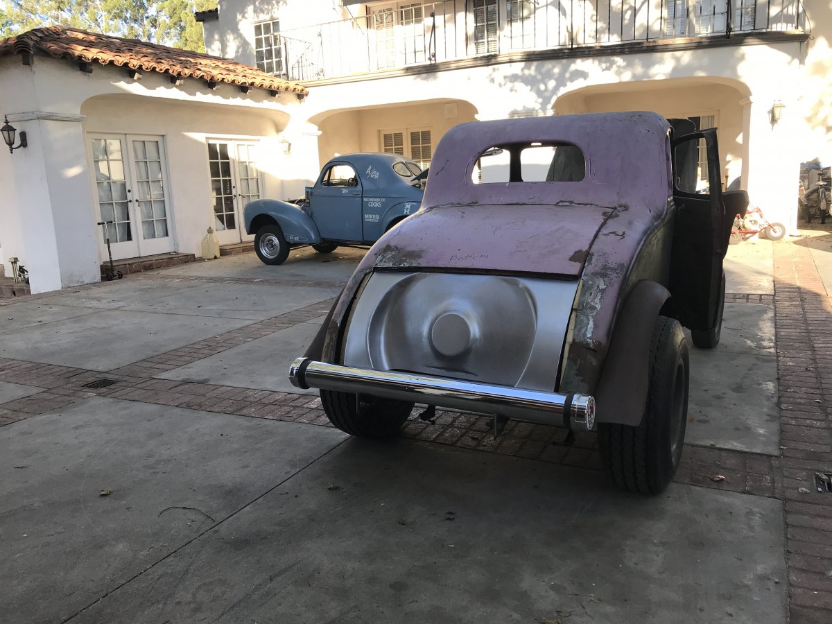

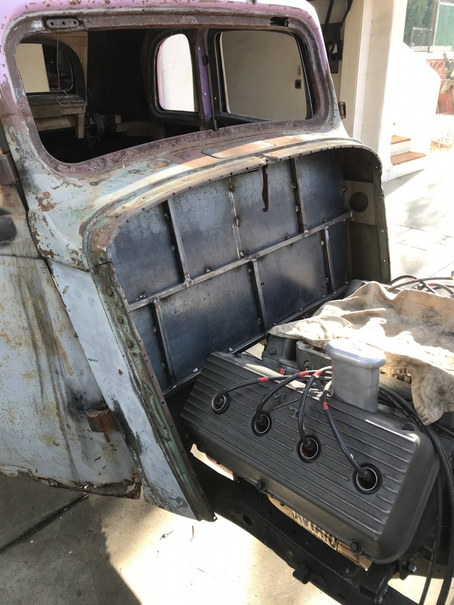

    I have been welding the small metal replacement areas and I am ready to mount all of the wood in the car and attach the trunk panel. After that, I will tow it to the leaf spring shop.
    I ran into a small hiccup with my Fairbanks bellhousing. It fits a 426 and I need it to fit my 392. Hopefully I can find a ****ter shield somewhere to work for my set up or I'll be running a 4 speed instead.

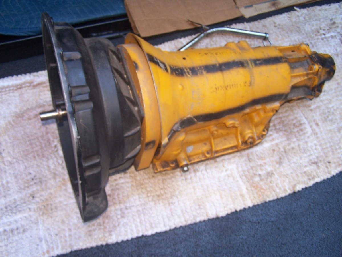

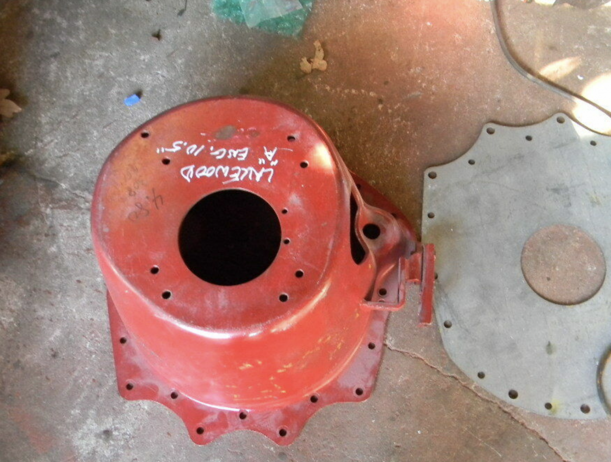

    The Fairbanks is a TH400 with a 727 plate mounted to the front. I'm not having a lot of success finding a bellhousing that works with a clutch transmission since it was originally an automatic. I won't give up though, there is one out there somewhere.

    Thank you! I am going to try to find something SFI since I will be racing.

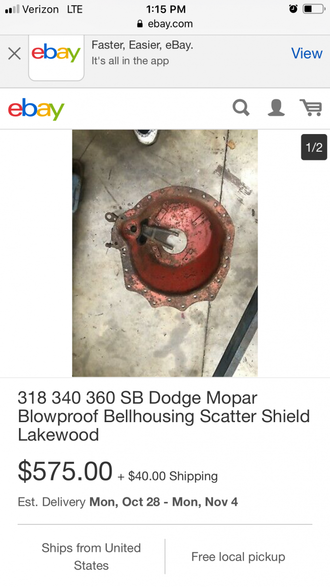

    Damn. I can't believe the pricing on those old ****tershields these days. I don't think I ever paid more than 200 bucks, when buying them. Hell, I'm only 47.
    Sold a used, 85% painted, big block Ford, Lakewood last year for nearly what that guy wants. ^^^
    Don't want to sell ... any more. Can't afford to buy one, I guess. :(

    I saw this but it's WAY overpriced! I looked at old Egay listings and they sold for around $200, so I guess I'll hold out a little longer.

    Mounted the transmission, MAN the oil pan close to the ground.

    So what did you do to get the trans mounted to the motor
  23. drumyn29
    Joined: Feb 16, 2006
    Posts: 2,300
    drumyn29
    re-drilled a few holes and it bolted right up. Small block and big block mopar bells are all the same bolt pattern. It was under $300

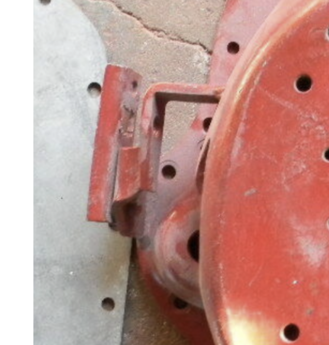

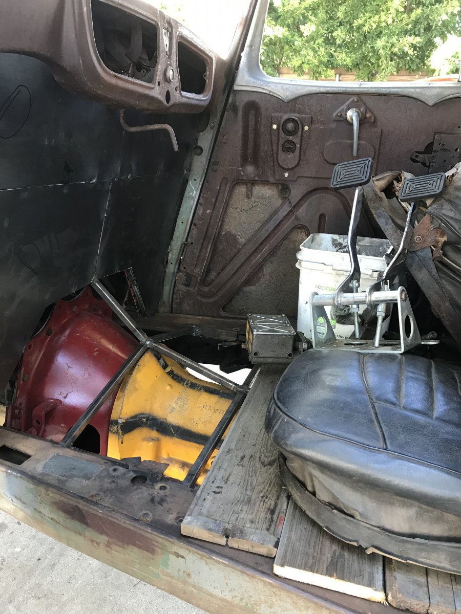

    I wonder what the brackets are for. I may cut them off. Screen Shot 2020-01-05 at 9.50.22 AM.png Screen Shot 2020-01-05 at 9.50.27 AM.png
