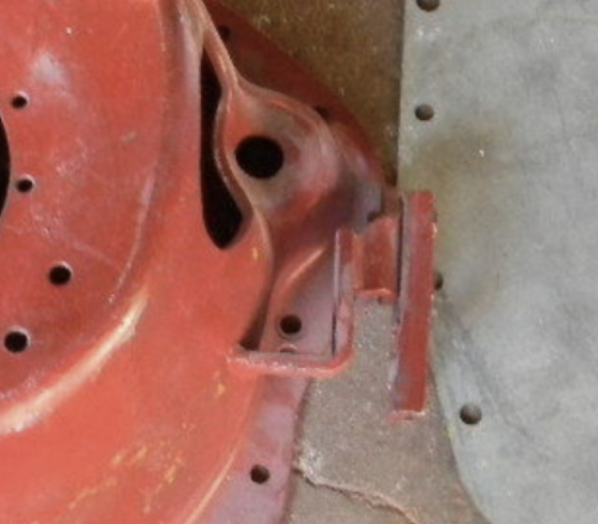

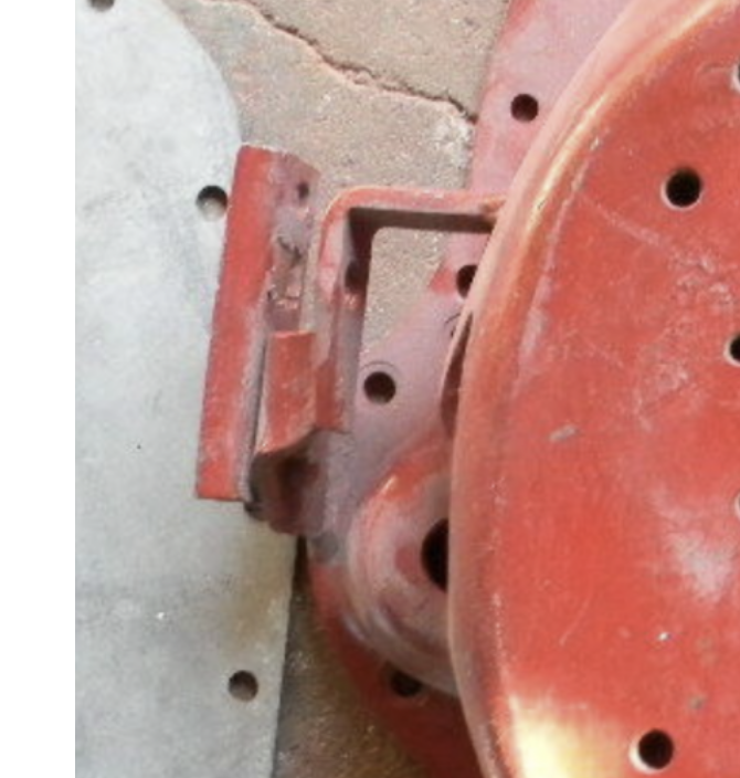

    Those brackets are to mount the inside z bar bracket for a mopar car The car is coming along nicely

    I stand corrected. Thanks for commenting, I would hate to send someone down the wrong path! I think tat I meant to say ALL mopar transmissions have the same bolt pattern as a 392 Hemi with the exception to the 426. Of course I may be wrong about that also.

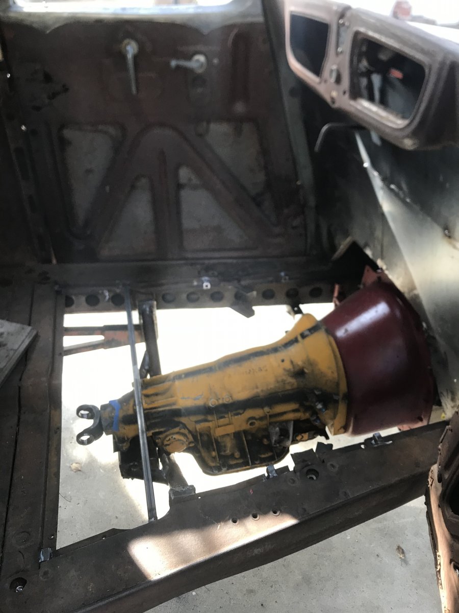

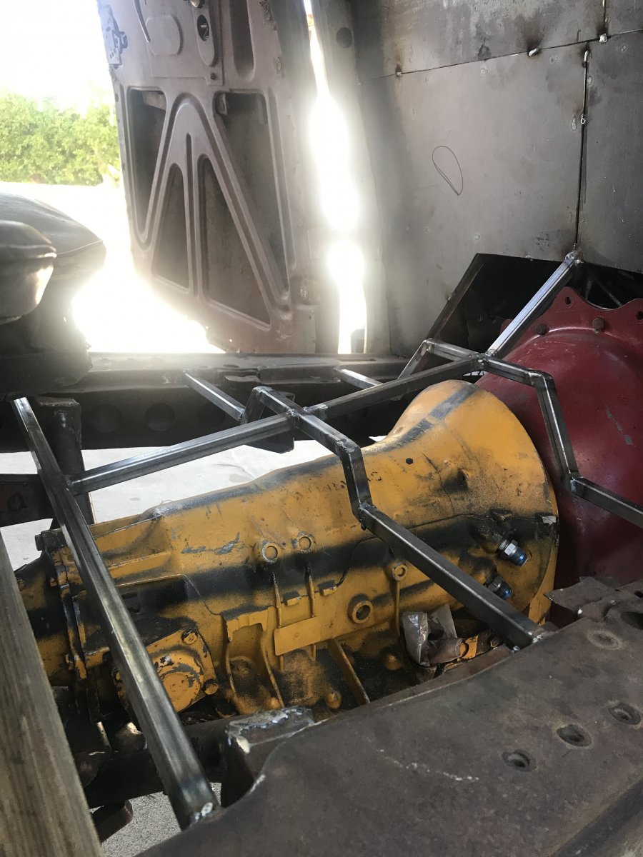

    are you going to have enough room for a trans shield with those square tubes that close to the trans?
  5. drumyn29
    Joined: Feb 16, 2006
    Posts: 2,291
    drumyn29
    oh ****.......

    https://www.dodge-wiki.com/wiki/List_of_Chrysler_bellhousing_patterns
    Small block (and 1st gen Hemi [392], 3rd gen Hemi)
    Big Block (wedge and 2nd gen Hemi [426])
    Make sure a long extension and swivel socket can reach all those bolts or make a removable cover.
    I answered your PM before realizing which project it was attached to; nice work, hope you find an answer!
    As for those brackets on the side of the shield, it would be smart to hang the engine and bellhousing in the car so that the trans can be removed without supporting the back of the engine with a jack. This allows servicing the clutch and trans more easily, along with having additional support to keep the clutch linkage aligned. If you do this, make sure this is also allowed by the floor supports before finishing it. Racing means fixin' stuff! If this was a street car, it doesn't matter if it takes 4 hours to pull. If you are going into the final round, it does matter.
    This is an example of how modern door cars have the trans mounted for access. You don't have to do it this 'modern', but you shouldn't have a single hoop roll bar and no driveshaft loop in a real race car either.

    I was thinking removable cover for sure.

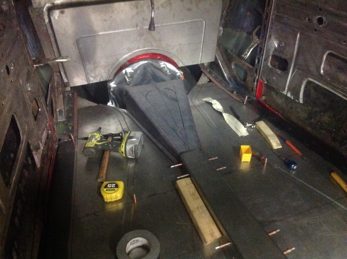

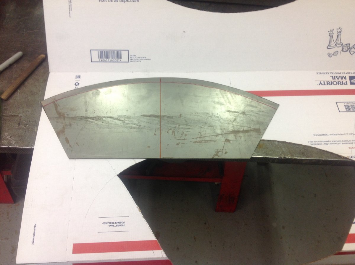

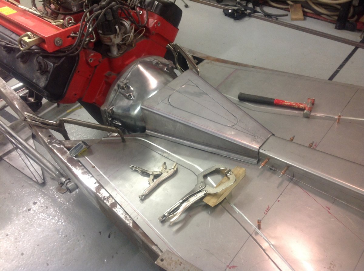

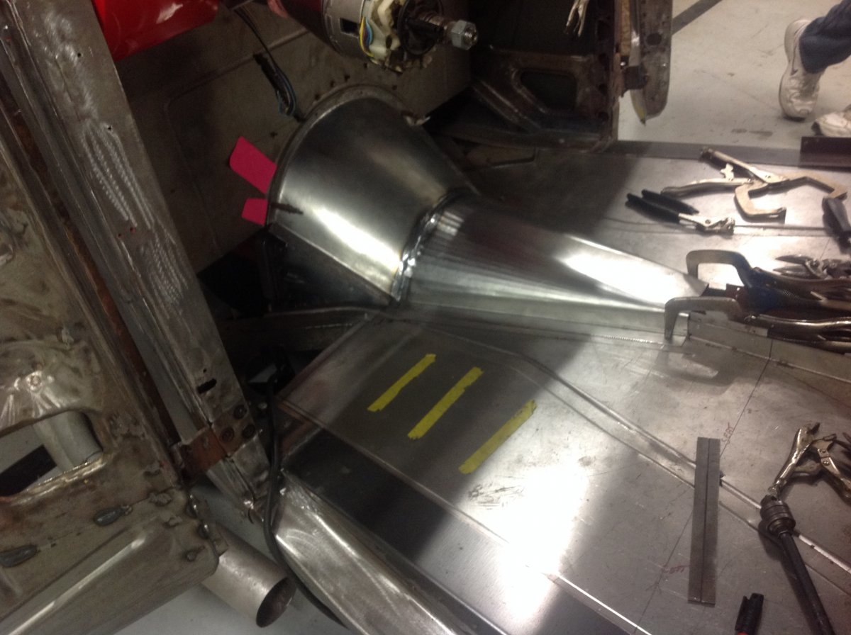

  9. I wouldn’t have those support tubes there around the transmission.
    A formed tunnel is incredibly strong for floor support and light. Also pretty easy if you’ve got a break and can make a pattern .
    This is a small car and the floor needed to be easily removed. It takes a little longer to plan set up build but then goes in and out in just a few mins.
    The routine stuff, or what might be roadside stuff is all under the seat
  10. drumyn29
    Posts: 2,291
    drumyn29
    I have always hated the los of the square tubes. Thats a beautiful floor !
    31Vicky with a hemi and loudbang like this.
  11. DDDenny
    Posts: 22,784
    As Vicky said no need for all that space eating square tubing.
    If you feel the need for extra support you can easily form up a sub-structure out of round stock, I've done it in 1/4" and it is surprisingly strong, lightweight too.
    31Vicky with a hemi likes this.

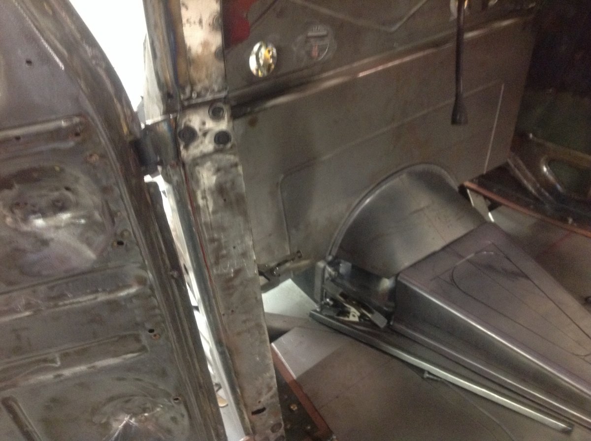

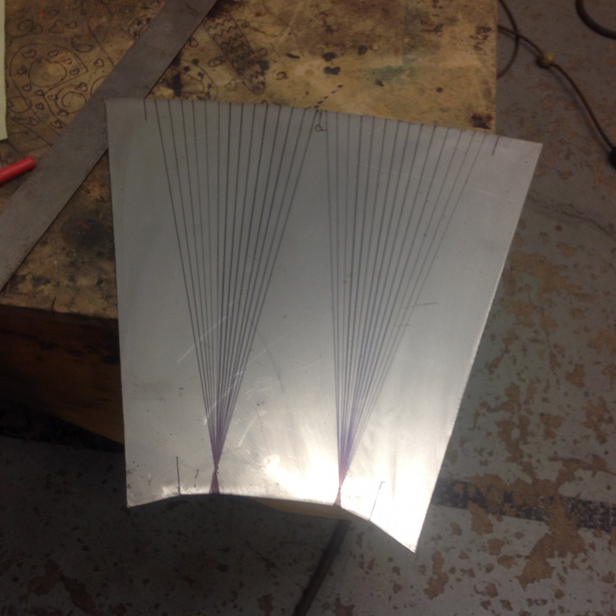

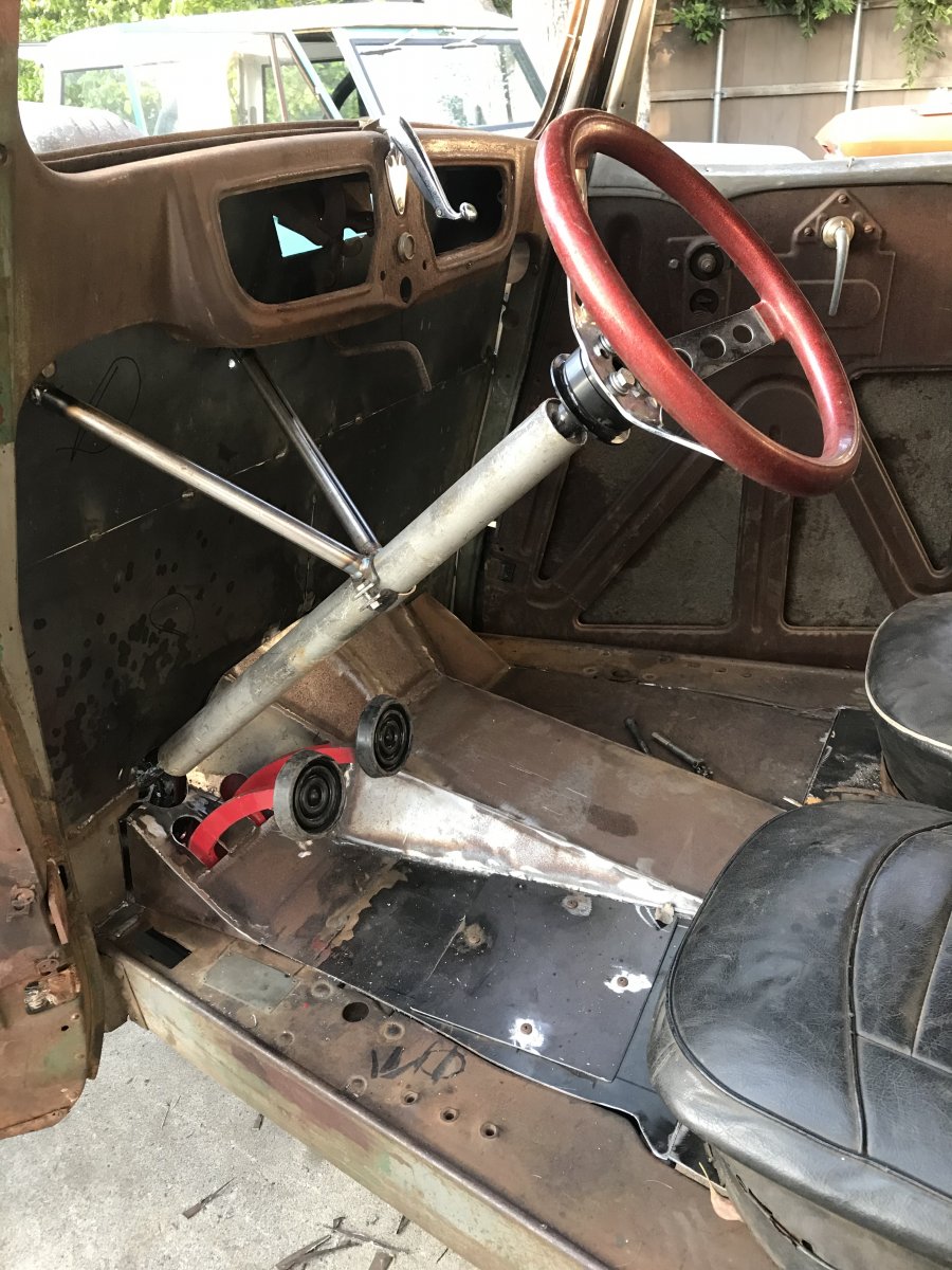

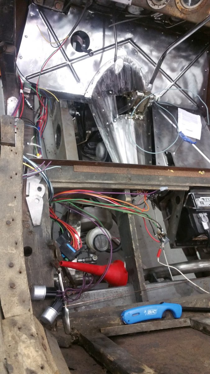

  12. Here’s 2 more to get you going.
    Actually same car and had a change so I changed the tunnel too.
    BF34108C-2F3A-4C49-B98C-5C06F56316A9.jpeg BD969A20-187E-43BA-B883-D6D4B8A8C376.jpeg 05C86676-CADD-4520-8FF7-DF23083BC28B.jpeg 0D45FB01-6017-40B5-B93B-DA4B50117DE0.jpeg EB69F039-12BF-4085-9D9C-7B27F0CEAA27.jpeg A954EBC9-F2ED-426A-A917-E0A0137D79A5.jpeg

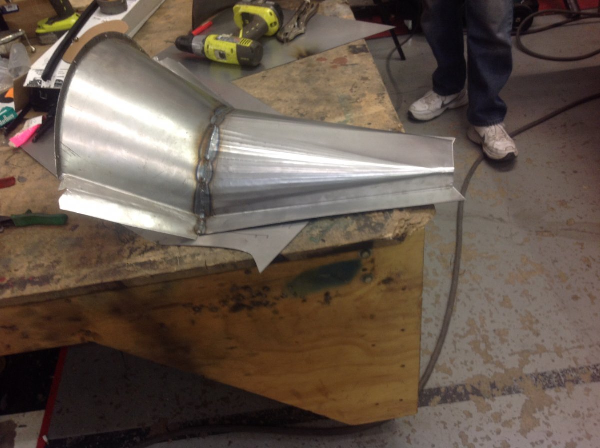

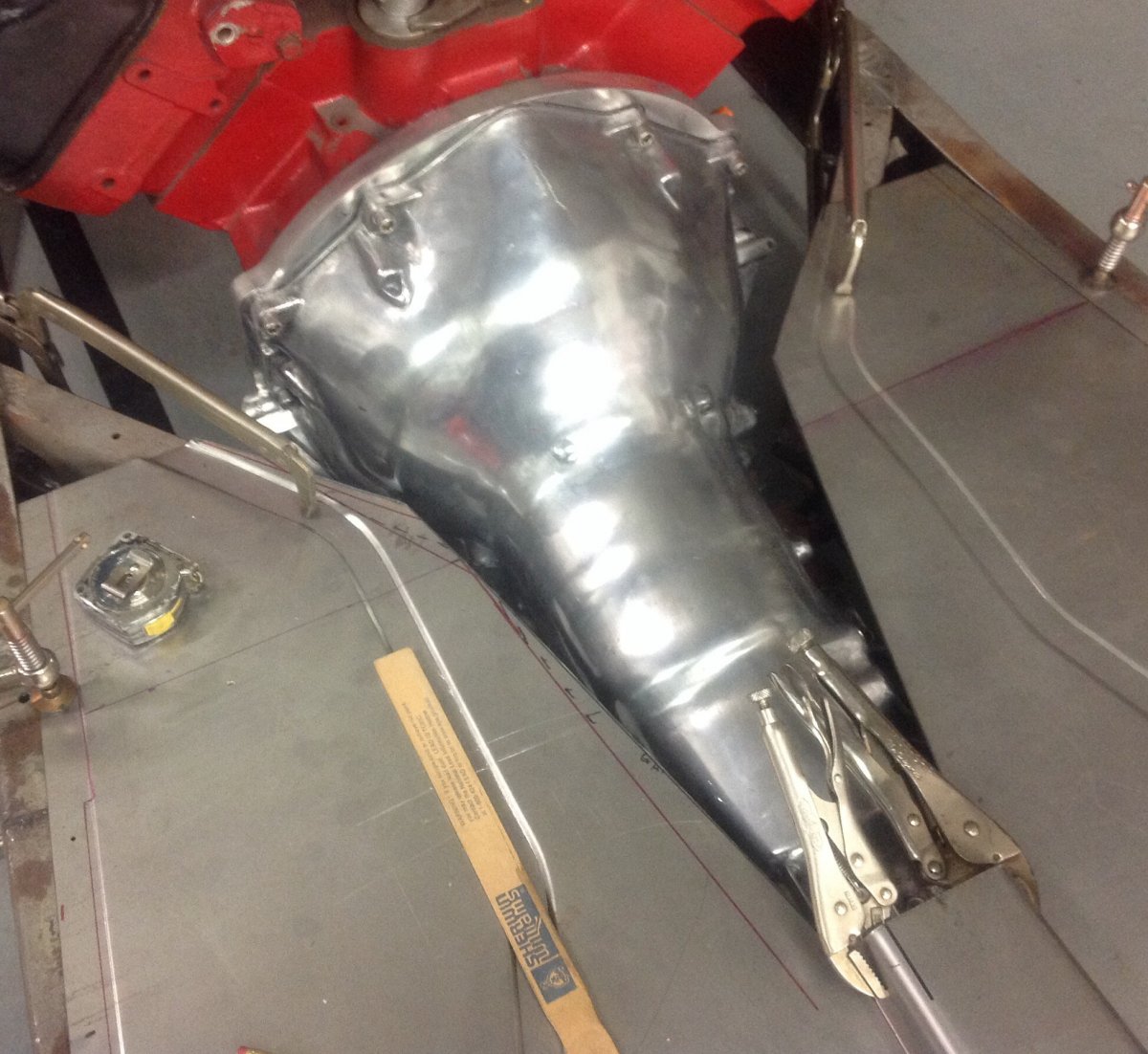

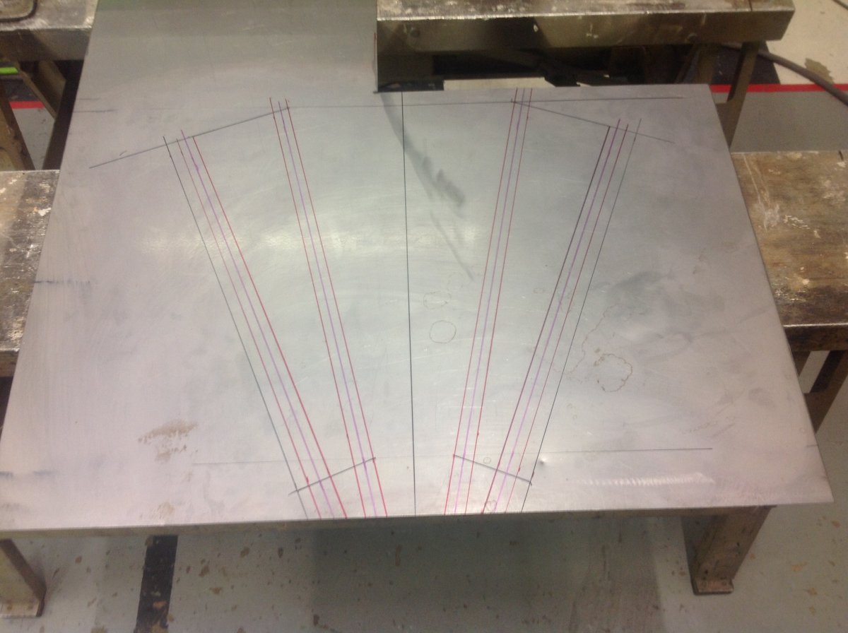

  13. Then the re dooo
    92335829-5DD8-4419-8CCC-143C914509E7.jpeg 231F9F07-6906-4298-B609-527D641A7142.jpeg 988EB7BD-AAC0-4B81-B738-ECA35EB9B881.jpeg CEB0DC63-9470-46A4-AE9F-9BB45E2F5996.jpeg 622CDDA2-9088-4B6C-9B79-799412FC46C7.jpeg
    A fella could wheel out the defined break lines and smooth it out. I kinda like them
  14. chop job

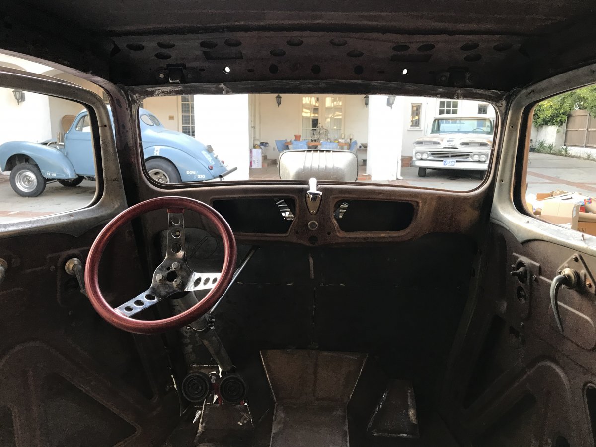

    I don't have any of them there fancy tools like 31 vicky but I did take his advise and I'm glad I did. The floor section that I am building will be plenty strong without the tubing. Now I just need to decide if I should weld it in solid or have it removable. I don't necessarily need access to the trans and the bell housing bolts are easily accessible from the ground and of course there will be carpet and a shifter mounted.

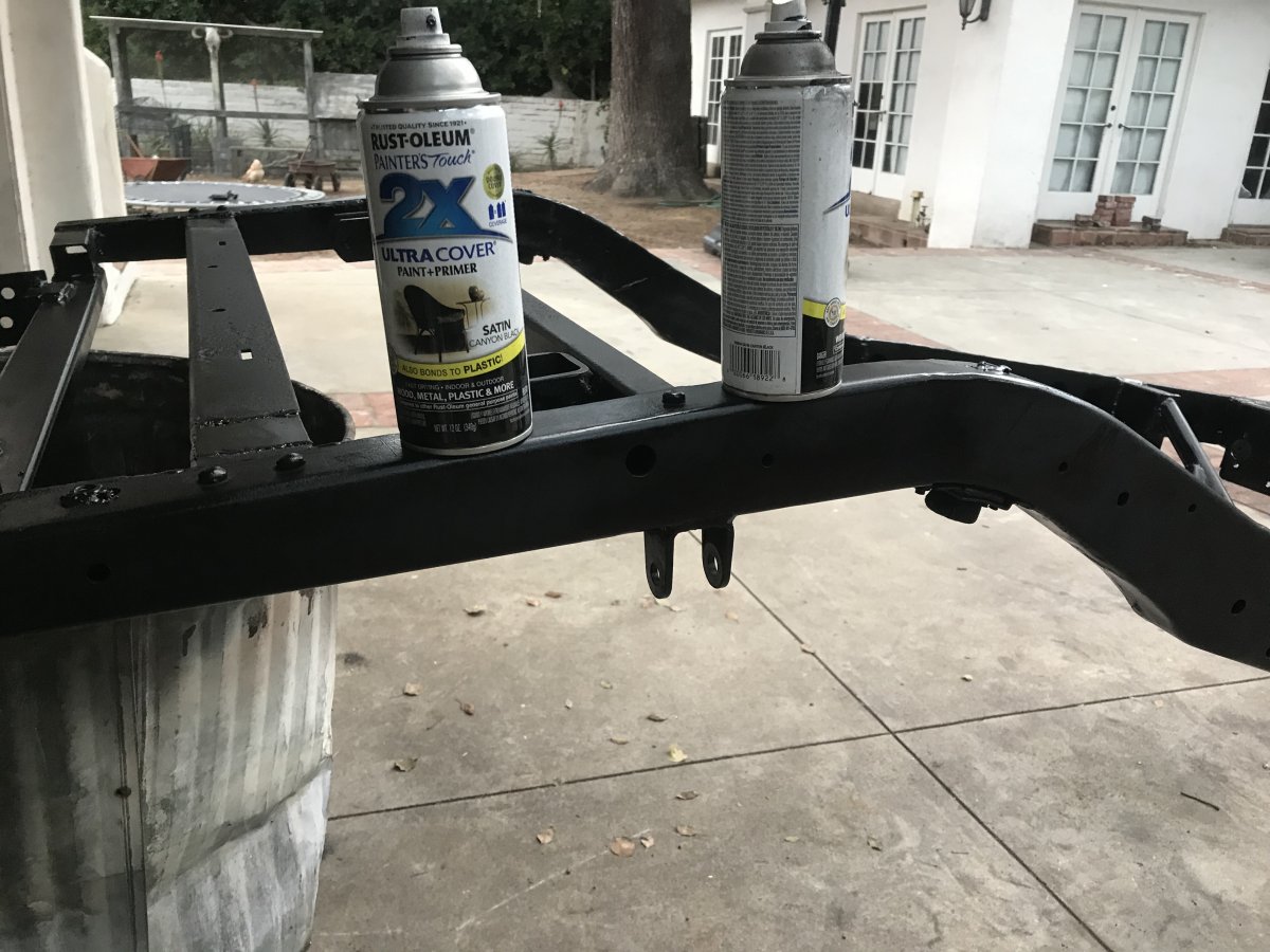

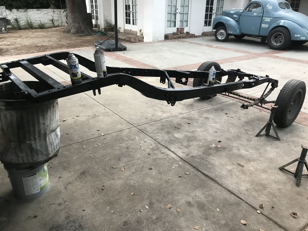

    Finished all of my welding on the frame today(I hope).
    Nothing better than rattle can!

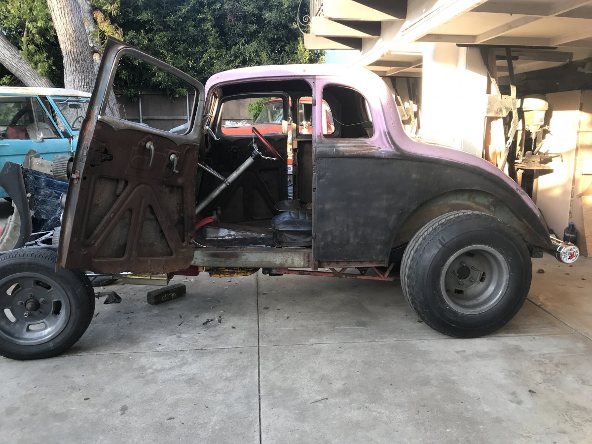

    The back yard build resumes.
    driveshaft, windshield frame, rear coil over shocks, steering box, pitman arm, steering column, seats, pedals, trunk hinges, rolled fenders.
    It's about ready to go to the leaf spring shop and then I can add the brake lines to the list.
    IMG_8834.jpeg IMG_9124.jpeg IMG_9172.jpeg IMG_9173.jpeg IMG_9174.jpeg IMG_9176.jpeg

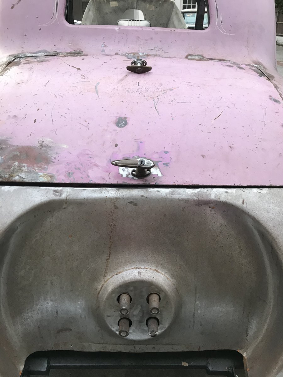

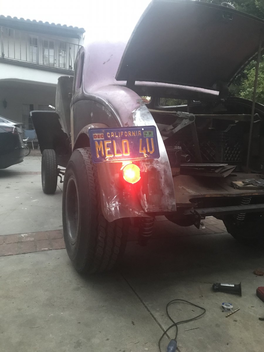

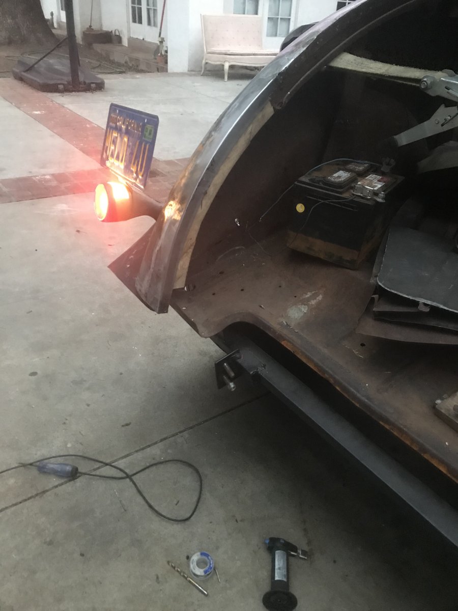

    Rolling with the stock 33 tail light and headed to the shop Wednesday for a new front leaf spring.

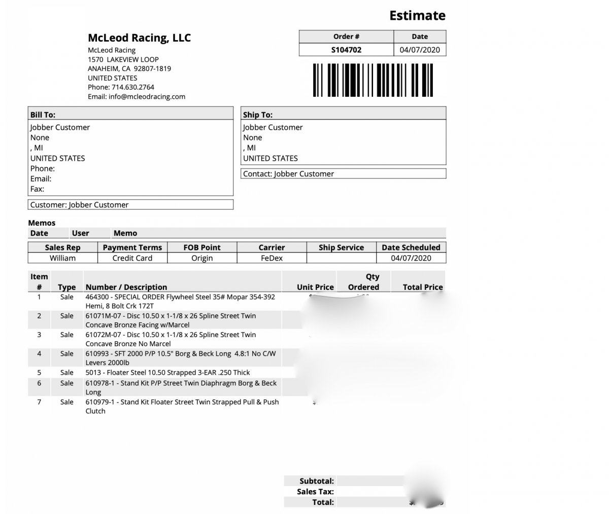

    I also ordered up my entire clutch ***embly for the Fairbanks, ouch!

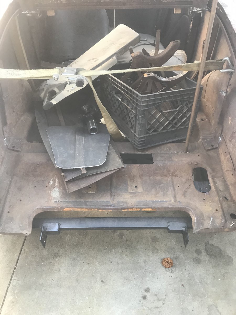

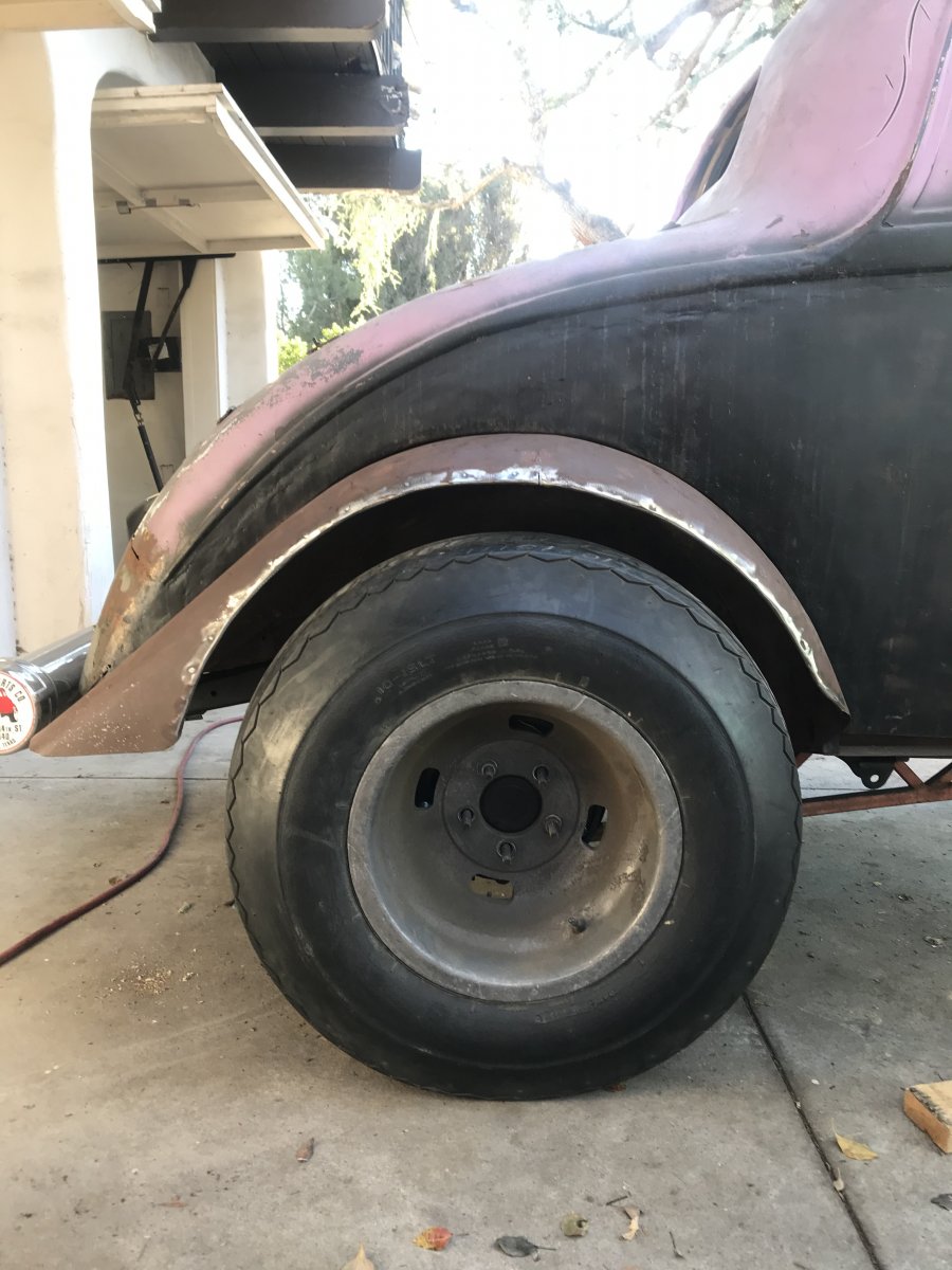

    Rebuilt the rear bottom drivers corner today, p***enger tomorrow and final install of spare tile panel.

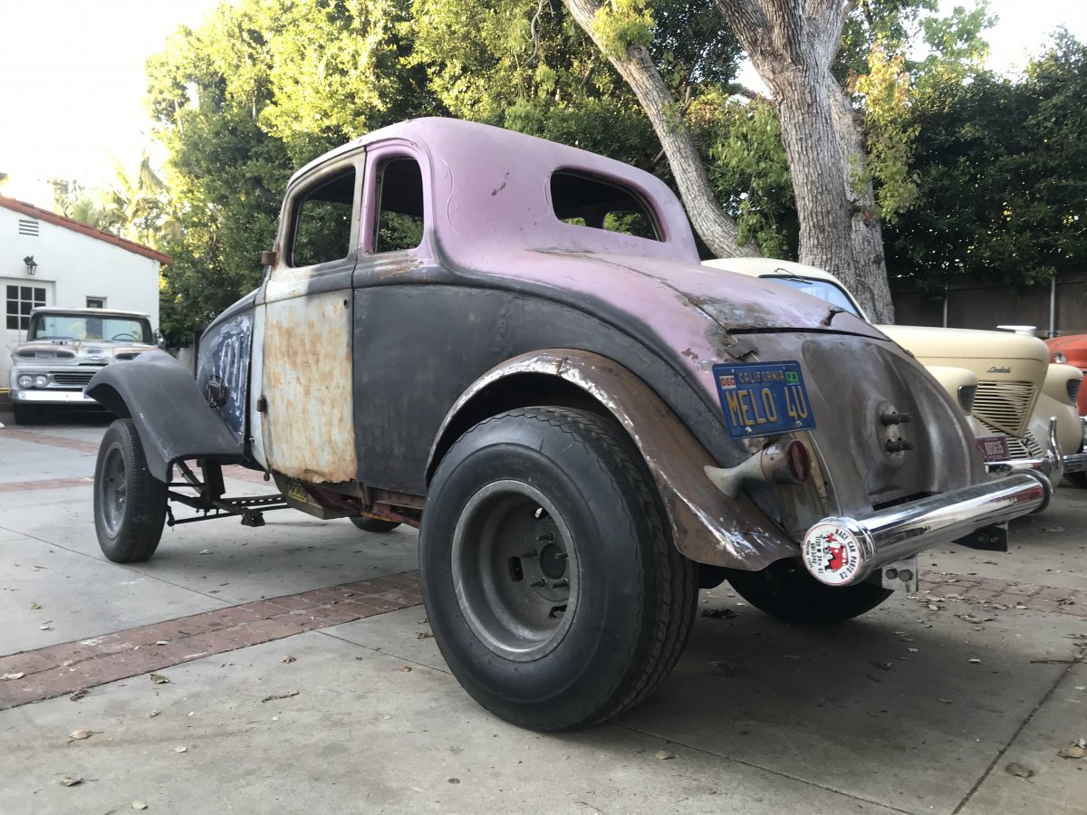

    It took 4 months but I finally have an appointment for front springs.

    It’s coming along great, did they finish the front springs and what is the next thing that you need to do for it to move under it’s own power? Post a few more pictures of it. What was the reaction to it at the spring shop?
