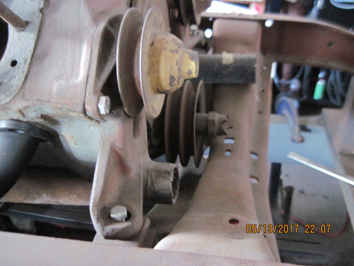

    Can anyone help me with this. I have just put a 8 BA in my 33 cabriolet. And the pulleys are to far out. Crossmember is in the way. Any good suggestions without cut in the frame or change camshaft to get it down [​IMG]

    I think you really need to put your radiator in so you can address the total picture. Fan clearance etc.

    Hi there. Okej, i understand that you are the guys to ask.. In my case i can make all of the part with changing front end of motor or kill firewall or cut crossmember. But i want to make it as easy as possible... I can raise the engine 3 in, But i don't know if the x after the trans will work like that? Any pics?

    I make this on an old ( probably the firs known in U.K.) Hotrod so the Crossmember is strange.. Had both banger and V8 in its history..

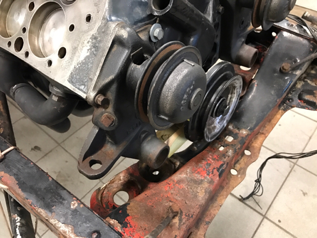

    This is the old school fix.
    This is mocked up to get correct engine position. I am not going to retain double crank pulley, but you can add mechanical fan to generator mount if you want to keep it. Small shim was added to mount, it will be replaced with larger washers. Engine is bolted to transmission with chatter rods hooked up. There is plenty of firewall clearance for oil breather and throttle linkage. U shaped riser on motor mount is original Ford part. Some suppliers do not have the correct one. Early Ford Store in San Dimas has the correct part. You need to make sure you have enough clearance on bottom pulley to install fan belt.

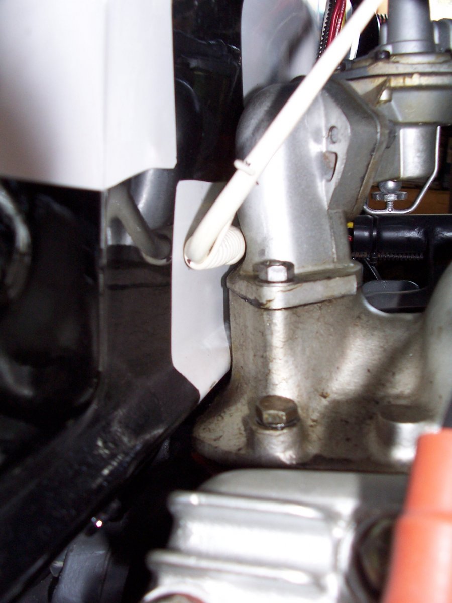

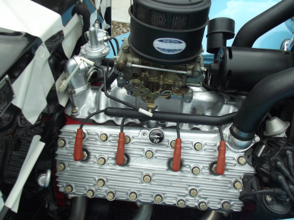

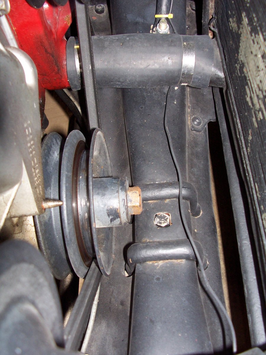

    Have one in mine what a pain. Firewall pushed back 1/2 inch in middle. Early water pumps and chevy dist. to clear fan belts. Notch in fuel pump stand to clear stock gas pedal. lots more little things I don't even remember. DSCF6913.jpg 100_7711.JPG 100_7711.JPG 100_7710.JPG

    Never have seen one like that, however it still looks like using the U style risers will work with early pumps. The risers are made so they take in the wider pump mounts. They not only elevate the motor with the stock mount but also off set the mounting bolts.

    no room for the U-bolts. How are you going to install a fan belt?
  19. AngleDrive
    Joined: Mar 9, 2006
    Posts: 1,169
    AngleDrive
    from Florida
    I machined off the second pulley, I don't need it. Those were old photos from when I started. When I start my build thread you will be able to see it all fits together quite nicely.
