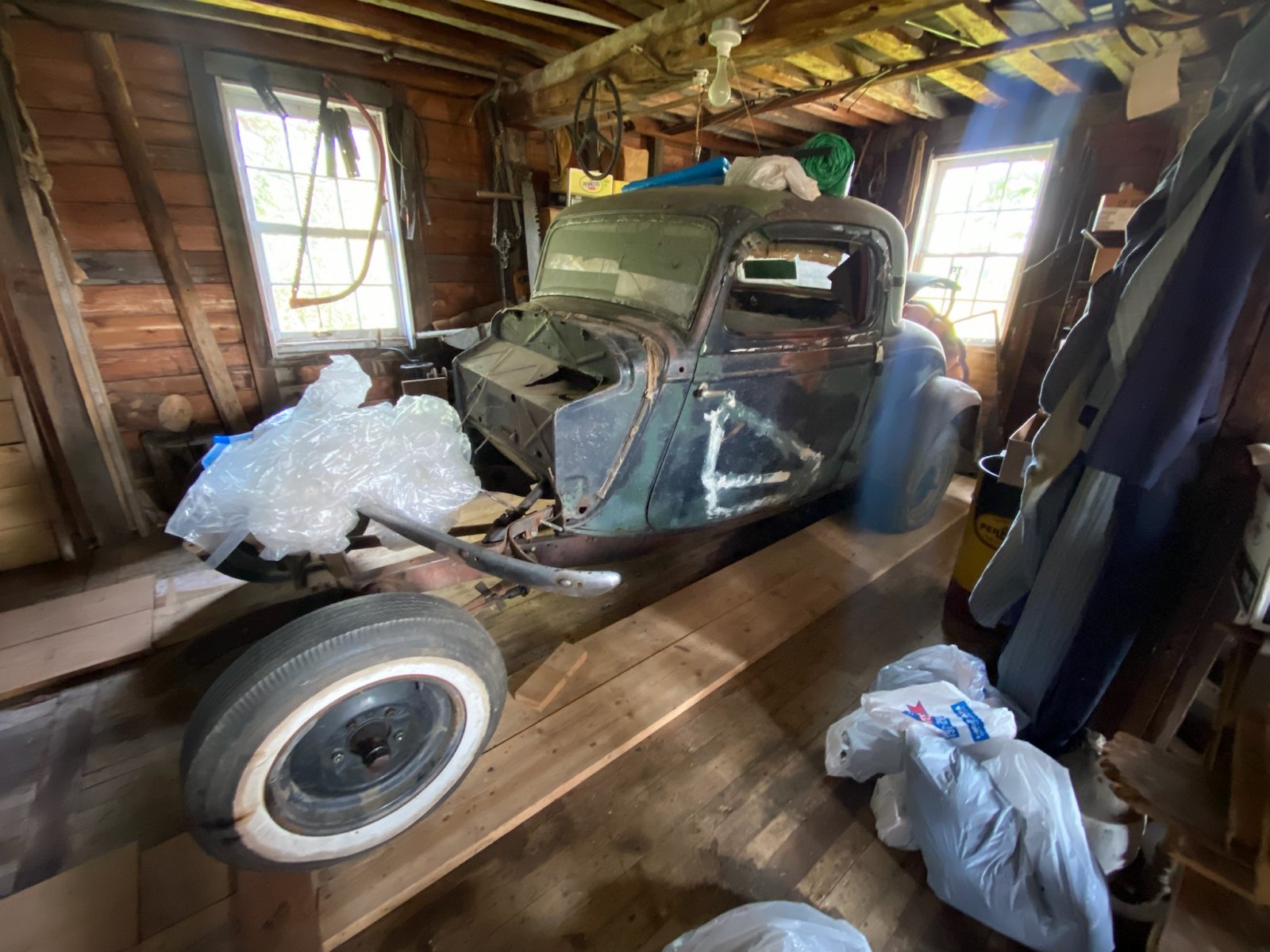

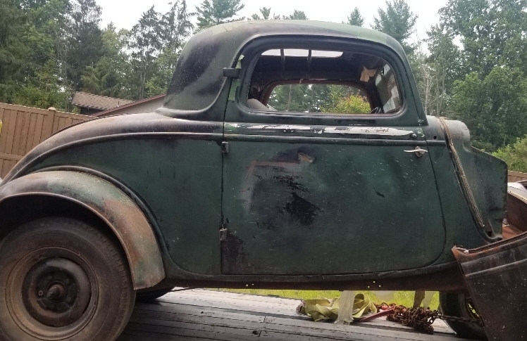

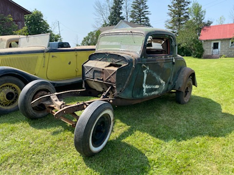

    Anyhow, about a month ago Matt Murray, from Irontrap Garage, gave me a ring that he had a lead on a barn full of 34's stored since the early to mid 1960's. Matt is a local guy and in addition to horse trading and parts swapping over the years, we've become good friends. He knew I was sorta lookin for a 34 3 window and filled me in that there was a nice solid one in the bunch. Fast forward a month...the deal worked out for everyone and the 3 window got to my garage.
    It was put into dry storage in 1967 and hadn't seen the light if day until this past week. The car came with Polaroid pictures taken back in 1967 when it was 1st purchased before being put away. Amazingly , the condition is exactly the same today. Also included were letters from the owner's brother to him when he went to look at the car for him. Some pretty cool do***entation that you rarely find with these cars

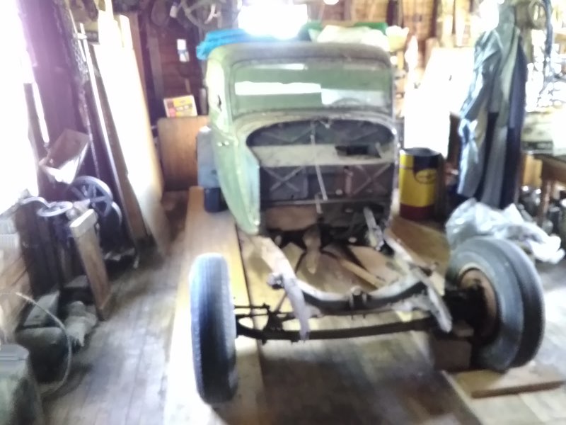

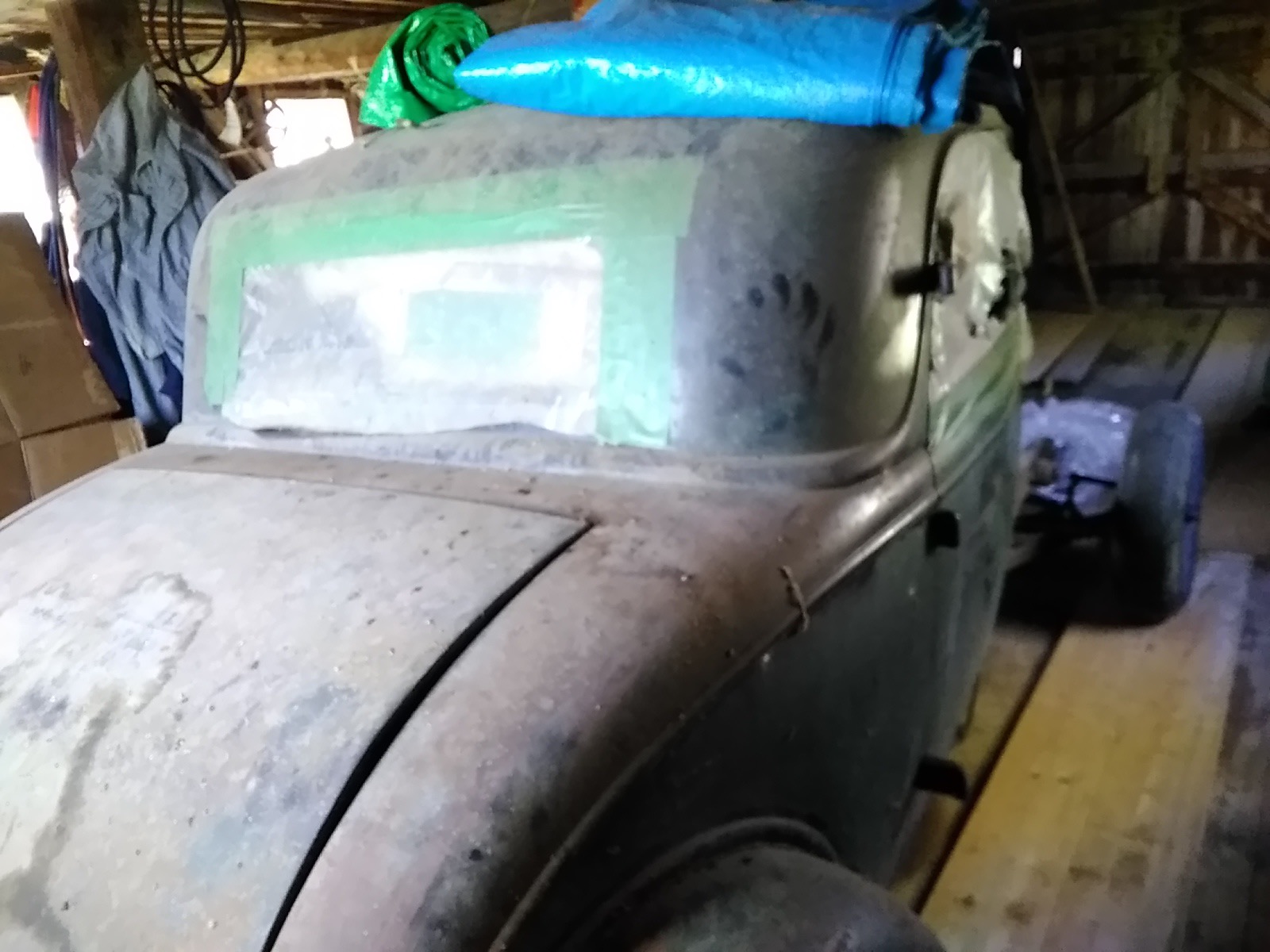

    The body is practically rust free...probably the most solid one I've ever seen. It was coated in a green primer of some kind and the window openings were taped shut with plastic and green tape

    I was worred about rust on the roof opening..but again..rust free. I had to heat the tape with a heat gun in order to get it off.

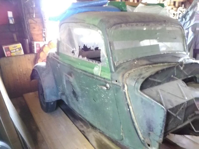

    Next I slowly began getting the green **** off with heavy duty oven cleaner. This was a trick that Scott McCann in California told me about that he used on a roadster of his years ago. Scott found numbers underneath a top layer of paint and discovered that his roadster raced on the salt flats years ago. He painstakingly removed the top layer of paint slowly using oven cleaner and shared with me how he did it. It worked great..
    I should say at this point I dont know 100% what Im eventually going to do with the paint....chop and repaint...chop and save the paint..blend in on cut lines..etc. im just having fun cleaning the car up at this point.

  24. Awesome results, that technique works well.
    ...any chance you could tell us how its done?
  25. HomemadeHardtop57
    Joined: Nov 15, 2007
    Posts: 4,340
    HomemadeHardtop57
    There's a picture early in this thread. You just spray the oven cleaner on wait 5 minutes and start wiping it comes off a little bit of time

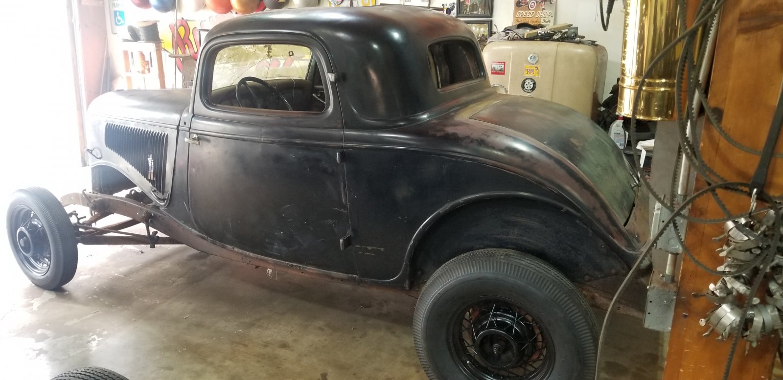

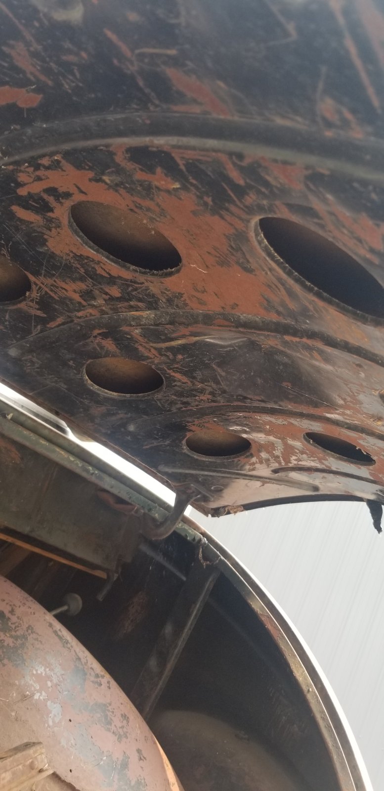

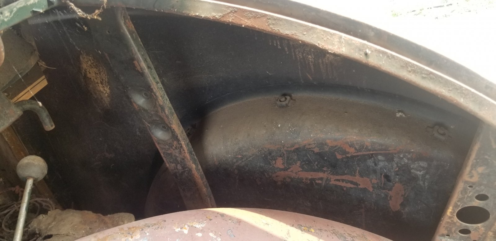

    Told the fenders off today and the rear tank cover to check out the wheel Wells. Surprisingly they were also super solid and rust free. All of the mounting bolts came out super easy which is not my usual luck 20210729_112746.jpg 20210729_112742.jpg .

    Had a set of wire wheel rollers that I threw on for now

    I have a 34 3 w and the rear inside wheel well has the crow feet indentations. I notice some do not. I thought the 33 s were smooth, unless Henry mixed and matched. I also was told by a good friend he had a 34 with one side smooth and the other had the crows feet. Any thoughts?
  30. HomemadeHardtop57
    Posts: 4,340
    HomemadeHardtop57
    From what I understand there were several variations on these 34's. Early 34's had the smooth wheel wells, door handles on the extreme end of the doors, and a fully stamped dash where the instrument panel is.. a**** other variations. Little changes to the body happened as the year went on and they were being produced
