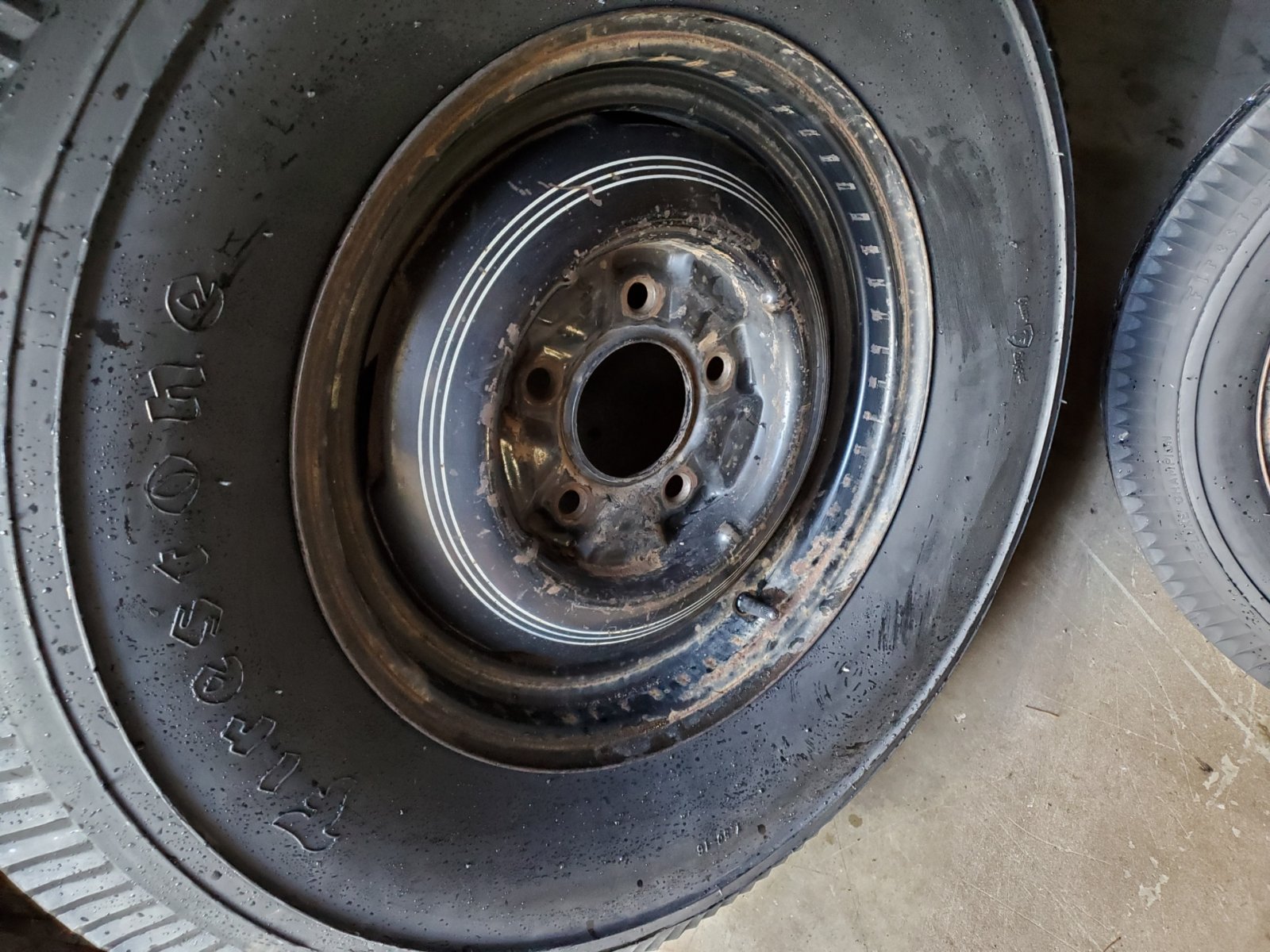

    Found some original black wheels with cream pinstripes. Git my tired mounted this week

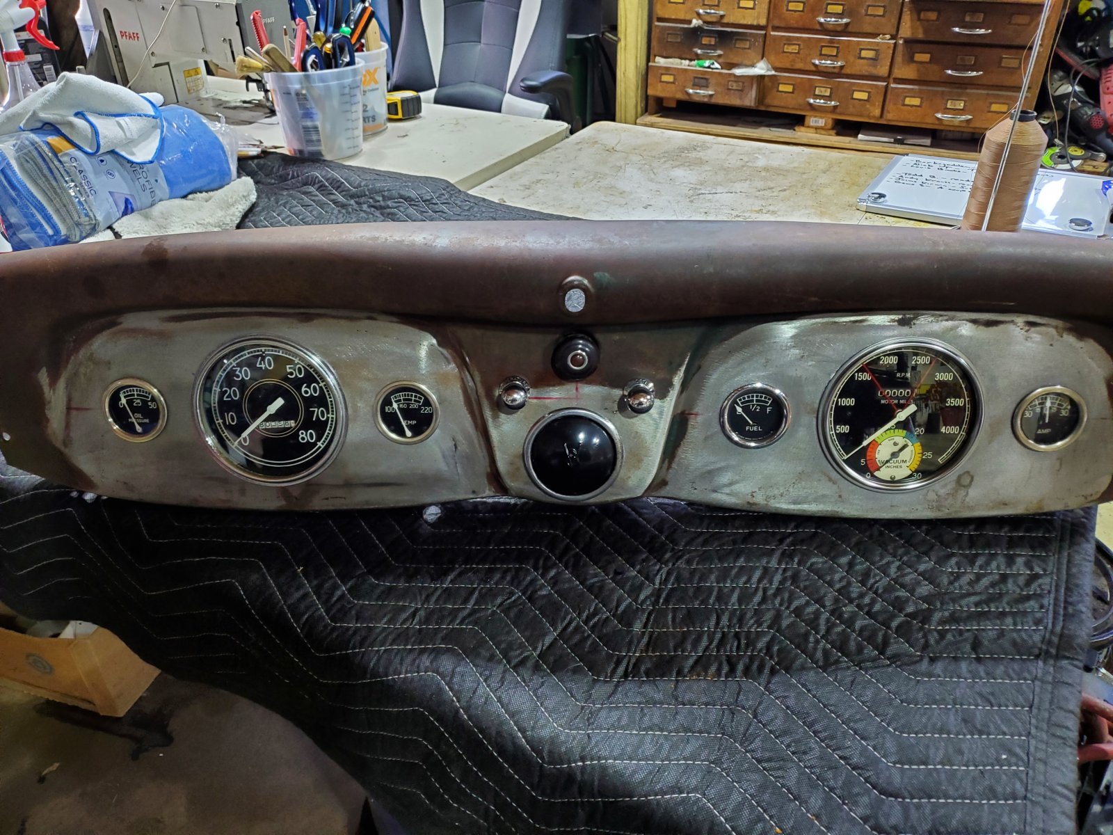

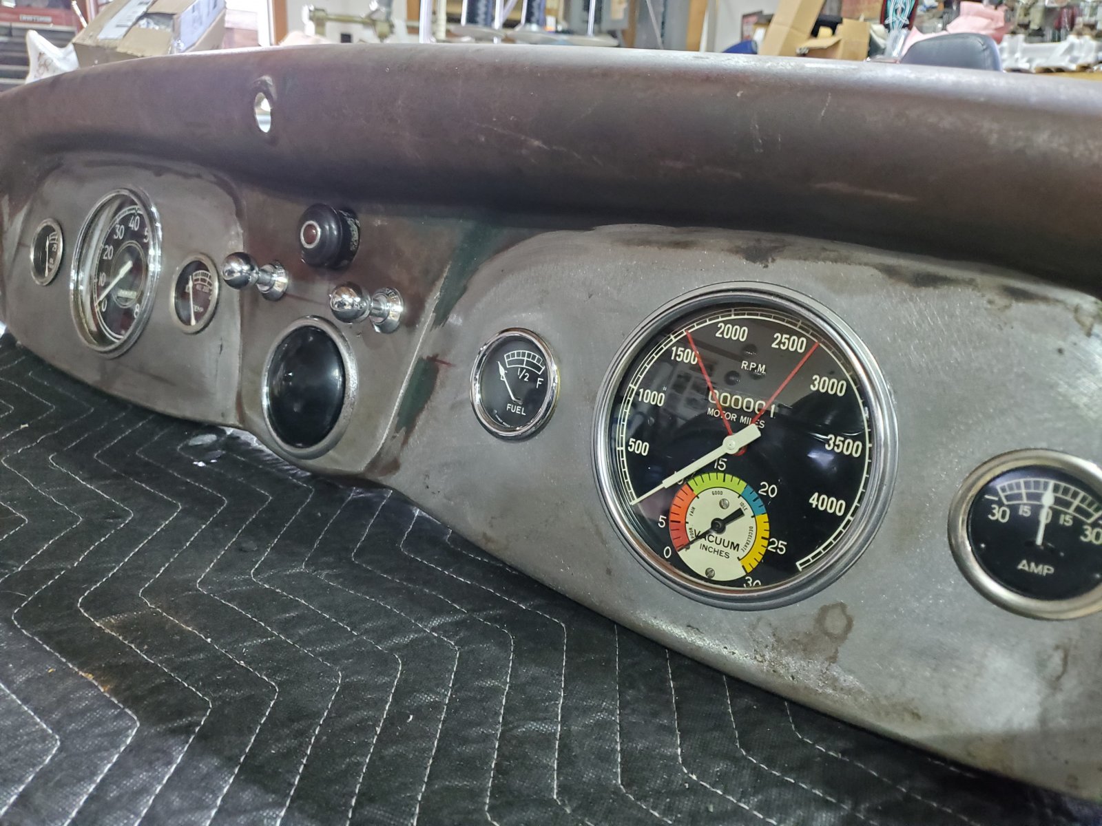

    20220922_154958.jpg 20220922_154944.jpg 20220922_154935.jpg Got the dash finished up today. Early Stewart Warner big and little gauges, 37 astray, and 49 shoebox knobs.

    Got the dash bodyworked and I sprayed it with some black lacquer. When the paint dried I added some patina with some rubbing compound applied with superfine steel wool and then rubbed clean with a course shop rag. Looks like old lacquer and matches the paint on the body now. Put my gauges in it this morning . Very happy without how came out. Lots of work in this
