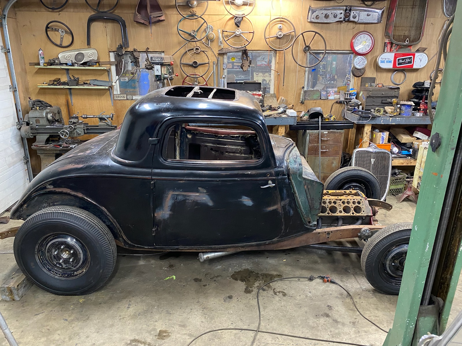

    Fitted the body on the finished ch***is today. I think it sits nice

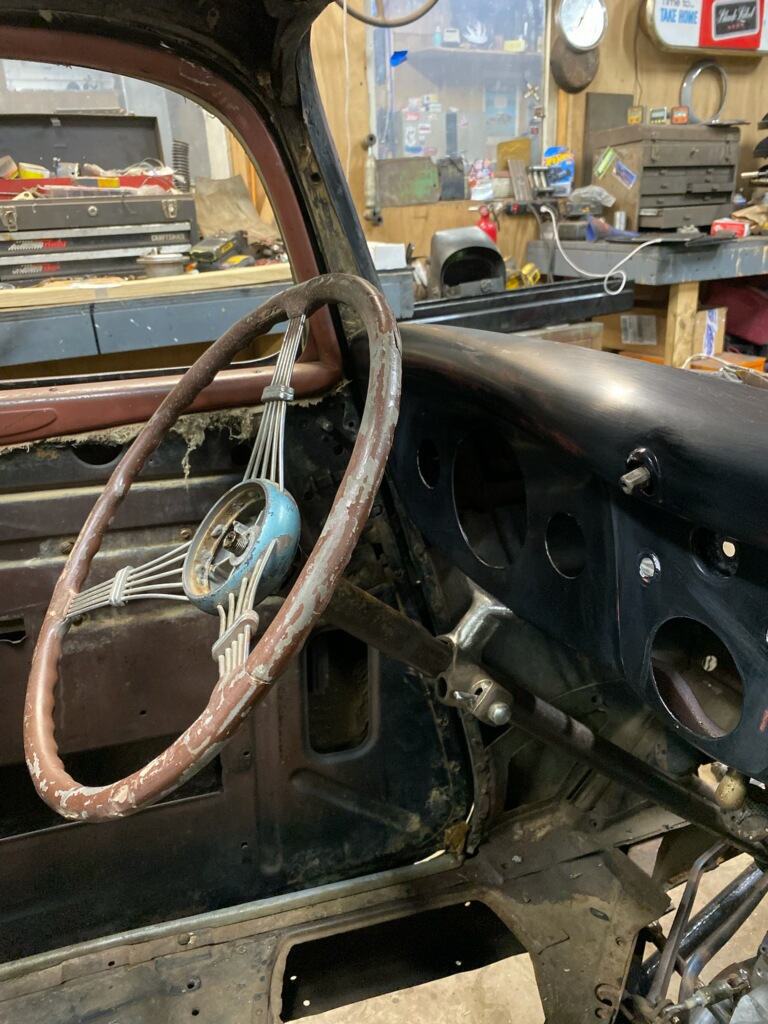

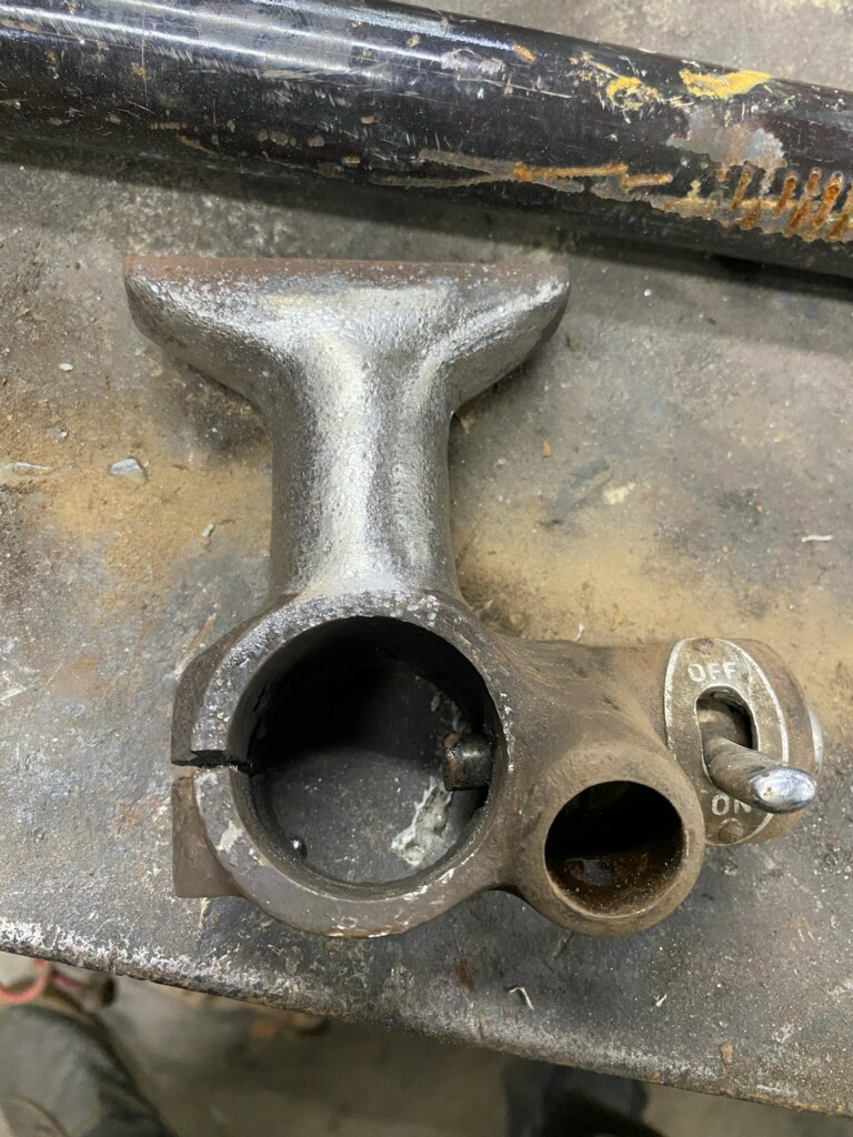

    HomemadeHardtop57

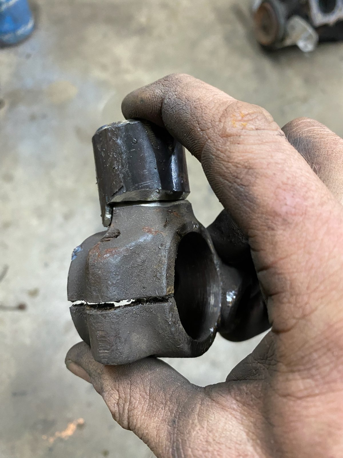

    F-1 steering box installed today. The stock flange was trimmed off, box was fitted to framerail, and new mounting flange welded on.
    Column drop is a 36 Ford that was lengthened.

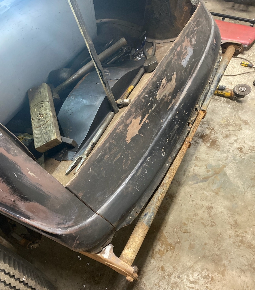

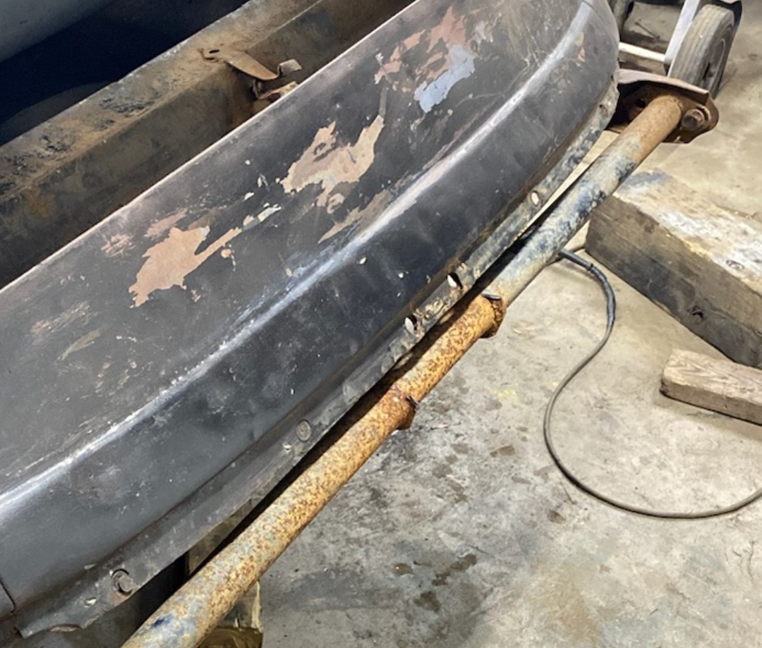

    HomemadeHardtop57

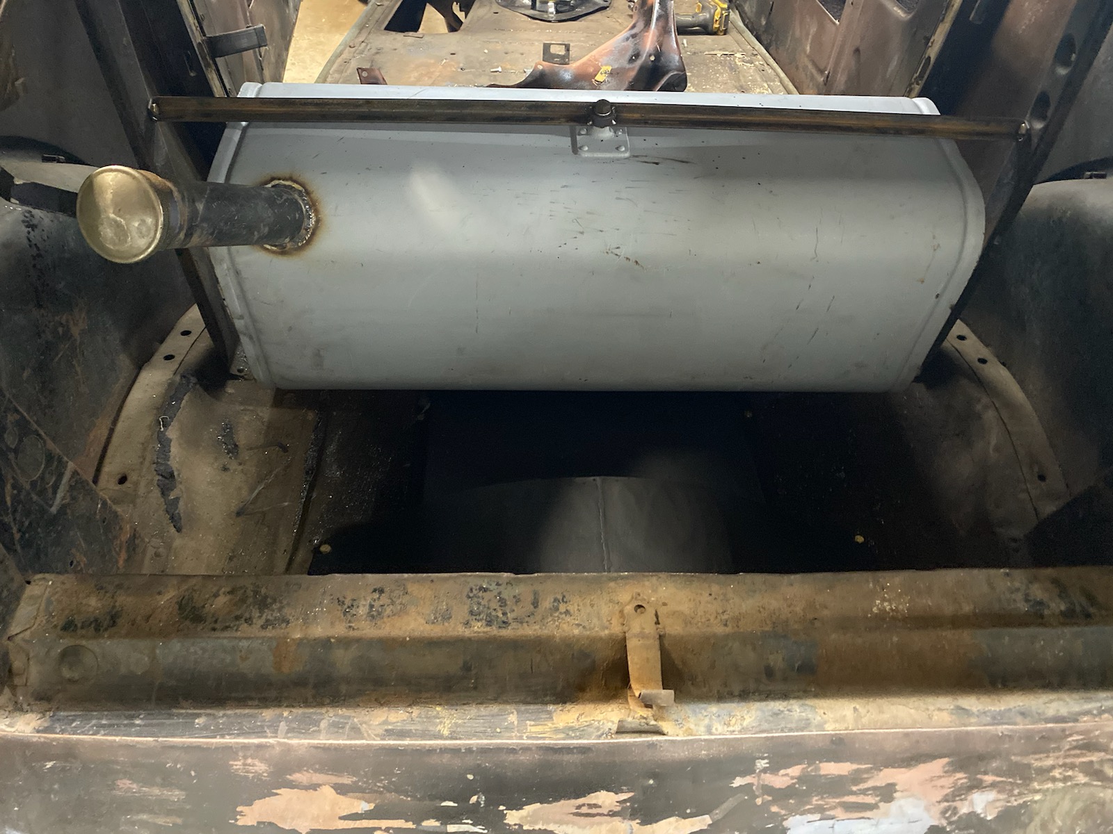

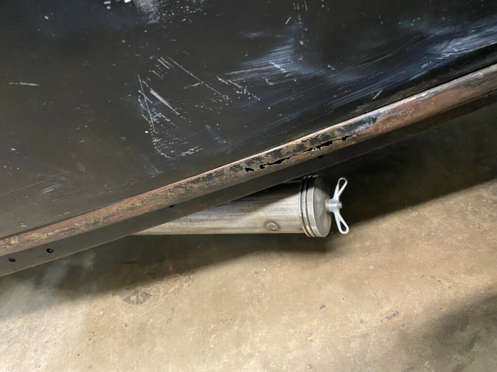

    Some more progress. Rear frame horns bobbed and tucked into the tail pan. Block off caps for the exhaust dump tubes were made from model A piston tops. The wing nuts are British bicycle hub fasteners.
    I found the gas tank at Hershey this past year and it tucks nicely into the trunk area. Floor cover made for the model a Spring in the rear.
    Firewall was fixed up where it was previously cut and smashed down for a battery. 698694004.jpg IMG_0814.jpg 698694044.jpg imagejpeg_0(1).jpg 698694118.jpg Screenshot_20230221-131256_Chrome.jpg

    HomemadeHardtop57

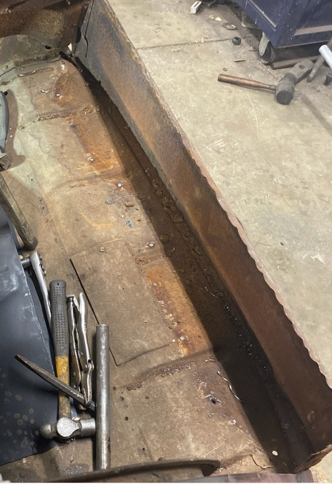

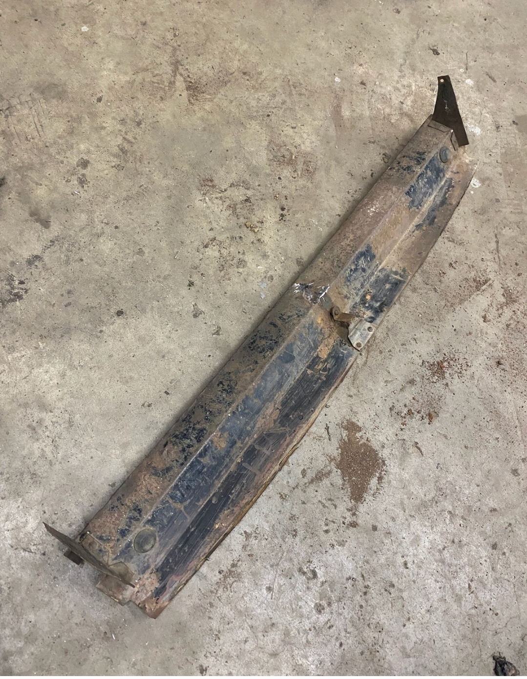

    Tailpan bead had lots of bumps and bruises. Looked like someone tap danced on it. Inner structure temporarily removed and dents knocked out. Por 15 then inner reinstalled. Much better!

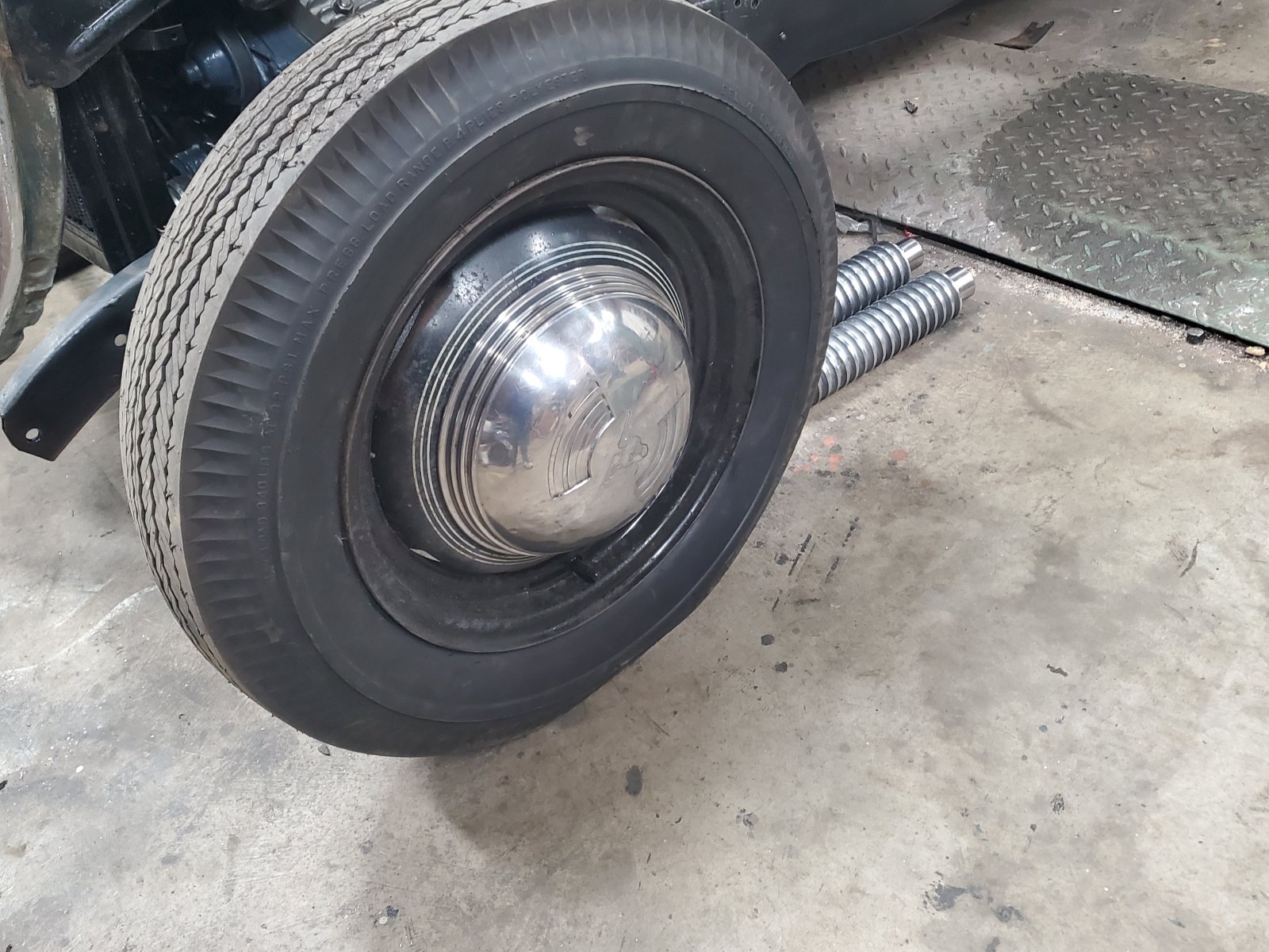

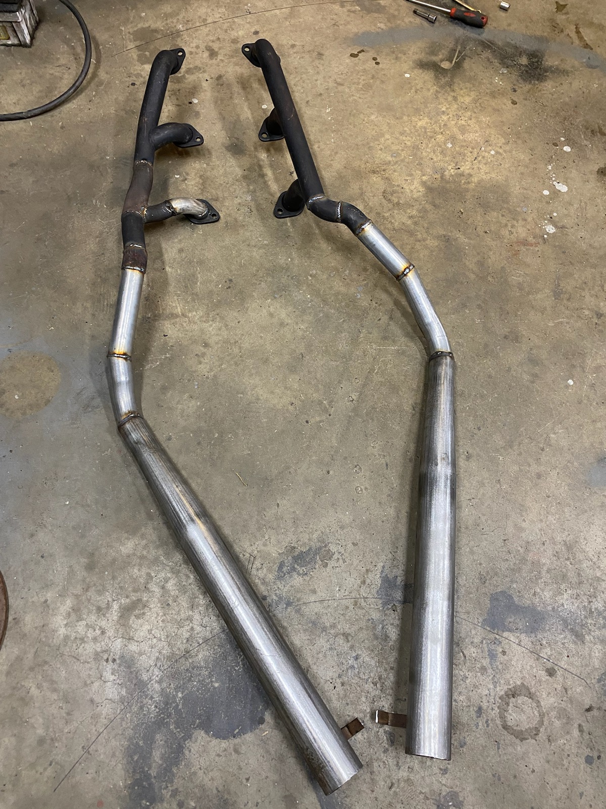

    Engine, ******, exhaust, shocks, installed!

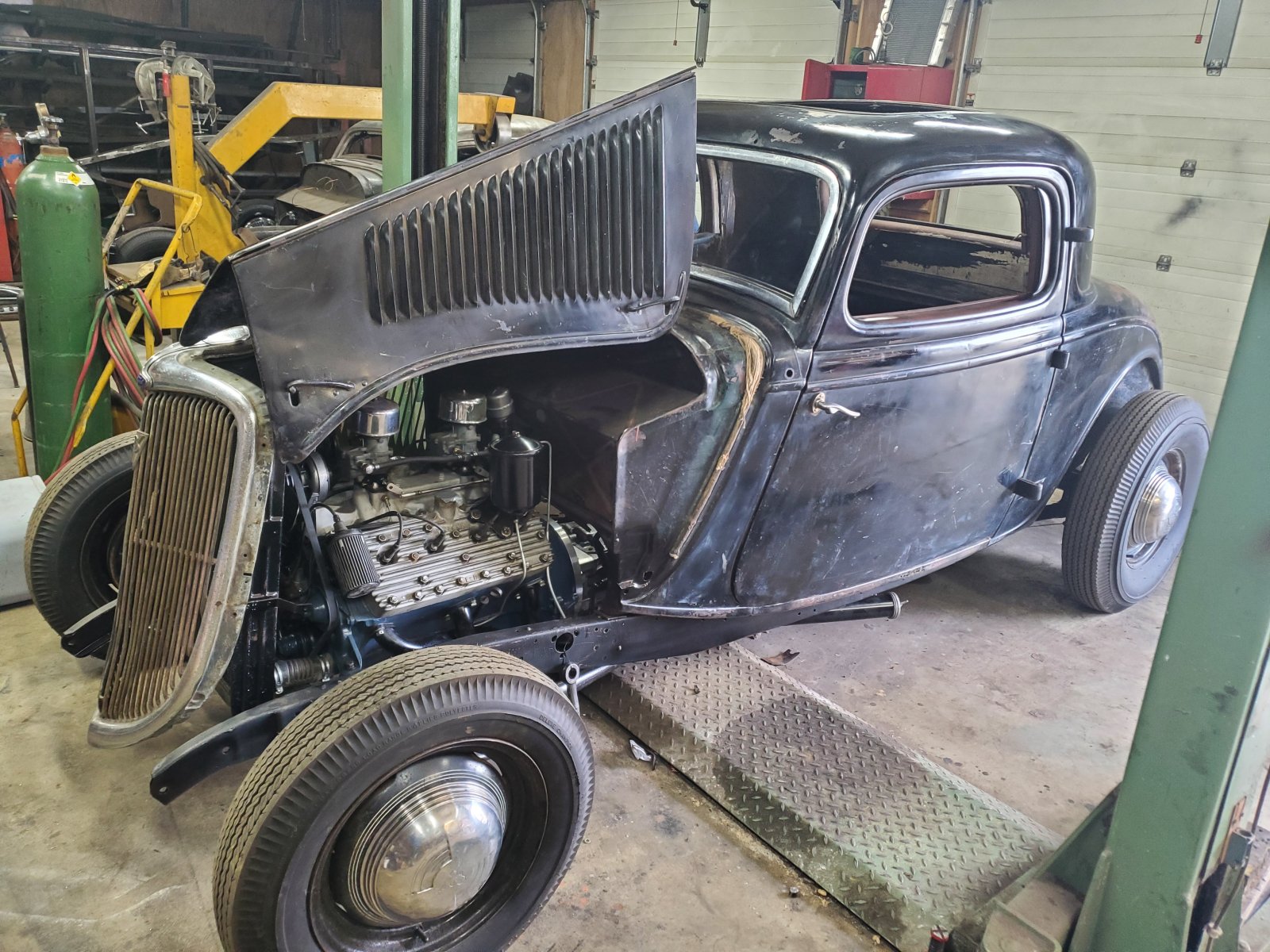

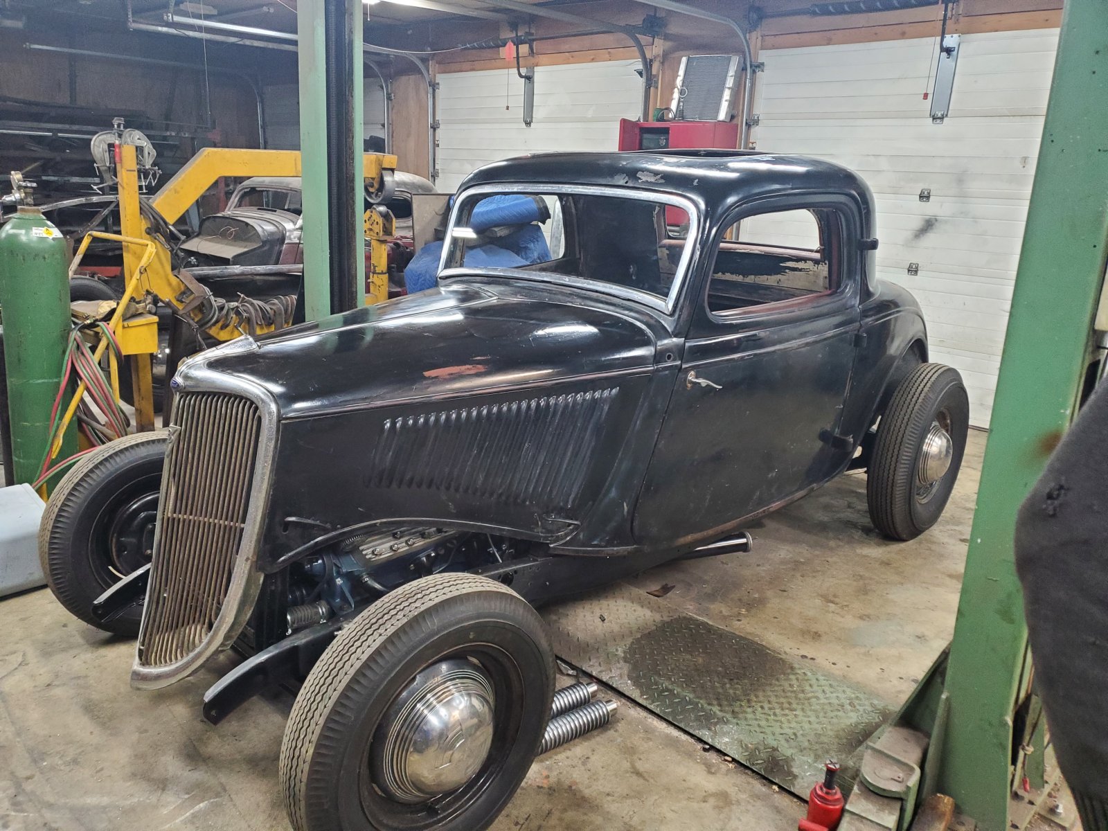

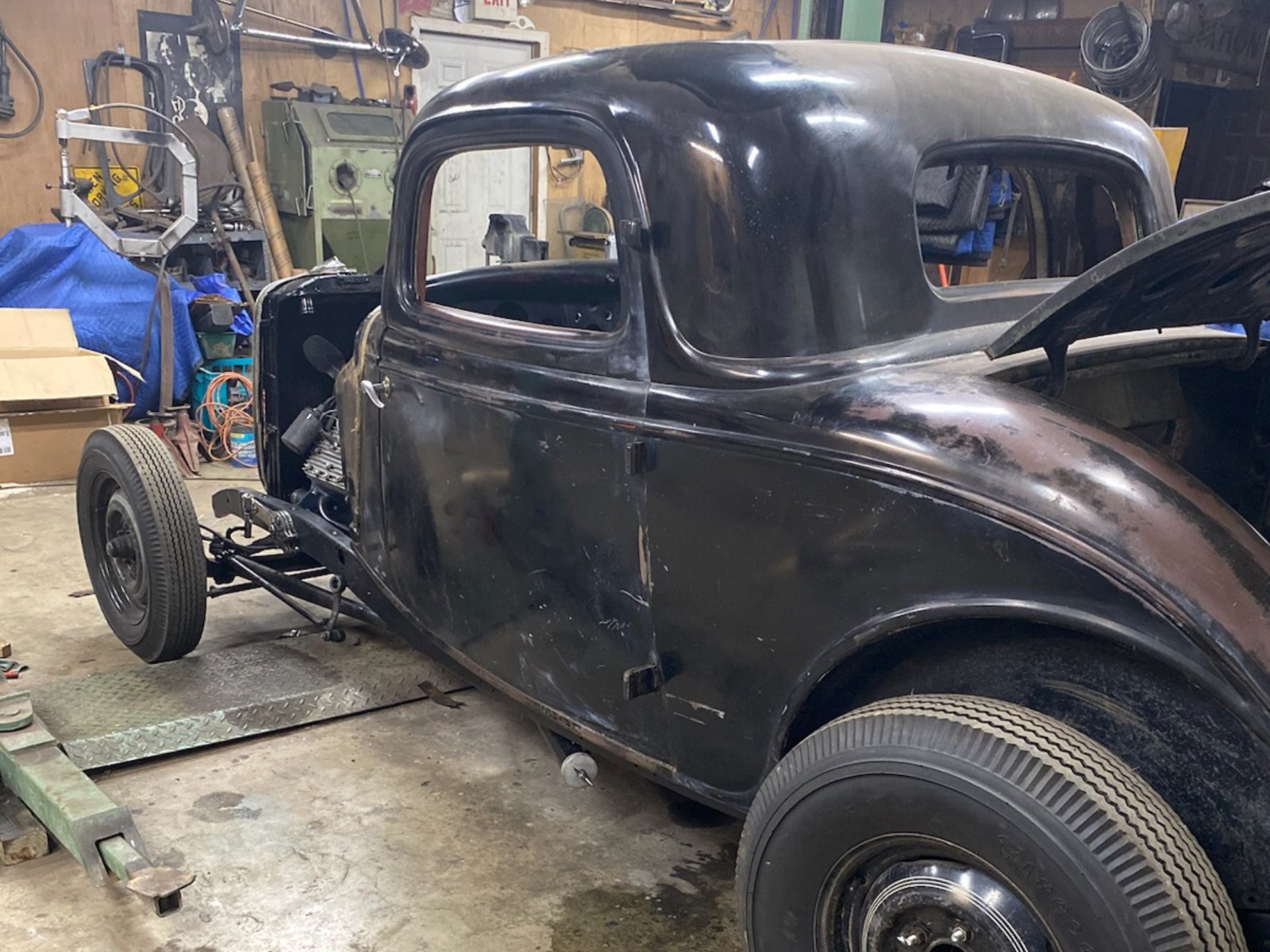

    Got the windshield frame in today with new gl***, got the hood back on, in a couple of other little things

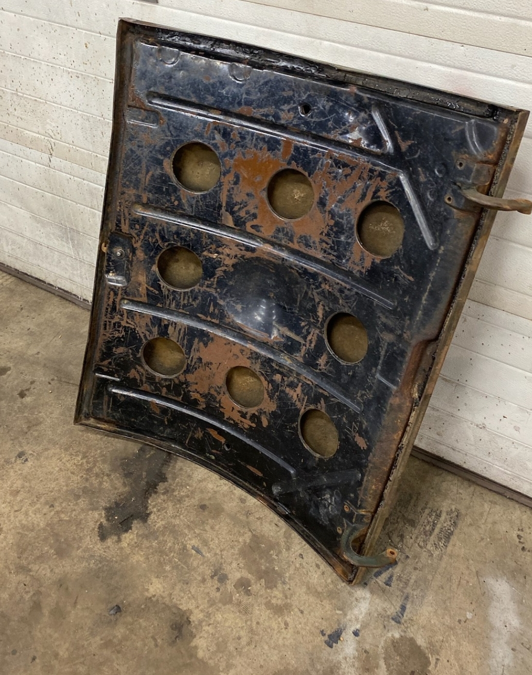

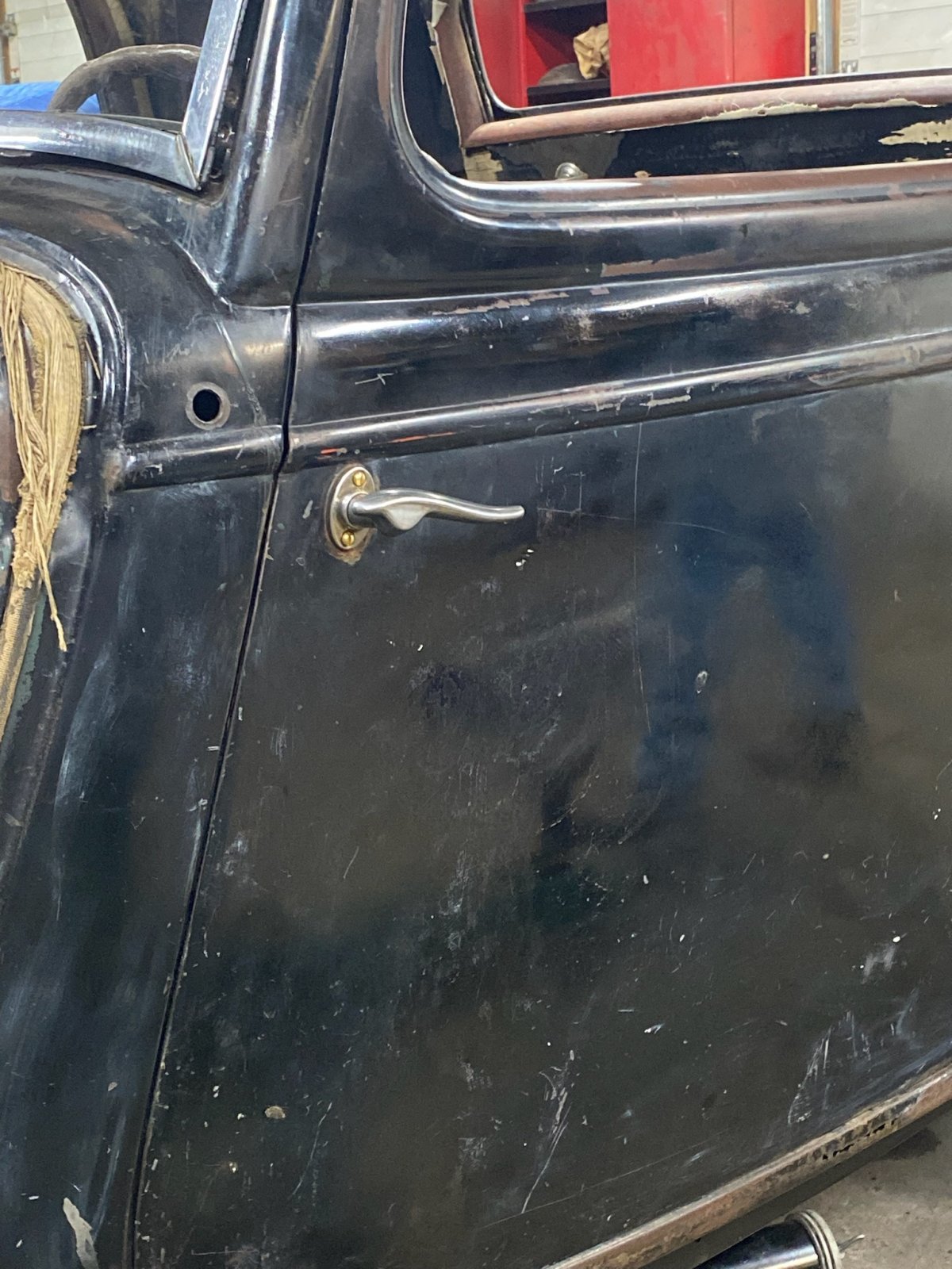

    HomemadeHardtop57

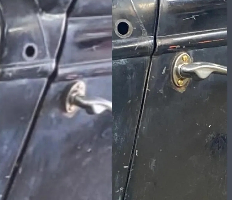

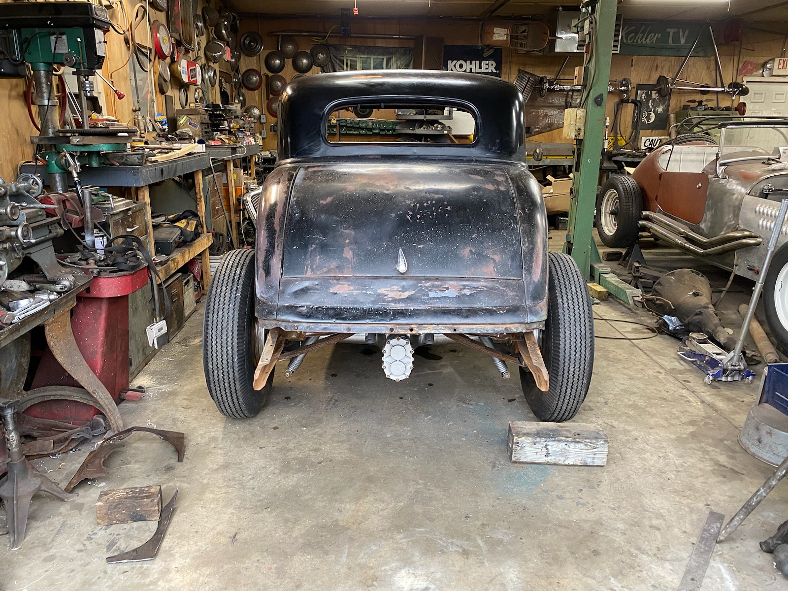

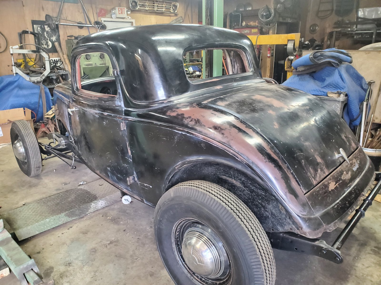

    The decklid on the 34 came off today for some tweaks to get it fitting better. Cool original Ford black still on the underside too. Driver side door hinges got some adjustments to fix a door sag. Body lines fitting up nicely now. You can see how much the body line was off in my last post above
    akoutlaw, Thor1, A Boner and 2 others like this.
  25. HomemadeHardtop57
    Joined: Nov 15, 2007
    Posts: 4,340
    HomemadeHardtop57
    Driver door adjustment before/after
