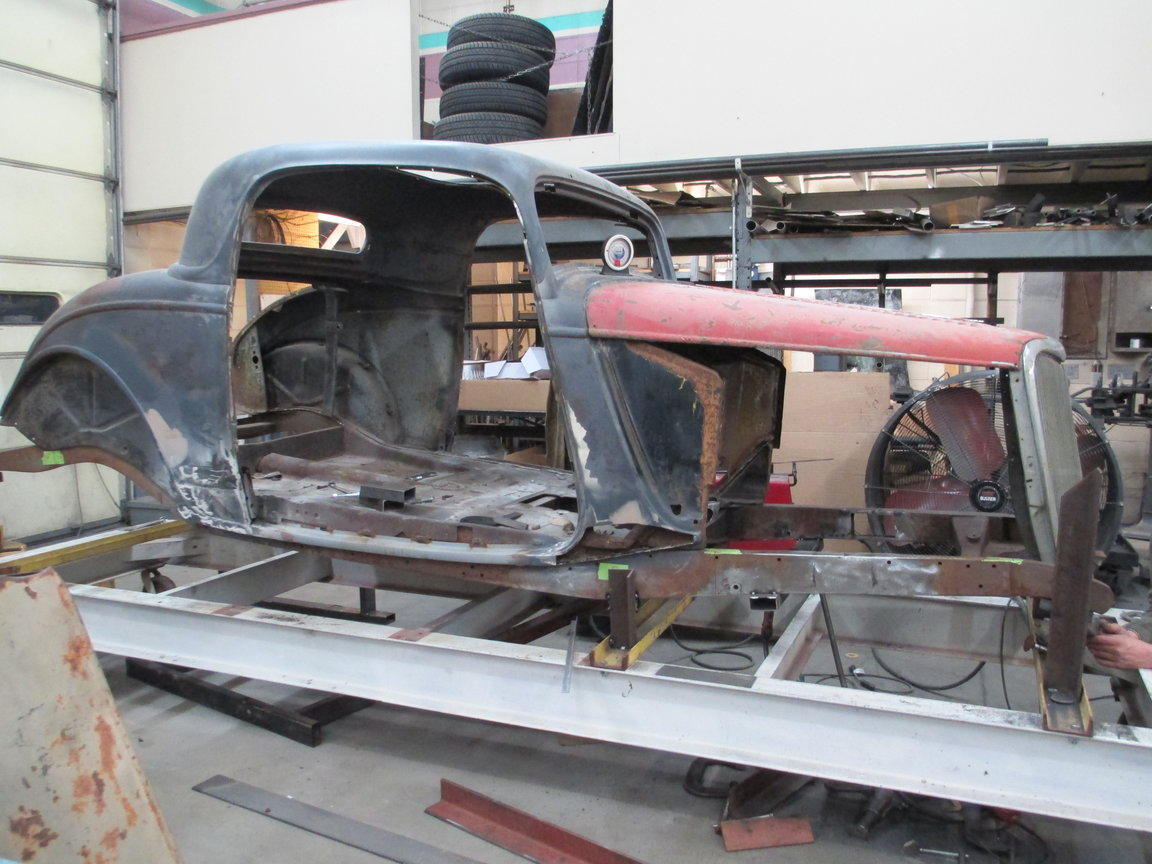

    The attached picture shows the 3w on the frame jig with the previous poor patches cut out as well as the rear floor pan that was both rusty as well as pretty beat up. Note the "arc" of the frame rails from the firewall forward. These will be cut in a way to make them straight. The net result will be a 1.5 inch at***ude adjustment to provide more rake. The radiator/ grill will either be lowered the 1.5 inches or the radiator chopped and the grill kicked out at the bottom. (to be determined after mock up) The plan is to KEEP THE BELT LINE STRAIGHT AS AN ARROW while leaning her forward. We do not want a "broken back" line from the cowl forward and have to be careful to gain rake without screwing up the great looks FoMoCo designed from the start.
    regards,
    George

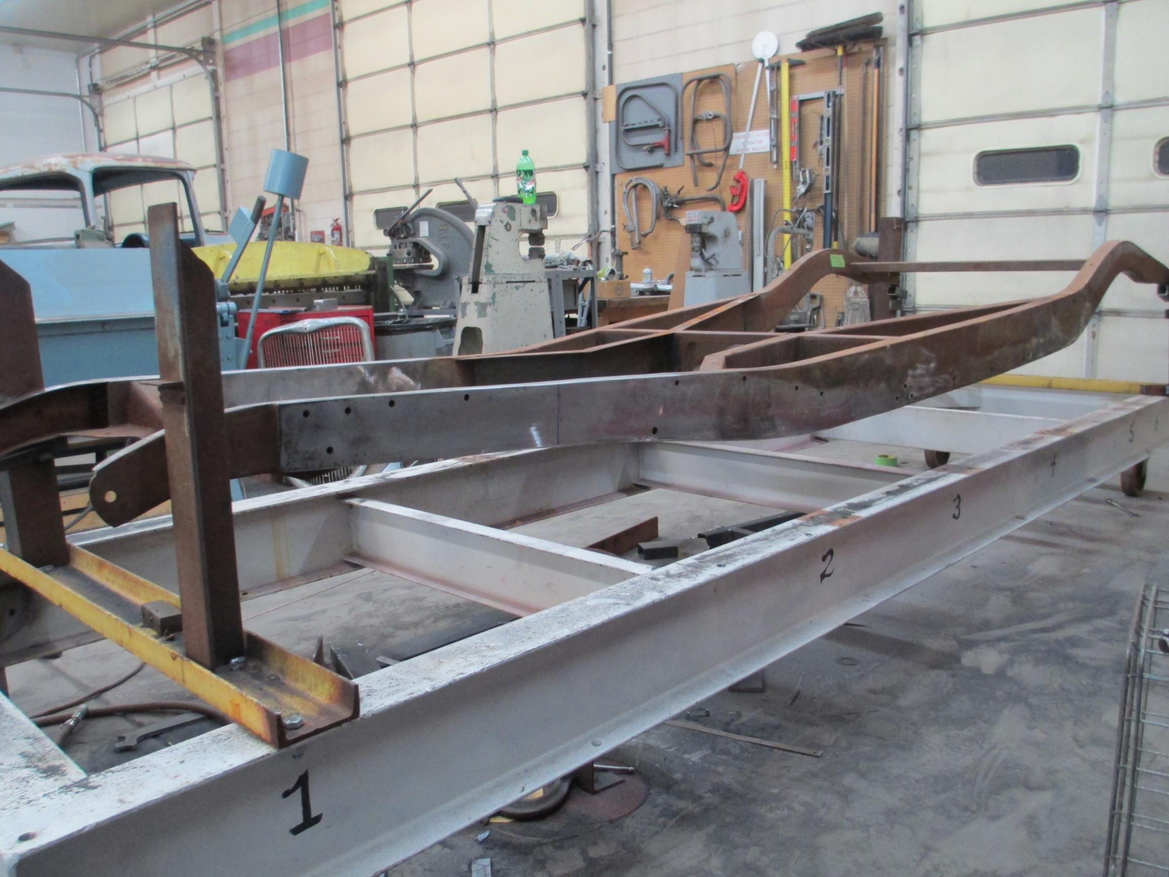

    We only need 1.5" and will be careful to not screw it up. By Kirk's data we would only need 3 degrees tilt for 1.5 inches drop. I am still very confident that we can just lower the mounts and not have any issues. Rex will be able to mock it up soon and report back as to what will fly without having a case of show car over bite? smile.
    Here are the frame rails STRAIGHTEND OUT....before replacing the removed windows and welding her surgery up. smile. Note: Rex will utilize a Fish Plate on the inside of both outer rails to insure we have structural integrity. Minimal effort to make sure we kill the cat.

    The following is from Rex this afternoon.
    "George
    The front frame area is ready to go, and a 1/2" tapered cut was made centered off the kink in the stock frame, this smooths up the lower edge and the sheet metal will follow along this same path given the 34 frame what it needs to match the kick up we did in the front a nice flowing frame along with the body. The front suspension will be installed tomorrow. and hair pins mounted.
    Rex"

    Sam,
    The frame rail kicks upwards from about the midpoint of the welded on "up right brace" (at about the midpoint of the cowl) on the frame jig. If you can imagine a mountain peak that has been turned upside down at this point..... Rex has eliminated this peak by measuring upwards 1/2 inch , marking a perpendicular line each direction right and left and then cutting off the bottom of the frame. Each end of this cut was a taper. The result along the bottom of the frame rail was a more smooth of radius curve without the sharp peak at the apex. The intent is to have the lower body reveal to frame bottom be the same approximate measurement from rear wheel opening to the engine bay. To complete this task, Rex will lower the cowl sheet metal to continue this visual line.
