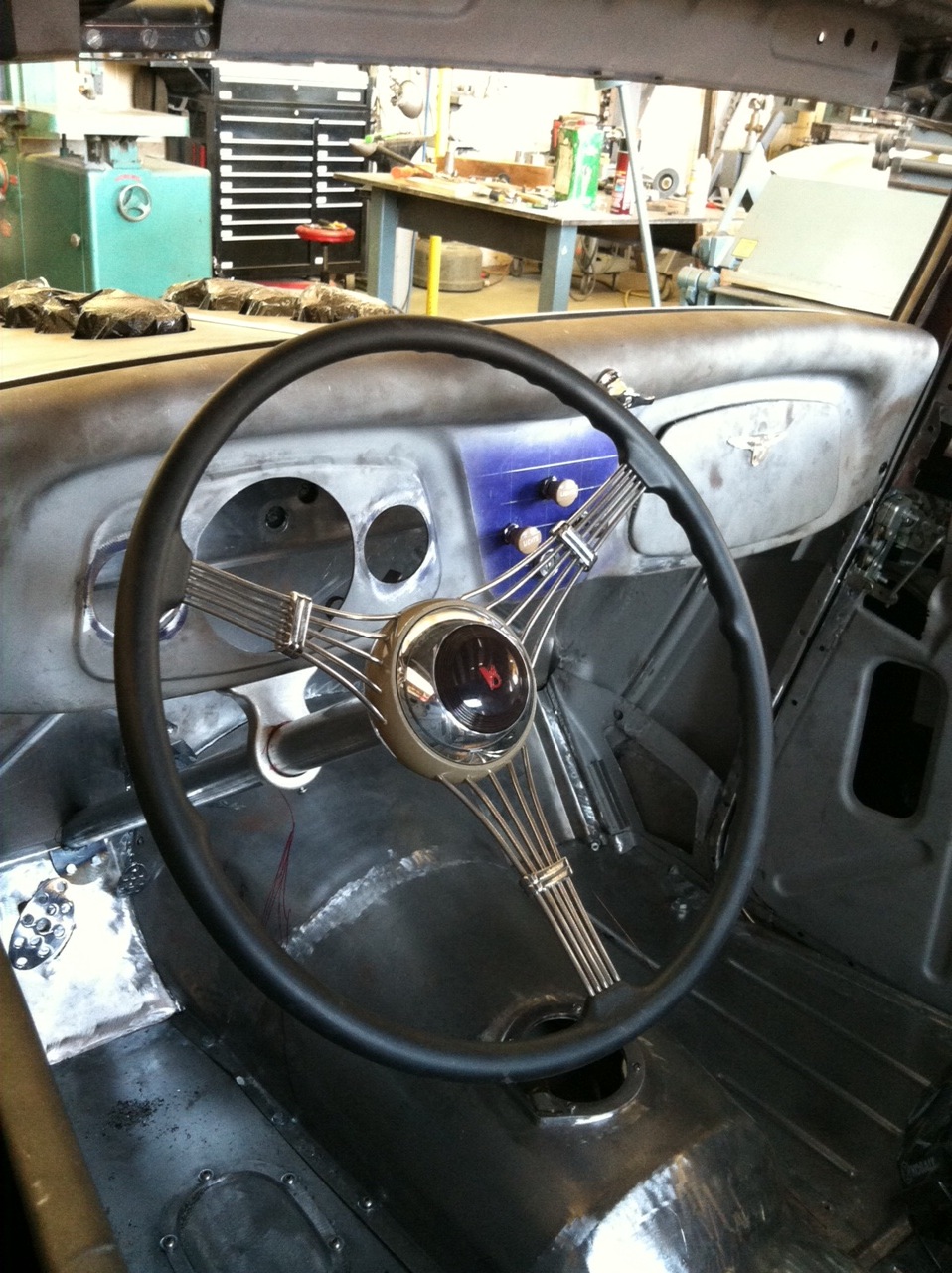

    Josh has the body in white about wrapped up and he and Rex have been working on a dash lay out. We need lights ,wiper and heater PLUS ignition and thats all!

    Pete and I drove up to see Rex Saturday morning. It had been a month and although I had been keeping up with picture progress, it is always nice to see first hand.
    Rex had a list for discussion with regards to sorting out a few things and we visited a little while before getting back on the road as Pete and I wanted to head over to Golden early.
    The car looks awesome and I am getting increasingly concerned about the challenges ahead with regards to the kick down linkage for the 700r4 and the Hilborn set up. Josh doesn't seem to think its a very big deal. grin.
    I have narrowed paint colors down to dark blue or maroon "vintage" Ford colors.

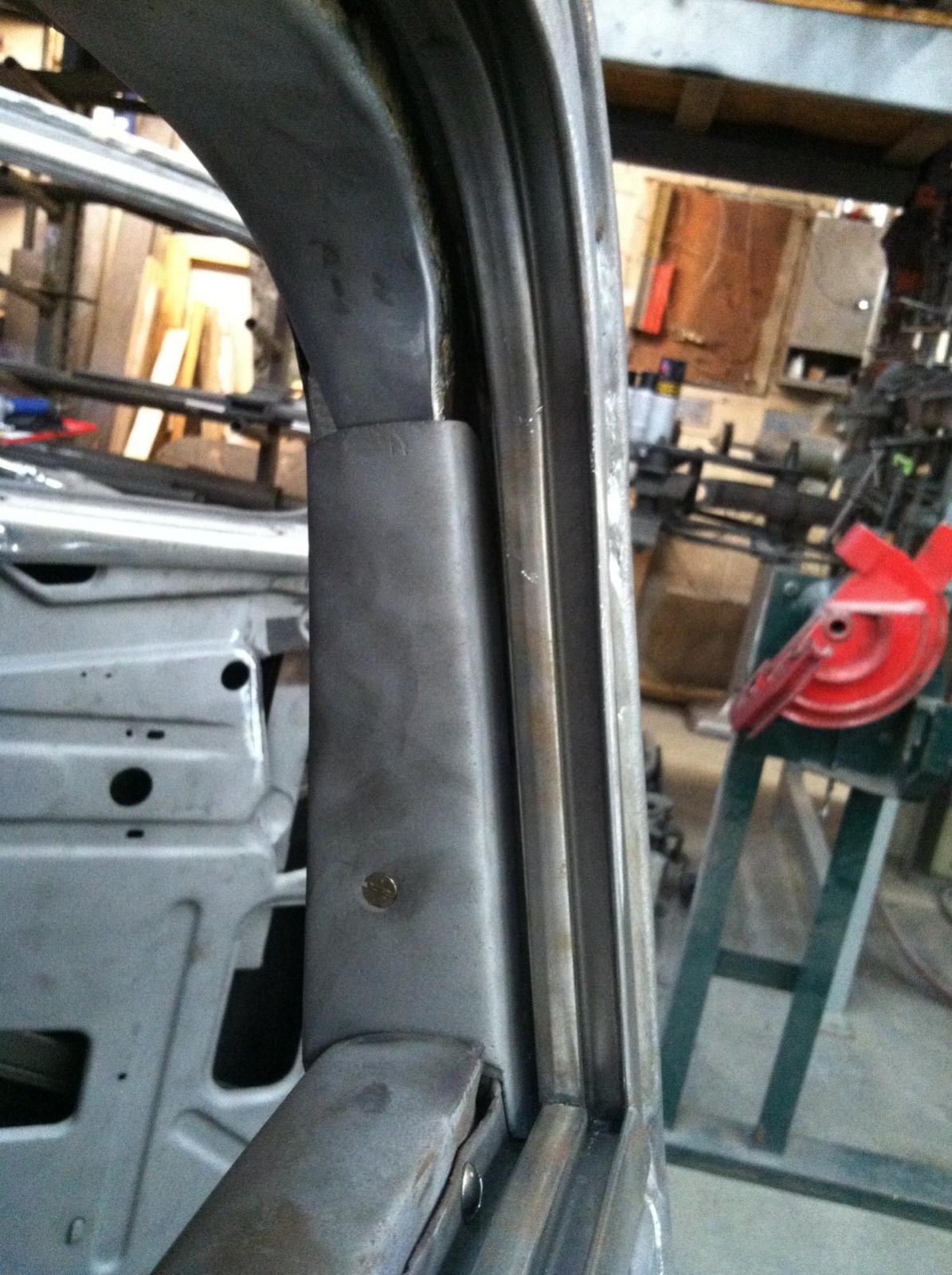

    Last but not least , please find a picture of the p***enger side garnish molding chopped and installed.
    This week Josh will put the inner deck lid back in, get the lid on its hinges and start on the all aluminum interior. HOW COOL!

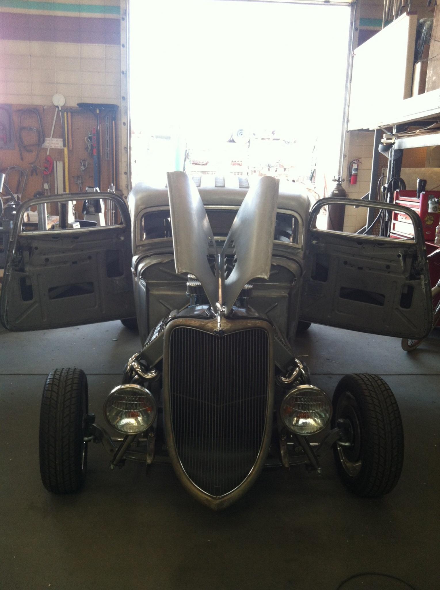

    More progress ...plus some extra pictures

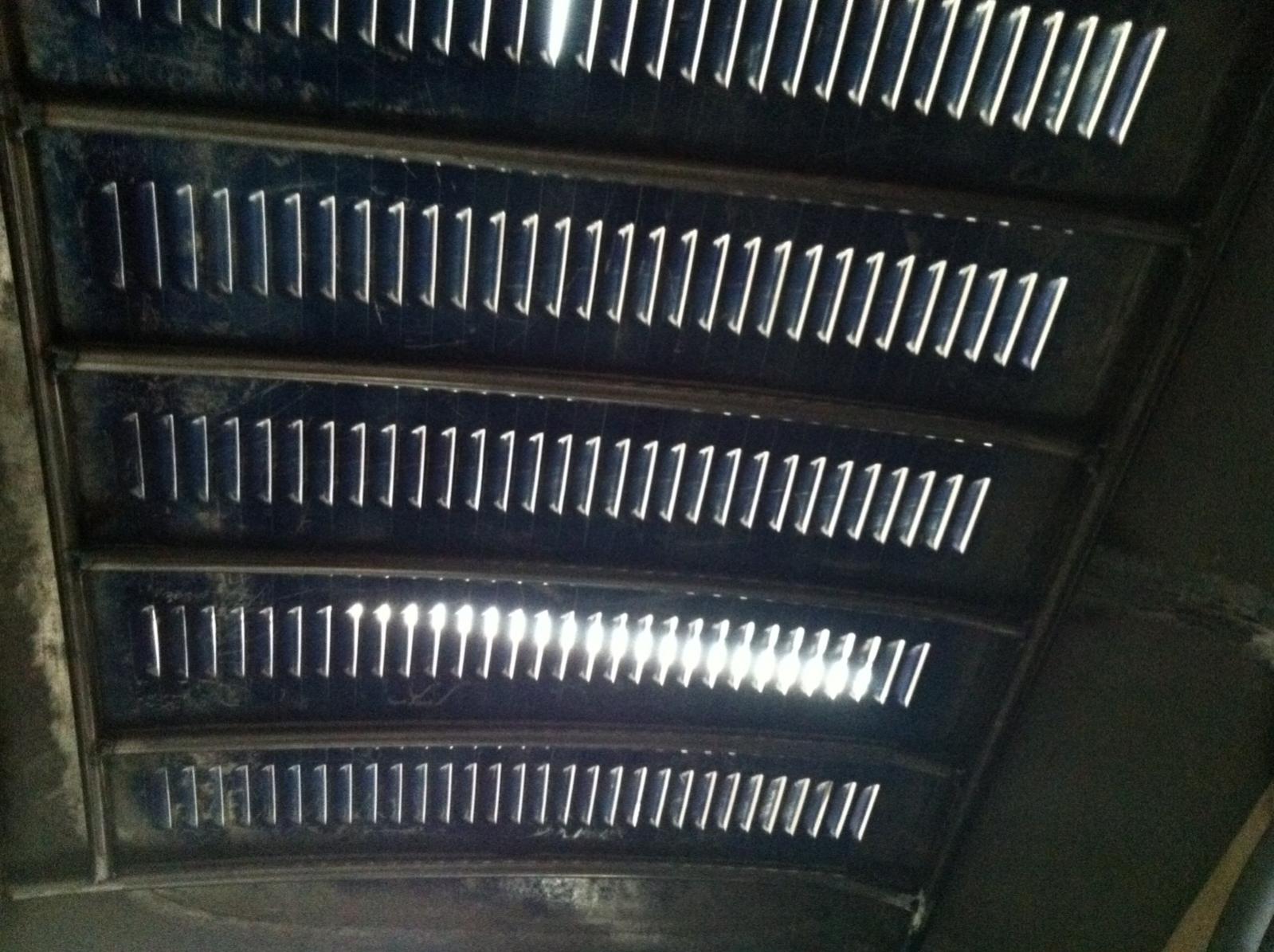

    Josh is tackling the inner roof structure to hold the drain pan and the head liner. He stopped for a few minutes to take a few pictures of her all opened up.
    As someone up in Loveland says "Bad ***"
    Regards,
    George

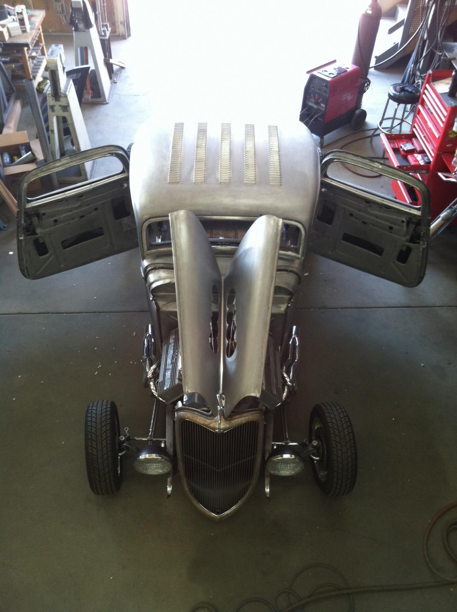

  12. Wings spread.... Looks like she can FLY!

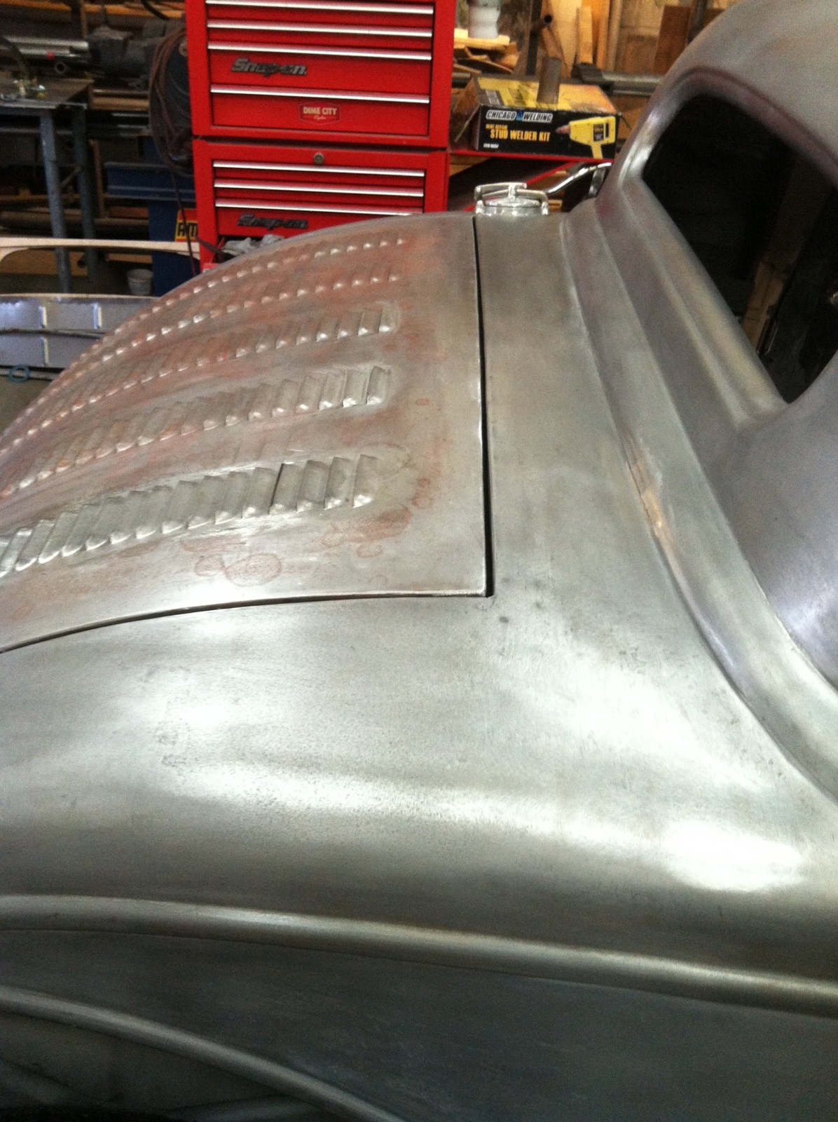

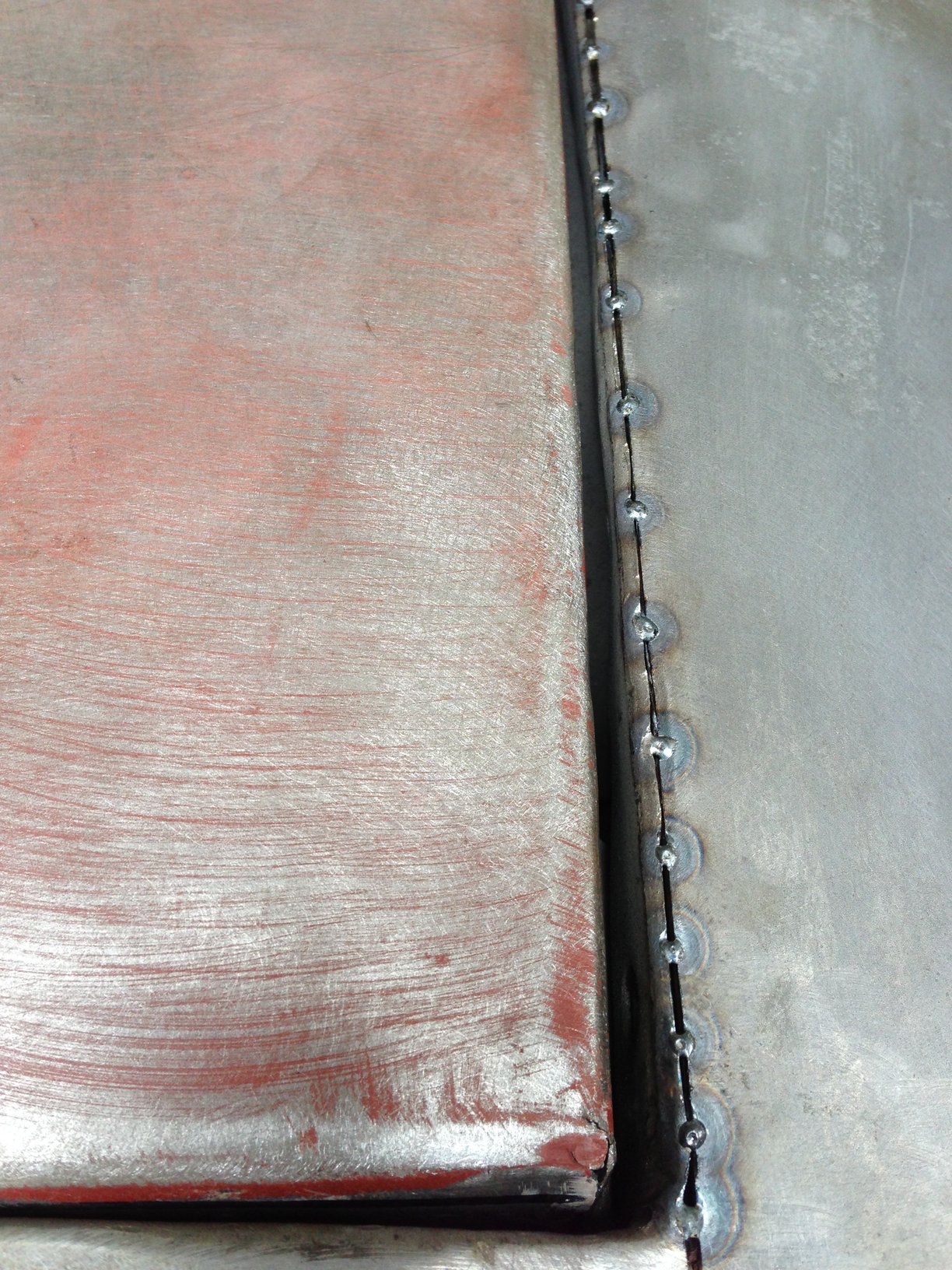

  14. geoking
    Joined: Nov 12, 2008
    Posts: 717
    geoking

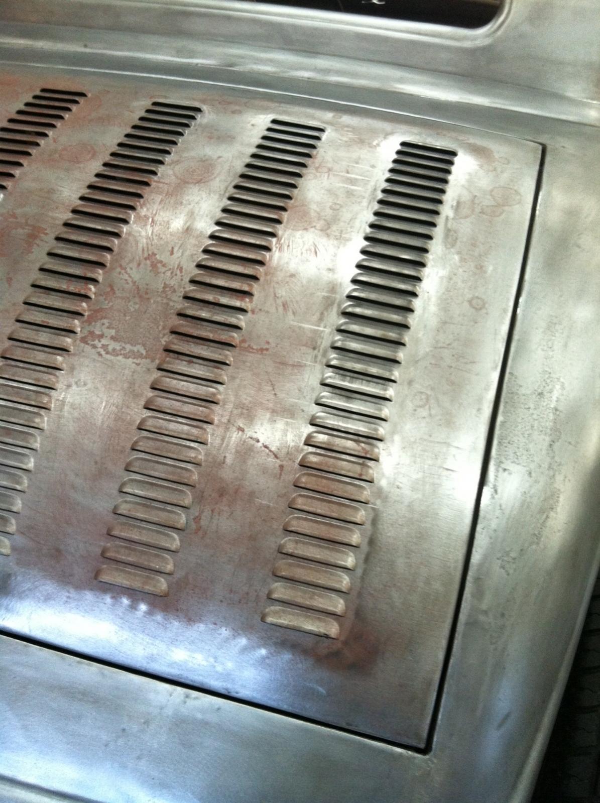

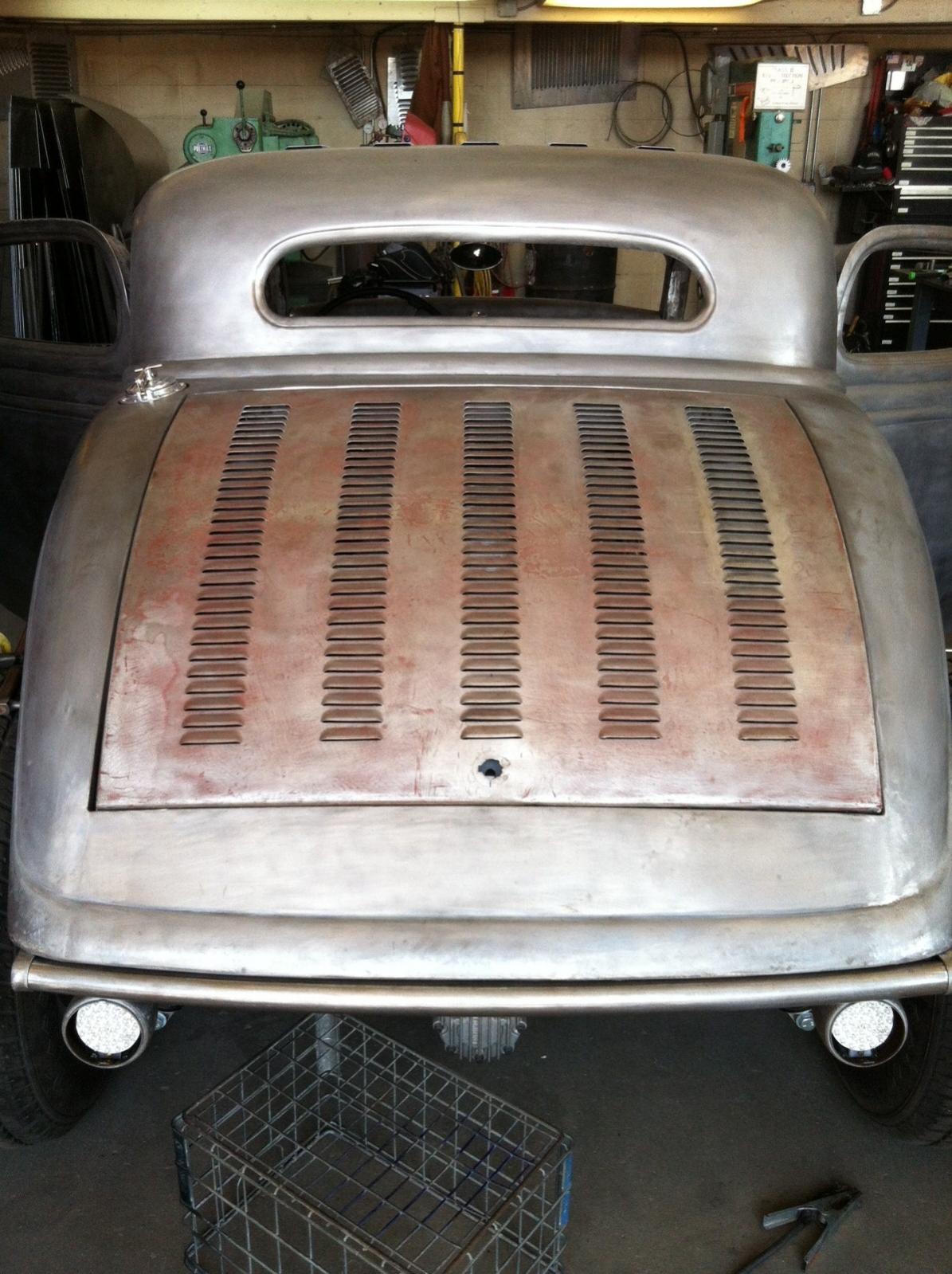

    The rust at the upper deck lid has been repaired and the lid is hinged "first p***" . IE: It needs to be gapped as well as have the original prop rod installed. I will always remember the louver party...5 guys supossedly paying attention..Ha. How much fun was that! Thanks again Rex, Nick, Bob and Pete. A great memory as part of this build.
    Another step forward...

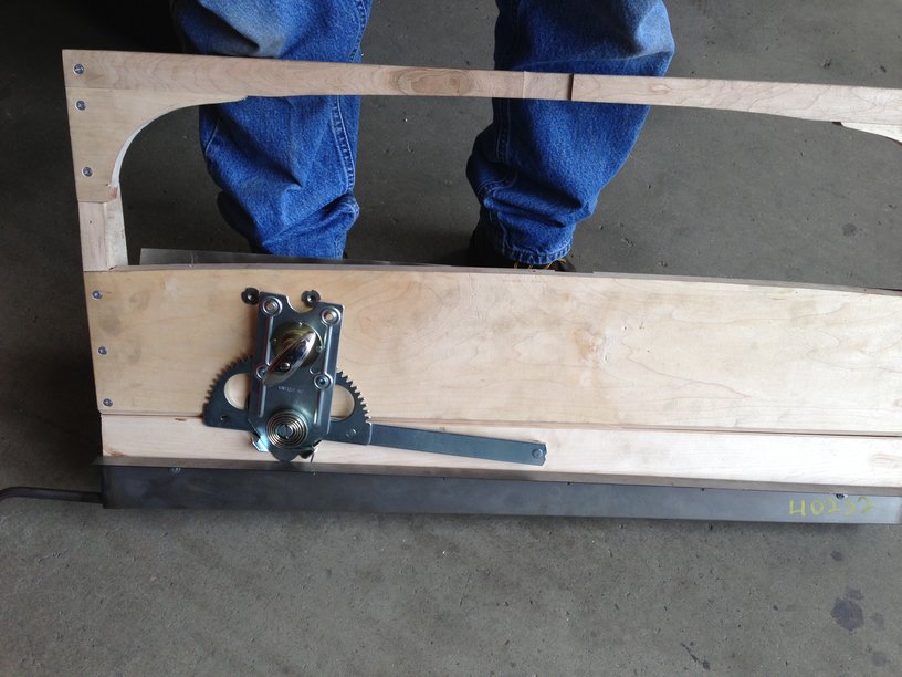

  15. geoking
    Posts: 717
    geoking
    ...Spent time at Custom Auto this morning. The purpose of the visit was to drop off EFI electronics ( Holley) with fuel pump and regulator. I also double flared a piece of 3/8ths tube section to share with Rex the alloy material that I wish to use for running brake and fuel lines. It's similar to "Cunifer"..A COPPER NICKLE ALLOY. I PURCHASE MINE ON LINE FROM ADVANCED Auto as it keeps the cost down. (About a dollar a foot ). Advanced calls their product "NICOPP'. Anyway , I am a big fan .....as it is easy to double flare, bend and then polish.
    Please find pictures of my rear window regulator ( Rex states it is from a Model A little window), mirrors to be mounted through the door perimeter frame ( first removing the hoop that hangs it over the door), Nerf bars up front ( off the shelf) , heater valve that is so simple with manufacturers name and number on the label ( just power and ground wires and it is normally closed) the deck lid gap issues. Very ugly and a lot of work for Josh Monday.
    It sure is a lot stuff to work on! whewie.

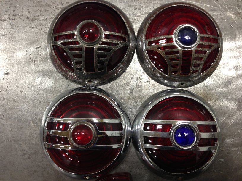

  16. geoking
    Posts: 717
    geoking
    I spent time in the shop today adding the blue dots to two sets of bezels for my coupe. I haven't decided on which to use yet. The blue dots are quite the funny after market game. Plastic vs gl***.... faceted vs smooth....thick vs thin and all different lengths of twist tabs.
    No matter which one I looked at ,......not a single one would fit the I.D. OF EITHER THE BEZEL OR THE GL*** LENS.
    Grinding the gl*** was a slow and dusty process and required I remove between .040 and .060 depending on which lens I had in my hand at the time. The chrome plated br*** bezels were much easier to open up with the concern having enough material left to not destroy the hard to find bezels.
    The attached picture is of original vs modified and two styles of blue dots. The plastic one looks much darker but I believe will actually shine brighter.
    I'll go ahead and send the bezels out for new chrome and make a decision on blue dot style/color later on when we are ready for final ***embly. I was able to have the LED ***embly manufactured in Taipei with WHITE output instead of RED output . The new electronics will arrive by month end. If you have ever seen red light through a blue dot you will know why I needed different output. The circuit will run nominally from 7.7 volts through 14.4 volts with consistent brightness. Response time is in MILLI-seconds and brightness is awesome. Worth the effort!
    I know from previous posts some of you don't like blue dots. The all red with reflectors is just too blah for myself. sorry! smile. This isnt trying to look 50's hot rod , but just simple preference for adding a little life to the tail light ***embly.
    Regards,
    George
    PS ...I had complete sets of everything but dropped one lens. OH Four Letter Word ,....that IS SOOOO Depressing!

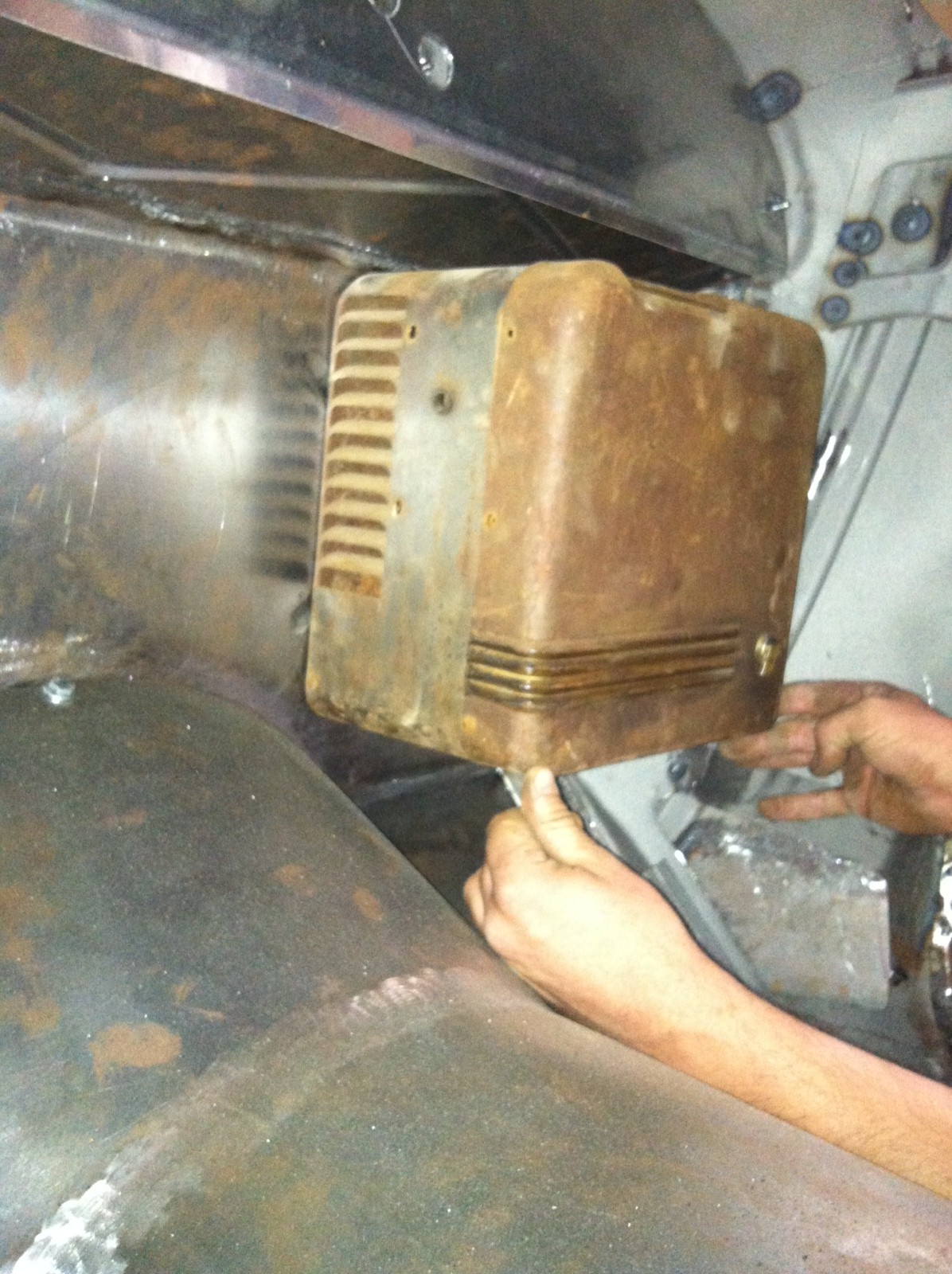

    Received the1948 F1 heater this morning and it's just too big for the space we have under the dash. It is back to the drawing board with either of 2 aftermarket heater manufacturers that have smaller units. One we looked at has 20000 BTU and 250 cu ft per min output. It's the modern day version of the Hupp 360- (now Mobile 8000 model) It works...hmmmm, but it is UGLY!
    The Vintage Air stand alone heat with defrost might go in as it' only 5.5 inches tall. I am not a big fan of the ABS plastic housing,....but it MIGHT also be a good choice? sigh
    choices , choices....

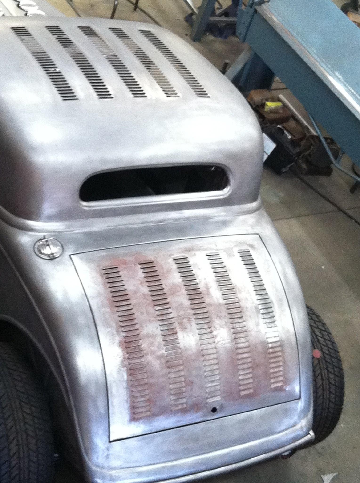

    The pictures tell the story.... ahhhhh, Josh almost has her metal work completed! GREAT JOB JOSH!

  22. ss34coupe
    Joined: May 13, 2007
    Posts: 4,266
    ss34coupe

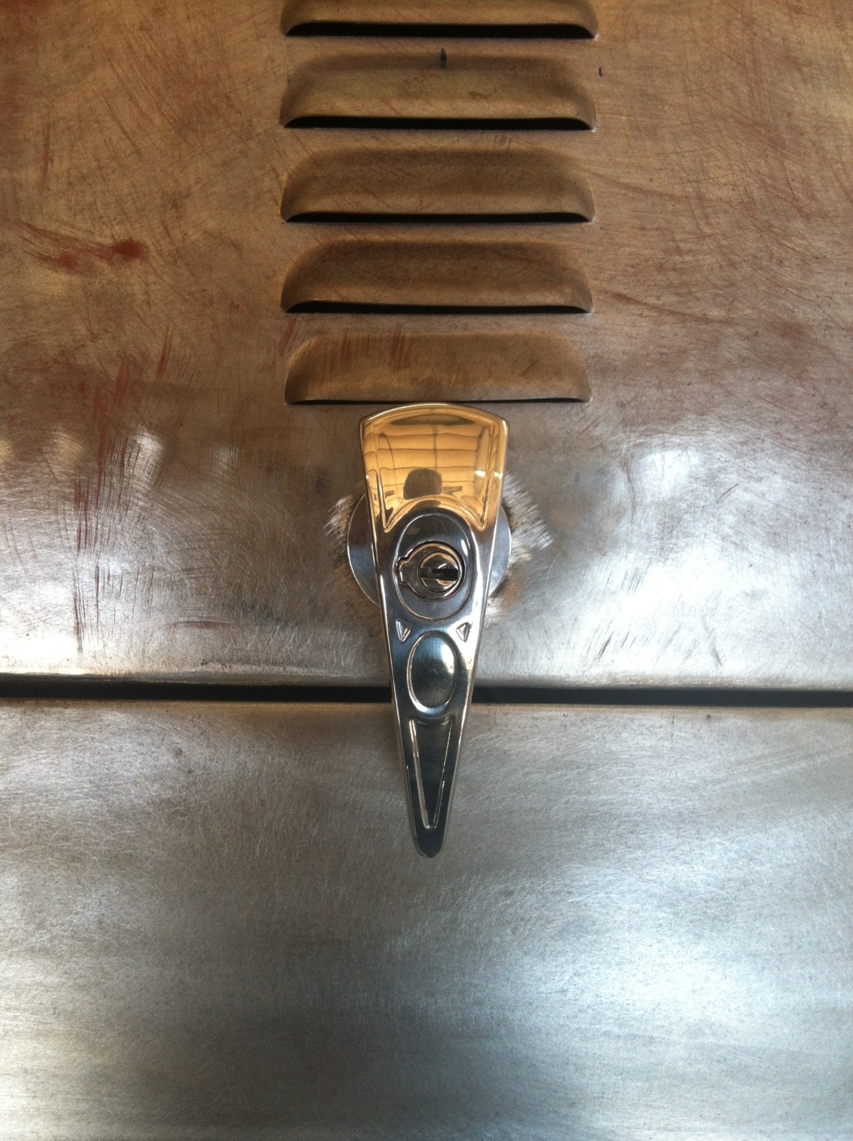

    Very nice job lining the truck lid up. I did it the same way on my 33 five window.
  23. geoking
    Posts: 717
    geoking
    Steve,

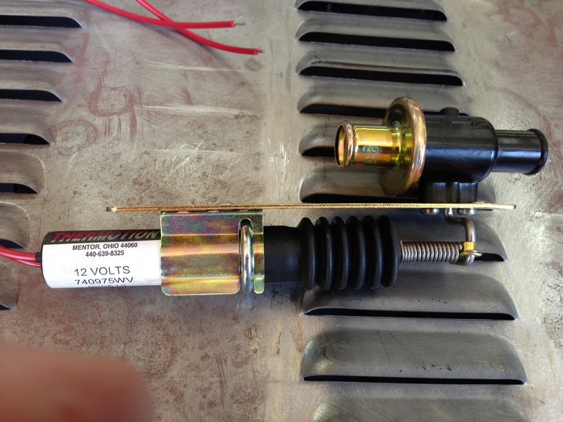

    Thanks much. Here's a picture from Josh's effort to get the deck lid latch installed this morning. The N.O.S. 37 decklid handle detail with the "v8" is a little different thing that folks have been doing for a long time. ( read as.... I copied it! ) smile.

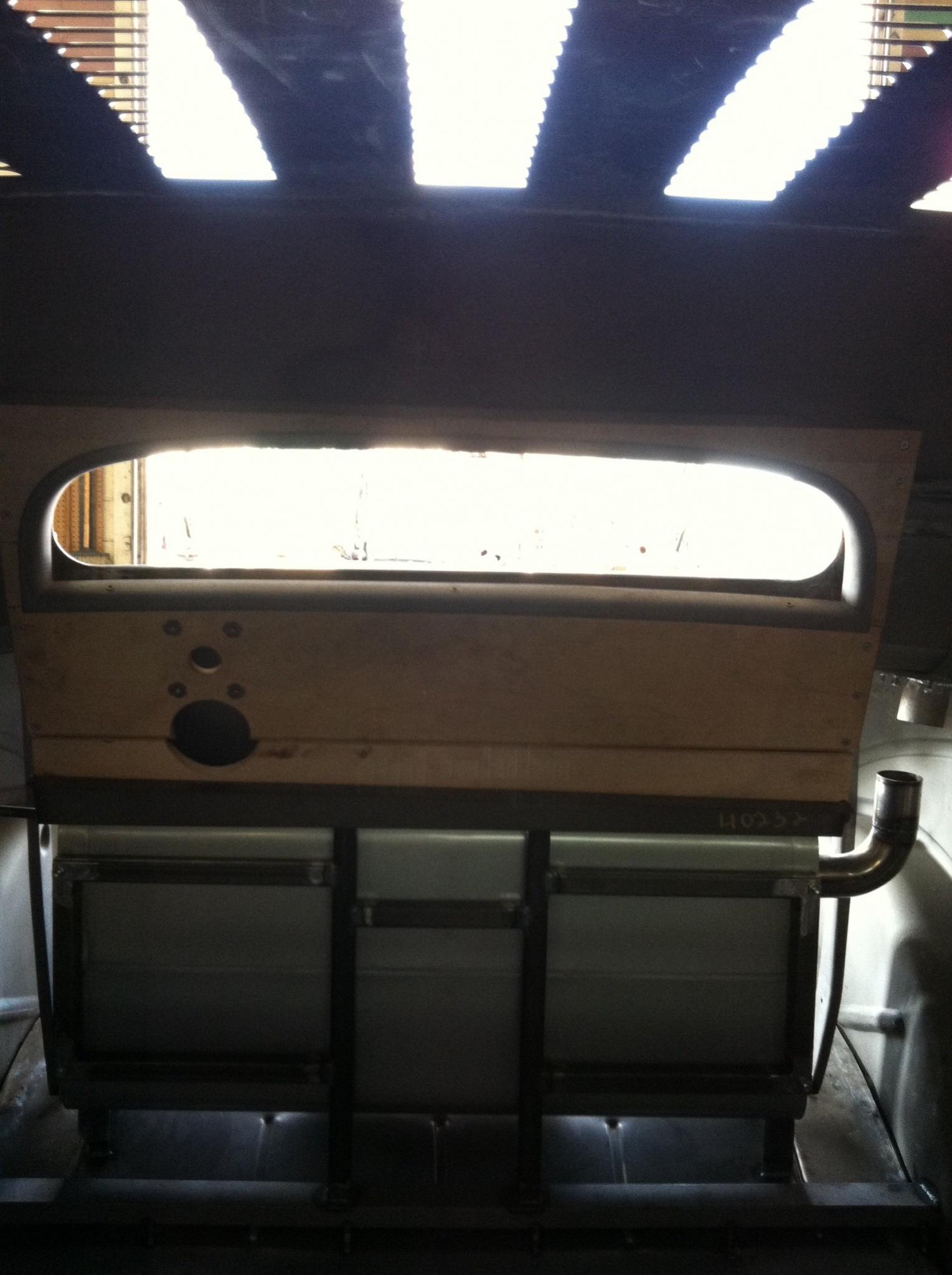

  24. geoking
    Posts: 717
    geoking

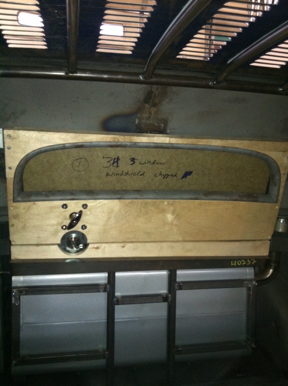

    Josh managed to get the rear window rolling up and down today with a Masonite pattern for the gl***. It looks cool with it's little banjo crank knob.

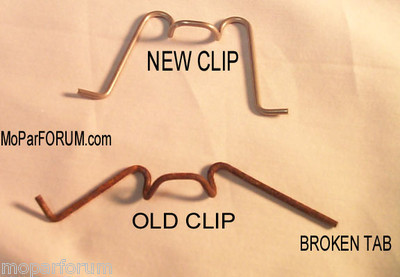

    On another issue..... I have been looking for the original retention spring clips that hold the RiLite 1904 lens to the bezel. (3 per) I have a handful of originals that are rusty and have broken tabs. Since I havent been able to locate, I have two choices...glue the lens to the bezel with RTV or make new retaining springs. I chose the latter and have sent samples to a professional "wire forming" company that will duplicate these via a CNC 3 axis wire forming machine. I might as well order 1000 pcs as the "cost per" is next to nothing after the programming and set up fees. I was teasing Rex this morning about my effort to sell these on ebay at an outrageous price over the next 20 years. I might sell a handful and at least be able to help someone else out. I will never be able to get my money back. Oh well...please dont tell the Mrs. Well, go ahead, she knows I am eccentric.
    The below picture is NOT what is needed...BUT IS VERY CLOSE. The MoPar Forum fellow sells this clip for holding the light bulb in fog lamps. You can find them on ebay.
