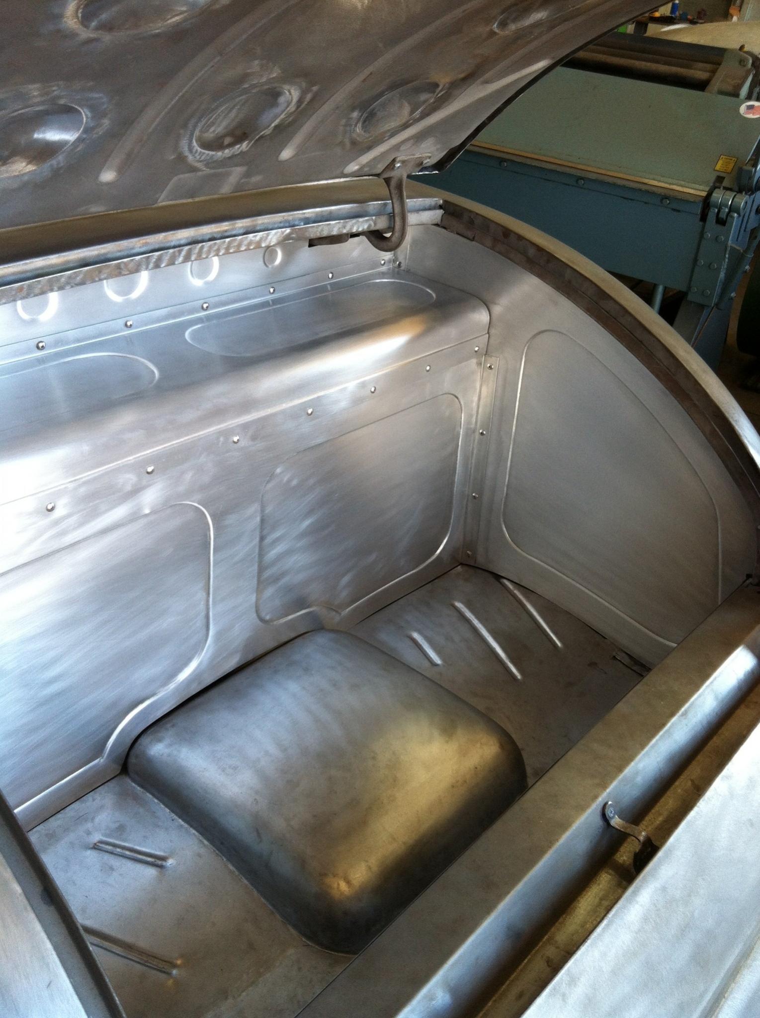

  2. geoking
    Joined: Nov 12, 2008
    Posts: 717
    geoking

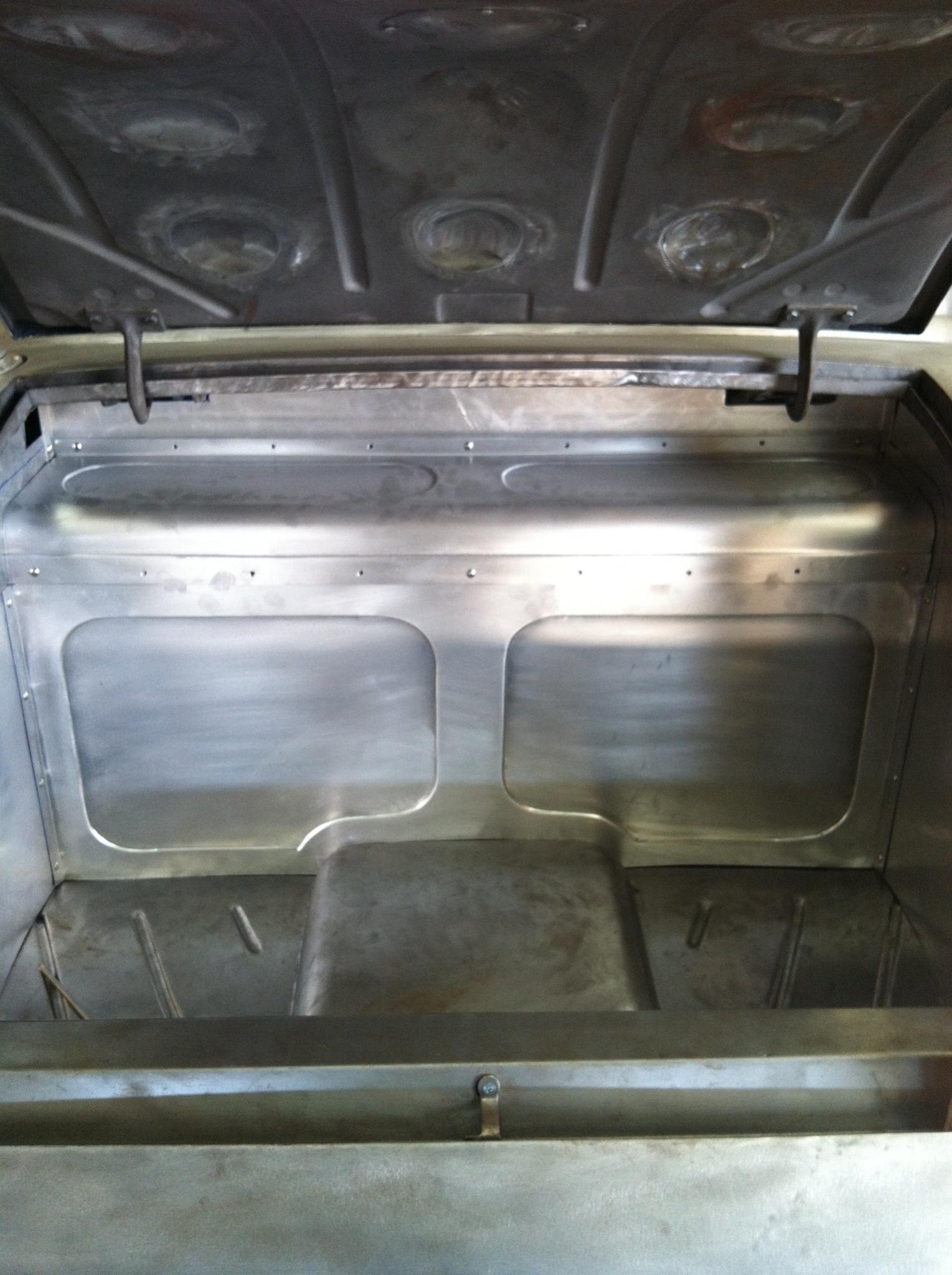

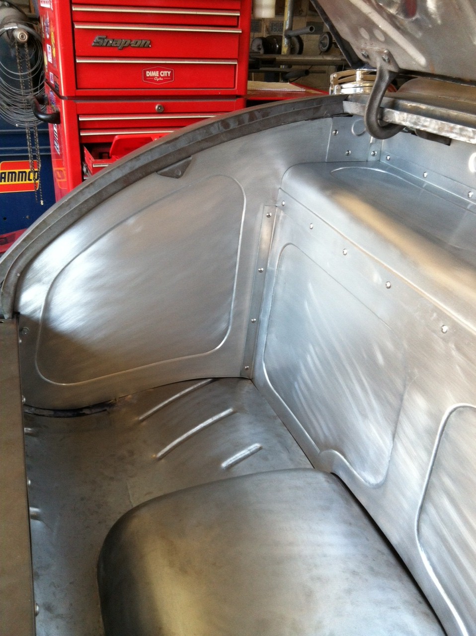

    Josh has completed the trunk and is moving on to the dreaded big interior job with roof pans and drains...
    We are still waiting on the custom arc 3.5 inch diameter stainless pipe to make side pipes out of. The company is difficult to deal with in regards to being non responsive and late on their delivery committment. Josh has plenty to keep him busy,...we are just interested/ excited to get to that part of the build.
    Regards,
    George

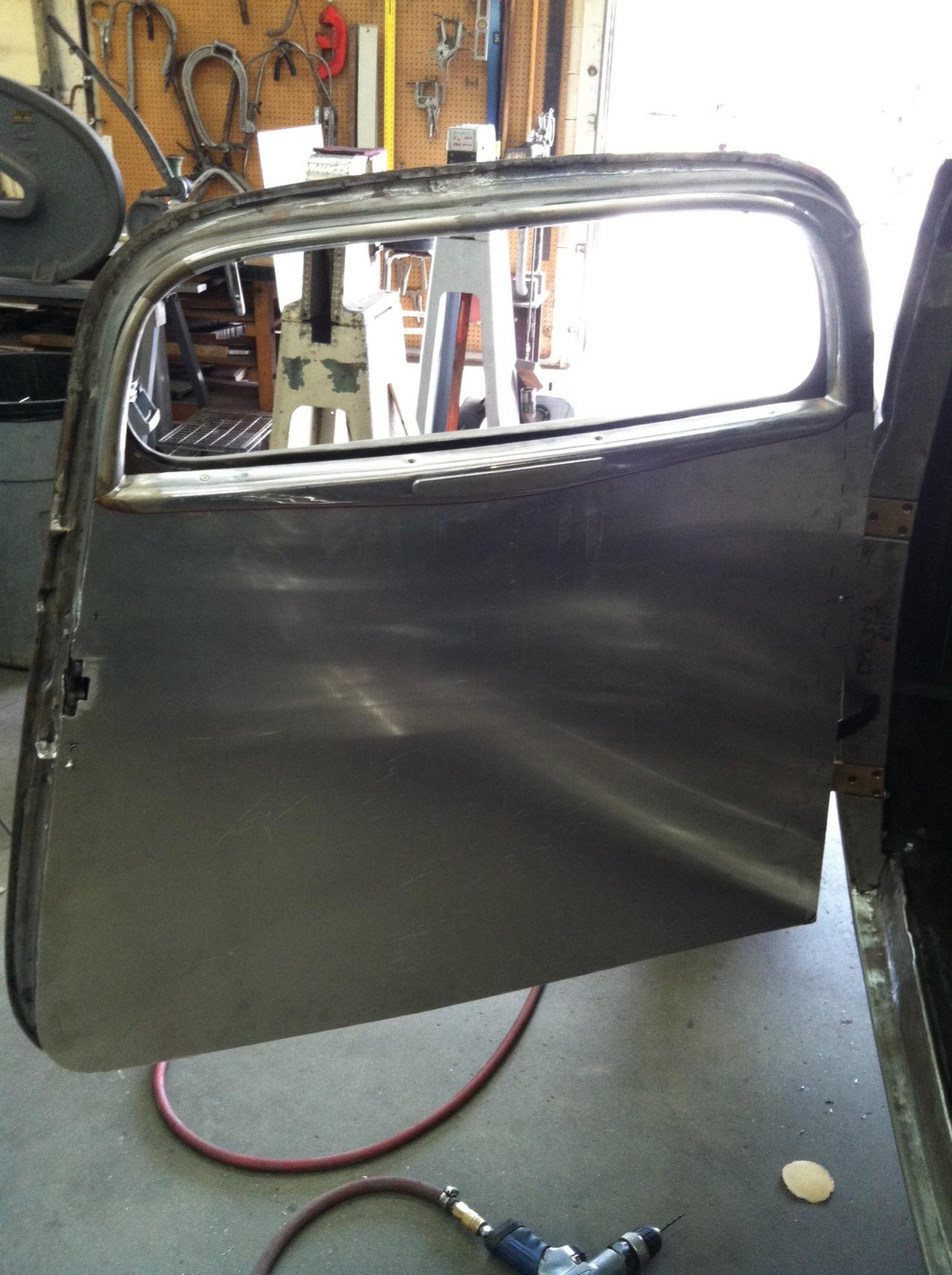

  3. geoking
    Posts: 717
    geoking

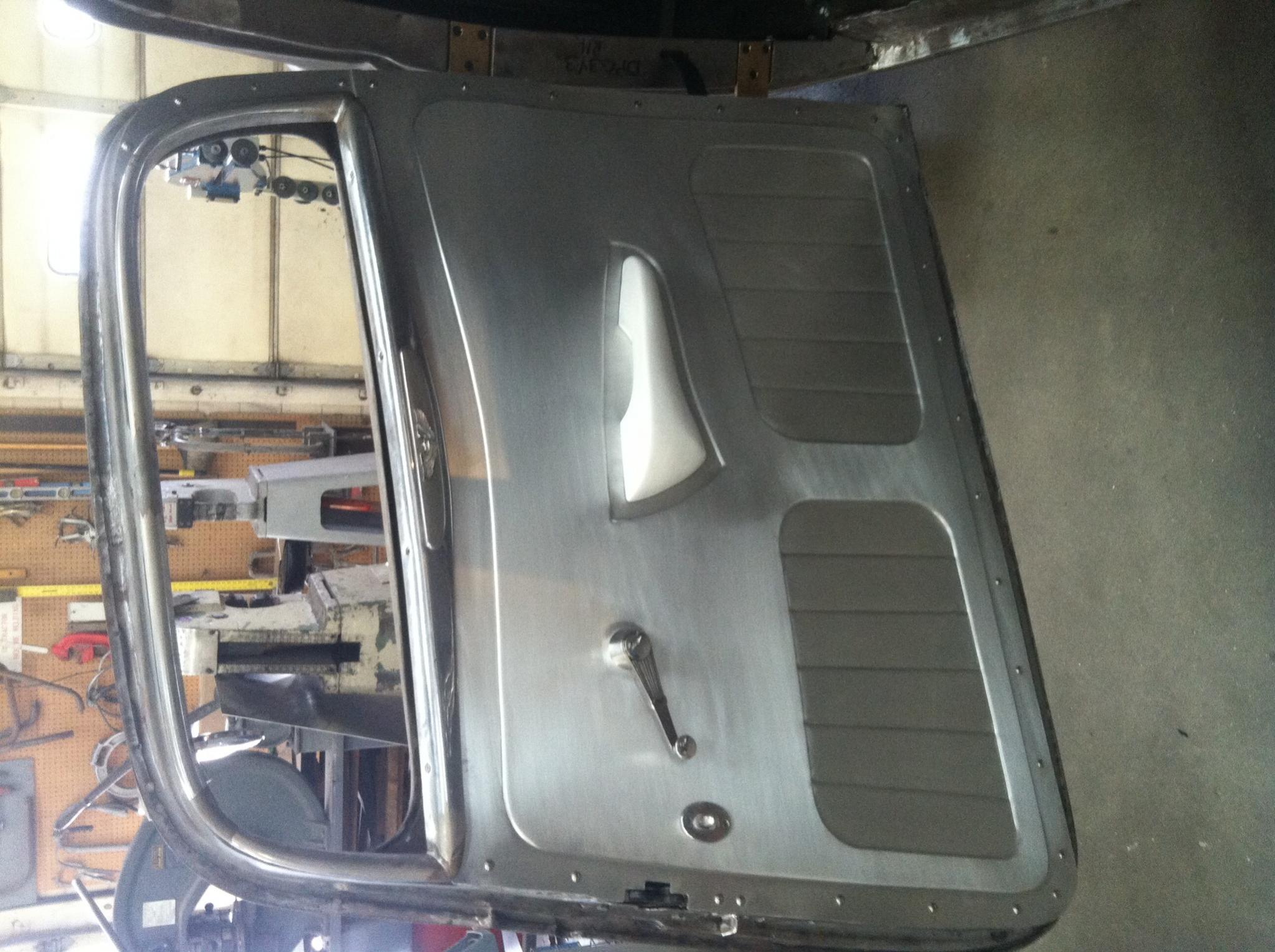

    Ok...drivers side door blank cut by Josh and now he has to also think about the arm rest / door pull. The raised area at the bottom of the garnish molding is where the wing "bling" will be mounted.
    regards,
    George

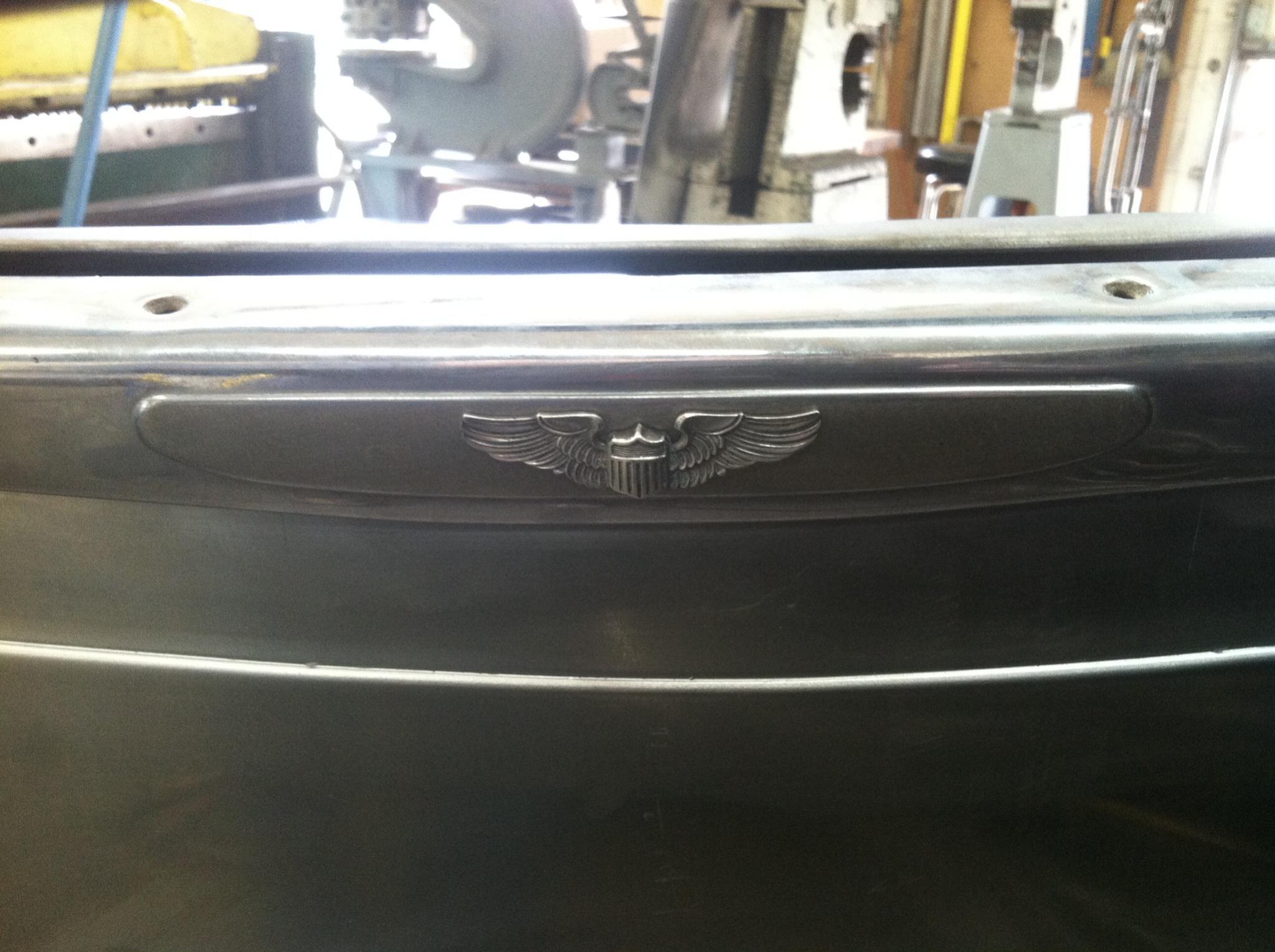

    Josh has added the perimeter step on the p***enger door panel as well as the "wing" bling on the lower garnish molding reveal. He has the armrests "on order" and can not review or do anything additional on the panel until the armrest gets here and is installed. I really like the clean look. Josh might add a matching pattern like the ovals in the trunk???? We are in a wait and see mode for what might be best after the arm rests.
    Thank you Josh.

    Here are some more shots of Josh running the detail beads in the door panels. He started out with a simple lay out and after laying out a lot of sharpie lines he decided that some simple pleats would fit the panel nicely. Trying to keep the inside panels fairly simple.

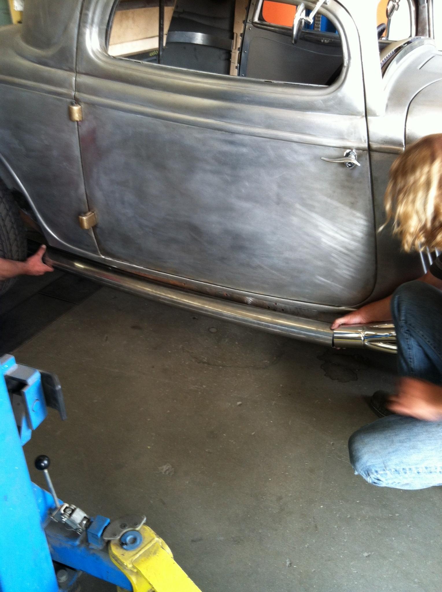

    Well, it is hard to tell much from the attached picture of the side pipe being held up for an idea???? What I can see, is that the collector output angle will need the be changed and the side pipe finish improved. Other than that...hmmm, just not enough there to tell if what we have is going to work?
    I will be in Loveland tomorrow and look forward to seeing it. My first impression is that it seems a little anemic. A heat shield might help and also keep a few burns from happening!
    The good news is that Josh has something to work with.

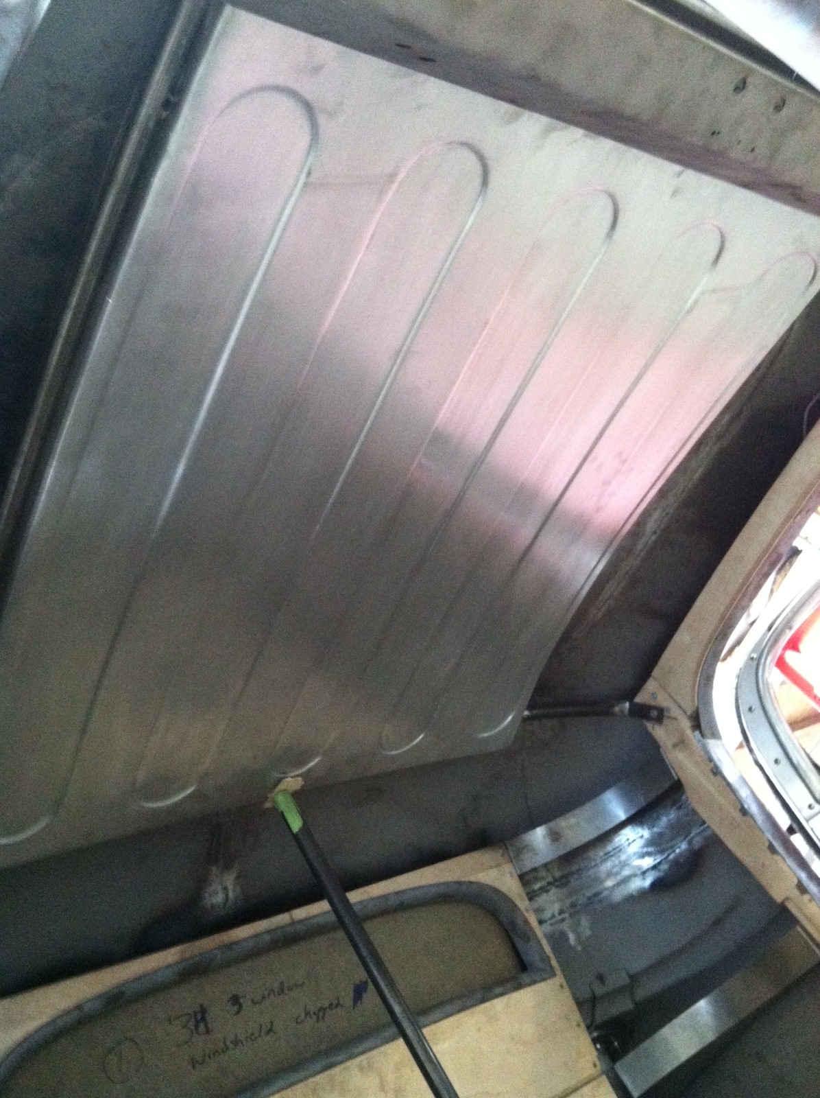

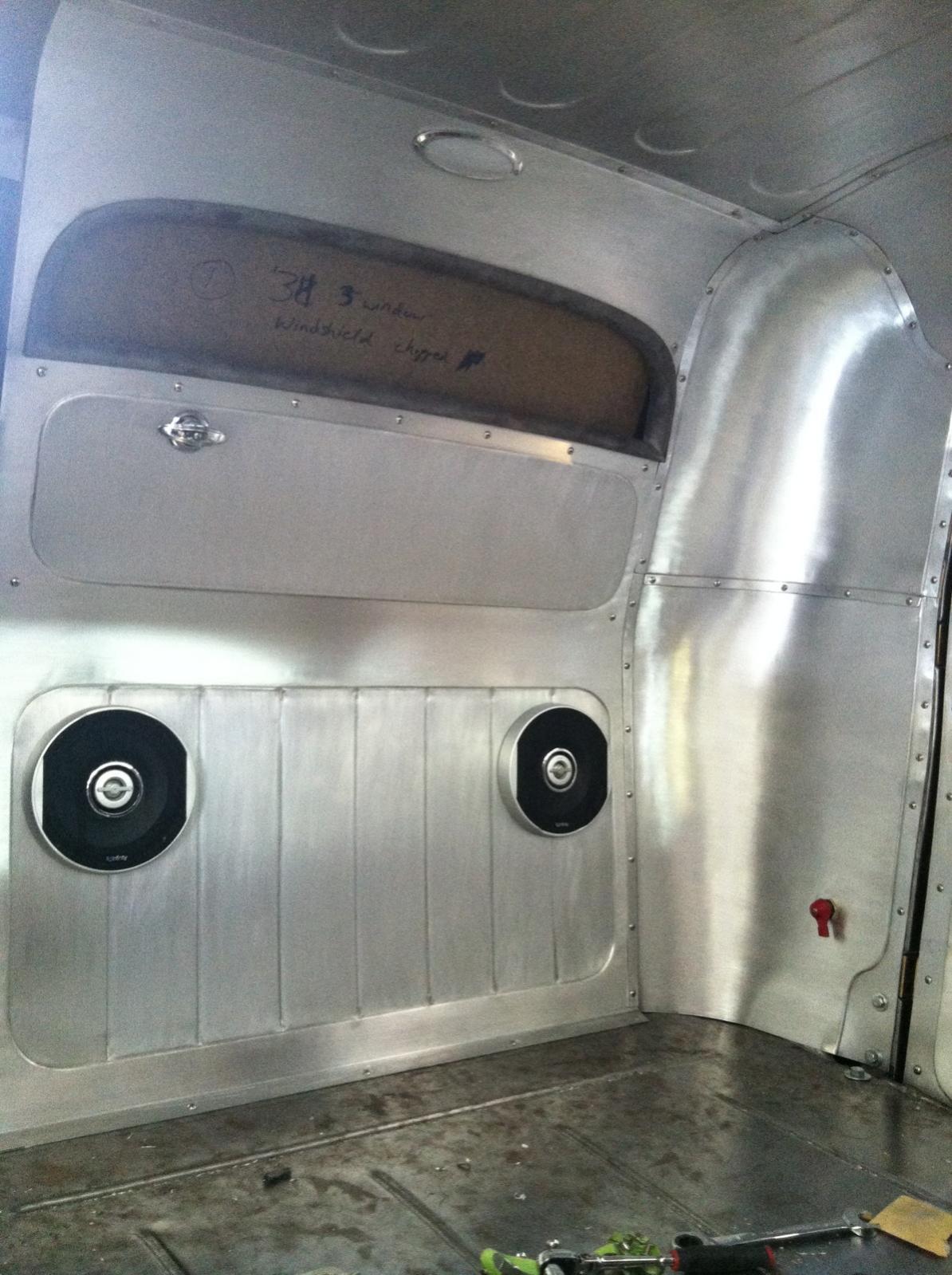

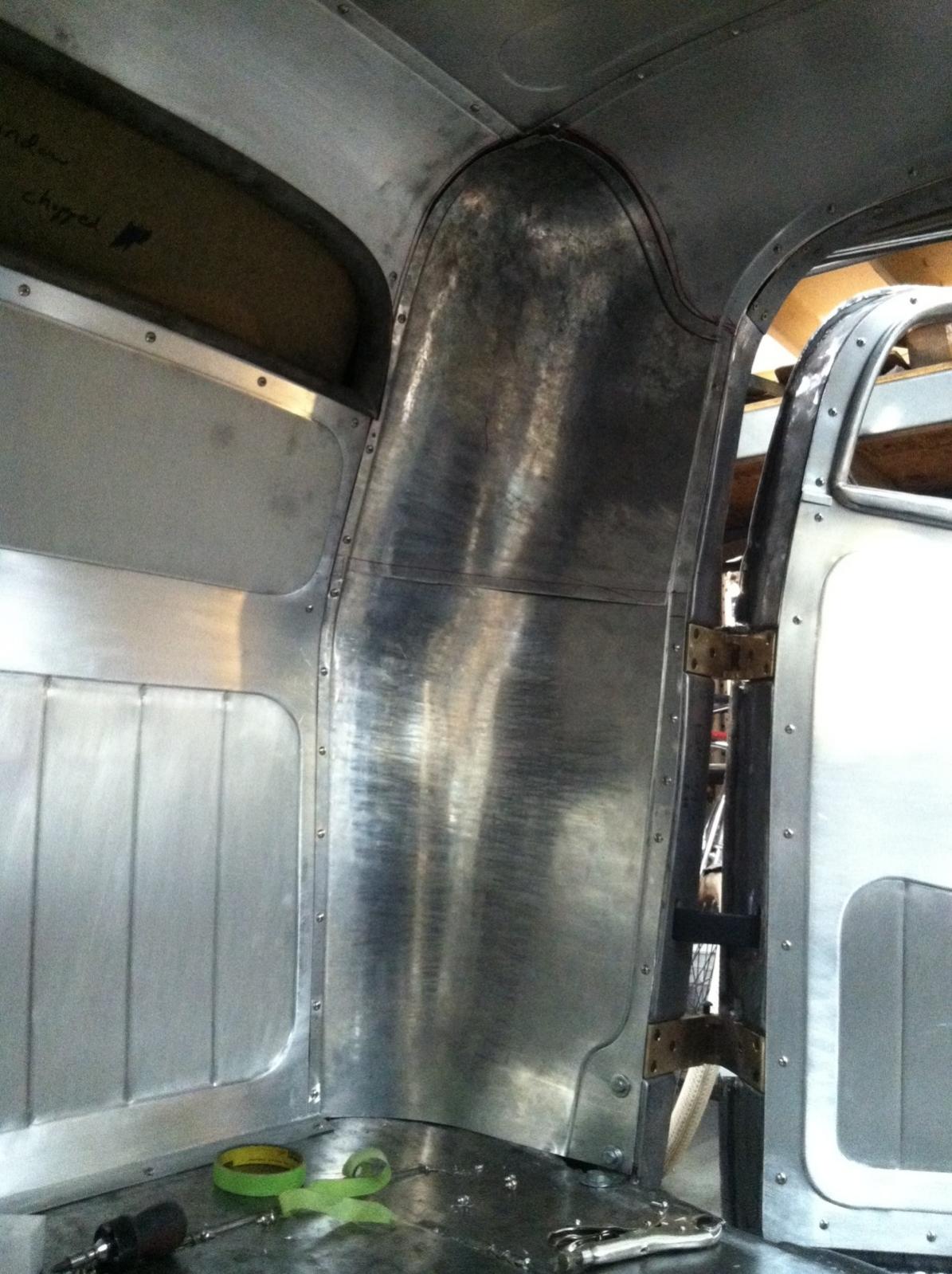

    Here's the drivers side upper interior piece Josh has fabricated and installed. PLUS: Josh has started on the rear of the interior with a one piece "movie screen". smile. It will have an opening cut for the window/ garnish molding and then more matching detail rolled in.
    Josh is hanging in there as this is getting close to the end of his fabrication effort. The rear upper quarter head liner pieces will be the last complex effort as he will need to get the three dimensional corners pounded out.
    It is getting smaller and smaller in there!

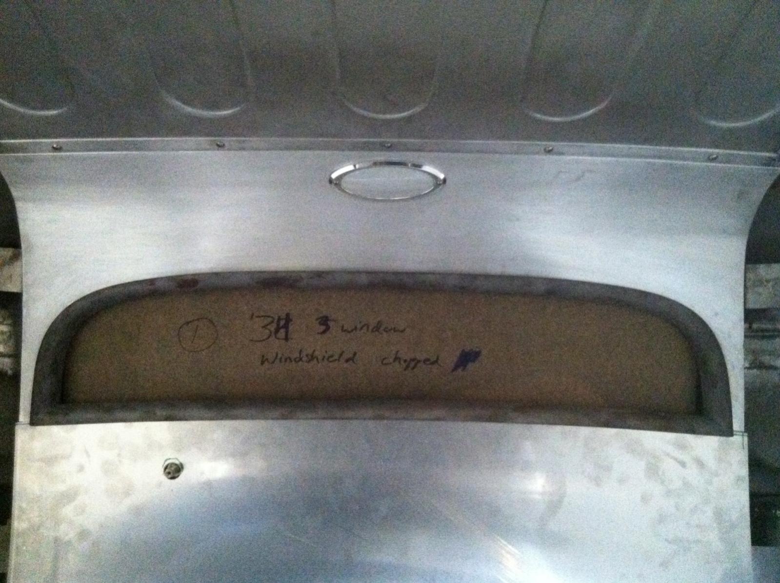

    Josh has made more progress in the interior panel effort.
    Please see the attached picture of the rear window opening with garnish, interior dome light and opening for the rear window handle.

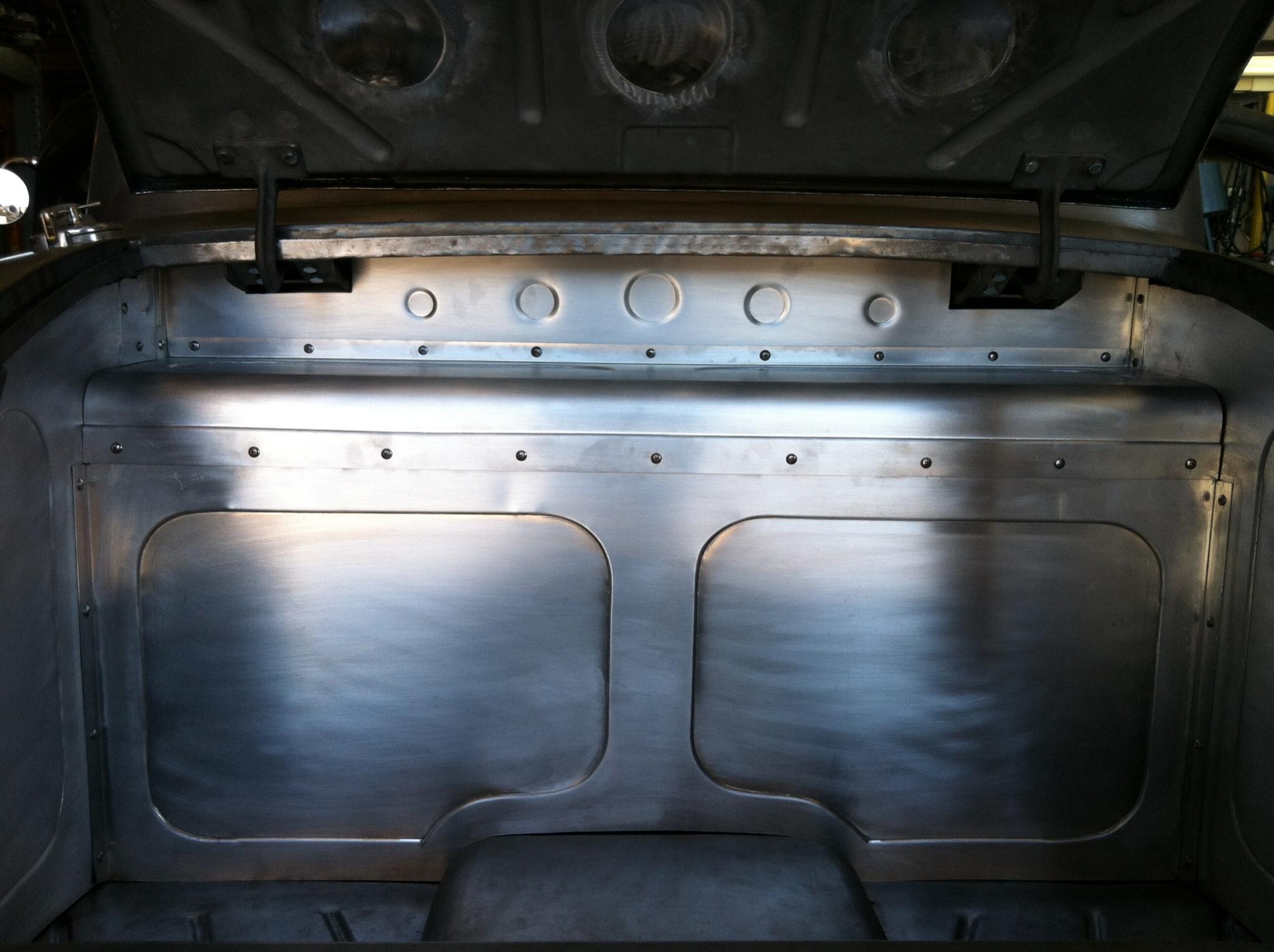

    Here's the final rear panel...I really like the outcome. Thank you Josh!

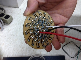

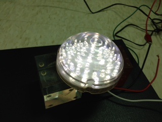

    If you guys don't mind pictures of electronics .....the white output LED tail lights
    Will be here next week. I have to put them in the lathe and cut off the clear housing. After that , I will use optically clear resin to fill around the LED's to insure the circuits are protected against moisture.

    geoking
    David,
    How about this one then? .04 amps on 22 circuits off the power buss . The LED is 3.5 volts,
    Regards,
    George

    David,
    Since current draw isn't additive.... It is 22 circuits x .04 amps = .880 amps per tail light circuit card ***embly. For comparison, an 1157 bulb draws 2.1 amps.
    The 44 LED'S will be much brighter, they do not get hot, last a lonnnngggggg time and will look great and will make my blue dot really shine!
