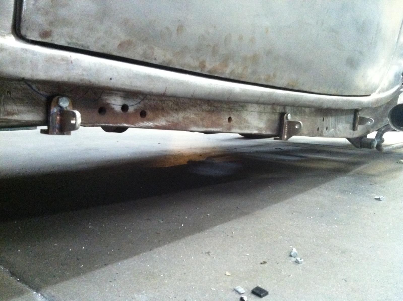

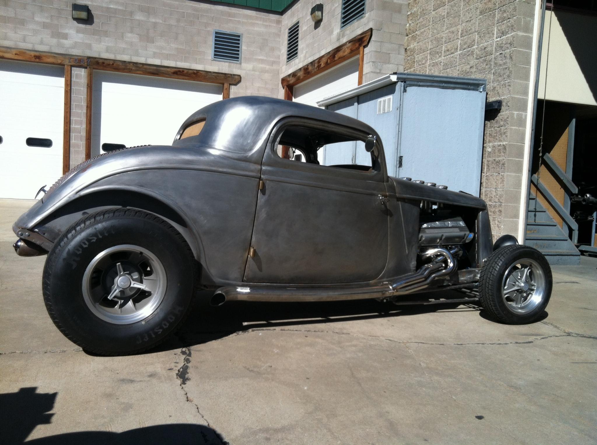

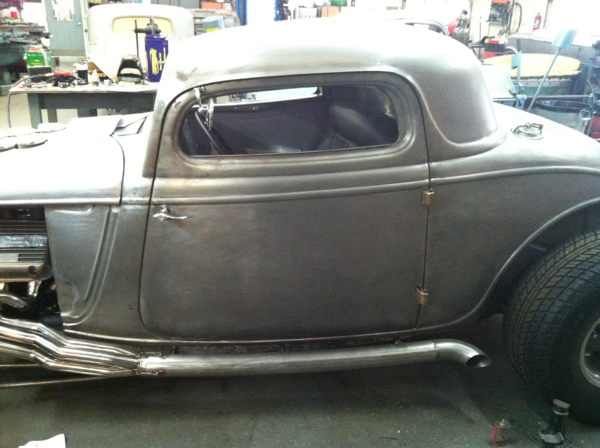

    Sidepipe mounting issue: We are concerned with ch***is and motor flex and will address the over all reliability of the side pipe attachment with flex mounts at the pipe and solid motor mounts to limit the sidepipe's rotational movement.
    Details:
    Please find the atached updated pictures to reflect the approach to mounting the side pipes. While you can't see the isolation pads underneath each of the frame attachment locations...they are there! You can see that there is a gap underneath the two legs that go 90 degrees back under the frame bottom. This gap will also have a rubber mount inserted at final ***embly.
    ADDITIONALLY....There will be isolation donuts at each of the three tabs on the pipe itself. Note that each pipe tab has first been welded to a diamond shaped plate. Josh has then s***ch welded this diamond shaped plate to the pipe. The deliberate lack of a continuous weld seam SHOULD DO THE TRICK to provide more reliability!
    We are confident that this approach will enable good long term results and prevent the welds from becoming stress fractured.

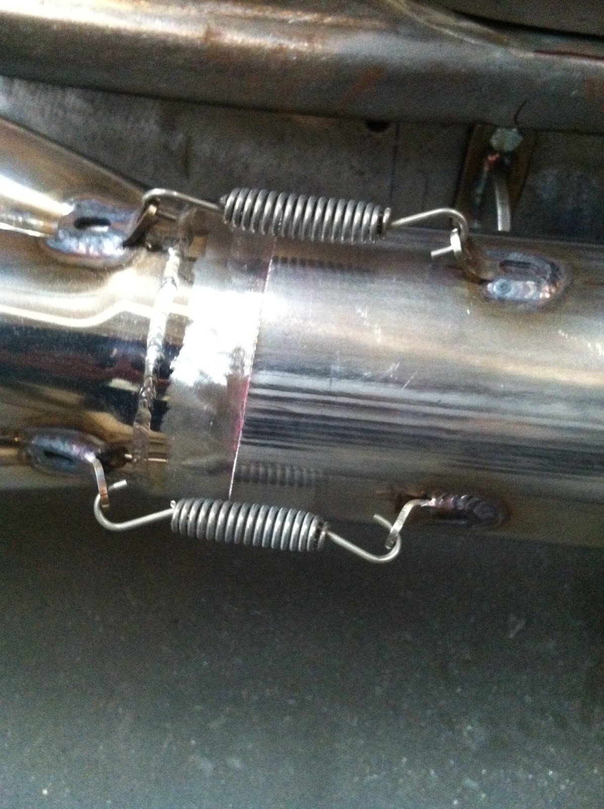

    Josh has completed the side pipes and added the springs that hold the pipe to the collector. All of the recently m***aged metal will now have to be cleaned up and metal finished.
    It is getting very close to tear down for paint.

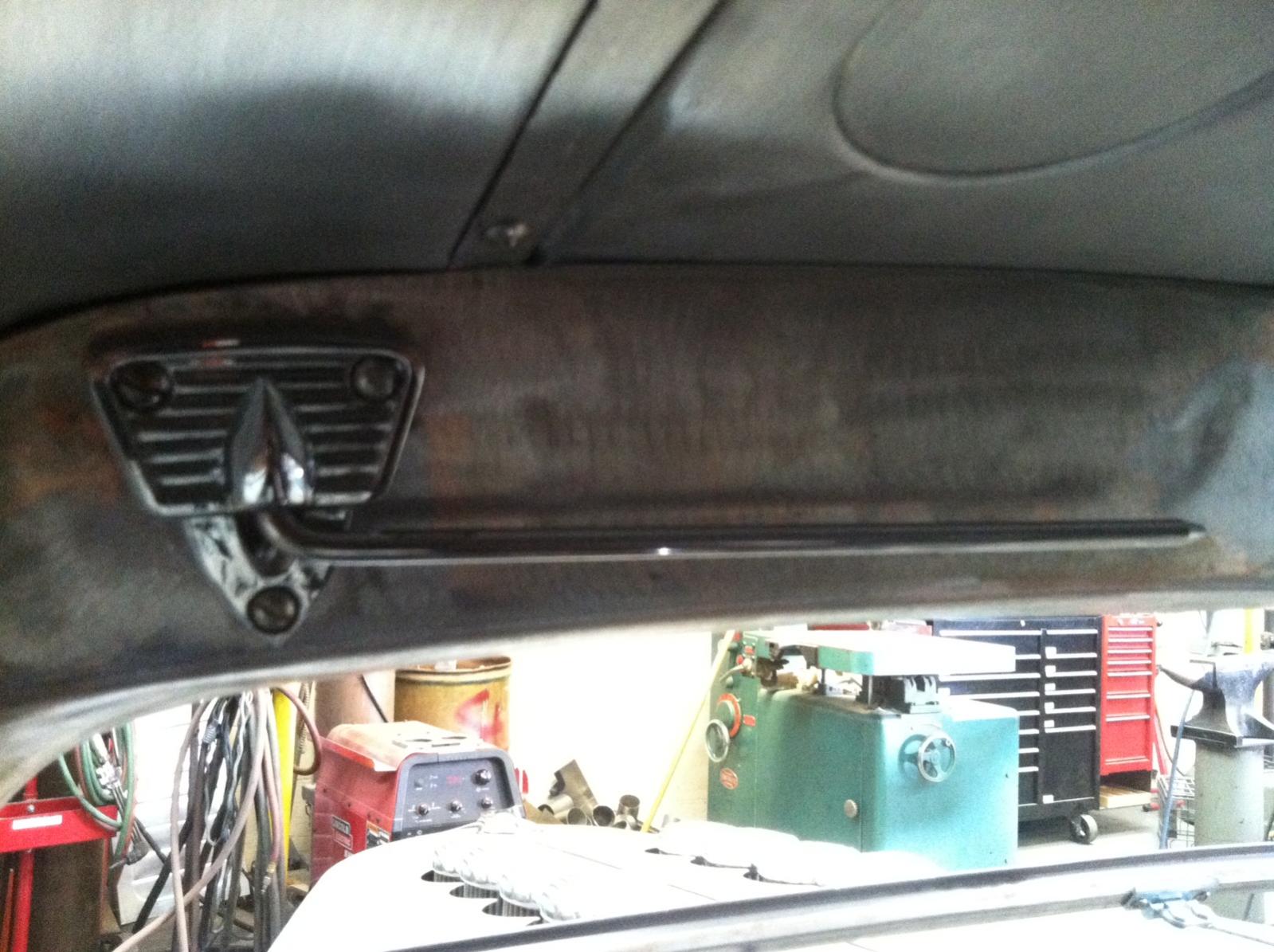

    1. I have attached pictures of the glove box with the WWII observers wings attached with a knob that matches the other knobs on the dash. This knob is way too big and simply doesn't work. I still like the wing detail but we are going to have to find something else or make it. It's a minor issue but still needs m***aging to get it there.

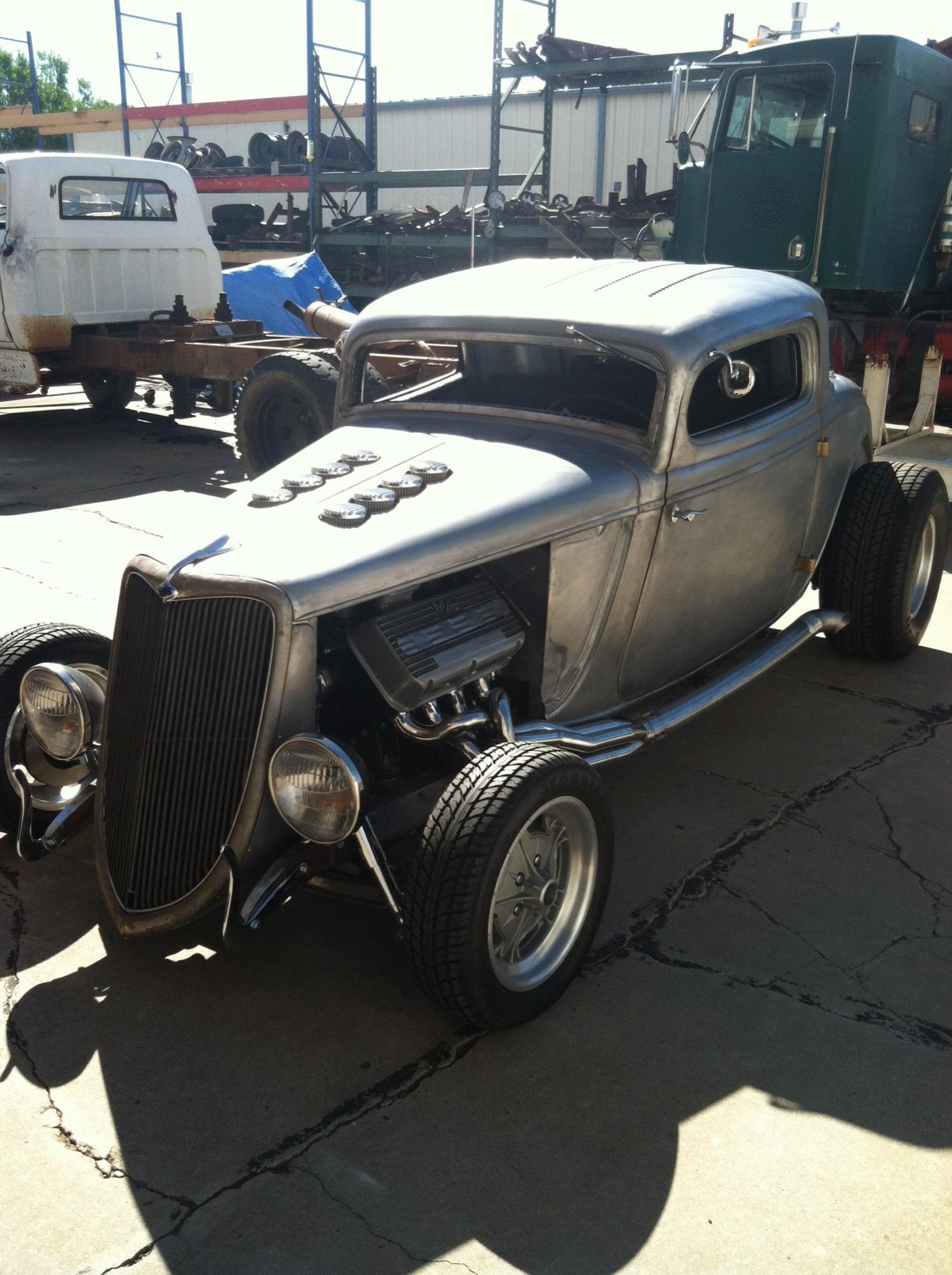

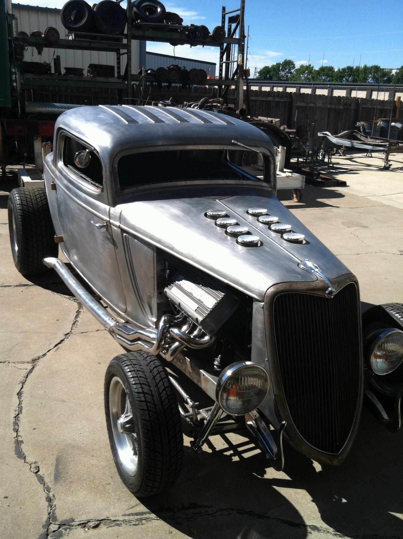

    I asked Josh to push her outside for a photo update now that the rain has subsided and the side pipes are on.
    Thank you Josh.

    really liking that stance ....
    keep up the good work .... =)
  10. loudbang
    Posts: 40,347
    Whew almost too pretty to add paint. But no go for paint.

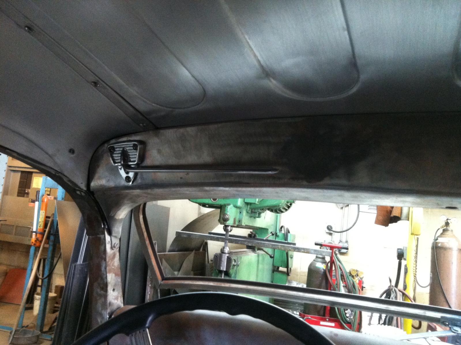

    Keeping it real....
    1956 Ford Truck Sun Visor arms

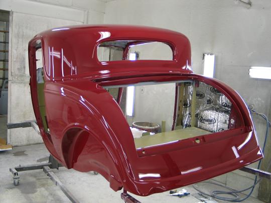

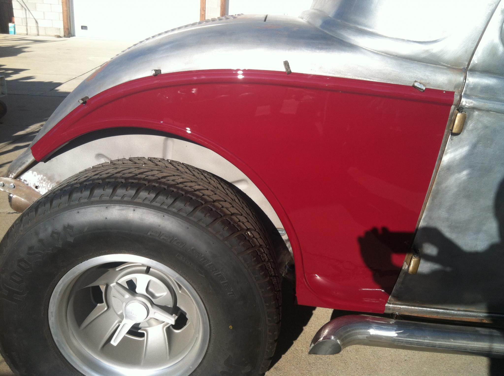

    Josh forwarded this picture with a note that states it is a "Sissy Color" ! Thanks Sweetie. LOL
    Dustin will spray out another red as well. The silver spray outs have been nixed by popular demand/ rejection.

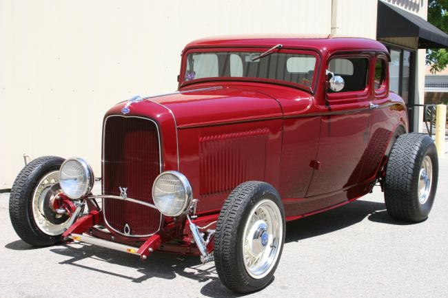

    I like the maroon you have here! If you don't mind what make model is this from and what is the name of the color?
    Thanks
    Mike
  19. Just Gary
    Joined: Oct 9, 2002
    Posts: 5,829
    Just Gary
    George,
    I really like where you're taking this build; kind of a street-going fuel coupe, like the 554 and 15 oz '34s.

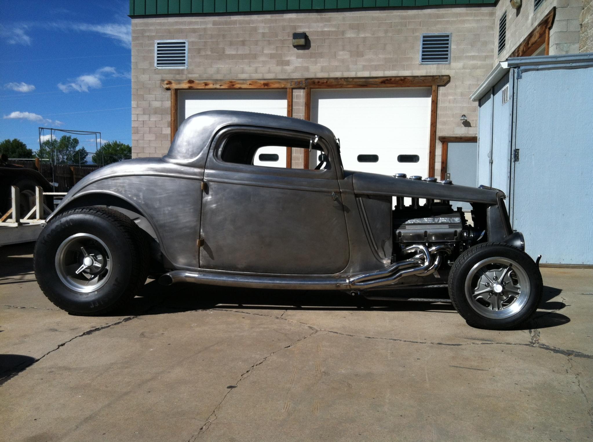

    The hemi looks great sitting a little higher in the engine compartment than typical.
    Is the bottom of the oilpan flush with the bottoms of the frame rails?
    How high is the oilpan flange above the tops of the frame rails?
    Thanks,
    Gary
  20. geoking
    Joined: Nov 12, 2008
    Posts: 717
    geoking
    Mike,
    I don't know the model but here's the detail.
    Make: Ford and the Color: Medium Red
    Base Coat / Clear Coat IE: Dual Stage
    Dupont Paint Code 6536
    Chroma Base coat, spray to desired coverage as it gets darker with each p***. When your satisfied, cover it up with clear .
    Regards,
    George
  21. geoking
    Posts: 717
    geoking
    Thank you Gary,
    The oil pan flange is actualy about flush with the TOP of the frame rails. Maybe slightly higher.
    The bottom of the the oil pan has 6 inches of ground clearance. The front axle and hairpins have about four inches of ground clearance. IE: We have room for the suspension travel without having to worry about the pan dragging the ground. See if these pictures will help? The bottom of the pan is actually below the bottom of the frame rail. Take a look at the steering in the second picture. Moving the engine up was a blessing for a nice straight shot to the aftermarket Vega Style box.
    Please keep in mind that all of this was AFTER STRAIGHTENING THE FRAME RAILS which lowered the entire front of the car 1 1/2 inches.

    Dad bought a 40 coupe almost thirty years ago that was painted Med Red and it has been a family favorite color ever since then. It's ended up on numerous other cars. Lots of uses for a color like that. I certainly approve it on your car.
    And SAR cuts up 34's to use as test sample panels?!

  24. rcnut223
    Joined: Oct 12, 2006
    Posts: 1,282
    rcnut223
    from wisconsin
    George
    thanks! Is this a non-metallic color? appears to be a medium red
    I like this shade...do you think this is similar?
    Mike
  25. geoking
    Posts: 717
    geoking
    Mike,
    Definitely NON - metallic. I think it is one in the same. The indoor lights make a huge difference in appearance so a little hard to be 100%.
