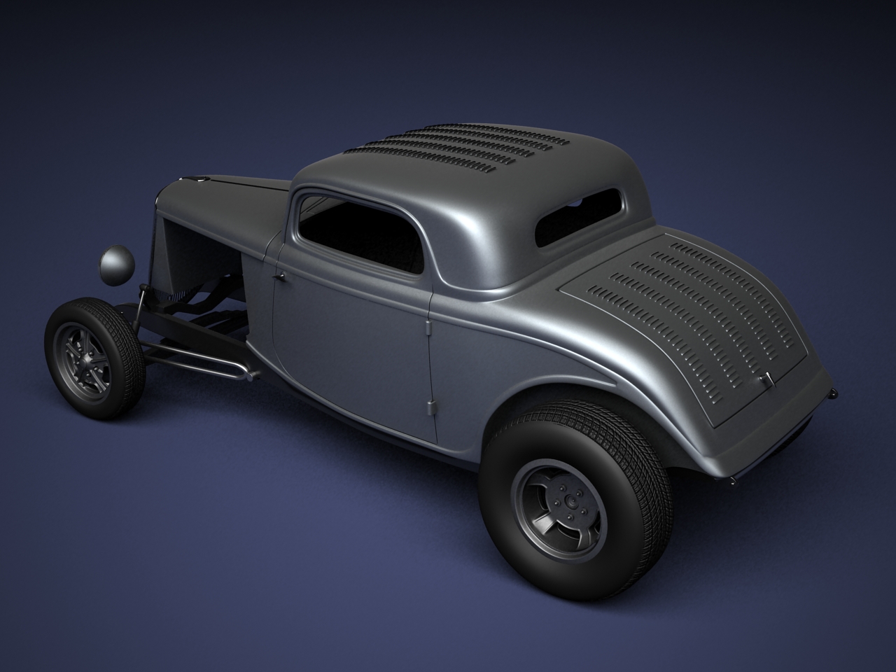

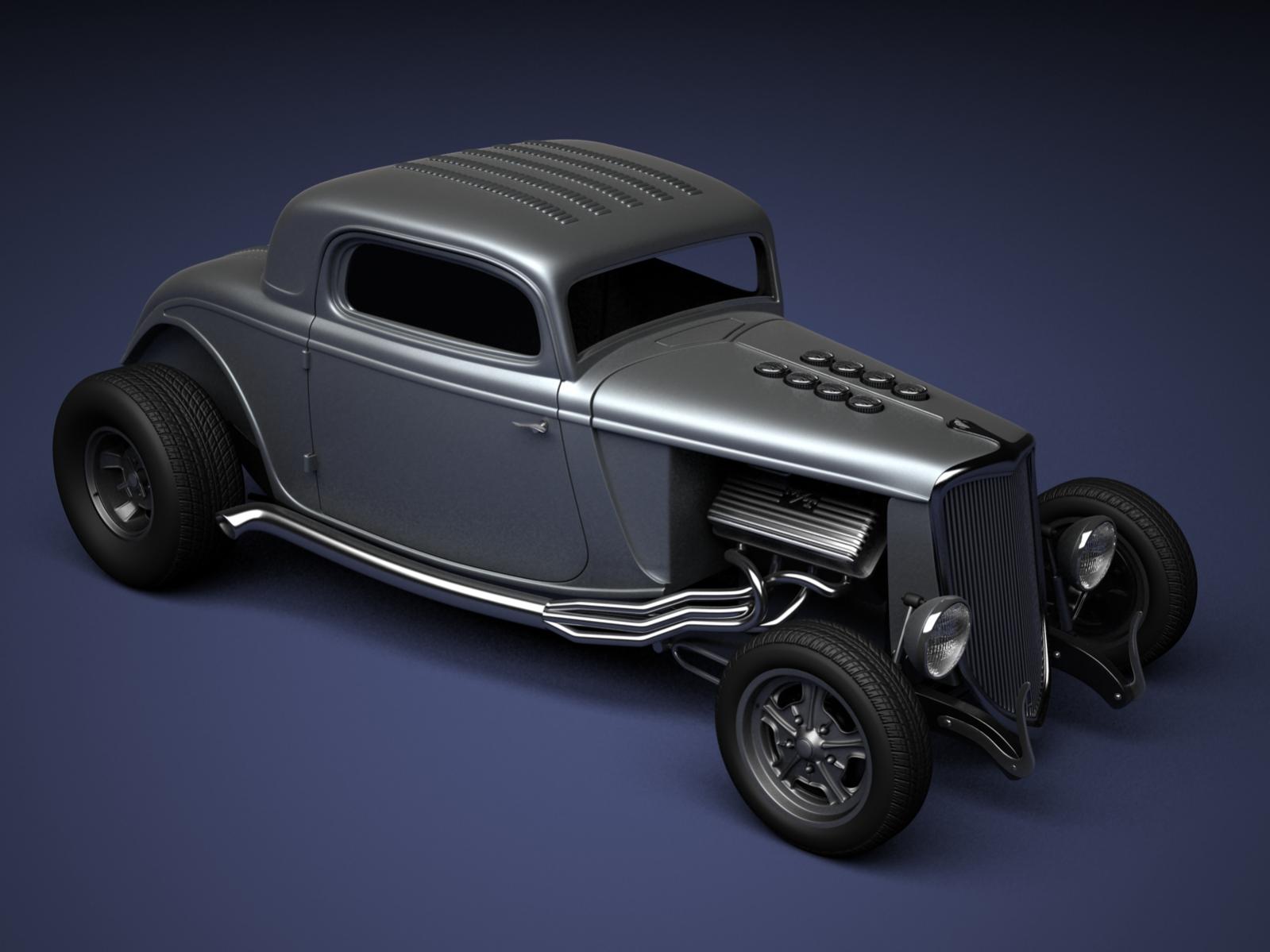

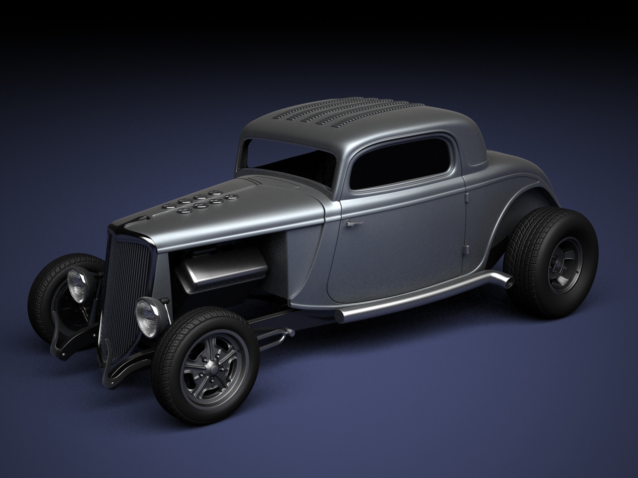

    Here are five different "metallic" renderings from Dan. He has been such a pleasure to work with. Of these, I will consider the darker gray. (Upper right hand picture)
    Next up will be a series of 1930's to 40's solid cl***ic colors.

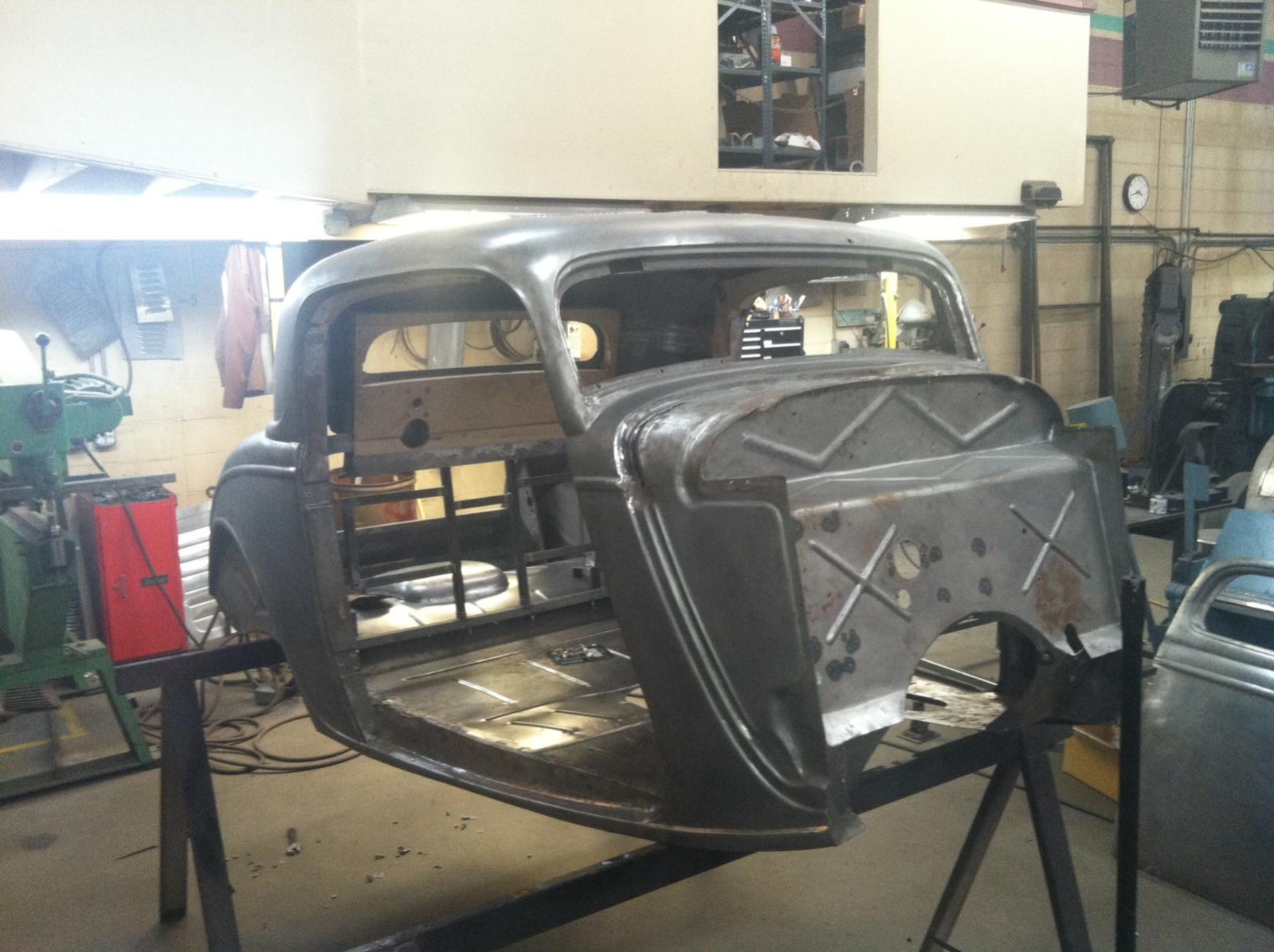

    While I have been goofing off,...Josh has been working. He has the coupe going the other way now. It is no longer about about the decisions and creating / fabricating. It is now about getting the smallest of details right. Welding up unused holes, getting gaps correct and tending to the mundane that will make a difference in the end.
    Josh has the coupe stripped down and will be working on getting all of the parts completed to hand off to Dustin for prep and paint. It will not be long before there will be a picture of the shell in its' color coat.

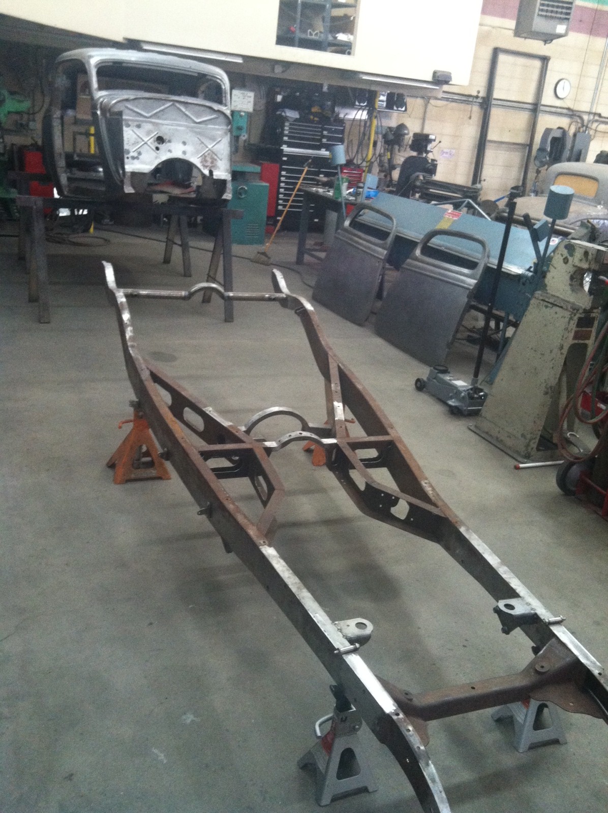

    The ch***is is going to have to be blasted as well as tended to for unnecessary holes and welding up previously "tacked" only modifications such as the motor mounts. The frame rail rear ends sure look odd without the body on. smile. Some of things that haven't been installed on the ch***is before and will still need work for mounting are:

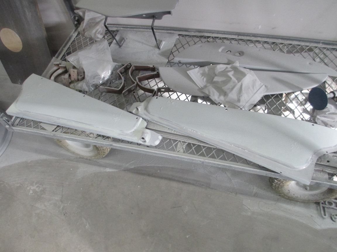

    Well, what can I say about these pictures....
    Like sending your wife to the SPA. LOL. They put mud on her face to make her prettier.
    Dustin should have the frame in primer soon and completed through paint sometime next week.
    Once he starts getting color on things, Josh will begin final ***embly.

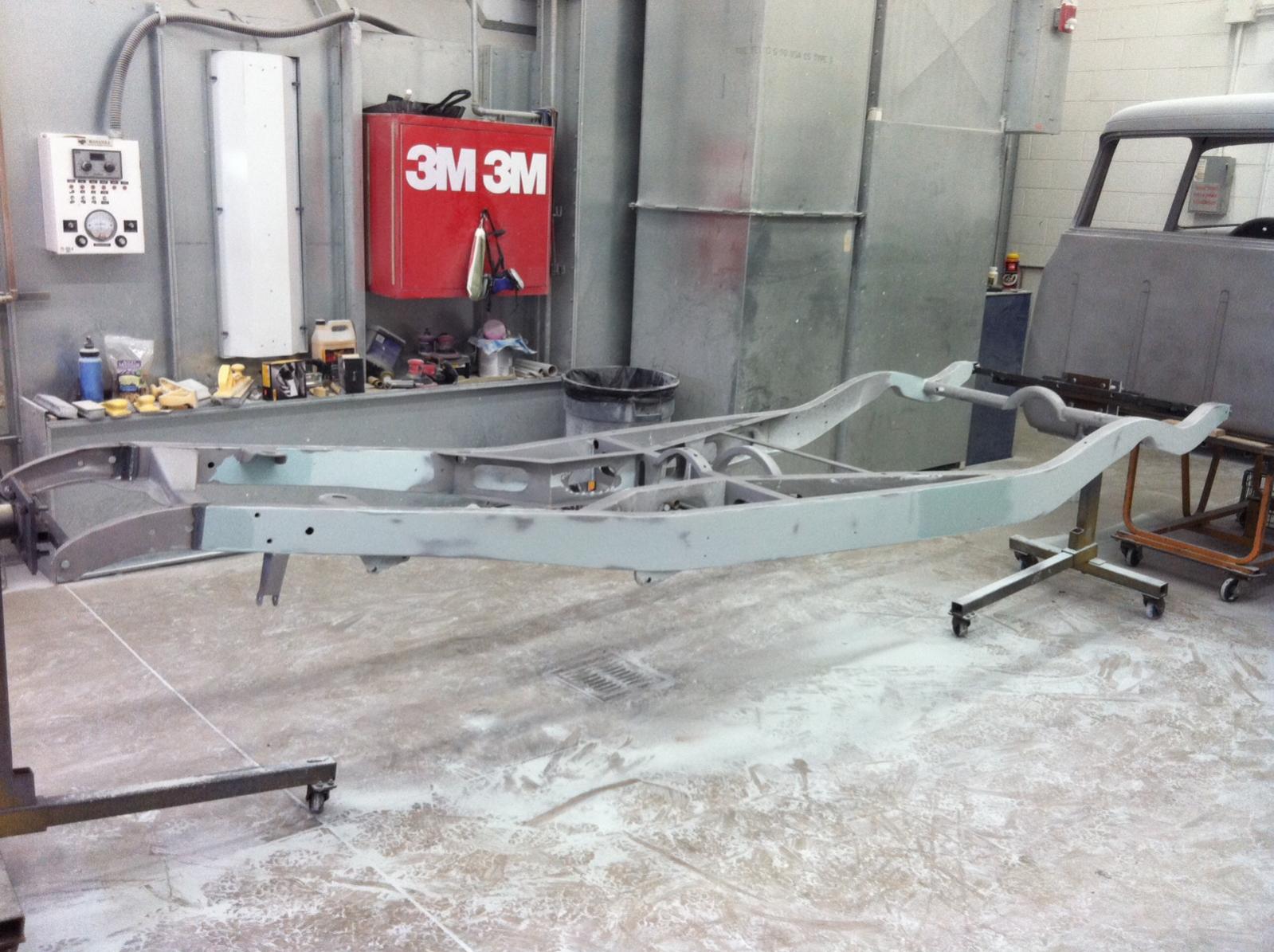

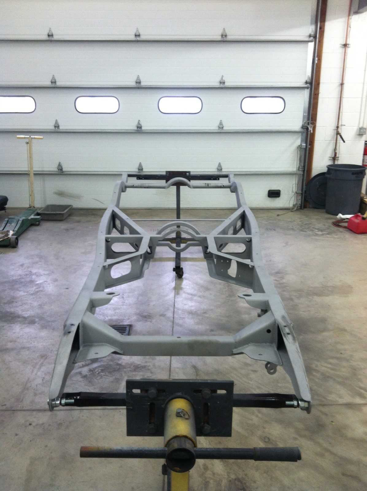

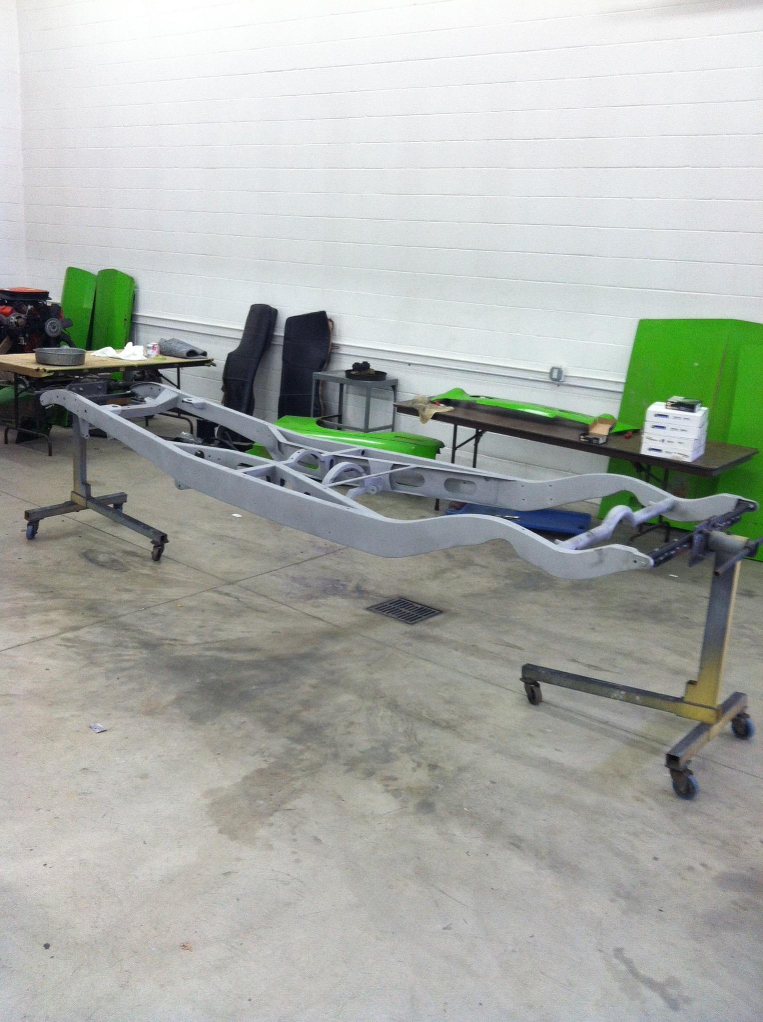

    The frame prep has now been completed. Etching primer has been utilized on the bare metal and epoxy primer used where body work had been done to smooth up the frame rails that would show after project completion. The second picture shows the two different coatings.
    I am looking forward to paint after water sanding. Hopefully the weather will cooperate for an outside picture shoot in the sunshine later in the week.

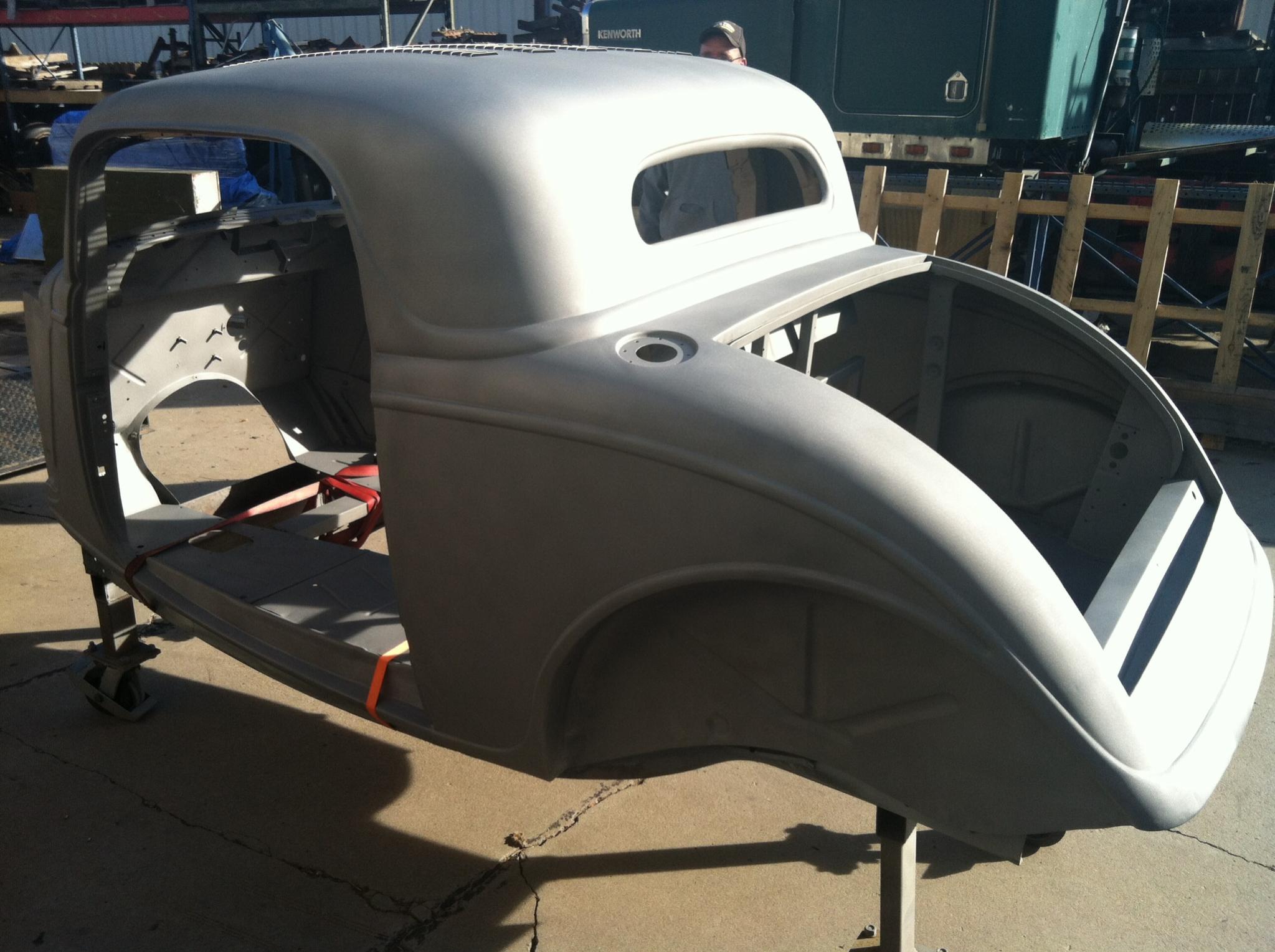

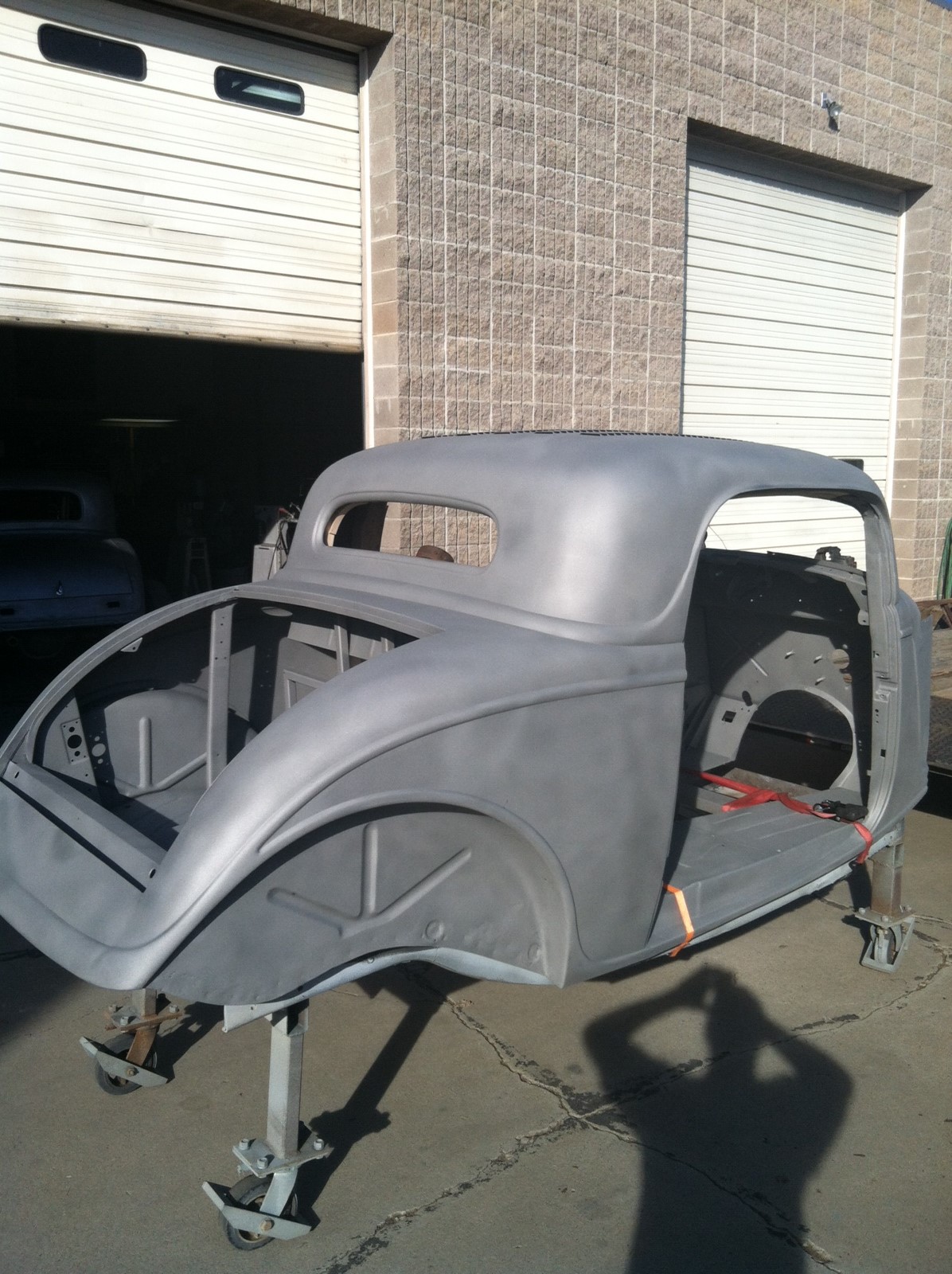

    Please find the attached "body in white" pictures as the coupe was unloaded today. She has been on a trip to "Blast Tech" in Denver for a prepping clean up before etching primer. I have to admit that I am like a proud parent. She looks awesome.
    Hope that you all like her too!
