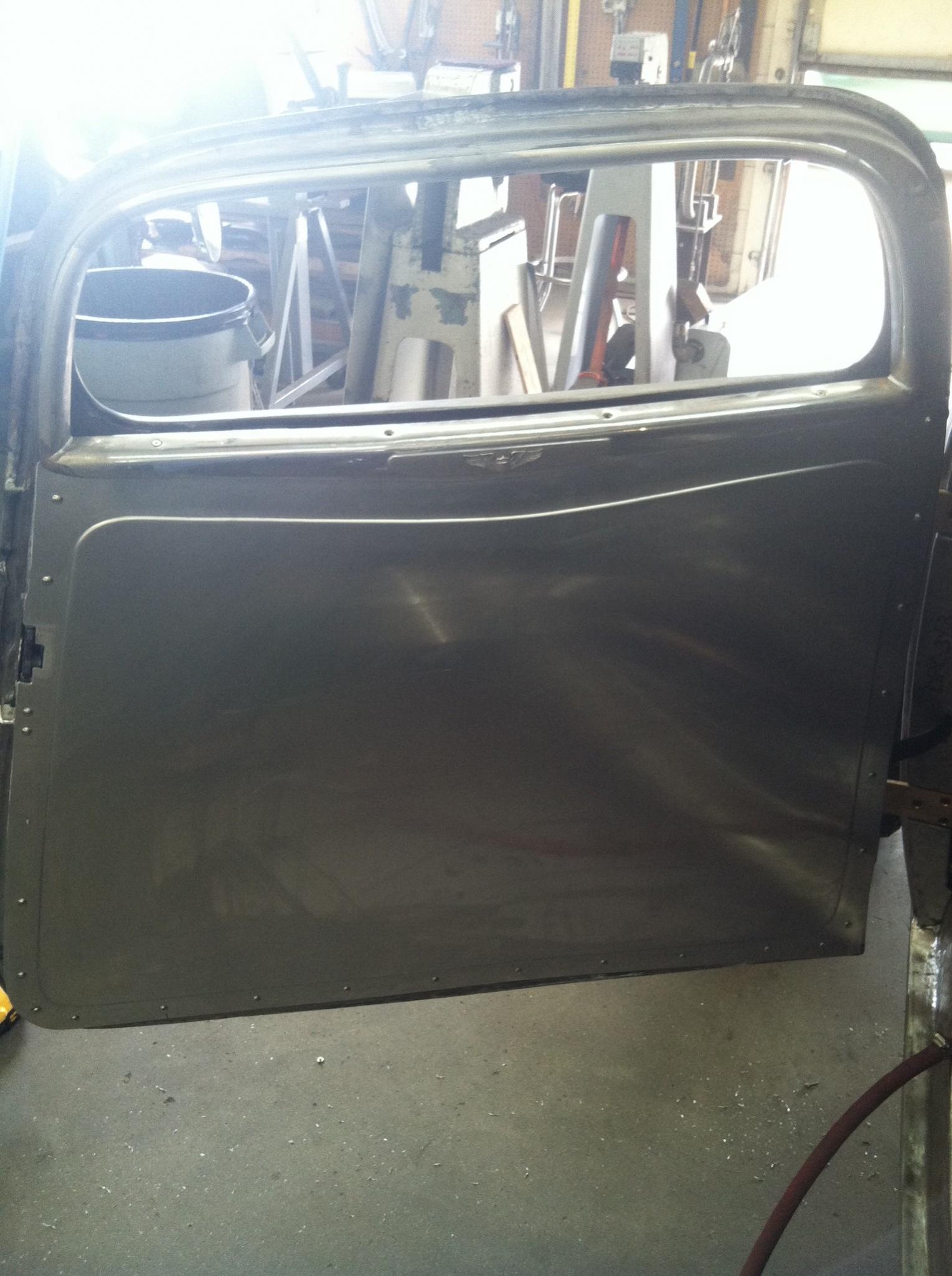

    The entire interior excluding the seat and arm rests is in brushed aluminum. Rather than you digging through the previous posts, I have added some pictures for you. The seat and arm rests are in a heavily textured black leather.... think of a very old library chair with thick, soft leather on it. I bought the seat from WISE GUYS last December when they were having a year end sale. The sale discount helped off set the up charge for picking an over the top premium cow hide. They did a very nice job on the seat and sent the left over pieces of leather for us to have the arm rests covered.

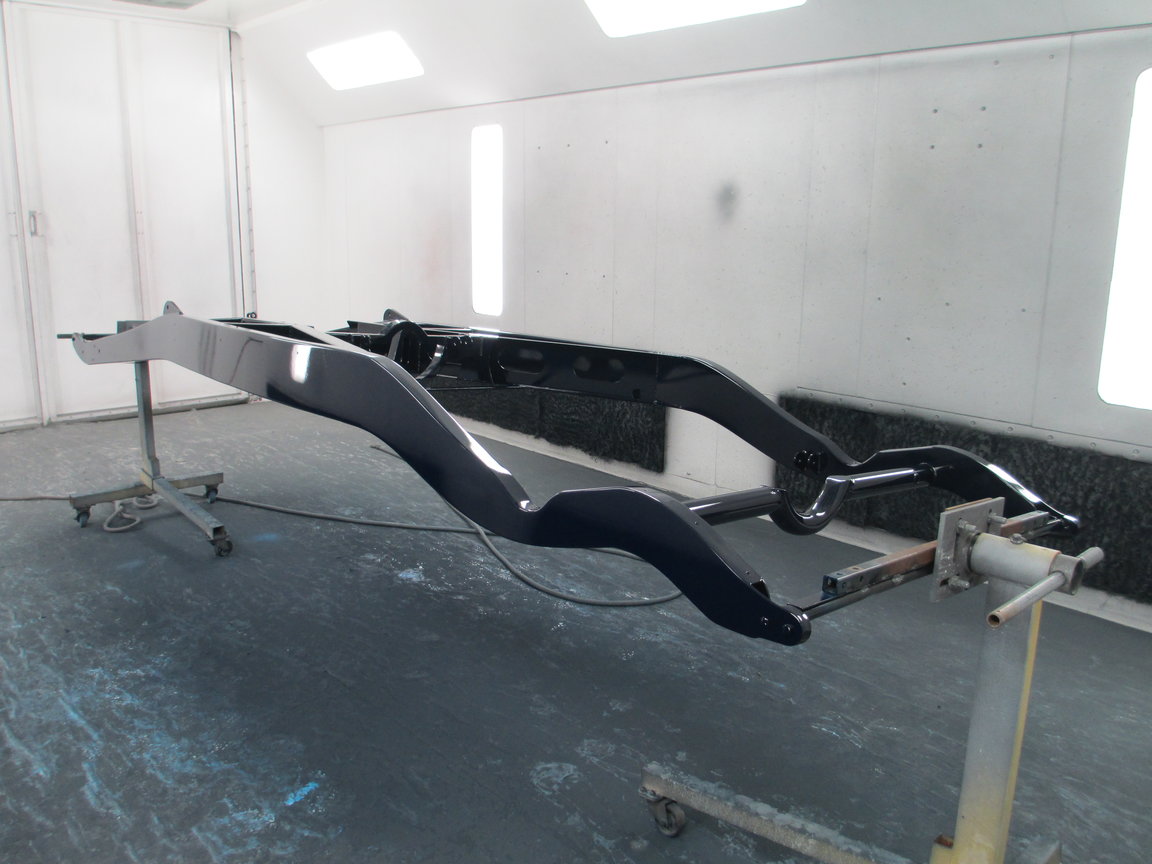

    Poor Dustin has wet sanded and wet sanded and wet sanded some more.
    The chassis has now been rolled over to the paint booth and will be shot with color on Monday.

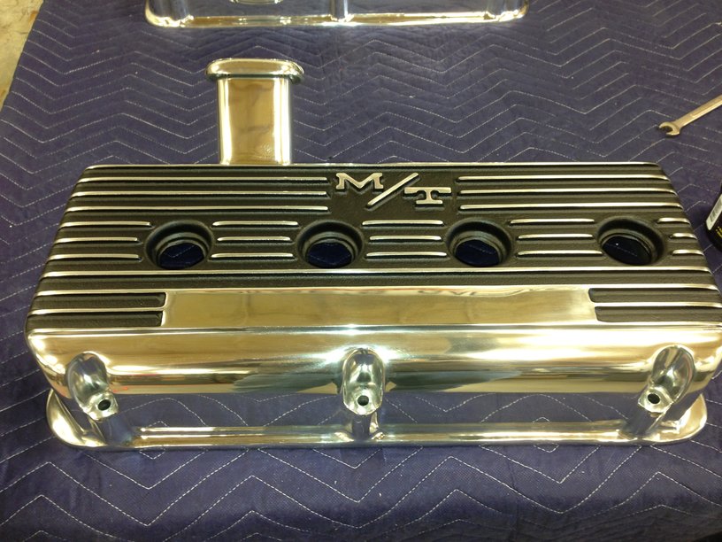

    Please tell Dustin I am doing a little to help out . smile. See the attached pictures of the polished, painted, drilled and breathers added MT valve covers. I have over 2 days labor in these things. geeze. But...I like the way they turned out better than the previous pair that I had wrinkle powder coated.

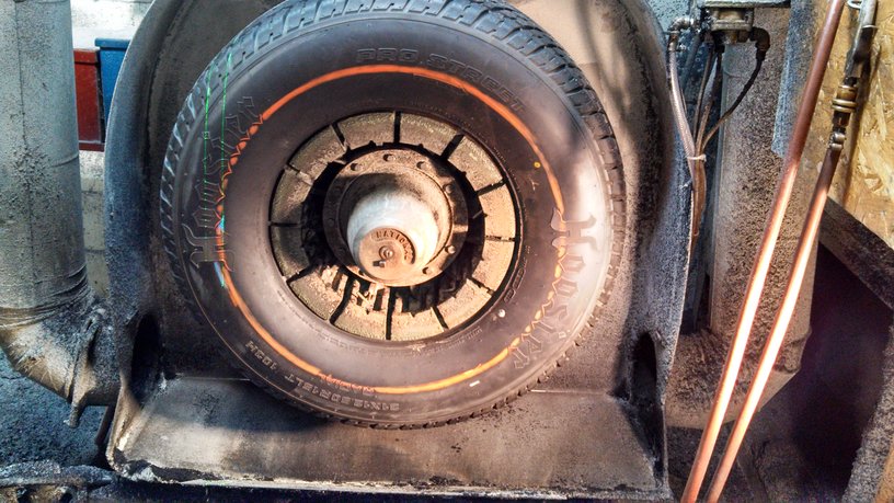

    Tire update:
    As part of the overall design, the tires will be smoothed and 5/16ths Red Lines added to them. The attached picture is from Diamond Back's founder "Bill Chapman". The rear tire has been chucked up and a chalk line added for our discussion of the new red line sidewall placement.
    The two green vertical laser lines towards the upper left quadrant are for centering the grinding wheel for part of the prepping process. The new red line will be 1/2 inch further to the outside than this photo shows. (Just personal choice and no other particular reason). The backside of all four tires will also be smoothed as I am looking for a clean look.
    Bill started in the retread tire business and all of his equipment is re purposed, customized equipment. The red rubber is applied in a 3/4" strip and after bonding/ heat it stretches out to approximately 1 inch. The newly bonded line is then laser trimmed to your desired width. I chose 5/16" as a compromise. The front tire sidewalls would have been great at 1/4" but the rears would have swallowed the 1/4" up. Since I wanted front and rear red lines to be the same, I bumped the front up a little.

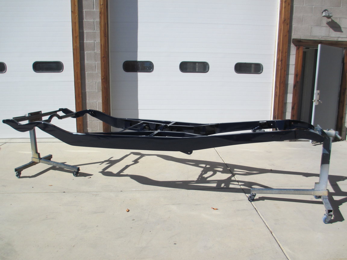

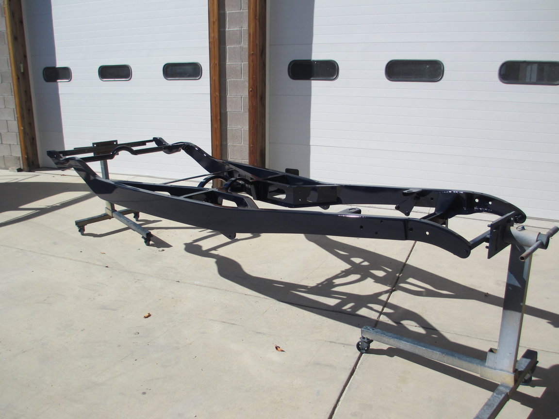

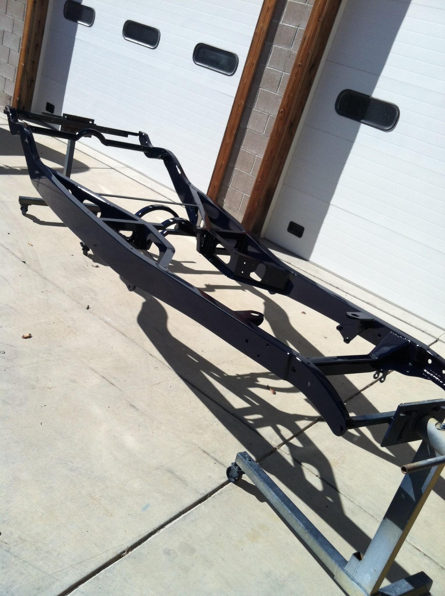

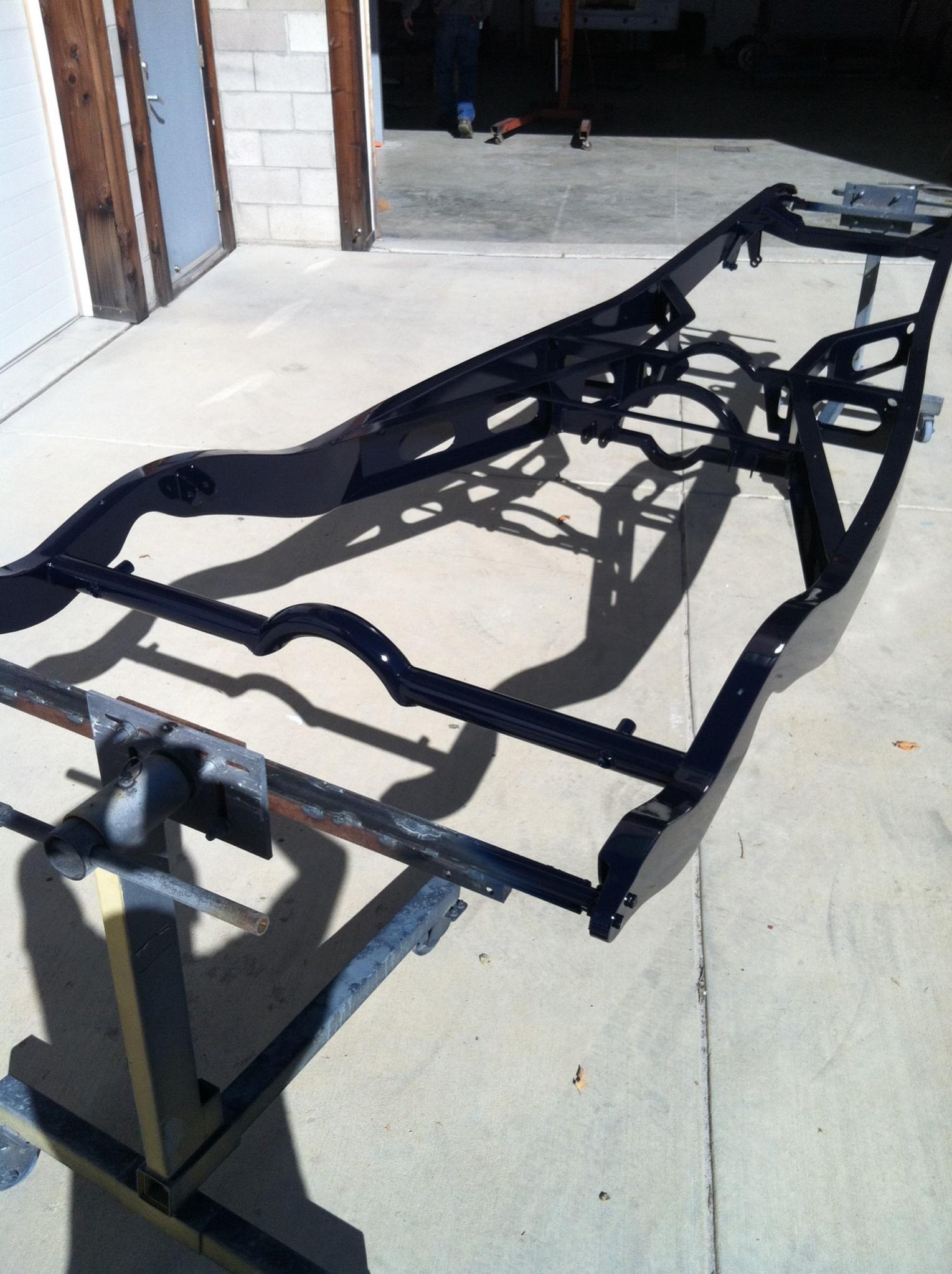

    As promised...frame in the sunshine pictures.
    regards,
    George

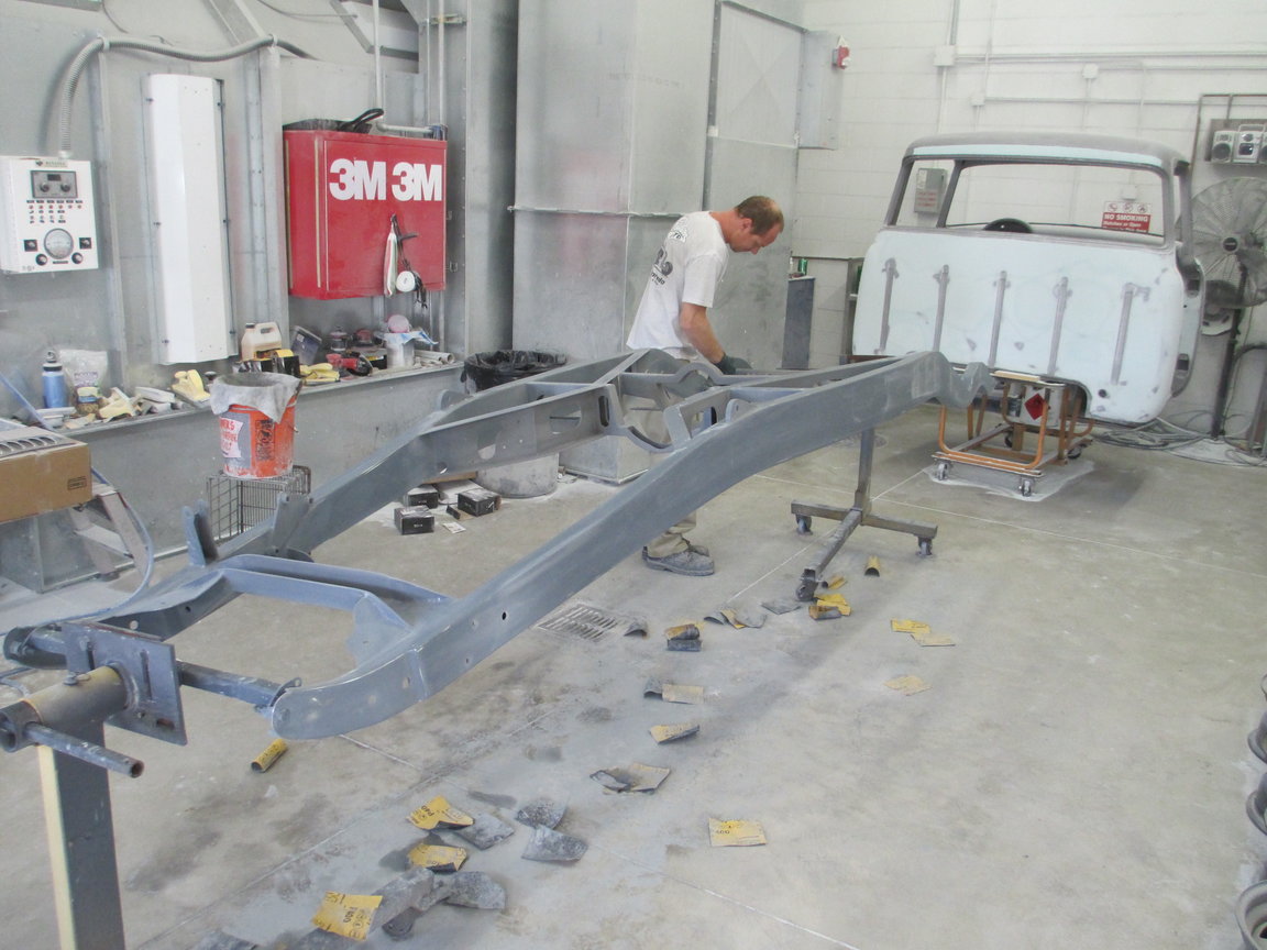

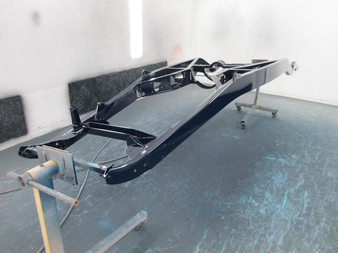

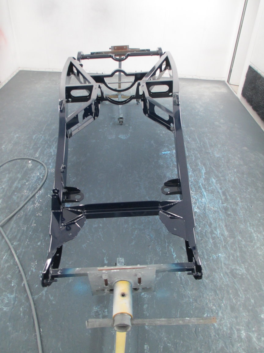

    I trust you guys don't mind more pictures... additional frame shots PLUS the body prep begins.
    regards,

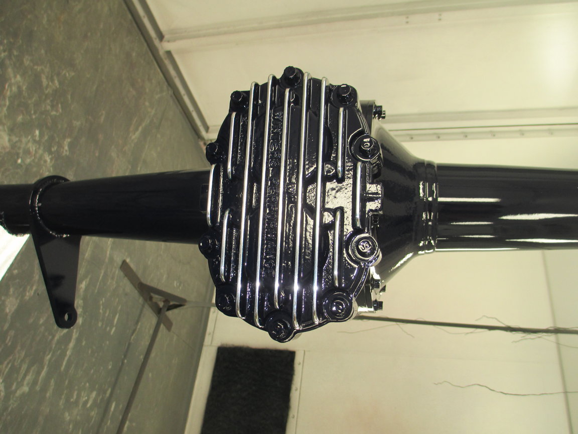

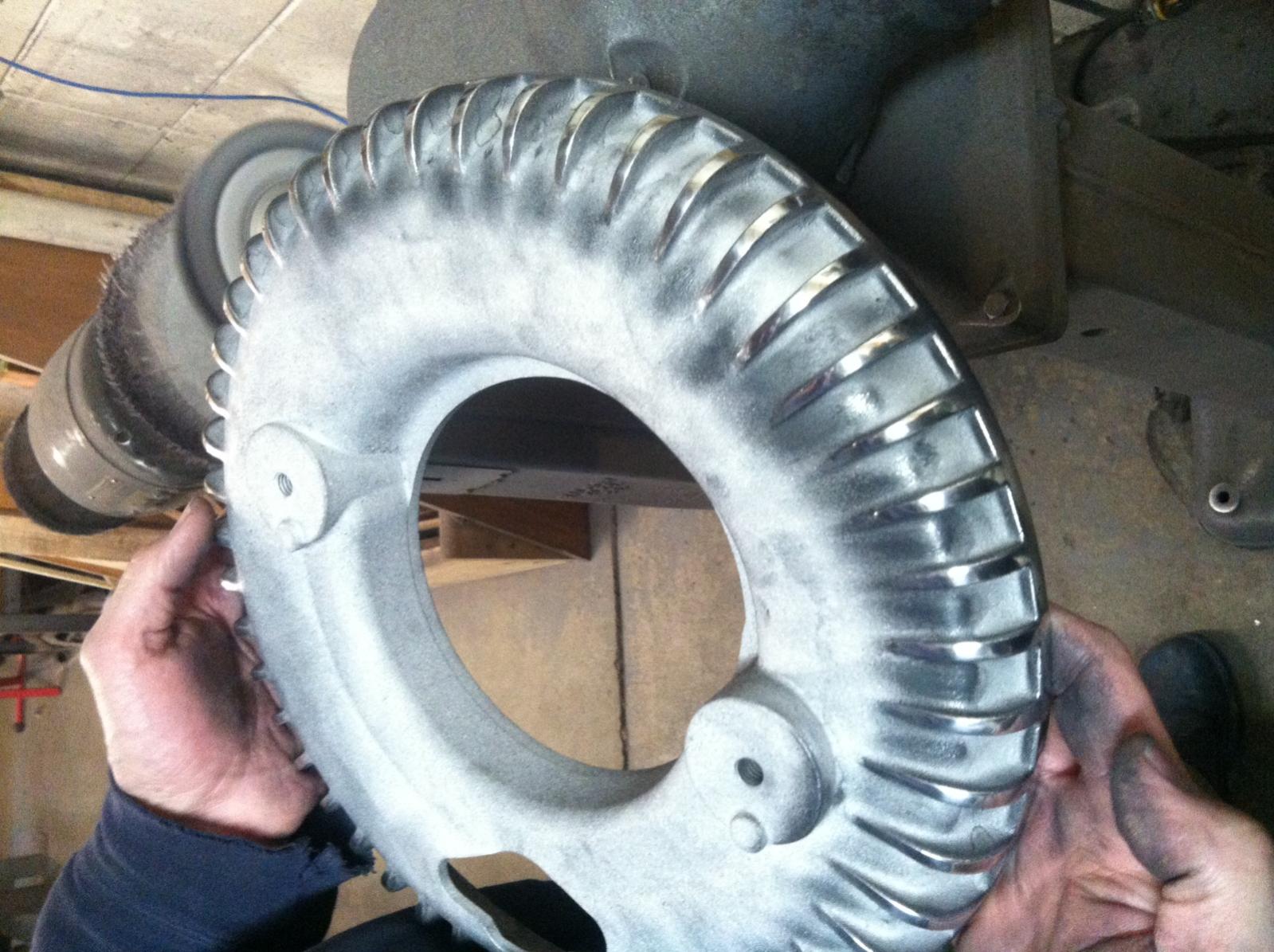

    Here's the rear end and other parts being readied for paint round two. Please note that the rear end cover fins had to be polished first. After priming and paint,...the fins will be cleaned with laquer thinner to expose the polishing effort.
    regards,

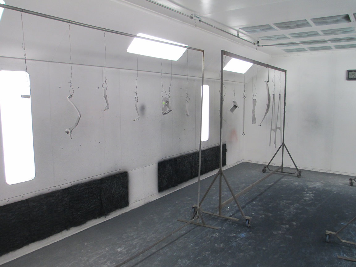

    Dustin has painted all of yesterdays part's more of the same blue. The key is to get enough of them done to allow drying time so that Josh can begin re-assembly. Everyone is working on something. Whether it is the body, chassis paint, chassis assembly or outside tires. We have also received our Kinmont STYLED brakes from Johnson's Hot Rod Shop. We will polish the ribs while painting the backing plates to go with the over all polished fins theme.
    The front suspension parts will also be matching Pozzi Blue with the exception of radius rods, front axle and shocks that are currently planned to be shiny.
    The drive train will be basic black. As a side note to the picture below, there are two different gears in the quick change. Pending which one is upper and which one is lower, the ratio choice for my gear set was either 3.94 or 3.62. I went with the 3.62 as I already have plenty of go.

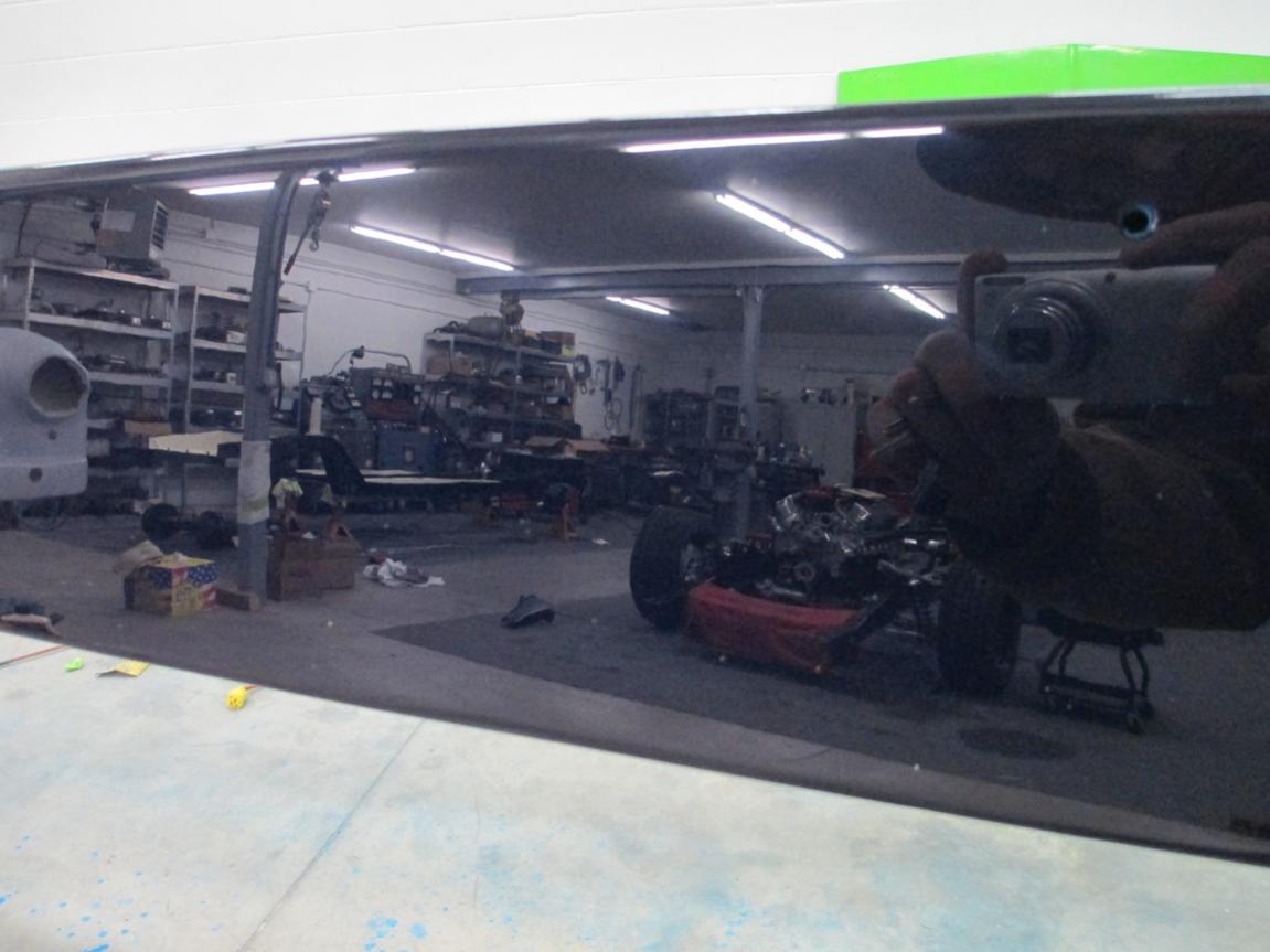

    Dustin has been busy buffing on the frame. If you look carefully , you will notice that this is not a picture of the shop, but a reflection of the shop via the frame rail mirror quality paint. Look a little more and you will see Rex holding the camera.
    Nice picture Rex! Thanks.

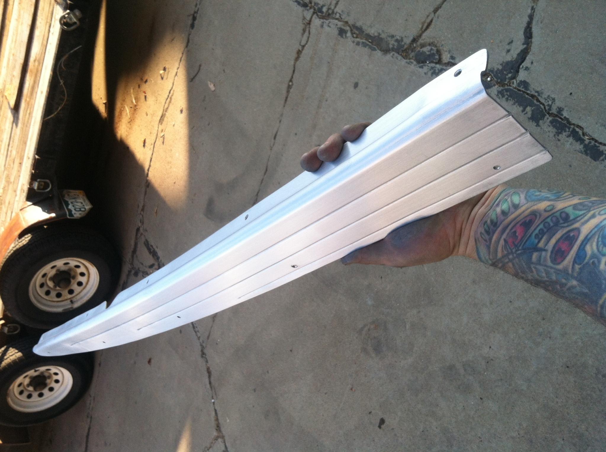

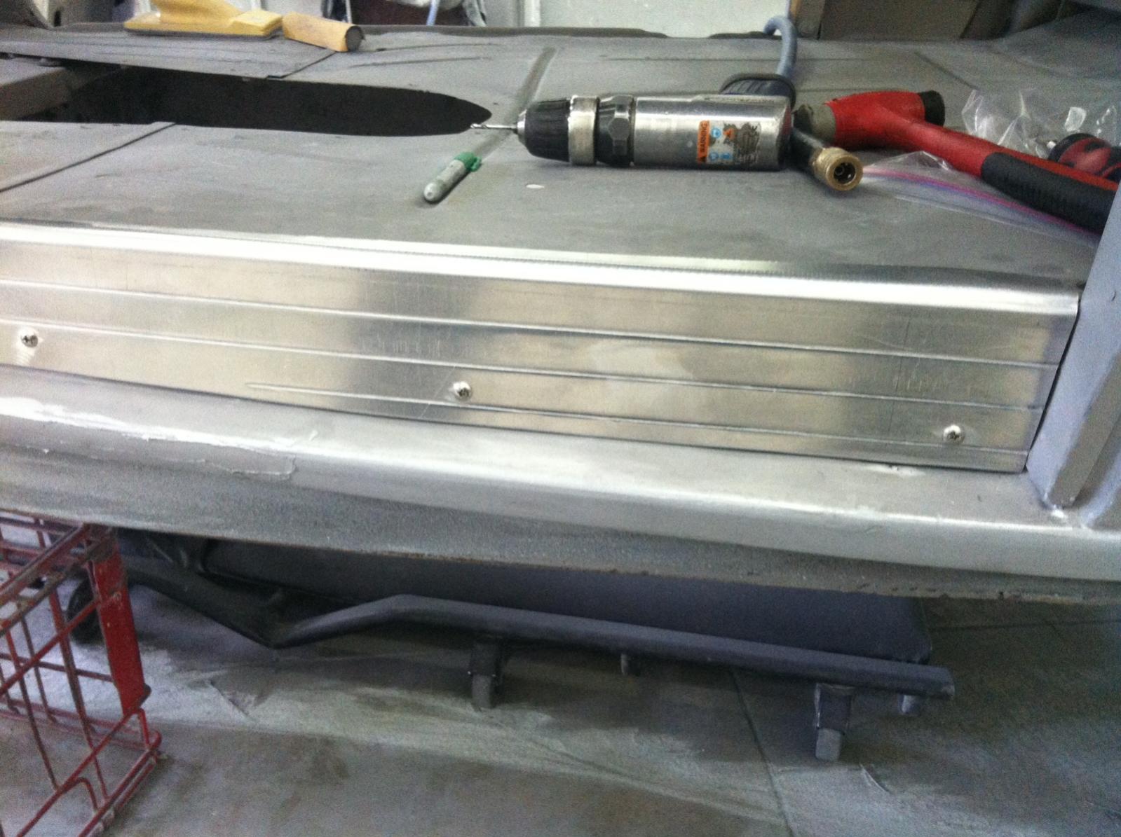

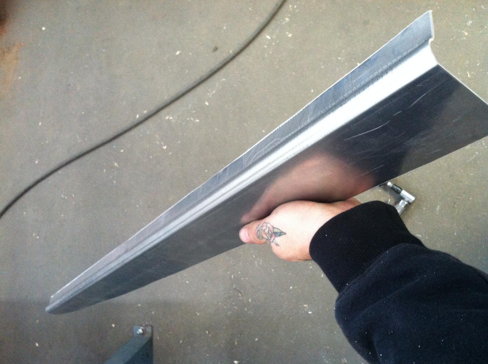

    Josh spent the morning working on fabricating the drivers side door sill plate. Please find the attached pictures from paper template to finished fabrication and first install. If you are interested, the large upper bead with step was run on the Pullmax. You can tell the speed by the track marks on top.( made by the upper dies stroke as the panel was pushed through) The smaller ribs on the face were done by first laying out with a divider and then being run through the bead roller. The final fabrication step was to use the shrinker along the inner leg to pull the sill plate in to match the floors radius.
    Next,... Josh will flip the pattern over and fab a passenger side. After he completes the fabrication, he will work on the details of sharp edges , surface finish etc. etc. Great work Josh!

    Here's the final look of the door sill plate after scotch brite to match the interior panels. Additionally, here's a first sharing with the H.A.M.B of my Kinmont styled backing plate. Josh has polished the fins so that he can turn it over to Dustin for body color. IE: Pozzi Blue.

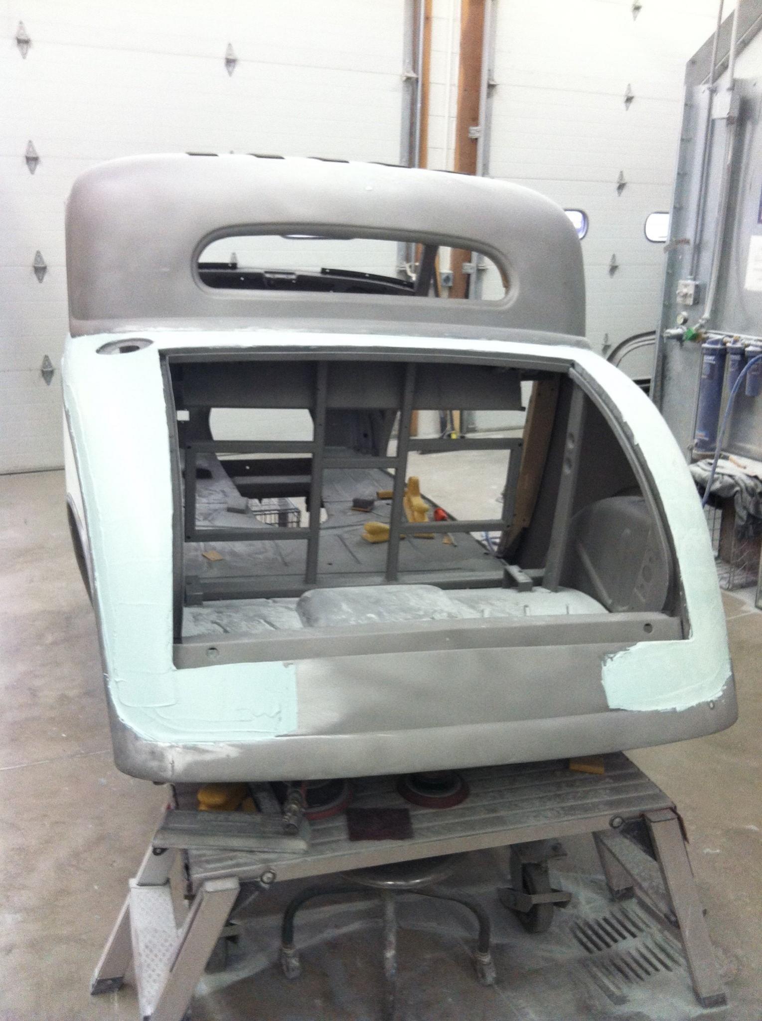

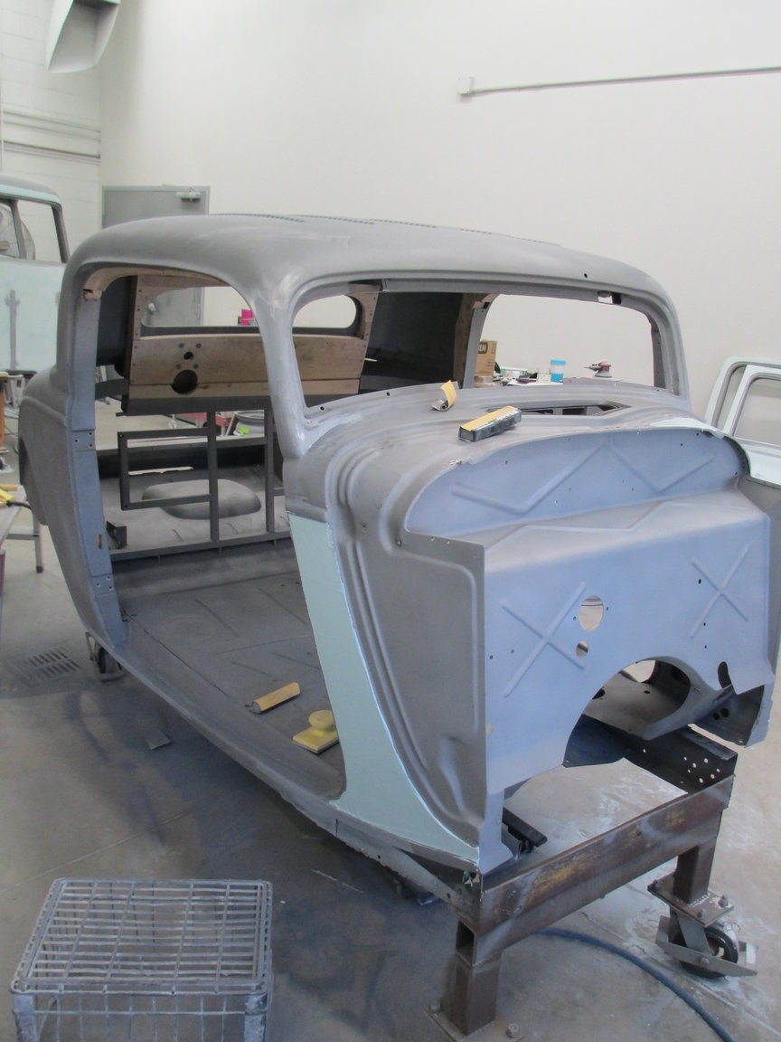

    The body shell has a little more skim coating on it and I have attached pictures of it.
