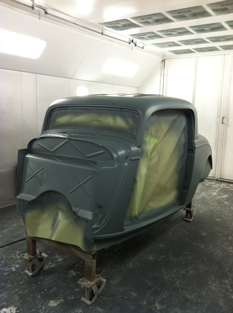

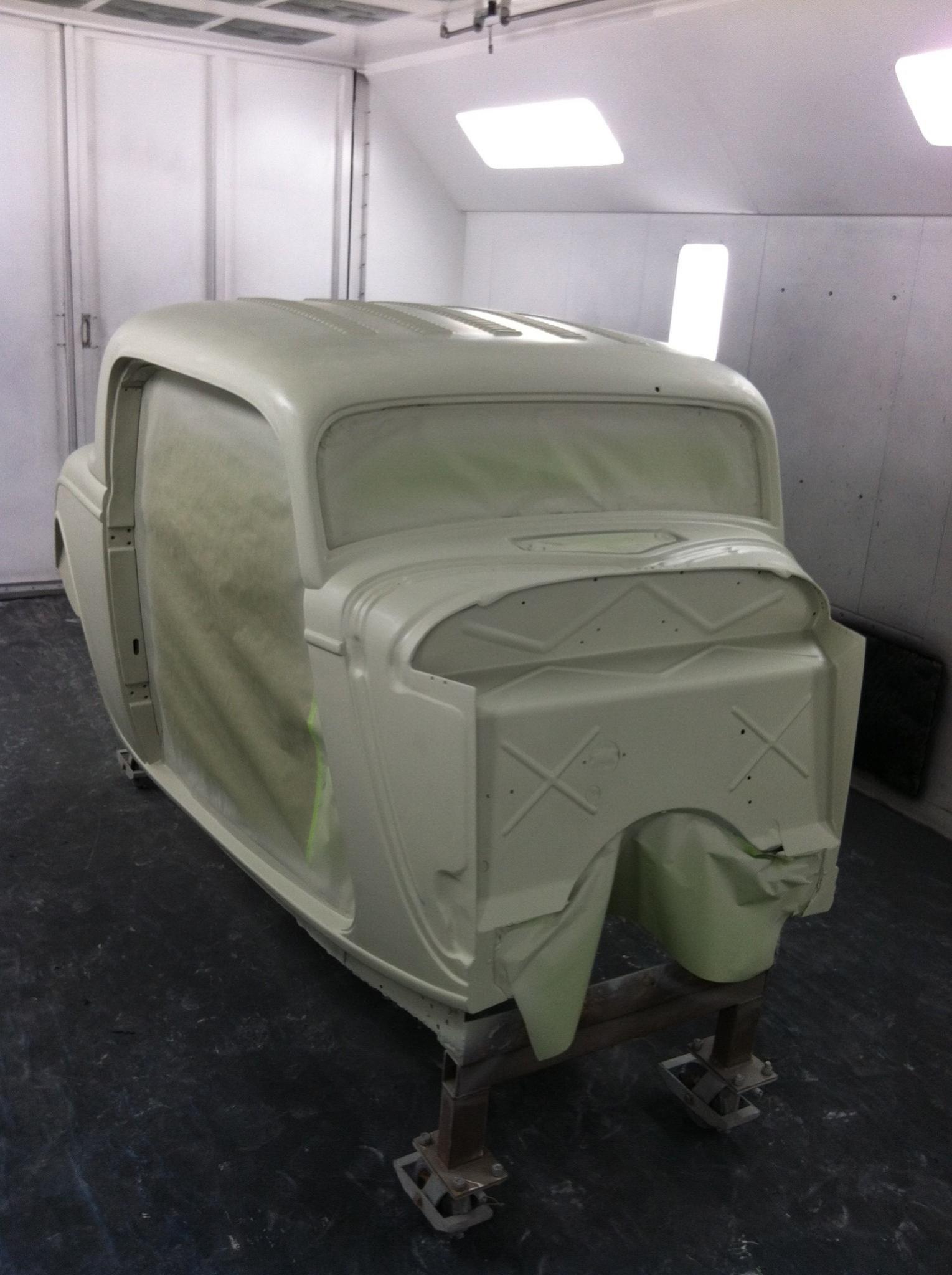

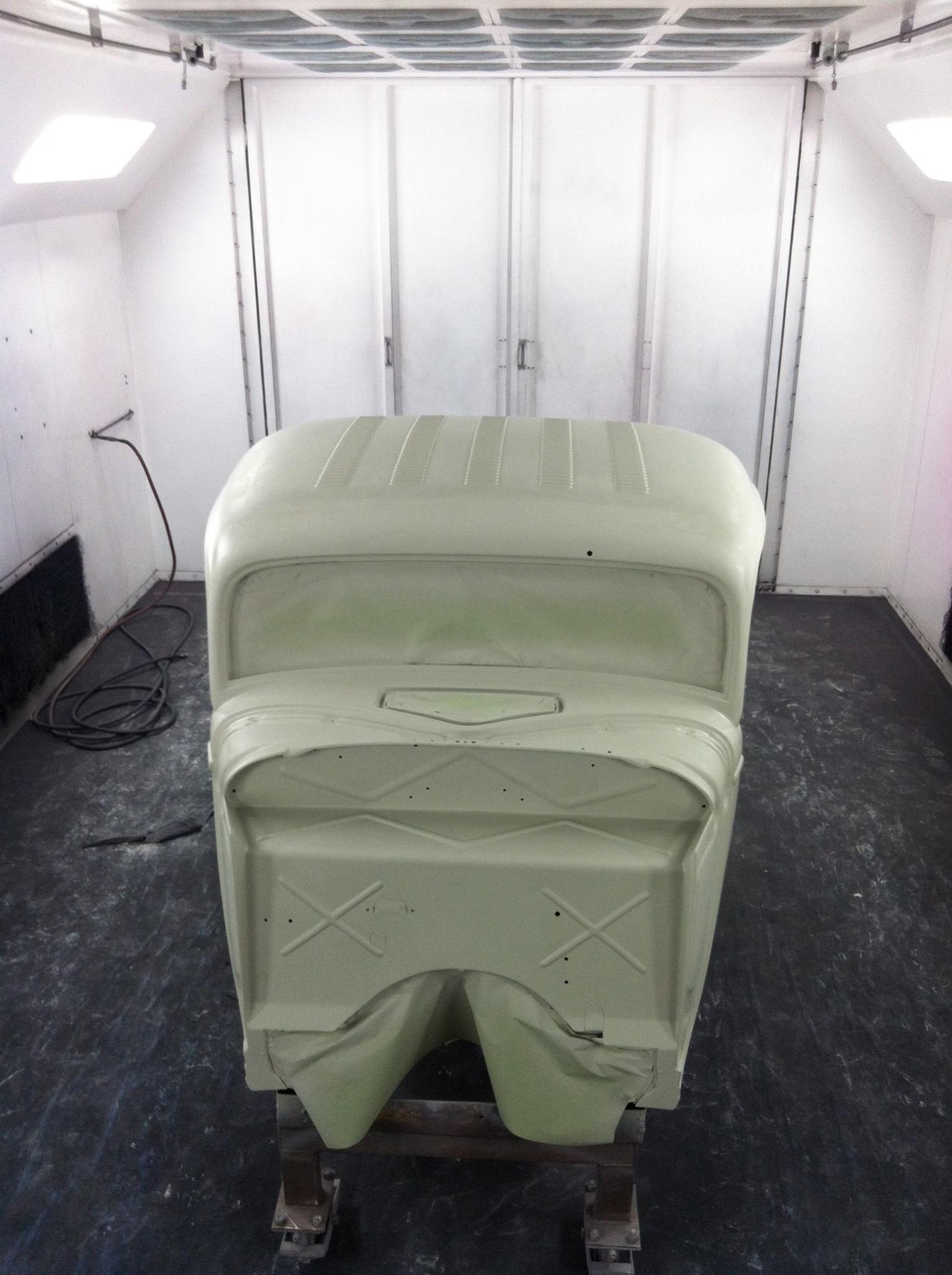

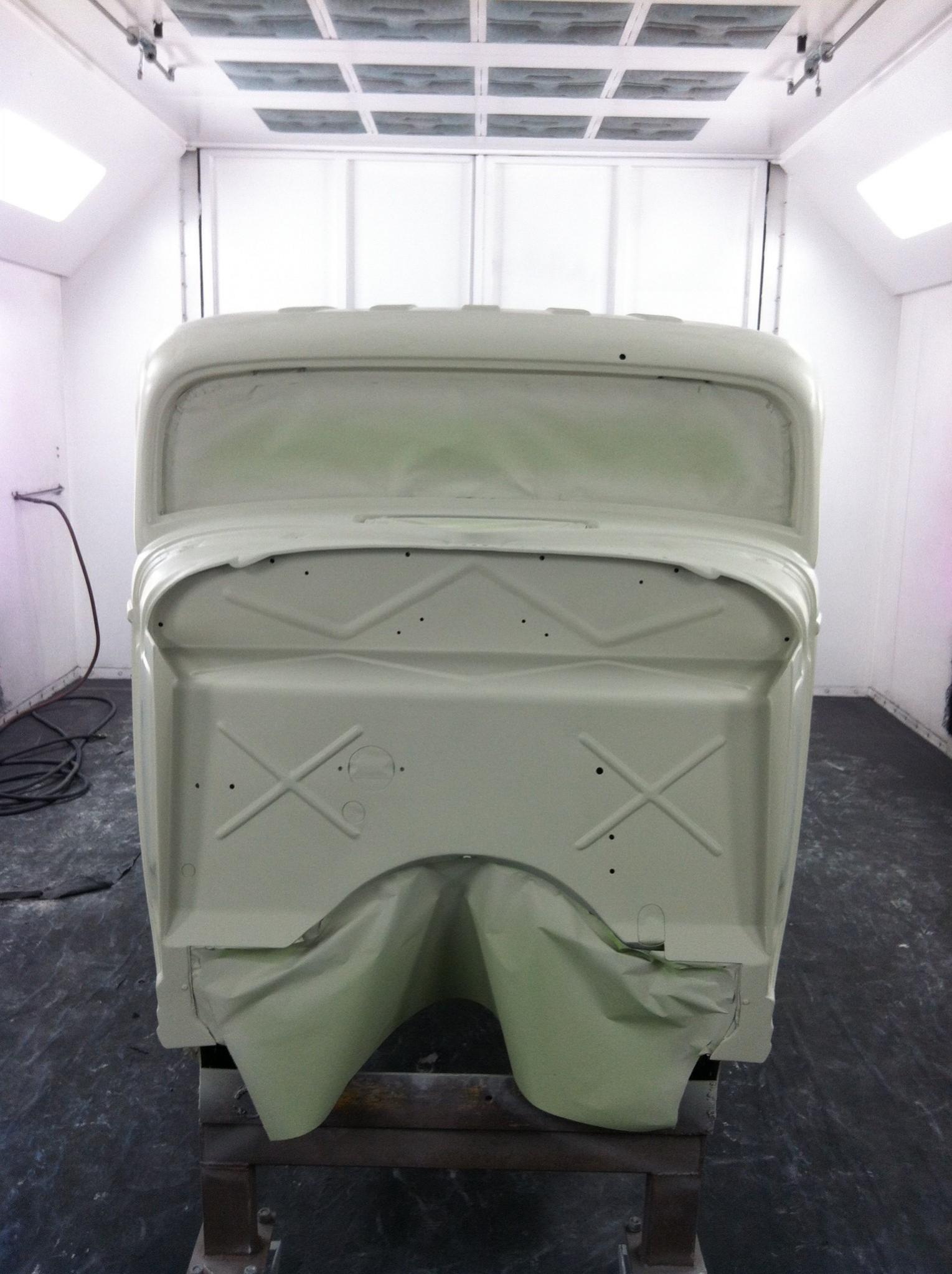

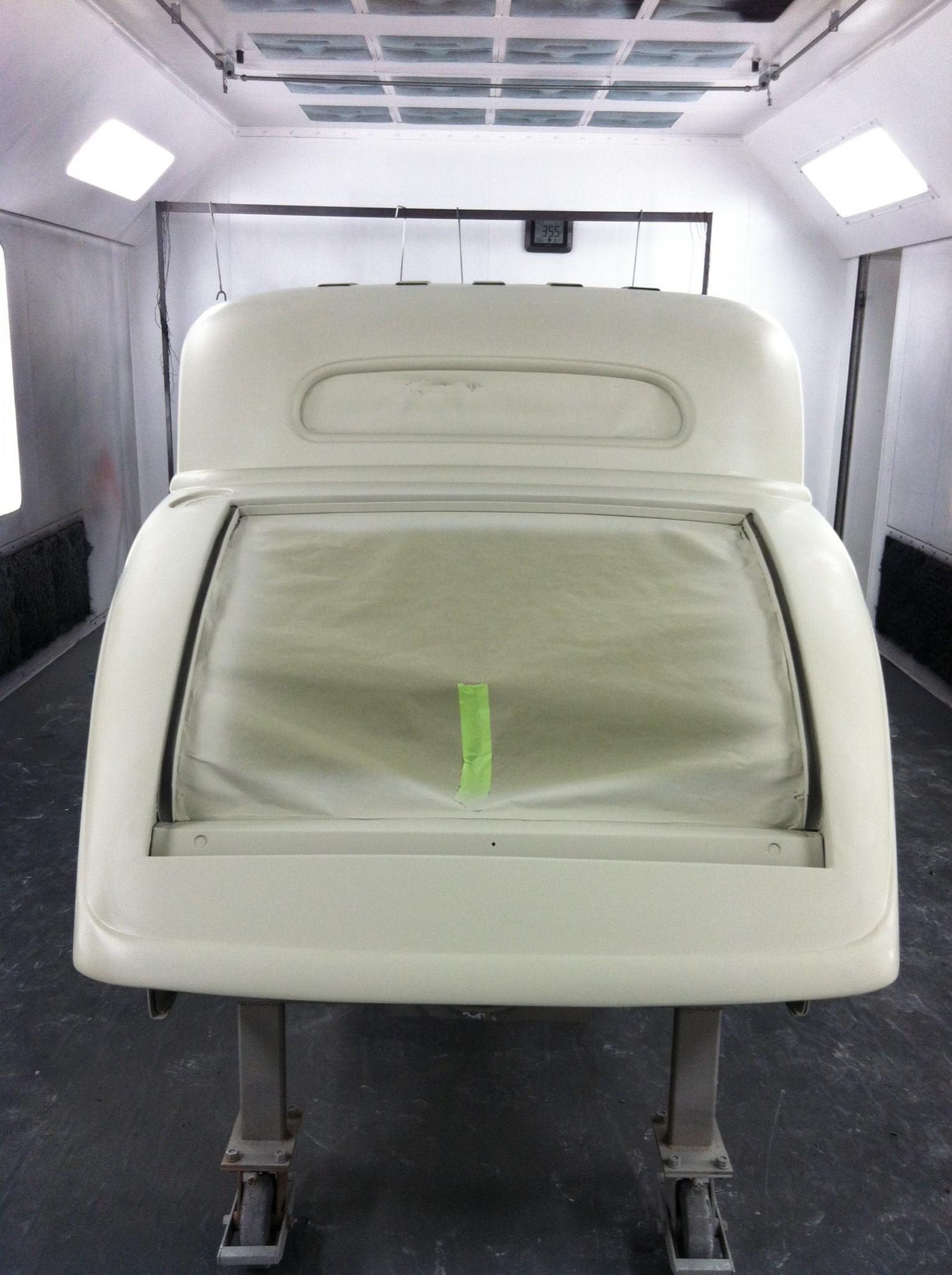

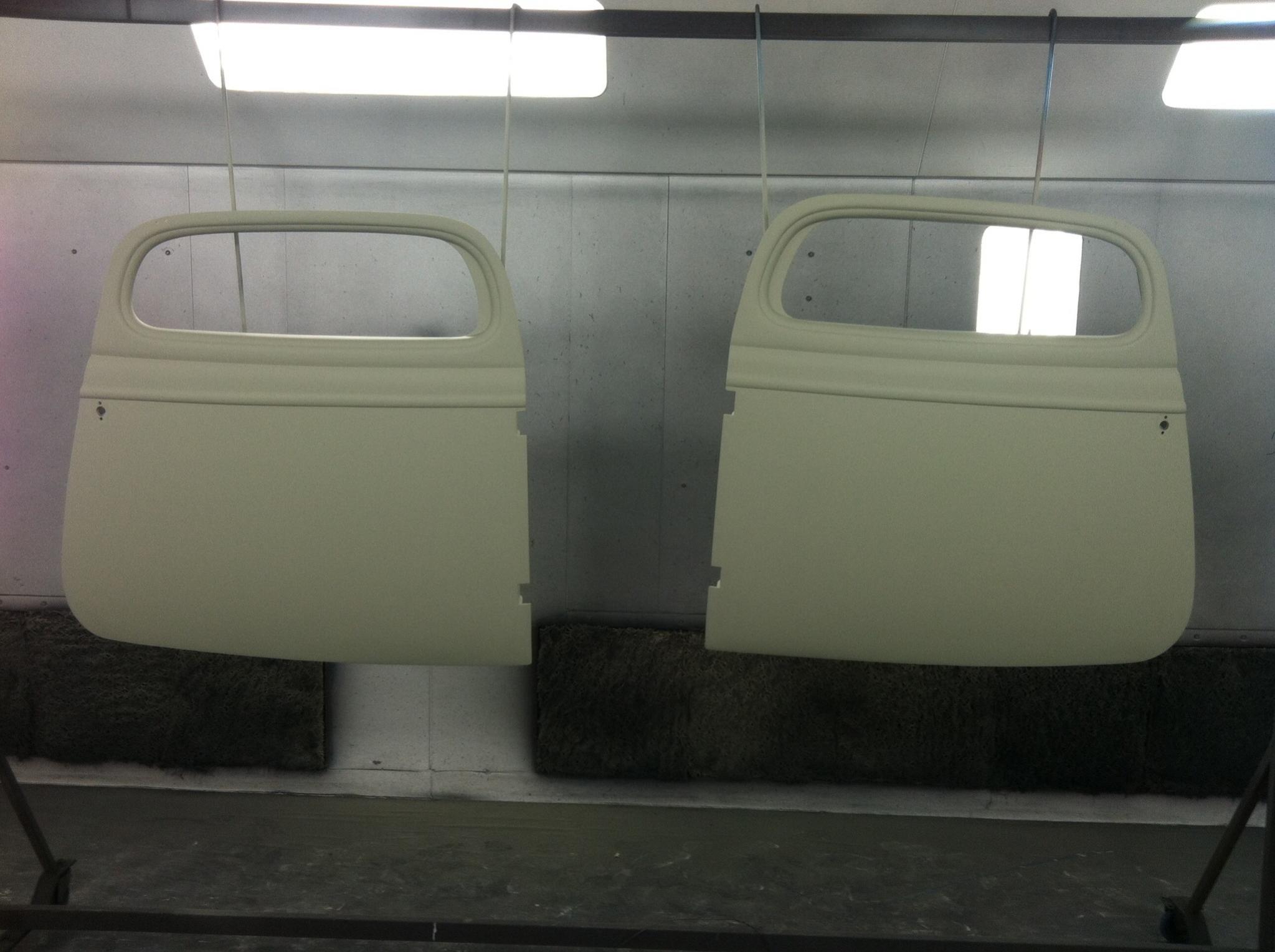

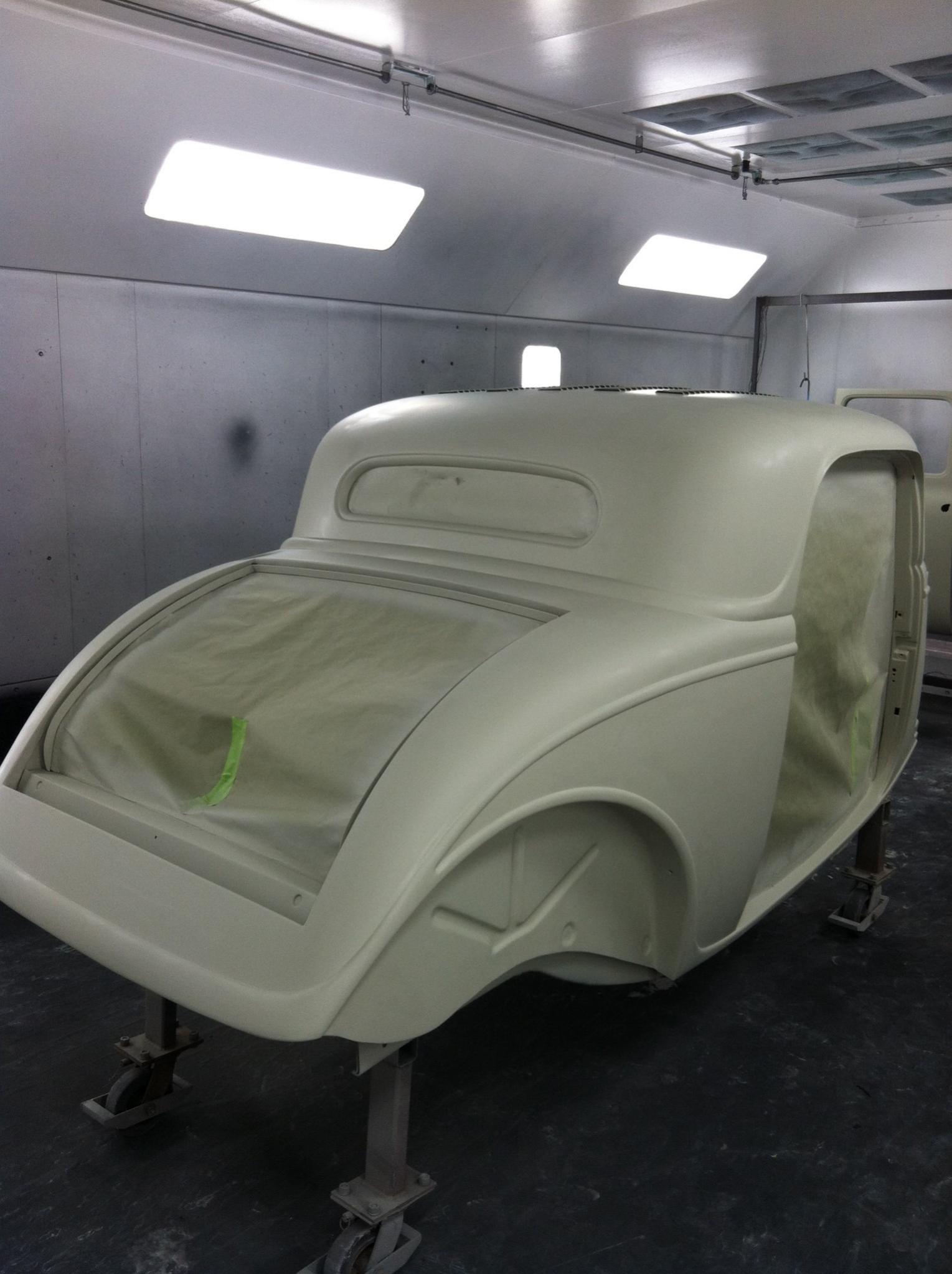

    End of the day paint booth " primer" pictures from Josh....

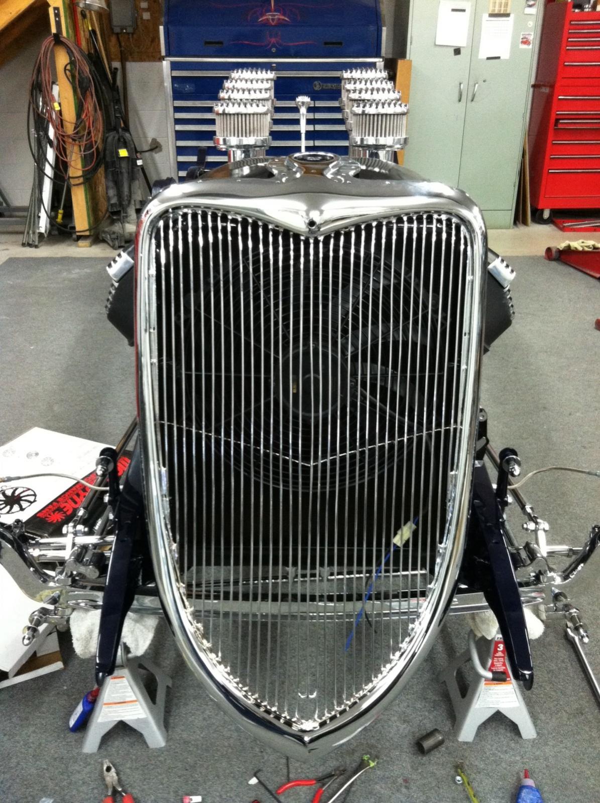

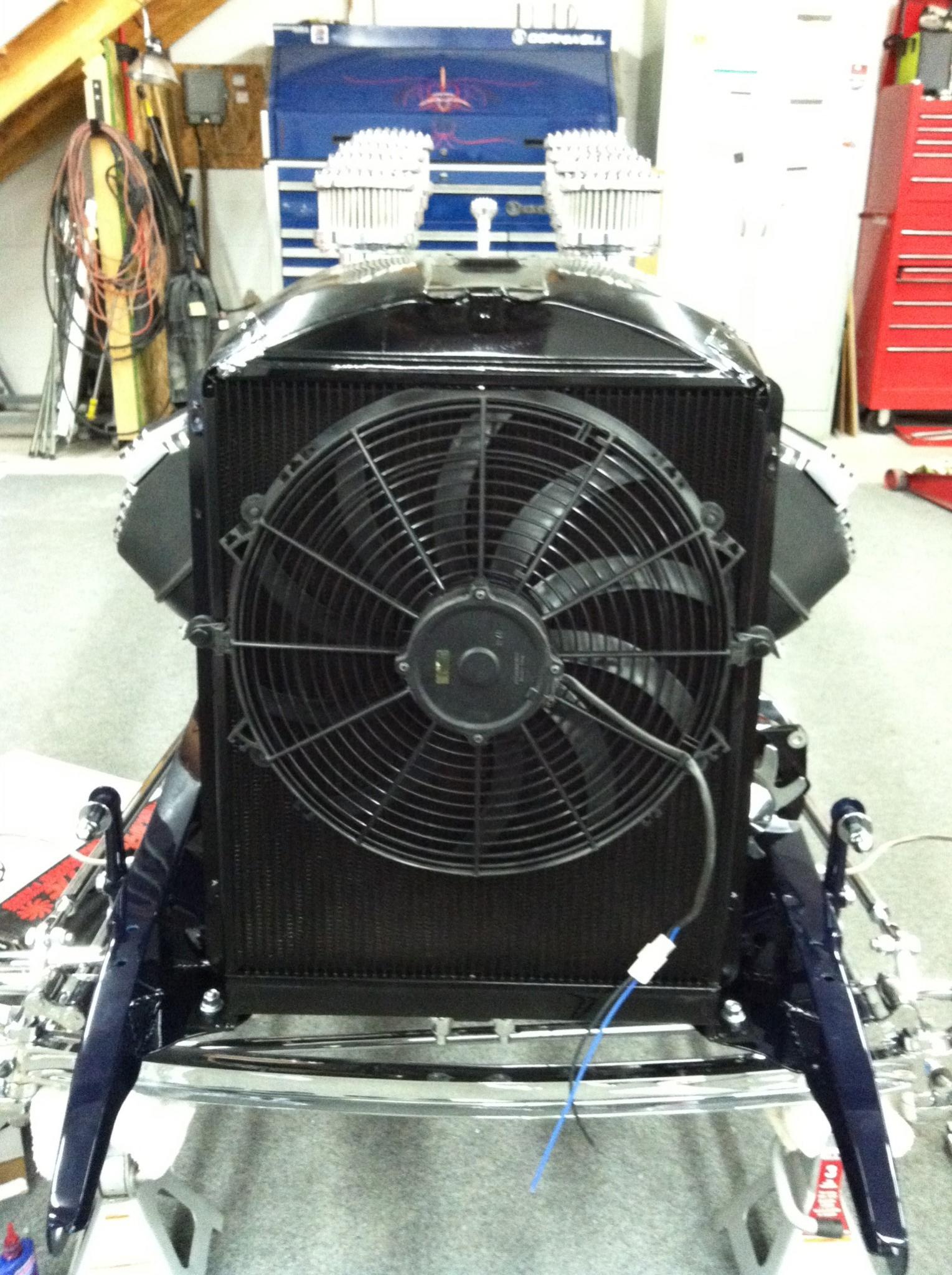

    Now that the temporary detour ( sorting out the brake direction) is completed for the time being, Josh has been able to get back to the business of getting the radiator/grill ***embled.
    We DELIBERATELY went over board on moving air. Please note the large stainless fan driven by the water pump pulley and the auxillary electric pusher that will be available by manual switch rather than temp sensor. It's hanging on the front of the alternator in the photo but will be thrown in the trash. I should be able to drive without over heating by just using the mechanical fan. If stuck in cruise traffic, I wanted the option to flip on additional air flow to insure confidence in reliability. IE: NO OVER HEATING.
    The radiator was shortened 1.5 inches to maintain a straight belt line and the bottom of the grill was kicked out to accommodate.
    It's starting to come together. smile.

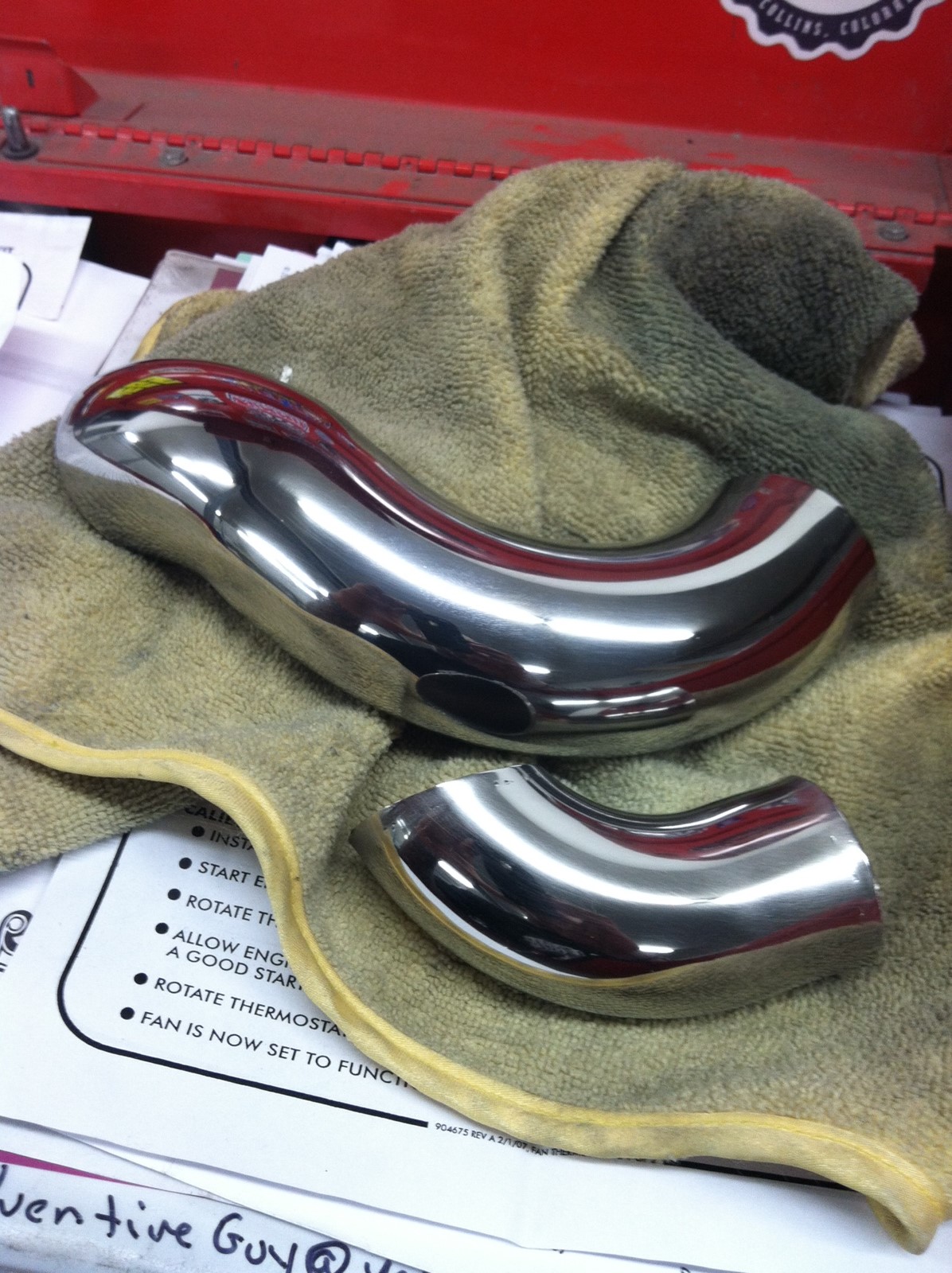

  4. geoking
    Joined: Nov 12, 2008
    Posts: 717
    geoking
    Now that the radiator is mounted, Josh has polished the stainless steel water pipes that he had previously fabricated to use along with short hose sections to connect the upper and lower water pump to the upper and lower radiator.
    Some of you may remember that way back in the engine build, the crossover was modified for using the 331 heads on the 392 block. The effort was made to insure that the thermostat housing and cover was centered for a short 45 degree into the radiator inlet.
    Now, after all these months later, the fussiness will pay off in CLEAN detail.

  5. alchemy
    Joined: Sep 27, 2002
    Posts: 22,748
    alchemy
    I don't use one, but have read here that an electric fan will block airflow when not turned on. Are you concerned that the electric fan will do this, since it's right out front?
  6. geoking
    Posts: 717
    geoking
    Alchemy,
    I have seen it go both ways. Lot's of variables including fan size on both sides as well as having a good fan shroud that is properly installed.
    To answer your question, Sure, I have concerns. That being said, it isn't a big deal to work out during intial driving and if it becomes an issue, it will be a simple fix. I like the optional e-fan usage and it is working very nicely on Pete Stringers 34.
    I'll report back results at the beginning of January.
    Wish me luck!
    George
  7. daddio211
    Joined: Aug 26, 2008
    Posts: 6,012
    daddio211
    That's always been my understanding as well, that pusher fans block airflow while at speed (driving).
    My '27 T Roadster build: http://www.jalopyjournal.com/forum/showthread.php?t= 734383

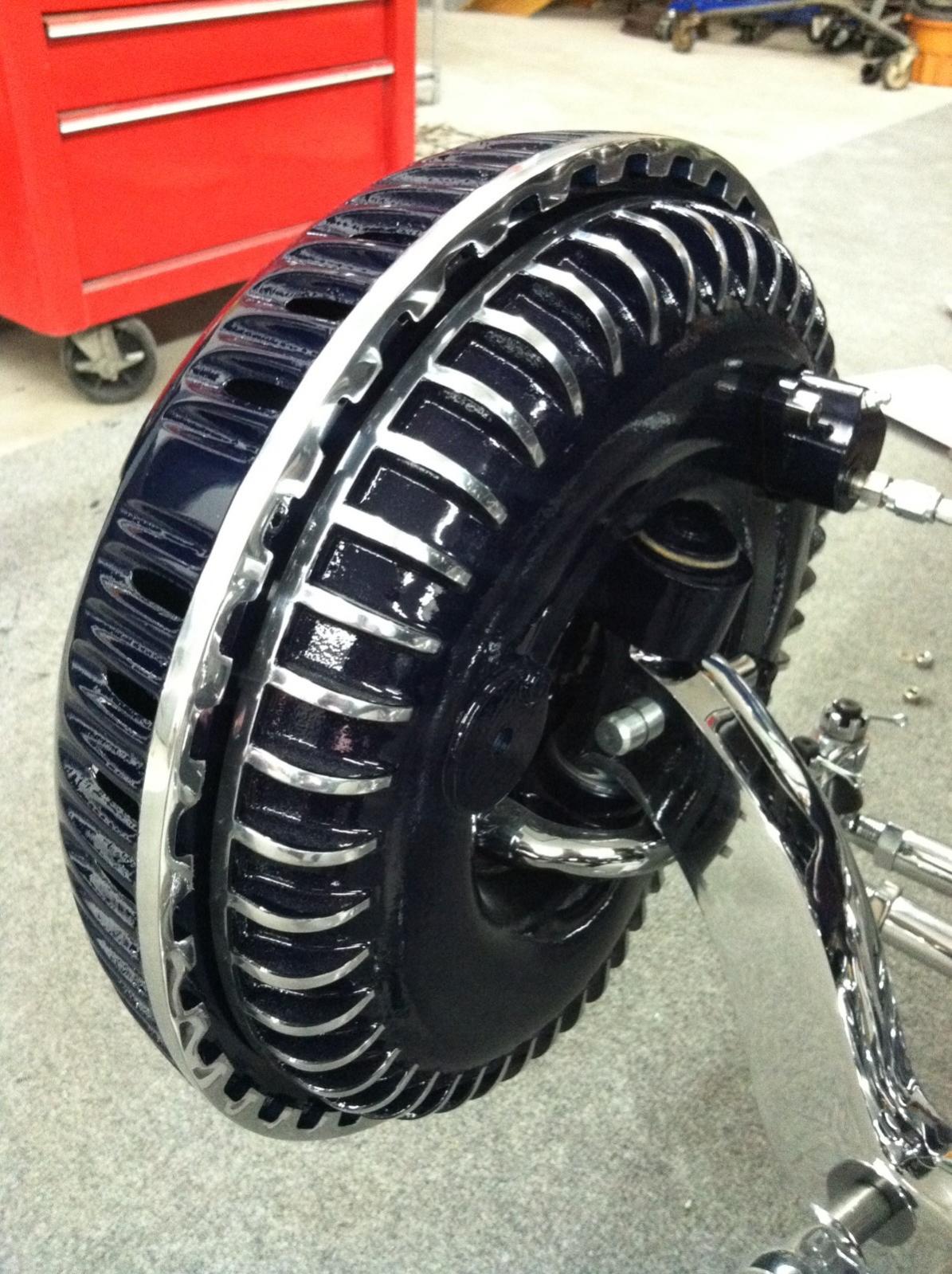

    Josh sent me the attached picture of the Kinmont "style" brake cover this afternoon.
    He has polished the lip and edge to match the backing plate effort. The cover will be shot in matching body color. "Pozzi Blue".
    I also heard from Bill Chapman this afternoon and the red line tire set shipped today. I am looking forward to receipt and mounting.

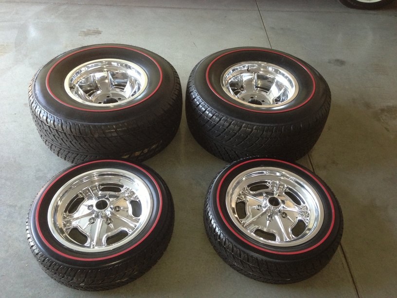

  11. geoking
    Posts: 717
    geoking
    Red Line tires arrived last night and I had them mounted today. See what you think? Smile.

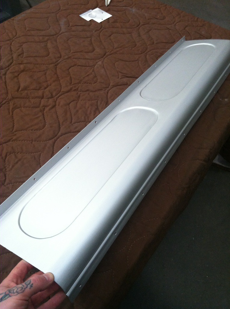

    Josh dropped an interior panel at the hard coating shop to see how a panel would look before we have them all clear "hard anodized". The caustic dip tank that etches the aluminum as part of the preparation process, made the panel a little more grey in color. It also resulted in a huge improvement in the uniformity of the finish. The best part is that the panels will now be able to be handled without leaving finger prints or turning black. A simple damp wipe for dusting and good as new.
    Now for all the rest... 2 full tanks worth and then carefully ***emble into the coupe.

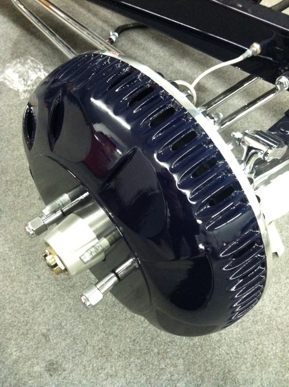

    Here's an update on the front brake cover detailed finish.
    Another small step. The drive shaft has also been painted and will be installed today.

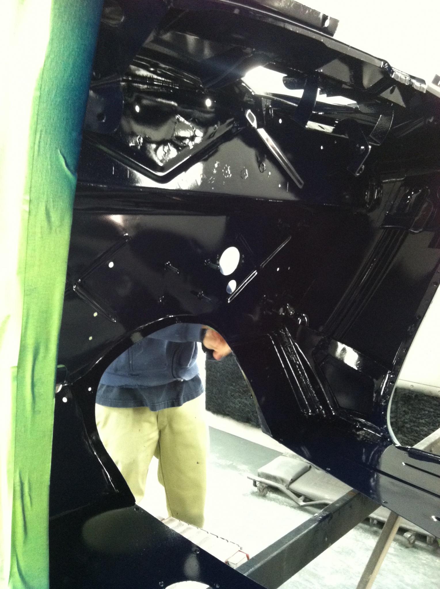

    If you have any interest in how the interior paint looks?....
    HERE YOU GO!
    While it will all be covered up with sound proofing ,panels , and carpet , it is still nice to see it "clean" and know that we are getting good coverage for rust prevention. I asked Dustin how many cars he paints to this level annually and he said he averages about 7.
    He really pays close attention to detail and I can't say thank you enough.

    Maybe I got bad tastes but I just don't get the redlines. On the low profile fronts they appear way too big. Might look better on the car. Don't get me wrong, I simply love your car and if you can put whatever tires you want on it. Maybe I just never really liked red lines at all. I can't wait to see it all done. Very bad***.
  27. geoking
    Posts: 717
    geoking
    Todztoyz,
    You never know if something is going to work...OR NOT, until you try it. If you look at the renderings below, plain goes to plain PLUS a belt line red stripe, then it's all in with red line tires and a flame job. I have two sets of tires and can swap them out if the red lines prove too much. I don't take any offense to your speaking out against the red lines. Your post actually made me smile.
    One of our build team members is dying to pin stripe each and every louver which I am dead set against. Another wants to just let the pin striper have an open canvas and do what ever it is that comes to mind? YIKES....
    I am currently in the mode of less is more and trying to balance a little vs plain Jane.
    I too, can not wait to see it done.
