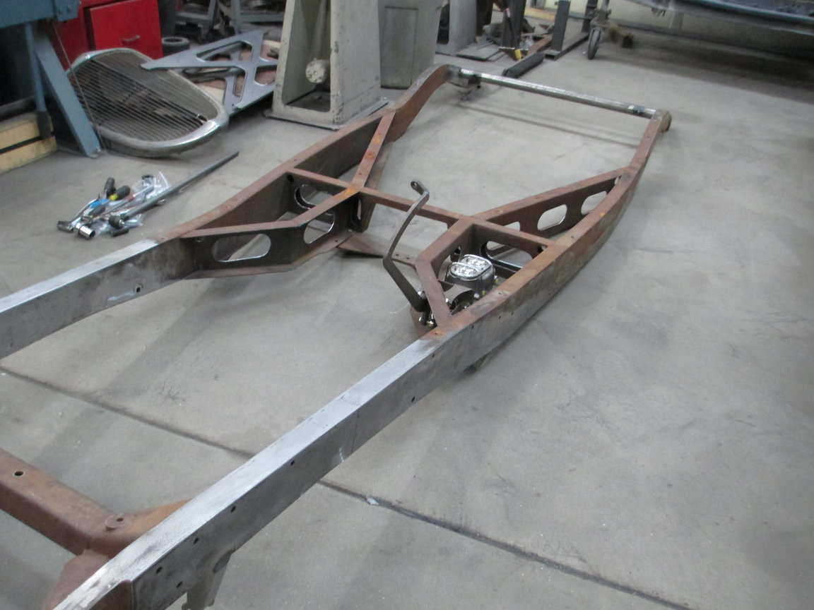

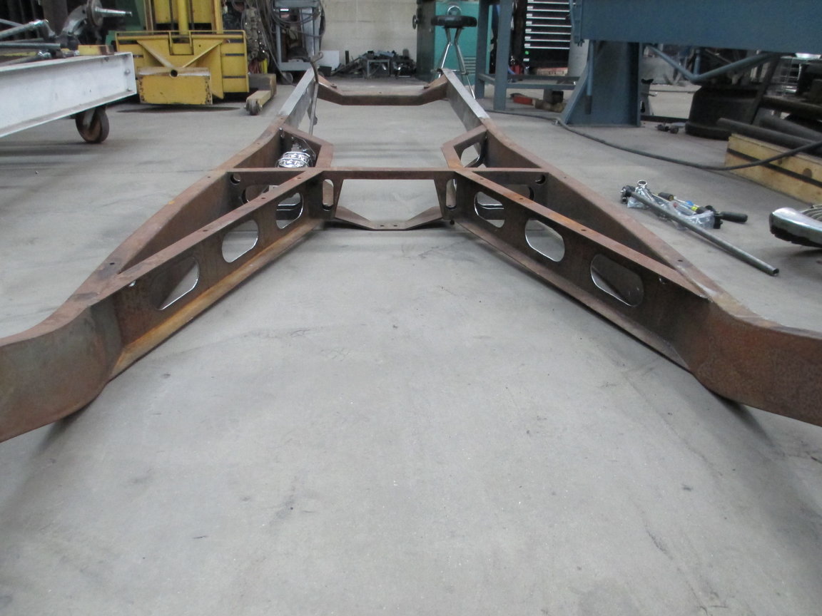

    This frame was so overbuilt, that it looked industrial. Rex and I discussed replacing the x member with a tube section, but decided it was a waste of both time and money. IE: Add some big oval holes and it will be just fine. It was still a pretty big job to lay them out and then do the "demo" work on all of the ovals. None the less, they are complete and the master cylinder added as well. Thank you Rex. Now time to "c" notch the rear axle.

    the front frame horns are now a 1 1/2" higher than stock the frame area in the front has been straightened out and the sharp kink by the a pillar in the frame has been re worked here is a pic of a stock frame.

    Nice build, that is going to have a nice stance. Windowing the X member really helps the function and the look.

    Looks great and I like the frame modifications, especially the holes in the x member.

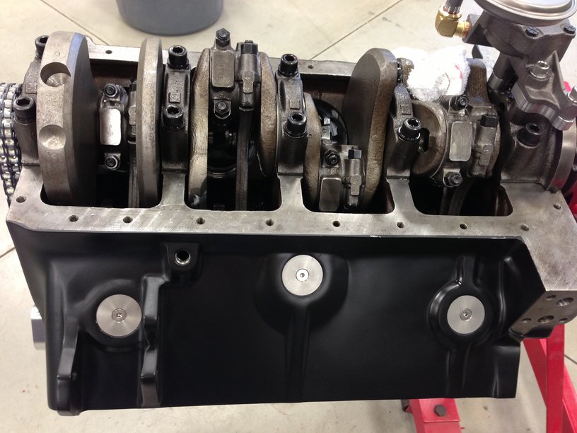

    Spent the afternoon playing in the shop. Chased each thread with a tap for the 20 each ARP studs before applying anti-seize and running them in with an Allen head on a ratchet. I removed the sand core plugs ( freeze plugs) lubricated the o-rings with silicone and put them back in. I have ordered the last plug that goes in the block....an 1/8" pipe plus 2 each drain bab****s for each side of the block. (from McMaster-Carr ) and will add them upon receipt. There isn't much else I can do on the engine until the heads show up from R and R speed shop. I did get my sample ram tube from Hilborn this week and will need to use slip adapters to allow a straight tube for my filters instead of the bolt on version.
    While I was in the wrench mode, I removed each bolt from the oil pump and added lock-***e before re installing!

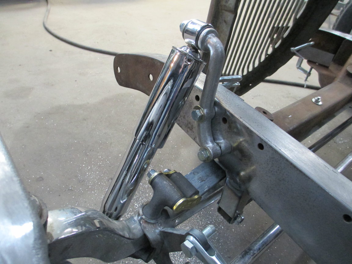

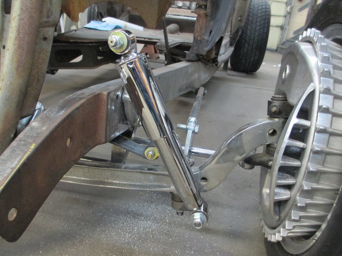

    A little progress this week...please find the below pictures of the front shock mounts added by Custom Auto's "Fred" and the Deck lid separated inner / outer skins for the up coming louver lay out and punching by Rex. A few items were ordered: A roof insert from Waldens,...a Hemi to 700R4 ****** adapter from Hot Heads + a few odds and ends. I met with Neal at Parker Transmission and we worked on the details for the build of the 700R4. Most had to do with how the coupe will be driven to match up with the build specs for HP and Torque with is anticipated to be 375 HP and 450 ft lbs. Fred got the great task of removing tar from sheet metal as well. The progress was slow as the media blaster was closed this week and the engine mount with ****** cross member could not be done without the adapter we ordered after the need arose. oops. I asked Dan Shady if he has a model "A" head light bar to help with the build as he might have one? I need a bad one for Rex to cut off the headlight mounts to weld to the shock mounts at the lower radiator area. We have decided on 34 commercial lights . LOW and WIDE. smile.
    regards,
    george

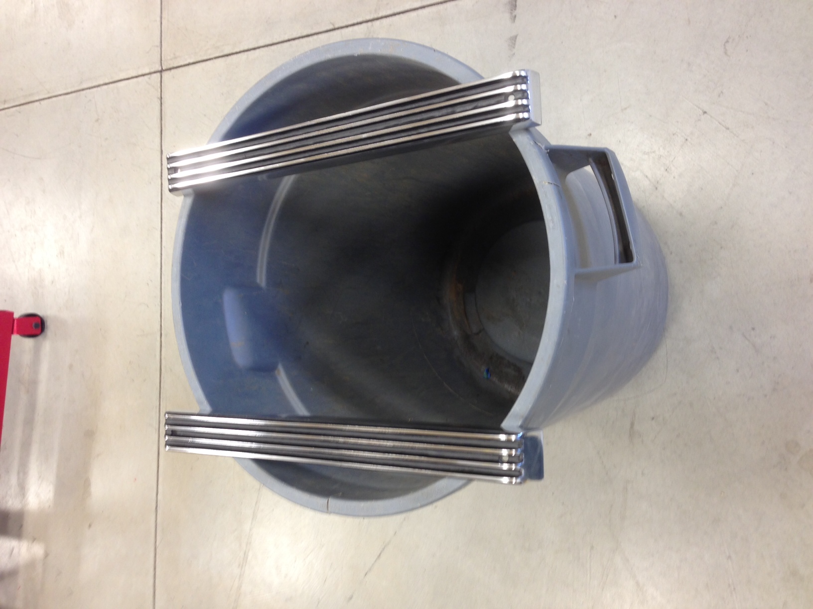

    Nothing happening at Custom Auto this week as the next step is to media blast the body. This will be done at Blast Tech in Denver. It looks like a full load will be on its way tomorrow. fingers crossed!

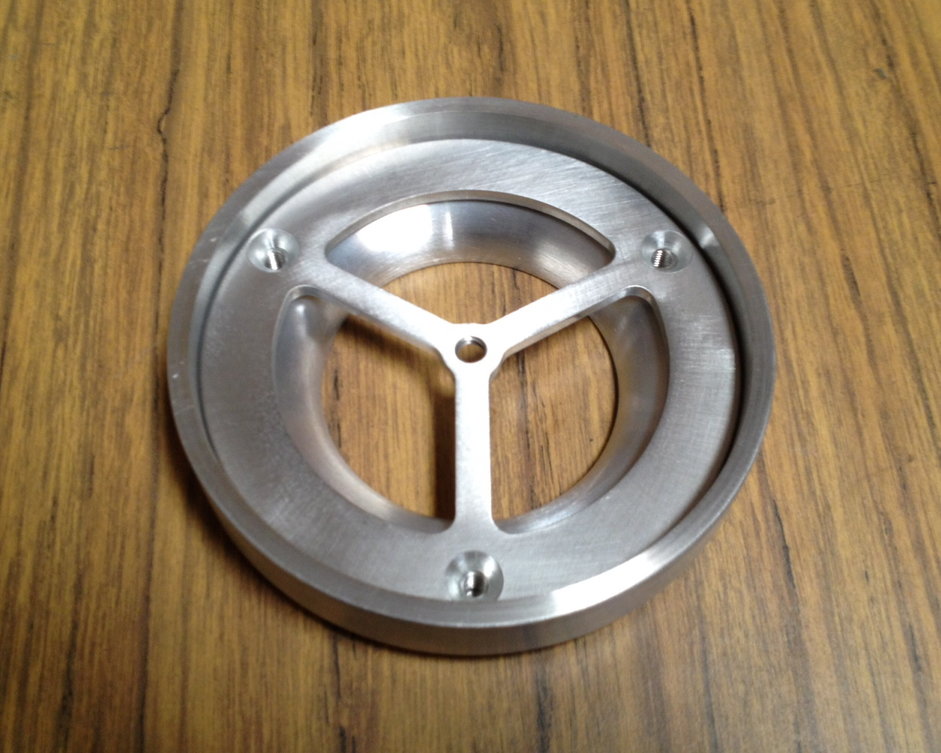

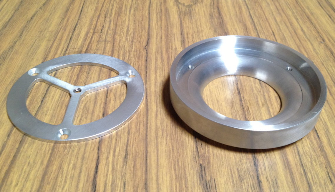

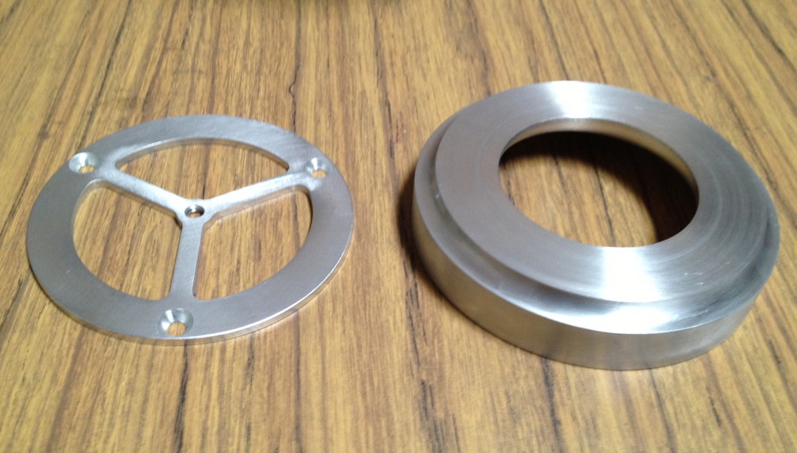

    I would like to share the FIRST PROTOTYPE for my filter housing bases from Bill Lathrop at OTB Gear. Bill has been absolutely awesome in helping me get his induction filter bases modified to fit my Hilborn Ram Tube stacks. Actually not modified, but custom machined from scratch!
    The picture of the stack below has a 4 bolt 90 degree flange at the bottom . This is what normally goes on the early Hemi set up from Hilborn. This will be replaced with a "slip on tube" ( 2 3/16 diameter) with slip on adapters that bolt on the injector/ intake casting. Using this set up will allow the OTB custom base shown below to slip up the tube. You can see that the flare will nest into the base and be captured by the tri-star clamp with 3 screws. The center threaded hole will house the threaded rod to add the finned aluminum cap which will house/ hold or clamp the filter element. Bill will be sending this new set up to me (a set of eight )over the next few weeks. I will update a completed stack picture at that time. This is way cool as no one else has these...YET! smile. I can not say enough kind words about Bill and his marvelous spirit.
    regards,

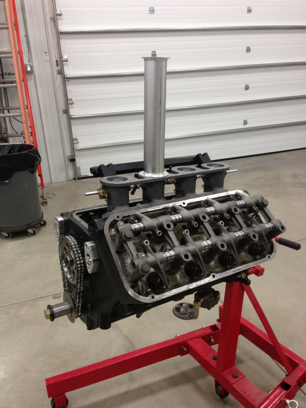

    No new pictures to share today....but a really good story about "Edris" @ Hilborn Fuel Injection. My Early Hemi EFI set up arrived with 8 inch steel ram tubes. They were not to be shipped as I did not want them. I had requested 12 inch aluminum slip in stacks to enable the custom bases from Bill at OTB Gear to be utilized. The Hilborn Rep advised me that the tubes I requested are no longer available. I tried a few stocking distributors for existing stock and got no where. Mike ( Alkydigger) suggested I call Hilborn to speak with Edris. Ok, will do, thanks. I explained to Edris why I needed the aluminum slip ins' and that I could deviate from the original tube specification to allow a subs***ute as the extra horse power or maybe even a loss of horse power wasn't important to me. She took down my contact information and promised to try to resolve the issue. WOW is all I can say. Edris phoned the aluminum tubing mill and worked the issue to find a slightly thicker wall with the same 2.250 O.D. that was needed for the pinch clamps. The original spec. was for an I.D. of 2.187 and now my tubes will have an I.D. of 2.150. Can you say who cares? Yippie...It will not make a bit of difference accept to make the ram tubes a little more robust for my application. Thank you to Hilborn for having a can do employee that made the effort to solve a customers request. I called Edris to thank her profusely this afternoon and let her know how appreciative I am for her wonderful at***ude. She shared with me that they would add it back to their offering and that they believed there would be no impact to performance. Maybe a little better on the top end.
    I have to admit I have always wanted an 8 stack for its cool looks and that great customer service has made this an excellent experience.

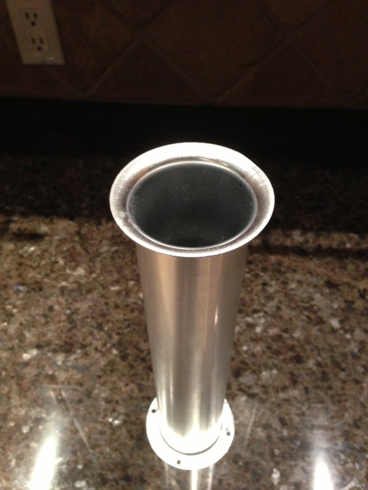

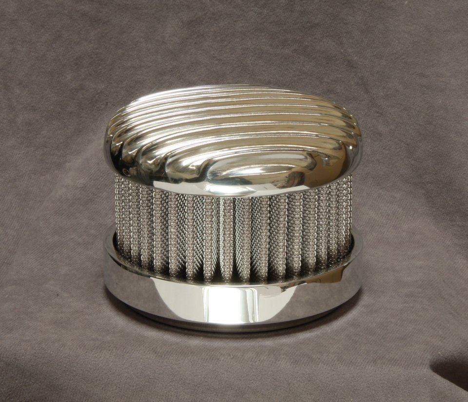

    I am so jazzed that OTB's Bill Latham sent the below picture tonight. He was able to get one of the prototypes polished and put together. All we need now is a set of tubes from Edris at Hilborn. This piece of bling is so exciting because the slip on filters were just not going to do it for me.
    THANK YOU BILL!

    quote "I will update a completed stack picture at that time. This is way cool as no one else has these...YET! smile. I can not say enough kind words about Bill and his marvelous spirit.

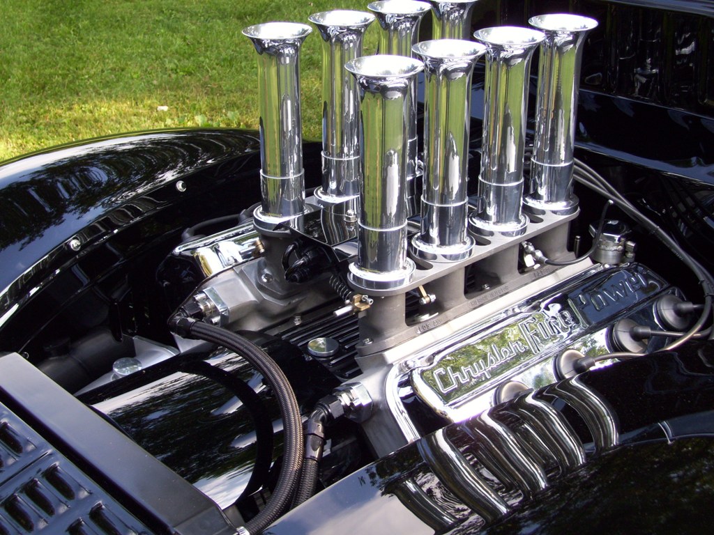

    Following your build and it is looking nice. Smith Brothers adjustable pushrods are really nice and take a little longer to adjust than adjustable rocker arms not that you have to do it very often. If you ever have to lean over fenders to adjust your valves you would want the modified rocker arms. It has been said that there is not enough meat to do the mod that you had done to your rocker arms but I have also heard of people that are running them and never had a problem.

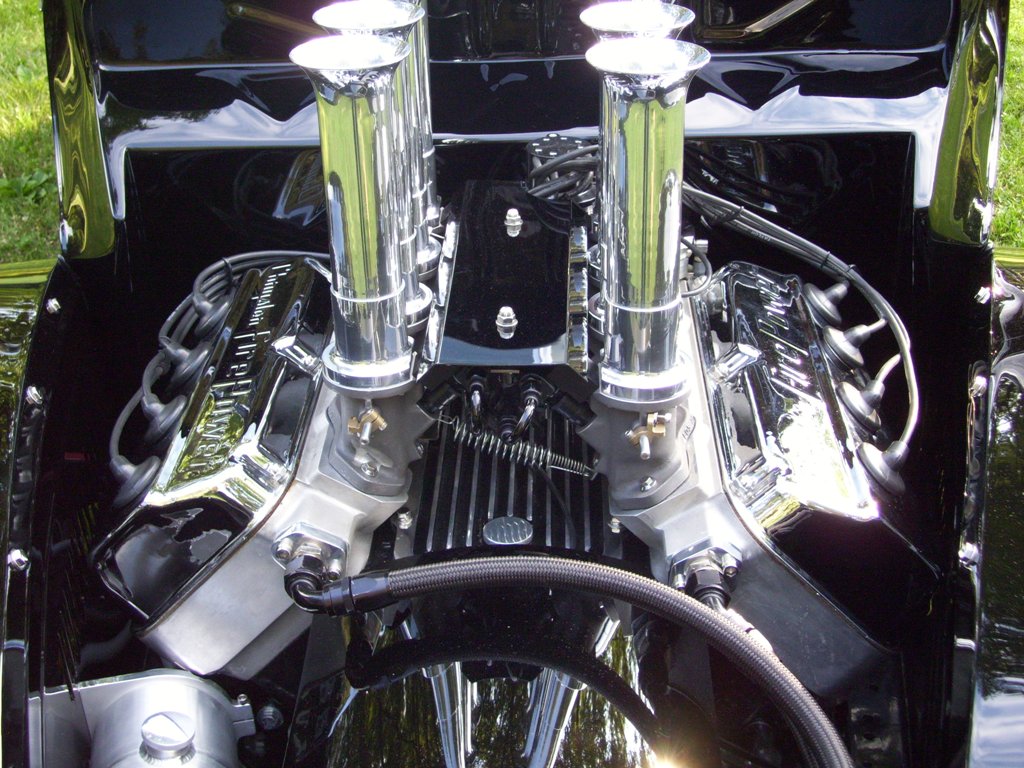

    I have attached a couple of pictures of a friend of mines 392 with the Hilborn straight up fuel injection. He did not like the stamped steel stacks either so he ordered some Kinsler stacks and had the bases made to press the stacks in.
  30. geoking
    Joined: Nov 12, 2008
    Posts: 719
    geoking
    Thank you Bobby Socks! I notice that your friend has plugged the vacuum source ports by each injector, so he must be running a manual ******. I think I will have to use the 8 hose vacuum gathering set up. The picture you posted above with the stainless plugs in the ports is very clean. sigh. I LIKE IT!
