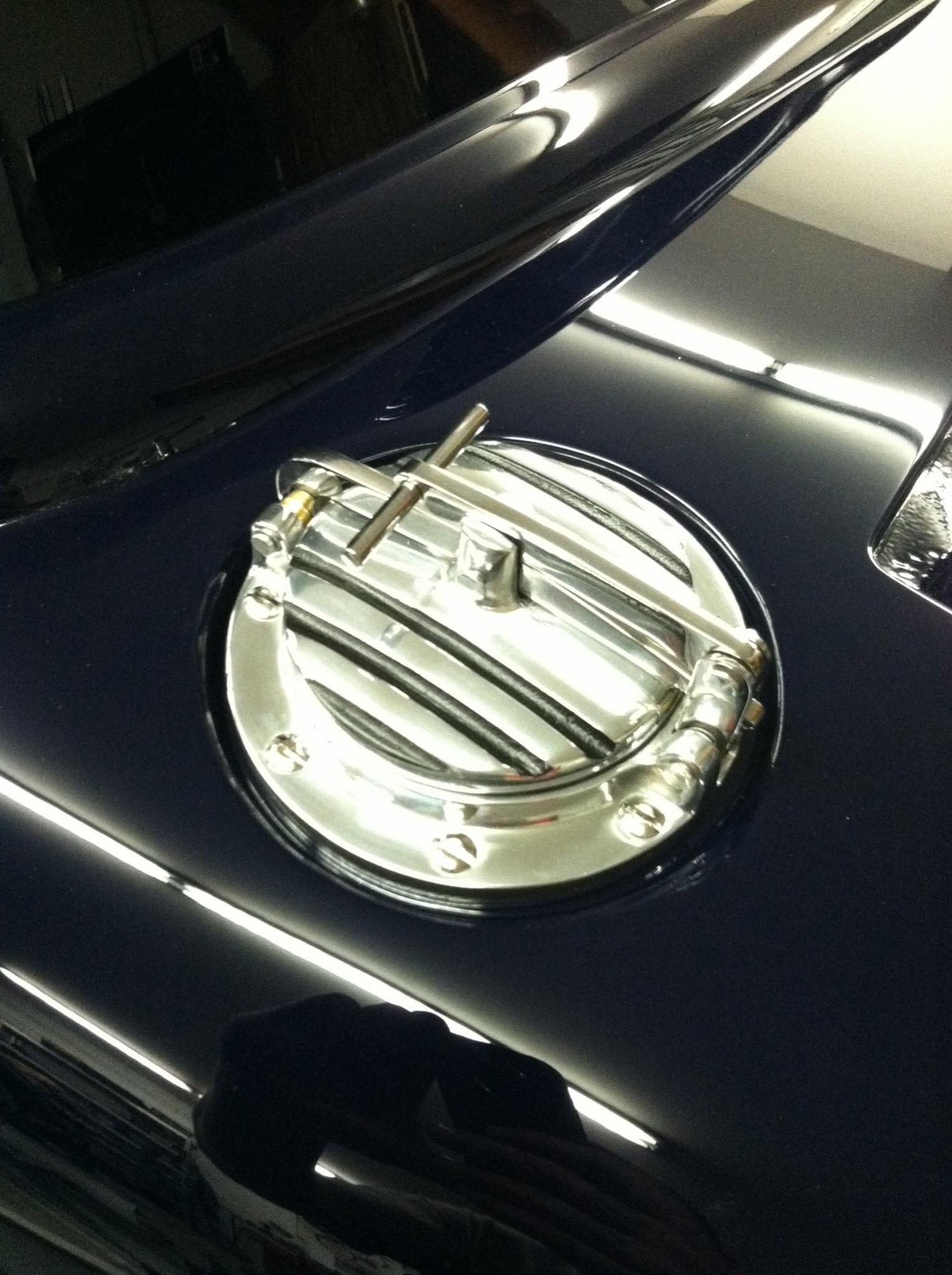

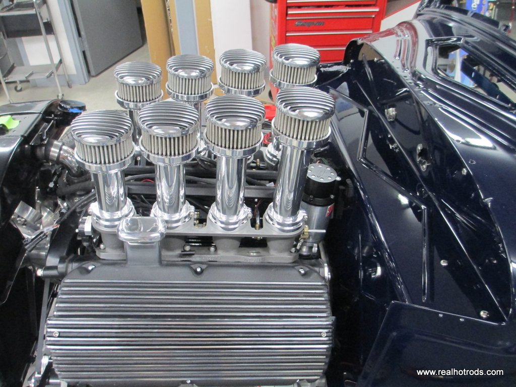

    Here's a little more progress from today. Josh has the tank in as well as the gas filler. The very large fuel pump as well as in line fuel filter are both mounted to the frame rail on the right side. They feed the fuel pressure regulator up in the engine bay. The regulator allows non used fuel to by-p***/ return back to the tank via it's own return line. This fuel flow is little different than the continuos flow set up. IE: Only a single line goes up to the fuel rails for the right and left banks.

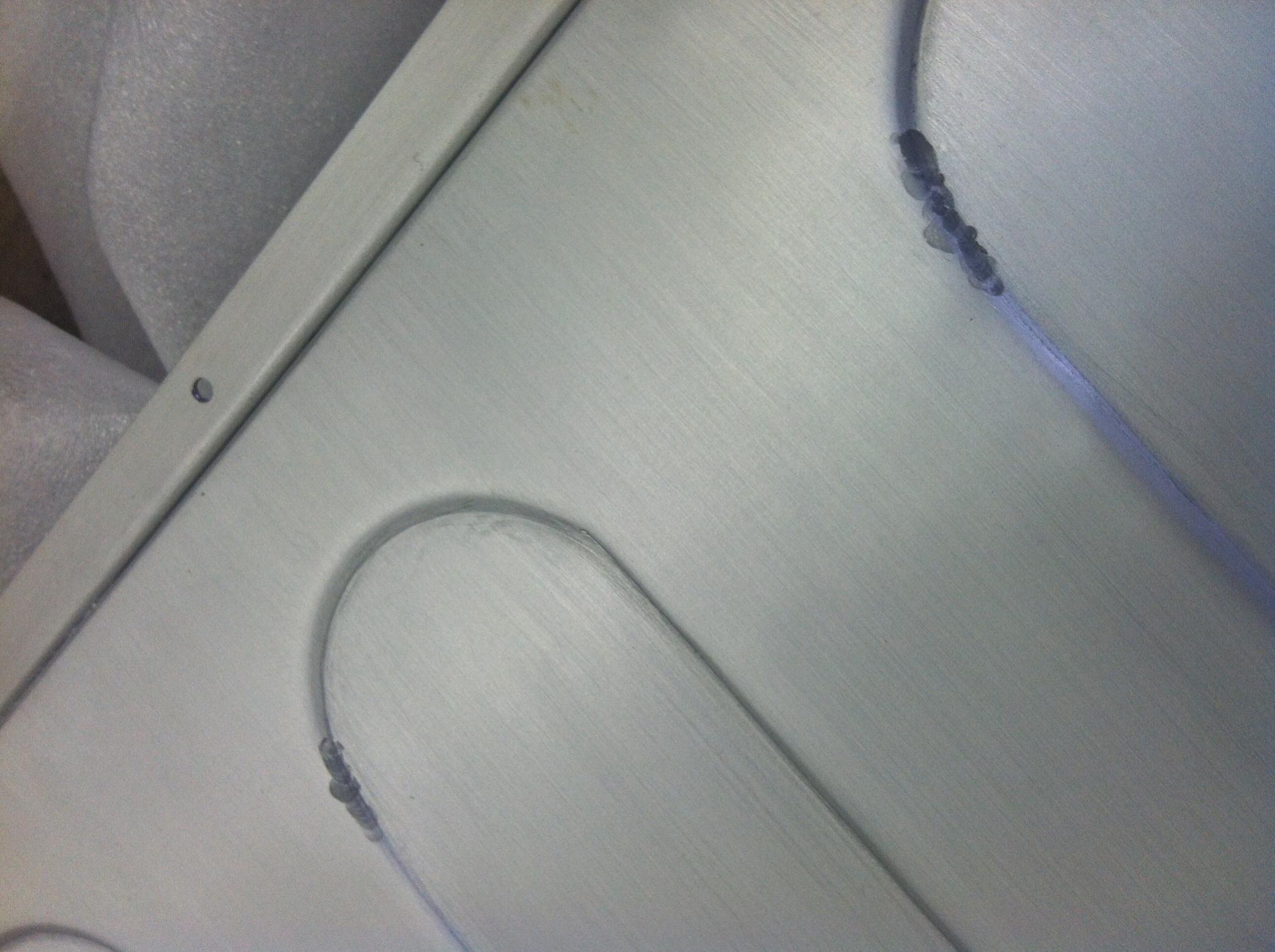

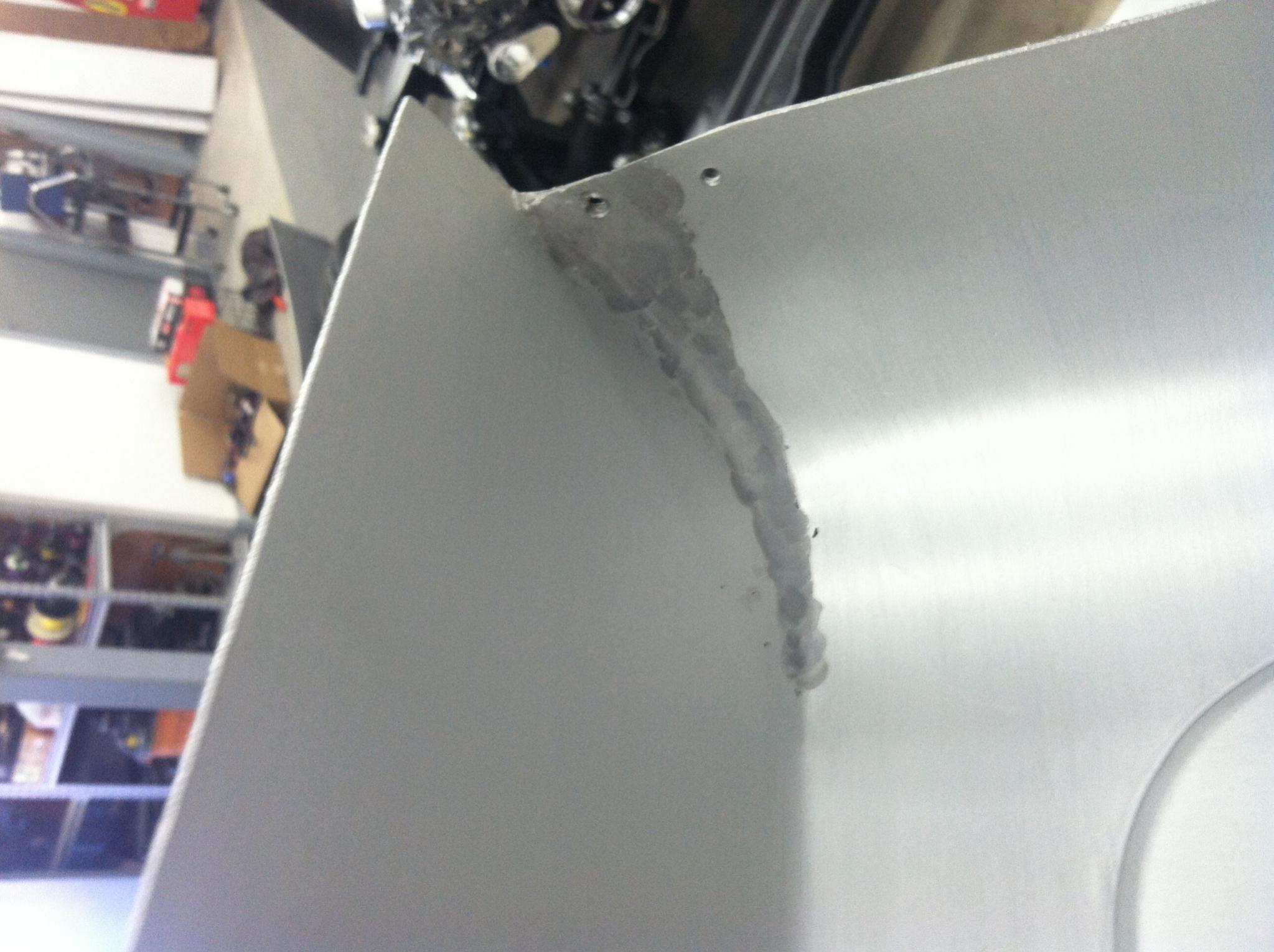

    So much for day after day of positive progress and great news. We ran into a real buzz saw, set back this morning. When Josh picked up our aluminum panels from the hard anodizing plating shop, he found a big negative surprise. Everywhere that had been welded was dark black due to the difference in material. The sample we had done early on did not have any welding, so we didn't see the issue. SIGH.
    The panels absolutely can not be used as is. See for yourself in the attached pictures. While some of them can be re-made without welding, some still require weld effort. There are a ton of hours in these and it was a bit of a heart breaker.
    We have three choices, strip them and go with sanded panels, upholster them or paint them. Is there a perfect answer? Not really. We have discussed the pro's and con's of each solution and Dustin is going to spray them out!
    Such is the real life of a build! smile. I hope you share our pain as emotion is part of this. BOTH GOOD AND BAD.

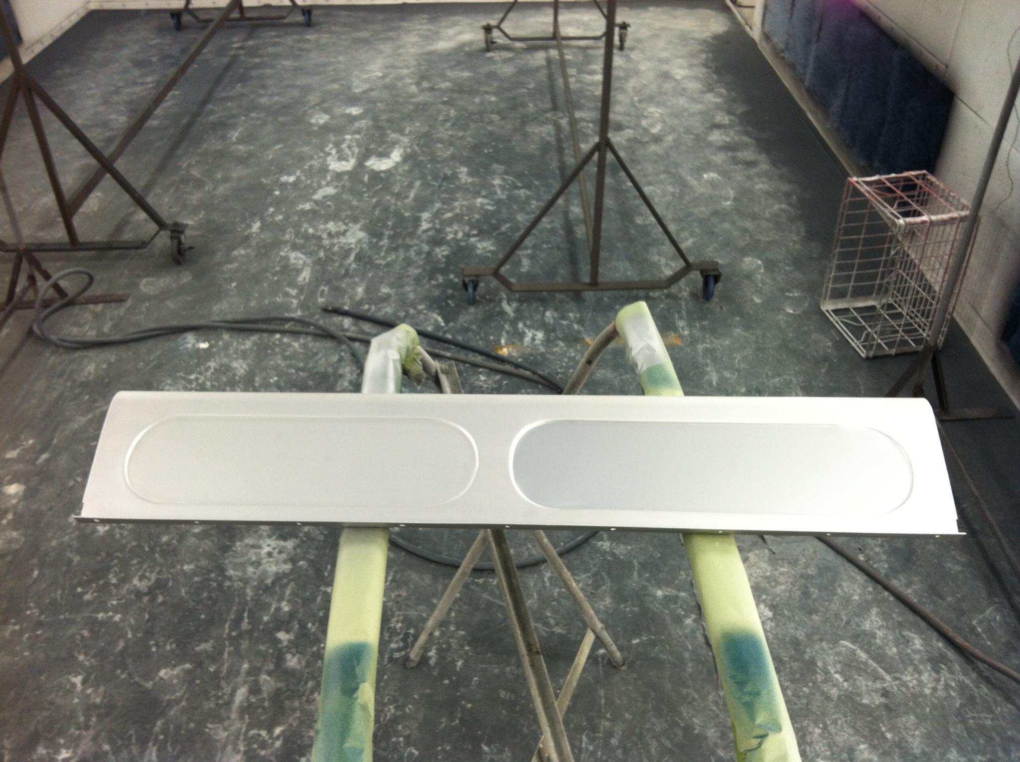

    Here is the process for tomorrow's test panel:
    Dustin will use grey Scotch Brite to prep the anodized aluminum surface before spraying a coat of sealer, base color coat of aluminum and then using a final FLAT clear coat.
    Once done, Josh will send a picture to share.
    Hopefully this will work just fine and we will be on our way.

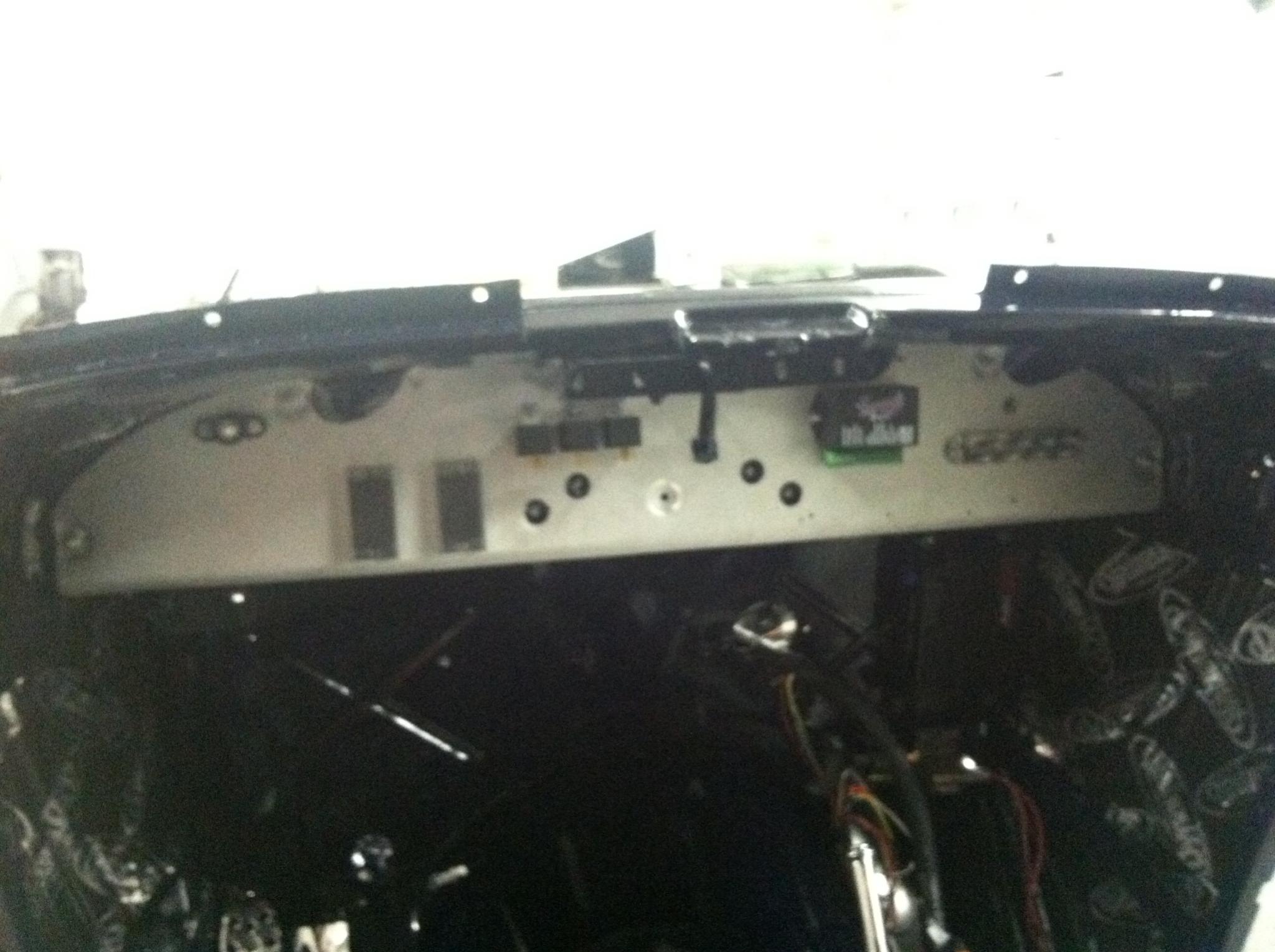

    Josh spent the rest of today mounting and routing things that have wiring needs . There is a raised panel on the interior side of the firewall that allows mounting items without showing hardware through the firewall. IE: the fuse panel, relays, ECM for the EFI ...just the normal stuff with the need for clean layout and wiring distribution. Josh still has enough to keep him busy without losing ***embly time for the interior panels paint rework.

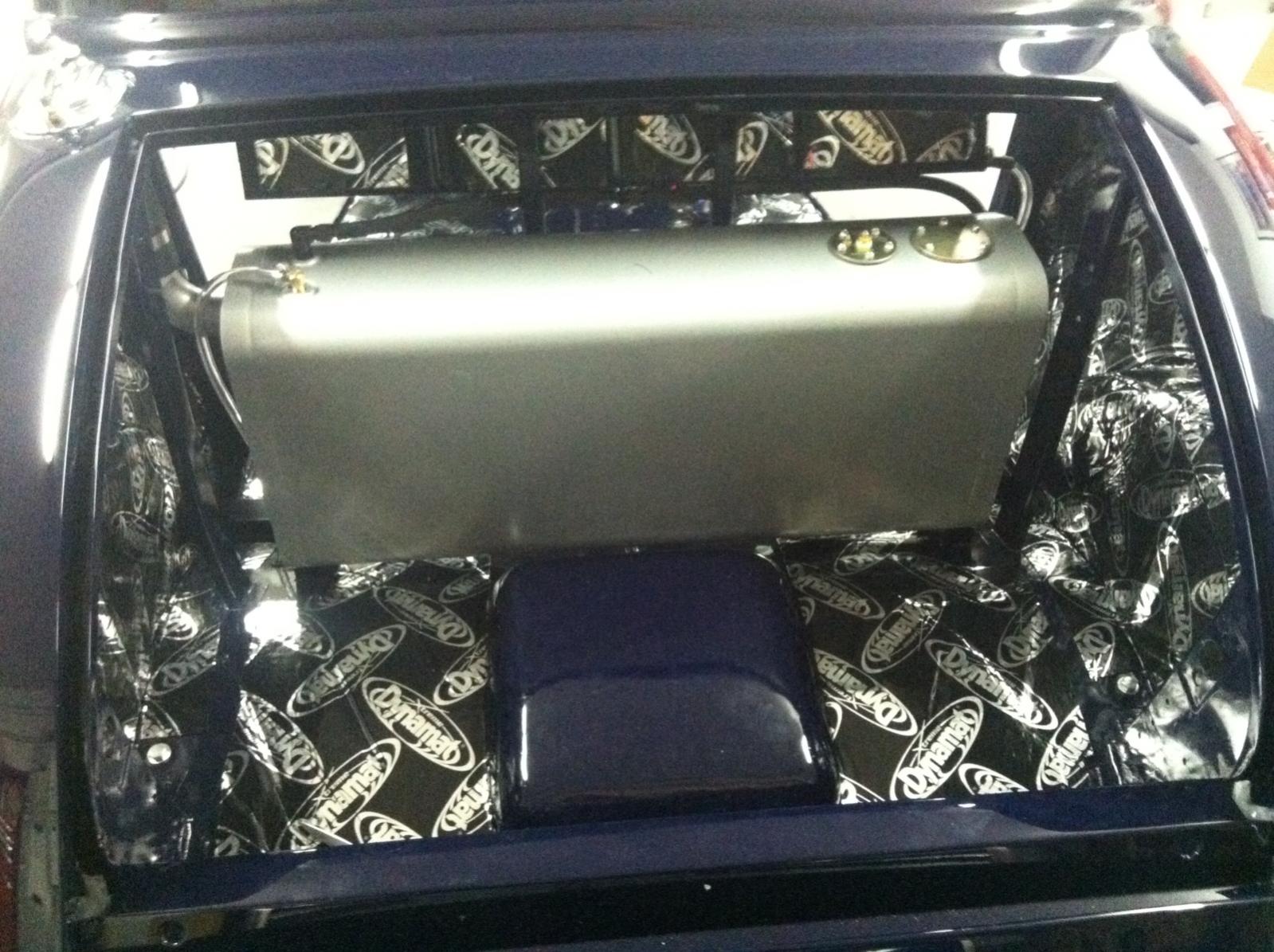

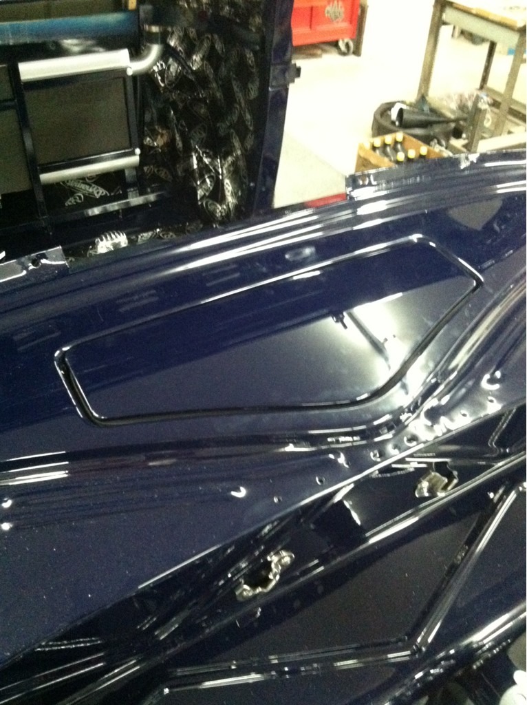

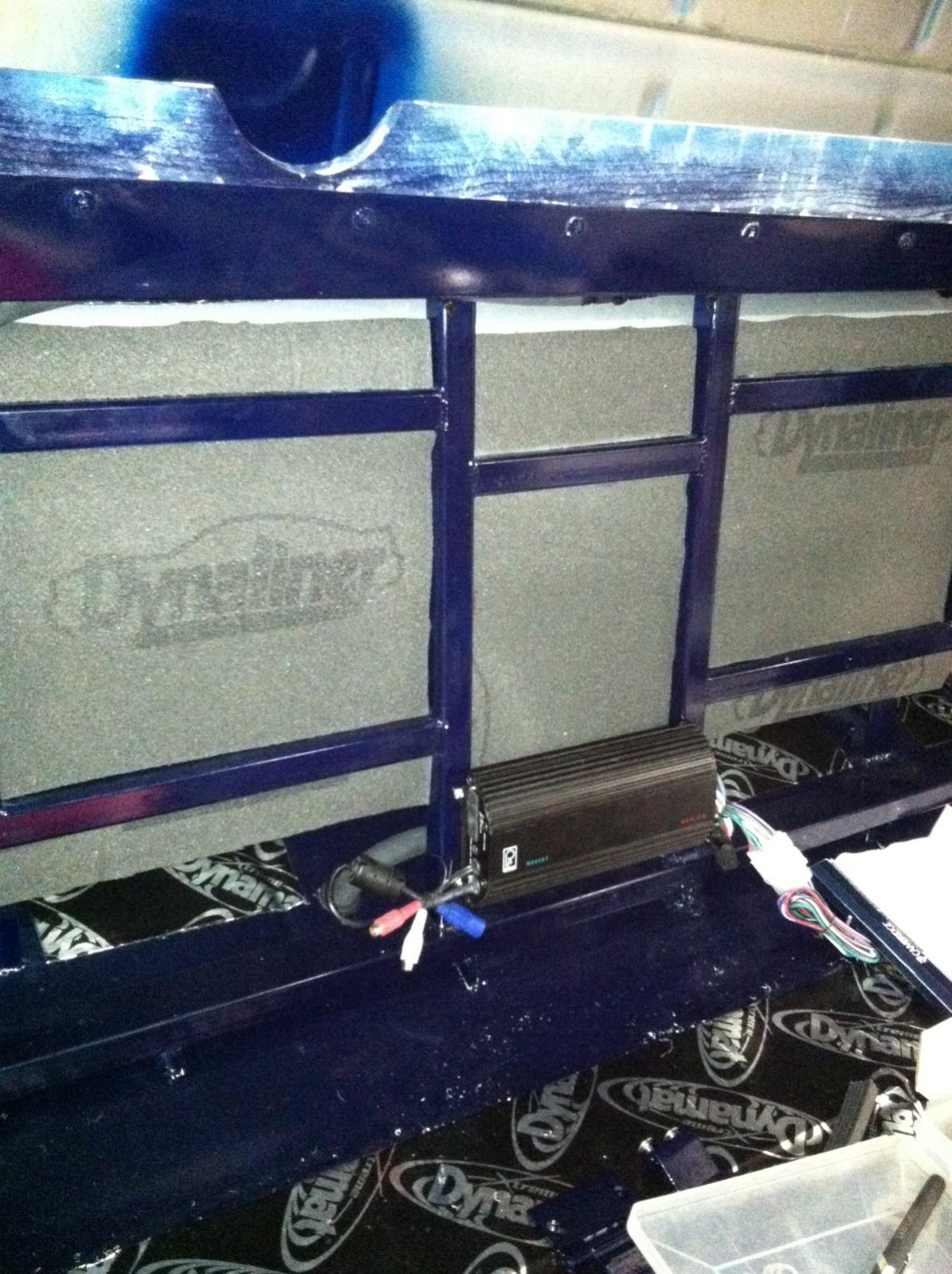

    Check out these patterns.... smile. Dynamat needs to send endor*****t dollars for these pics. Additionally, here's a picture of the "mid-dash" installation progress. The picture is very grainy and I will ask for another to update in the morning.

    What do you think about Dynamat on the back side of the gas tank (where it won't show) to deaden the sound of gas sloshing? Especially since it is right behind your ears there.

    At my place of employment, for aluminum weldments that will be anodized we use a 5356 welding rod to prevent the discoloration like you've had occur.
    Next time, be sure to consult with your anodizer to find out what rod should be used to maintain consistent color for a given anodizing process and base material.

    Great idea. I have already spoken with Josh and he will add the Dynamat to the gas tank as you have suggested.. Thank you.

    Thank you Mike. It was a learning experience and this is beneficial for the future.

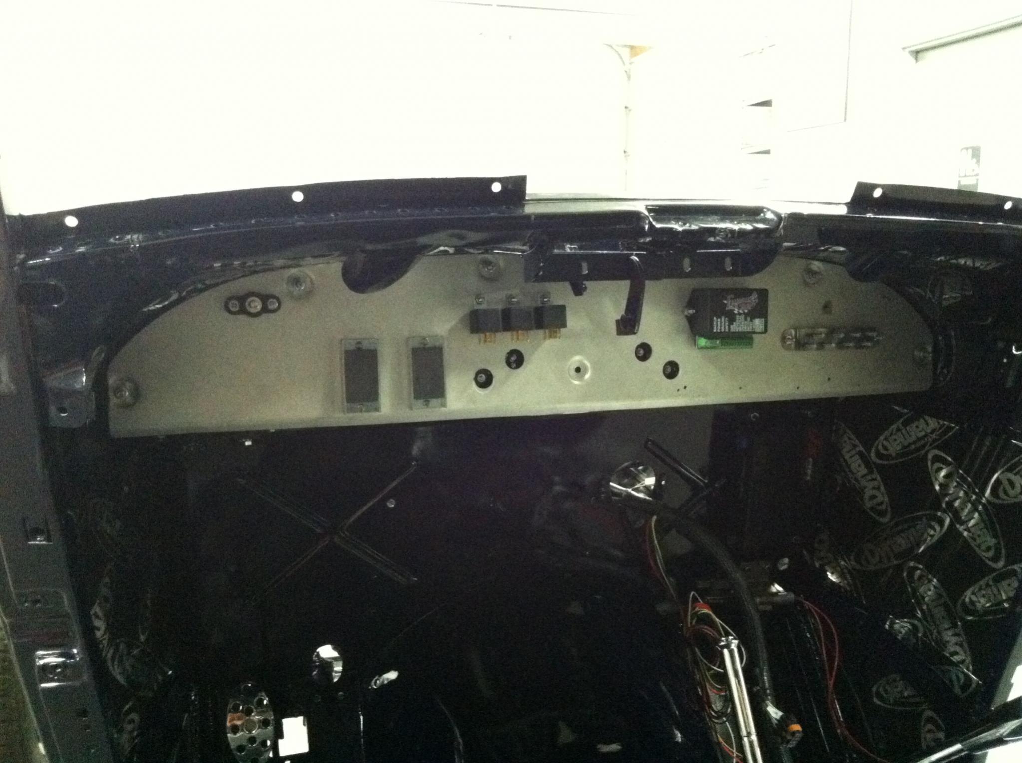

    See if this picture is any better....
    power stud/ post, 2 rectangular magnets for the fuse box which can come out for ease of access, relays, EFI controller and last but not least grounding posts.

    Time to sort out the spaghetti! The aftermarket fuse panel and harness has the wiring already terminated into the fuse panel. I prefer this to the non wired panel that utilizes crimped spade lugs. Using the pre marked wires makes this part of the build only a matter of taking the time to be neat and organized. Nothing complicated!

    Dustin sprayed half of this panel today to evaluate the match. It looks good and it will look even better after it has a flat clear coat sprayed over it.
    I am not only pleased, but quite frankly RELIEVED. whew.

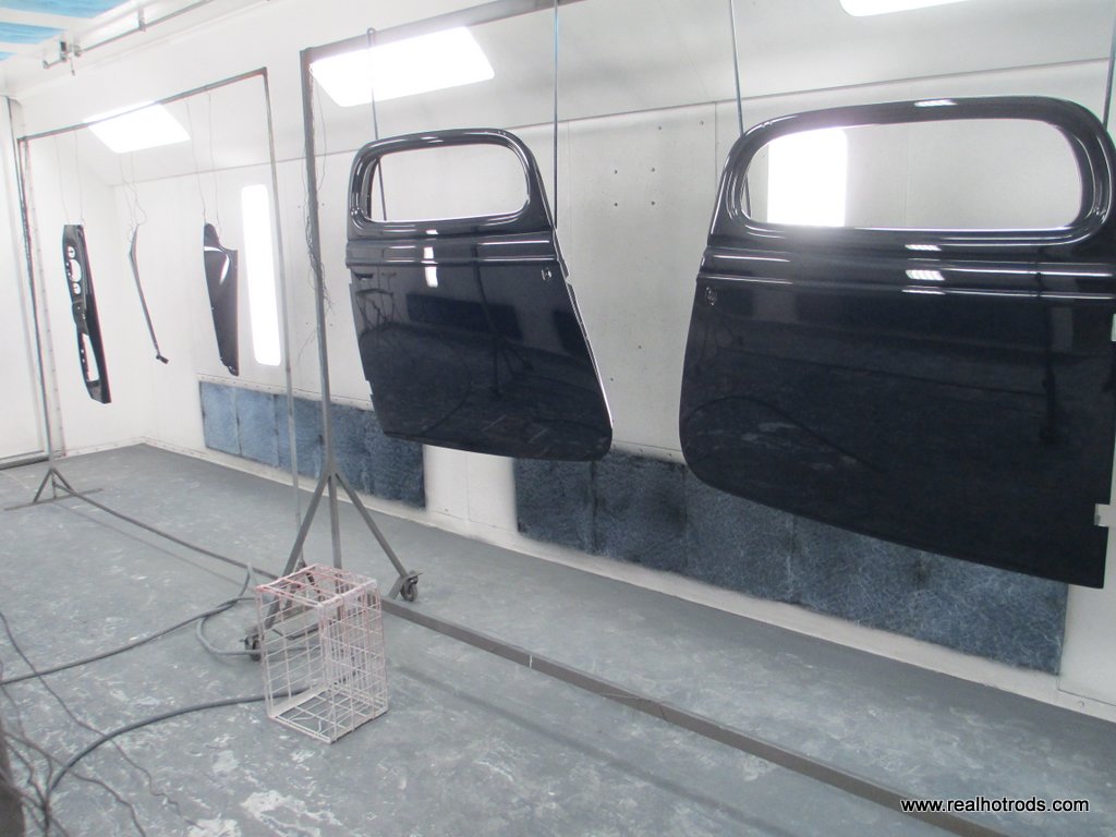

    The doors have been cleared and cured, but not yet cut and polished.
    Here they are hung and looking sweet.

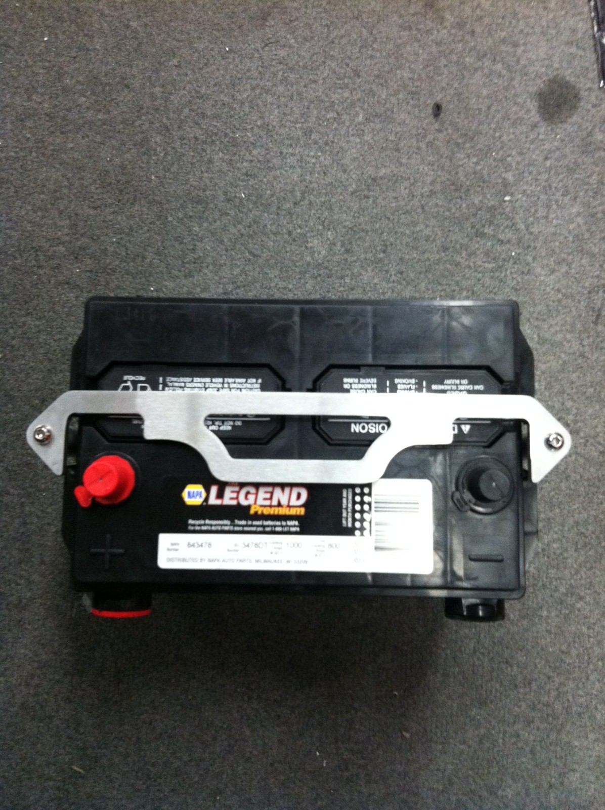

    ....one more step completed! The last picture is of the battery change today. I do not have the discipline to properly take care of a gel battery much less the patience to properly charge one. I asked Josh to replace the Optima above with a standard lead acid one. There are over 30 threads on the HAMB that address this if you want to read those.

    Bob, Joel, Randy, Pete and myself made a run up to Loveland yesterday morning to return the 348 I had purchased. ( it has a cracked block in the typical place under the exhaust manifold) Afterwards, we headed over to Custom Auto for a visit.

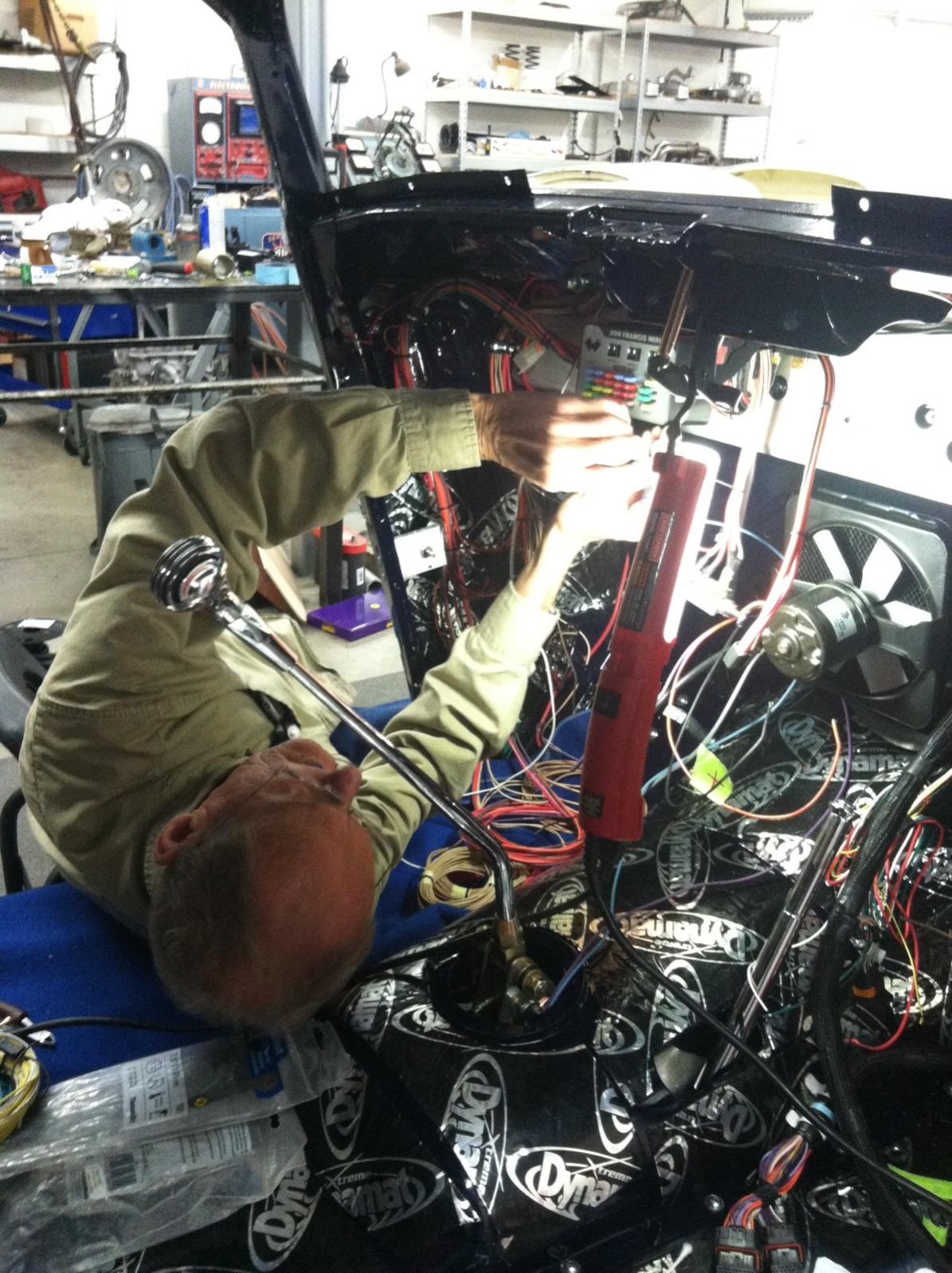

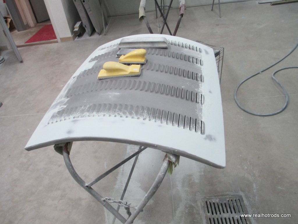

    Fred was working on the hood tops and will have all the remaining parts in primer before Christmas. Roy was wiring away. I was surprised by how well his "gorilla tape" was working. He had a small bundle of wire that included tail lights, and fuel connections (pump and sender) that needed to get to the back. He was carefully laying them FLAT and taping them about every six inches to maintain the low profile ribbon cable effect. NICE JOB ROY! The EFI harness is 44 inches longer than required and it is going to be quite the nuisance to roll up and keep neatly bundled out of the way in a small space. I sent an email to Hilborn and hope they are in next week to work on the issue for us. As some folks close for the entire Holiday week, it may be the first of the year before we hear back. While not a show stopper, this is definitely something to work on for improvement. Roy has the wiring very close and should finish soon.

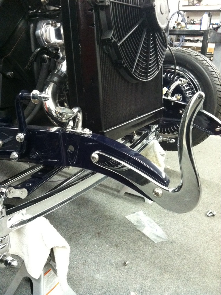

    Josh has the windshield gl*** in the frame and installed up front. The polished aluminum shocks have long last arrived. YES! They were the last missing pieces and will be installed next week.

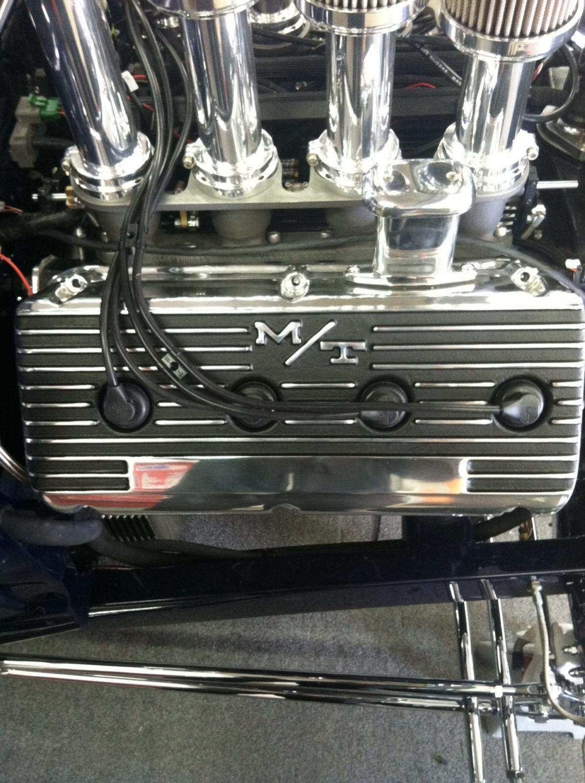

    I brought the plug wires, new Honda boots and silicone spray up and we ***embled one set to look at the fit. Obviously, I had already done it for myself, but wanted the guys to see how well it works. I really have to give credit to the H.A.M.B.'s "HemiRambler" for the great tip.

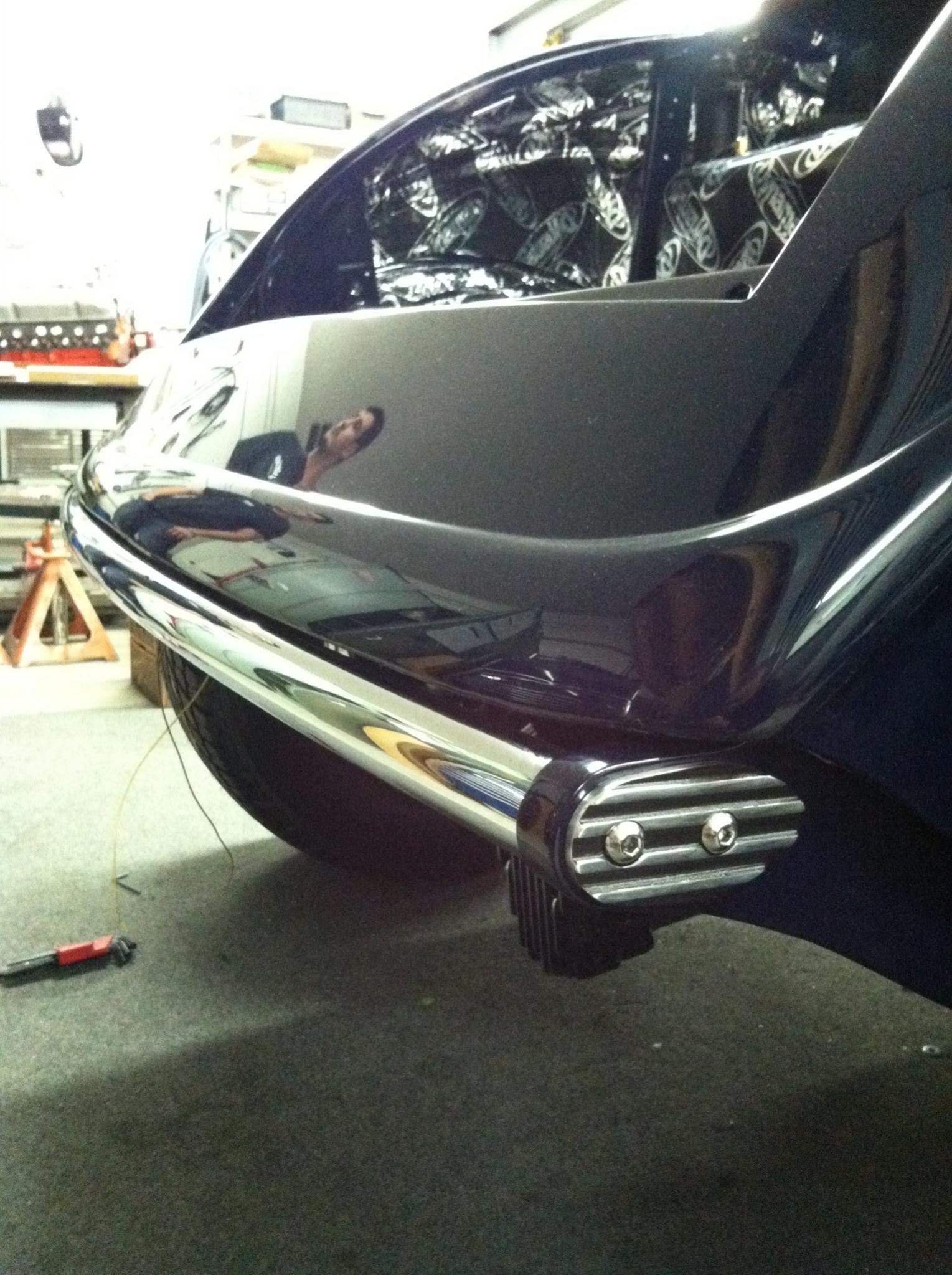

    Josh and I debated direction on the spreader bar end caps as they are flat and I would like to see them finned to match our theme. If there is time, Josh will work this at the end. If not, it can wait until we get back from the show.

    Here's a picture of the spreader bar cap I was referring to in an earlier post. We were going to wait until the end to see if there was enough time.....but apparently there is a fellow named Jon that had time today. I have never met him as he goes to school and works part time when the shop can use him. Thank you Jon. I am very happy with the result. Great Job!

    Here's the plug wire routing we discussed. smile. Additionally, please find the below picture of Roy's progress on the wiring. Josh has the shocks mounted and spent most of the day on a nice battery box with venting to keep fumes out of the ****pit. I chased down the updated valve cover studs required for the M/T's. The easy find was to use carb studs. Correct size, length and dual thread pitch as needed. The hood, deck lid and rear valance are all ready for color on Monday. Josh says everything is looking good on timing and I am a cross between happy and just plain nervous. Heck, we haven't primed hurt or even put gas in the tank yet. Yikes. 3 weeks to go and she needs to go to the upholstery shop for carpet. Rex has that scheduled in 2 weeks. geezem . grin. There is controlled thrashing going on and everyone is in good spirits. I am absolutely dying to see the front end and grill with head lights on her.

    Josh is going over board on the the details. smile. Just like my desire on the heater box, Josh decided the battery box needed to match the interior panels.
    Looking very professional Josh. Great job!
