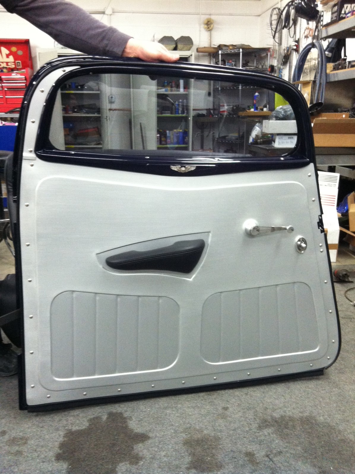

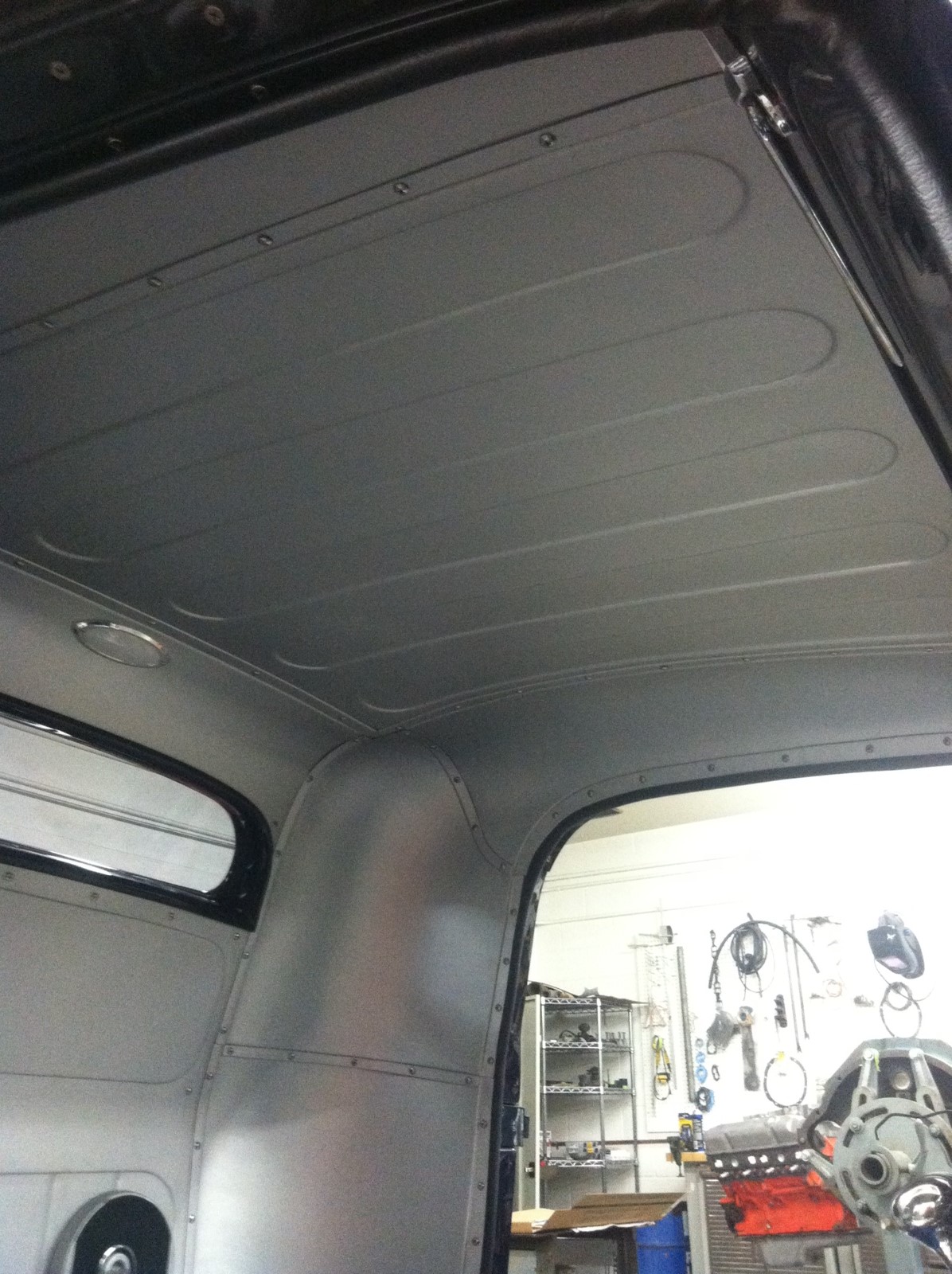

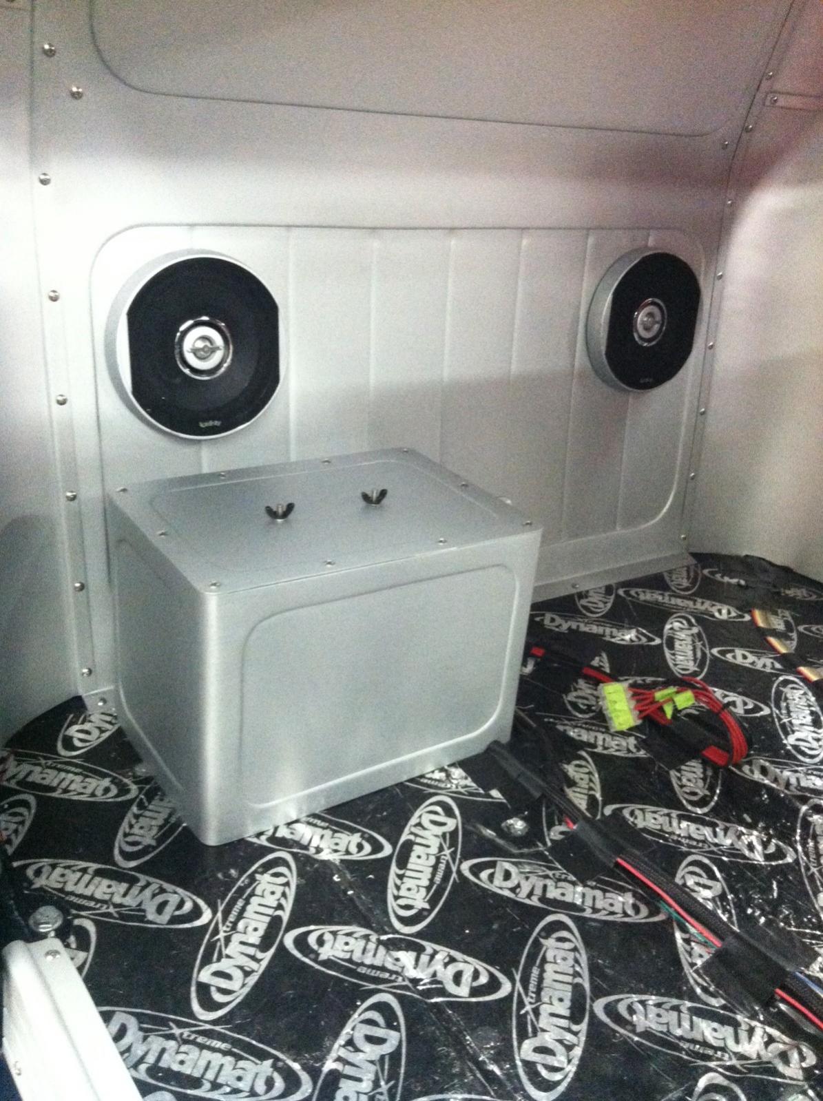

    In the mean time, Josh had to break away from the "get her running" activity to finish up ***embly before this mornings carpet installation. He had help from Rex in hanging the deck lid and the rear of the coupe is looking awesome. I don't remember where or who on the H.A.M.B. that I copied the 37 Ford Deck Lid idea from. But, thank you just the same. I like the v-8 detail that is stamped in the stainless housing.
    I have added pictures below.

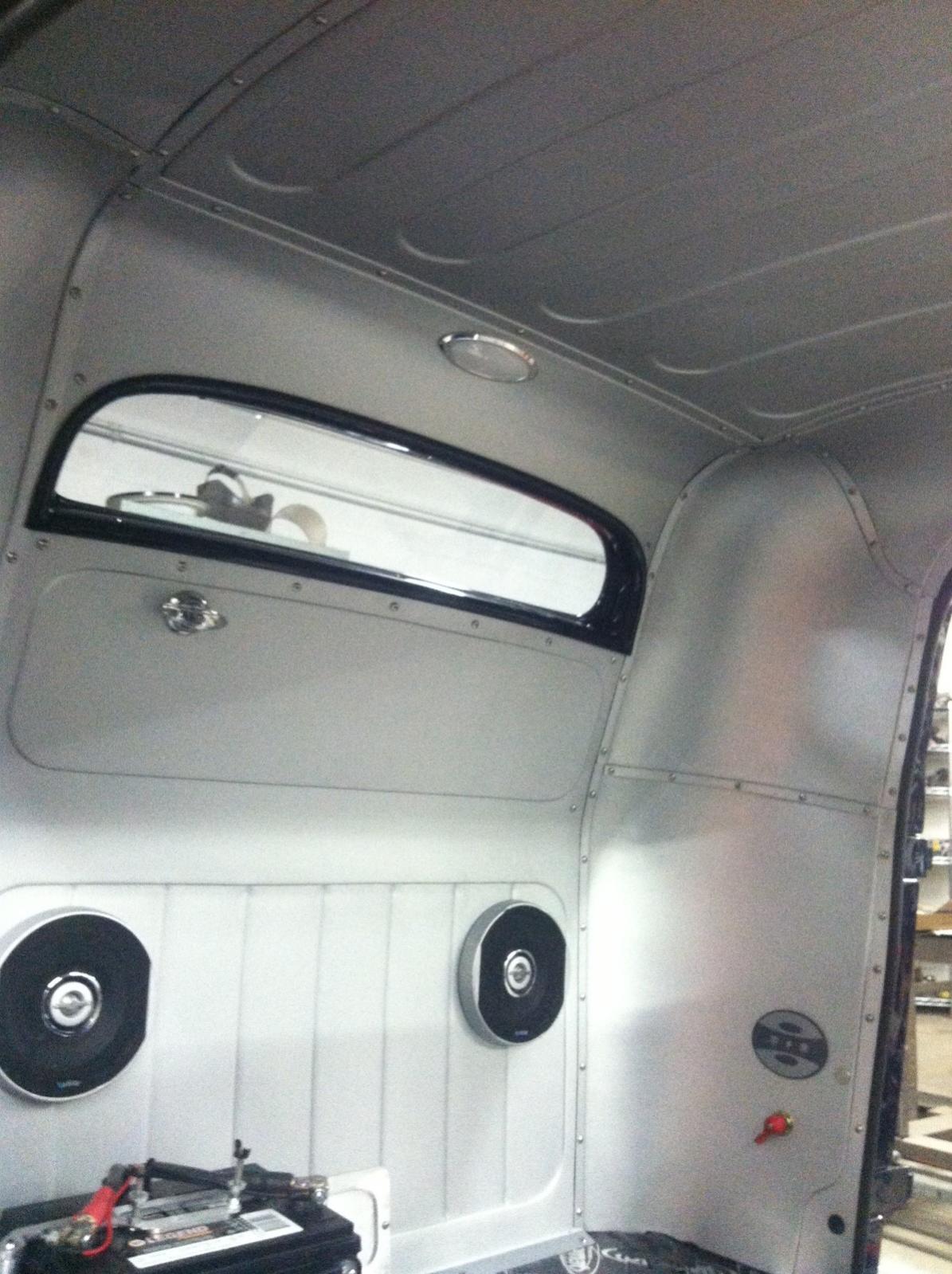

    Rex has been trying to keep everything scheduled and moving forward while he pitches in and helps in making things happen. He and Roy fought the Limelight turn signal, as it wasn't behaving properly. It had an internal shorting issue that was fixed with a short piece of shrink tubing. This was a huge last minute diversion that was a PITA and took hours to resolve.
    They also needed a 3 prong flasher with a ground wire which I found at the NAPA warehouse in Commerce City. It was the only one in Denver, so I will be ordering up a spare for the future.
    What else,....if you will look at the picture of the rear interior you will see an oval shaped control panel. This was another last minute gotcha. We were not going to utilize it and therefore had not accommodated a mounting location. After wiring in the blue tooth amp/ receiver, it was determined this had to be used for the "tunes" to work. This seemed like as good as a place as any. It's accessible and yet out of sight after the seat is installed.

    ...1937 Ford deck lid handle and completed battery box pictures. The wiring pigtail is for the seats power requirements.
    Regards,

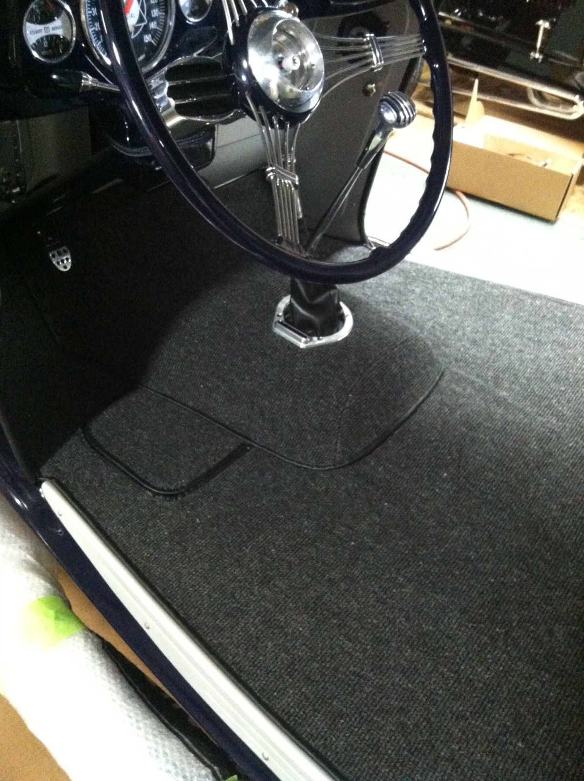

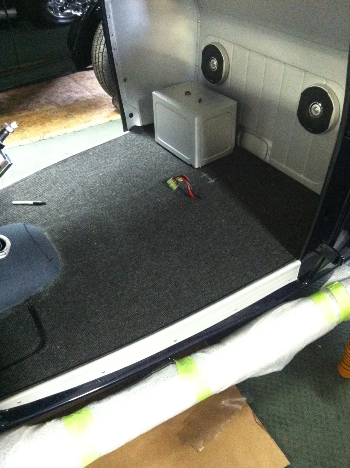

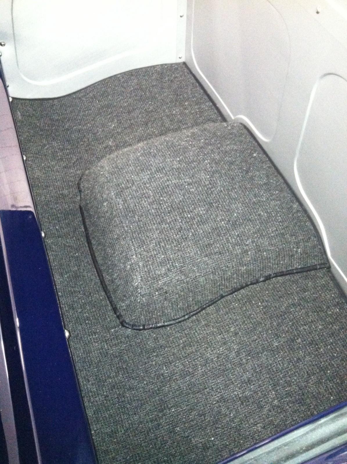

    I spoke with Dan and promised to post the progress on the carpet. Please find attached pictures.

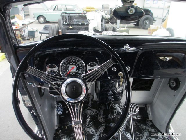

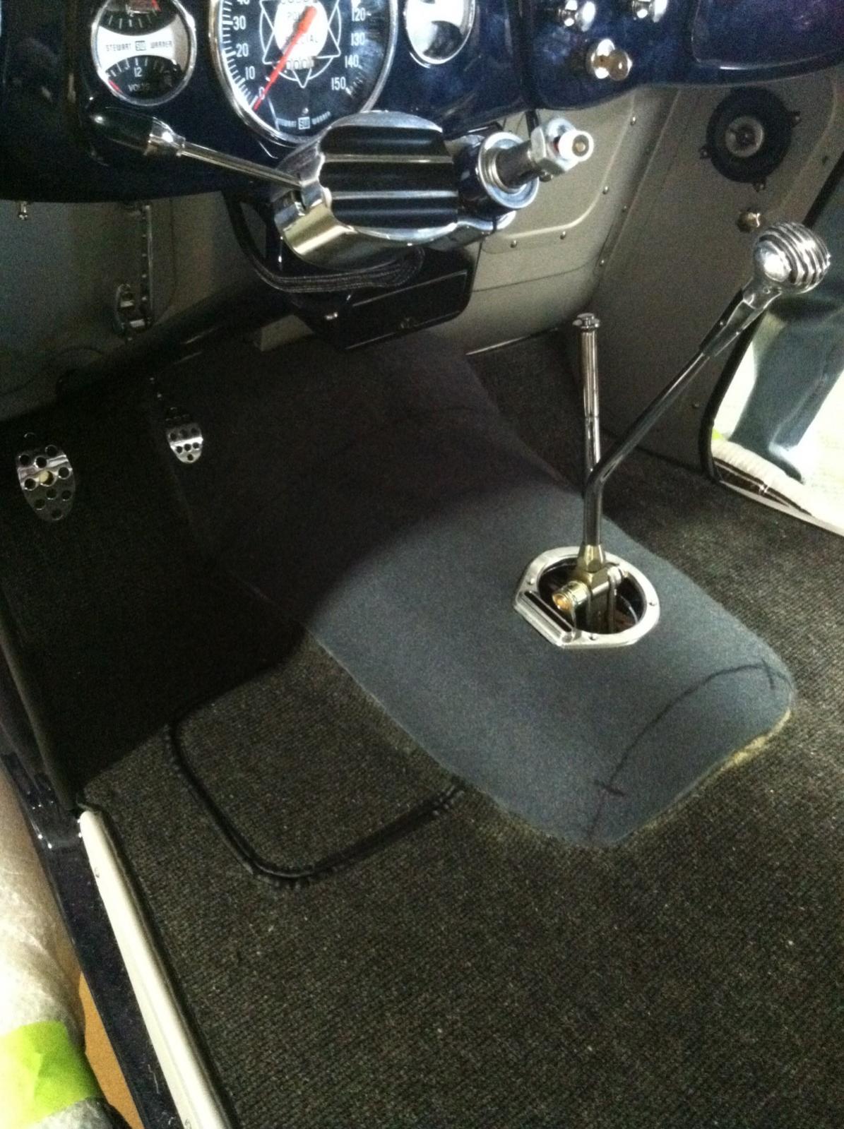

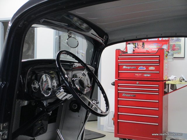

    We are chomping at the bit to get the coupe back from having the carpet installed. The front is completed and Rex and Josh are standing on top of the upholstery shop. They are trying to get the car back to add the doors and get her running this afternoon. It's hard to push someone that you want a terrific job out of. My guess is that it will be late in the day.
    (See attached pictures. )
    The seat will be bolted in when the coupe returns. Also shown below is one of two book stands that Josh made for our build books from Dan Greenberg.
    The horn ****on was pulled to have Alan Johnson highlight the v8 logo in red one shot. We had discussed this earlier but had not made a decision. My guess is that we will do it over with body color and then red accent later.

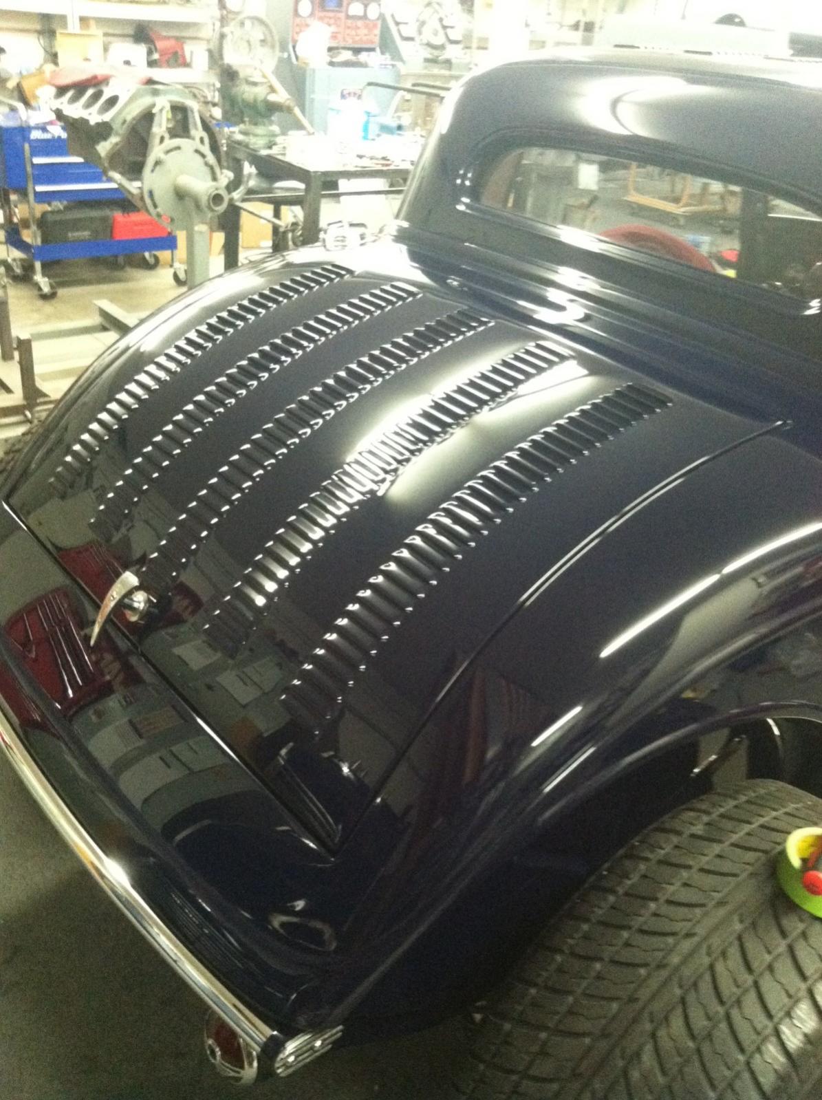

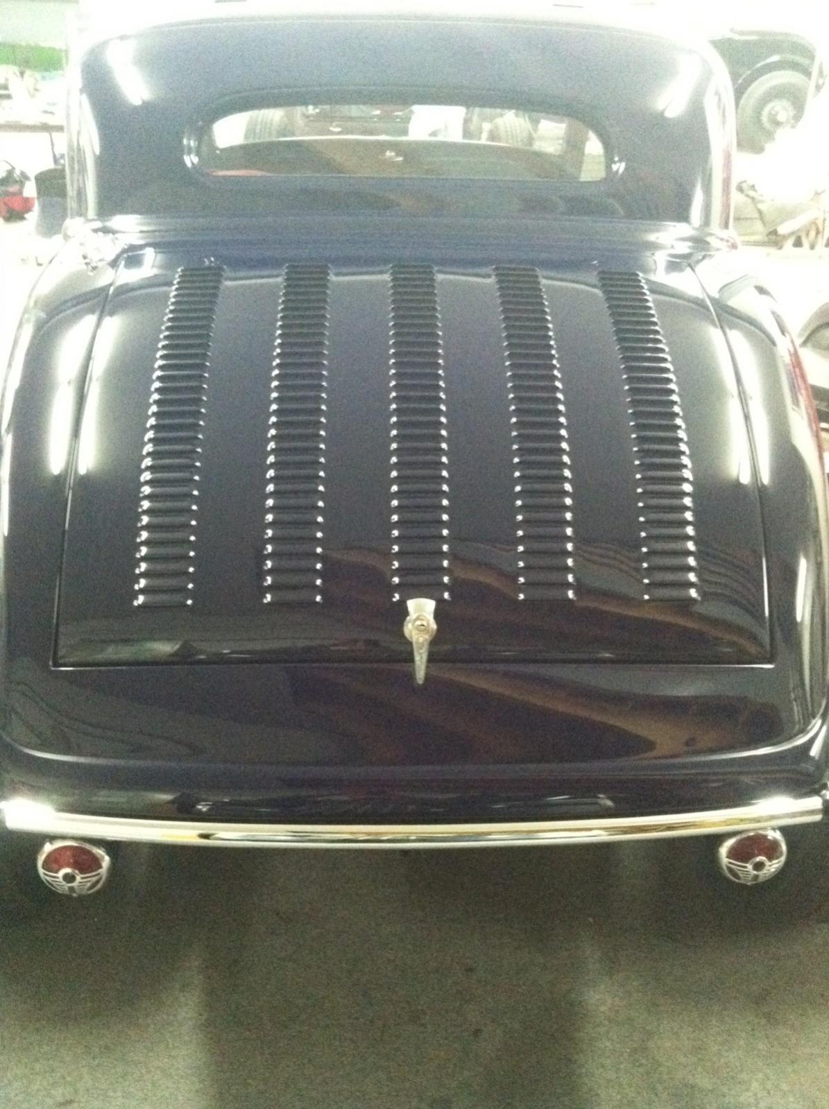

    Speedy, I won't be selling any books. smile. Here are two updated pictures.
    One of the doors being hung and one of the completed trunk. All that's left is the pesky little issue of getting the engine running. Hopefully, good news on that tonight.
