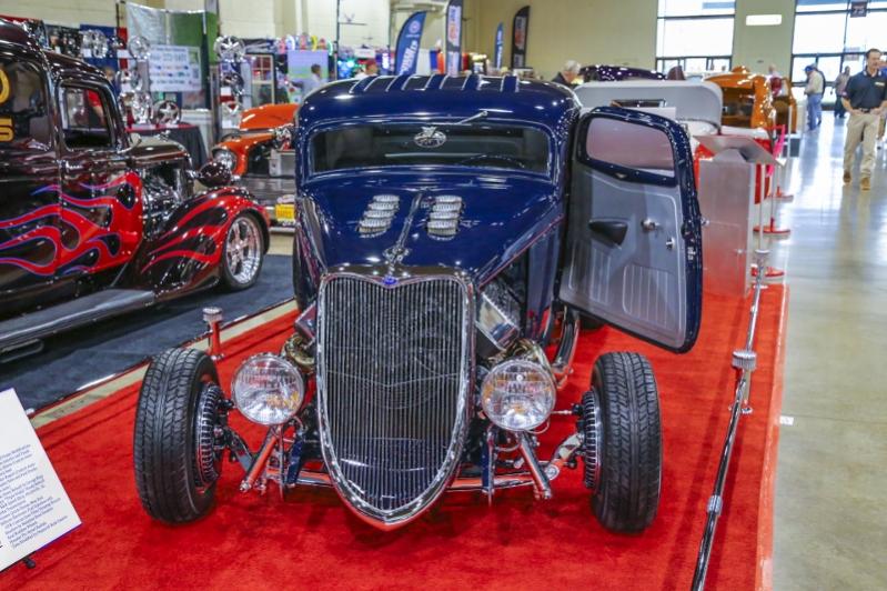

    Here is how she looked displayed at the show.
