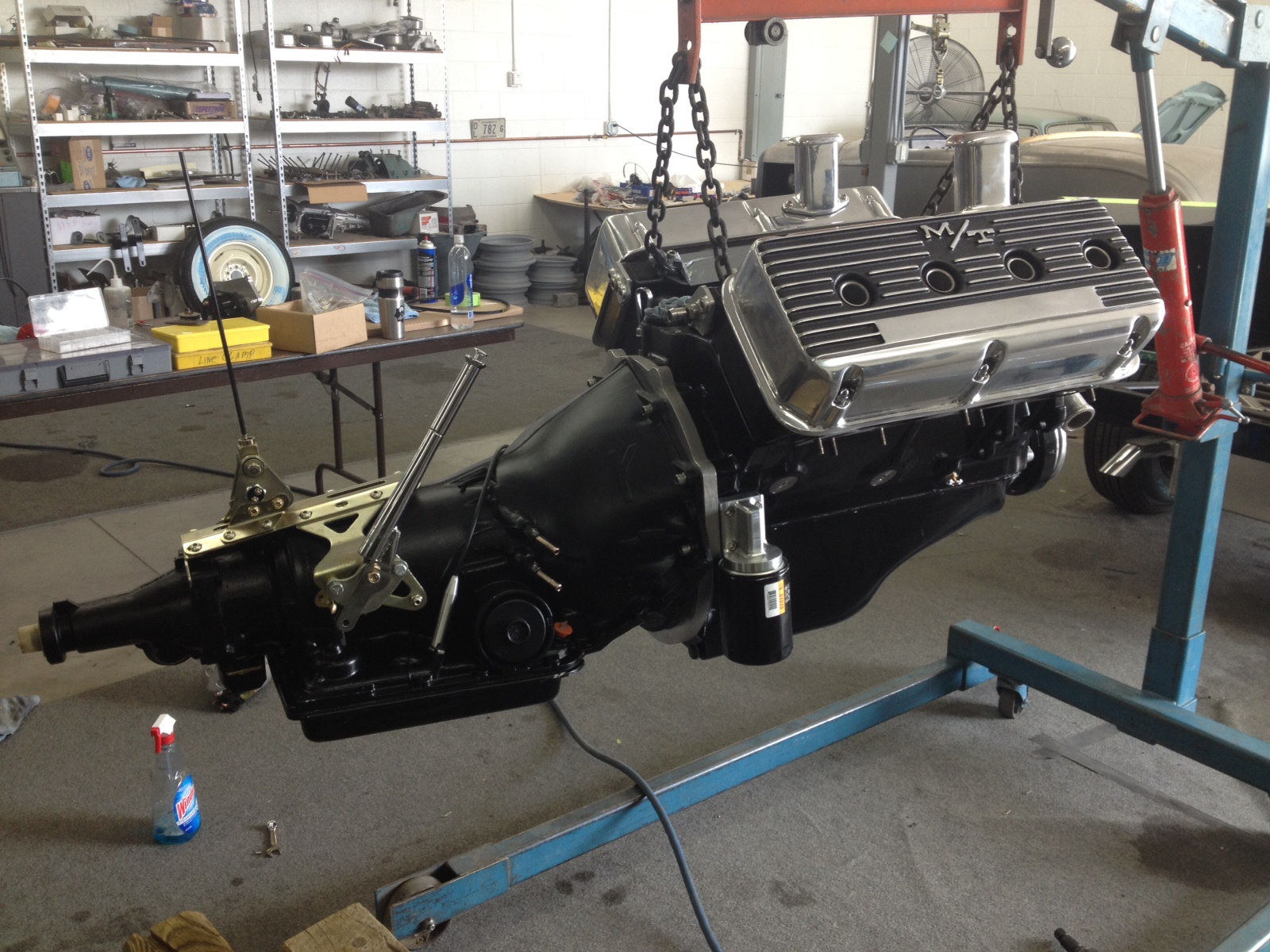

    Ok , I have two pictures to share tonight. Sorry that one isn't in focus. Rob from Blue Oval Performance has gone back through the 392 after the folks up in Greeley honed it and polished the crank. We have had a few things to sort out. I.E. finding bearing sets for the new rods that are based on the 426 journal size…. finding a new cam as the first one had a strange wear pattern and we didn't want to take a chance. Of course we needed a new set of lifters as well. While degree-ing in the cam, the spec called for +4 degrees. When at 0 on the crank key we had 0 on the cam. Ok, here's where it gets ugly. When we moved to +4 we got +8 on the camshaft. Hello! 4 ON THE CRANK IS 8 ON THE CAM, ????WTF ??????? We swapped to a different manufacturers lower gear and wrongfully ***umed a 2 on the crank would give us the 4 we needed. NOPE, It yielded 2??? Well Ok then , put the darn thing on 4. Well, I'll be a monkey's uncle ….. We got the 4 degrees advance that we needed. Over 2 hours later and we had good results on number 1 , intake and exhaust. Then Rob suggested we check the other bank as he has seen right and left sides not ground the same. Setting up the dial indicator didn't take but a minute and then we checked the intake reading to yield great numbers. May I have an amen?
    Rob is going to have her finished up Tuesday and we are going to Greeley for DYNO run in Wednesday. Afterwards, we will drop off at Custom Auto for the team to get the 34 back together.

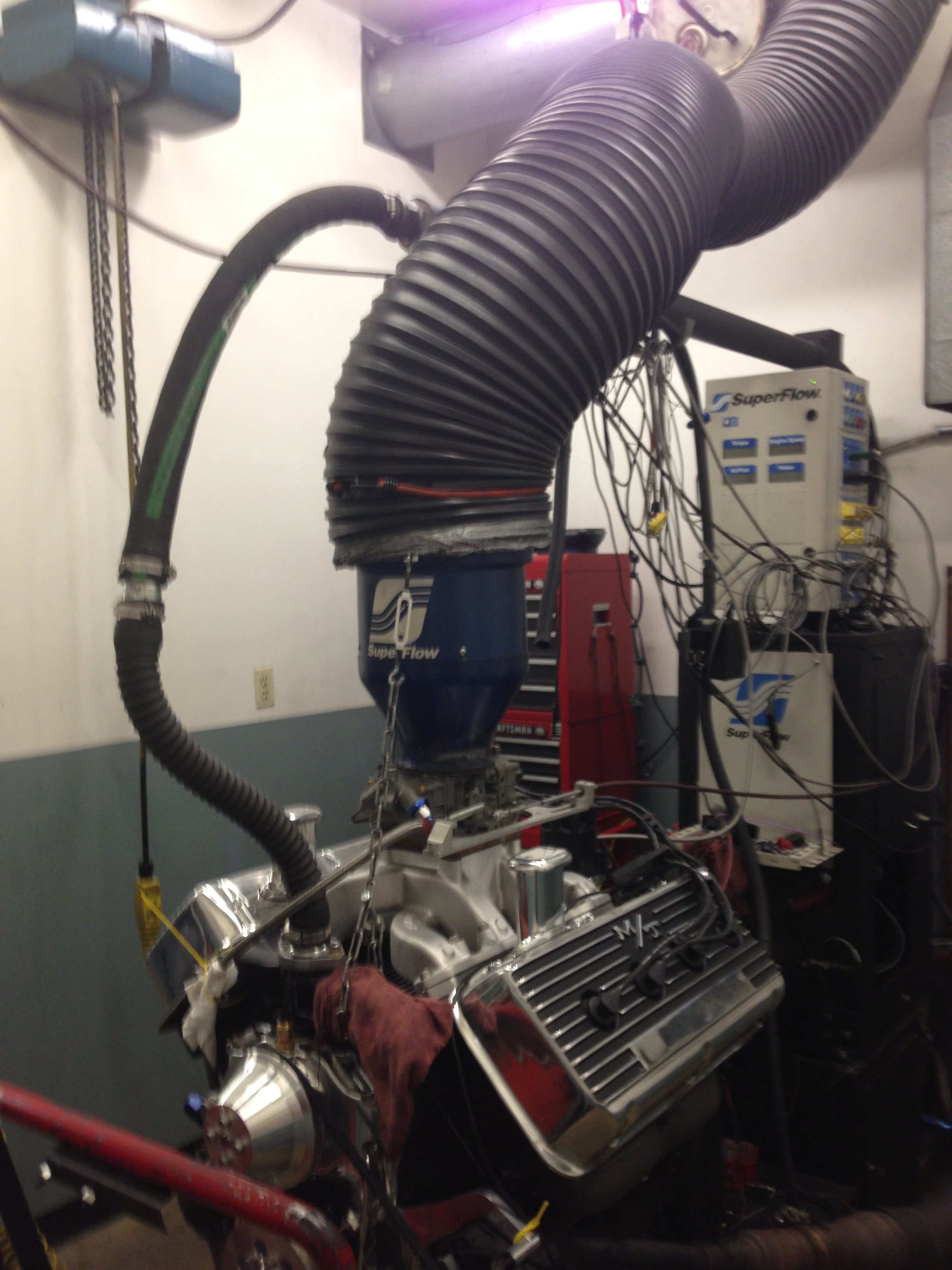

    From the time I left home this morning headed out to spend the day on the HEMI , until the time I just walked in, was 12 hours! Quite frankly ,I couldn't be more happy about it. I got to Rob's engine building shop before 7:30 . He and Rick the really smart employee were working on finishing up. I pitched in and Rob and I pulled out of the parking about 9 am with the HEMI loaded up in the back of my 1966 Chevy panel truck. We eased up to Greeley in under 2 hours and were met by Leonard.
    It took us 30 min to unload, then get the 392 on the dyno, plumbed up and ready to go. We had a few minor issues with the front float on the Holley 735. It took some tinkering to get it to quit dumping gas on our project. The 392 cranked right up and was run at varying RPM's between 2000 and 2350 for 20 min.
    It didn't take but a moment for us to notice smoke from the right exhaust pipe. We had put a small hole in the oil filter when bolting the engine to the stand back in Littleton. Rob and I took turns holding a metal pan under the steady dribble for the 20 min it took to run in the engine. Not bad, but I had ear plugs in to help. smile.
    Leonard monitored vital statistics and the oil pressure was running 68 lbs so there was no worry.
    After run in, we changed the green break in oil, as well as removed and replaced the oil filter. Rob de-capped the filter and we examined the element for debris. ALL CLEAN! Next Leonard added a fresh air duct to the top of the carb with an airflow velocity gauge.
    We decided to go to lunch and came back after a short visit to a local restaurant.
    Everything was checked for leaks and ***urance that nothing was loose. Leonard thought we should check the carb and turned the fuel pump on to find the same problem, Turns out there was a piece of trash in the needle valve. It was cleaned as well as a new gasket swapped out on the float adjustment hardware.
    Fuel pump on ….no leaks!
    She started right up again and the first Dyno pull resulted in 373 HP and 429 ft lbs of torque. The second pull was better but not much. The console info on the dyno indicated that the fuel mixture was too lean. Time was taken to re-jet the carb as well as insure that the vacuum secondary was working before making another pull. Much better , 383hp and 427 ft lbs! Pretty darn good.This is with factory exhaust manifolds and not my full length headers. PLUS, it was still a little lean. My EFI with 36 lbs/hour sized injectors will be just the right amount of fuel. With just 10% improvement from adding headers we should be able to get up to 421 HP . Now add a little fuel and we should be able to get a very respectable 425 HP. We let her cool down enough to put back in the panel truck and delivered the fresh HEMI to Custom Auto.
    Josh and Lance will put her back together over the next week and take the coupe down to the ch***is dyno for final tuning with the EFI /stacks instead of the 4 barrel.
    Oh Happy day,…getting much closer to wrapping this up.

    Thanks…here's the 392 AFTER run in. Rob and Leonard were trying to get the float adjusted. As stated above, they ended up putting the largest jets possible in it for fun. I.E....it doesn't make any difference as the carb and intake were swapped for the EFI set up.
    Regards,
