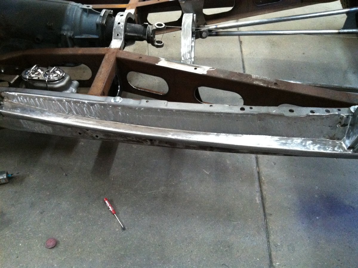

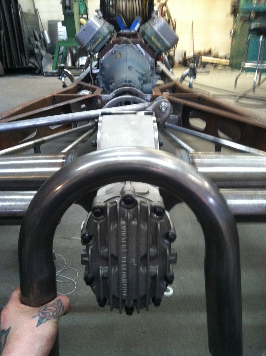

    A lot of effort to get the front ladder bar mounts incorporated into a driveshaft hoop...Here is Josh's vision and implementation today. The lower half of the hoop is tomorrow. I am very happy with the quality of Josh's effort. Rex advises that they will add support between the two hoops to insure there is no twist with the forces on/from the ladder bars.
    Regards,
    George

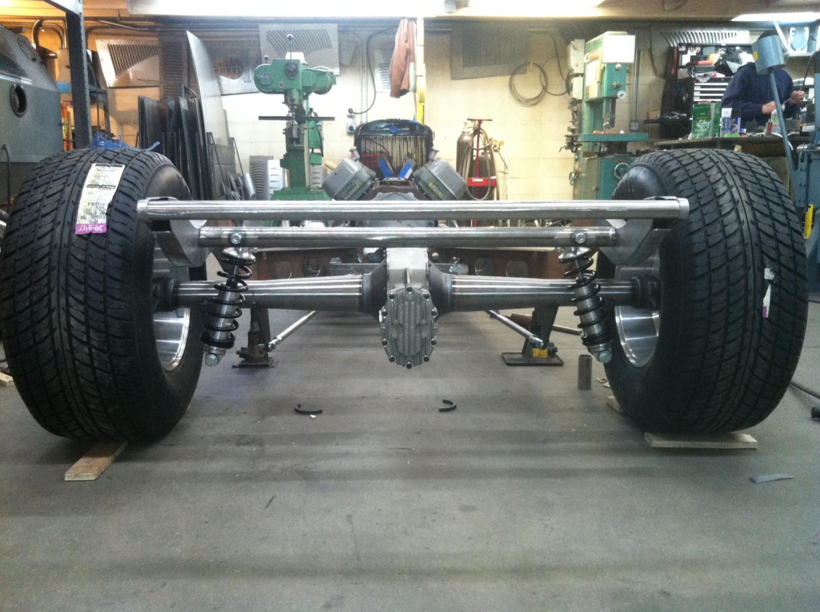

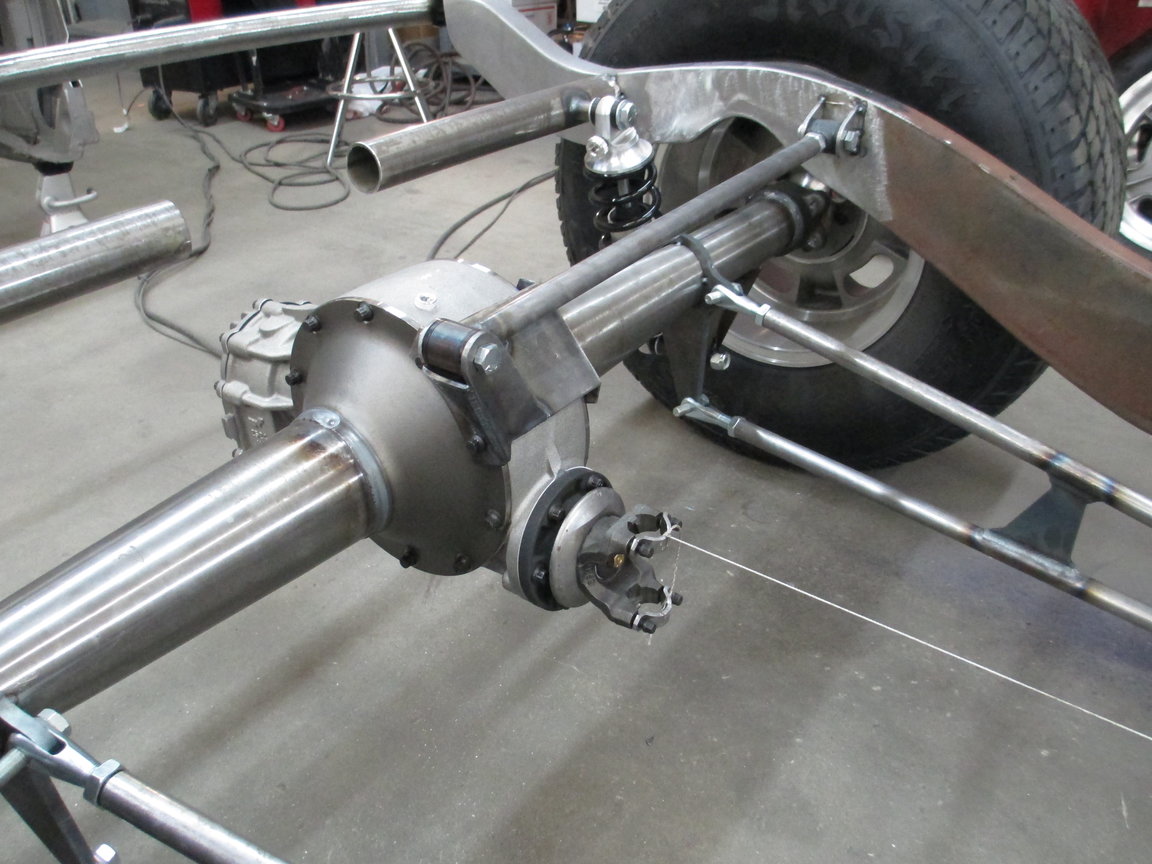

    Thank you...Rex and Josh are doing the work....I just get to report in as I get pictures from them. smile. The below picture is of the added panhard bar and entire rear frame lowered to eliminate the "up the skirt" view that needs to be avoided. I would really like the quick change to be visible to show it off a little , WITHOUT looking at the entire undercarriage. IE: A nice compromise. A small hoop for clearance will be added to give the rearend room to move up to the bump stops without hitting the coil over cross bar mount.
    Regards,

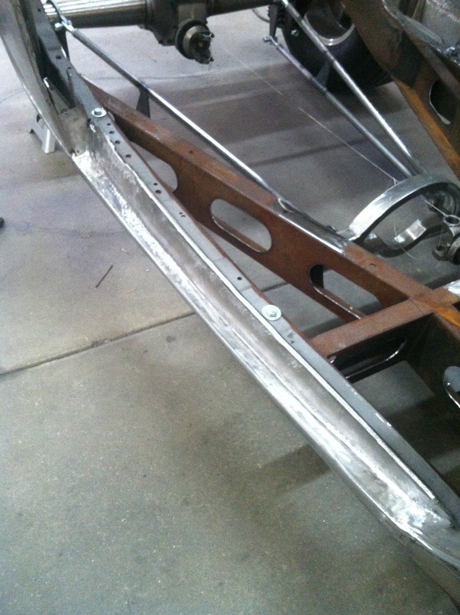

    Here is more progress from Josh today and direction for the rear end clearance needed. The ch***is is getting close to being wrapped up!
    regards,
    George

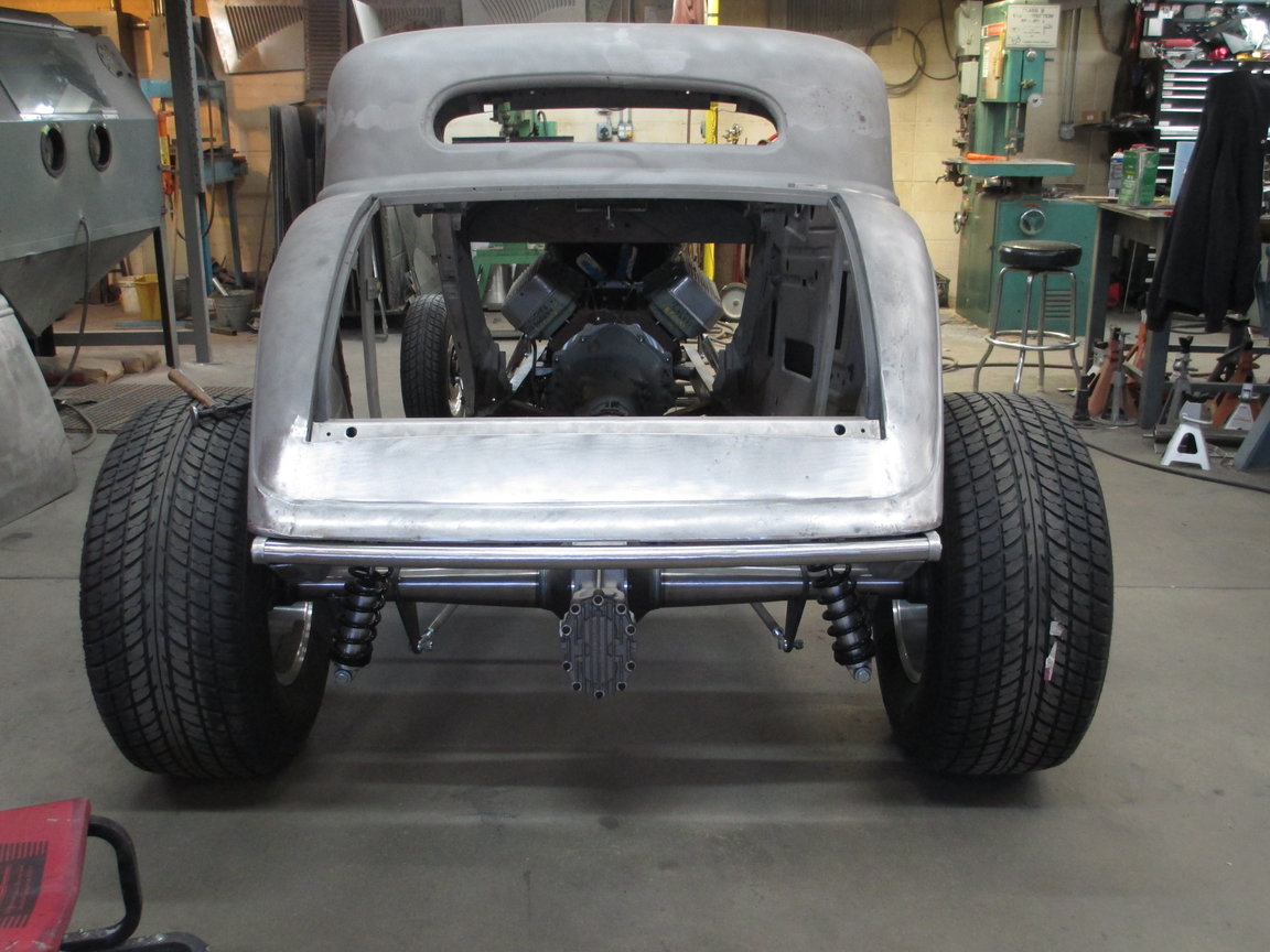

    Here's a shot from after the body went back on today. This is much better as the view is "mo better" .
    regards,
    George
    Thank you Josh an Rex!

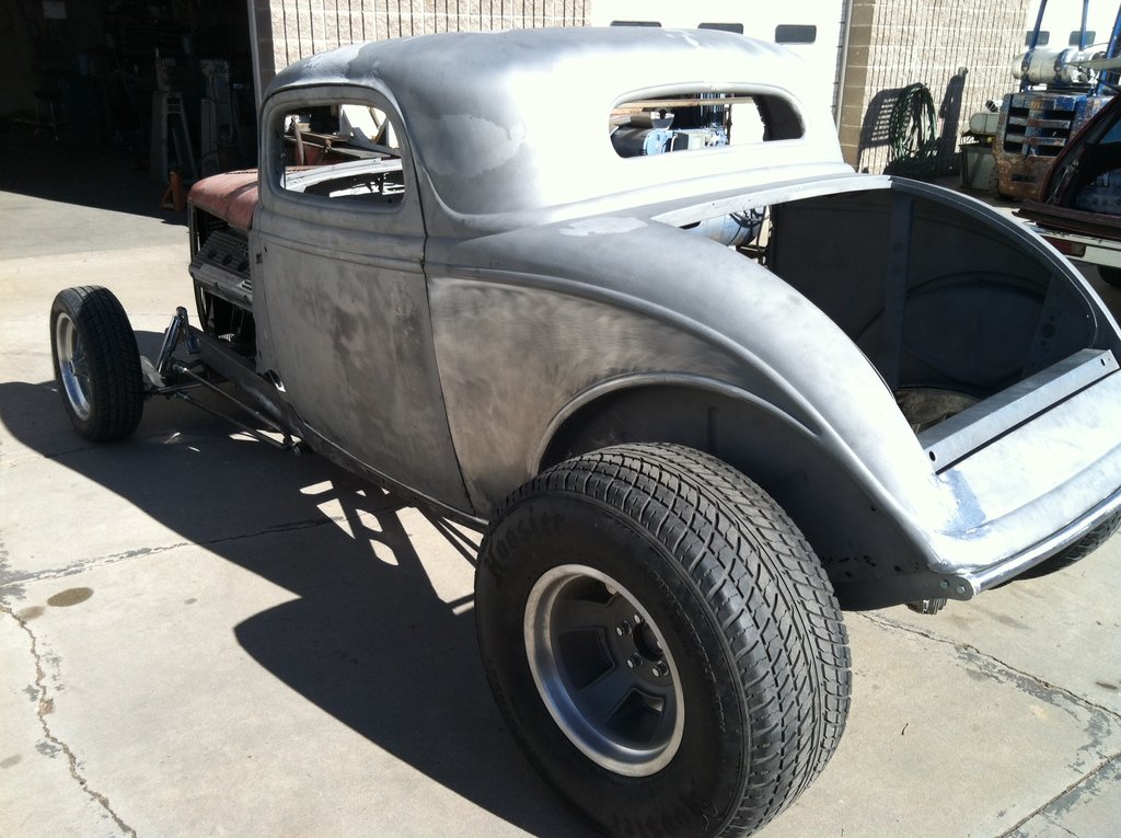

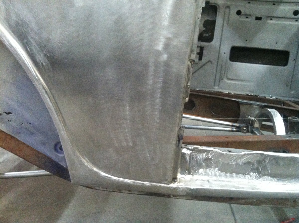

    Both rocker panels needed replacement..... Josh has finished the drivers side and continues to work towards getting her put back together.
    Thank you Josh!
  20. geoking
    Joined: Nov 12, 2008
    Posts: 717
    geoking

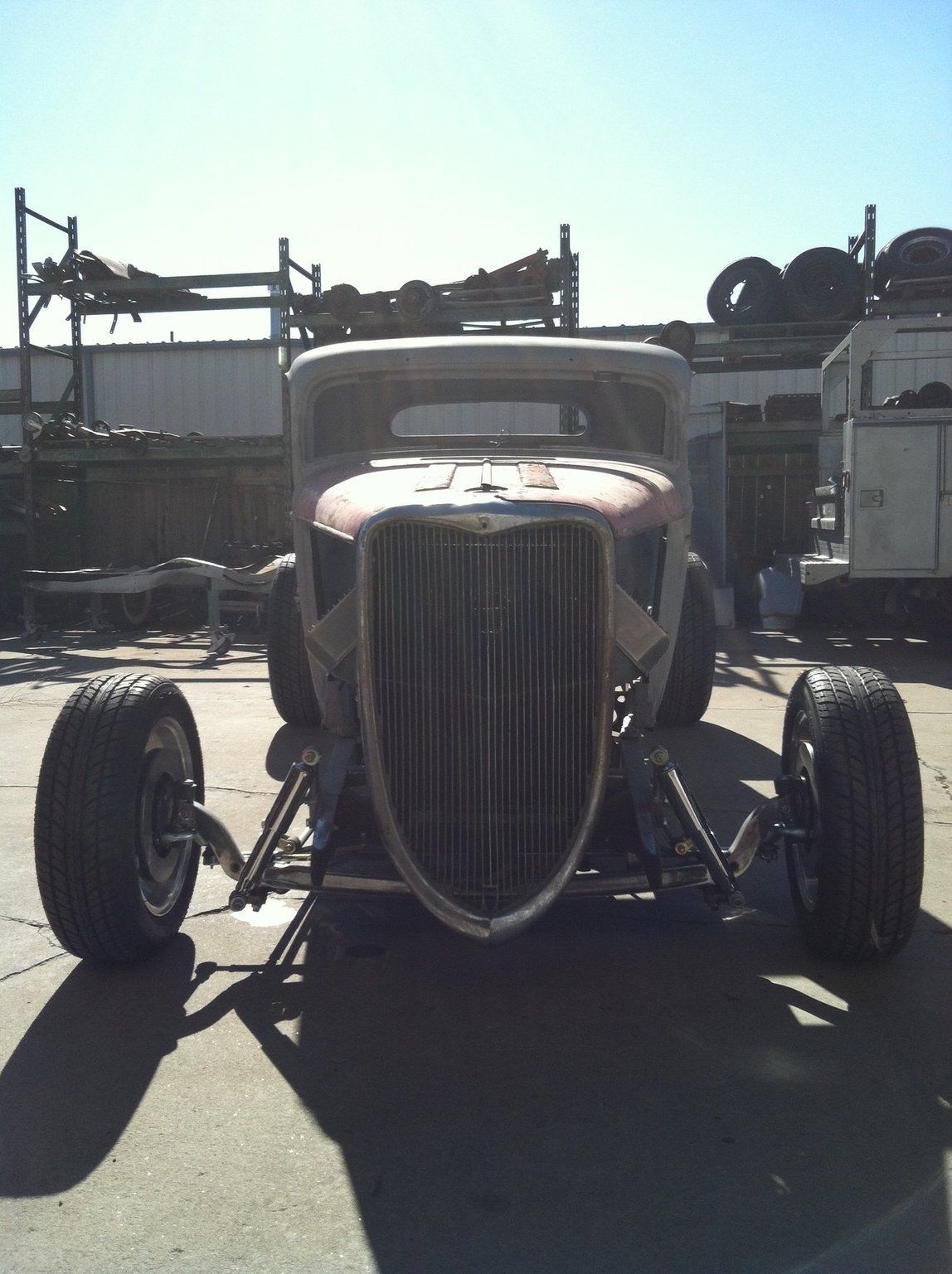

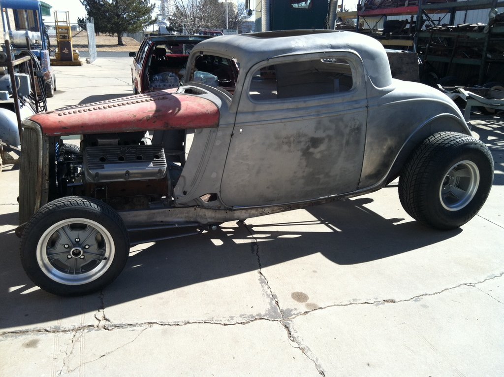

    Josh made the effort to roll her outside this afternoon to see what her stance is and give a good visual check on lines. She will sit a little lower in the rear when you get more weight and a tank of gas in the "boot". grin.
    Trust you will all apreciate the feel of the car as much as I do.
    Regards,
    George
    PS: All the tires are running the right direction. snicker. Josh said he couldn't take it anymore! LOL

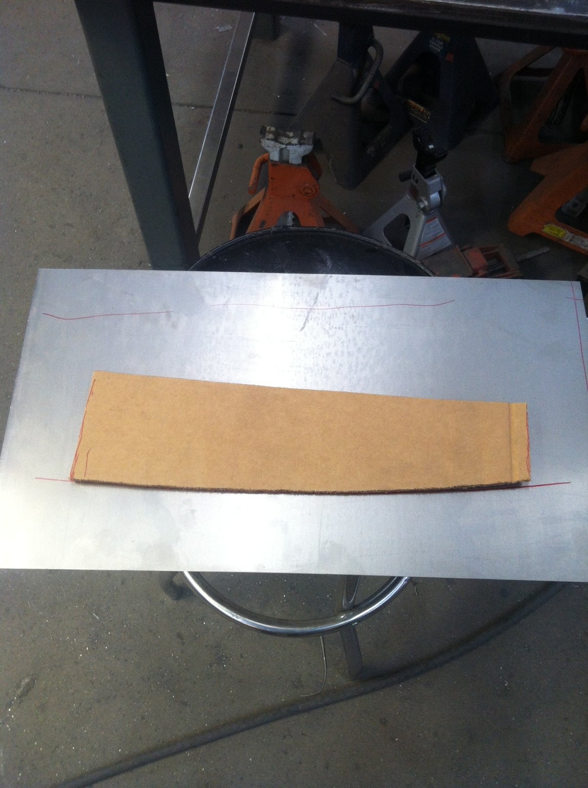

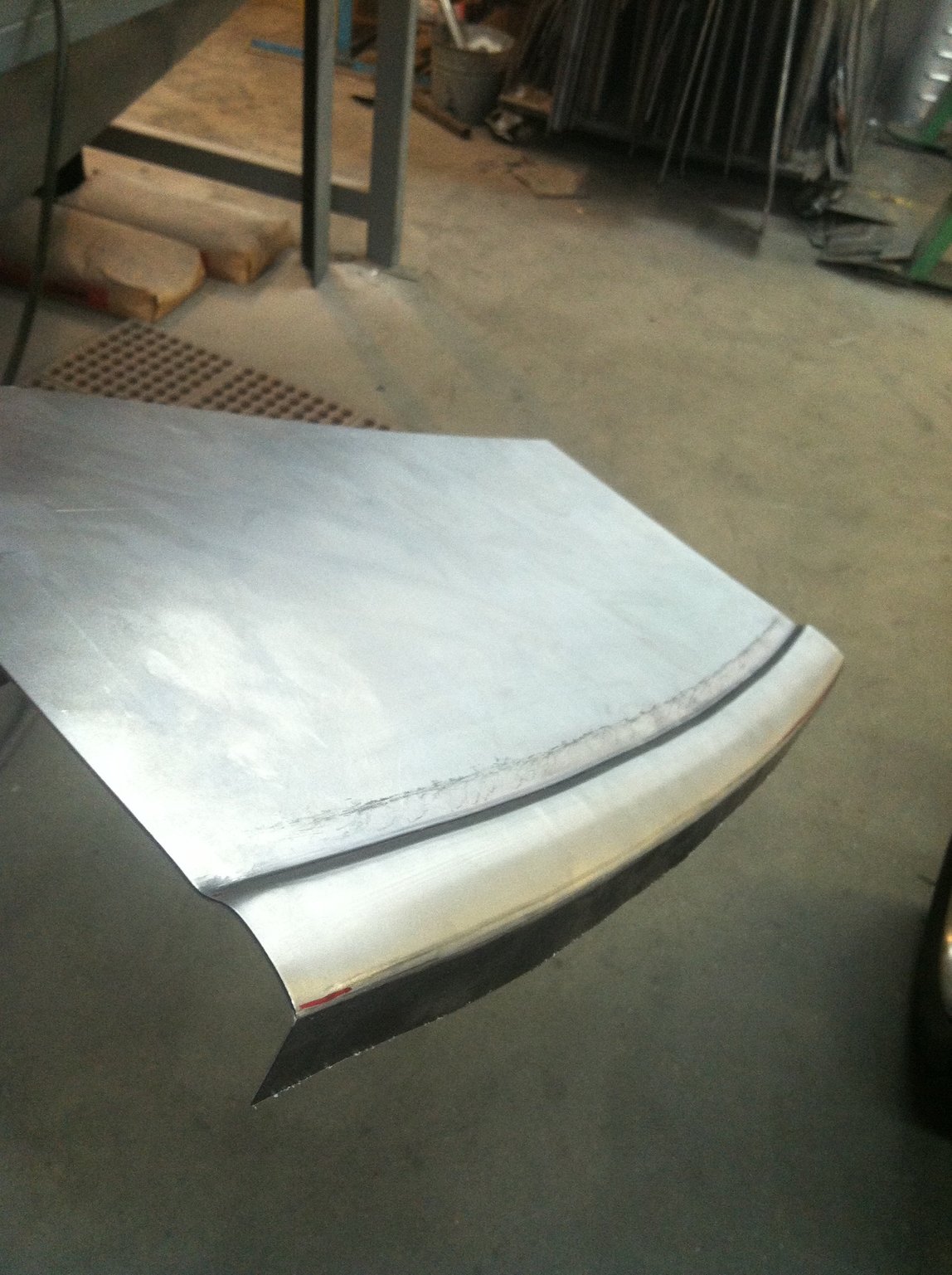

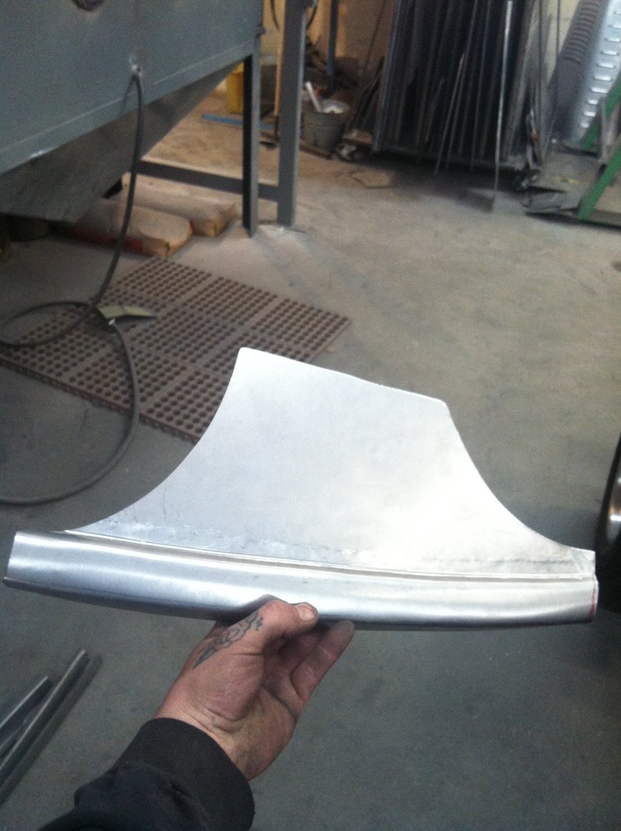

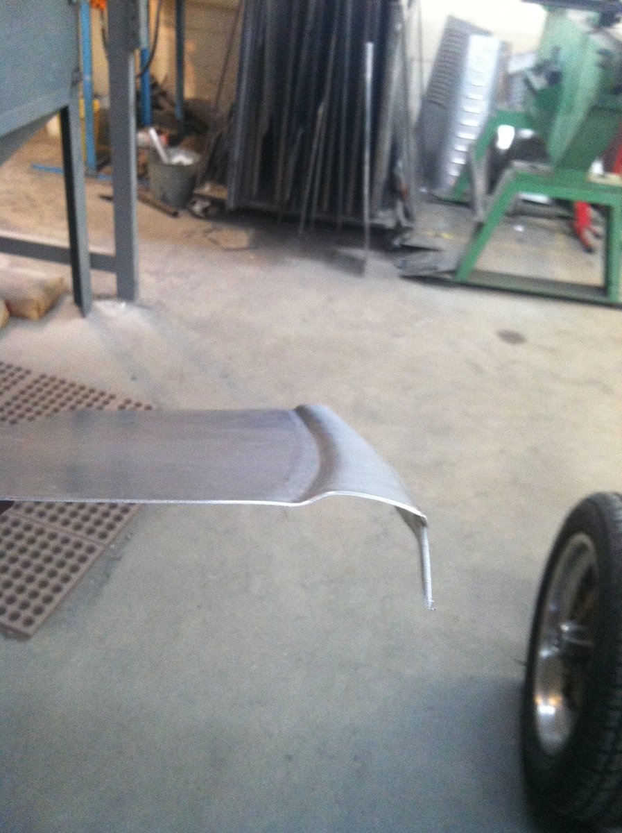

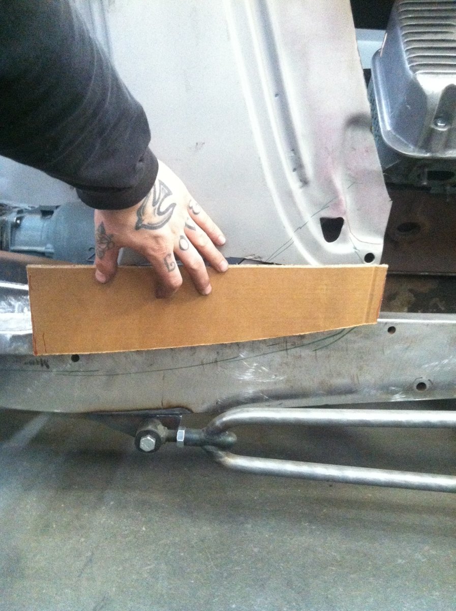

    Josh spent today getting the p***enger side cowl patch panel fabricated plus installed as well as getting the right side rocker installed. He was gracious enough to take pictures along the way.
    Please see the below from pattern to install. Thank you Josh.

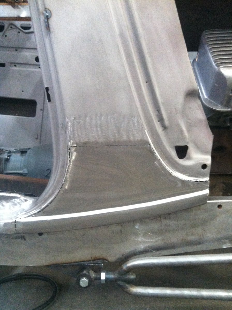

    Josh finished up the cowl patch and entire p***enger lower side today. Next up is the bottom of the drivers side and moving on to the cowl and floor. Rex sent me a note tonight with the attached pictures and a strategy for going from the completed lower side including floor before they start moving up to the top for the roof fill. The rear of the car will have a short louvered panel under the spreader bar. A mini roll pan of sorts. Note that the cowl panel is not as curved as original. This has been done deliberately to match our intended future custom built headers with 3 inch collector and side pipe. The door is tack welded on for the set up. Both doors have MAJOR surgery planned to get rid of the hidden hinges and put original type PLUS inner "X" bracing in. Can you say ?,.....remove the door skins, install the braces, replace door skins?? OUCH!!!! but this will be worth it over the long haul when the doors stay put and do not sag.

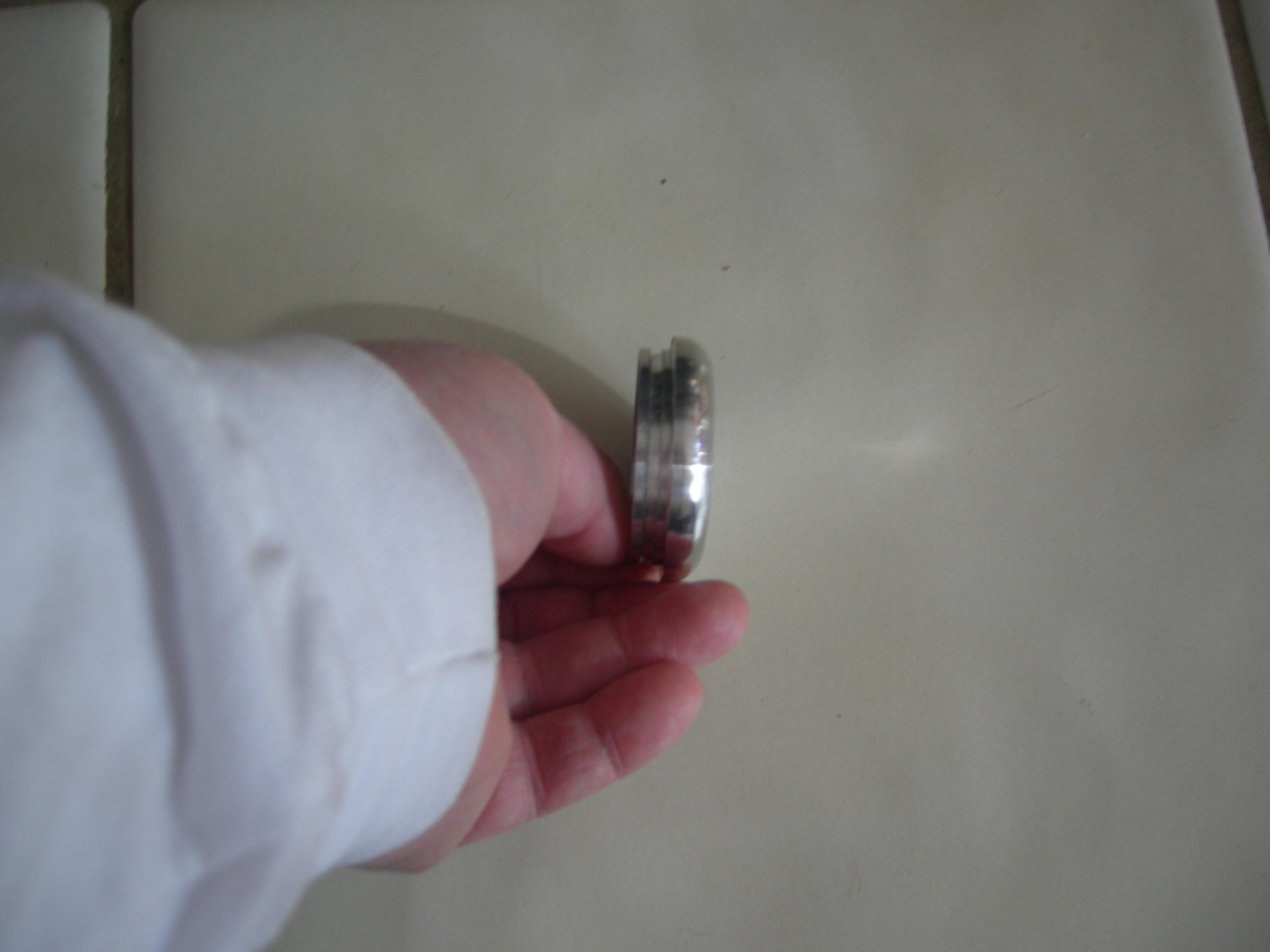

    While your on the first picture , note the Real Rodders Wheel bolt on "spindle mount' look alike, IE:the empty grease cap hole. Pat O'brien was nice enough to let me send him a drawing of the type of center cap I wanted. The recessed lipped will allow me a place to have engraved and fill with one shot paint. I haven't decided on what to engrave yet?..an early V8 logo, Ford Oval or ???? If you have any thoughts on this...chime in! smile
