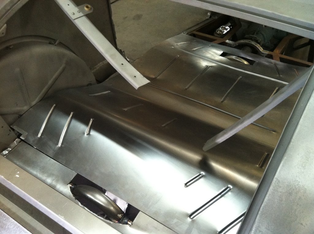

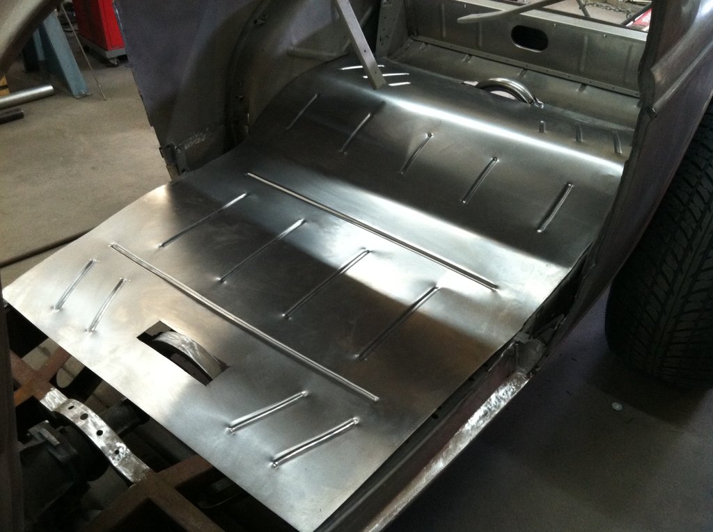

    Josh is laying in the floor today. He started with flat sheet and then used a marker to lay out where he wanted to roll the stiffening ribs in with a bead roller. The two hoops showing through the slots will have a blister formed for each and then added secondarily.
    The second picture really shows how naked the jambs are without the wood, covers and hinges. PATIENCE...they too will come. smile

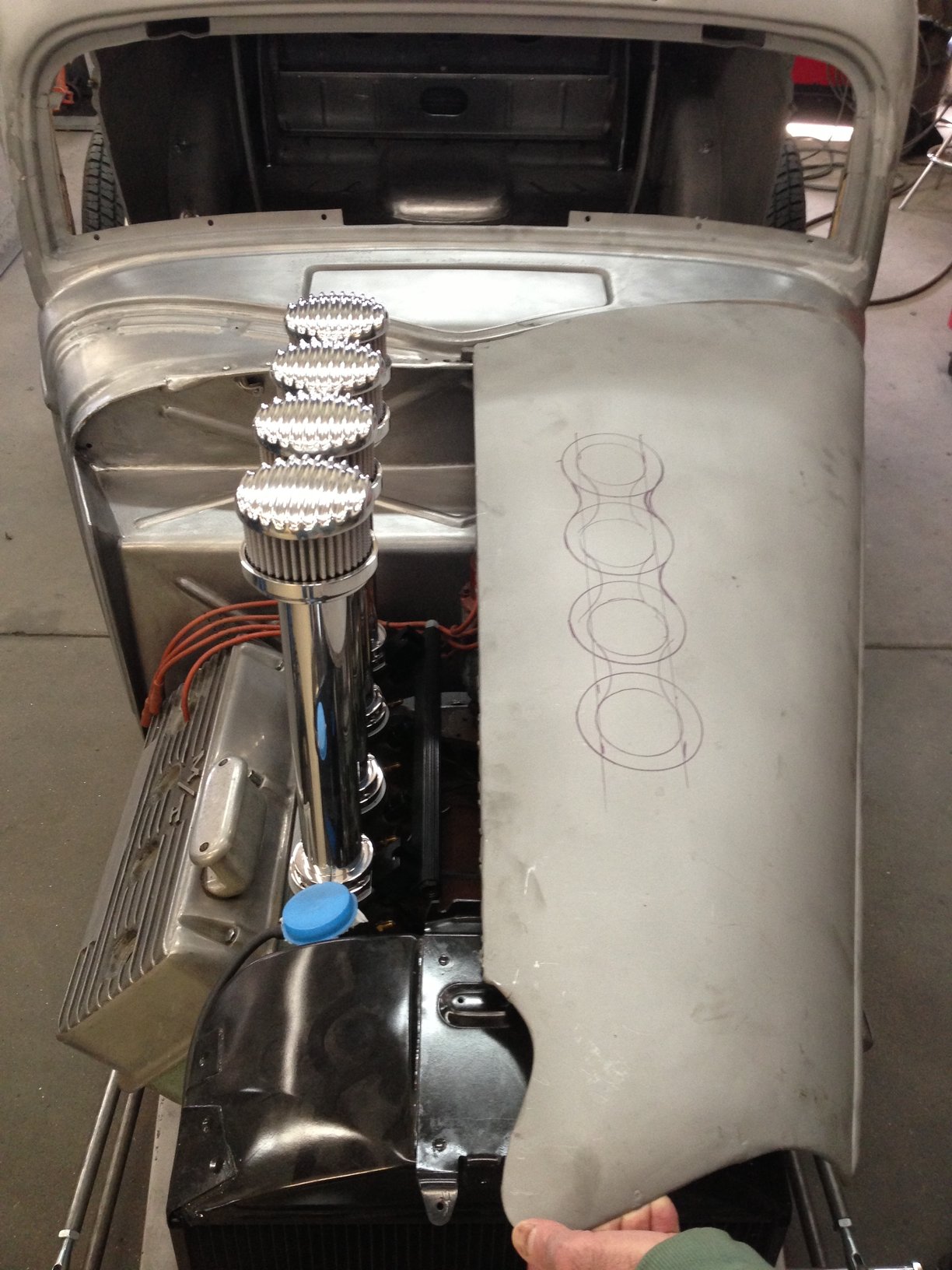

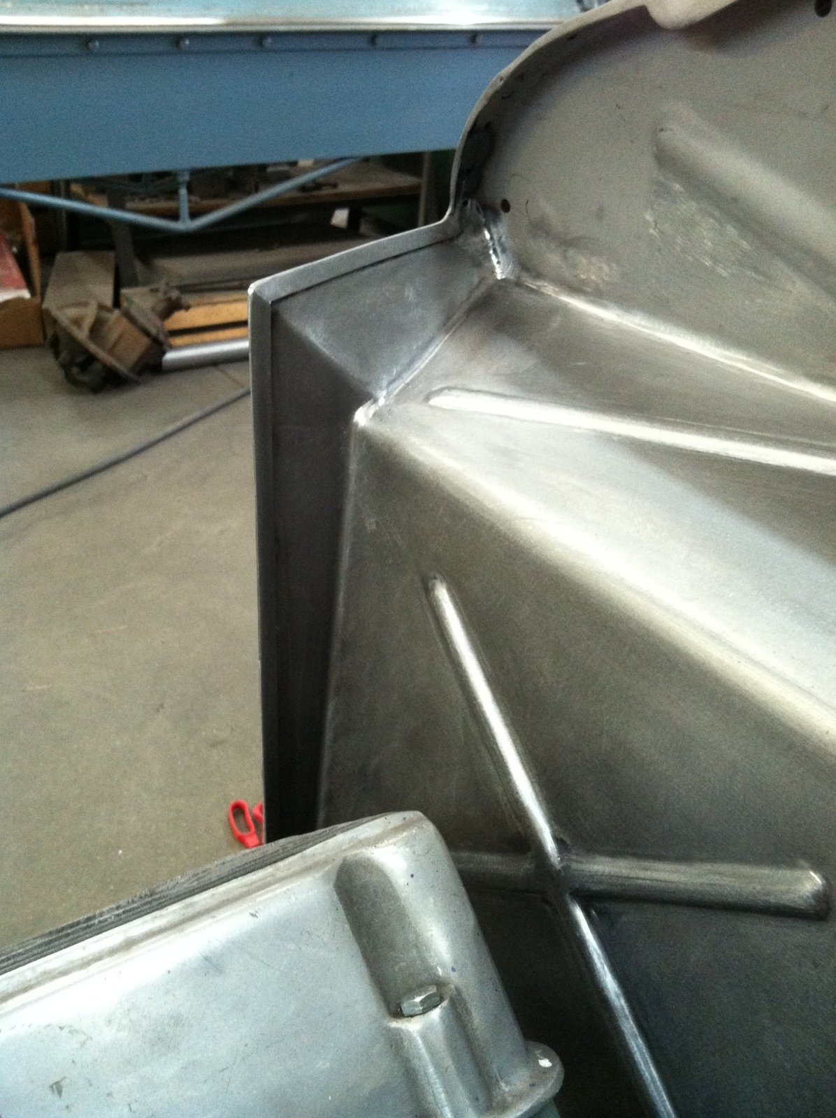

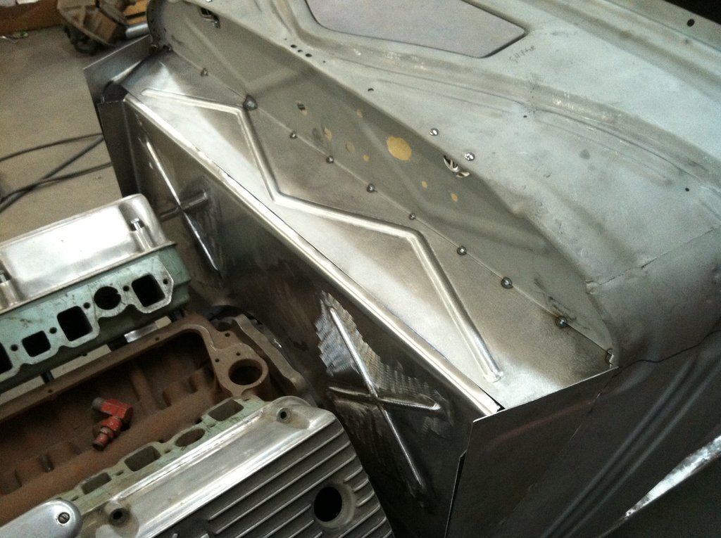

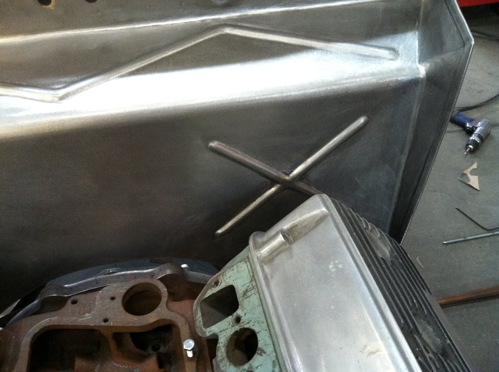

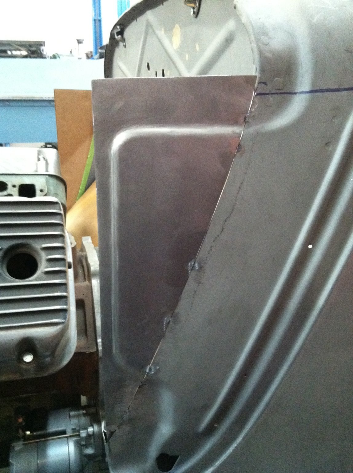

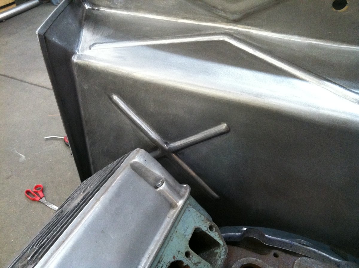

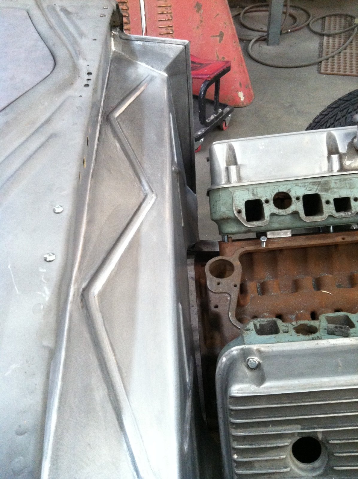

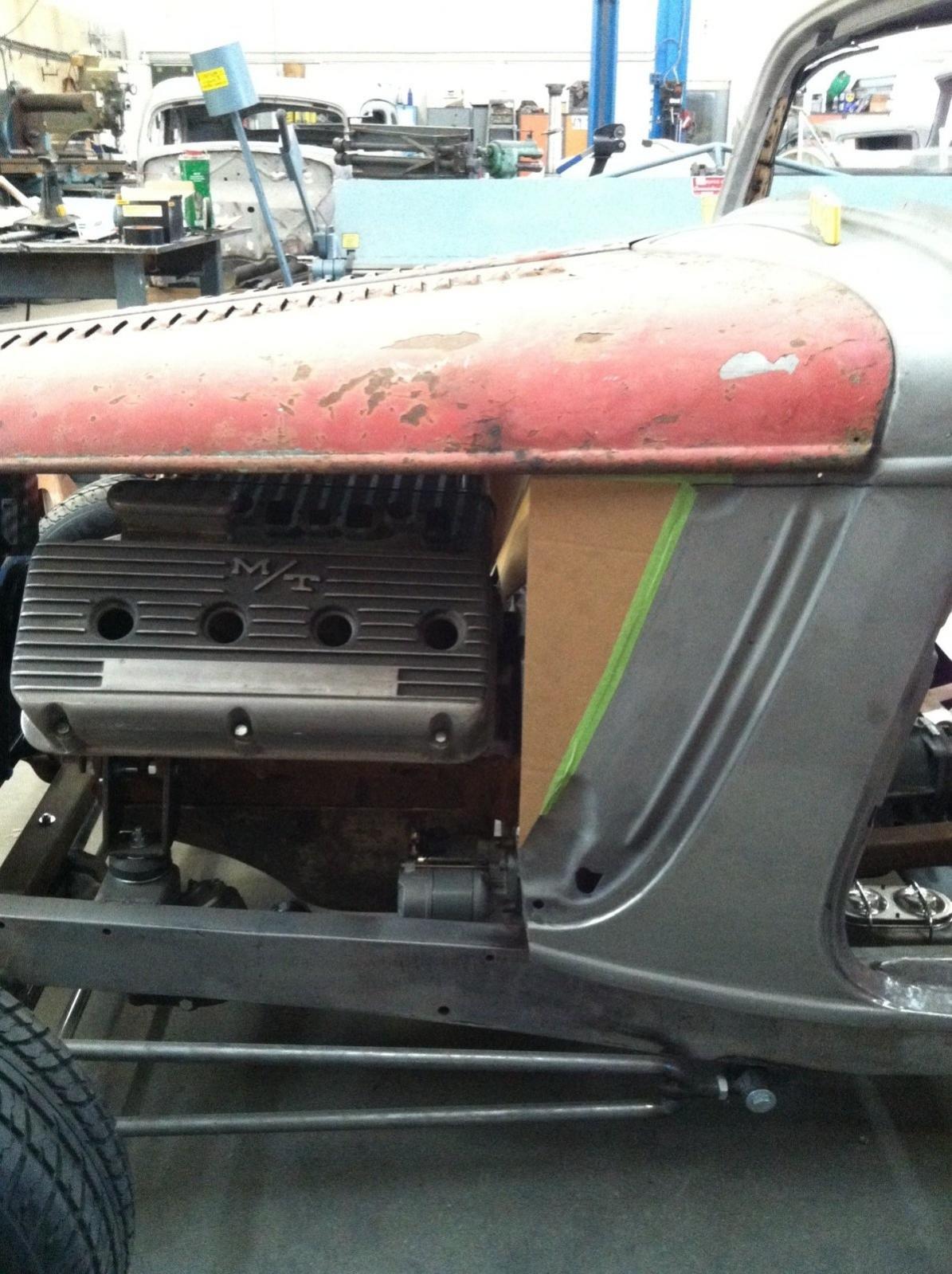

    Josh has made a lot of very good progress with the cowl extension replacements as well as the fabrication of the firewall and upper firewall shelf.
    Please note the JOSH inspired reveal lines that pick up at the factory line on top, go around the perimeter of the new panel and then tie back in at the bottom. It Looks like it came that way! We have decided to fill the lower cowl hole even though some might complain about losing the original look. smile
    Pic 1 is the card board mock up.
    Pic 2 is the flat panel and bead lay out from Josh's inventive side
    Pic 3 is beaded and tacked in place
    regards,

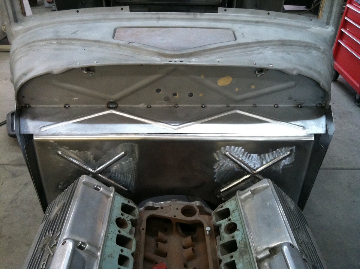

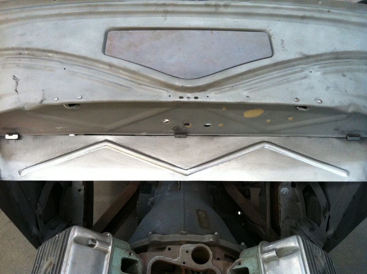

    Please find the following pictures of Josh's progress on the firewall and cowl extension replacement. We discussed leaning the firewall ,(new vertical panel) backwards to the original firewall that was left.(after cutting out for engine/ ****** installation) The decision was made to provide as much under dash room for a heater as possible and go completely 90 degrees with a return shelf. The mirrored beads on the new return shelf mimic as much as possible from the original design. The return shelf actually looks like it belongs and that is key to pulling off changes without destroying the car. Josh is at his best when he gets to create. smile . I am particularly pleased with the last picture as the hood covers up the top of the cowl extension and yields a nice clean profile. NICE JOB JOSH!
    regards,
    George

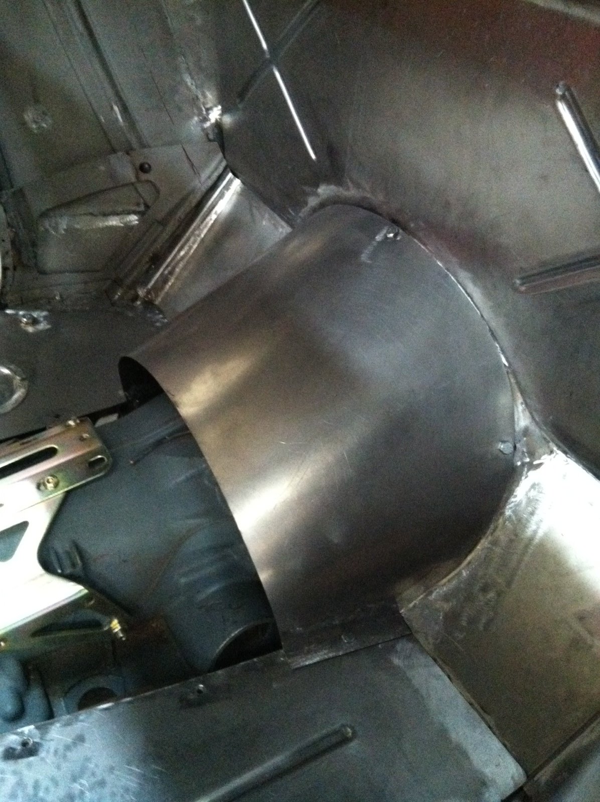

    Please find the attached pictures of the firewall install progress. There is an enormous amount of labor in running all the seams with the TIG and then finish grinding. Not quite there yet...but Josh has it looking good and moving forward.
    I have been out of the shop for a week and looking forward to time working on the Hemi this weekend. I also plan on taking a drive up to Custom Auto Saturday morning to bring an EFI set up with Ram Tubes for the guys to have for setting up and cutting holes in the new hood. FUN.....very. smile.

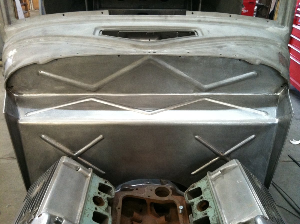

    One last picture of the COMPLETED firewall. Way to go Josh. Great work!

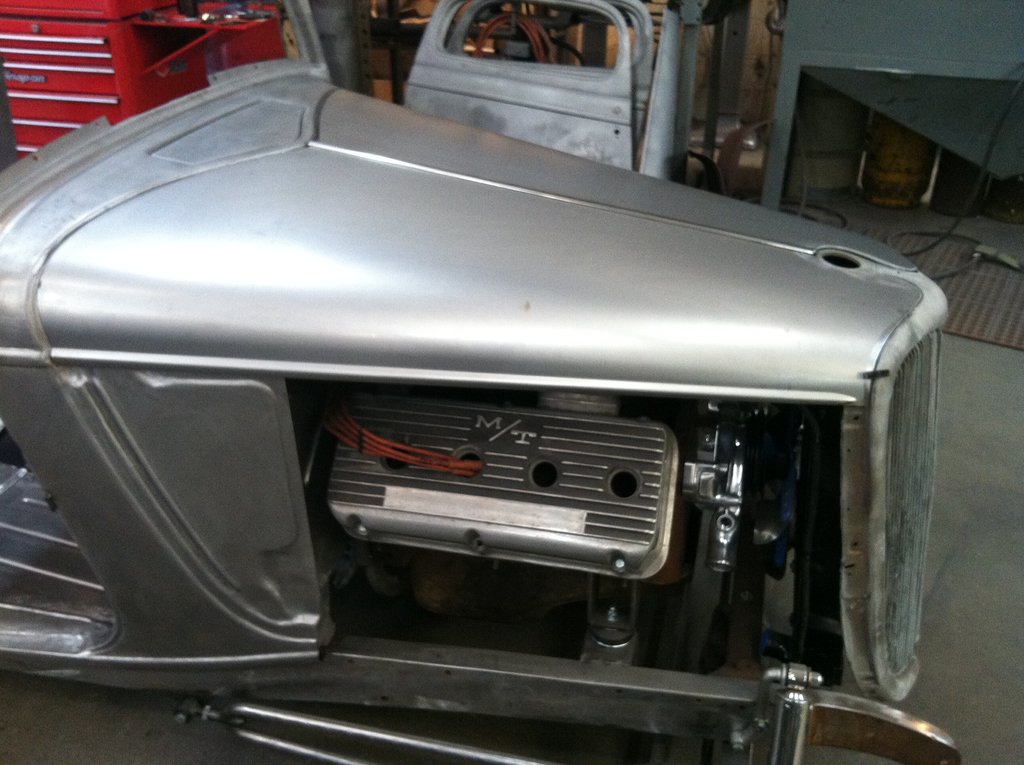

    Saturday was a fun play day with regards to "Let's see?" Pete , Bob , Nick and I met for breakfast before driving up to Loveland to visit Custom Auto's Rex and Josh.
    Let's see how the ram tubes will work with the hood? Way too tall, but the plan was always make them long and cut them down to the desired height later. Definitely going to keep all of the tubes the same length for cylinder to cylinder tuning. We are going to start with a desired height at either end of the row, front or back and then keep all tubes the same height in order to keep them parallel to the heads and NOT the hood. The pictures are for getting an idea of how the two planes compare. ( ie: hood vs breathers). Note: we only used one EFI side to enable putting half of the hood on to see the profile and also discuss cutting holes through the hood that will allow the breathers to protrude.
    Let's see if the pretend knock off's will mount? Well they wouldn't go flush as the lug nuts were too long with the acorn tops. We cut one lug down on a grinder until we got an acceptable height and then I took the sample one home and turned the rest down to the correct length on my lathe. We also played with a little art to have engraved on the wheel centers. See the crown drawing stuck to the rear wheel center.

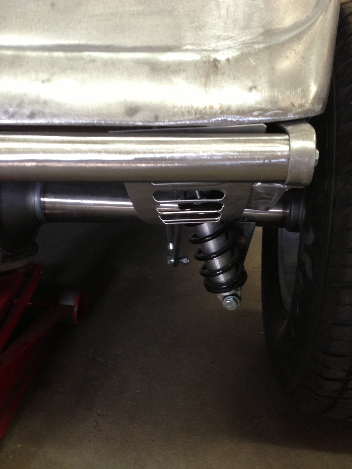

    Let's see how the rear roll pan might look louvered with a standard single sided louver vs a double punched louver? The double punched louver shown in the picture below is DEFINITELY the decision for the roll pan under the rear spreader bar. You can see through the louvered sample just enough to be visually nice while letting the air come on through the pan. The single sided louver just blocked the air flow without doing a thing.
    If you have never seen a double punched louver, just imagine one louver punched and then turning the panel over and punching another louver on the opposite side of same center line as the first louver. The result is twice the air opening. In the case below ,..it is perfect for both the function required as well as the aesthetics gained. This idea is from Bob Padilla in Pueblo, Thanks Bob!

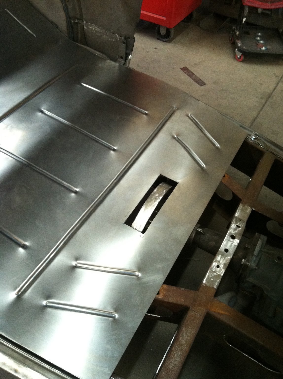

    Some more progress pictures to share from Josh....

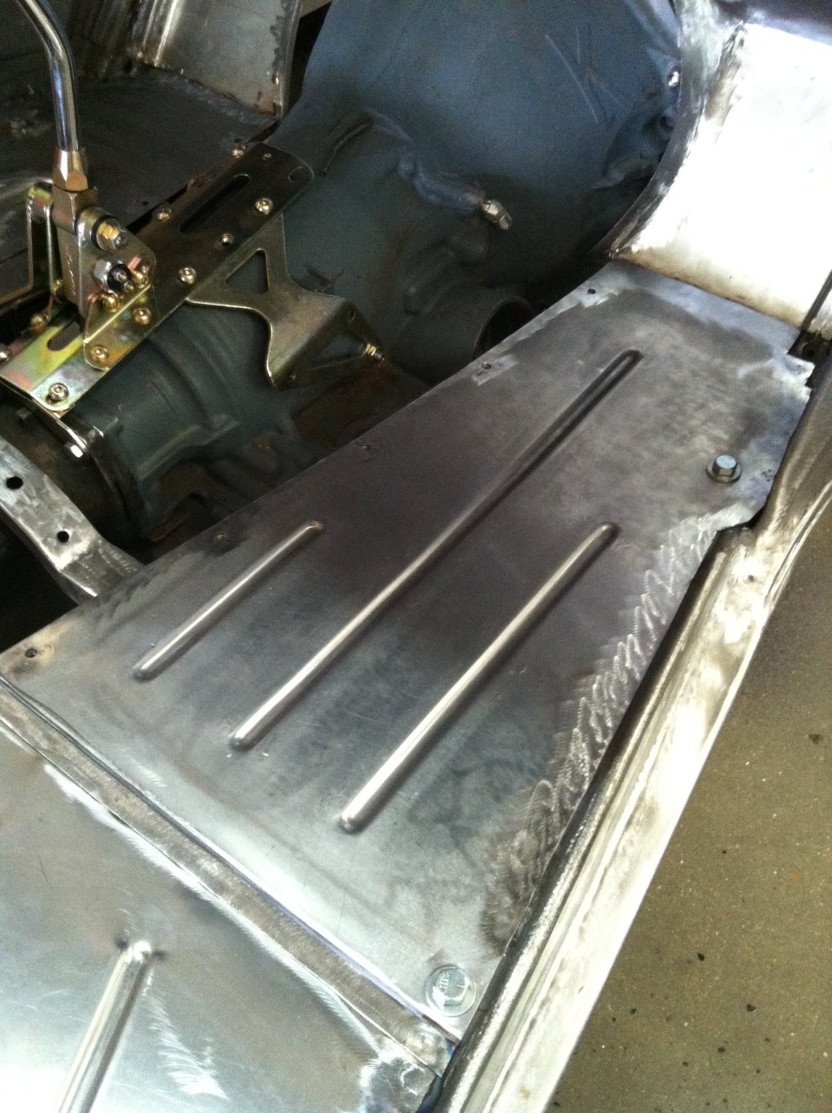

    Left floor board with access cover to the brake master cylinder
    Right floor board

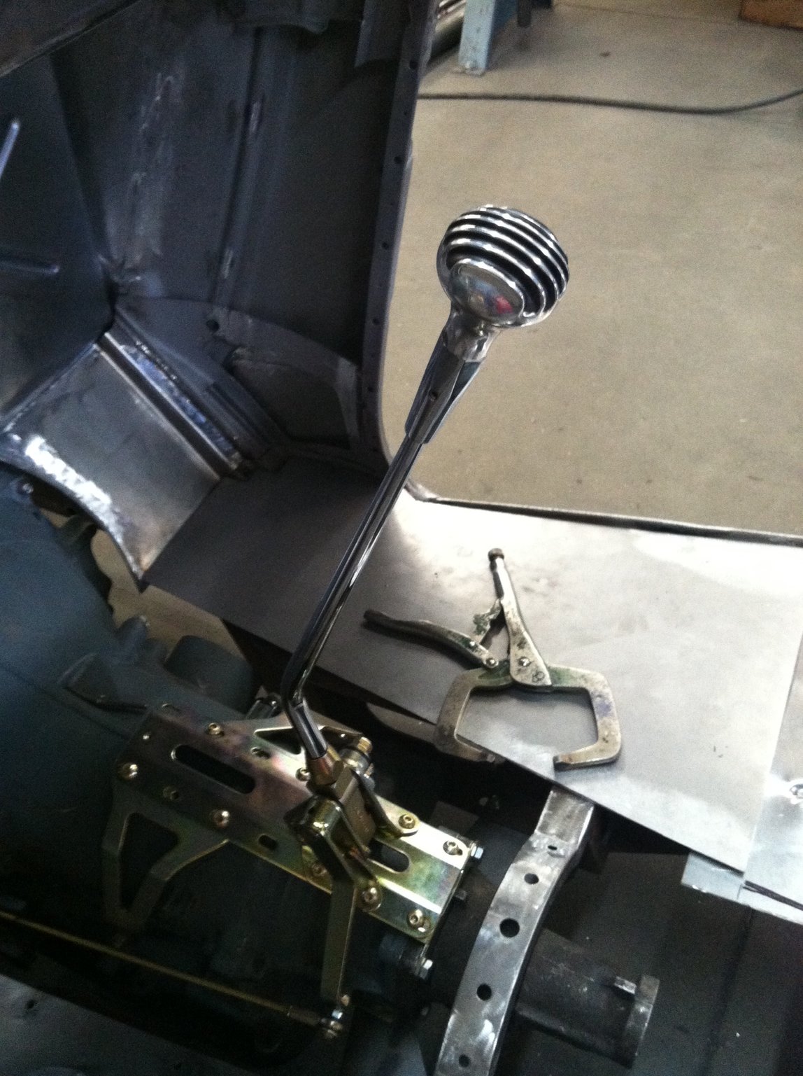

    Shifter installed to enable center sheet metal fabrication with shift indicator. I bought the knob from OTB and painted the inner fins.

    I know you guys will not get too excited....BUT just the same...here is today's start by Josh on a ****** cover. IT HAS TO BE REMOVABLE TO SERVICE THE ****** and that makes the effort a little harder.
    The cover will have a Lokar shift pattern/ gear selector indicator mounted on it. It's time to start thinking about a gas pedal and the foot well is very narrow because we moved the engine up for ground clearance when dropping the front end to get more rake. rhut rhro....LOL, sometimes it's hard to get want you want, without giving up a little something elsewhere.

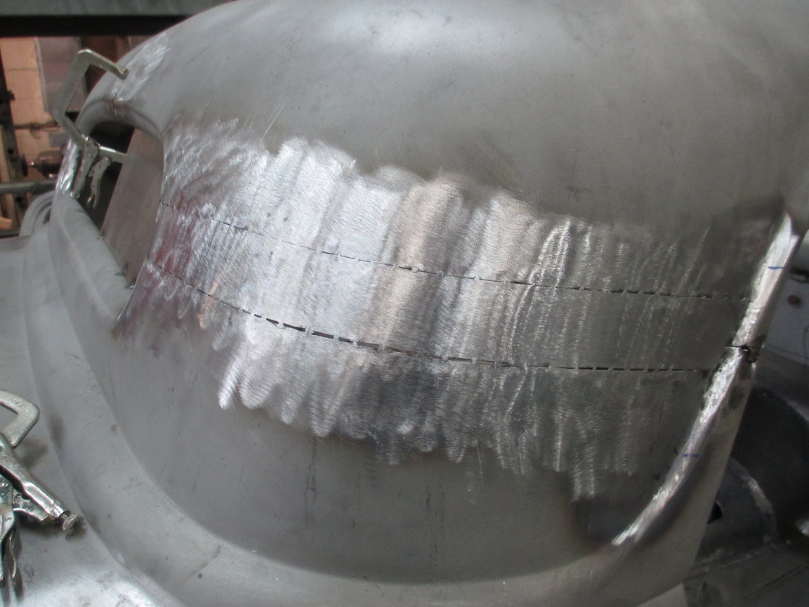

    More roof progress...almost ready for the louvered insert. The right quarter roof was 1/4 inch lower than the left and the rear window opening had a resulting off set. Josh cut the quarter roof off and raised it up by inserting a new wider piece of steel where he cut out the leaded original chopped seam.
    The attached pictures are of the ALMOST final repairs... The drivers side still needs more work in the reveal.

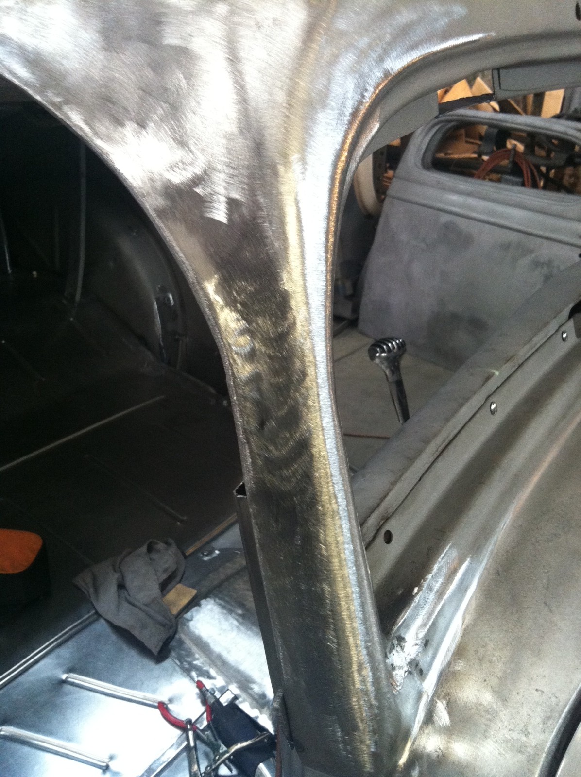

    I hope you guys aren't tired of "pretty pictures" . Josh has cleaned up both A Pillars as well as the windshield opening. I think he was dreading the Drivers side reveal and has been putting it off as it will be a bit slow and tedious. smile.
    But, such is life. He has a personal goal of getting both roof sides finished by tomorrow evening. Josh is doing excellent work and I appreciate the results. I will be driving up to Loveland Saturday morning with Pete to pick up my left over Ford 8 inch and my waterpump with adapters. I will bring home the pump and put it on the 392 to get a belt size measured up and have one more little thing completed. Pete is going to take the 8 inch and keep it as a spare for two of his rides.

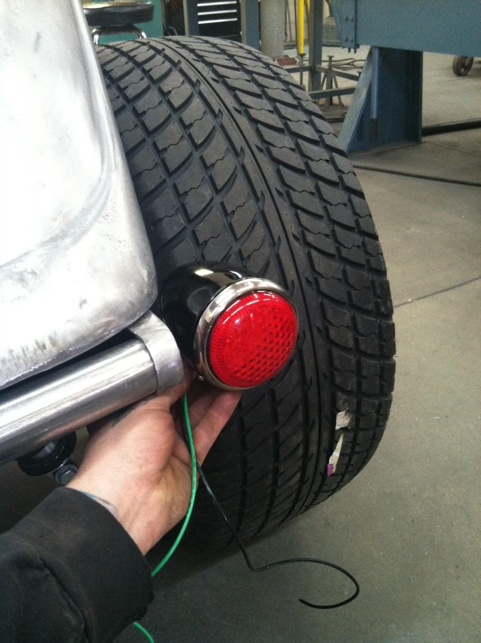

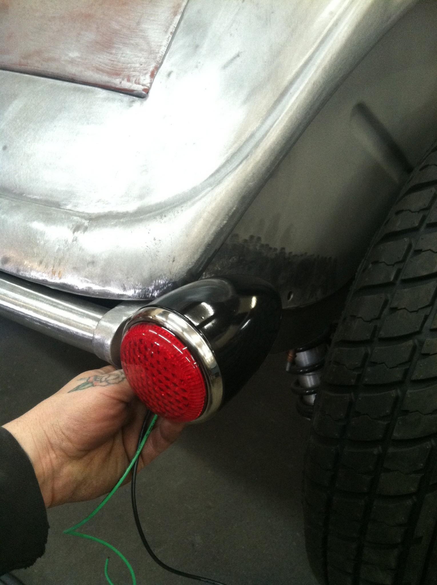

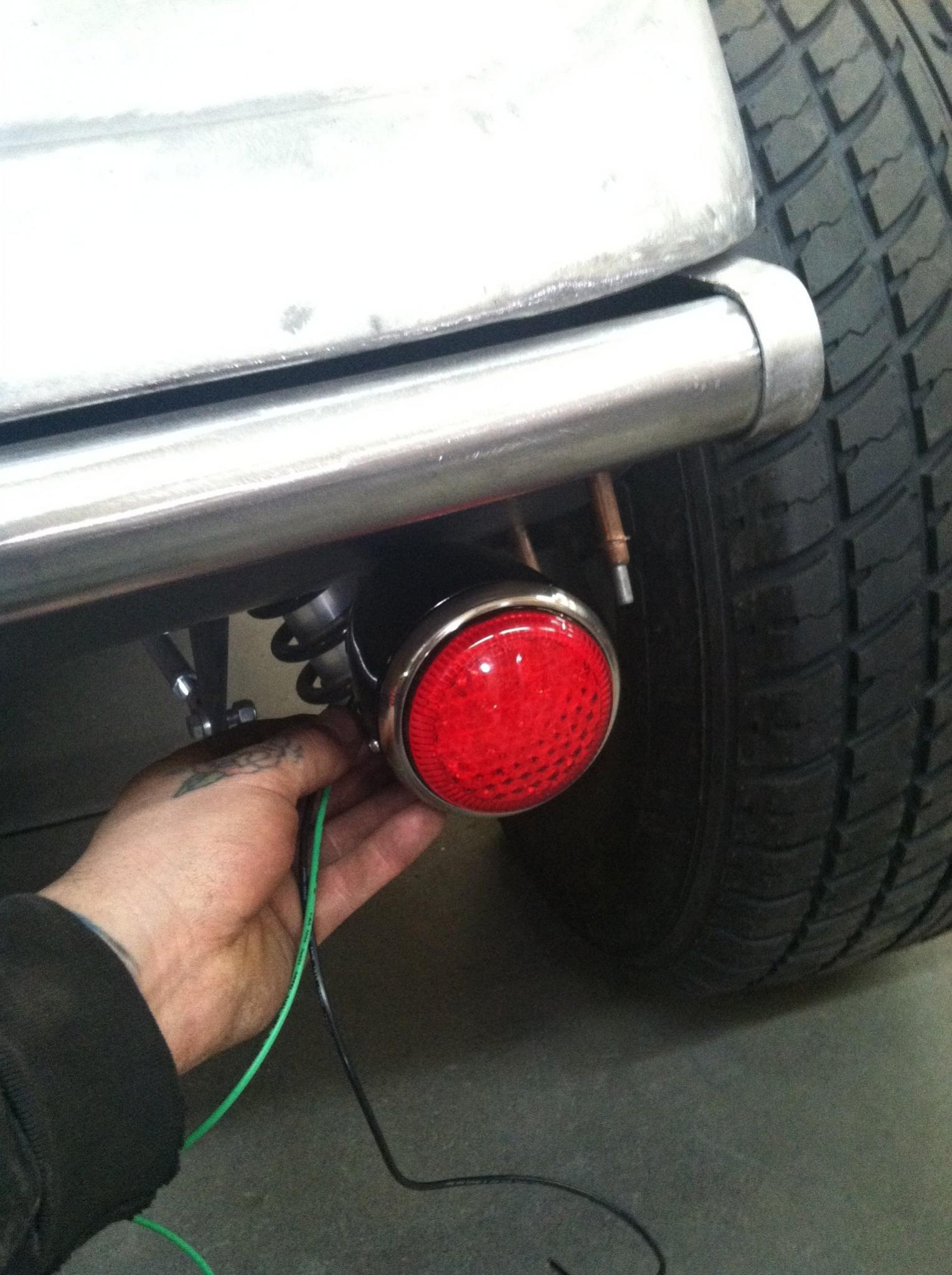

    Please find the attached photos of a 37 Ford tail lamp and "thinking out loud" on the possible ways to mount it???? I really prefer a 34-35 Dodge tail lamp as it is shorter and a larger diameter. But, I dont have a clue on where to pick up a set? If you have them, please contact me off line.
    Any feedback on the pictures will be most appreciated. If we went with the under the spreader bar, the housing would need to be sunk back into the tail pan to make the lens be further set back about an inch.

  30. PRIMER STUDIO
    Joined: Nov 13, 2006
    Posts: 1,245
    PRIMER STUDIO
    from Butte,MT
    I think it would look killer under the spreader bar. Always loved that look.
