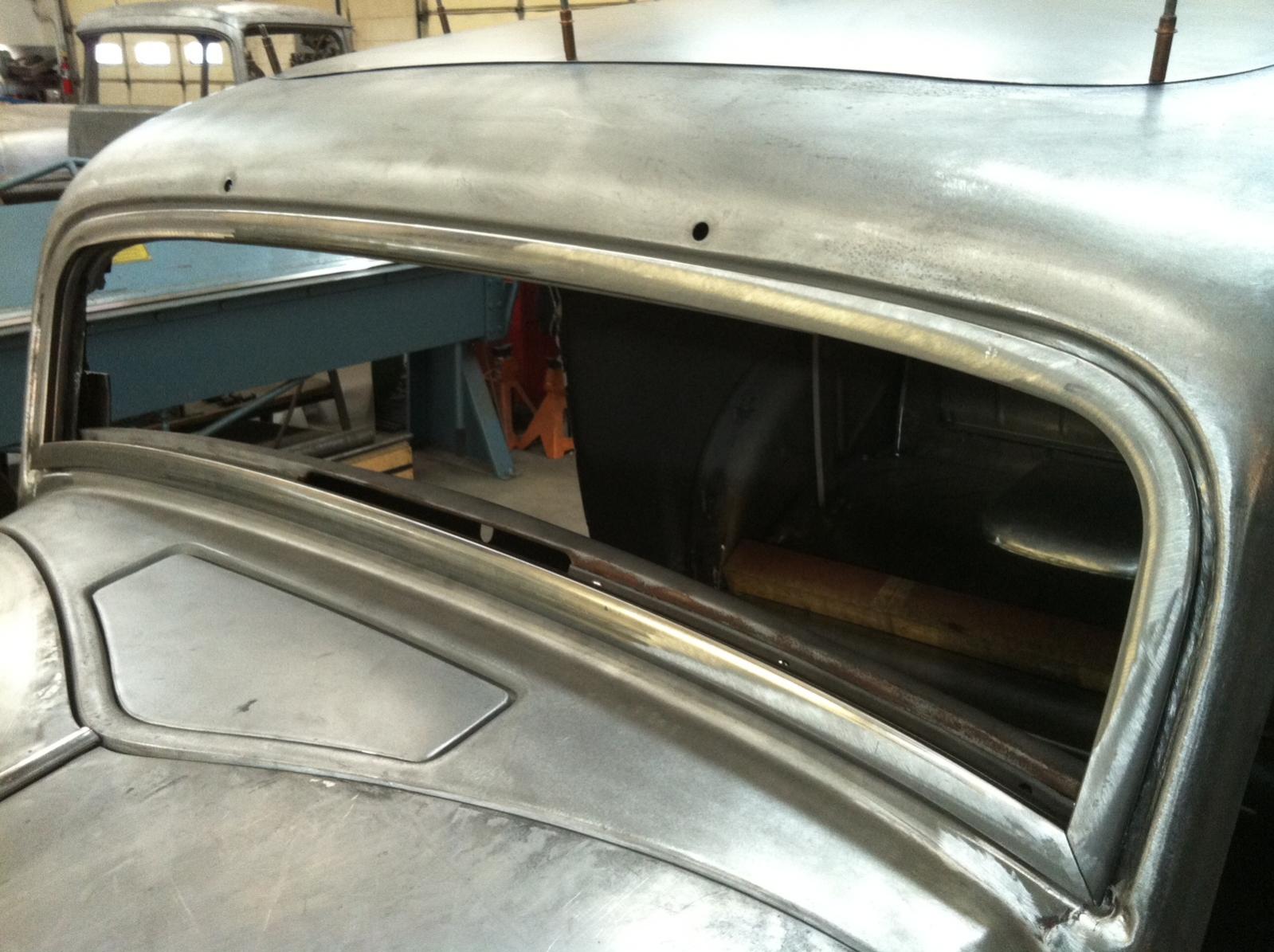

    Even sweeter is that Josh has the entire roof chop rework completed. The Walden insert is ready to be laid out for louvers and HOPEFULLY we will get to go see Bob Padilla in Pueblo to have the louvers punched in both the insert as well as the deck lid soon.

    Josh has the windshield frame chopped and looking like it will fit. smile

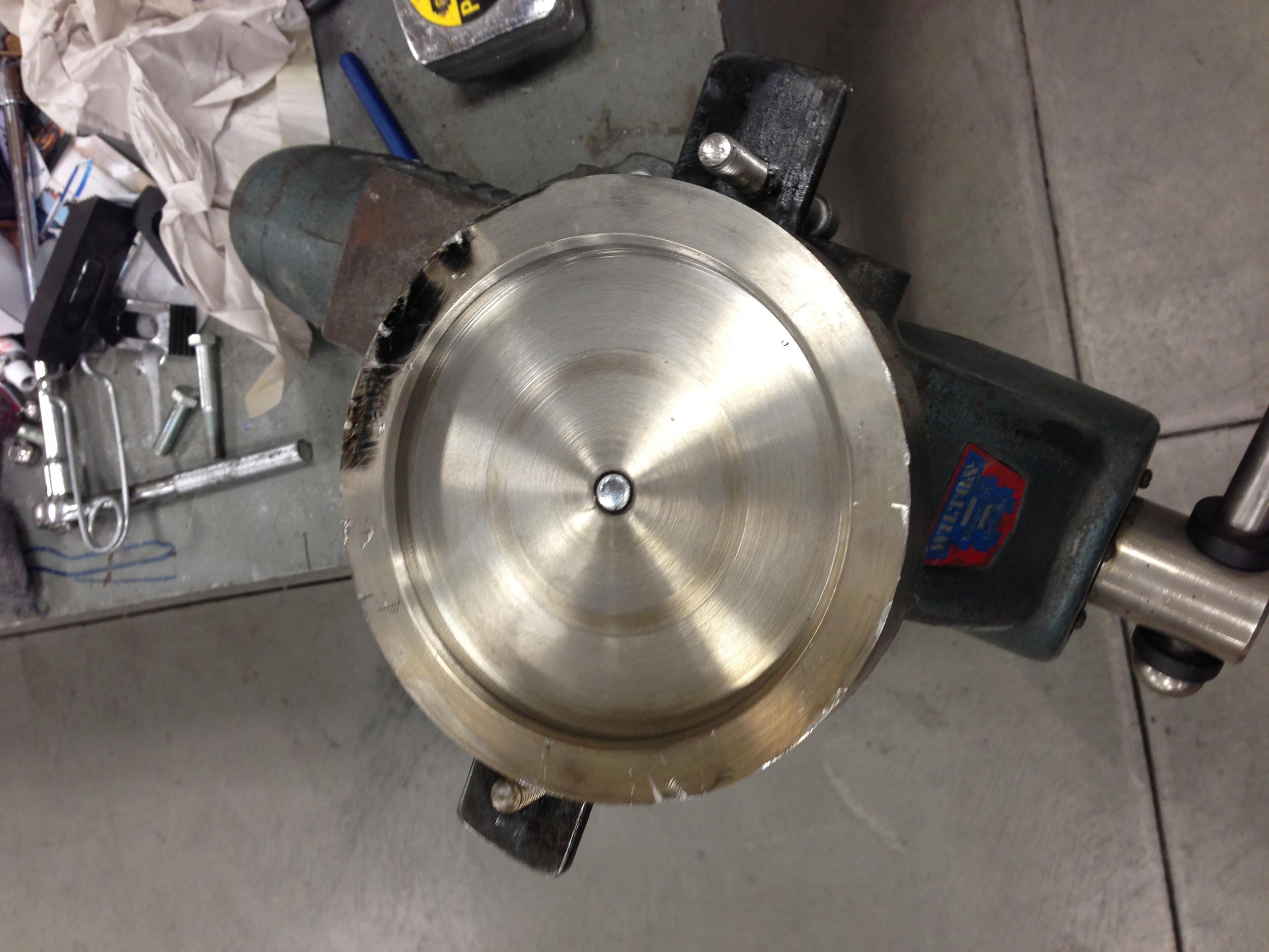

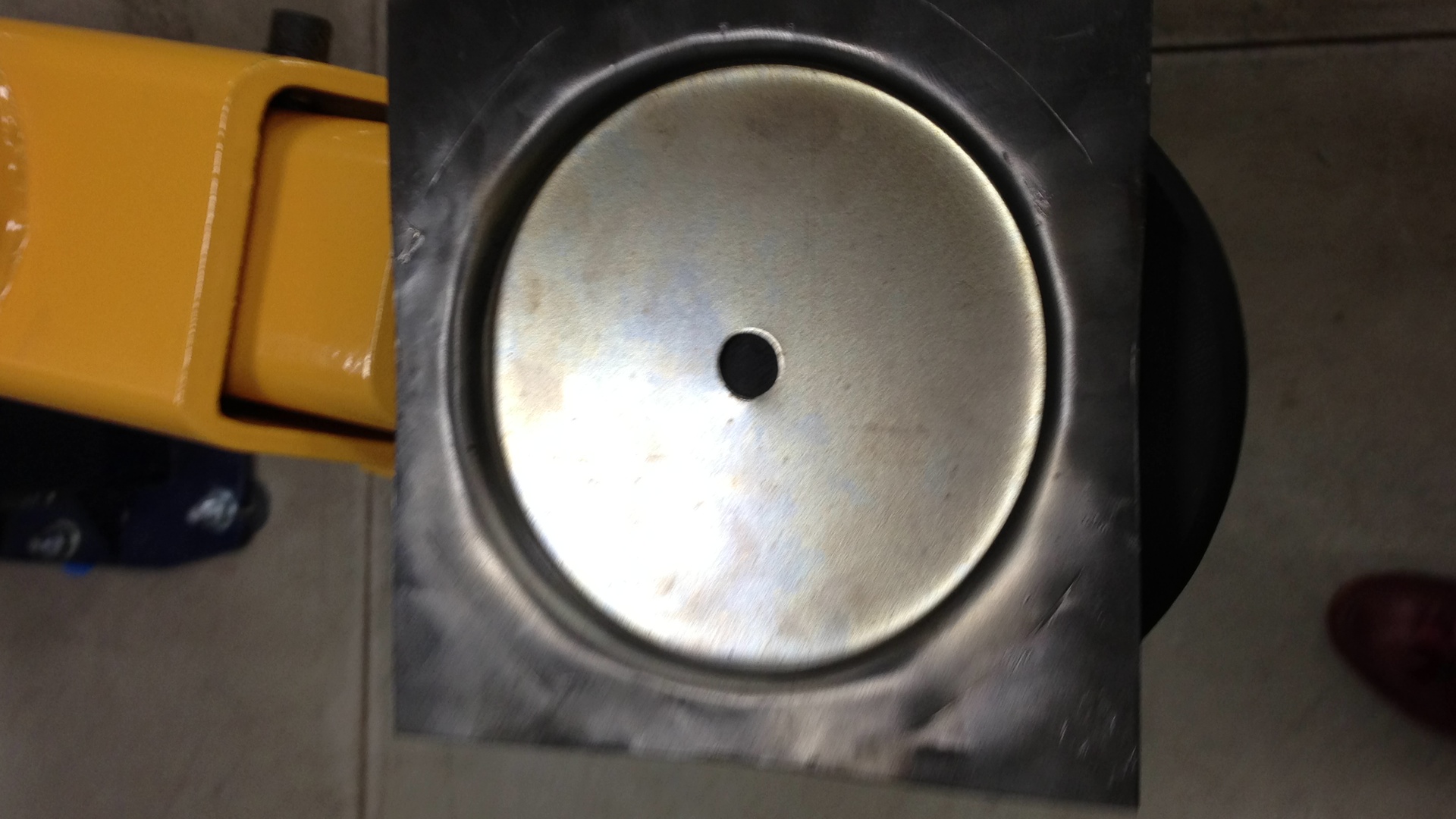

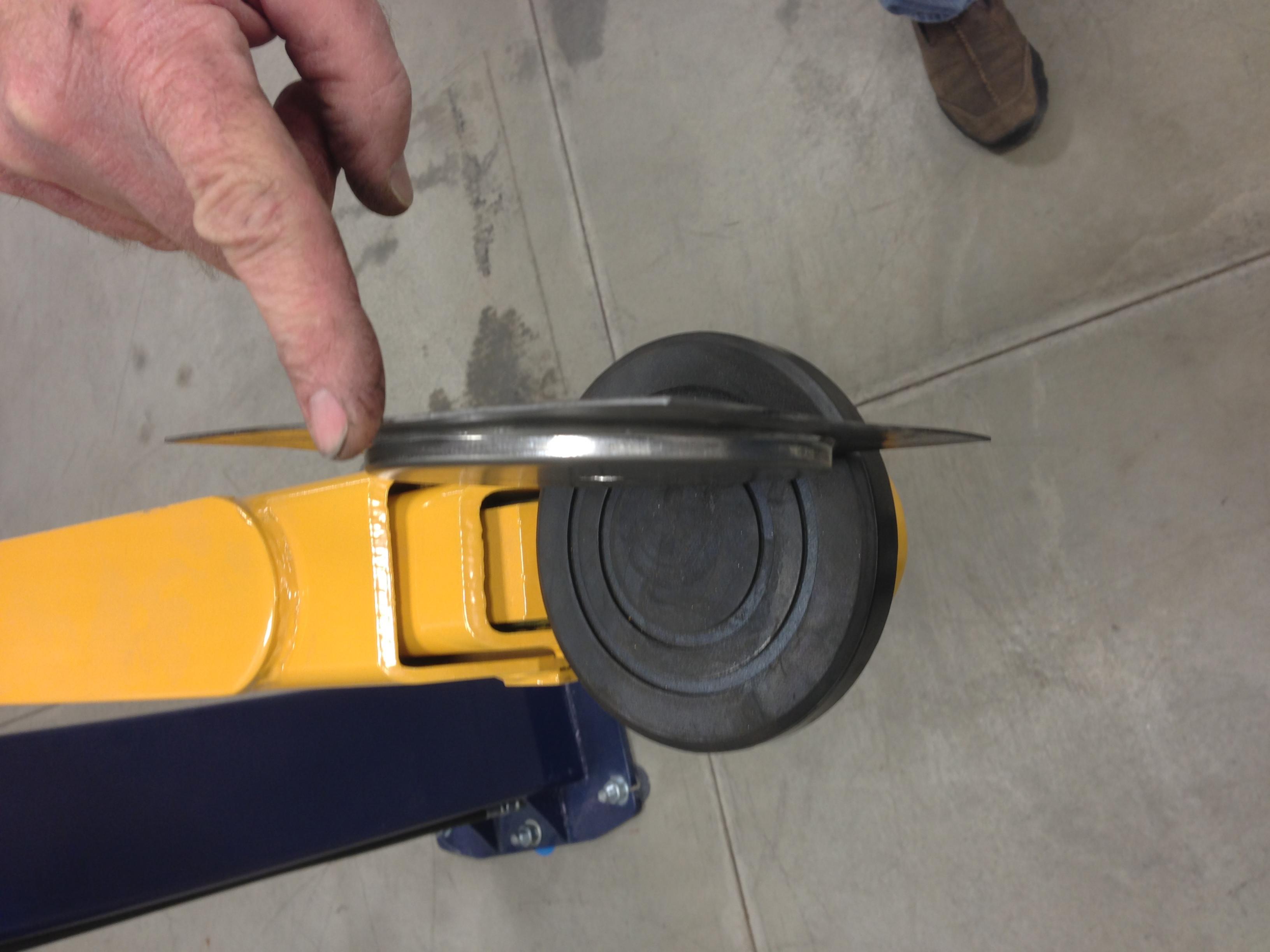

    The fuel cap ( pictured above in the post from Rex) is 4 7/16 inches diameter with a 3/8ths inch flange height. I would like to sink this flange into the upper quarter panel rather than to flush mount it.
    In an effort to make the recess required , Nick "Fatkoop" and I played tool and die/ machinist's last night. Nick dropped in a little after 6pm and we spent 5 hours machining upper and lower dies that are male and female to emboss a circle into a panel which will be inserted by Josh into the Coupes Quarter.
    We chucked up, 6 inch diameter round stock blanks that I had on hand for hammer forms on the 48 coupe head light buckets. The steel was very good quality and machined nicely. I had made up a drawing for a 4 5/8 DIA male die and a 4 3/4 female DIE to sandwich a blank in. We decided to form the blank by putting the stack into my press brake and squeezing the sandwhich together.
    We checked out dimensions, fiddled around and adjusted here and there. We added a half inch bolt in one side with a clearance fit on the opposite side to keep everything all centered up and we were ready to make the part.
    We lowered the press brake a little at a time and carefully got the stack fully pressed together.
    All smiles...ummmm???? UNTIL ,...it would not come apart???? A long story short , lot's of RUBE GOLDBERG effort, heating , banging , prying etc. etc until we finally got one side of the sandwhich off and then had to pry the part off the other side.
    Pictures attached.
    The blank needs to be either circular or much larger to prevent uneven pulling of the material as it is pressed into the dies. If you look at the last picture, it shows the part has 8 distinct inner surfaces. ( 4 round and 4 slightly straight) The picture from the edge shows how perpendicular the sides are and why we need to add a couple of degrees of draft angle to get the part out of the tool. Last but not least, I need to use a different steel. I will get some draw quality 19 guage for the effort. The 18 guage is just a little too much, PLUS, it is very stiff to work with after the forming. Nick and I are planning on getting back together tonight for cleaning up the dies before doing a little more developement on them. It was a super fun effort and I really enjoyed the fun of making a one off part with my friend. Thank you Nick.
    I will post a few more pictures after we wind up the effort.
    BTW, the part in the last picture WAS, repeat WAS really beautiful until we had to beat the heck out of it to get it out of the DIE. smile.
    Regards,
    George

    No problem reworking the dies tonight and trying a square. ( NOPE!) and then a circle. NICE.
    Now all I have to do is wait on the AK Steel that is on its way from the TIN MAN that had a little extra. smile. ( Thanks Dan!) The AK should eliminate the need for me to flatten tucks around the flange.

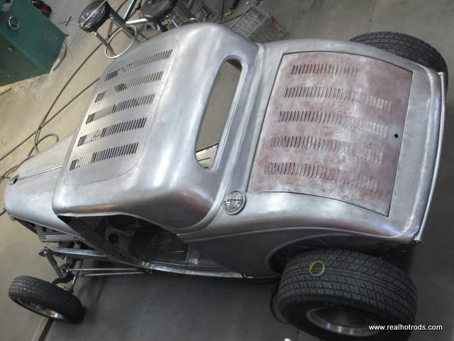

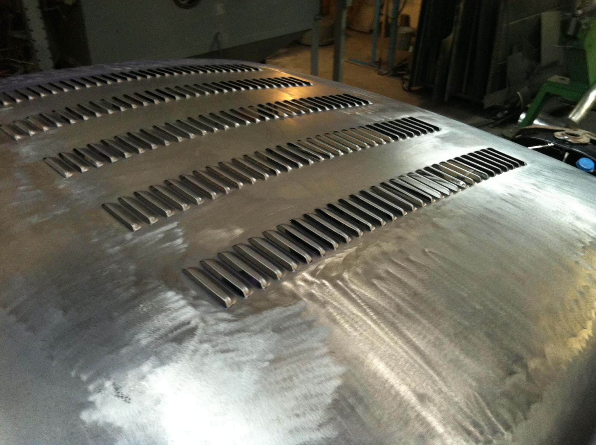

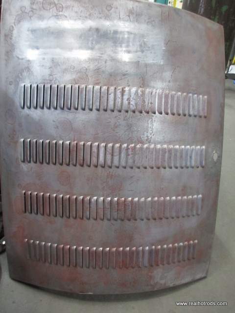

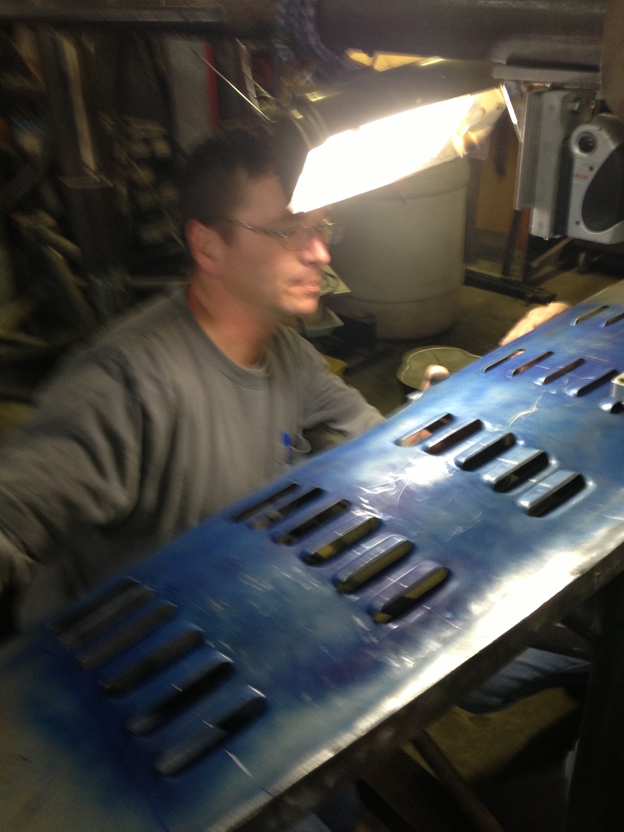

    Saturday was louver day for Rex, Pete, Nick and I. We all drove down to Pueblo to see friends for breakfast before going with Bob to his garage to press some louvers. The deck lid has 145, roof panel 150 and tail pan 29 for a total of 324 louvers.Wait! ..we did the tail pan twice for IN and Outs so add 29 again.
    353 Louvers!
    No one was injured in the wreck on the deck lid. smile . We somehow got off the line after pressing 4 of 5 rows. Rex (or Josh) is going to cut out the mistake and replace with a new section of metal that will allow us to redo/finish the last row.
    Please find pictures of the tail pan with "in and out" louvers. Rex will put the parts back on the coupe and send pictures.
    It was a very long and slow process and we didn't get finished until 7pm. The effort required multiple sets of hands to support each panel , center align and then pull the hydraulic lever for a resounding shot gun BLAST noise as each louver was punched. It was a bit un-nerving at first and after a while we just got used to it and carried on without jumping each time.
    I'm sorry I didn't take a picture of the roof panel as it came out very nice!

    Rex couldn't wait until tomorrow and dropped into the shop this morning to lay the louvered panels on the car. He snapped a few pictures to include the prototype gas filler insert I provided him yesterday. You might also notice in the first picture, that Josh has started installing the new wood.
    Rex, thanks for the good company and your help with the project.

    I think we need to add a few more rows along the bottom of the deck lid. We will use a 1937 Ford deck lid handle.
    Regards,
    George

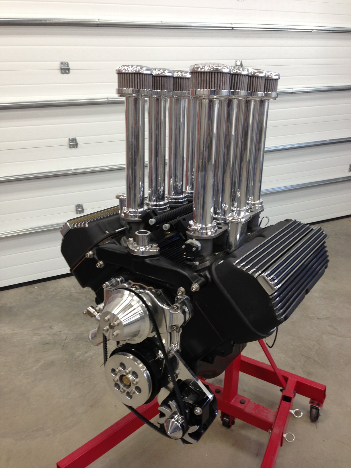

    I am ready to start building linkage and bought a few pieces from Kinsler to get started with. I haven't found anyone for advice with the TV cable so I will round up a few friends and we will go after it!
    Regards,
    George

    last two pics from Josh for today... louvered roof panel install complete!
    I just can not quit staring at the car. smile

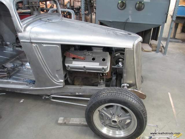

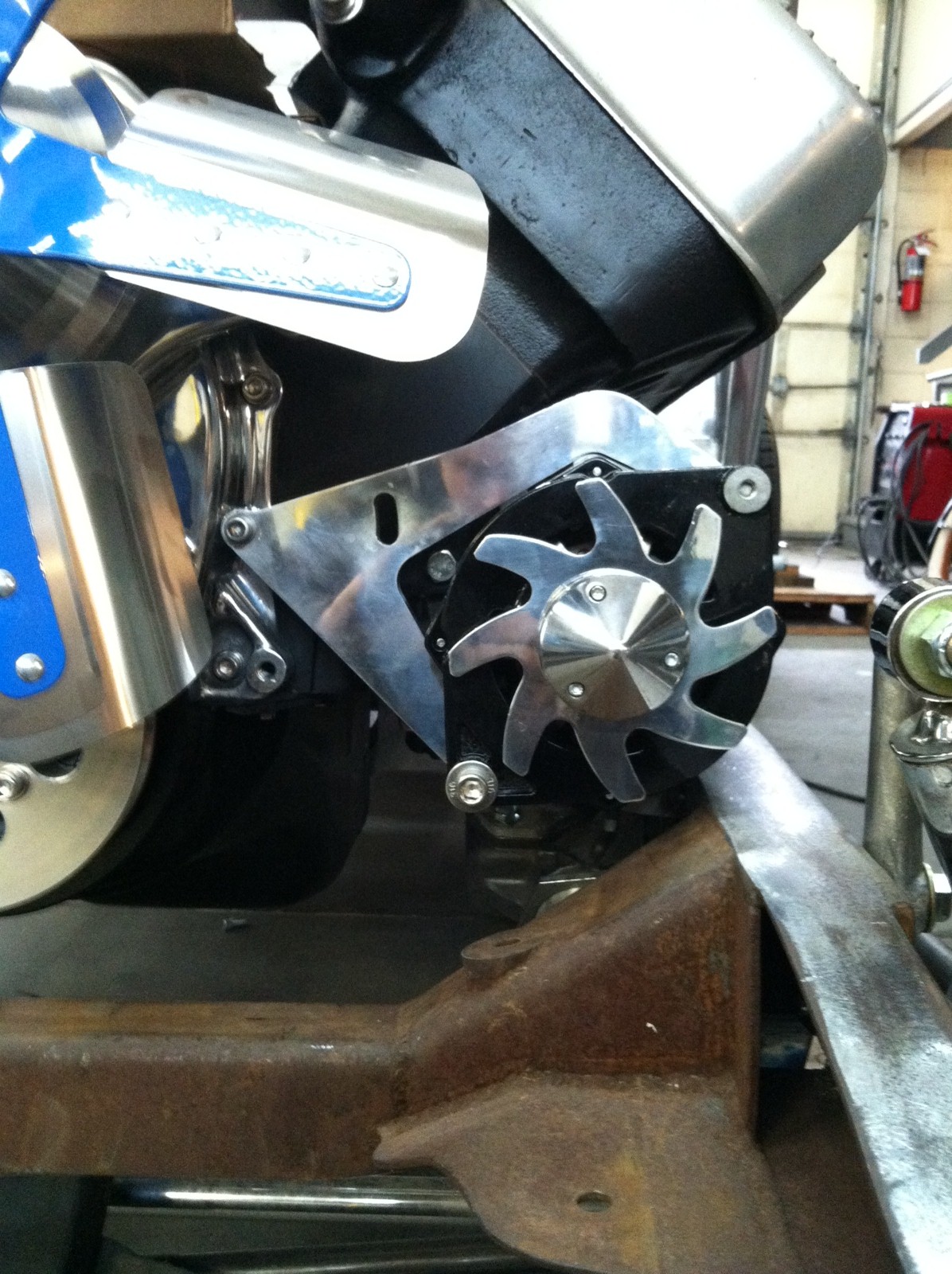

    Josh was able to swap the mock up motor for the real deal today. He is having to take a sheet metal break to mock up the headers and send them out to be manufactured in North Dakota. It is race season, so I am expecting a 6 week turn around.
    Josh had been worried about space for the alternator and he was correct! See attached picture. A fancy bracket, but no room to hang it due to the tight space between the frame rail and the alternator. A pattern will be made and a new bracket water jet cut out of aluminum to hang it near where you see it in the picture. . Yes , I know this picture has the bracket upside down, grin. And the bright blue fan isn't going to stay either. LOL
    A small matter, just a little more detail to be worked.

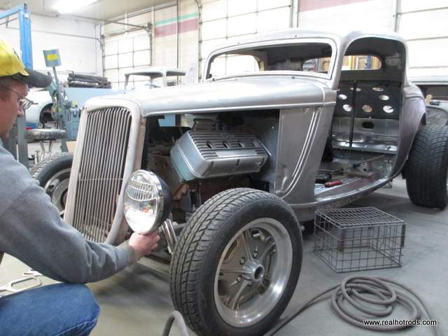

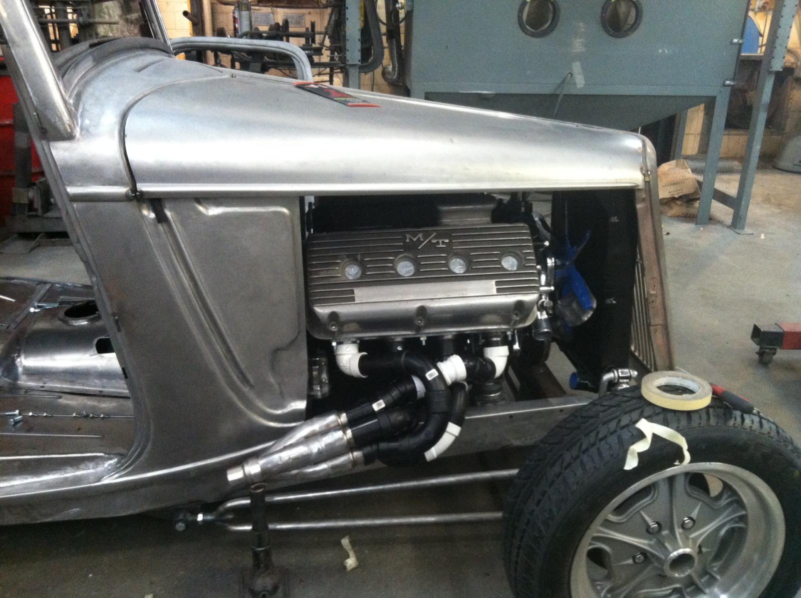

    As Josh and Rex keep focussing on the sheetmetal work, I have been driving things that I can. Drivetrain, seat, wheels and tires, custom design and fab items etc. One of the things I found interesting was the ability to have custom headers made from PVC mock ups. The kit from the manufacturer came in last week and Josh swapped my motor out yesterday to begin the mock up. He had to go out locally and buy more PVC fittings/ pipe in order to get the look we all desire. "agressive".
    Please see the first side mock up in pictures below. I am very appreciative of the great job from Josh.

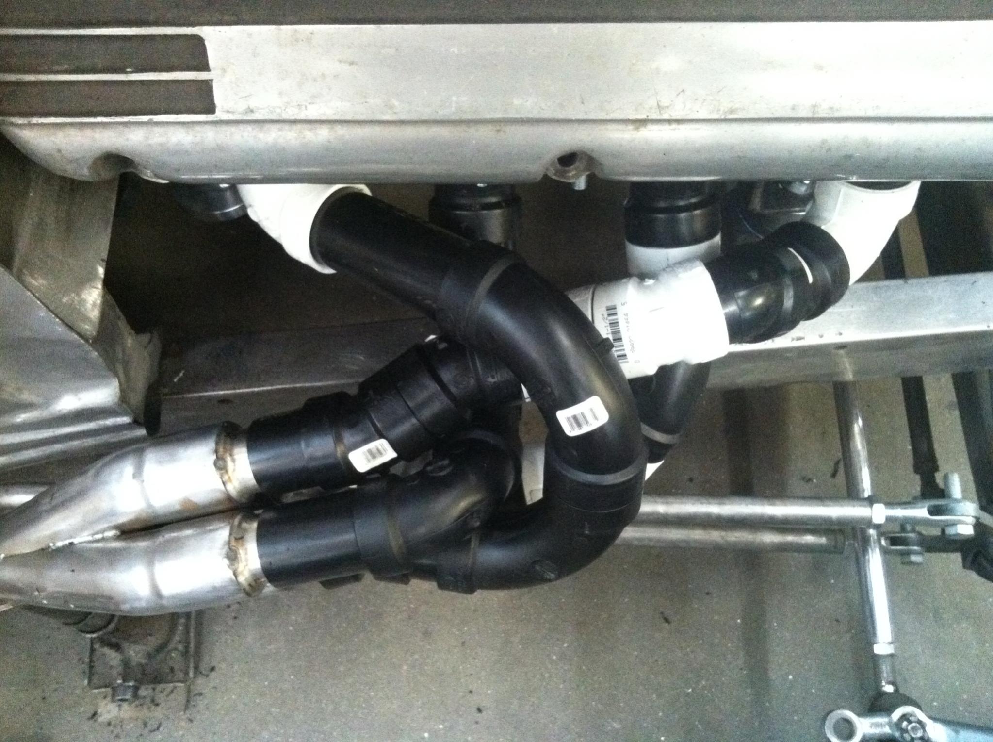

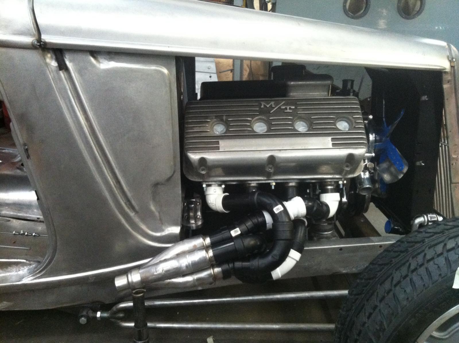

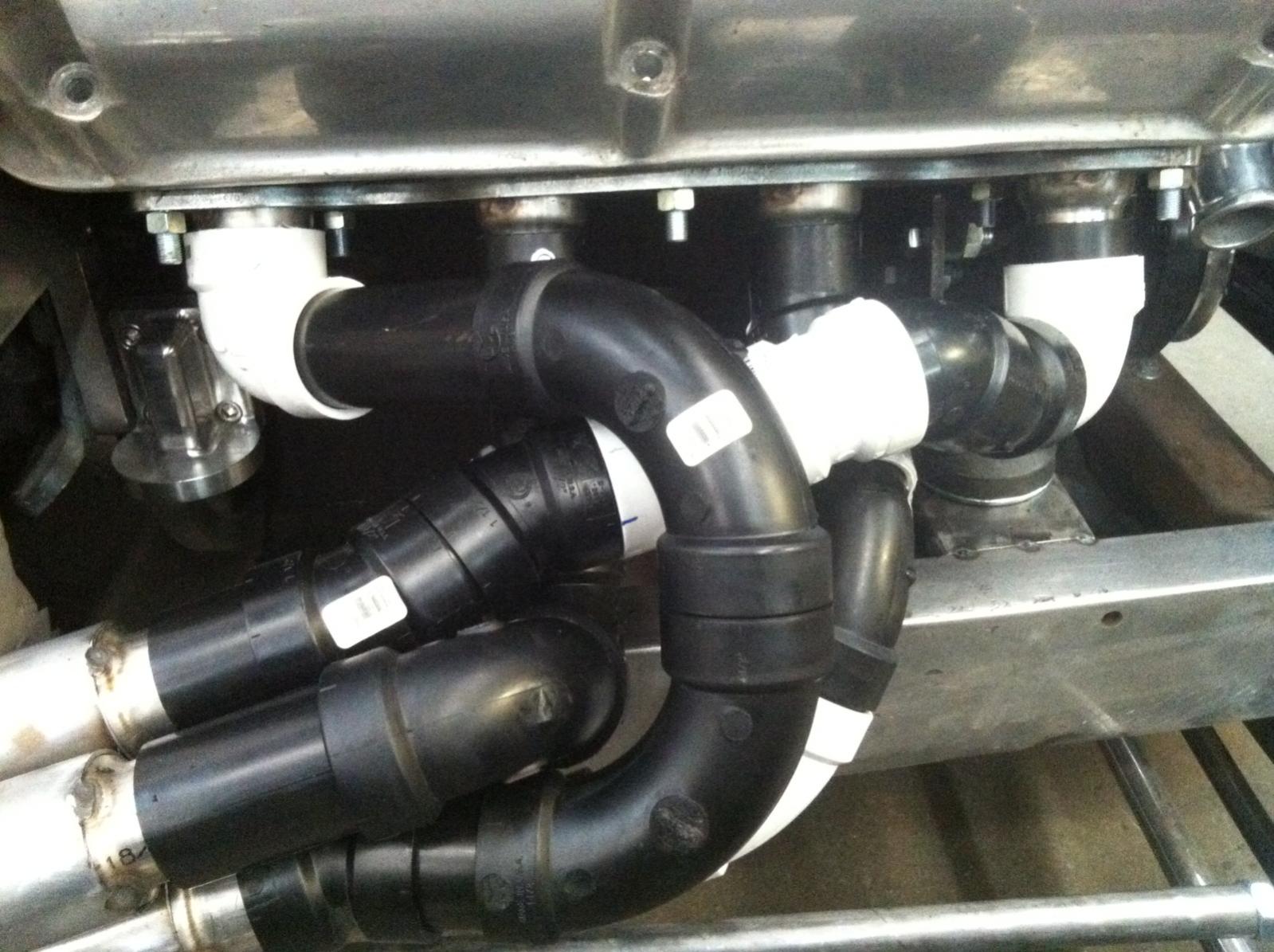

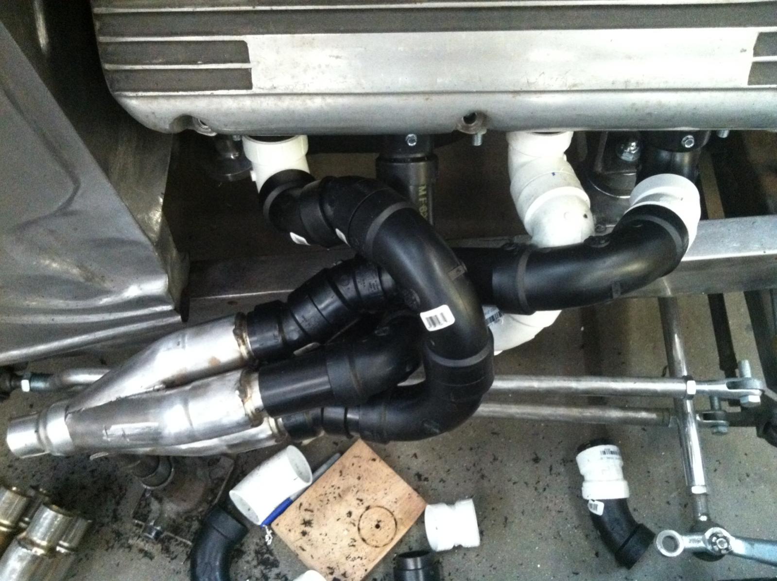

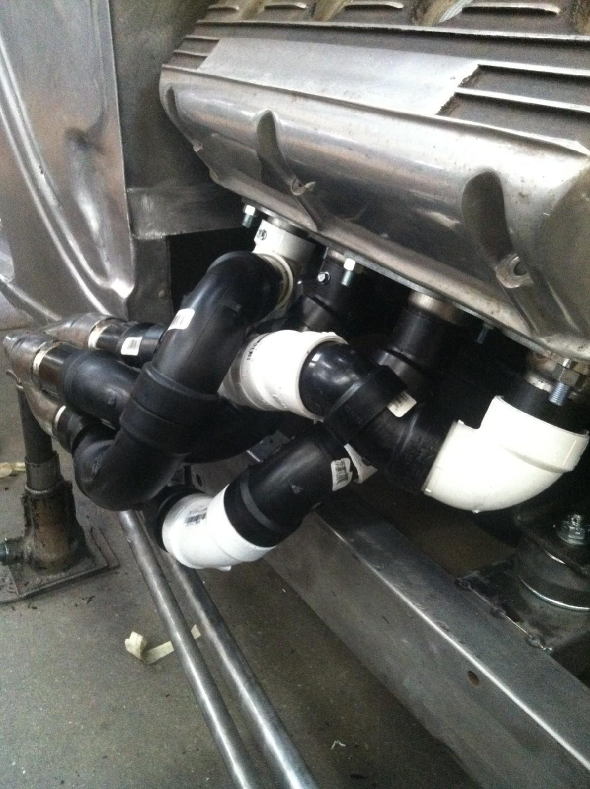

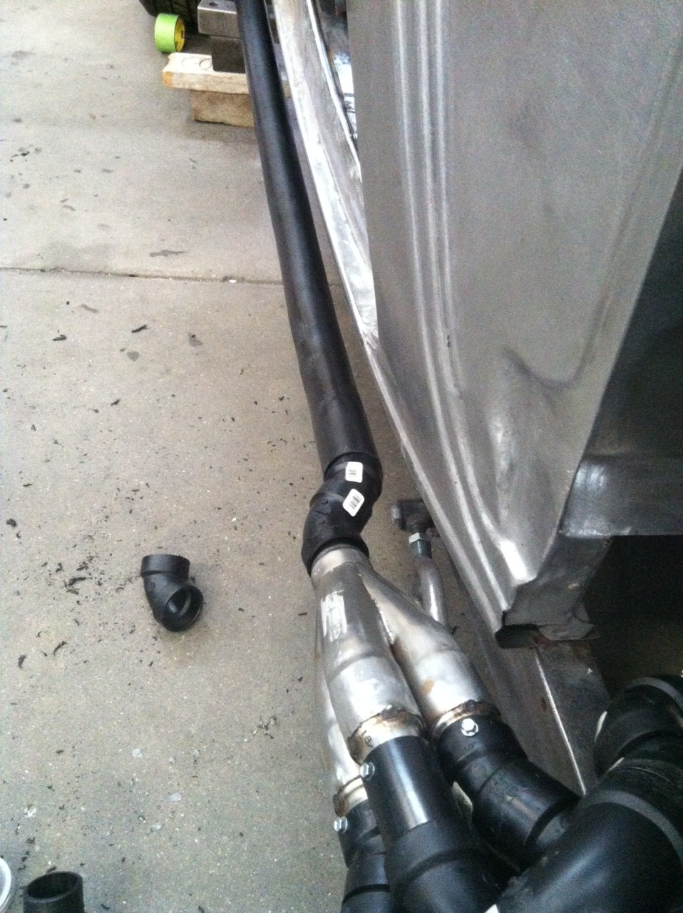

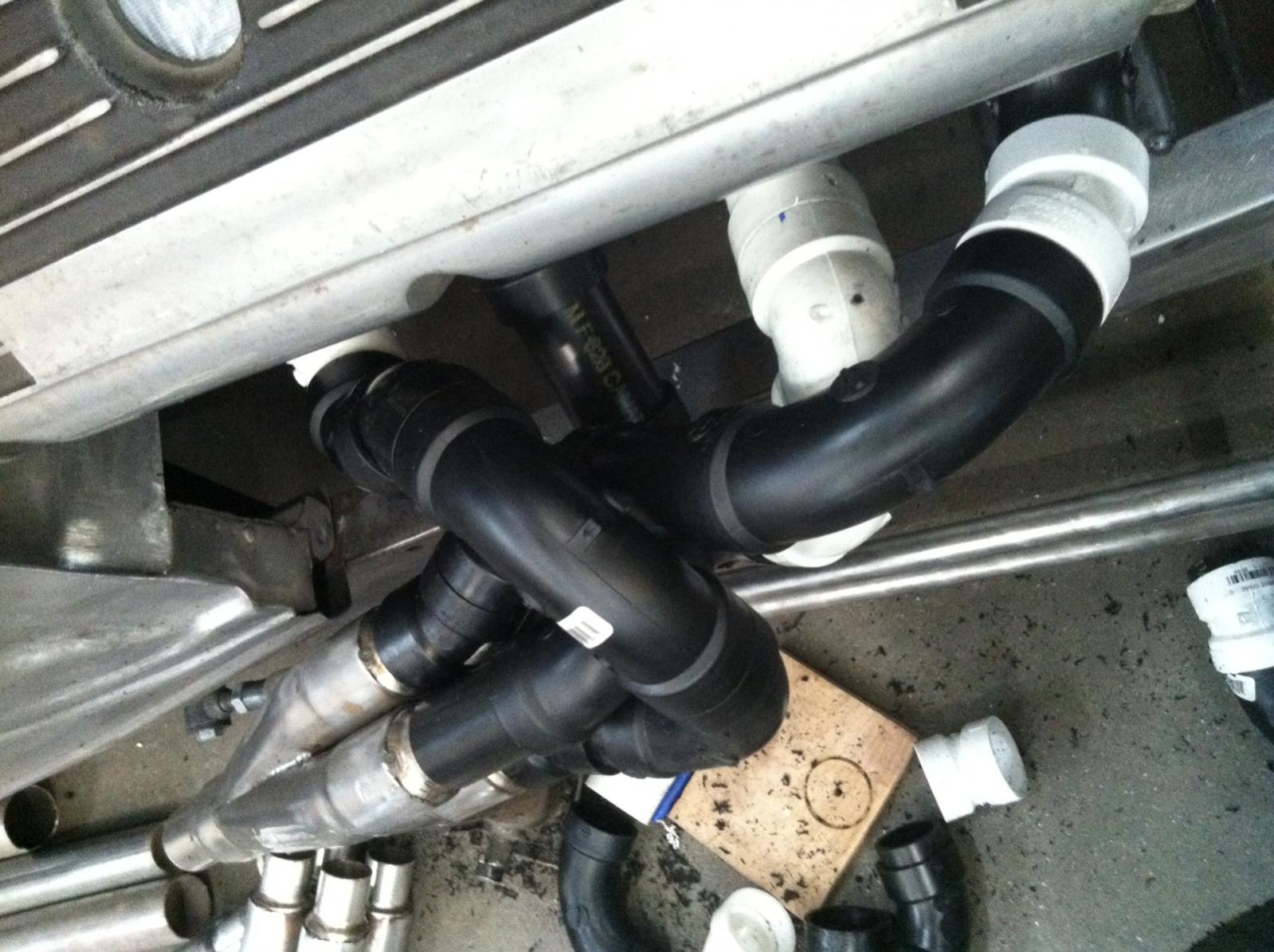

    Josh has been working to get the headers to have tighter bends and with smoother transitions. ( first two pictures)
    This morning, Josh also mocked up a side pipe that showed us that we were not quite there yet. The after collector pipe had to have a jog to get the side pipe parallel to the ch***is and just didn't flow as well as desired. A little more staring at it..... somethings not quite right????..
    ....Hmmmmm???....it really needs more scale. Josh is working to get the collector to a better straight shot location that will allow a good line with the side pipe that should be 3.5- 4 inches in diameter.
