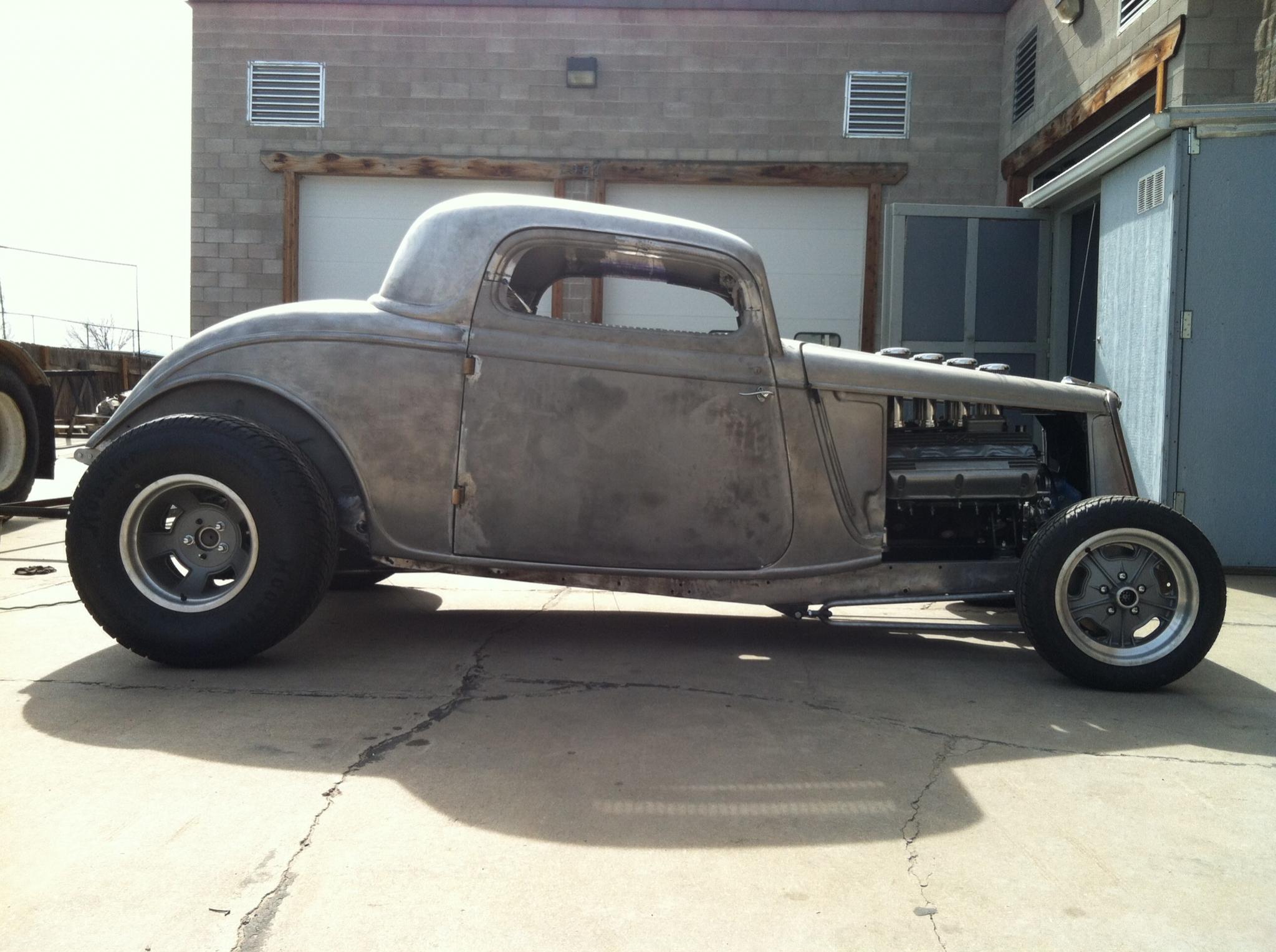

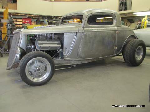

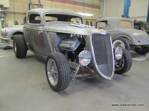

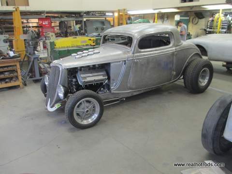

    Thank you from an ex Moorpark guy. grin. Here are a few pictures from outside today.
  3. chopperrob
    Joined: Oct 8, 2010
    Posts: 110
    chopperrob
    from ny
    That thing has the "look" bad ***!

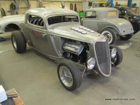

  4. Uptown83
    Joined: Apr 23, 2007
    Posts: 722
    Uptown83
    looking bad***. You going to run inner fenders?
  5. geoking
    Joined: Nov 12, 2008
    Posts: 717
    geoking

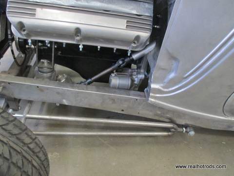

    No sir... 2 inch primary headers . See above posts with pictures. They fill up the area that the inner fenders "would "have gone.

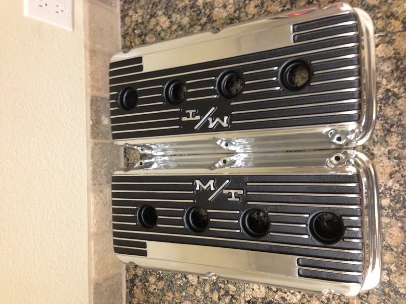

    In keeping with the "Mean" theme, I have been working on getting a pair of 60's style MT valve covers to replace the Obrien ones I originally picked for the project. They have been back ordered for some time and arrived last week. I spent part of the weekend prepping, painting and wiping off paint on the fins with lacquer thinner.
    I look forward to putting these bad boys on the Hemi.

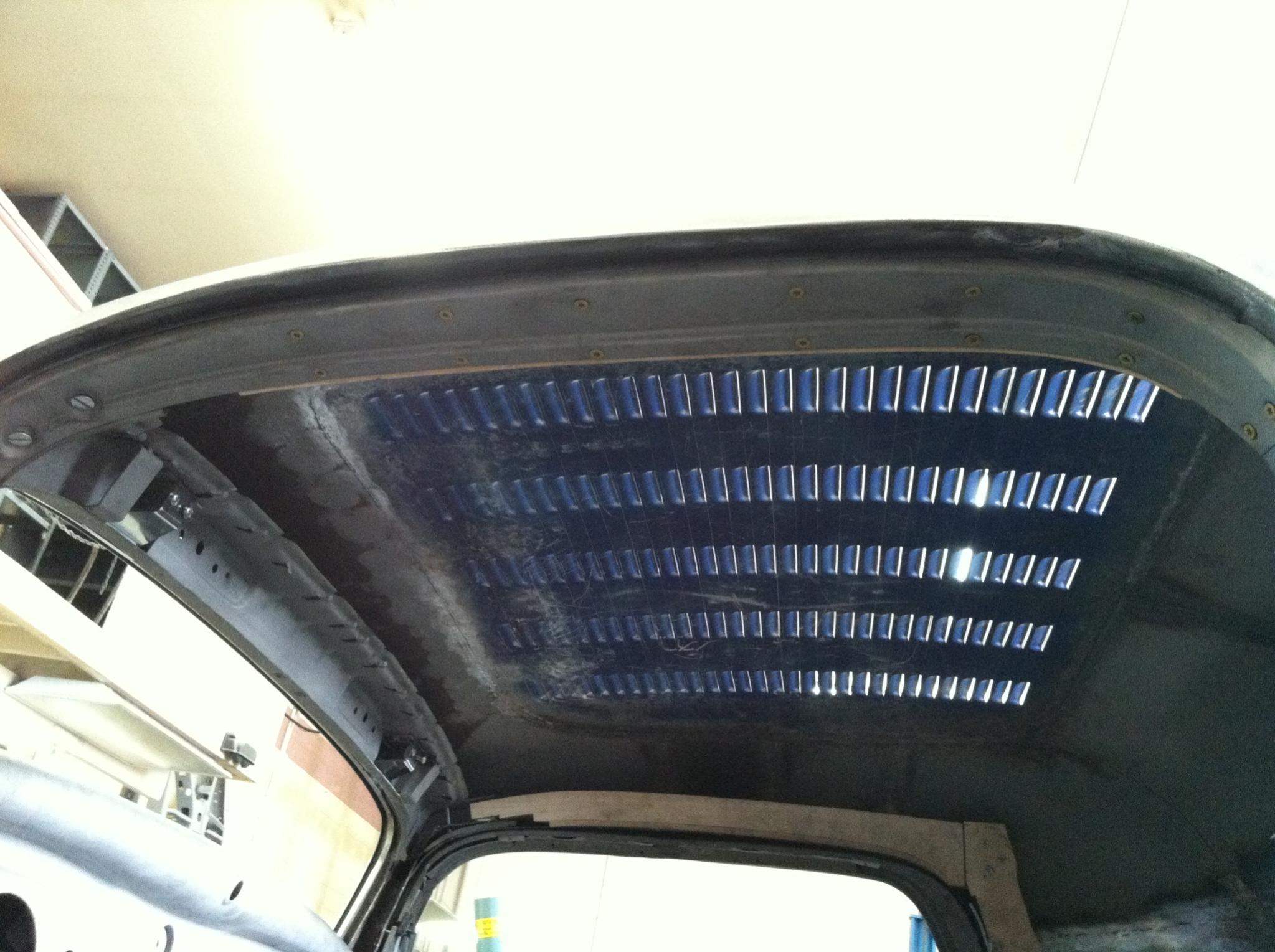

    Nice build, a louvered roof. Interesting.
    Where will the water go that is obviously going to end up going through the louvers ?

    There will be an inner roof underneath the louvers. This inner panel will act as a big square gutter and channel the water to two drain hoses ,IE: down spouts that exit through the floor. The same issue applies for the louvers in the deck lid. Holes will have to be drilled to allow water to drain. While I dont plan on leaving the car out in the rain.... you know it is going to happen sooner or later! No hood sides and 8 holes in the hood isn't going to help either!
    I see the guys driving cross country without a roof of any type and think, how crazy are they? YEP...Im just as bad! grin.
    My 48 has all the creature comforts, power everything plus heat and a/c. This one is the opposite.

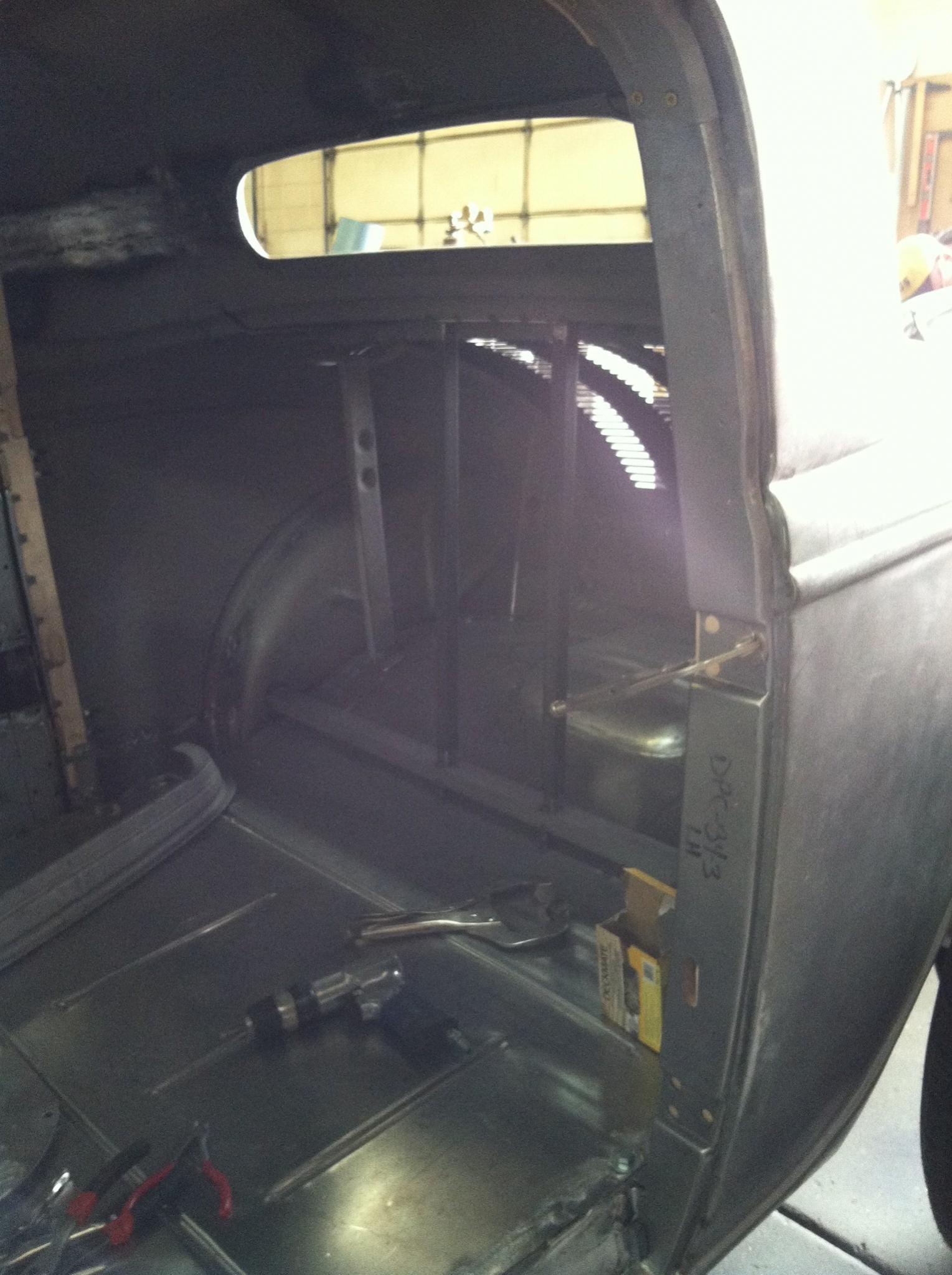

    Josh has moved on over to the drivers side for the wood, door jamb and hinge install before he gets out the giant can opener to add the drivers door "X" brace.
    Lot's of effort to get the second door hung!
    ....Then door tops, deck lid re ***embly , gas cap recess etc etc etc smile
    Josh has a great work ethic and is relentless in his efforts to keep knocking down one item at a time.

    Thank you Paul. Here's a couple of pictures of the finished inner stucture and door tins that Josh has just completed this morning. Very Clean! If you will zoom in on the underside of the roof fill panel, you can see the labor of love needed to lay out the louvers.

    As nice as that roof is and even with the plans for a catch-drain pan underneath it, I still don't thiink its that great an idea.
    There will be a wet area under the roof that can never be cleaned out or refinished. No mater how well it is built or drained.

    Ahhh, ye of little faith! Who said that it isn't going to be removable. IT IS,...just so that it can be cleaned/ serviced as required....
    For the record: As already stated in a previous post.....
    I don't think that putting holes in the roof or the deck lid is that great of an idea either. But after all, It is my car ....and I like it...and TO ME, it's way cool!... and besides that, ..... it's already done!

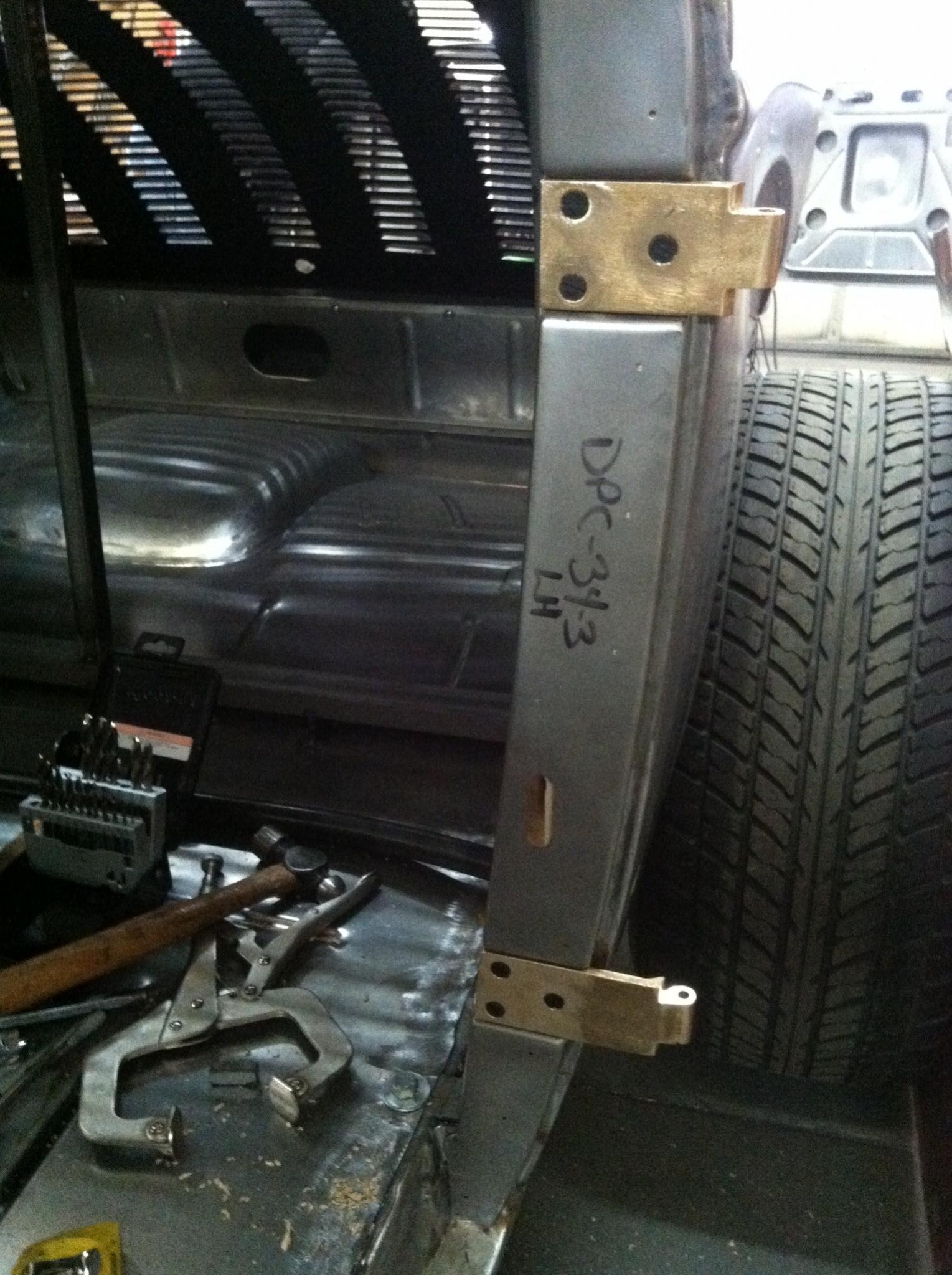

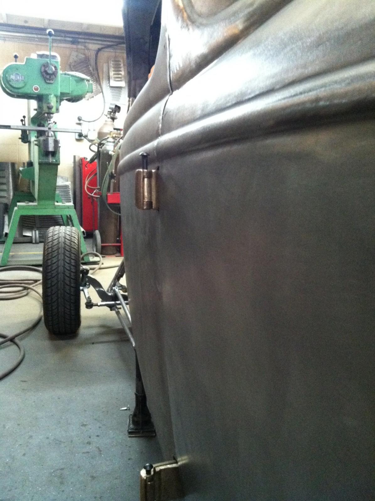

    Josh finished up the "X" brace install and got tthe door skin back on the drivers door. Please see attached pics of hinges, door hung with good straight belt line and ready for door tops.
    Still fighting with getting the doors done,.....but almost there.
    Hang in there Josh!
    Regards,
    George

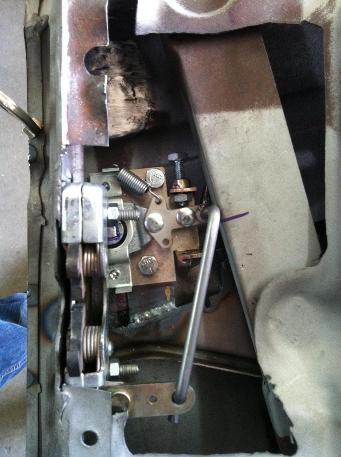

    Josh worked with the drivers door hoop today along with getting the new latch in. We are NOT going to use an original door handle. We are going to use the small arm as pictured below. In addition, there will be the needed saftey dead bolt! We are still talking about what to do for a door pull. As the door panels will be aluminum, we have to decide on fabricated pulls, pull slots or maybe leather? Just thinking out loud for now as that's not a critical decision at this point in time. As Josh says,..."it will speak to us when it's time" smile.

    A return spring, A couple of rods, some cutting and welding.....a little trial and error ...just a little more finessing and it will be time to ****on her up... whewie!
    NICE NEW LATCHES THAT ACTUALLY WORK>Thank you Josh
    Note the extra long hardware...I am always poking fun at the Custom Auto Boys on their hardware stock. It is all Hex Head Long and Extra Long, Grade 5 . I like to tease them about buying a little stainless and using lock washers. I'm probably going to get gigged for tweaking them here. LOL

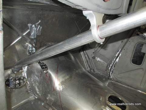

    If you compare this picture to the one just above you can see the perimeter of the upper door has had material added to properly "GAP".
    THIS DOOR IS NOW COMPLETE! THis is as of last FRiday morning and I will have to get an update from Josh to post later today.
    Can You say YES???? Makes me smile!!!!!

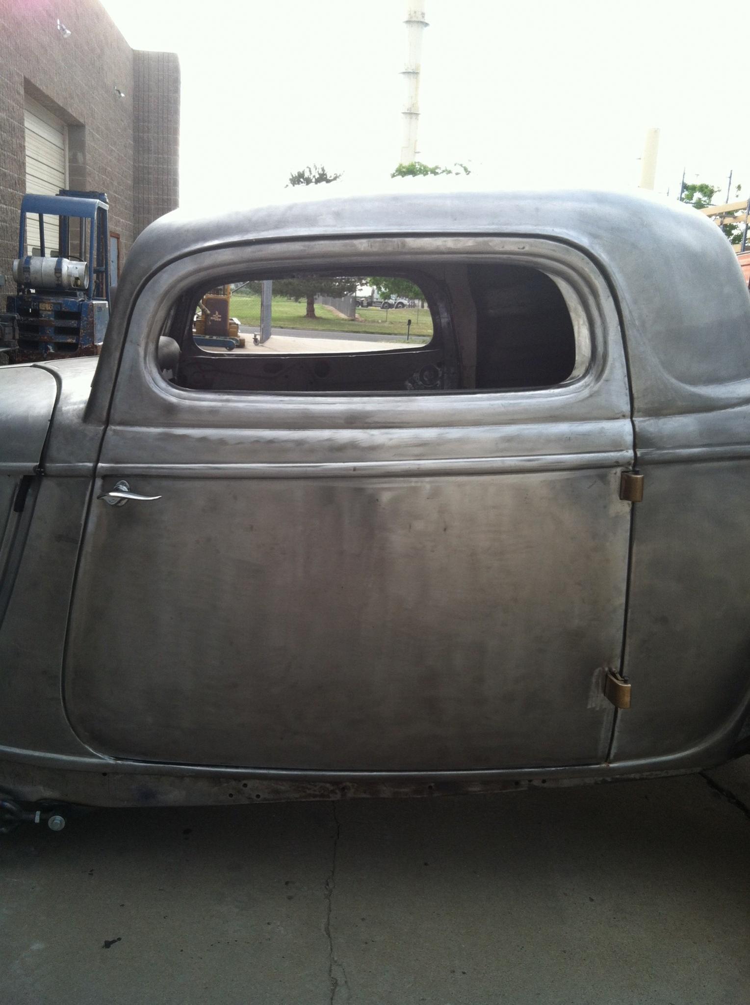

    Thank you on behalf of Josh. He sent me an updated picture of the drivers side door progress this morning. ( see below) I am not sure whom will be more excited about seeing these doors finished...Josh or Myself?
    It has been a long , tedious process and Josh has hung in there to get it right. The car has had so much effort in making the details right that skimping on the doors would have been a travesty. So ...drivers door top will be added today and gapped tomorrow to wind up the doors! WHEWIE,..almost there and sooooo happy about it. Thanks Josh!

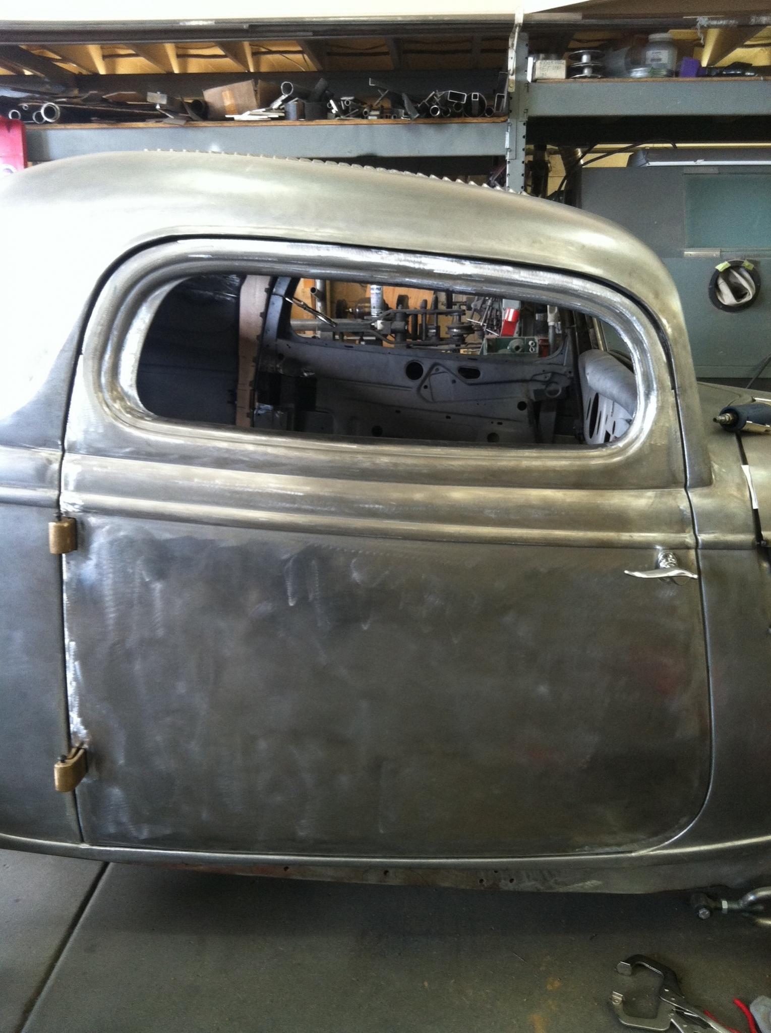

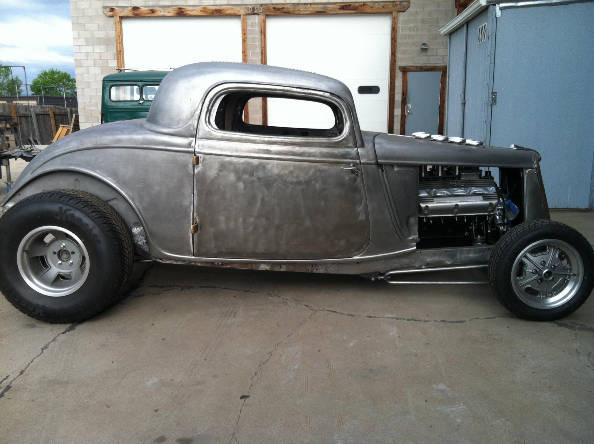

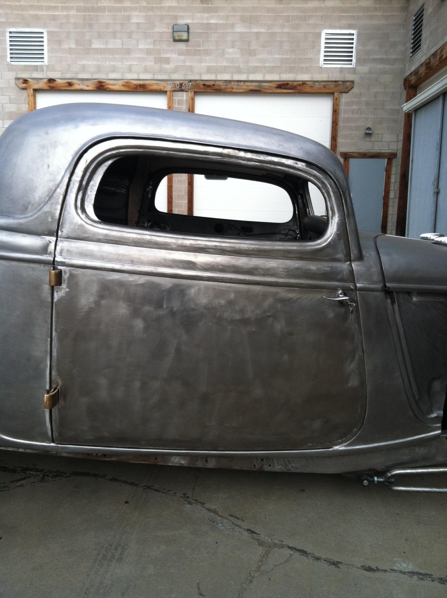

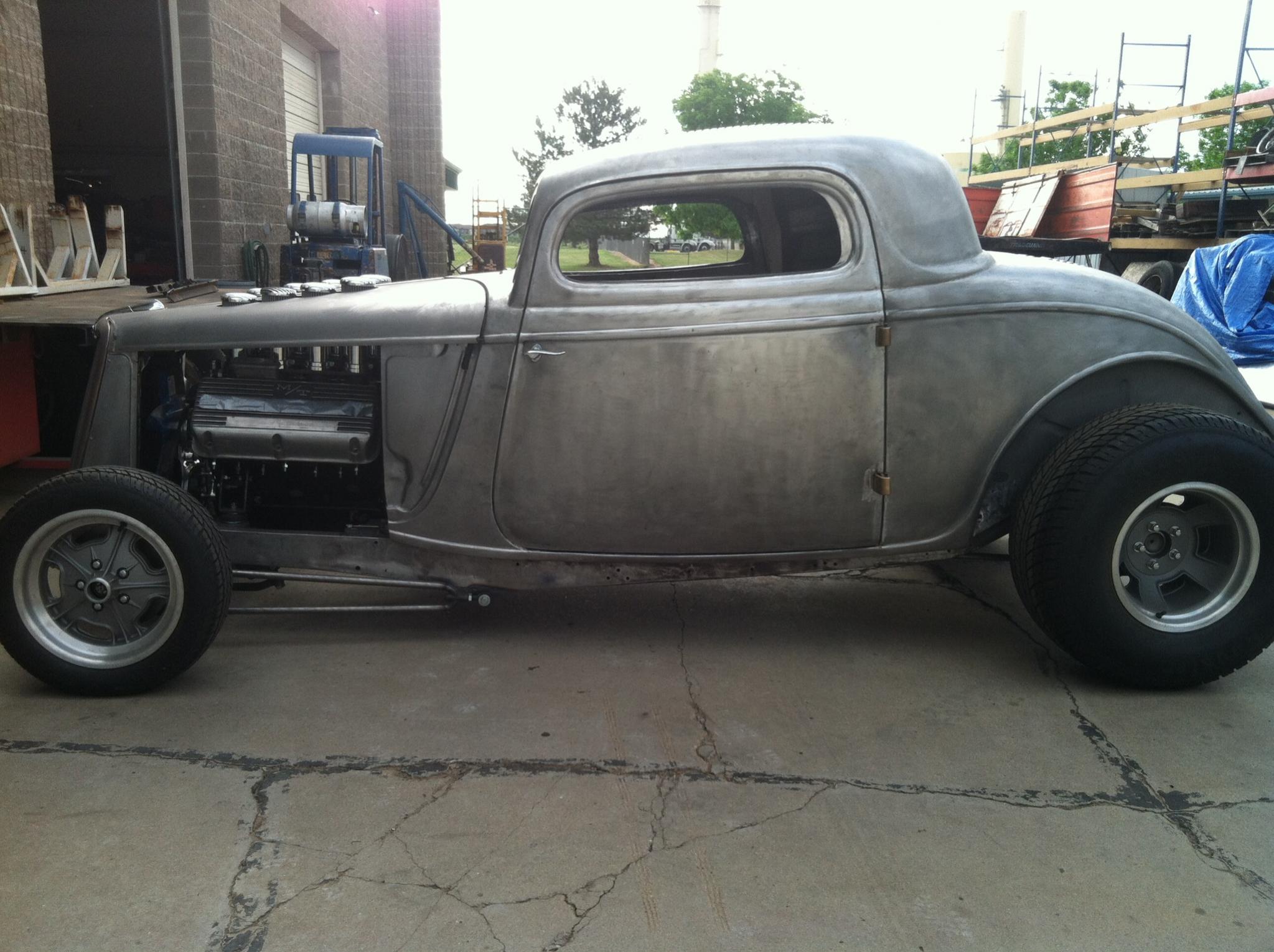

    It is absolutely Hallelujah time for Josh and I. The dreaded doors have been 100% rebuilt, x braced internally and gapped. WHEWIE.
    Please find the pictures below of a close up of each side as well as a side shot of each side. Josh might need to work one gap a little more before paint time. I am so very happy with the effort. The coupe has an excellent at***ude.
    THANK YOU JOSH!

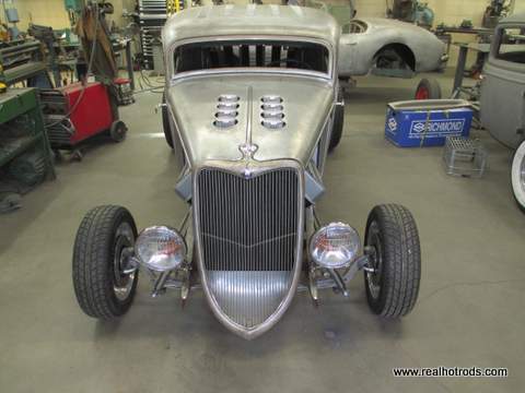

    Rex is going to work on extending the hood to match the grill as well as adding the 34 commercial headlights on modified Model A perches this week. Josh will work on a perimeter frame for another project. I will finish up a set of wheel center caps and take them up Friday when I visit for the Good Guys car show.
    Regards,
    George

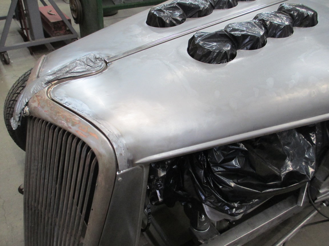

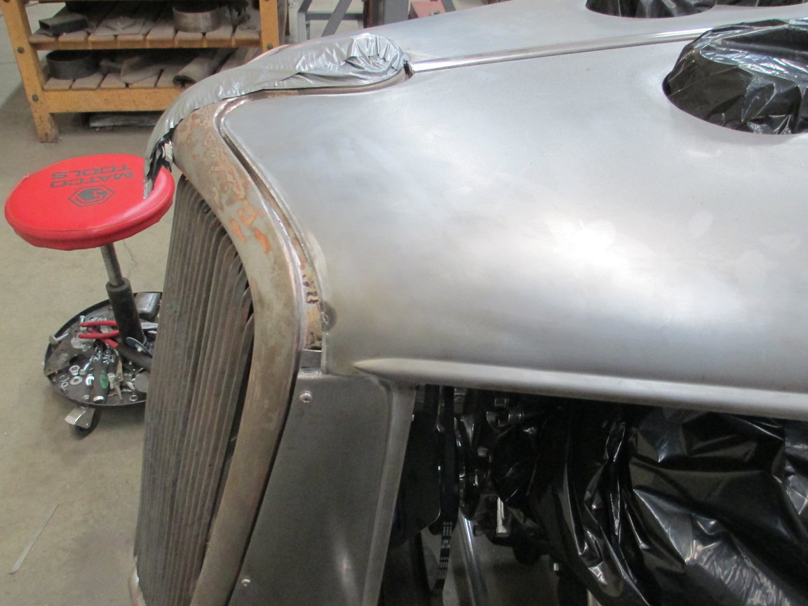

    Here are some before and after pictures from Rex this morning....
    He still has to dye chem and scribe the gaps before grinding and filing smooth.
    Good progress, thank you Rex.
    Regards,
    George

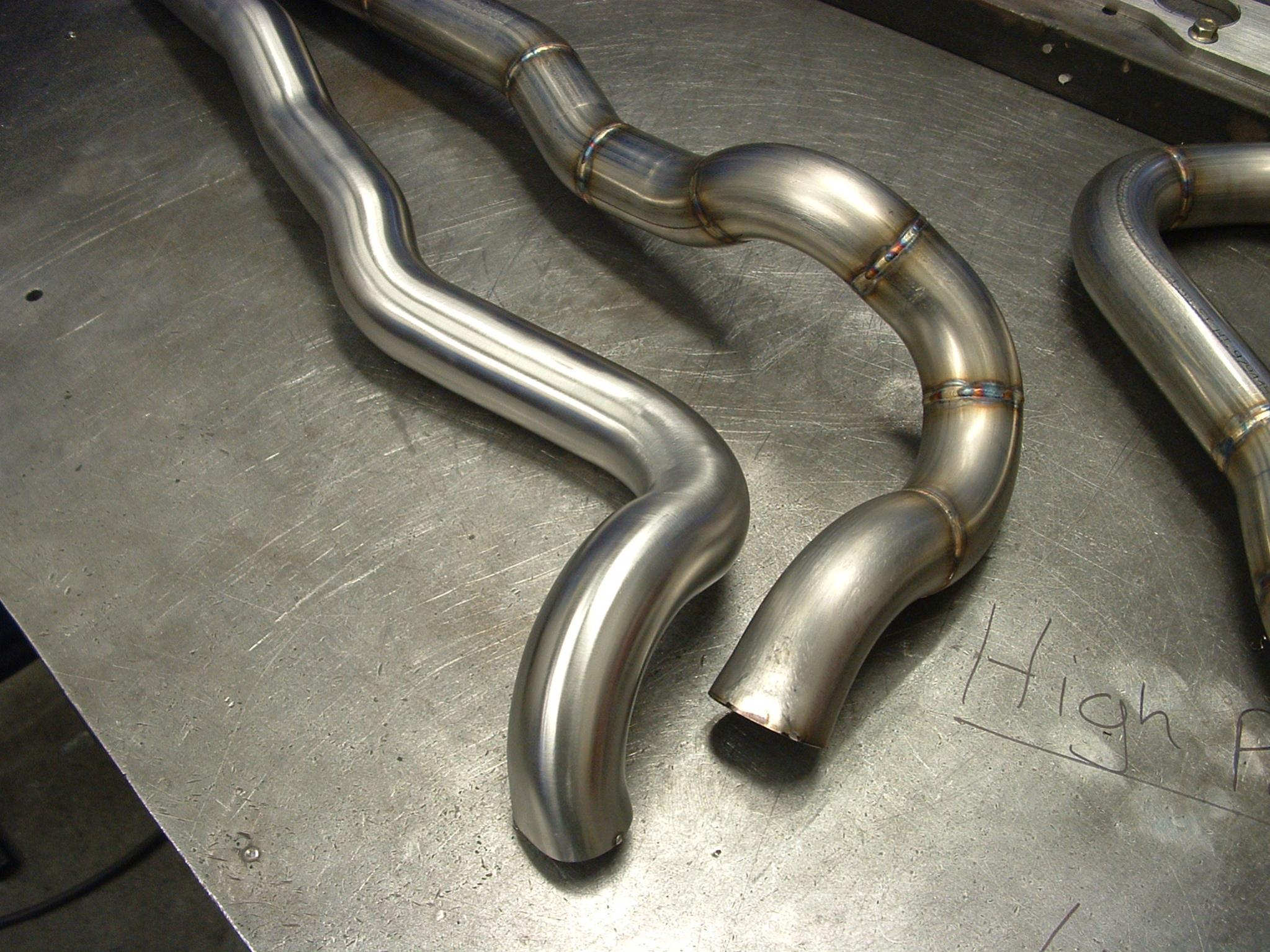

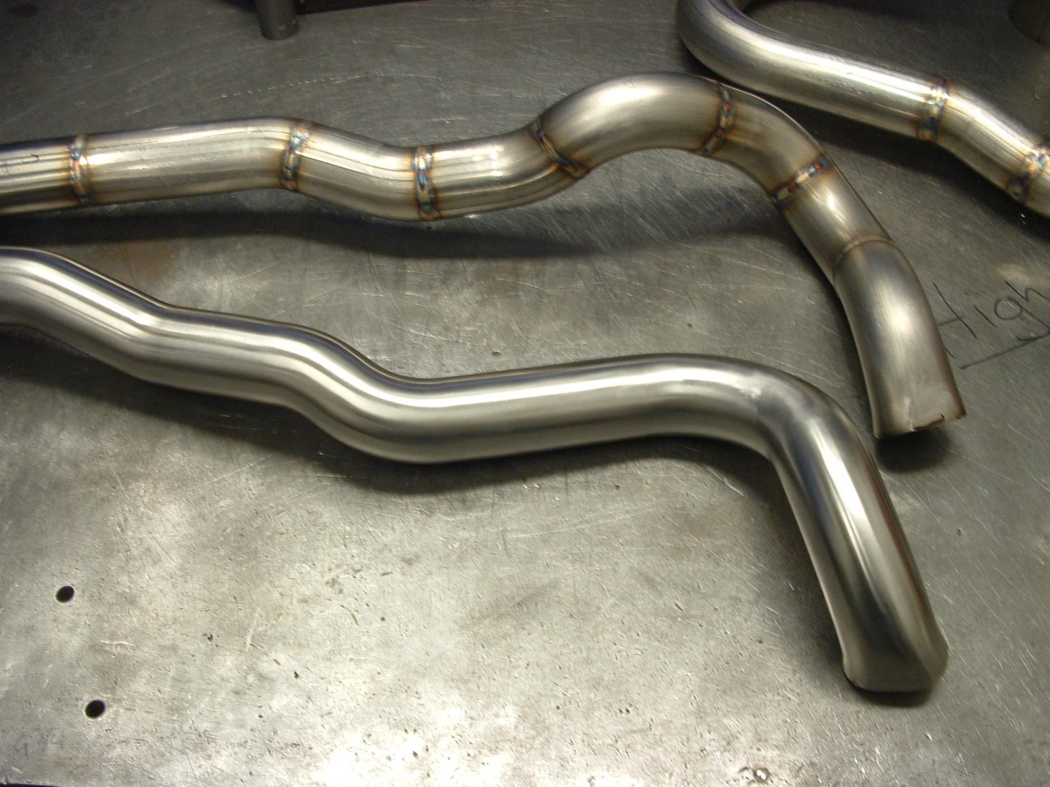

    Twisted pipe update... Matt at Stainless Steel Headers has finished up the fabrication of individual pipes. THe next step is to grind the welds smooth before going through a series of sand paper grit . Starting with 150 and going through 600. Then it's polishing time before ***embling to the header flanges and collectors. Any additional finish work will be after receipt. I am happy with the oval transitions.
    Regards,

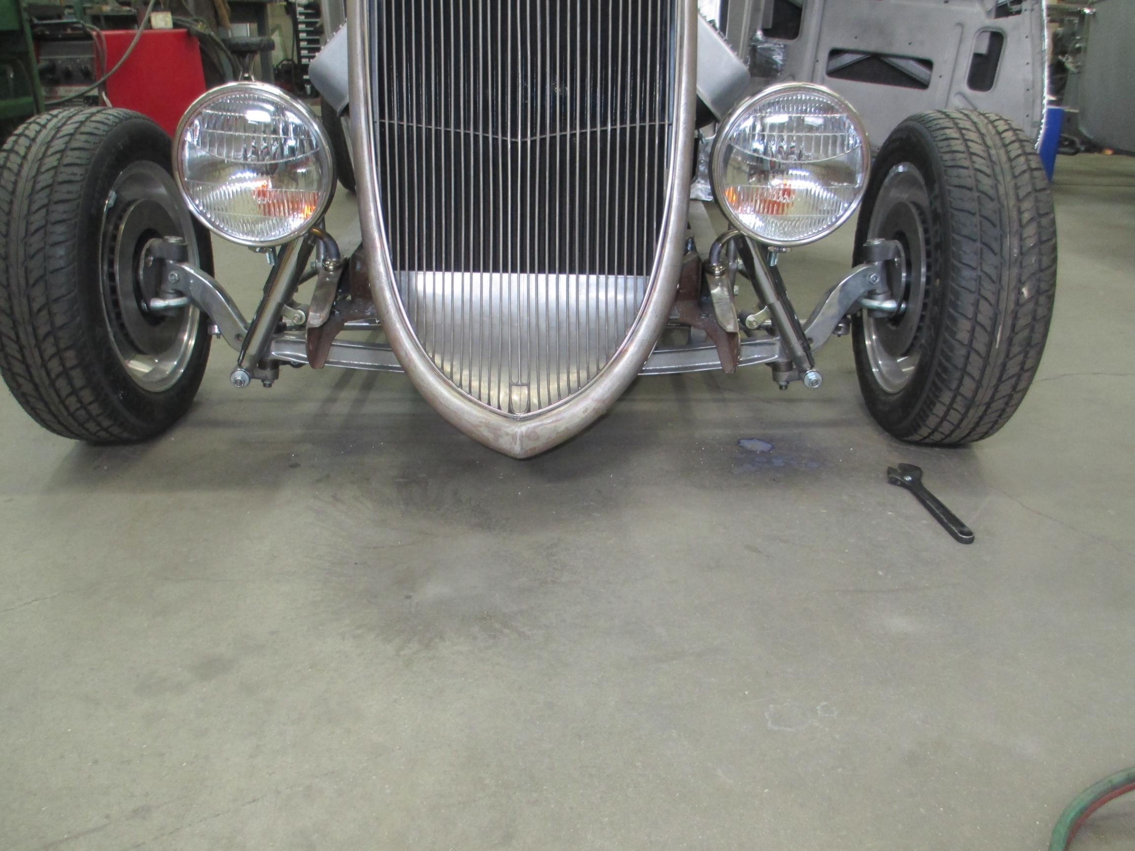

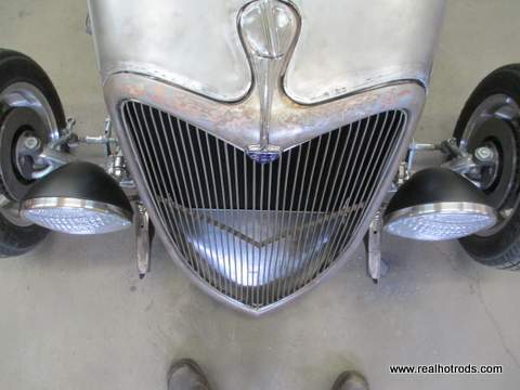

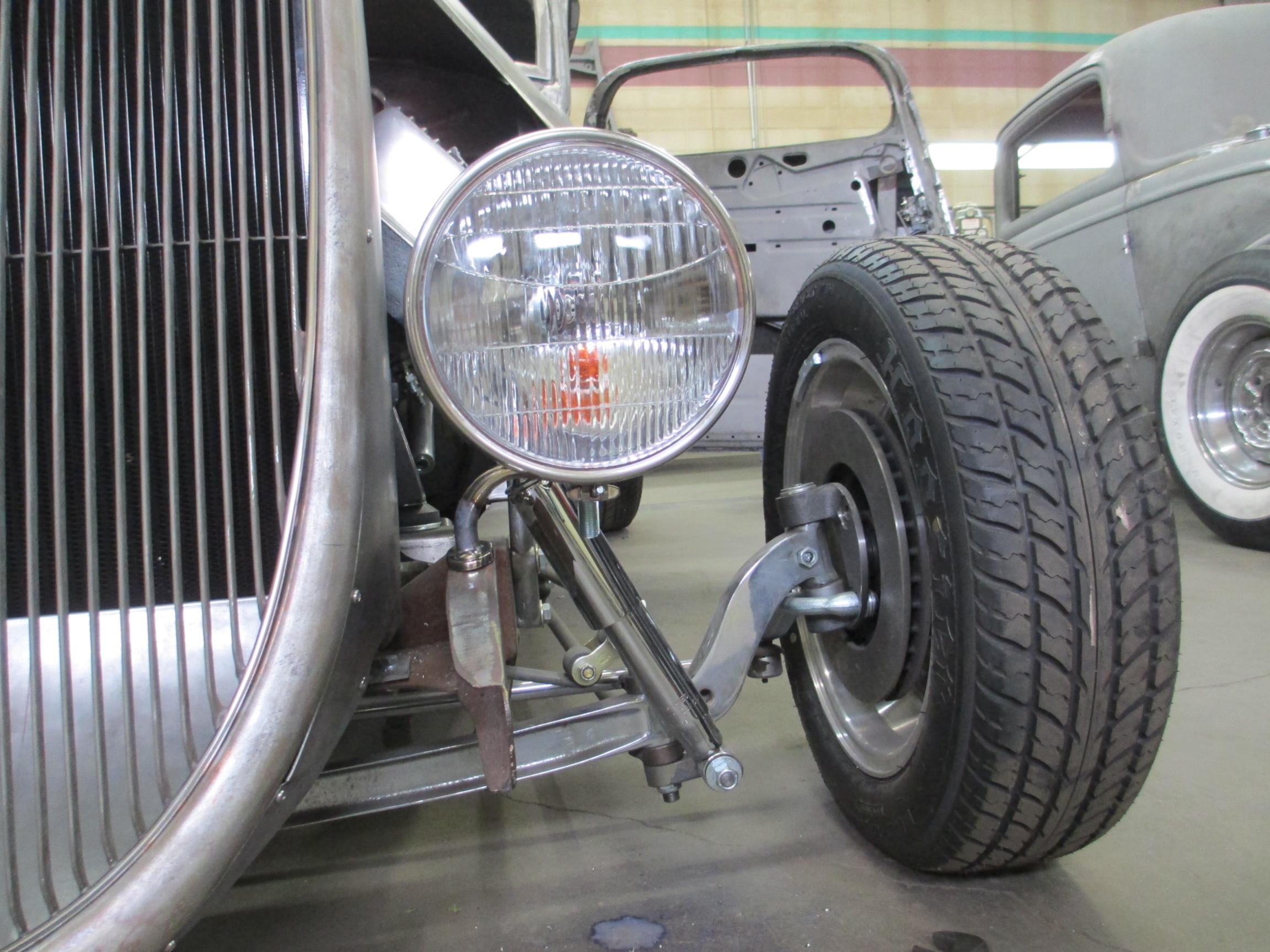

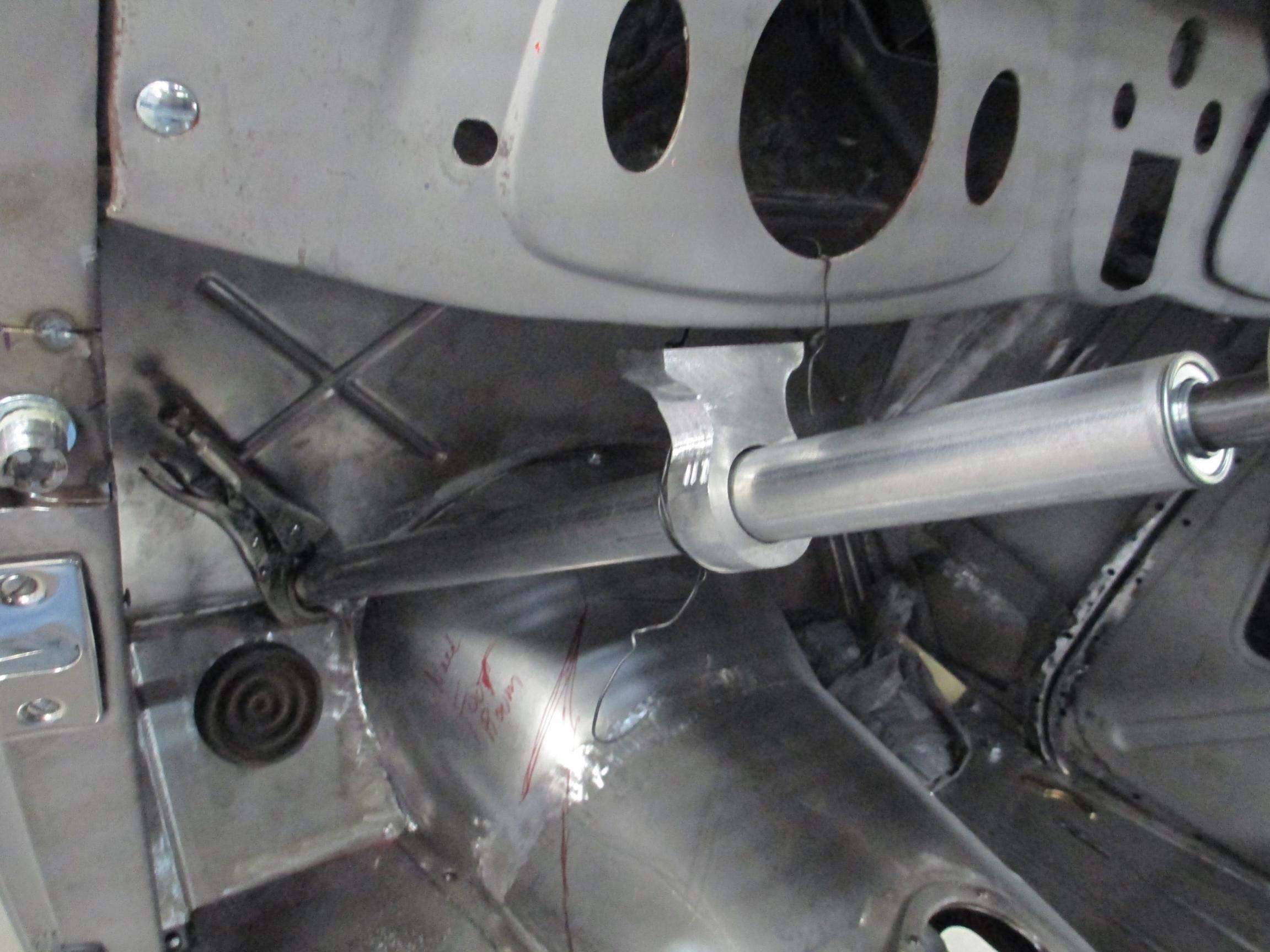

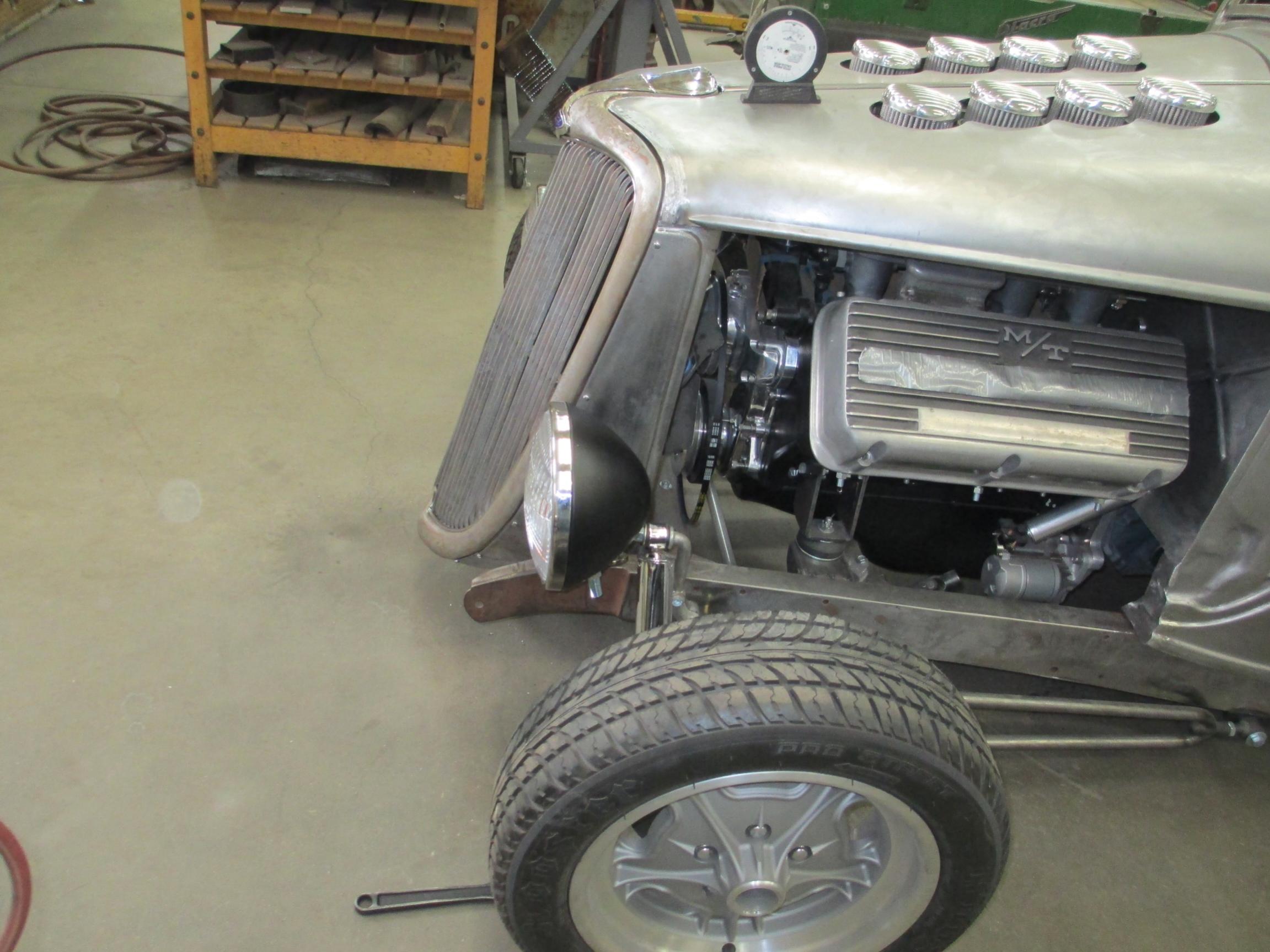

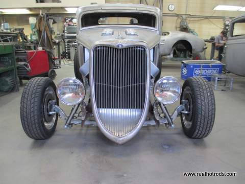

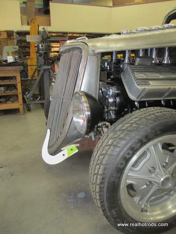

    Please find attached photos of mounted head lights, column drop rough in, steering and nerf bar thinking as well. (via card board mock up). There are even pedals mocked up in the floor if you look close to see them! smile
    Regards,
