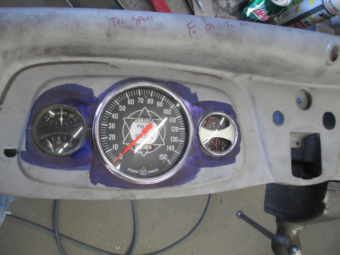

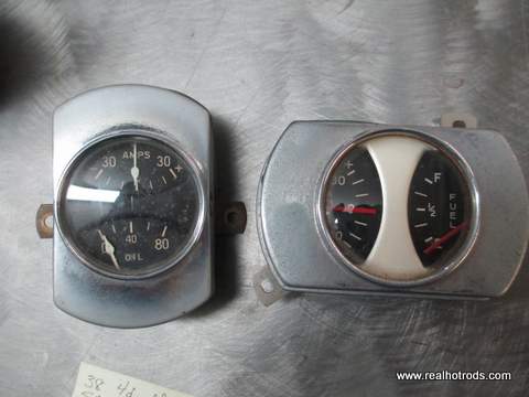

    I need the matching guages to complete EITHER of the ones in the picture. DO YOU KNOW WHAT THEY ARE?

    Old Stewart Warners. Used in many applications like boats, machinery, big trucks, and some bigger cars. If you can read the codes stamped in paint on the back, you may be able to narrow the application and year.
    Some other manufacturers made very similar looking gauges too. I think AC or US Gauge made some that look almost exactly alike from the face.

    Thank you! I'll start chasing marine gauge dealers and see what I might find?

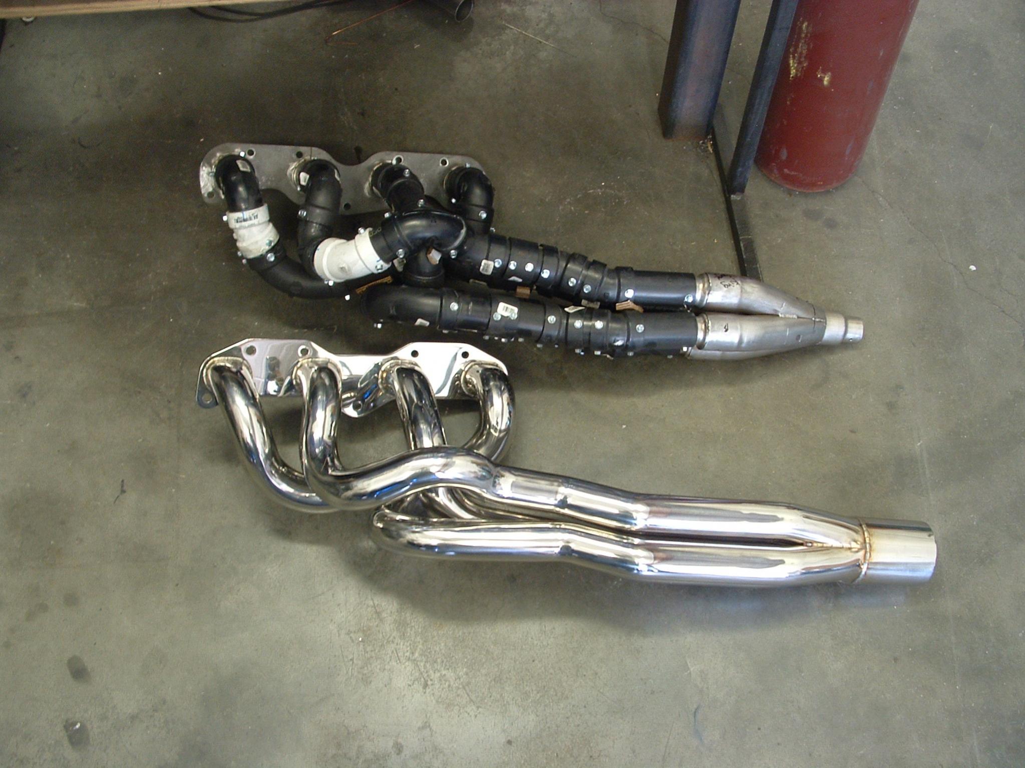

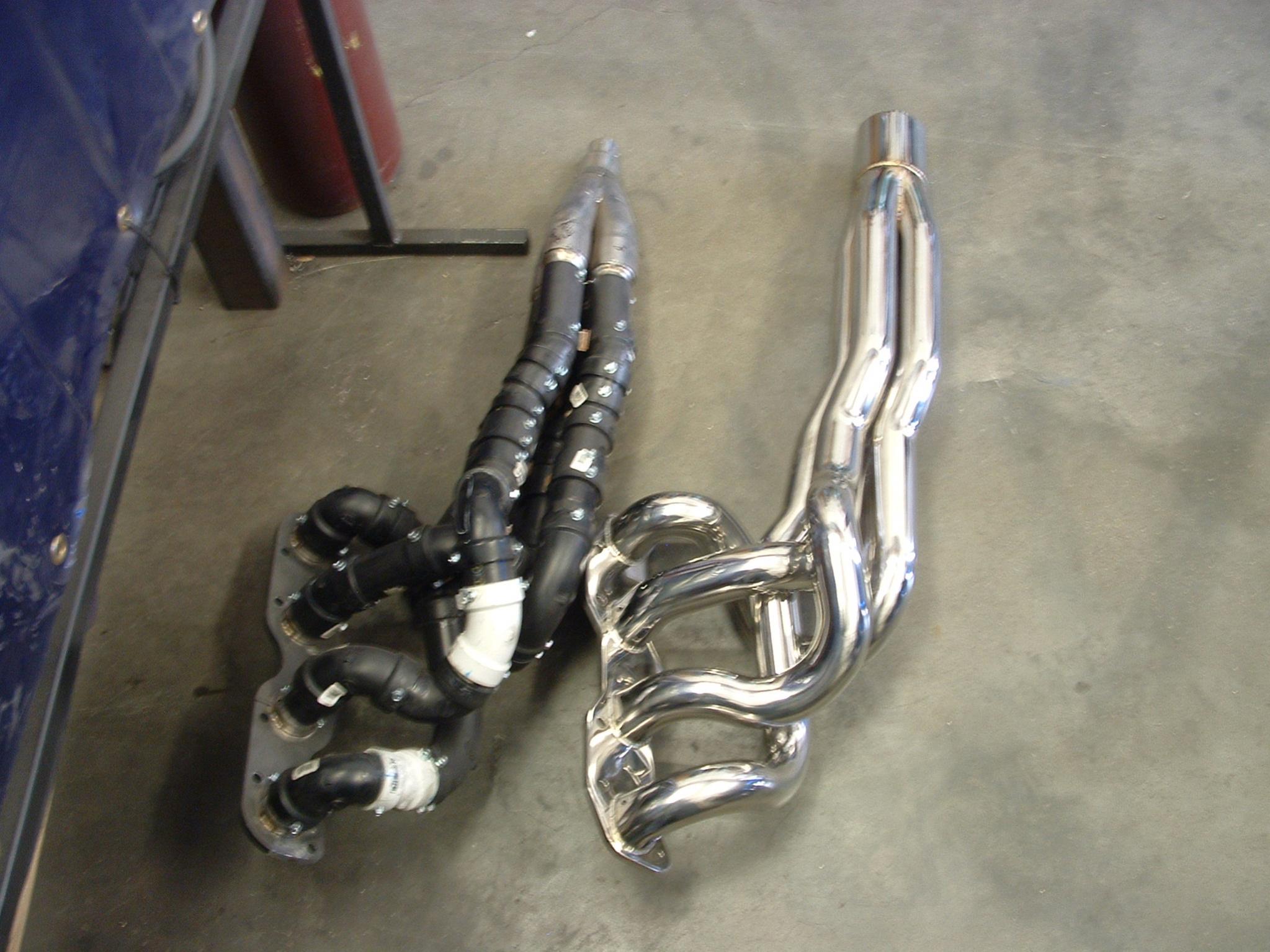

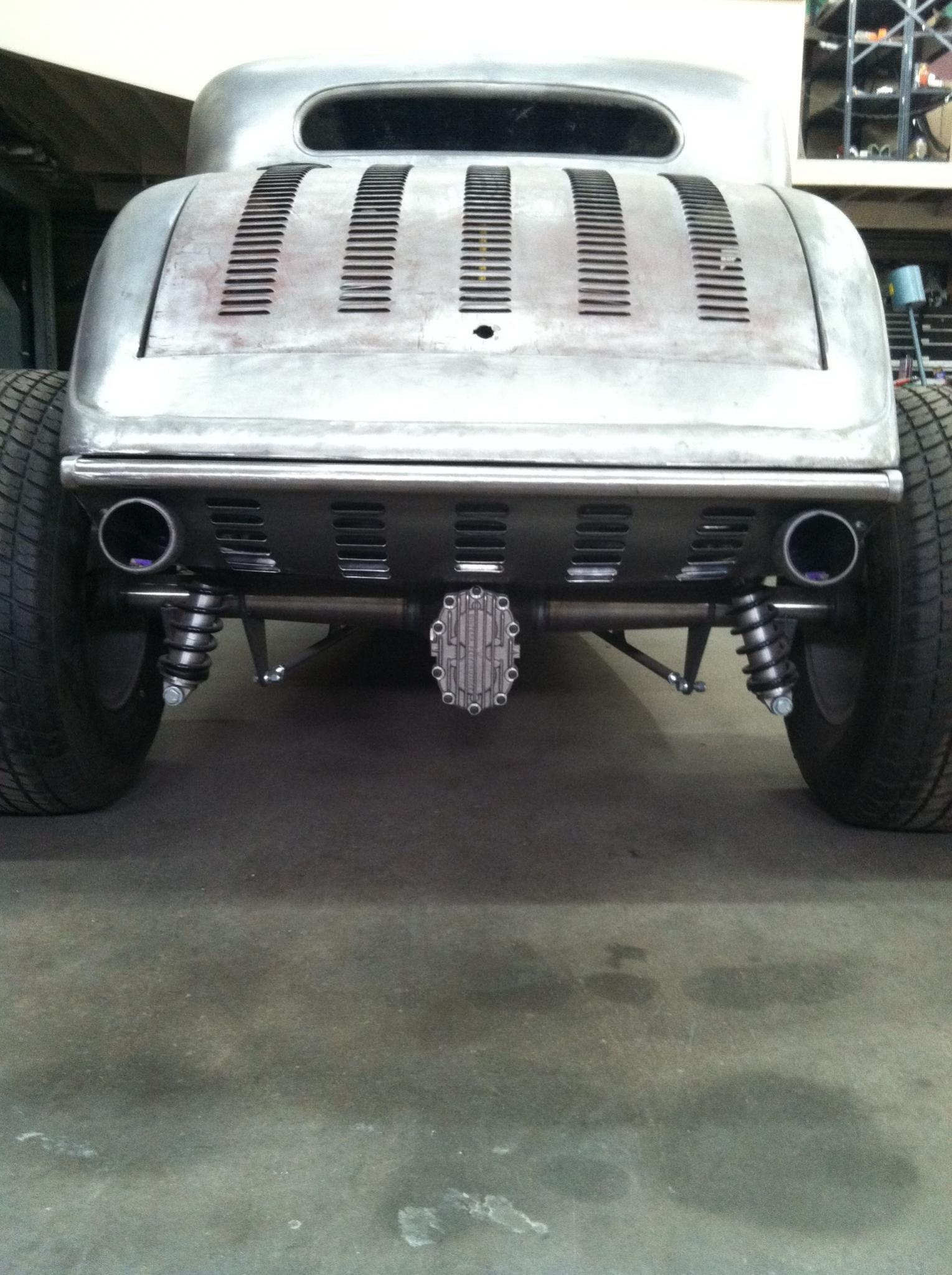

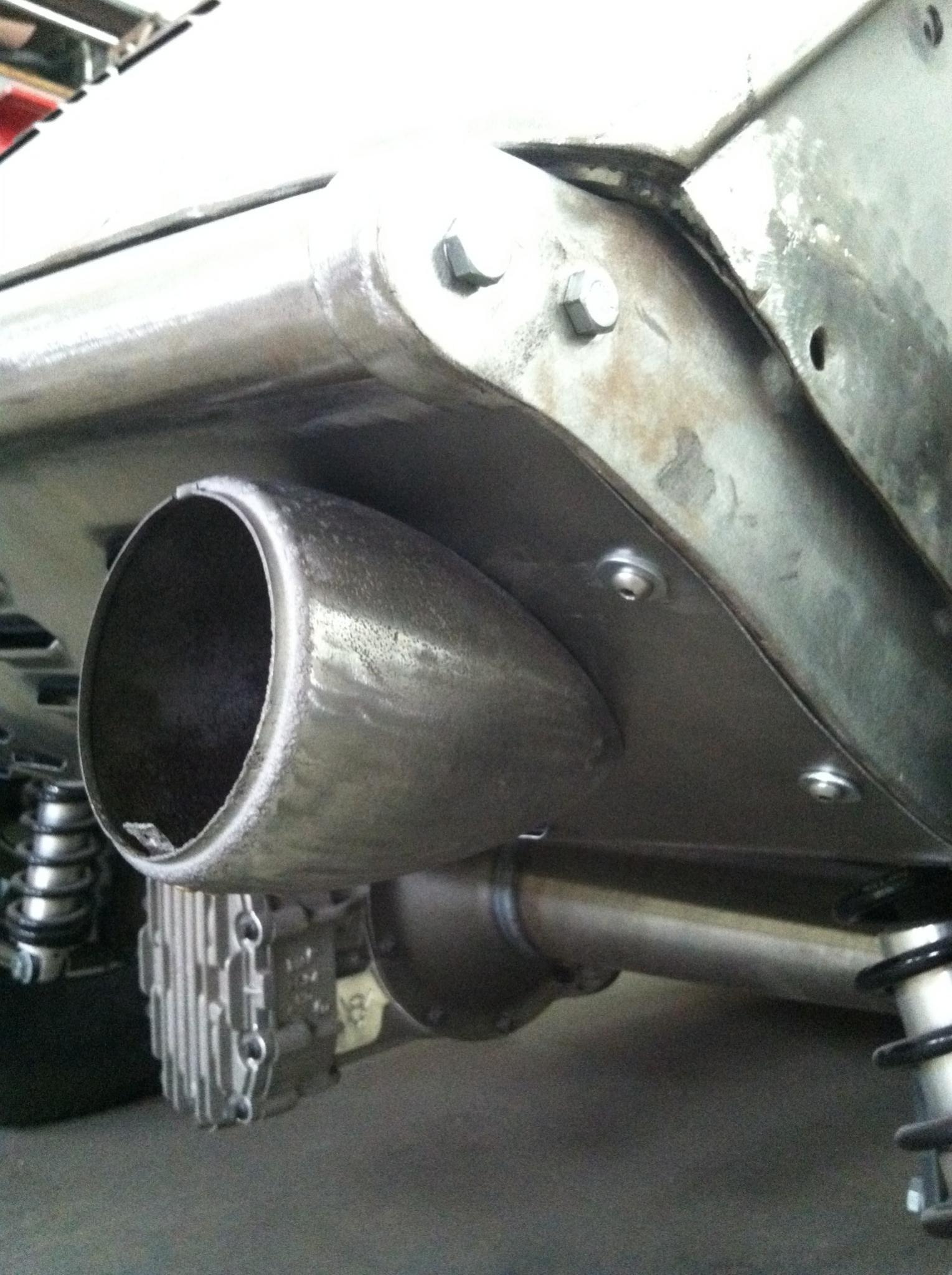

    Adding a couple of updated pictures from Matt on the header build. The original round port flanges are on the plastic mock up and the ovals I sent them are in the finished product.
    regards,
    George

    After a few days effort of trying to find where the desired gauges originated... THE ANSWER IS:
    1941 Graham HollyWood!( The last of the Graham Brothers History of Projects) One of three brothers could not stomach the failure and unfortunately took his own life. These gauges led me down a very interesting path of history and I look forward to having them in my coupe.
    They were also used in the HupMobile SkyLark that was contracted for build by the Graham Brothers.
    The guages were built by Stewart Warner and the guts were also used in 1940 by Ford Motor Co.

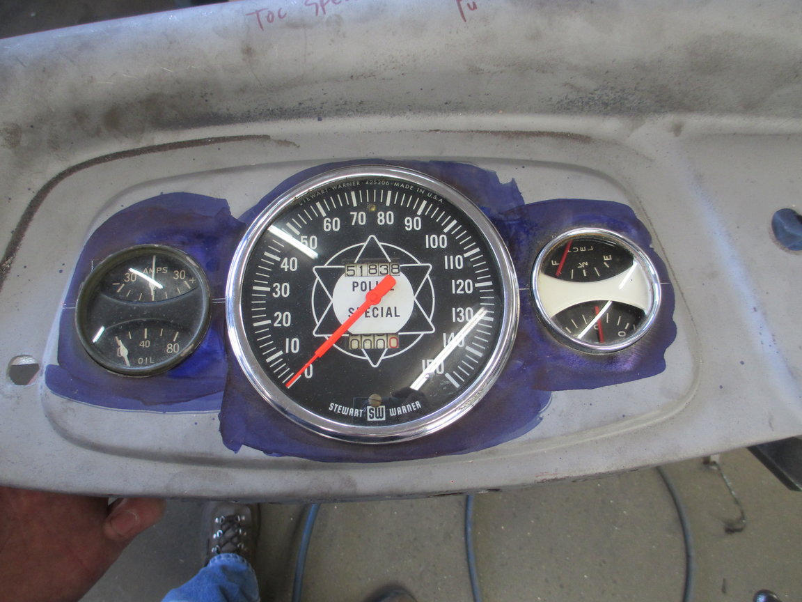

    Here's two pictures from Rex this morning showing the gauges mocked up in the dash. They will be sent out for restoration / clean up of the faces as well as being refaced for orientation and new insides with needle color to match the Police Special Speedo. You will notice that there is not a Temp gauge. As such, one of the AMP gauges will become a Volt gauge while the other one will become a TEMP guage . smile. These obviously came out of two different vehicles.

    That Police Special is not a Harley gauge. The motorcycle Police Speedos are worth about a quarter what the car versions are worth. You have a later 1950's car speedo.

    Thanks...I appreciate the information. I also have one "Police Special" that does not have the "Star" and only goes to 120mph. I'll dig it out and post a pic to get advice on what it might be??? I edited the post above to correct the info. SMILE.

    The motorcycle Police Specials were slightly smaller diameter. Pretty sure most didn't have a star on them.
    There are earlier car Police Speedos that only go to 120, but they are the same size as the pictured one, and they all have some sort of star on them. The earlier ones were cream/white faced.

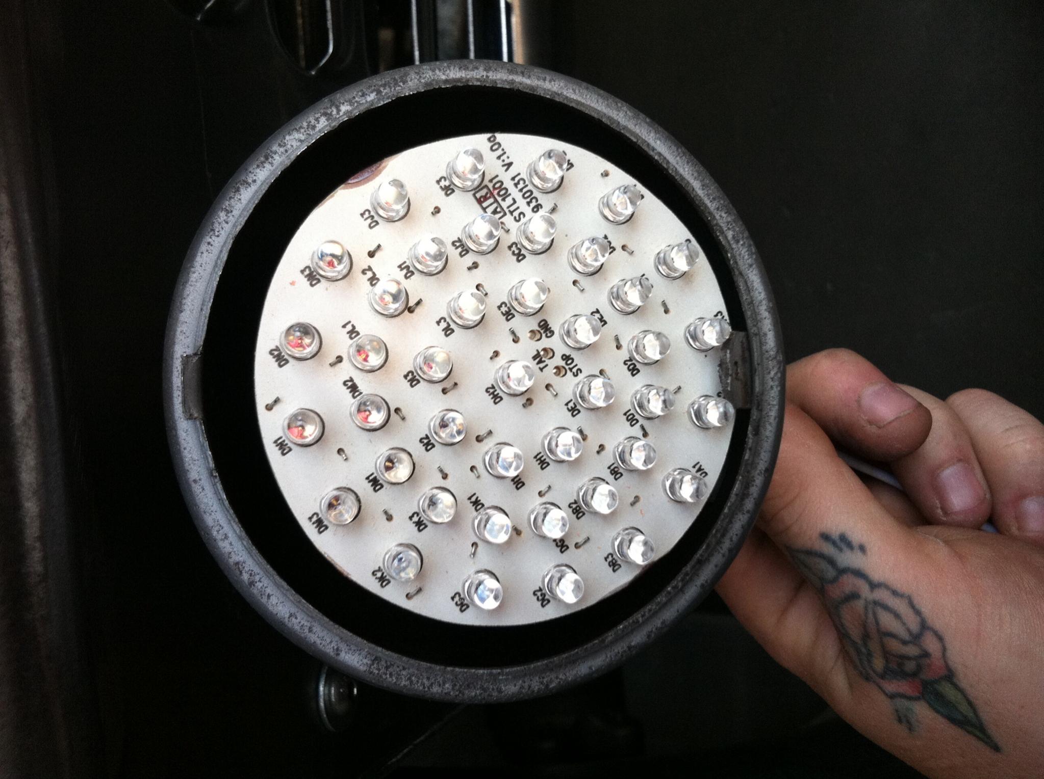

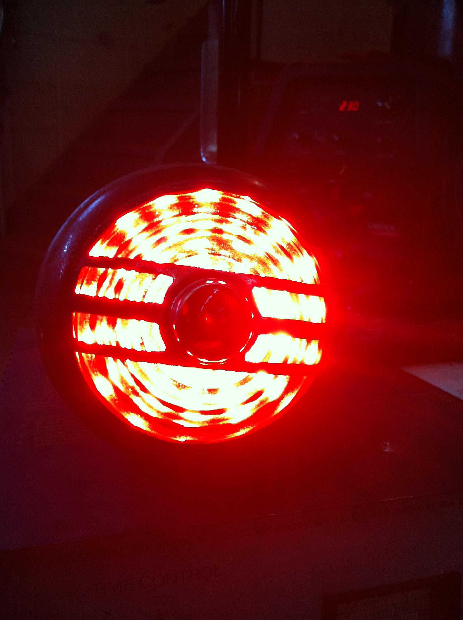

    All lit up... Well almost. smile. Please see the attached pics of the LED board with 12 volts applied. The good news is that it is plenty bright. The not so good news is that I am not a fan of the "cat eye" as it leaves a dark spot and I really like blue dots. Changing the cat eye out for a blue dot is easy enough to solve. HOWEVER, the LED lights inside are red and that isn't going to look good shining through a blue dot. So...the big problem...is how to source this in WHITE output LED's for optimal brightness and a nice shining blue dot?
    This sub assembly is manufactured by United Pacific which is head quartered in Taiwan. I have friends there and have asked them to work the issue locally in Taiwan and see if it is at all possible to have a few made with different LED's? IF NOT, we can always use high output 1157 bulbs if it comes down to it. This is only a matter of personal preference as bulbs will obviously work just fine. It will take a week or two to run down an answer. I will advise when something is determined.
    Regards,
    George

  17. alchemy
    Posts: 22,275
    Personally, blue dots always make me think of cars trying to add stuff that makes it look "like the 50's bro". Not really needed on a true hot rod.
    I was worried your lit lenses would have the LED pattern to them, but it doesn't seem that way. I'd leave them as is.

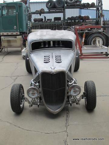

    What a fantastic view from the rear! Top notch work so far.

    I just hate the black spot when she is all lit up! Anyway, yours truly has been scrounging up 37 tail lights and has a couple of sets of bezels and lenses. I will do a pair of each style to enable a comparison. I can always change them out as it's a simple one screw effort. I want to avoid the LED pattern as well and may end up with bulbs before it is over. Appreciate your input and especially your effort to document SW gauges. Great job!

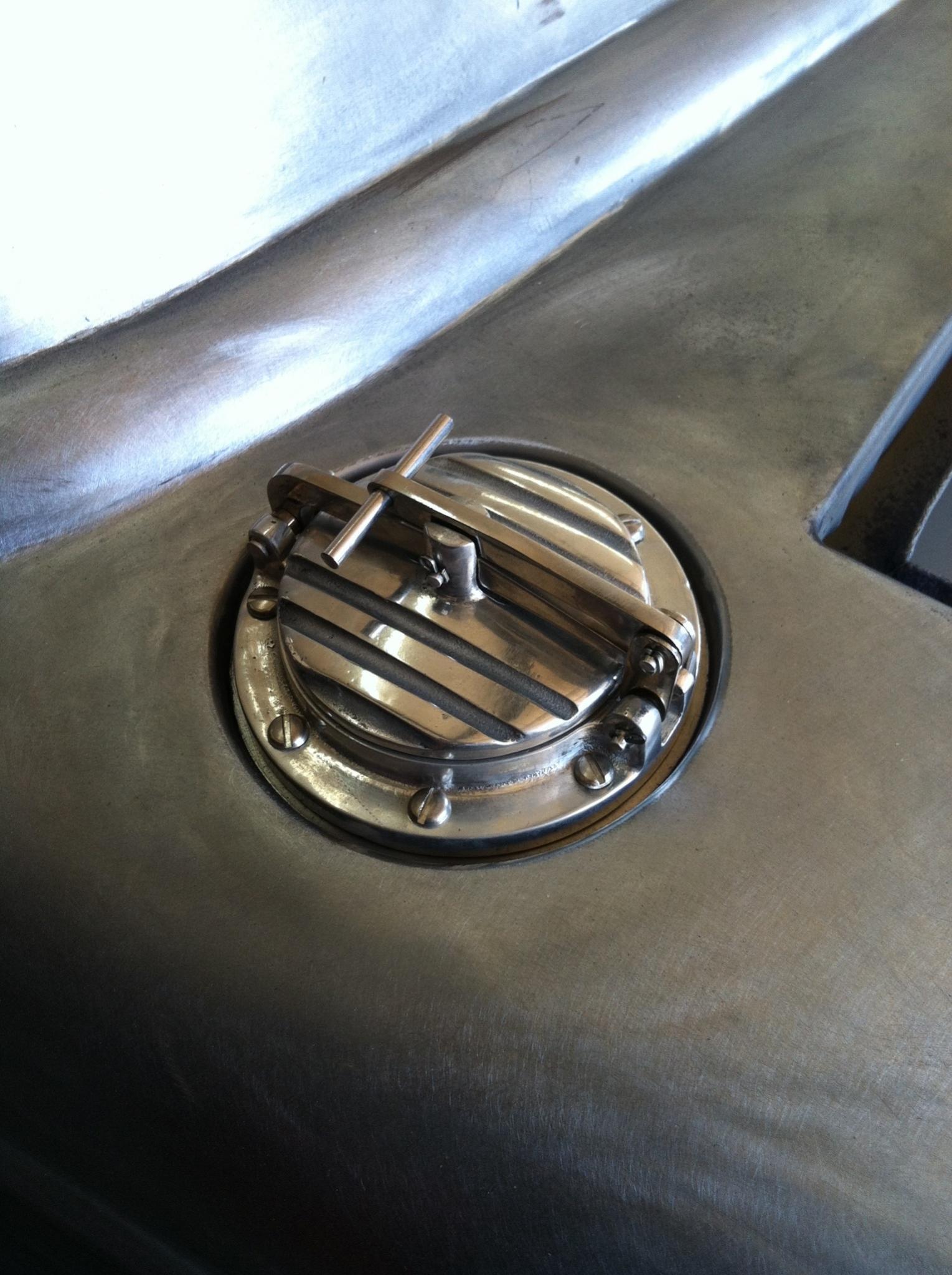

    Gas filler has been welded in and ground. Hood belt line has been cut off of the aftermarket hood and the belt line off of an original Henry Hood has been welded back on in an effort to match the cowl belt line profile and to get a straight belt line from nose to tail. The headers have been received and are hung for exhaust side pipe build. Josh has also mounted the gas tank and just needs to fabricate a filler pipe . Rex has been on top of the gauges and sent them off to "Bob's Speedometer" for updating. They have a better turn around time than one of the big name shops and we are going to give it a shot. I have a couple of more housings and may go ahead and send them out to a separate company for back up performance. I can always use them in a project down the road.
    Hope you like the progress pics...
