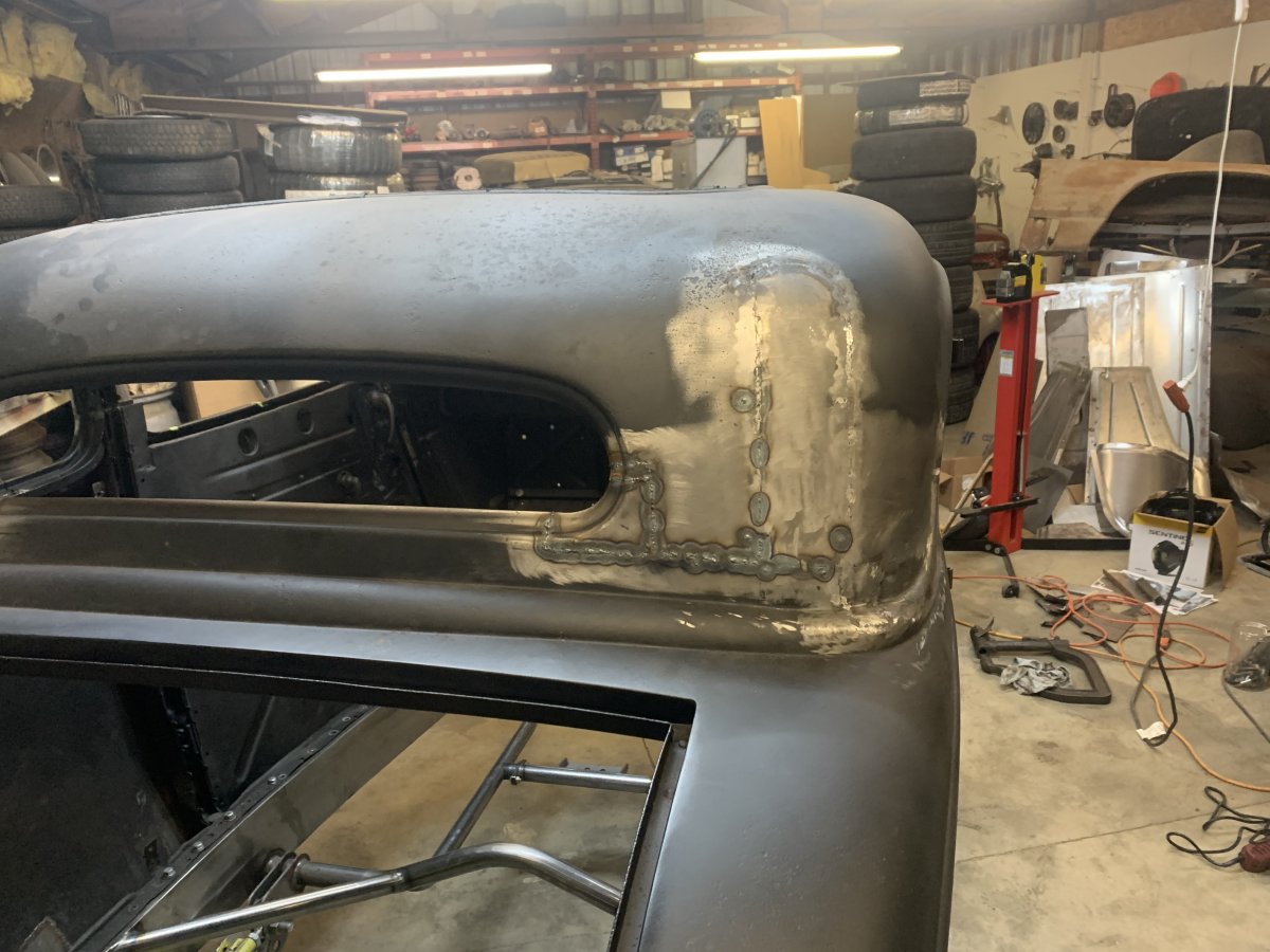

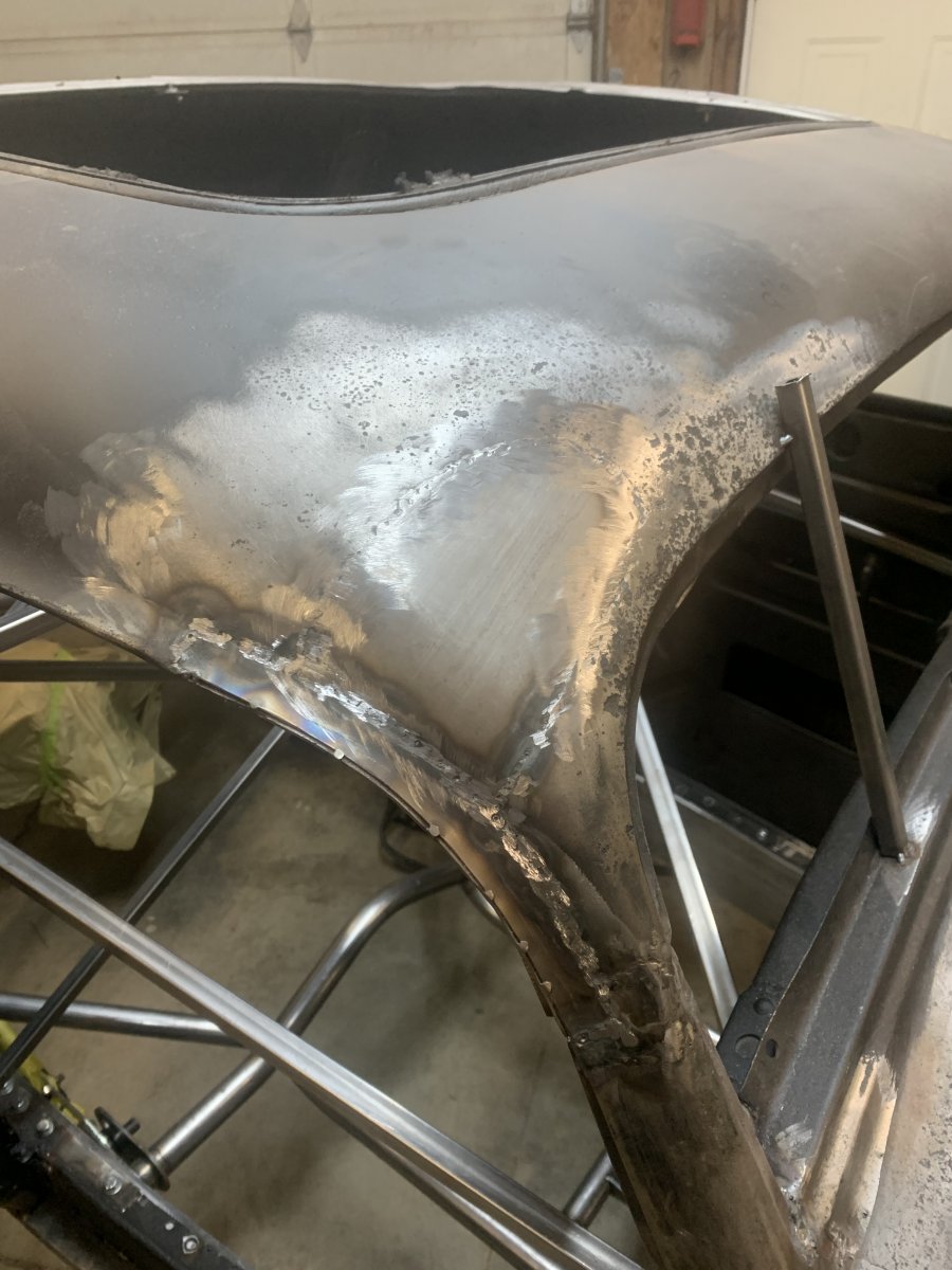

    Taking my time welding up all of the back, B-pillars, and A-pillars before I get the bracing out of the car and begin to figure out the door tops and garnish moldings. My TIG welding has improved quite a bit from beginning to end. Glad I decided to go that route so I could learn a new skill. Still a long ways off but feels like I am on the downhill side of the chop and can't screw it up too bad now. :) welding up top(4) 3.18.21.jpg welding up top(3) 3.18.21.jpg welding up top 3.18.21.jpg bracing out 3.19.21.jpg

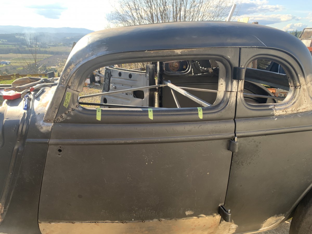

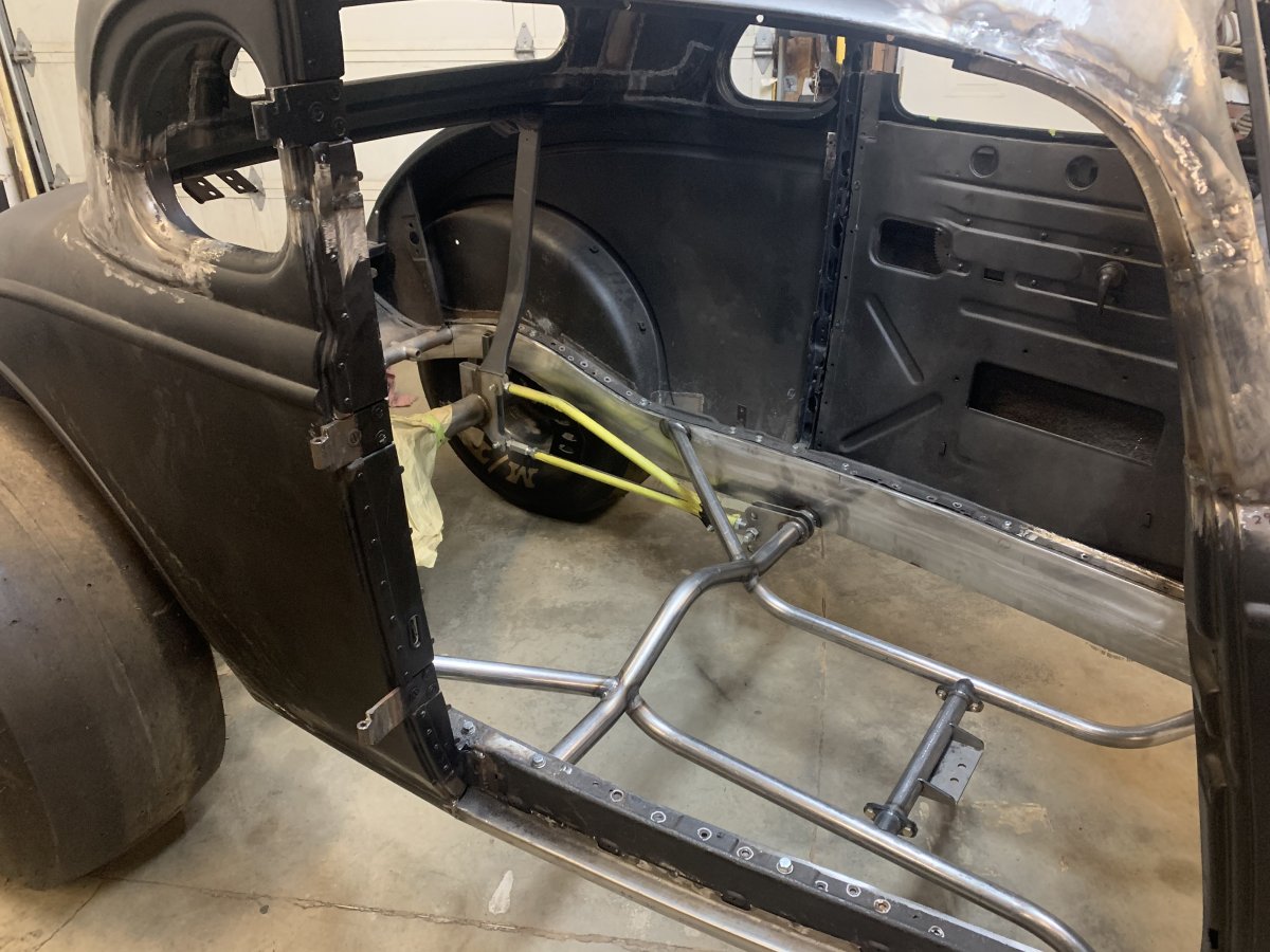

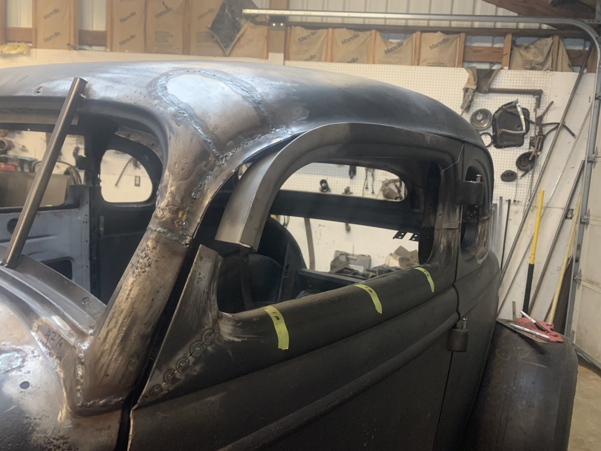

    Worked on the door top on the driver side last night. Since the A pillar is cut just slightly more than the B and C pillar it gives the top a slight rake. This provided a little challenge with getting the door top to gap correctly with the rain gutter. Also since the A pillars have been leaned back I had to rework the front of the door top and also add a new piece in the front so that the sheet metal all lined back up. It's amazing how many little things have to be changed. I provided before and after pictures. This was a little confusing for a novice so I reached out to a few people to get some guidance. Gap came out alright and will still be some minor fitting but I don't think its coming back apart. Door top mock up 3.23.21.jpg Door top mock up(1) 3.23.21.jpg Door top work(4) 3.22.21.jpg Door top work(1) 3.22.21.jpg Door top work(2) 3.22.21.jpg Door top tacked together 3.22.21.jpg

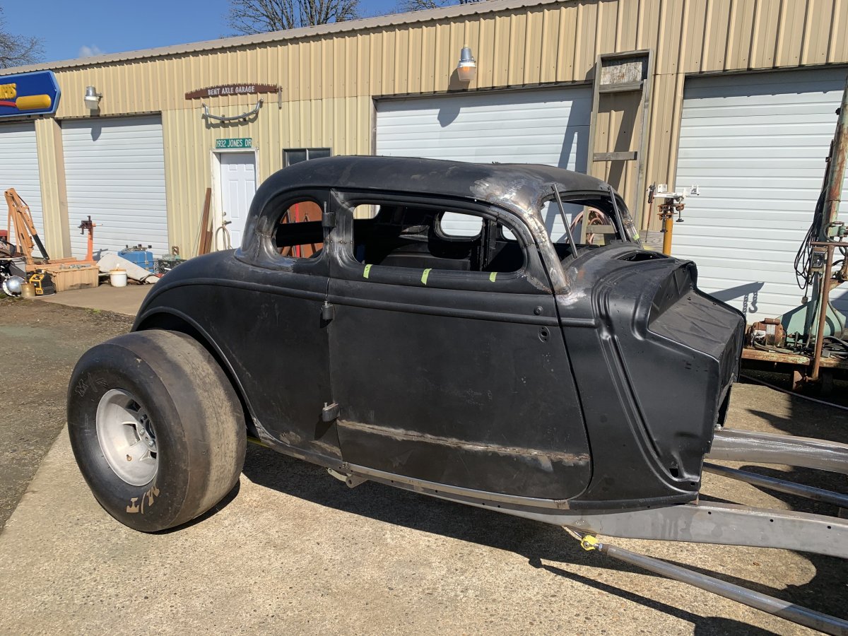

    Both doors now tacked together and rolled outside so I could stand back and get a side profile. Now time to weld everything up. Pass door top tacked together(1) 3.23.21.jpg Pass door top tacked together 3.23.21.jpg Drivers door top tacked 3.23.21.jpg

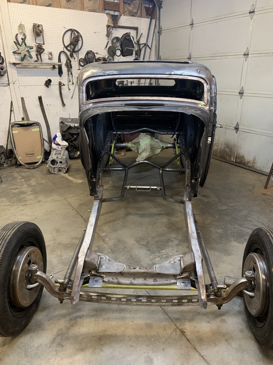

    Been finishing up little tedious welding jobs around the car. As I go along my welding with the TIG is improving so I find myself going back over areas to clean them up. I got some parts from CW Moss yesterday and have started the mockup with the radiator. With the cross member forward in the frame 3" it will require some t******* since I am running a full hood on this car. 34 coupe door repair 4.25.21.jpg 34 coupe door repair(1) 4.25.21.jpg 34 coupe door repair and gapped 4.25.21.jpg

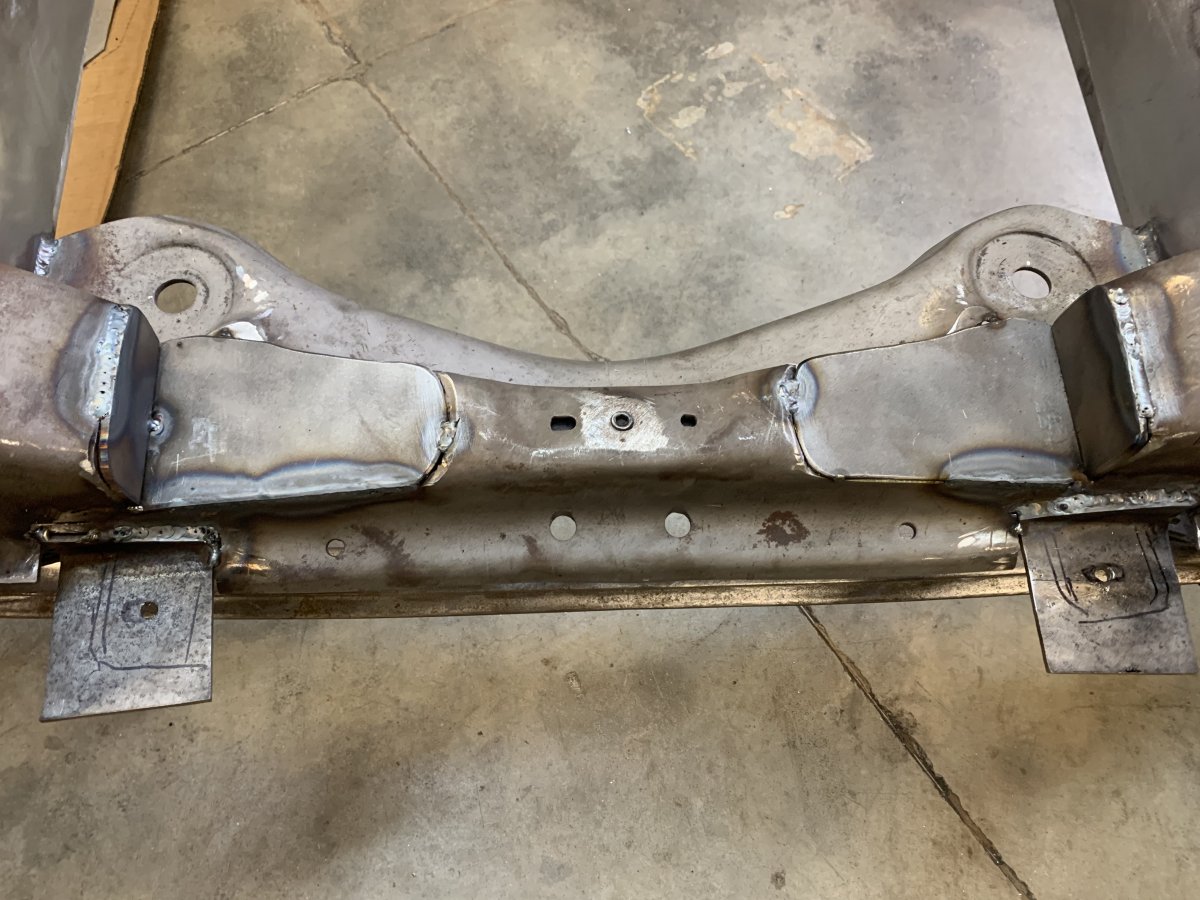

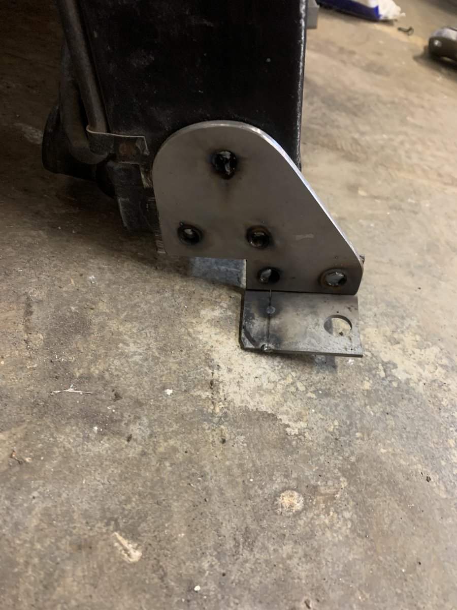

    Had some time to flatten out the crossmember and come up with a solution on the feet of the radiator. I made the mistake of thinking I had everything dialed in and welded everything up then set the hood and radiator all in place only to find out that I am 1" to high on the radiator support brackets. Picture below you can see the inner fender panel to hood is 1" too far apart. Back to the drawing board to fix the issue. Got a little motivation seeing things come together though :) Radiator fix 5.11.21.jpg Radiator and hood mockup(3) 5.11.21.jpg Crossmember fix 5.11.21.jpg Radiator and hood mockup(1) 5.11.21.jpg Radiator and hood mockup 5.11.21.jpg

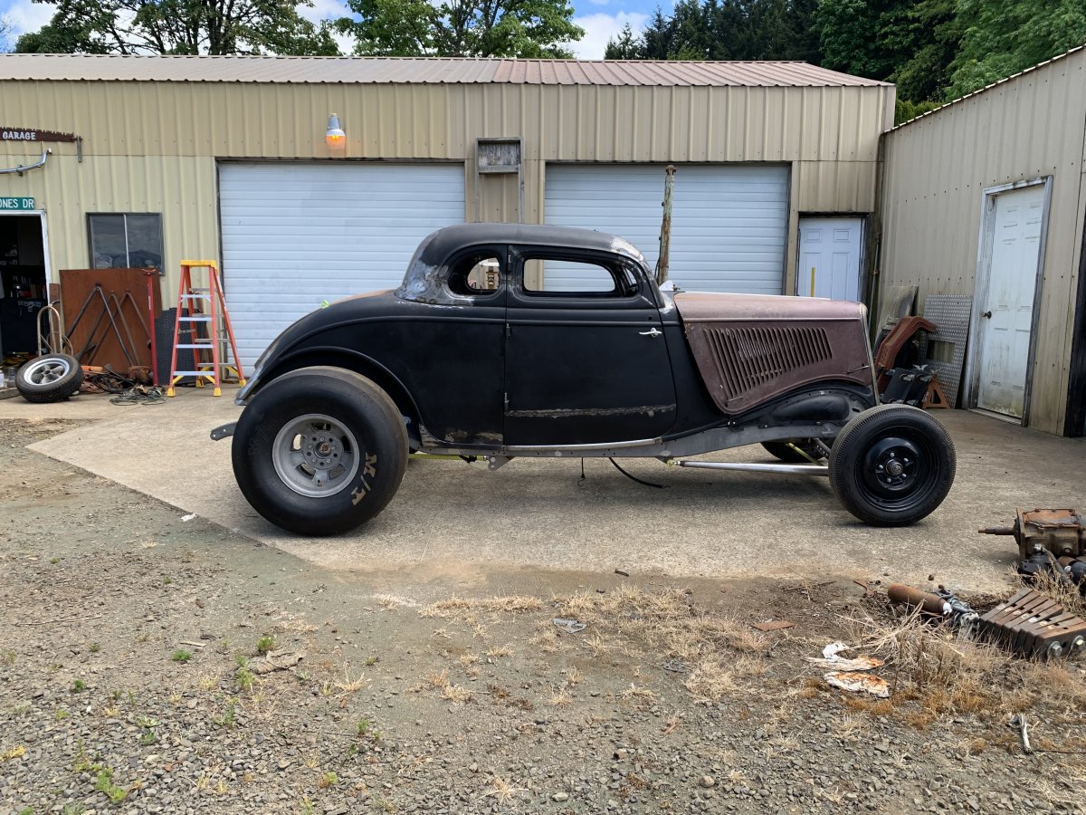

  27. fgnailhead34
    Joined: Mar 7, 2009
    Posts: 130
    fgnailhead34
    Had to redo the front crossmember changes to get the hood and grill to line up better. On my way to getting it welded up. Decided to get the firewall out so I can start to work on motor placement, etc. One more step closer. Front crossmember redo(1) 5.19.21.jpg Front crossmember redo 5.19.21.jpg Firewall out(1) 5.19.21.jpg

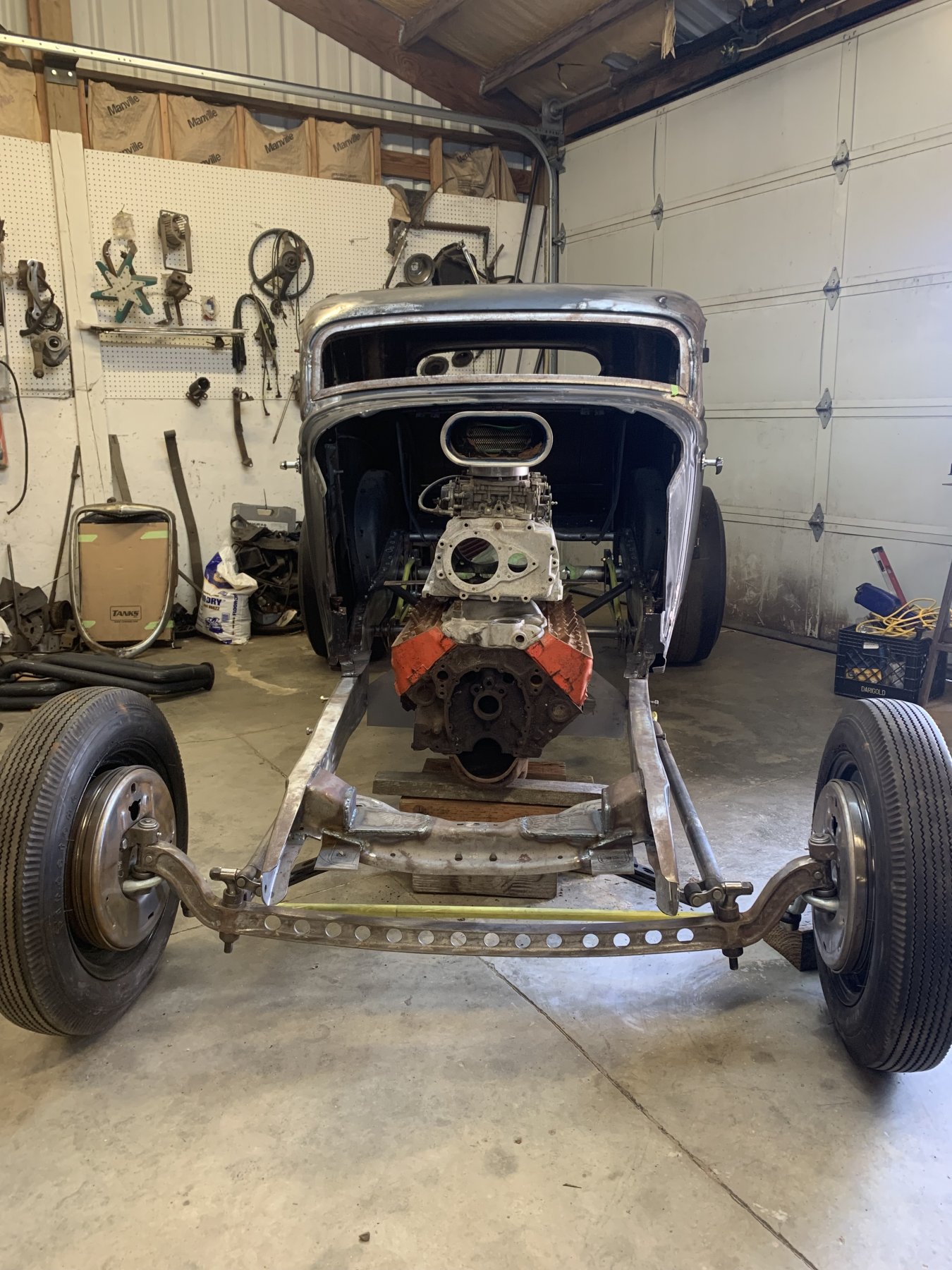

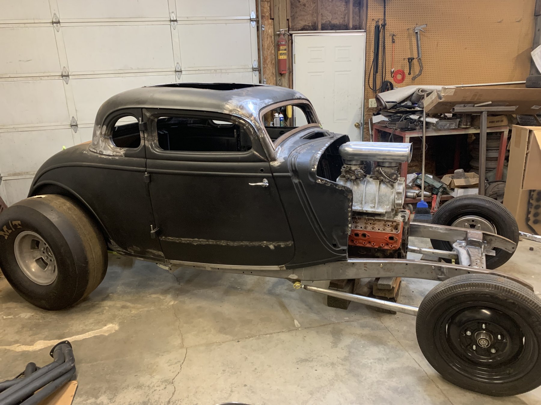

    Had some time to play motor mock up today. I am solid mounting the motor so need to build tabs on the frame to pick up the motor plate both front and back. Also need to figure out where and how I am going to position the new firewall. Getting really close to finishing up the build on the motor that will be going in the car. Will post pictures of it soon. 34 motor mock up 6.4.21.jpg 34 motor mock up(2) 6.4.21.jpg 34 motor mock up(1) 6.4.21.jpg
