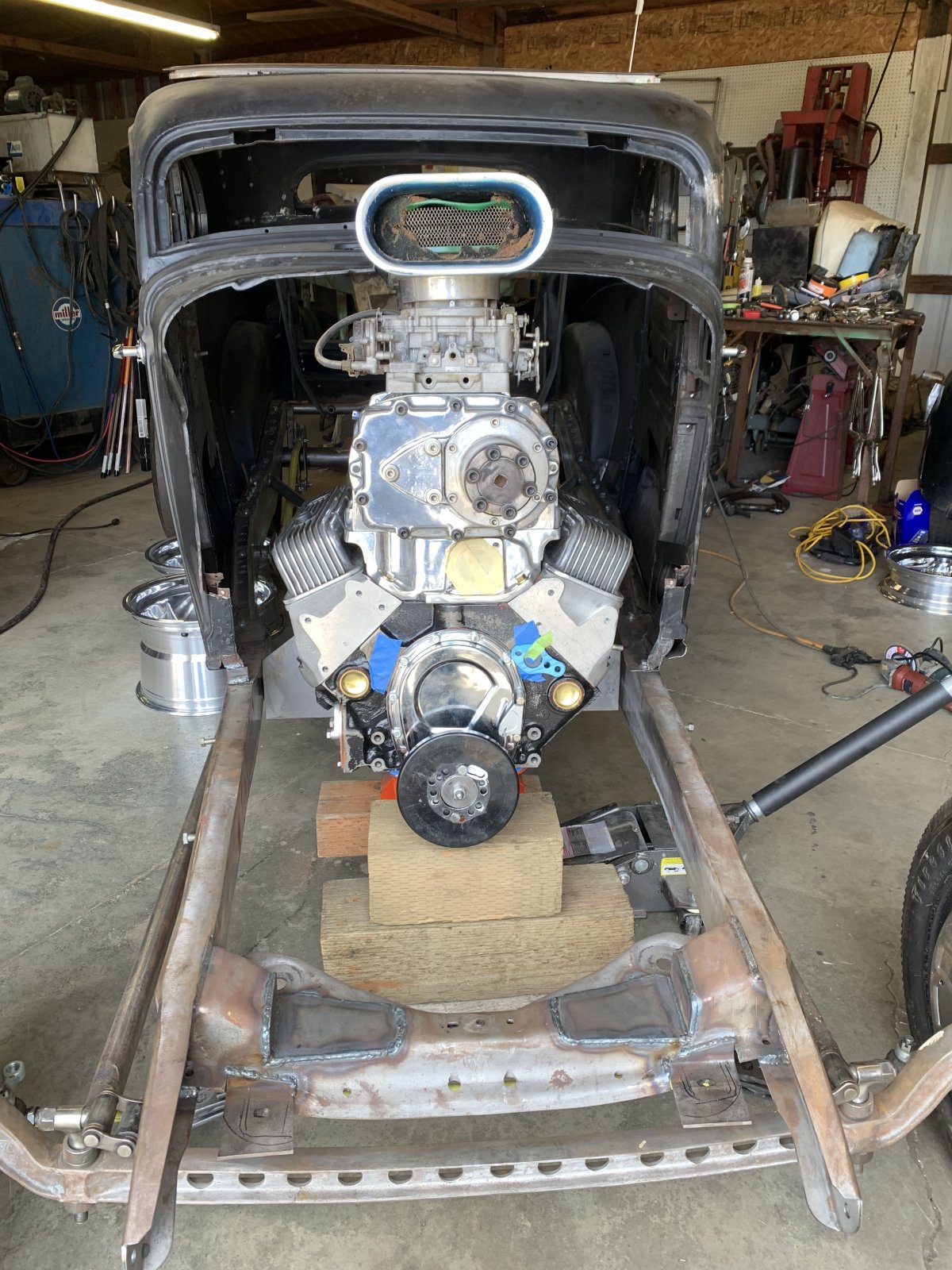

    Haha. It will come through the hood. I didn't have the correct intake or the top plate that the carbs sit on so I'm hoping once I put those on then I will be through the hood. The setback is more drastic than I thought it would be but having the scoop come up right before the cowl was the goal.

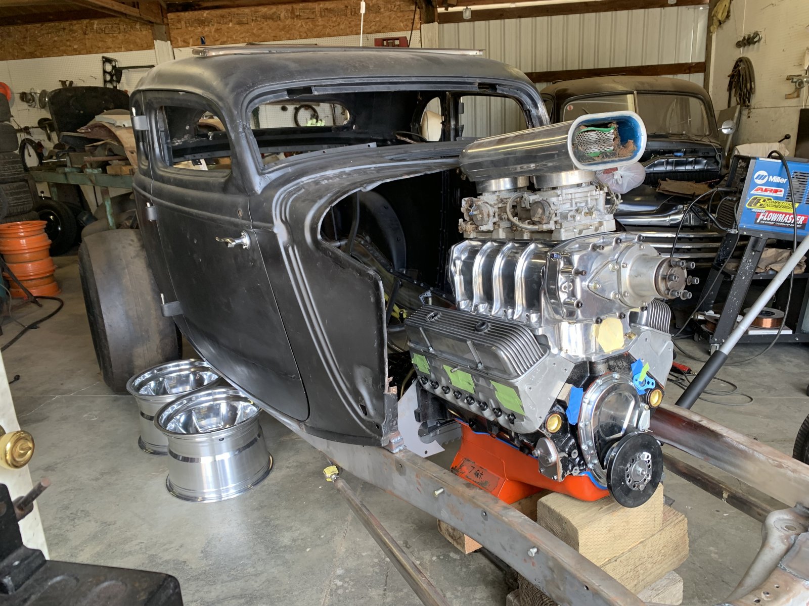

  5. fgnailhead34
    Joined: Mar 7, 2009
    Posts: 130
    fgnailhead34

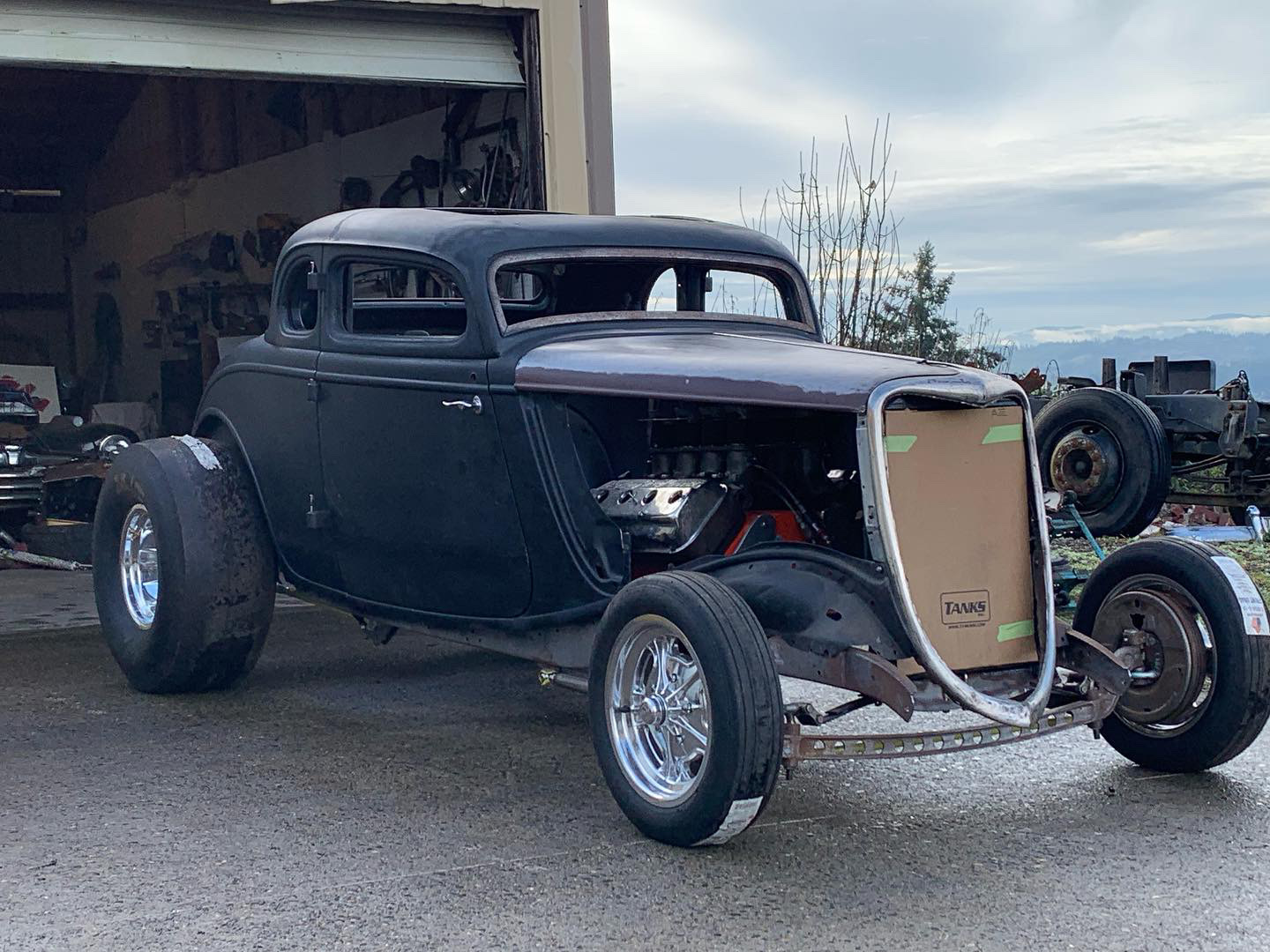

    Been slow going on the 34. Between moving houses, work, and trying to get the 40 ford pickup that my dad and I finished last year out to as many shows as possible it hasn't left much time for the race car. I am slowly ac***ulating some of the parts needed and was able to finish up the motor minus the carbs. I bought a powerglide and then hooked it up to the motor and stuffed it into the car to figure out where I am going to mount it. With @Marty Strode help I cut out some tabs to weld to the frame for the mid plate and front plates and then cut out some aluminum for the front motor plates. I am still working on ideas of how I am going to hinge the hood. With the hole for the scoop and the motor set back so far, it doesn't leave much room for the center strip to hold the hood together in the back. Want to run a stock hood vs a one piece so I imagine zeuss fastners may be the answer. Also picked up the wheels from American Rebel and excited to get them mounted and on the car! Hopefully I will really start making some headway soon.
    34 motor mock up(1) 7.21.21.jpg 34 motor mock up(2) 7.21.21.jpg IMG_5901.jpg 34 motor mock up(3) 7.21.21.jpg IMG_6257.jpg

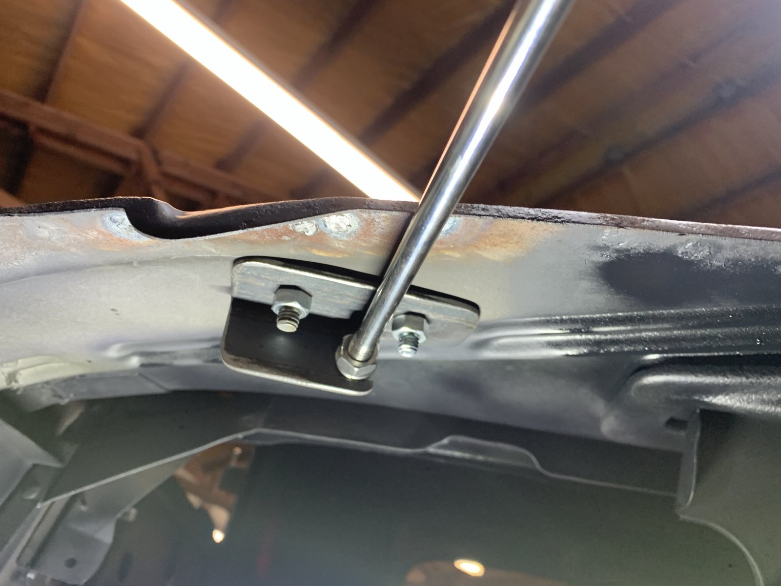

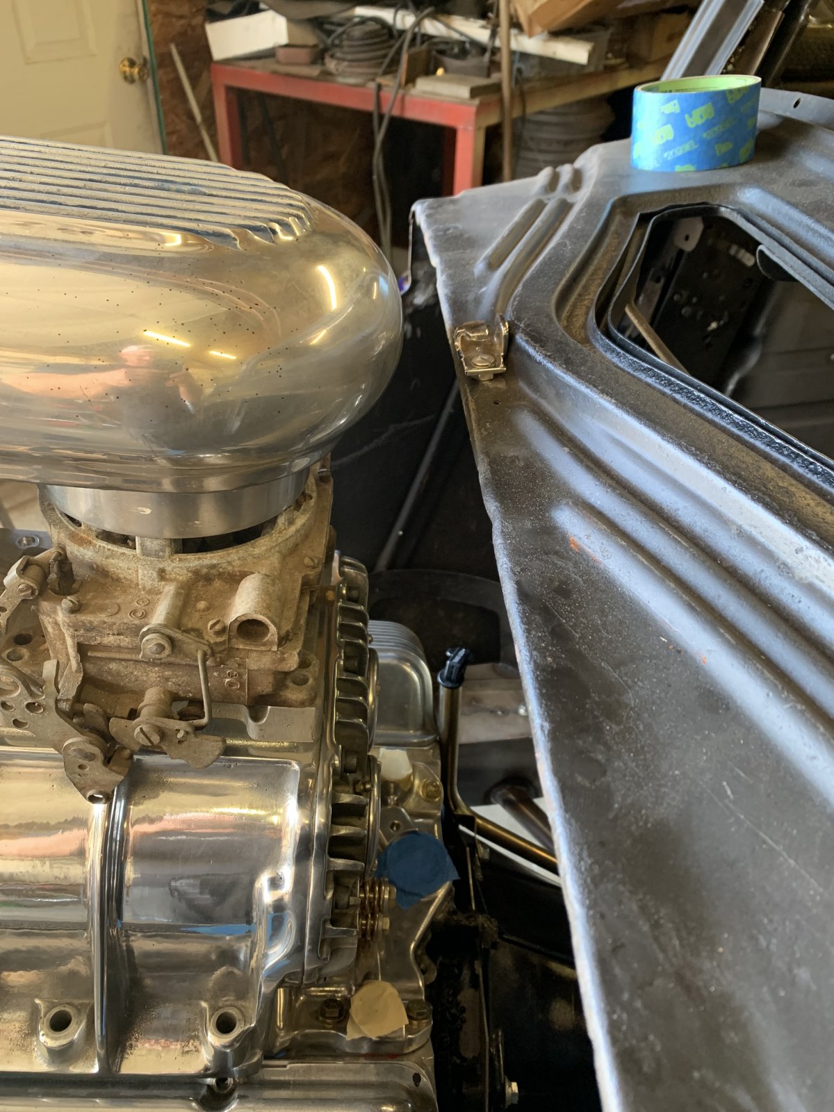

  10. fgnailhead34
    Joined: Mar 7, 2009
    Posts: 130
    fgnailhead34
    I am going to use the 4 piece hood and cutout a hole large enough so the hood can hinge up like stock but I am thinking I may put a zeuss fastner on either side of the hood hinge bracket in the back. Who knows I may just cut a small piece of the center strip and hook it up back there and that might be enough.

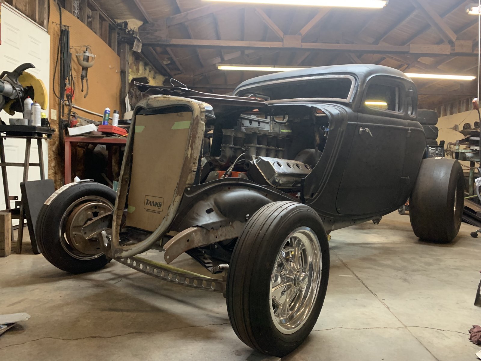

  11. fgnailhead34
    Joined: Mar 7, 2009
    Posts: 130
    fgnailhead34
    Little by little. Front motor plate and mid motor plates are in and bolted to the frame mounts. Motor is ****oned up and supported in the car. New wheels and tires mounted and back on the car. Need to get some holley carbs and the scoop sitting right where I want it before tackling the hood. Leaning towards a one piece top for the ease of lifting it off and on and I'm a little uncertain whether cutting a hole large enough for the scoop in the original hood will work. Looking forward to having all the sheet metal back on the car! Only to take back off again :)

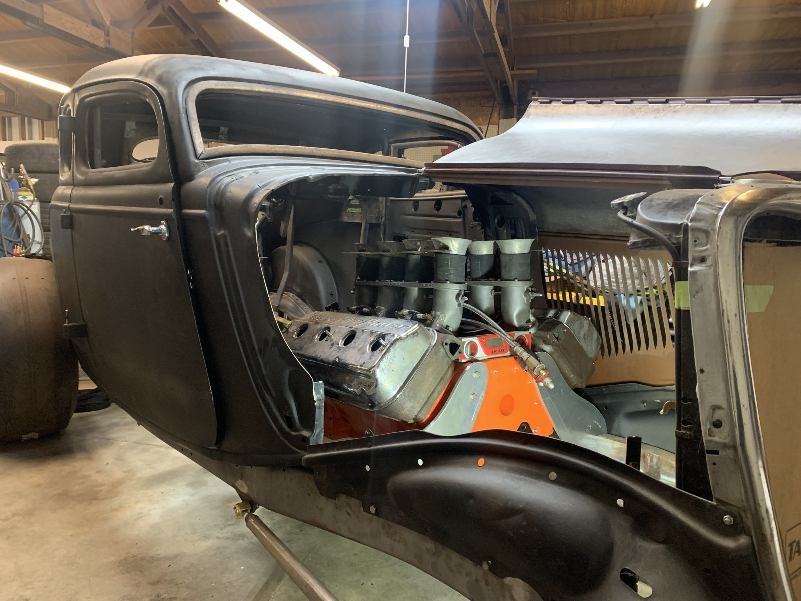

  12. fgnailhead34
    Joined: Mar 7, 2009
    Posts: 130

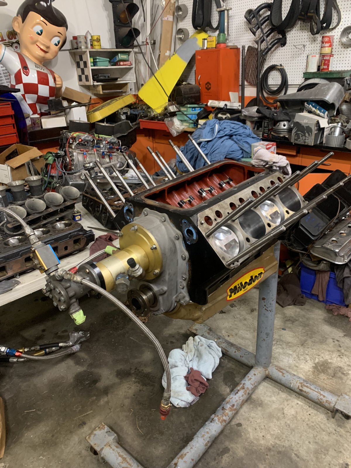

    fgnailhead34
    Well, I was fortunate to come across and be able to purchase a motor with a bit more cool factor than a blown small block. This 392 hemi was being built for a man named Stan Wilson who raced a T altered locally here in Oregon called the "Altered *******". He unfortunately p***ed away in 77' at Mission raceway in Canada when his car hit a guardrail. I have a notebook with information, specs, and notes from all of those involved with the build of the motor . Attached is an old picture of the motor along with some photos of it now as I get ready to mount it in the 34 coupe. Somewhere along the line the Donovan valve covers and fuel tank went missing. Feel very fortunate to be able to put this motor back to it's intended use. Hopefully those who were involved and helped build it are smiling down :) 392 Hemi at home 10.4.21.jpg 392 hemi spec sheet 10.4.21.jpg 392 hemi old picture 10.4.21.jpg

    Motor teardown is in full progress. Need to check everything out since the motor has been sitting for quite some time. Pretty wild seeing the domes of the pistons. 12:1 compression should make this thing run. 392 tear down(3) 10.18.21.jpg 392 tear down(2) 10.18.21.jpg 392 tear down 10.18.21.jpg 392 tear down(1) 10.18.21.jpg

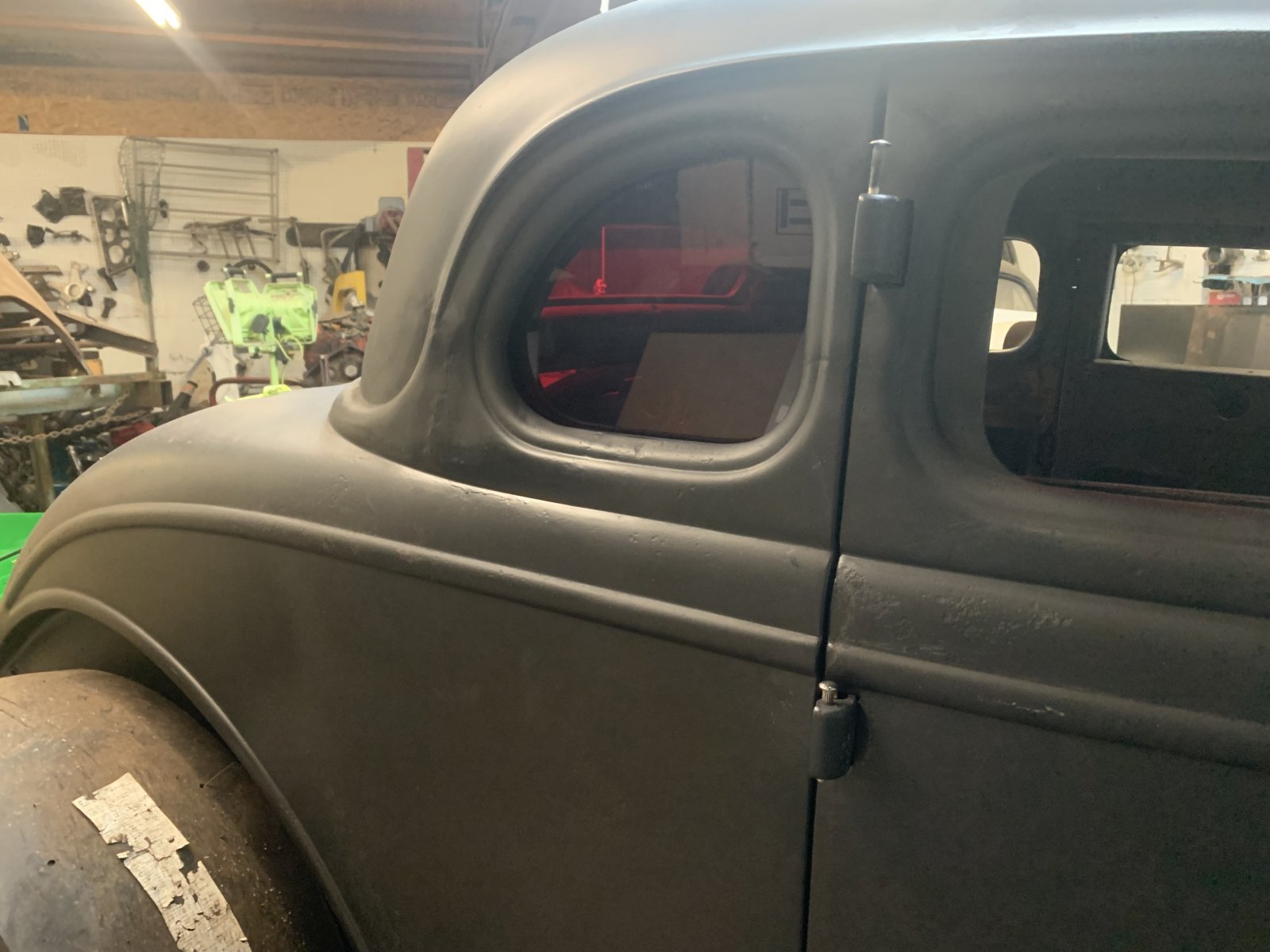

  24. fgnailhead34
    Joined: Mar 7, 2009
    Posts: 130
    fgnailhead34
    Working on a few different little things with the car when the snow allows. Took a couple spring leaf's out of the front to get the stance more to my liking. Picked up some 1/8" dark red plexigl*** and cut out the quarter windows and a piece to cover the top insert. Need to make a metal template for the inside of the grill so I can have something to d**** the plexigl*** over when I heat it up to create the peak in the grill. Never played with plexigl*** before so I'm sure this will take a few attempts. Built some radiator support rod mounts since the firewall is now removed and had to cut apart the p***enger door window garnish to make it fit better because I knew it would be something that I would only notice and would always bug me :). Started to mock up some ideas for louvers since I am taking the hood and decklid to a local guy to punch them first week of Jan. Also bought myself a Christmas present! Donovan 5 rib valve covers. Hope everyone had a good Christmas and are preparing for some burnouts in 2022! Outside shot 12.24.21.JPG Plexiglass quarter window .jpg Radiator support rod fab 12.26.21.jpg Radiator support rod fab(1) 12.26.21.jpg Donovan 5 rib covers 12.26.21.JPG

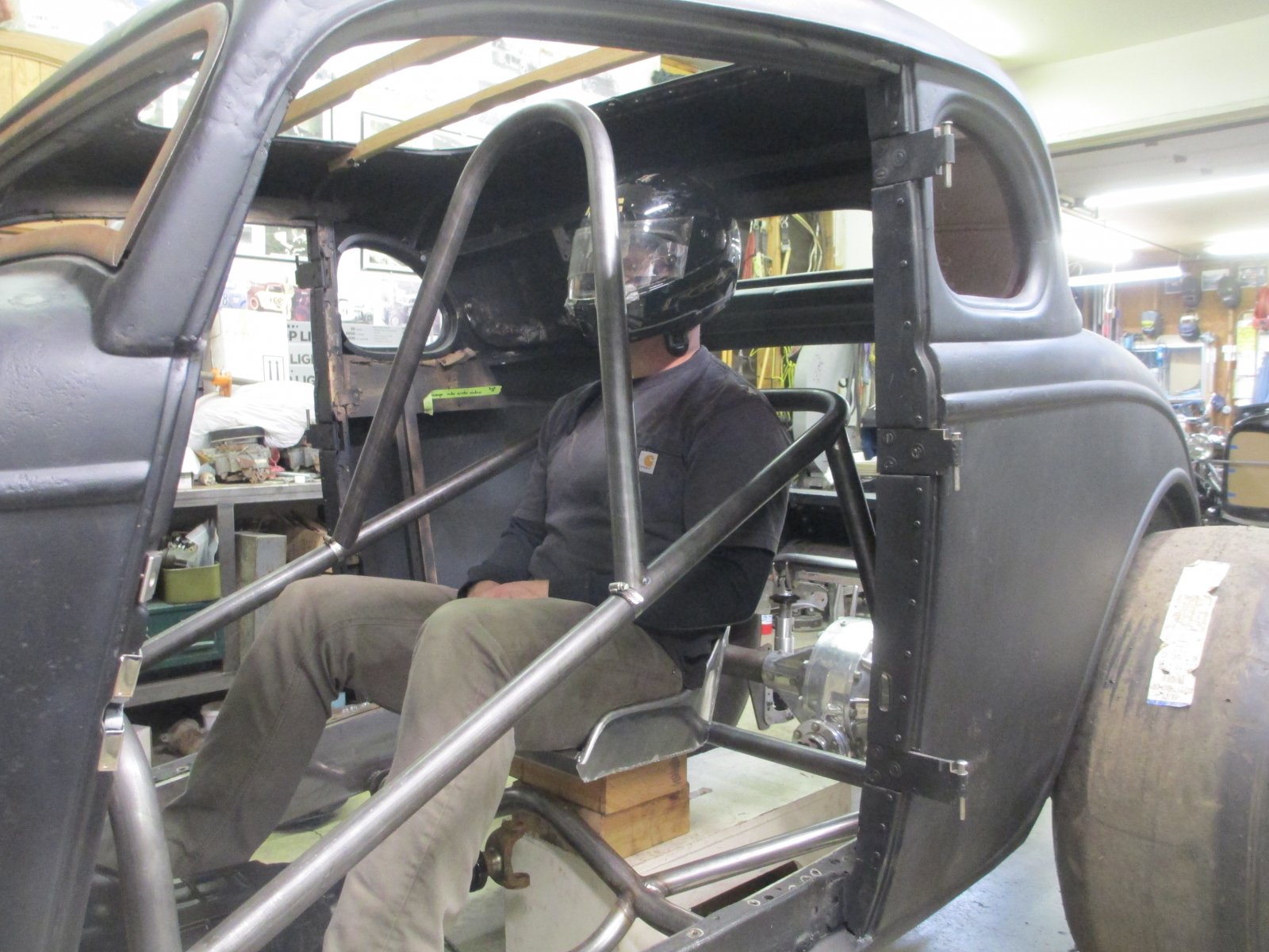

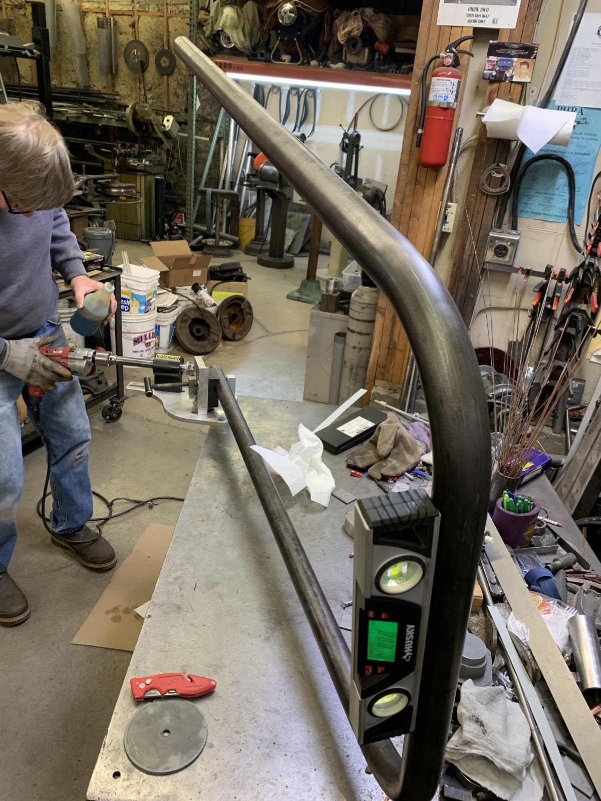

    Back on it with the 34. Son had pajama day at school and dad took the day off to start building a rollcage :). @Marty Strode the wizard is teaching me all his tricks with measuring, bending tubing, building floor diagrams, and coping round tubing. Been quite the fun experience. After some deliberating we decided to go with a funny car cage to make this car as safe as possible. The main hoop going from front to back we made a little wider than normal as I've had a few requests from some of my car club members to make sure I make the roll cage wide enough for them to fit in the car :). One club member, Robbie Davis, had to come up to check progress to make sure he could fit!! Anyway, we are having fun and making some progress. Back at it today! Rollcage 4.8.22.jpg Rollcage(1) 4.8.22.jpg Rollcage(3) 4.8.22.jpg Rollcage(4) 4.8.22.jpg Rollcage(5) 4.8.22.jpg Rollcage(6) 4.8.22.jpg Rollcage(2) 4.8.22.jpg

    @Marty Strode Took these 2 photos. Pretty cool how it's coming together.
