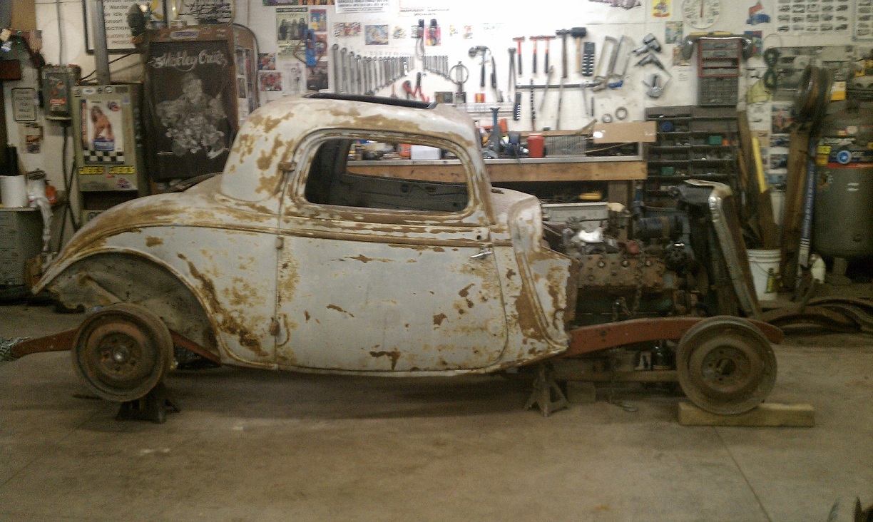

    Well, since you asked, here are some pics. I didn't think anyone really gave a **** about any of my stupid little projects. ha ha I already have 2 cars that run and drive so I am not hitting my non-running projects too hard.
    I got the '34 body blasted because I found a mul***ude of sin that needed replaced. It now has new rockers and wheelwells and I patched the p***enger door in a couple of places. i still need to address the rear pan but will worry about that after I have some sort of floor in it to hold it together. There is all kinds of brazed nonsense that needs/was removed.
    I took the ****py frame out from under the '34, boxed it, threw in a SBC and slapped together a "rudy truck" that will probably get sold to fund this project. Even the rear end was junk under that ch***is. The 8 inch was bowed over 1/4 inch from the 4 bar that was welded onto it. No wonder one of the wheel bearings was out of it when I took it apart. I am guessing that is why it got parked.
    I started building a new frame for the '34 using Ionia crossmembers and boxing plates. I am putting '32 frame horns on it and pinching the frame. I am going to do a couple of trick things with the motor mounts and try and make it all look like it could have been factory with Brian B*** fake rivets (TM) and Sam Strube suspension mounts and all.
