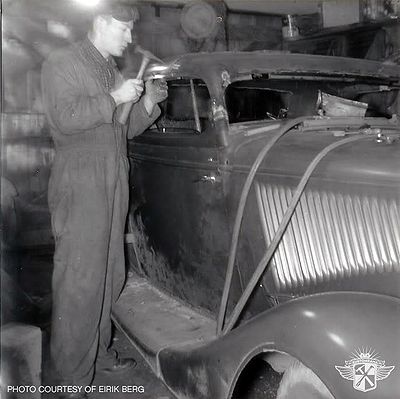

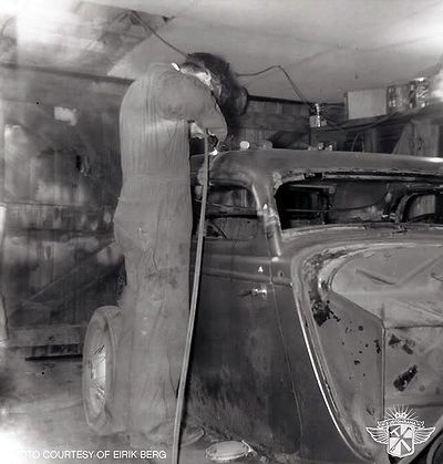

    I've just been lurk'n around just watch'n and even learn'n. They chopped mine 4 1/2" I'm told back in the mid 50's, ('55 or '56) and I really enjoyed seeing how it can be done. (I have the entire history of my car from purchase in '34 to my buying it in '95, with pictures through its entire history)
    What an outstanding accomplishment you've done. Your one talented guy. This is an absolute killer 1934 ford coupe built so far and your to be congratulated.
    I am also considering the lakester headers and have delayed not knowing how they would look and how low they are after installation. Now that I have seen yours, and how damned good they look that may be my next project on it. As far as seats, mine are 90's Mustang power (3) way power using the mounting that came with them. I of course can raise and lower them from the highest geek (square in my day) look, or lower them to the rolled up T shirt sleeve, arm out the window (way to cool for you) look.
    Can't and won't post pic. because IFS/IRS suspension and wouldn't if I could because I'd consider that hijacking your thread for my ego. I am looking forward to the day you consider it done, (even though they never are). being chopped.jpg being chopped 1.jpg finished chop.jpg
