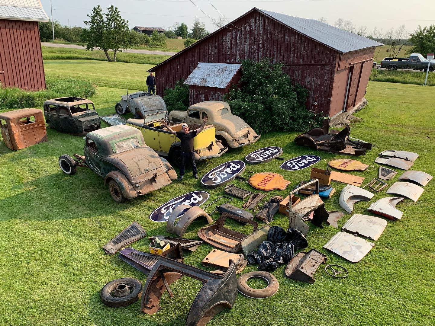

    Back in 2021 @IronTrap purchased a huge collection of 34 Fords, and I snagged the 34 Cabriolet, my first hot rod. The Cabby was in the loft of one of the barns on the property in pieces. The body was a hot rod at some point and channeled heavily. The b pillars are missing the lower 10" and have these heavy plates that were the mounts that sat on the floor.

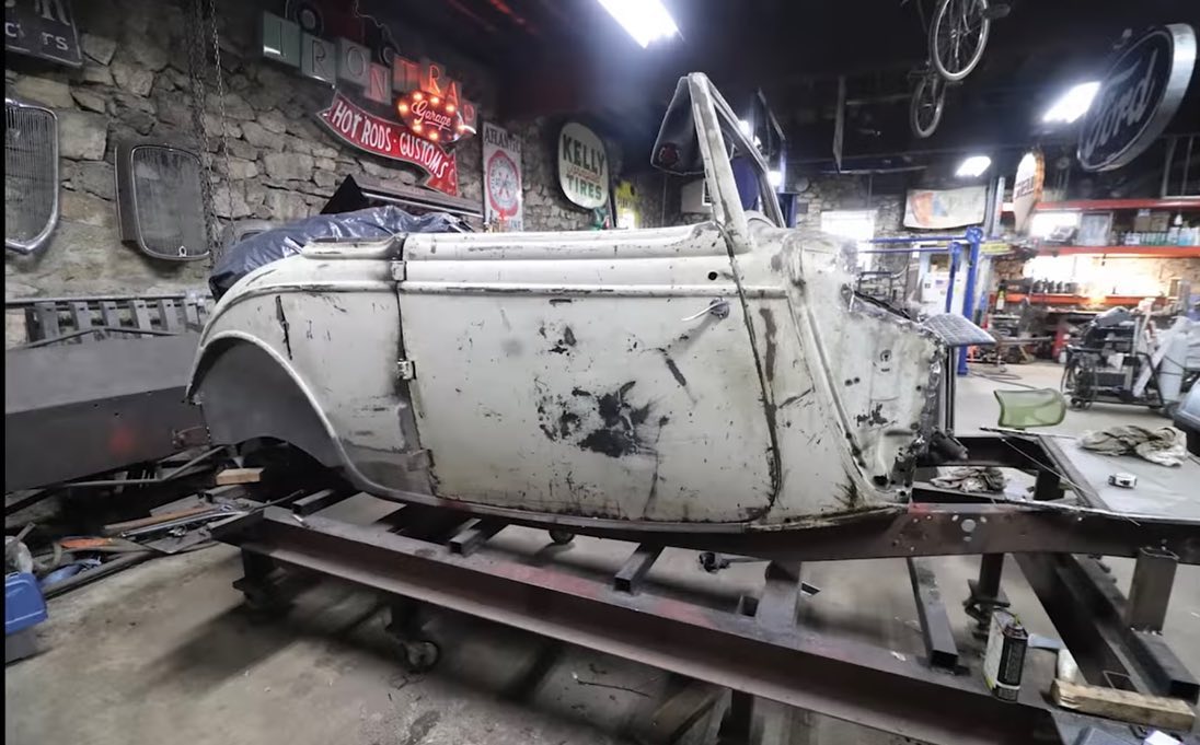

    Thankfully Matt has a frame table that will allows us to fixture the frame level and start pieces together the body. The first step was fixing rust on the rear of the floor and the panel below the trunk. After the rear panel could be bolted in we can bolt up the quarters and work on grafting in the lower portion of the pillars. Thankfully we had an extra set of b pillars.
    273773205_10161524464084465_1211281305152026348_n.jpg 273884053_10161524464089465_7064349536145237264_n.jpg

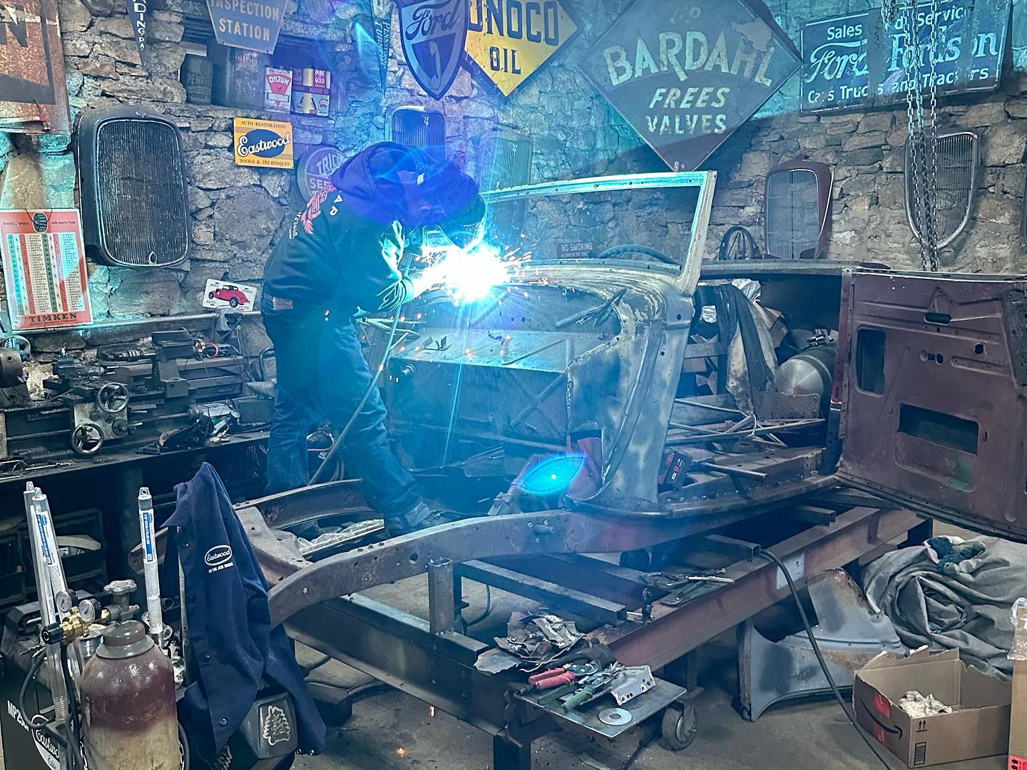

    With the Pillars set we started to work on hanging the doors and putting the cowl onto the cowl feet. Getting the whole mess to work together was a pain in the *** but we got it all together.
    We got the cowl welded in we started on the repairs that were needed. Rockers, Lower Quarter panels, and wheel wheels. We also replaced the firewall and fixed the side of the cowl that randomly cut out

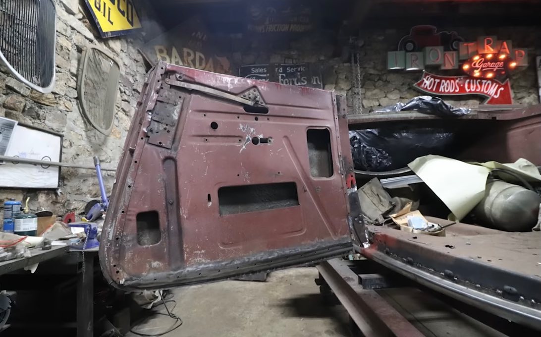

    The last major hurdle were the doors. Both were smashed i the bottoms, and the p***enger side was missing the lower 2". The drivers door ended up being full of lead and needed a bunch of metal work. Big kudos to Matt for all his help!!
