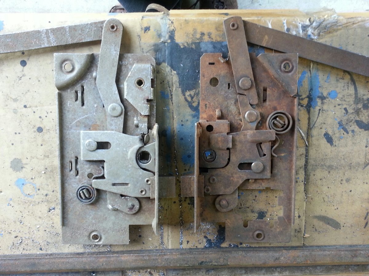

  7. Johnboy34
    Joined: Jul 12, 2011
    Posts: 1,665
    Johnboy34
    from Seattle,Wa
    One latch was made by "Swiss" and one was made by "Ford". Why they made it two ways??, See the one on the right has an extra pivot. I'm in the same boat, one of each and did not notice till I had them all restored. Maybe we could trade one?

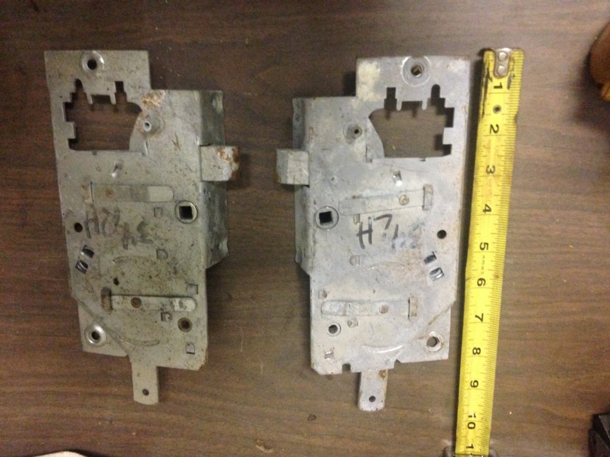

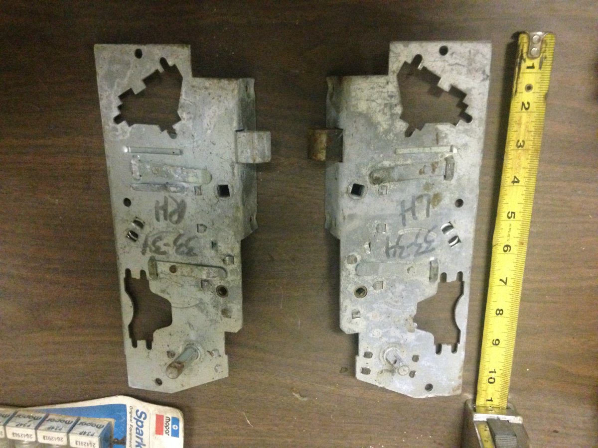

  12. stillrunners
    Joined: Aug 27, 2009
    Posts: 10,607
    stillrunners
    from dallas

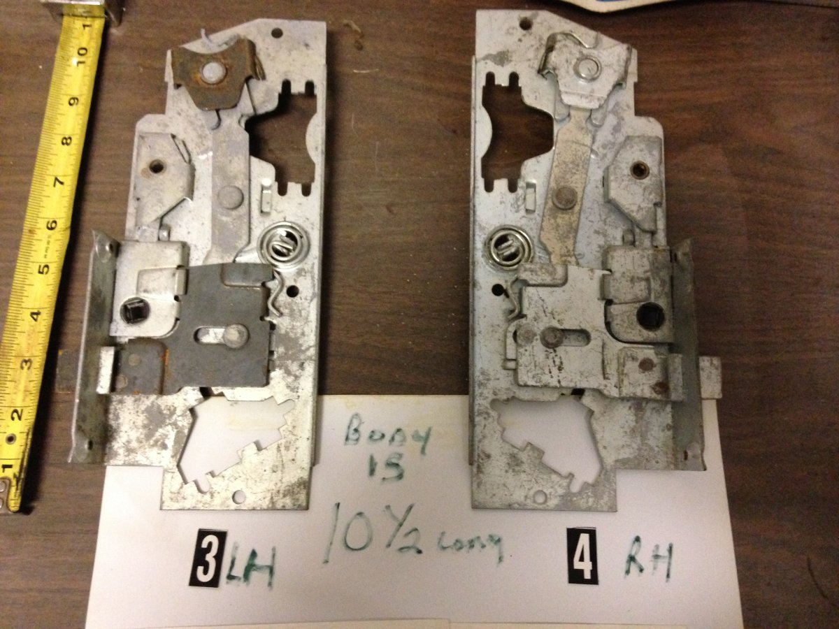

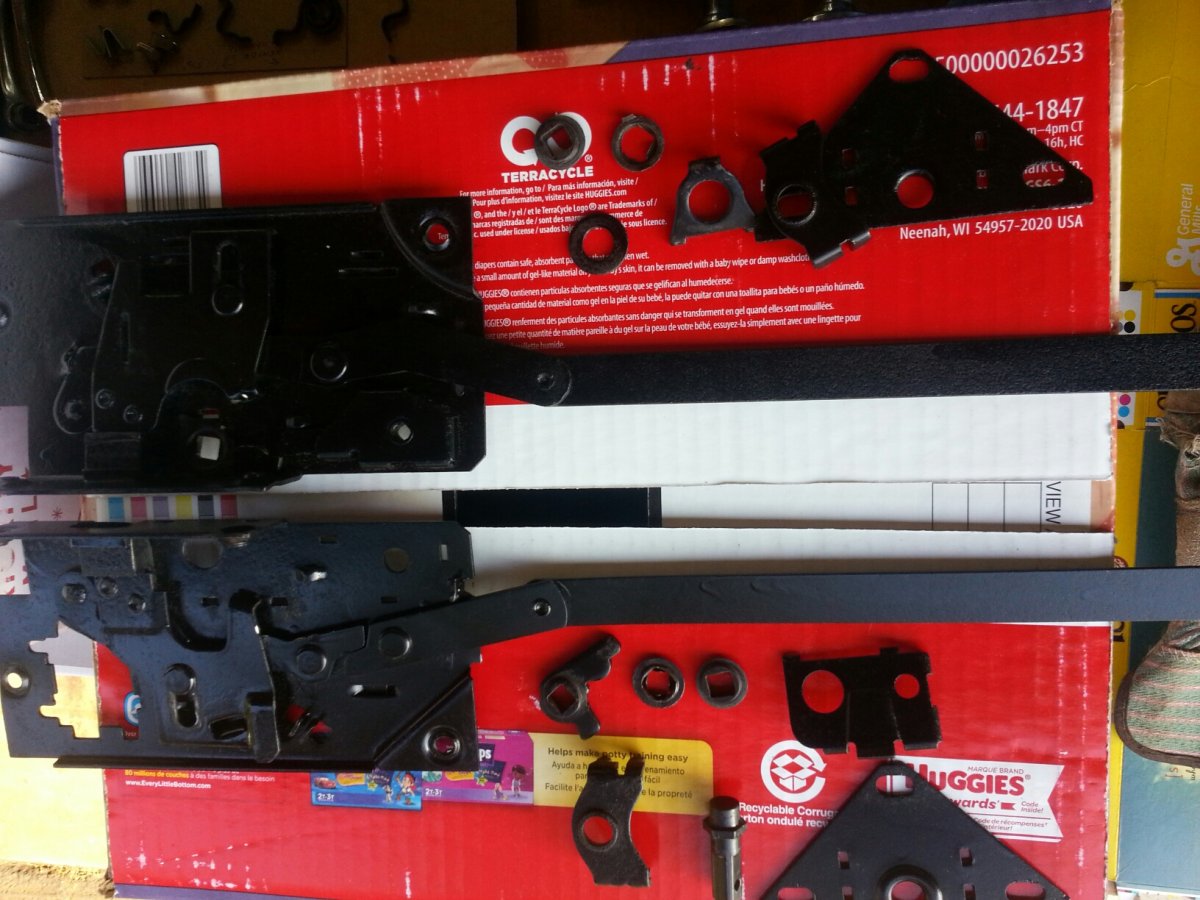

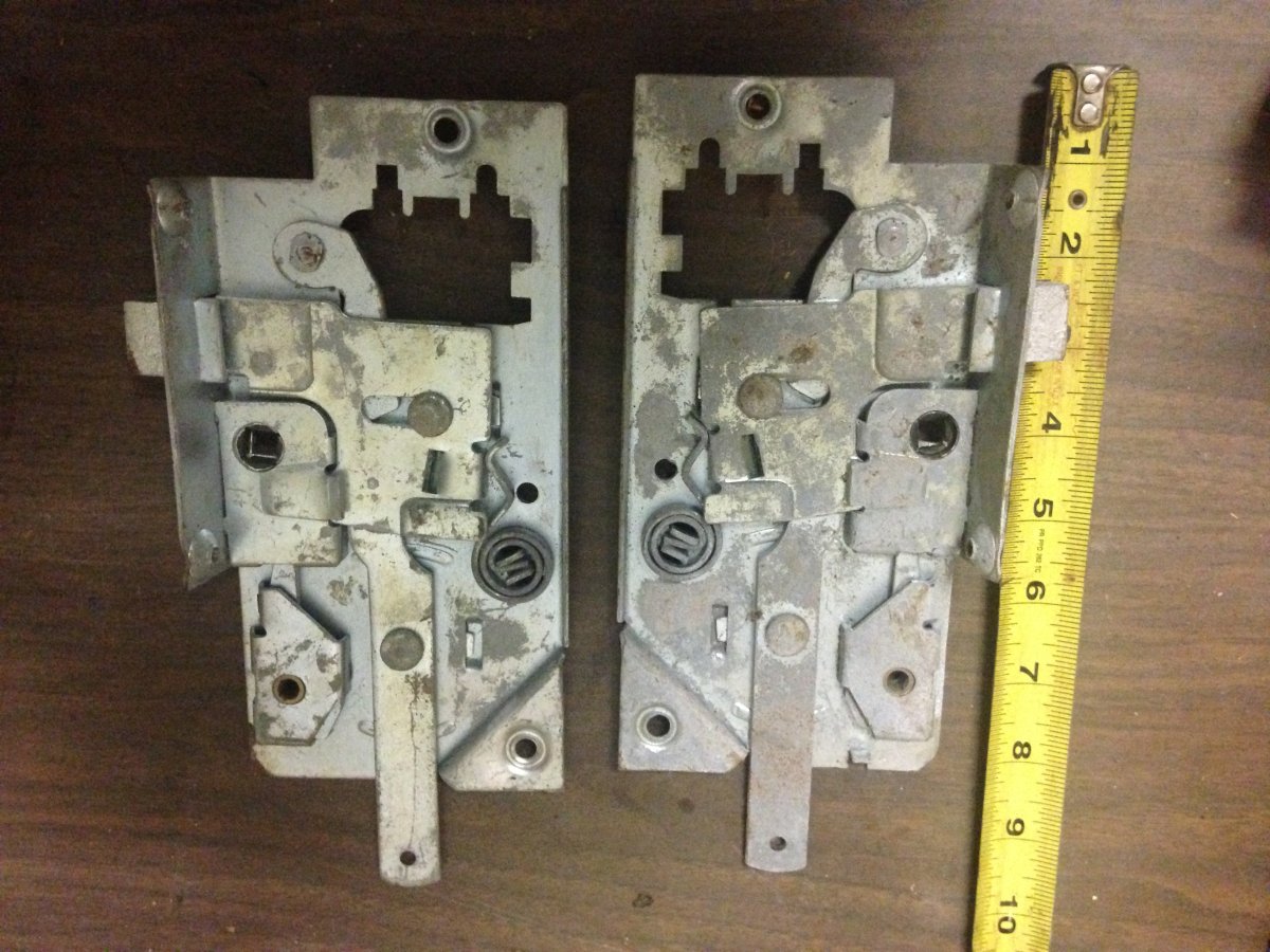

    still not sure.....they were marked 34 Ford....... IMG_3193.JPG IMG_3194.JPG IMG_3195.JPG IMG_3196.JPG IMG_3197.JPG IMG_3198.JPG

    stillrunners, those are interesting. Sure looks close, looks to be three pair? The center pair has the forward handles. Interesting all have outside key lock on both sides.

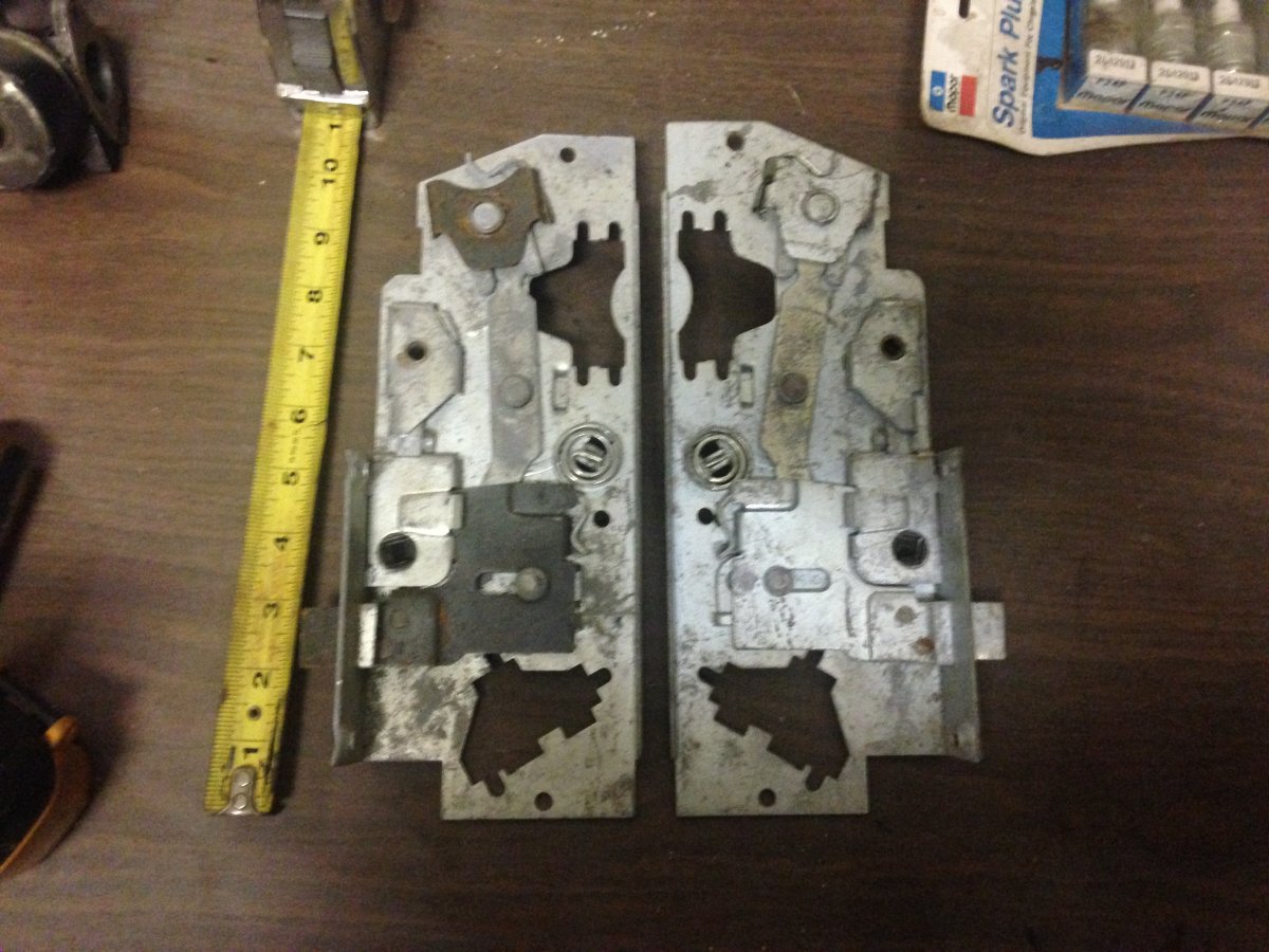

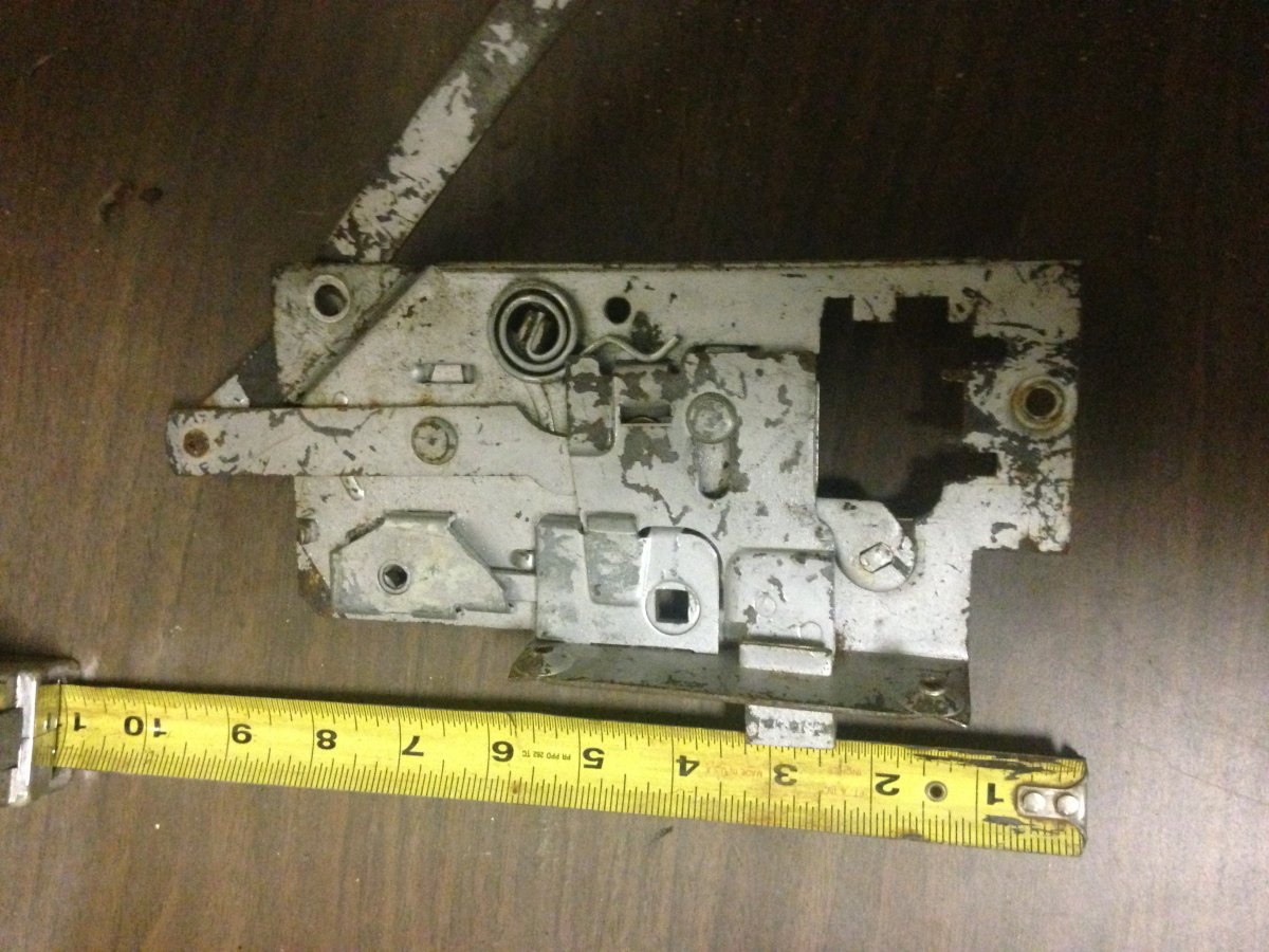

  17. stillrunners
    Posts: 10,607
    stillrunners
    from dallas
    Well....there's more - just pics of the clearest ones - they should be repo's as they never any of them had the Ford paper tag on them ? They were swap meet stuff I got maybe late 80's ? Should I take the picture of the others - the one with the arm was the only one with one. They do have LF and RH on them.....some have the long body and the others are a short body.....

  19. stillrunners
    Posts: 10,607
    stillrunners
    from dallas
    here's maybe some help IDing what I have.....one pair the main body is 8 1/2 long and the other pair is 10 1/2 long....
    Johnboy34 likes this.
  20. Johnboy34
    Posts: 1,665
    Johnboy34
    from Seattle,Wa
    Your # 1 & 2 are the closest to mine, remote handle, Mine are 7 15/16 X 4 so could not be sure it would fit in the door recess without trying. Not sure about the others because they are the early forward handle style. Thanks

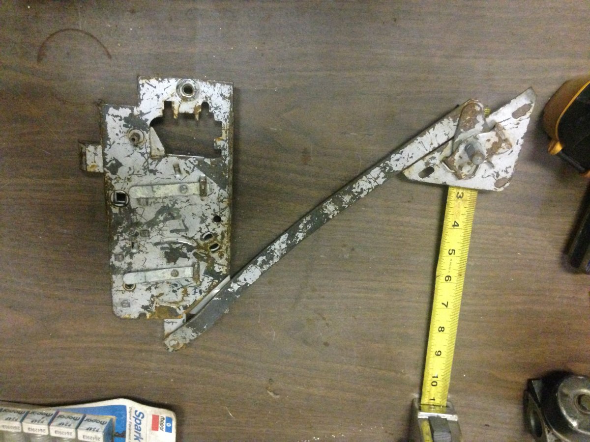

  21. 31aford
    Joined: Dec 20, 2006
    Posts: 123
    31aford
    from az
    I just measured mine they are 8" tall and 4” wide. That is 8 tall not including the lever just the body of the latch mechanism. I can't get the picture to upload says it is too big.
  22. 48-760
    Joined: Dec 15, 2009
    Posts: 156
    48-760
    from OH
    Ford P***enger car used a out side door lock on the RH side only, the LH side latch mechanism typically do not have the lock mechanism incorporated as some of the examples above. The rear doors of the deliveries have a lock also. The 33-34 restoration book list 3 different style latches for 33 early 34 and two for 34. The 34 latches have a shorter rectangular body than the 33 early 34 which is 10 1/2" tall. All three styles of the 33 early 34 latch would be also be the same height.
