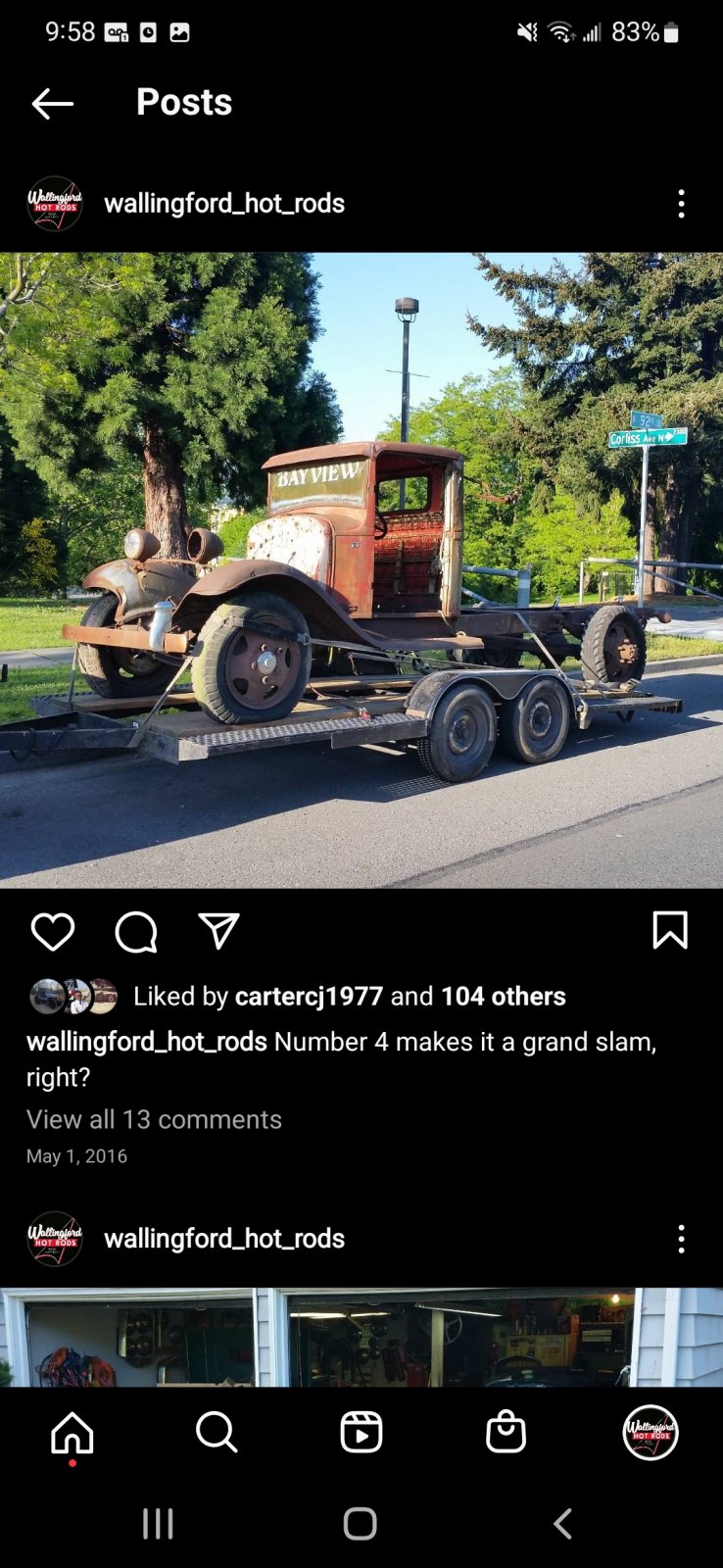

    Anyways..hot rods rule...here's a shot of @Flootiebuell 's new truck. He had to buy it since I wouldn't sell him mine.

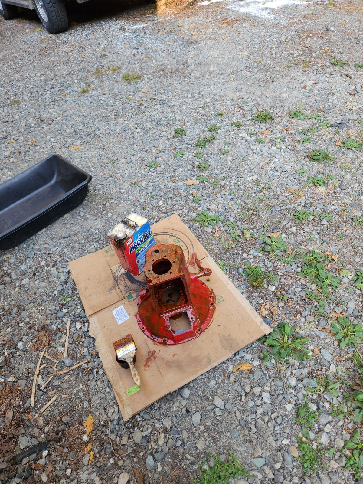

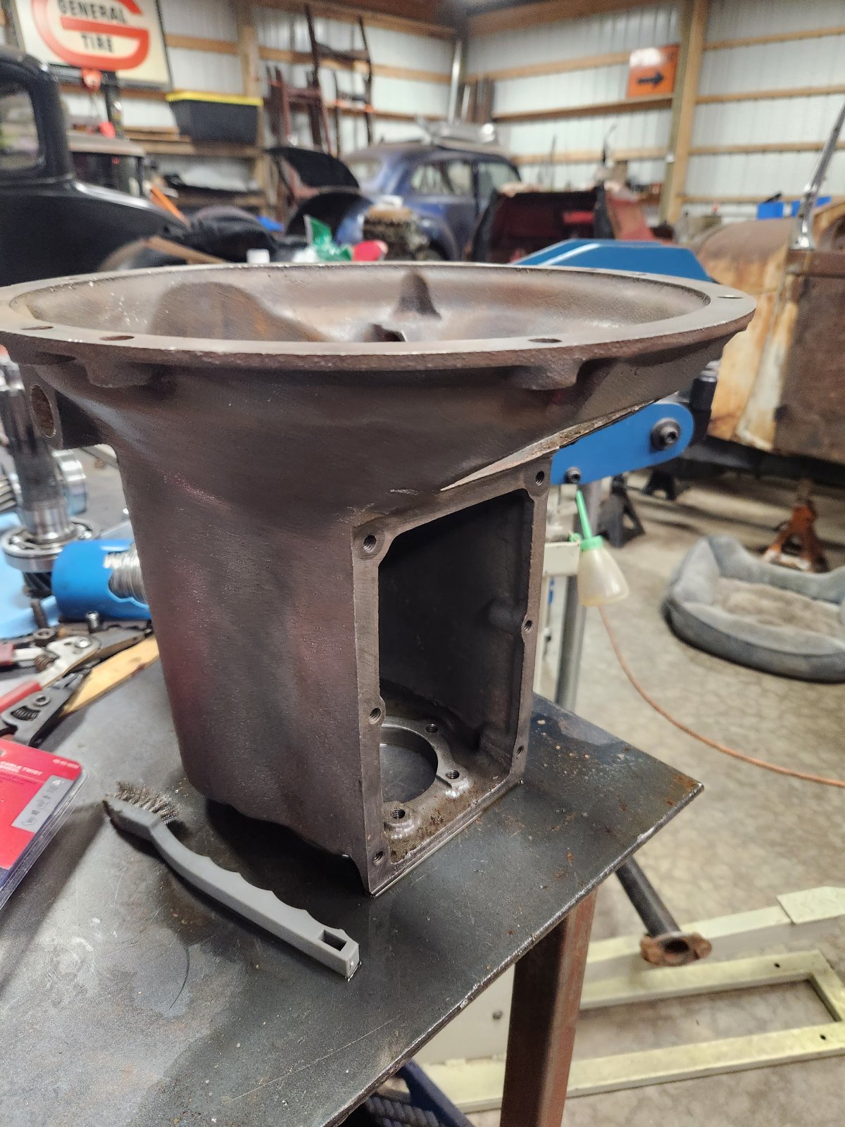

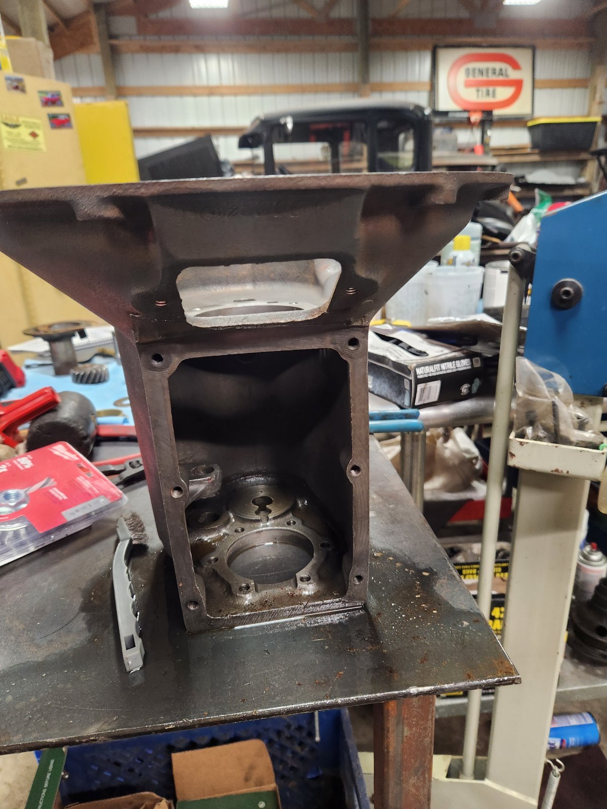

    Went with paint stripper. Box got the goo, sat for awhile, wire brushed it. ....then washed it off. And cleaned up as much as possible in the solvent tank after.
    So I inspected the guts. The input and output shaft bearings were ****. Definitely not replaced when it was "rebuilt" Glad I took it apart to check things out. Everything else looks good. I had some new bearings on the shelf, so I swapped those out today. This is a 28 tooth cluster.
    I like to lube all the bearings so they stay in place in the cluster and I hit all the thrust washers too... So they stay in place as well.
    I stupidly did not get a picture with the cluster in. But I go ahead and put reverse back in it and then slide the cluster in. I just put it in the bottom. Then I put the main shaft and synchro in, without the rear bearing. Then the input shaft goes in. Make sure not to forget the bearing inside the input shaft for the mainshaft to ride on...(ask me how I know) And then I put the rear bearing on.
    After that you can hopefully get the clustee gear aligned easy and slide its shaft back in. Then you're good to go.

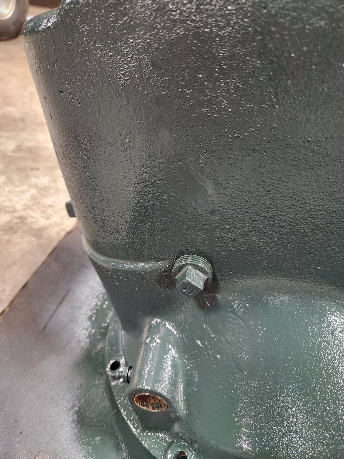

    Tomorrow I'll clean the outside of the case one last time, rtv a couple things like thr cluster gear shaft and the reversegear shaft. I'LL Add the front and rear bearing retainers and paint the case too.
    Once everything is clean and ready to go, I can usually ***emble these pretty quickly. The first one I rebuilt maybe 12 years ago took me hours.... I had no clue what I was doing. Now I am doing them in 30-45 minutes or so. They are pretty easy to rebuild. Cleaning them and inspecting parts takes the longest. I have many hours in that part of it. I highly recommend @Mac VP for all your parts need. Get his book too. Very detailed. Made a lot of things clear verses how I originally learned to do one.

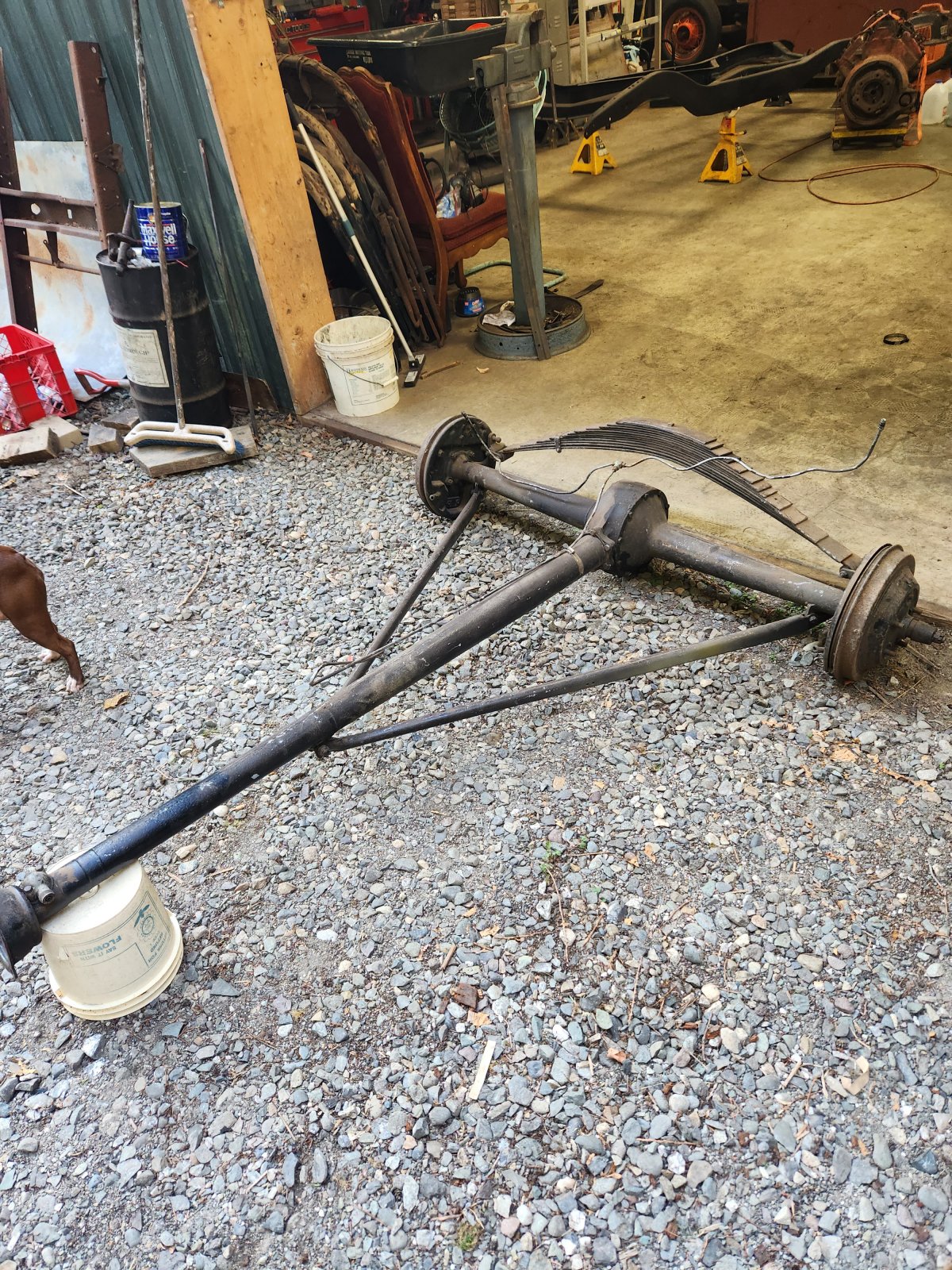

    Also started cleaning up the rear end. I should be able to finish up tomorrow morning and get some paint on it. Then I'll throw the front and rear end in and we'll have a roller. I'm hoping this thing isn't terrible. I'll try and run it first and if it's garbage I'll tear it apart and rebuild it. I've been lucky in the past and haven't had to rebuild one of these... yet. Though I have several shelving units full of dis***embled banjos. This is the only complete 33-34 rear end I have. At least it rolls...I'll change the fluid in it soon.
    Next thing to figure out is checking out the clutch and getting the engine up on a stand and take a peak at the internals and cleaning it and painting it. Where just gonna give it the old once over and Rustoleum rebuild as well and cross our fingers. I have a 59 Ab, that may get rebuilt to replace the 221 further down the line. Right now I'm just looking for a yard driver.

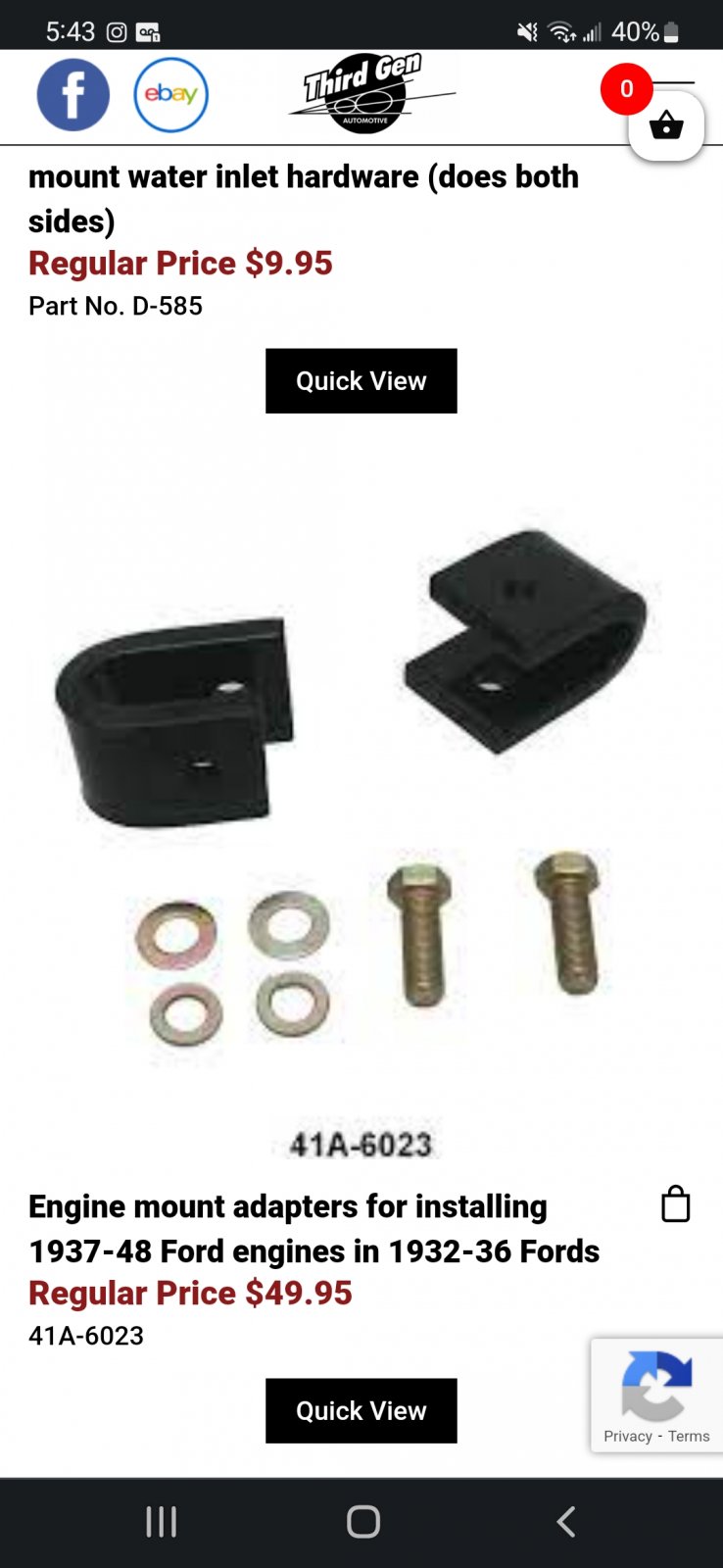

    I'm ***uming I need these for putting the 1939 ish 221 21A flathead in my pickup? Anyone know?

  10. Those are 49-51 Mercury front motor mount spacers. If you're building your own front mount stands off the frame rails, you won't need them if done right.

    I'm trying to use the stock mounts in the 34 front crossmember. Was ordering up motor mount pucks and saw these and it kinda seems like I need them...judging by the listing.
    bchctybob, Jeff34 and 41 GMC K-18 like this.
  12. My bad, I lost track. I thought you were doing a Model A frame. I have built those spacers using 2" tubing and caping with a stud and nut in the caps. Let me raise the motor a tad more and helped with steering to exhaust issues.

    I have those in my '34 PU. I think you need them.

    I got the scoop on them... in case anyone else is curious... We need them because the engine mount spacing is different on the early frames vs the later engines. The spacers aren't necessarily spacers, but more of a way to get the holes to align and bolt on. Between the two. You can see the holes are kinda offset from each other.

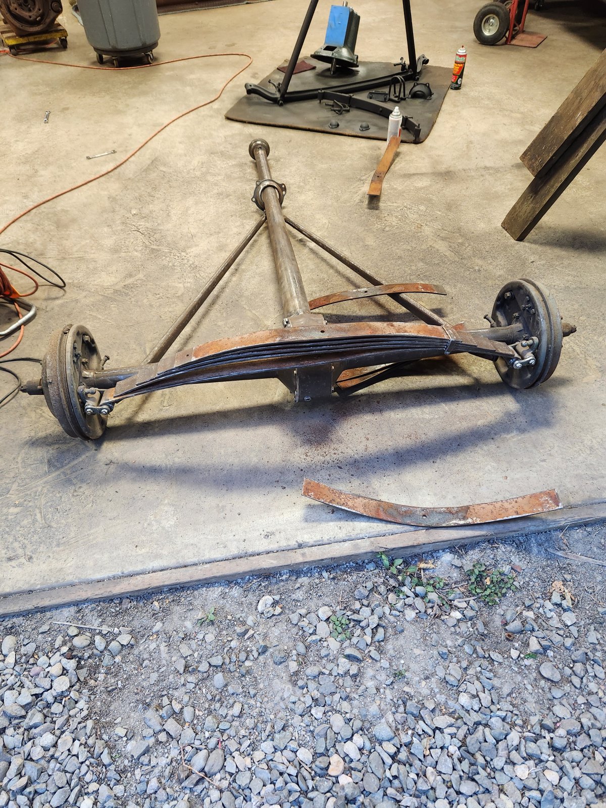

    Now...let me start this off with a disclaimer; no Hitchhiker's were harmed during this incident....

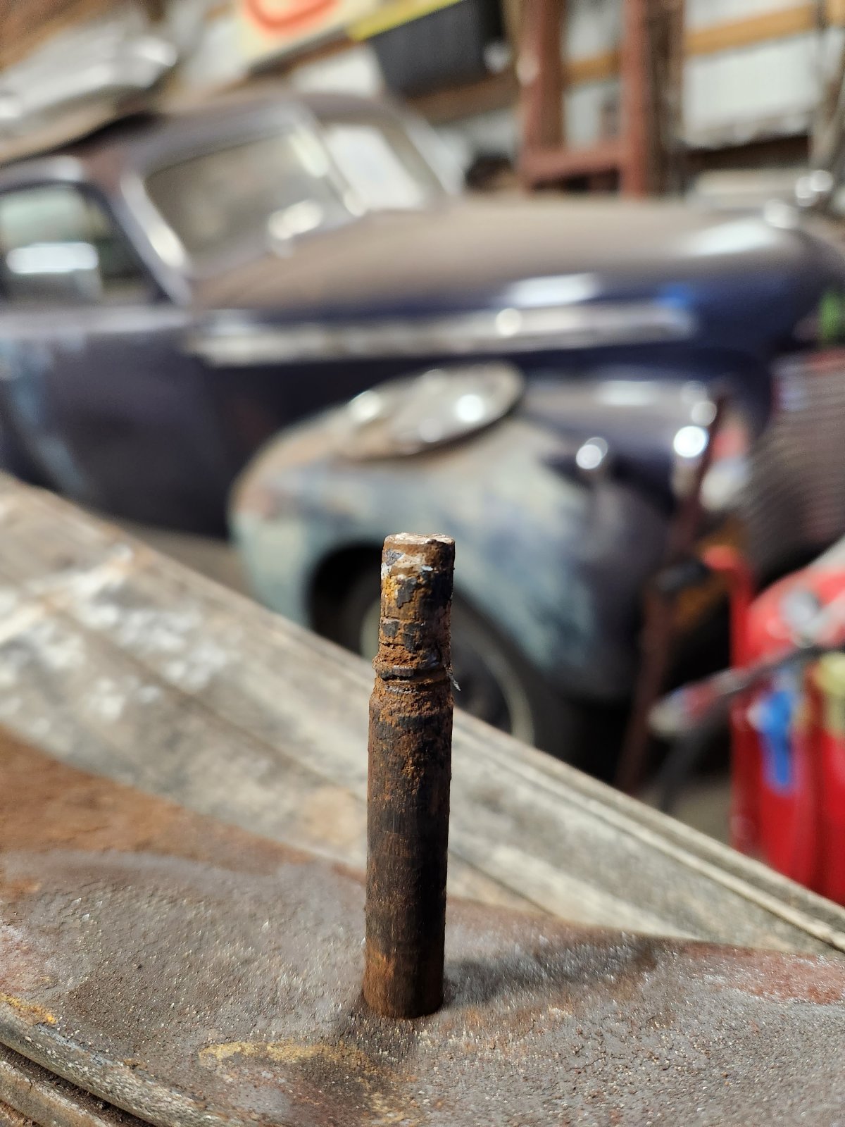

    Now let me make it clear... I usually remove and take apart all the springs on cars I work on....mainly for this exact reason.
    In all the springs I have built. Which is a lot...I've never had an incident. I have set some off before because I was curious. But never had one come apart on me until today.
    While moving the rear end the center bolt of the spring let go.
    While not the worst hit I've ever taken...it wasn't a light one either. I'll be sore tomorrow.
    After I'd got done cussing, I took a look at the bolt.
    This is the exact reason I usually take these apart and inspect, clean and replace. But not this time. Let that be a lesson.
    Anyways....that kinda took the wind out of my sails tonight, so I'm inside nursing a cold snack.
    Anyone got any ideas how many leaves I can remove now that I am gonna be into this thing?

  23. Dang, Mother nature at her worst. Many years back when I was building my avatar and removing the stock rear housing, I had just loosened the 4 nuts on the U-Bolts but not totally removed any nuts and the center bolt snaped. The bottom plate kept anything from getting away but I had Skid marks in my Laundry in a hart beat. If I remember right the Truck spring pack is a 9 leaf package. I do remember on the Truck I built I removed 3 leaf's, it sat nice on 30" tall rear tires and road well. Oddly enough that Truck came with a set of Overload springs on it. I still have them but somehow lost track of the special bottom plates that the U-Bolts went through. May have stayed on the Truck, but not sure.
