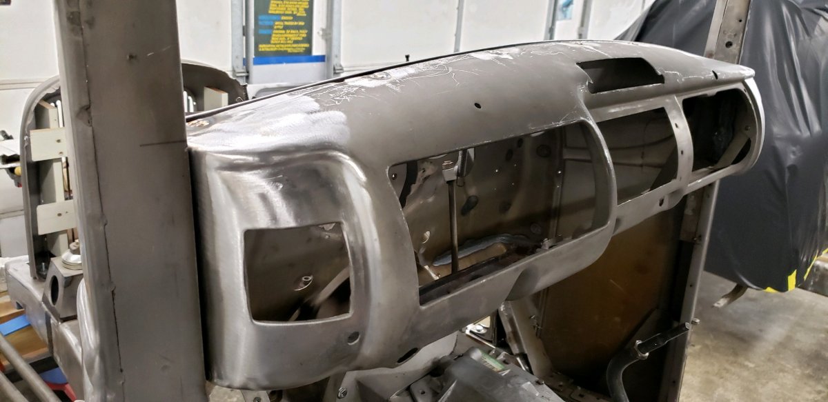

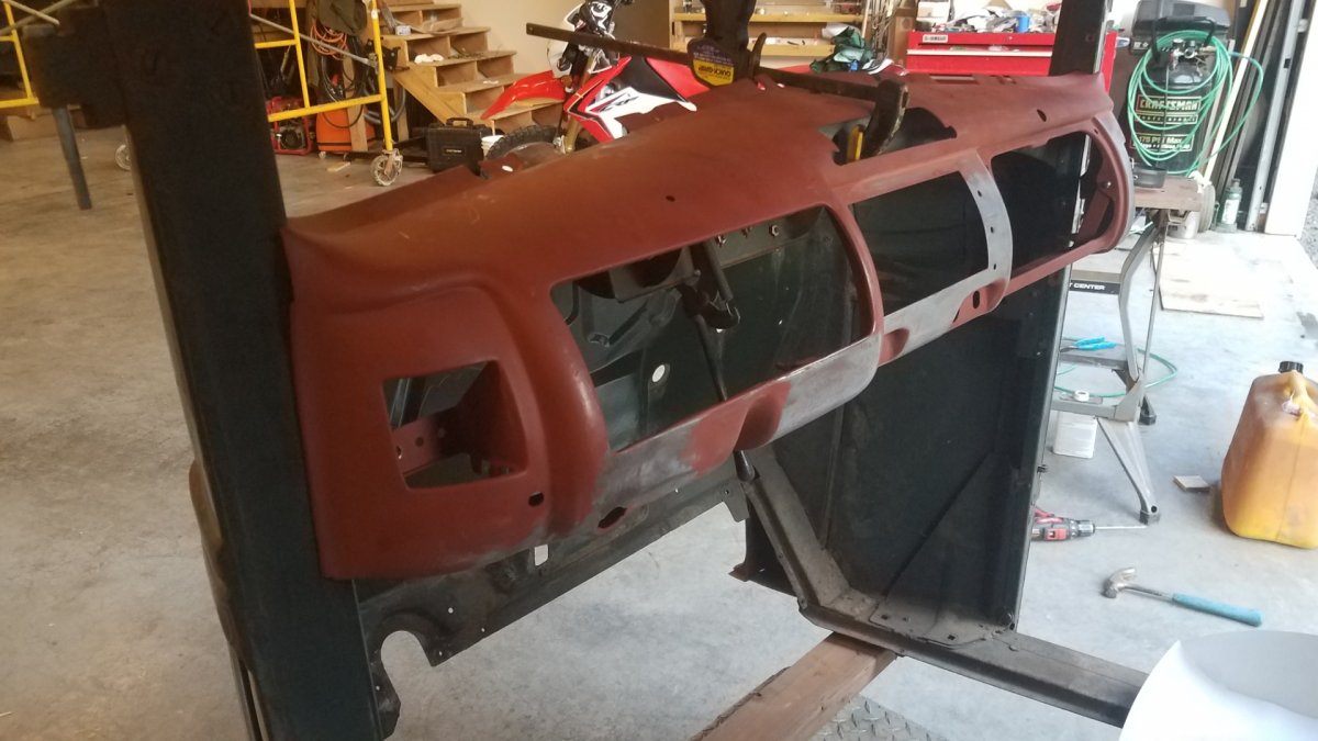

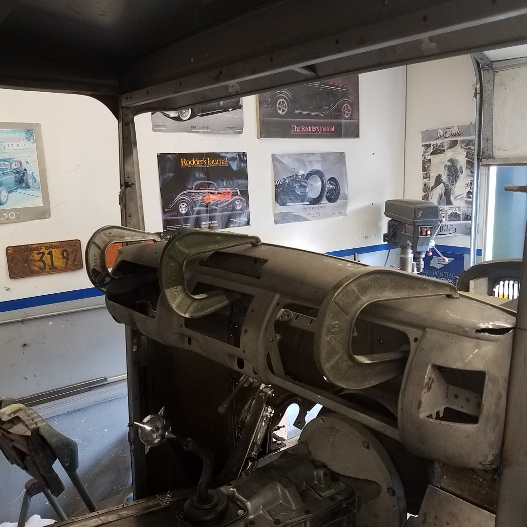

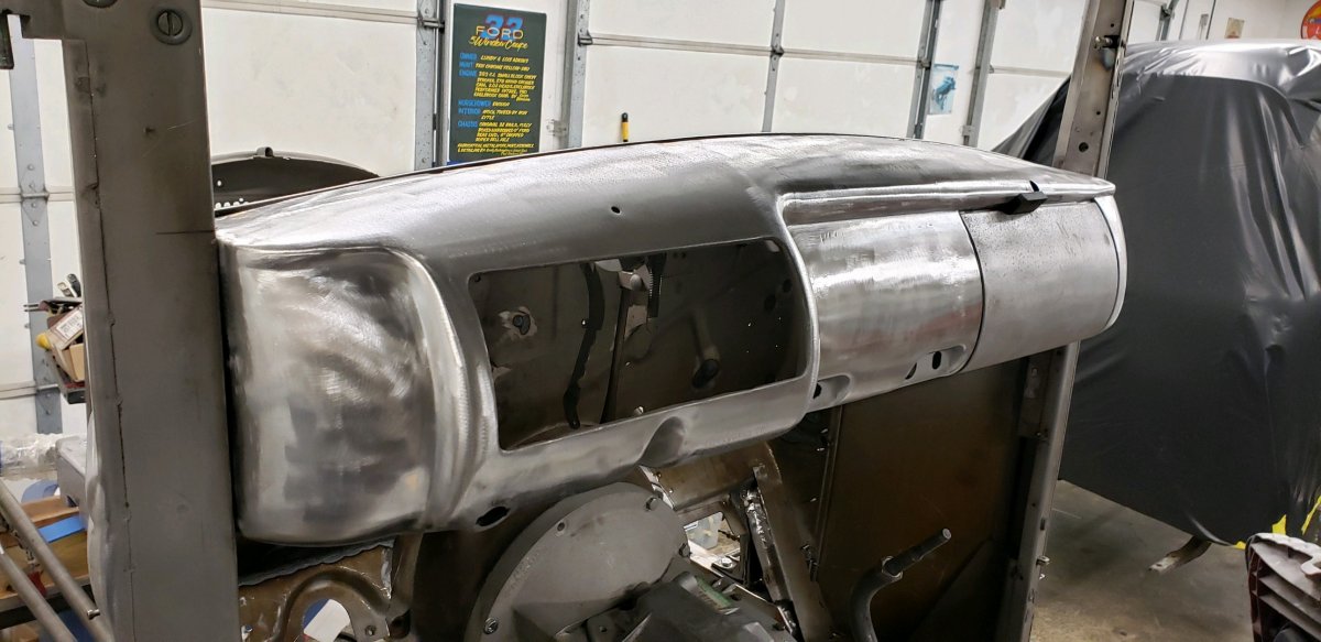

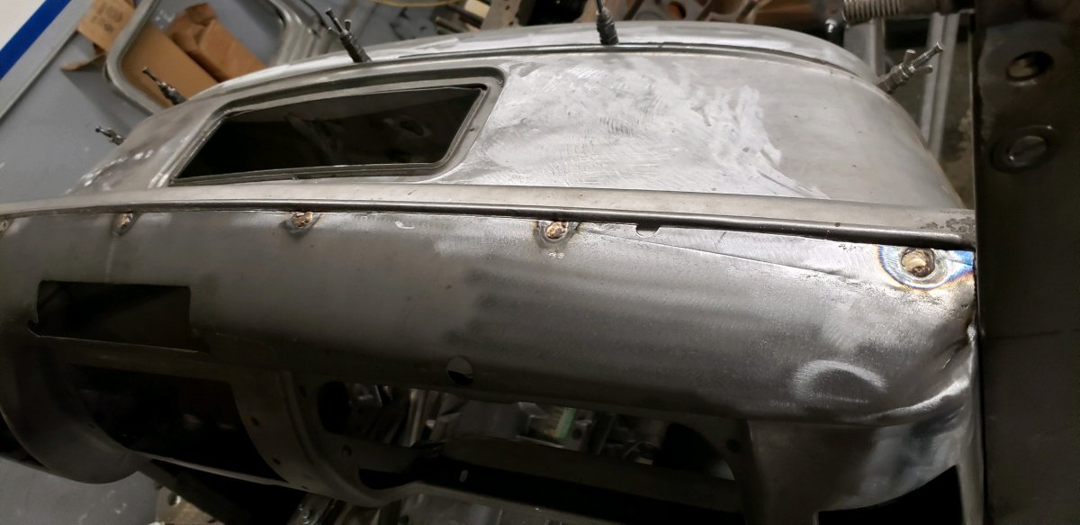

    Thank you gentlemen. The next step on the build was to attack the dash. The original dash was nice but what the heck, a 40 dash is even cooler right?. We had to cut and tuck the corners, shape the top, and fill a few holes.
    20190312_175952.jpg 20200629_121256_resized.jpg 20200702_082151.jpg 20200702_082134.jpg 20200708_064212.jpg
    Toms Dogs, Tim, 51 mercules and 9 others like this.

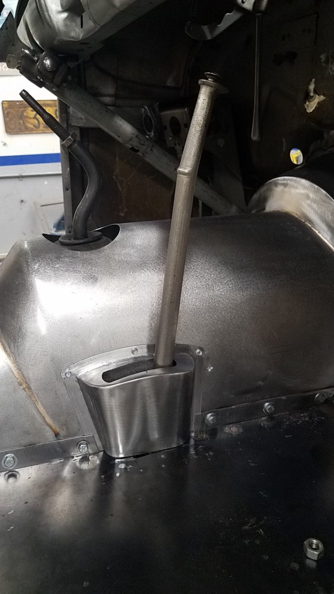

    With the tunnel in place it was time to figure out the e-brake location. I saved the original lever from the BB when I took it apart with the idea that I would use it on the build . Since the T5 lacked a mounting point we built a frame mounted bracket.
    tb33anda3rd, Tim, brEad and 8 others like this.

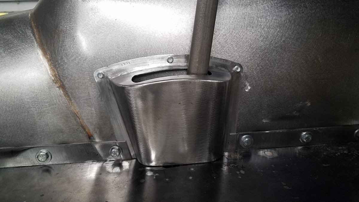

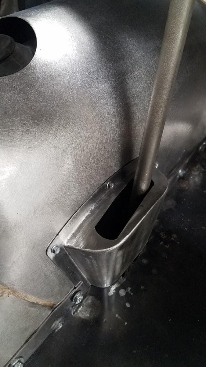

    As the old saying goes, "The devil is in the detail". And boy are there a lot of details. First on the list was to fabricate a E-brake pocket for the newly placed handle.
    20200928_115459_resized.jpg 20200928_115509_resized.jpg 20200928_115503_resized.jpg

    That ebrake mounted off the cross member is a great idea, might have to steal that one!

    You metal magicians kill me. Well I needed to make a pocket for the ebrake. Before long presto chango a real neat pocket that would have taken me a week or two make and looked half as good. :confused:
