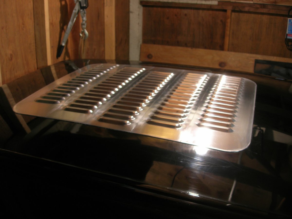

    Thanks for the ideas! Removing the rear window would also help get the hot air out of the cab. I spent several months this winter, DSCN3378.JPG installing an aluminum panel with louvers in the roof so that helps get the heat out also.

    Thanks for the compliment. I had louvers stamped in an aluminum panel and was hoping that all of the punched louvers would give the panel flexibility and allow it to comply with the crown of the roof. That didn't work so I had to cut the panel between the rows of louvers so it all would fit the roof line. The "dots" are aluminum pop rivets holding the panels to the roof steel. Five rows of twenty louvers each are open and functional. DSCN3752.JPG DSCN3753.JPG

    Many thanks for your insight. Fifty of the roof louvers do open to the cab. I have a louver fetish and can't give up my louvers. Also, with the windshield canted open the engine hot air has a direct path into the cab from the hood louvers.
