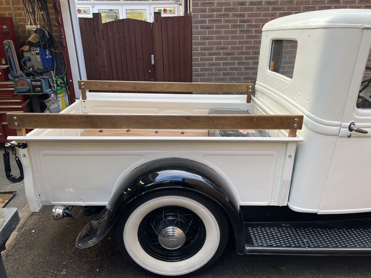

    Thanks, the rear tyres are stout, I believe they are 12 ply, they are certainly pretty heavy too.
    I'm running them at 24PSI, but ride quality is not something that I can be too concerned about in this vehicle.
    But they look good ;)

    Originally there could have been wooden stakes added to the pickup bed, now the bed was clean and painted all the holes and fittings for them annoyed me.
    Also the pickup bed sides are really quite shallow.
    So I got a piece of oak from B&Q/Home-Depot, which they comically describe as straight edged.
    I wished I'd waited for the timber merchants to open on Monday, as their definition of straight edged, is you can place a straight edge on it !!
    After faffing around for ages (I'm no woodworker).
    I managed to rip that piece into two straight planks, and wheeled the pickup outside for a mock-up.
    I wanted to be able to tie things to the rails, so some clearance for ropes/straps was in the brief, but that is just a little too high.
    Some very basic woodwork later, some wood glue, and stainless carriage bolts, and we are getting somewhere.
    The first coat of Danish oil makes quite a difference.
    Bolted into place after another couple of coats of Danish oil.
    Yep liking that a lot.
    Simple, pretty period correct, and now gives me the scope to carry an 8x4 board should the need arise.
    Thanks for looking
    Outback, hook00pad, Squablow and 14 others like this.
