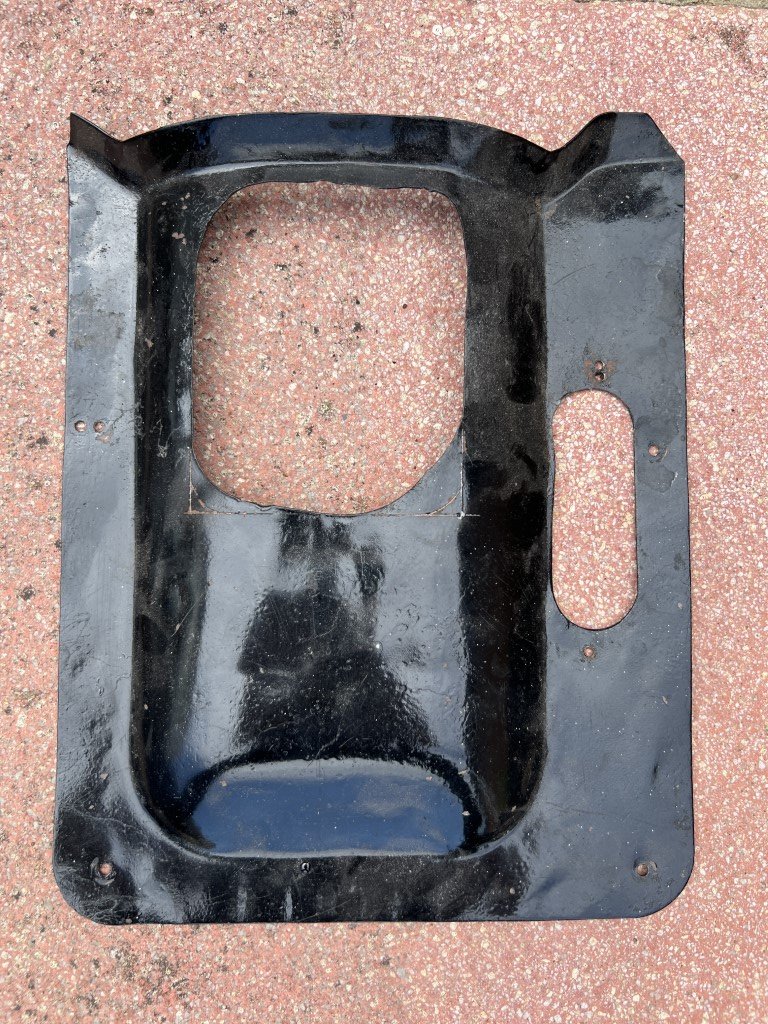

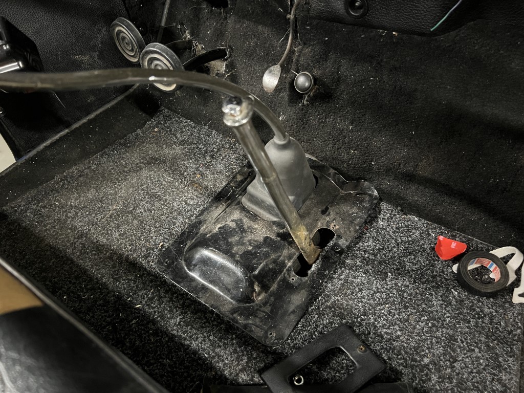

    The fixing for the tunnel cover have long since been lost. 2024-06-07 11.30.51 (Medium).jpg
    Taking it onto the bench for a proper look and it seems it is battered and posses no symmetry.

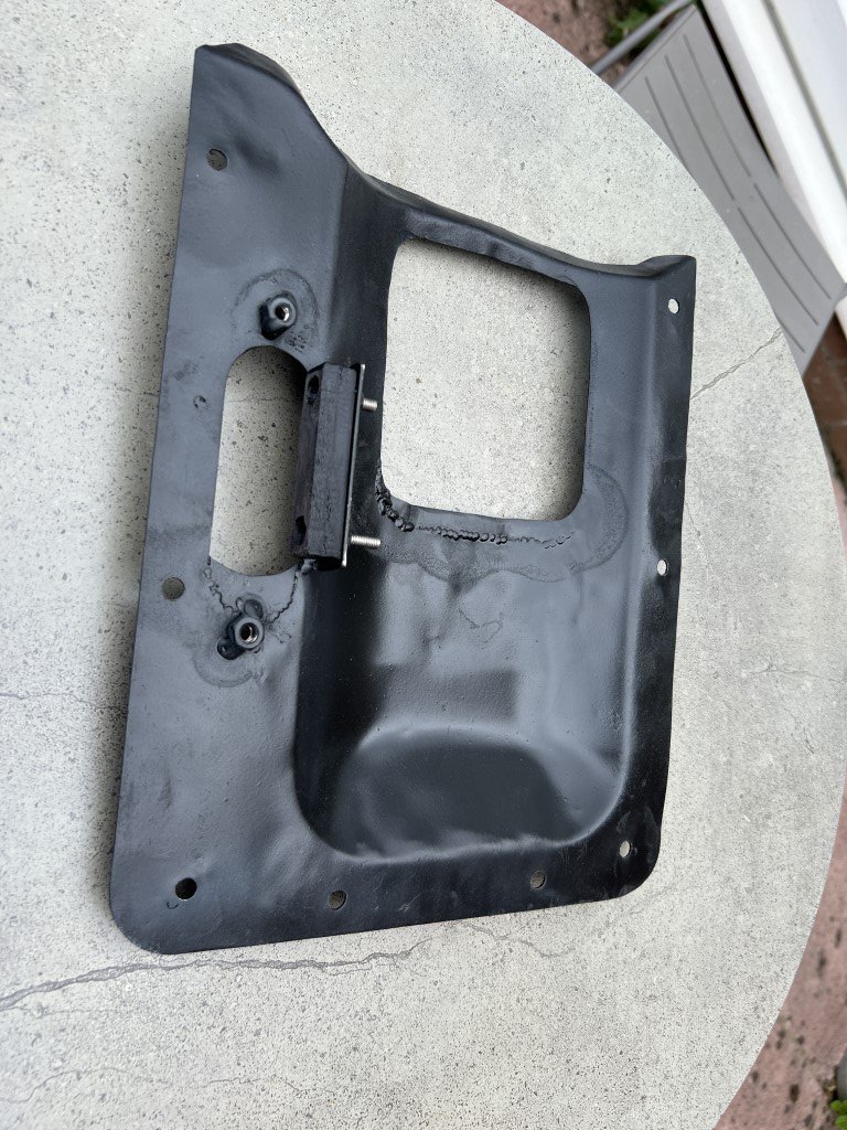

    Welded in a few bits, and all the original mounting holes up
    Added a piece of angle iron, with a plastic buffer, so the handbrake can slide against it, and not wobble around.
    A couple of UNC captives for the handbrake gaitor too.
    I did a little filler work on it, but nothing too crazy, as I knew I was going to use this finish.
    Which is aerosol truck bed liner, which is great, but sometimes doesn't dry to an even finish, so a dusting of satin black over the top.
    UNC allen screws go through the wooden floor into t-nuts to secure it.
    I don't like using wood screws for something like this, which has to come apart occasionally.

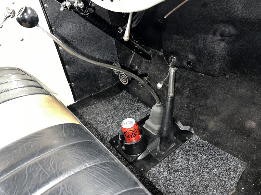

    3D printed and painted a little surround for the handbrake gaitor, which I'm very happy with.
    Also did a cup-holder, I'm less happy with the design of this, but as it a separate piece, I can remove it with two of the fixing bolts and try something else.
    All told a little bit neater and no holes in the floor to freak out any passengers.
