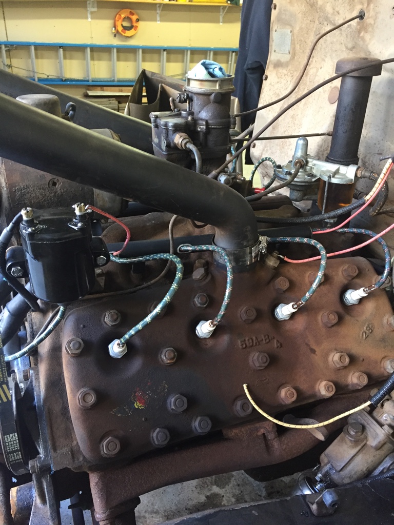

    Jeff34
    Since I replaced all the wiring, it only made sense to pull all the ignition wiring and replace that as well. The cap showed bad deterioration of the contacts, and the plug wires were stiff and brittle. Pulled the dizzy to send off to Bubba for reconditioning. Sending him the coil to test as well. I'll order new inner/outer cap rotor and wires to finish it off. This will likely take longer than I'd like, but I think it's the right thing to do [​IMG][​IMG][​IMG][​IMG]

  12. alchemy
    Joined: Sep 27, 2002
    Posts: 23,467
    alchemy
    When you have Bubba replace the rotor and cap, have him install '42 parts. They are easier to use than the '48 style cap you currently have.

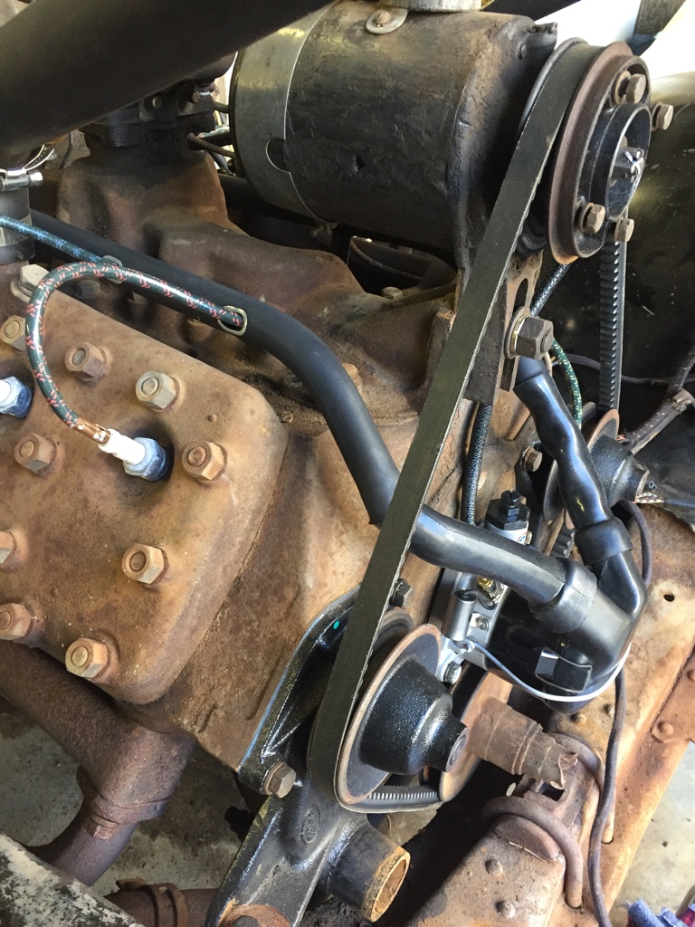

    Jeff34
    All back together. Crab style cap would have made this easier, but I like this look [​IMG][​IMG][​IMG][​IMG]
