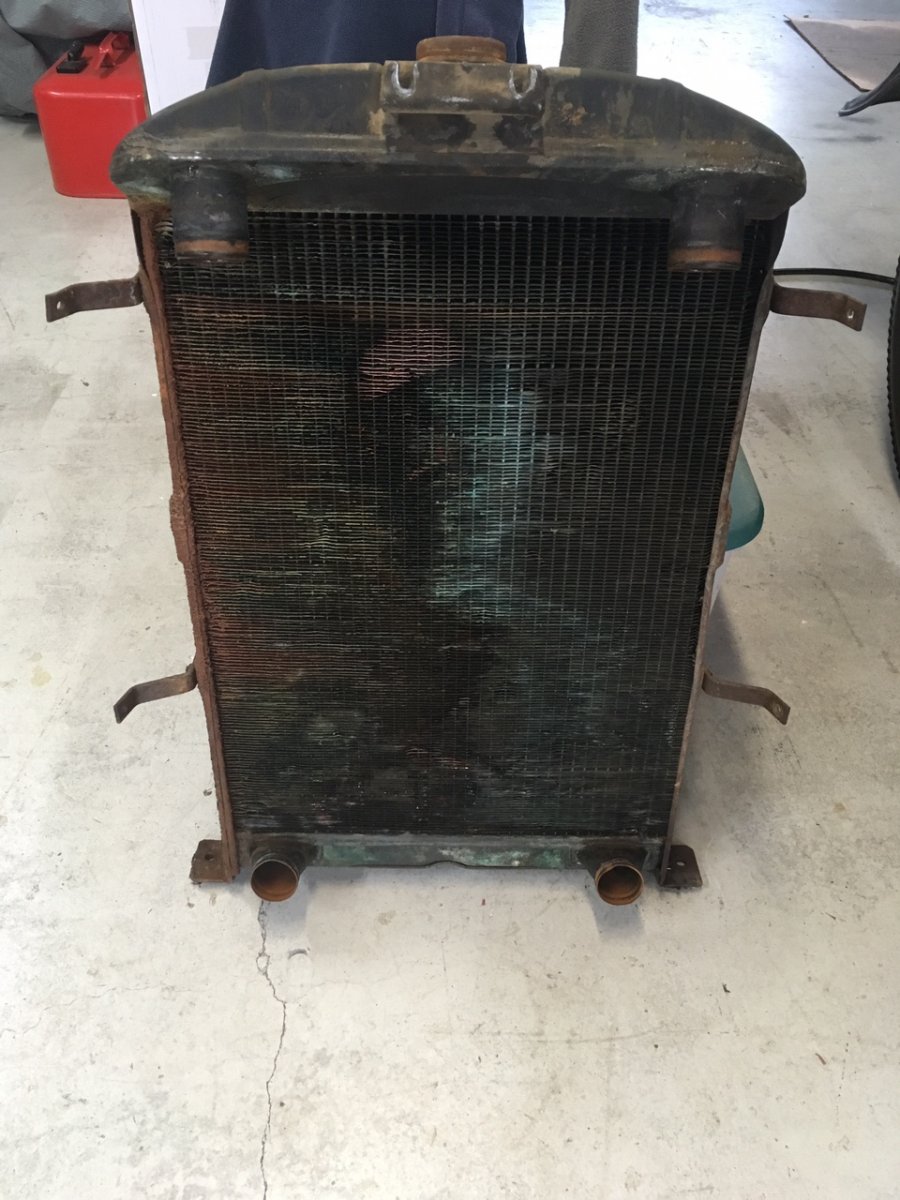

    Finally decided that the radiator needed fixed. Also, does anybody know what rubber plug fills this hole just to the right and below the foot rest? IMG_0313.JPG IMG_0314.JPG IMG_0315.JPG

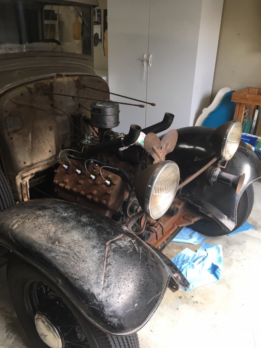

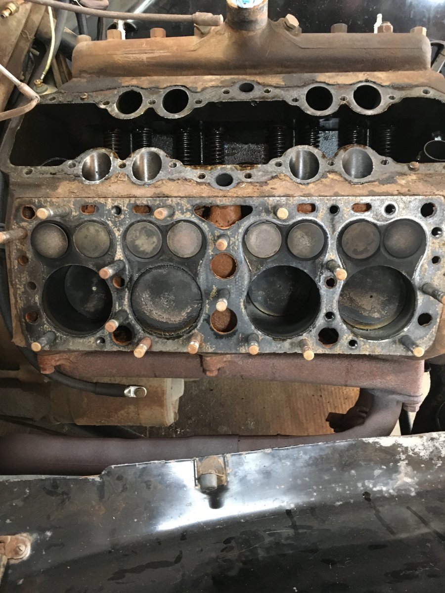

    Well, I guess it was probably just inevitable that this would happen at some point. I stopped at the gas station on Saturday and somebody told me my truck was leaking from the engine. The radiator usually spits out a bit of fluid when I stop because there's no recovery tank (yet). But this time the puddle was bigger, and foamy...
    I opened up the cap, and the fluid inside was all foamy and smelled unlike radiator fluid. I turned back and drove it home (3 blocks) and parked it in the garage. I had to go help a friend demo a kitchen, so the truck had to wait. I started tearing into it on Sunday (I probably needed an excuse to do the heads and mani anyway, so this was the trigger. Pulled the heads and the intake manifold. Need to order new head gaskets and some other parts to get it back together.
    After the stock heads and intake were off, I put on the Edelbrock's and Edmunds intake just to cover the open holes. They look nice sitting there. Put in spark plugs and the oil fill/fuel pump ***embly to cover those openings as well. Just like me to drop a washer or nut into an opening.
    Looks like my next couple of weekends are booked...

    Yes. It was head gasket. I got new Best brand gaskets and installed new studs. Put on the Edelbrock heads with new nuts and washers from VanPelt. Torqued it down to 40, then 50. Ran it for 20 minutes to get up to temp. Let it sit for a couple of hours to cool down.
    When I went to re-torque at 50, the p***enger side head cracked at the middle stud and drained all the water. . I spent the rest of the weekend drinking and thinking about what I did wrong. I pulled the heads off today, and noticed that all of the “hardened” steel washers had been deformed by the nuts. Seems strange that would happen. I took a file to one of the washers and it was very easily filed.
    Anybody know what the hardness of the washers should be? Because they’re easy to file, I don’t think they’re hard at all.
    Super bummed. The cracks are bad. And all the surfaces on the heads are now deformed.
