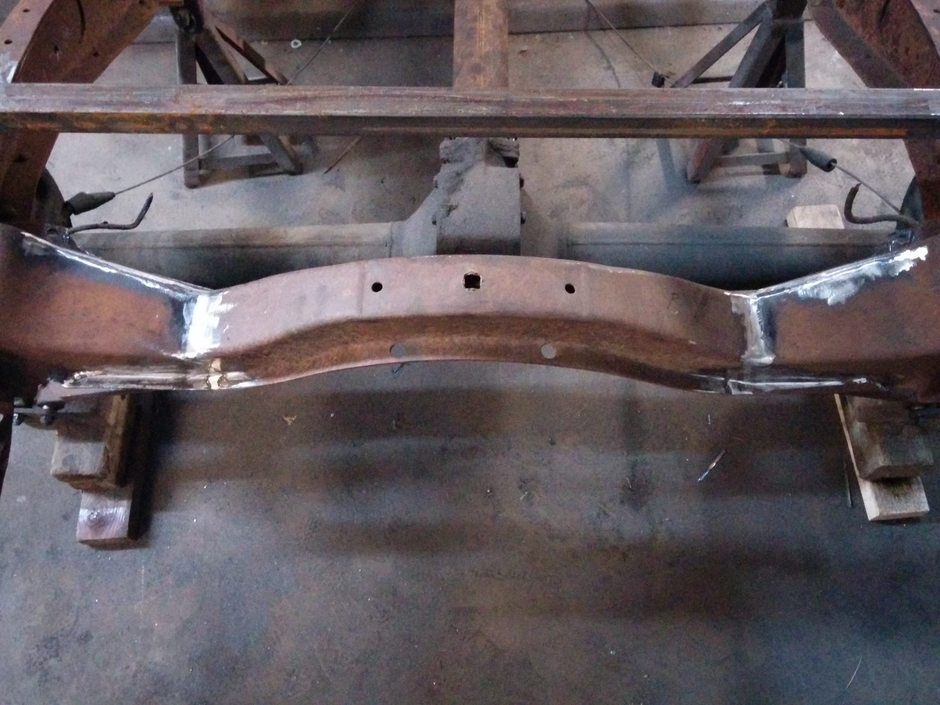

    My next task to tackle is the rear cross-member. I'm going to run a Model A rear cross member because I have a quick change that I may decide to run. I'm still on the fence here. I don't have much budget and all I have is a quick change housing and lower shaft so I would need to come up with the rest. Or I also have a Columbia but it needs an over haul. Or just put my set of 354's in the 40 banjo and roll. Then build one of the other 2 over a winter but at least the car is done.
    Any way,,With that I will be using a T spring with some leaves taken out. I did a bit of resurch on this before I got started and both the curbspeed coupe and I think the Jersey coupe grafted the model A center into the stock 34 rear cross-member. I liked the idea of having the stock mounting of the cross-member, so that's what I did.
    Basically all I did was a bit of measuring and a bunch of cutting welding and grinding and this is what I cam 060.jpg 065.jpg 067.jpg e up with.

  3. Looking good man!
  4. That crossmember looks really really nice Brad.
    I saw that pic, then my mind went thru that measure & set up process to get this where it needs to be - lots of fiddling to it
  5. Is it the way the pic was taken or is that center off just a tad??? probably my blurry eyes this am!!!

    She's all centered up burn out bob, must be the pic.

  9. great to see the progress. In regards to the rear 'A' cross member, do you think the chassis will sit a bit high in hindsight, and other than aesthetics, is there any particular reason why you didn't just use the full width of A crossmember? Reason I ask is because I'm shortly going to be doing similar with my 34, hence looking at where best to position the centre section and it's 'relative' height when compared with the rail.

    The reason I grafted the model A crossmember into the ends of the orig 34 crossmember was to retain the way it mounts to the frame rails. As far as the ride higt is concerned? I'm not too sure, I haven't had her on her wheels. I saw A few others do it this way and the ride hight looked pretty good. I was pretty torn too I hope it works out. I guess keep watching and see I'll have her on her wheels soon.
    Brad
  11. I like the rear crossmember graft...Looks great. How many leafs did you remove from the stock spring????
