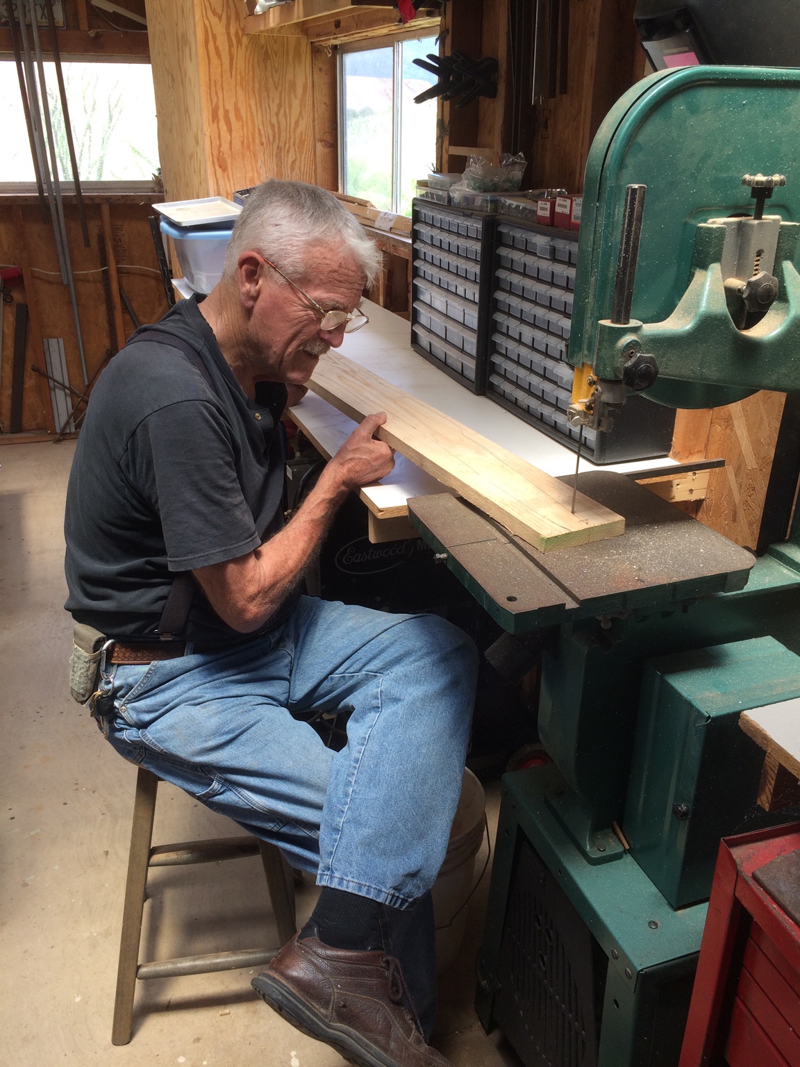

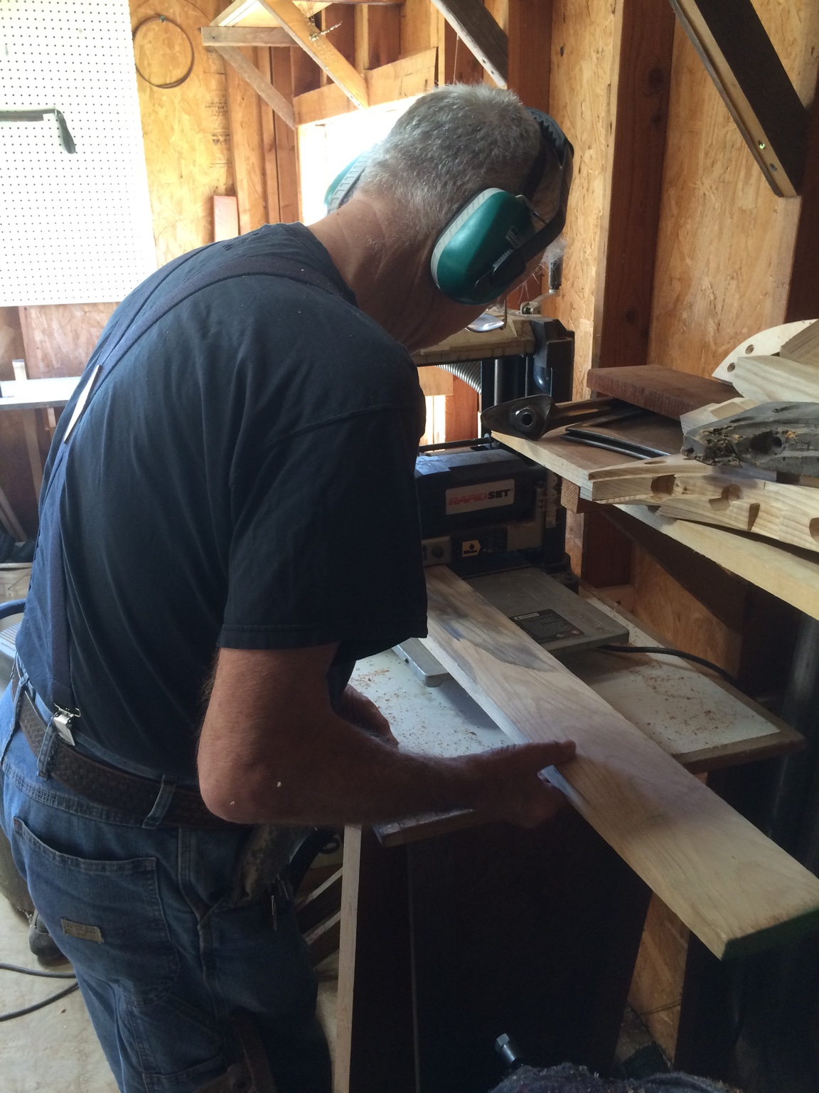

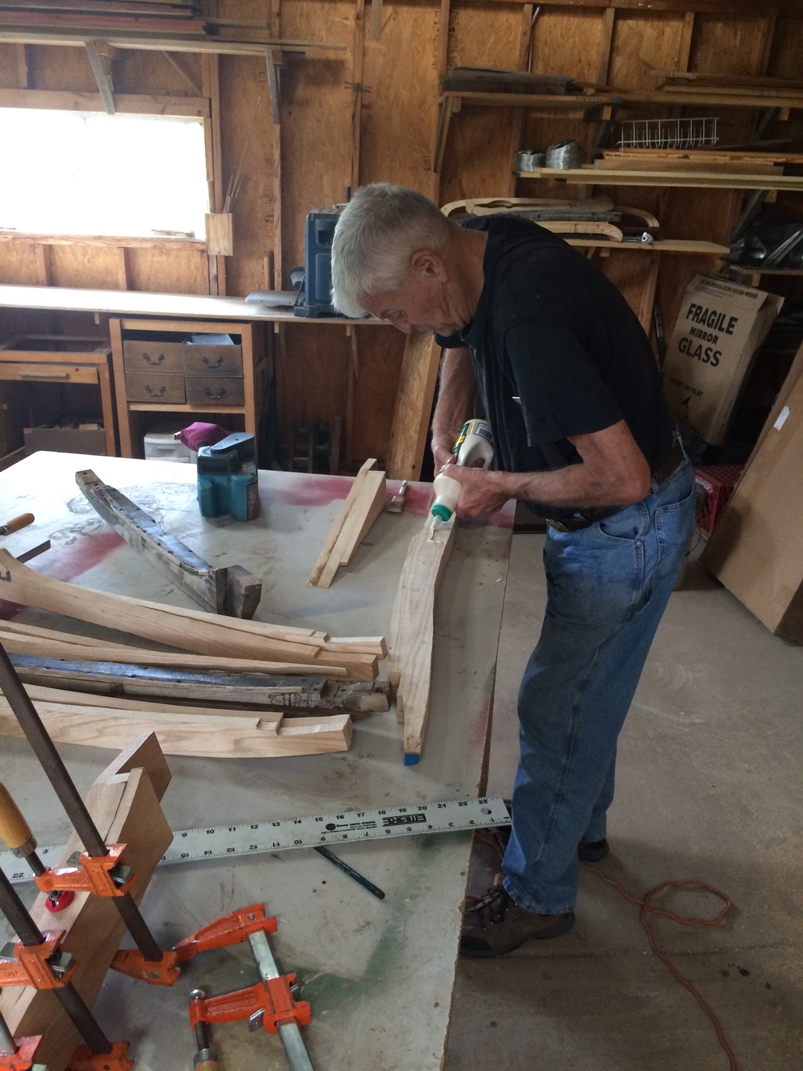

    I spent the last two days working with my dad on reproducing the wood b-pillars and the wood above the door. When I got the car, the wood had all been striped out, however I was able to get an original set suitable for duplicating.

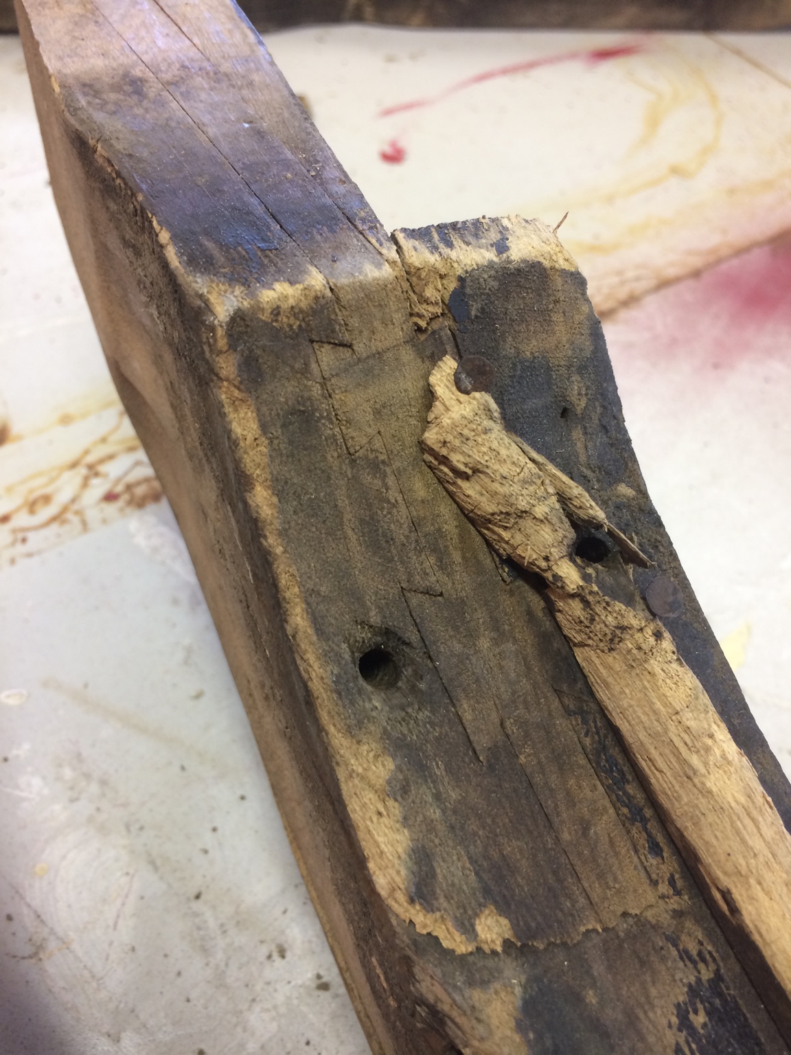

    The original wood above the doors was a myriad of s**** wood held together with dove tail joints, nails and glue.

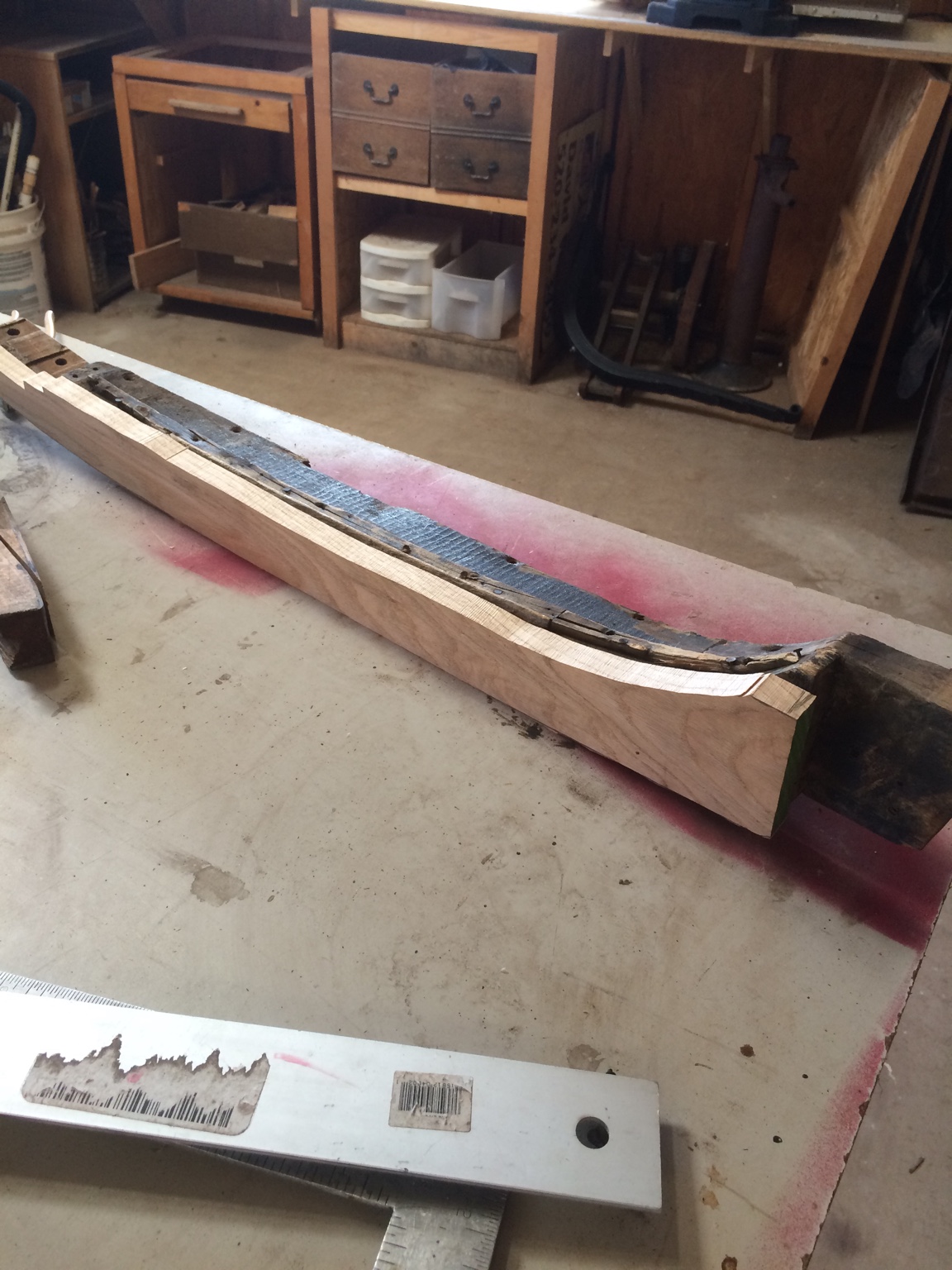

    The original wood was rotted at the bottom, but there was enough on one to screw the bracket through one hole. We were able to index the rest of the missing wood and duplicate the mirror on the other side.

    Thanks, we are using a nice tight grain red oak.

    Here are some more pictures from this morning. We had to dig deep into my dad's tool stash and go "old school".

    image.jpeg ^^^^ Regarding the picture above.....I was always told to lower the upper blade guide down so it is positioned just slightly above the thickness of the board you are cutting. That way you might be able to cut off a finger or two, but at least it would be all but impossible to cut off your whole arm. That much open saw blade scares the **** out of me.

    Thanks, band saws scare the **** out of me....I have a lot of respect for them.

    Here is a picture of the dove tail joint

    Did the shaping of the wood above the doors and final sanding on all the pieces. Now they go on the shelf awaiting installation.
