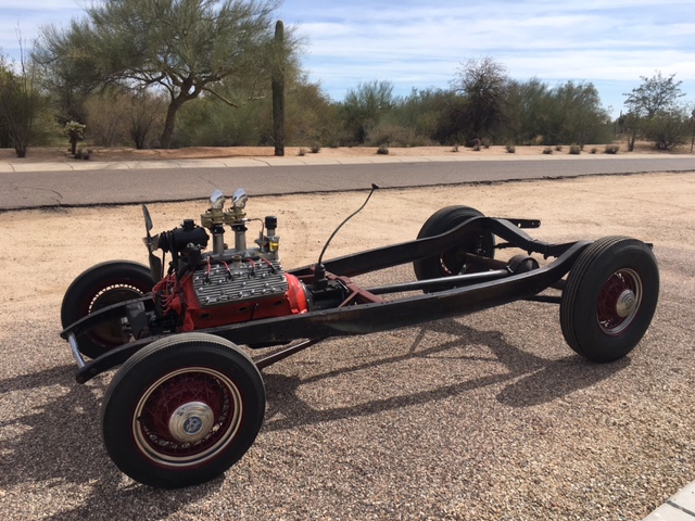

    I got the 4 door to use the ch***is for the 3 window....

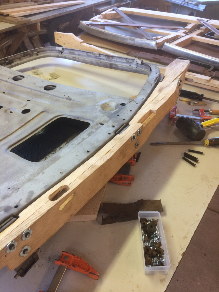

    Finished mounting the hinges on the second b-pillar. The door tins that came with the car are very nice except the bottom 8 inches. I made a template and bent the new bottoms.
    Mew metal installed
    Gave all the bare metal a quick coat of primer and ***embled everything.

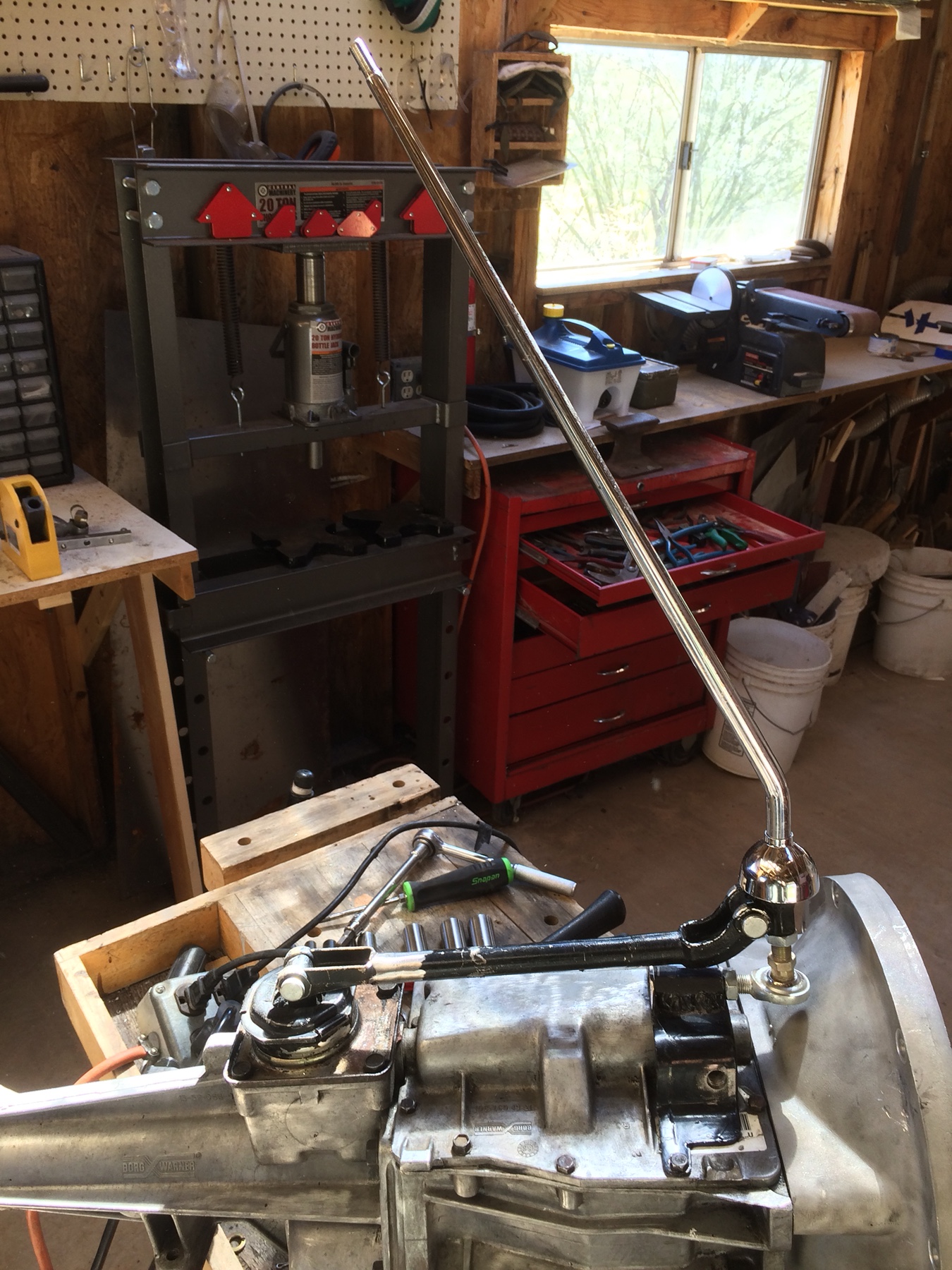

  21. Tricky shifter!
    Stogy likes this.

  23. That’s one interesting bit of engineering on that shifter, does it work well? If it does, might have to steal that idea :–)
    Stogy likes this.
  24. x77matt
    Joined: Mar 2, 2004
    Posts: 831
    x77matt
    Love the shifter!
    Stogy likes this.

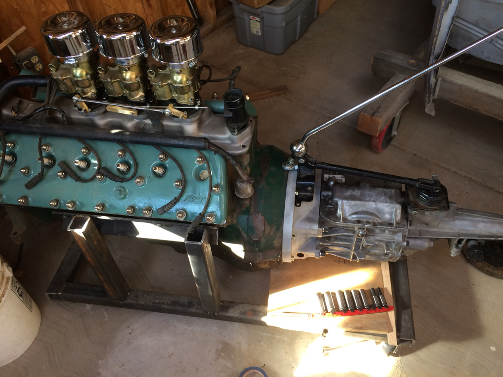

    Did some more work on it today...
  26. Elvis100
    Joined: May 21, 2016
    Posts: 679
    Elvis100
    It’s not very H.A.M.B. Friendly[emoji85][emoji86][emoji87]

  28. 3blapcam
    Joined: Jul 15, 2004
    Posts: 662
    3blapcam
    Nah... you're thinking of TROG. That combo is completely HAMB friendly!!! A LOT of cars on here have overdrive transmissions... since they're hidden.
    I love the shifter too! I hope it works out for ya!
    3blap.
    Elvis100 likes this.
