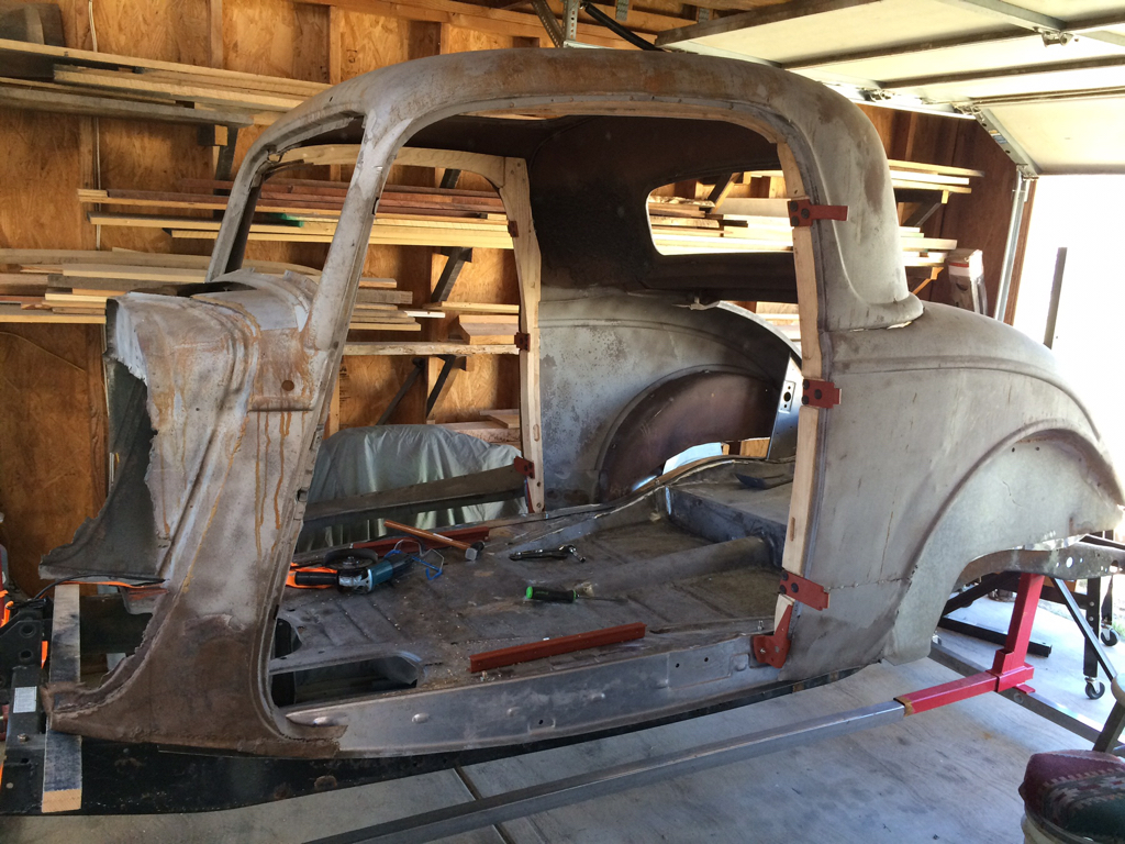

    I’ve been getting some good shop time on both projects.

    More progress
    What the rust didn’t get someone went after with a torch when they removed it.
    Here is a before

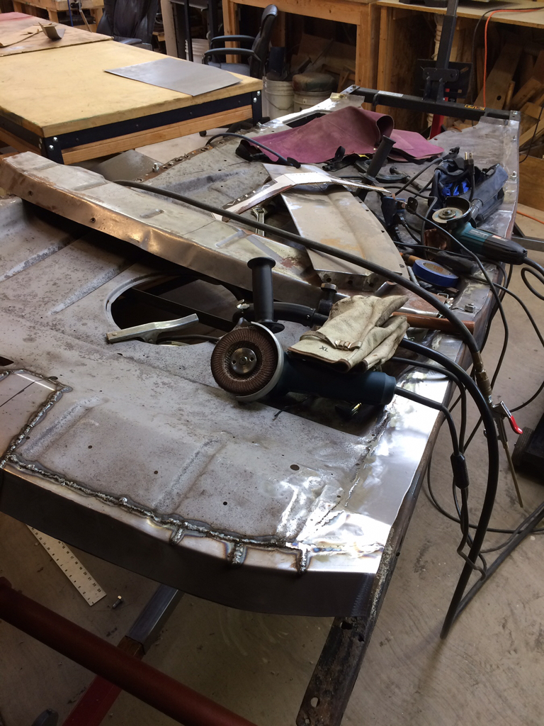

    Finished repairing the perimeter, still have a few bullet holes and other in the field to address.

    Finished up installing the subrails. I drilled a hole in the top every 2 inches and then welded and ground smooth.
    I then got sidetracked identifying what holes are used for the seat. I went ahead and mounted it to check fit.

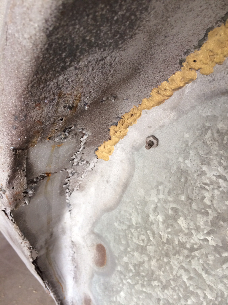

    Sins of former owners:
    The first picture is the “subrail”, it’s no more than a piece of angle iron with half an inch of bondo welded between the cowl and the quarter.
    This next picture is the wheel well...galvanized sheet metal brazed with a few screws for good measure. This is of course after sand blasting all the bondo off.
