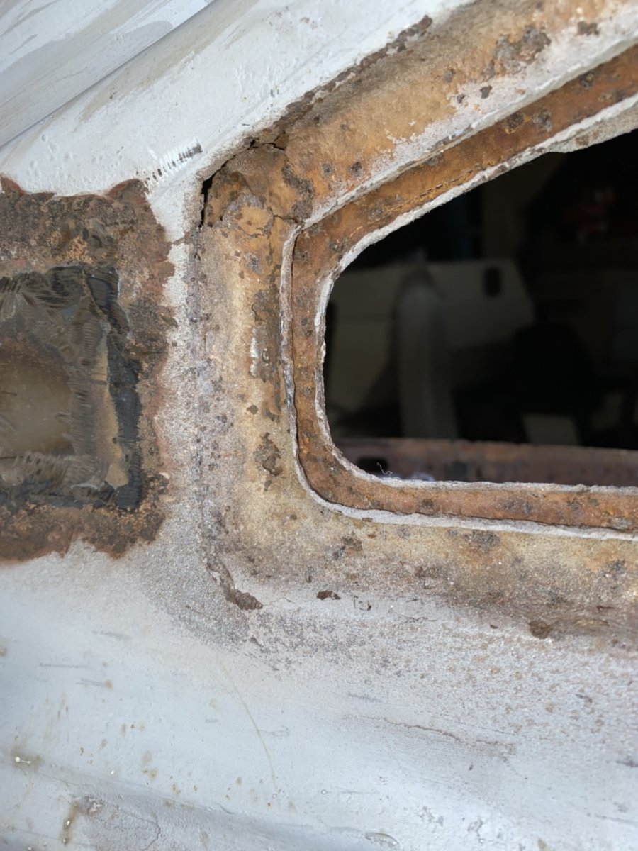

    Got the cowl I’m going to use back from the sand blaster and the skin around the cowl vent is much worse than I thought it was. I spent the day making a new panel to repair it.

  8. Way better than my attempt on my ‘36 [emoji38] May I inquire how you made it? Really enjoying this thread, nice job!!!

    I made a positive and negative die using metal and oak. Can only press a little of it at a time...I basically sat at the press for an hour taking small bites at it. I have a little more depth to get today and then do it all again for the interior drip channel. I’ll post some pictures of the die today.

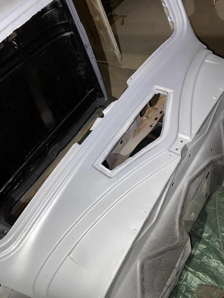

    Started some of the repairs on the cowl. Work stoppage on the vent, waiting for some metal to be delivered for the other die I’m going to make. Moved on to the cowl feet, got the first one spliced in.

    More work on the cowl vent. I decided to remake the body half of the hinge. I flattened the original hinge to use as a pattern.

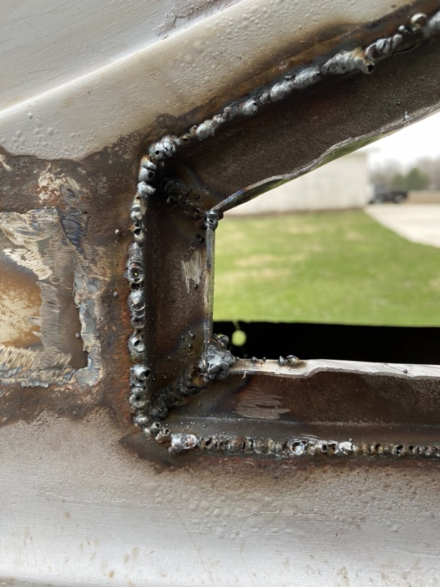

    Turned my attention to the rear corners. Made some pieces for the bottom of the corners and replaced the skin in the trunk jam.

    Finished up the cowl vent and installed it in the cowl. I ended up making a new scupper drain, the old one looked pretty thin.
