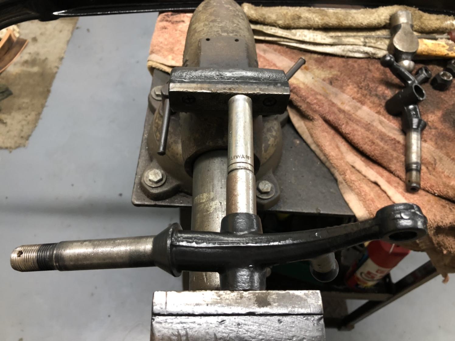

  22. 1934 SPINDLES : I picked up a spare set of spindles, so will clean them up and fit new bushes to them to keep the job moving without taking the car off the road yet. I don’t want the car laying around for months in the garage immobilised with this brake conversion so as much pre work as possible will help getting it done whilst I am still using it in the weekends over our Kiwi summer. IMG_5150.JPG IMG_5137.JPG
