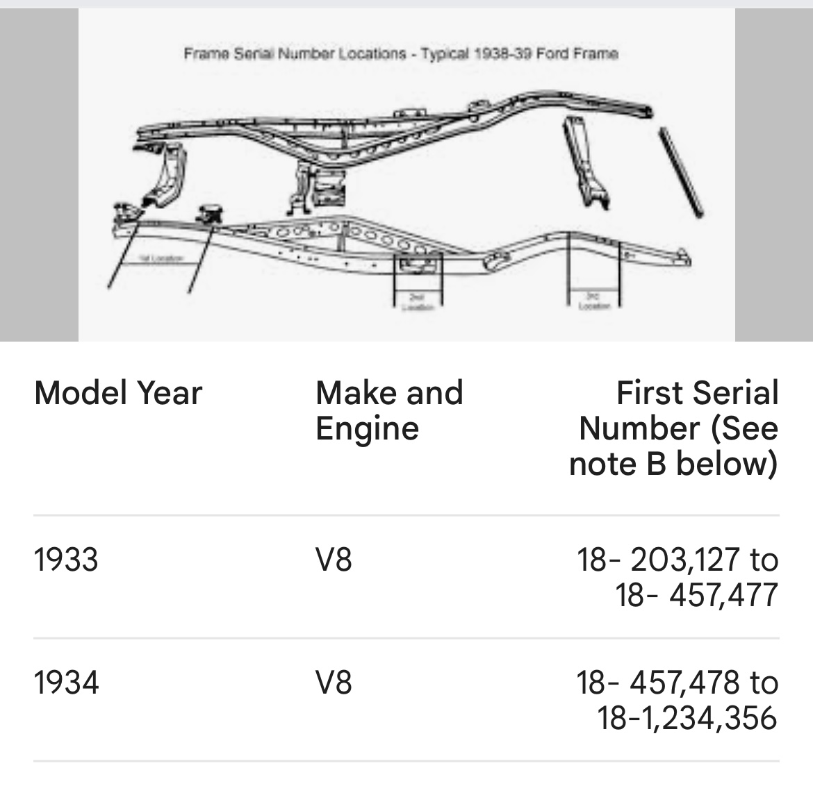

    Does anybody have access to running a vin number 18-93**** to see if it's a real 1934 Roadster ? Wanting to buy this car but something doesn't seem right ! Should of said serial number .

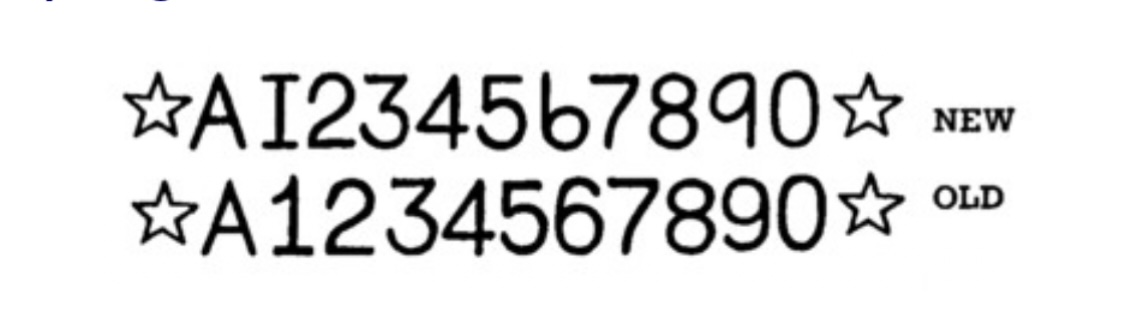

    Two things to be aware of, first photo shows the serial number range for a ‘34 and the second shows the new font for the 1 and 9 characters that your car should have.
    The serial number stamps were changed during Model A production in late 1931.

    So if I'm reading this right ,the serial numbers on the 34 should be the new style numbers !

    Correct^ And looking at the top of the frame just to the front of the firewall you should see a star character followed by 18 and then the actual S/N beginning with 457,**x. The 93 you mentioned is a red flag.
