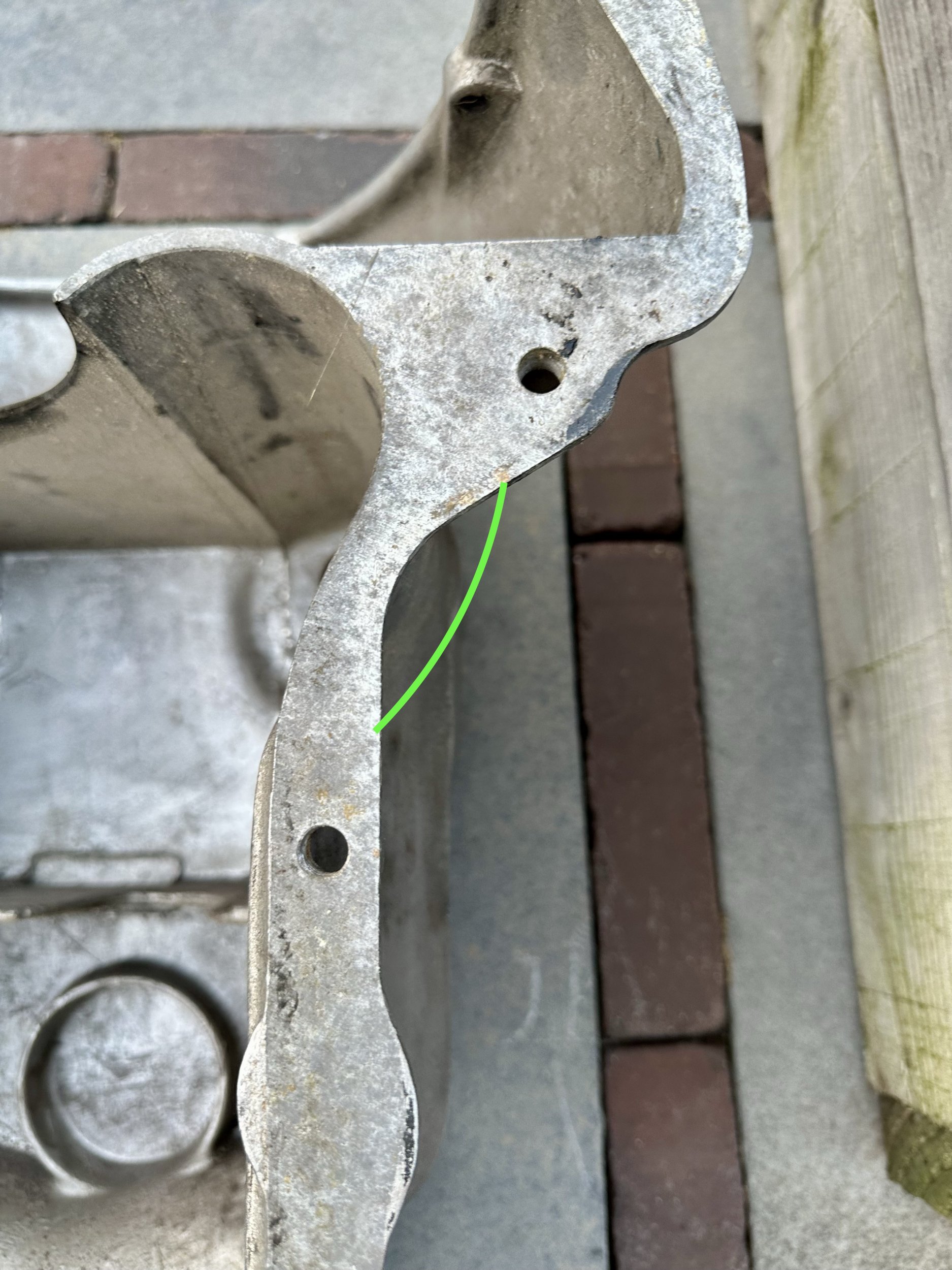

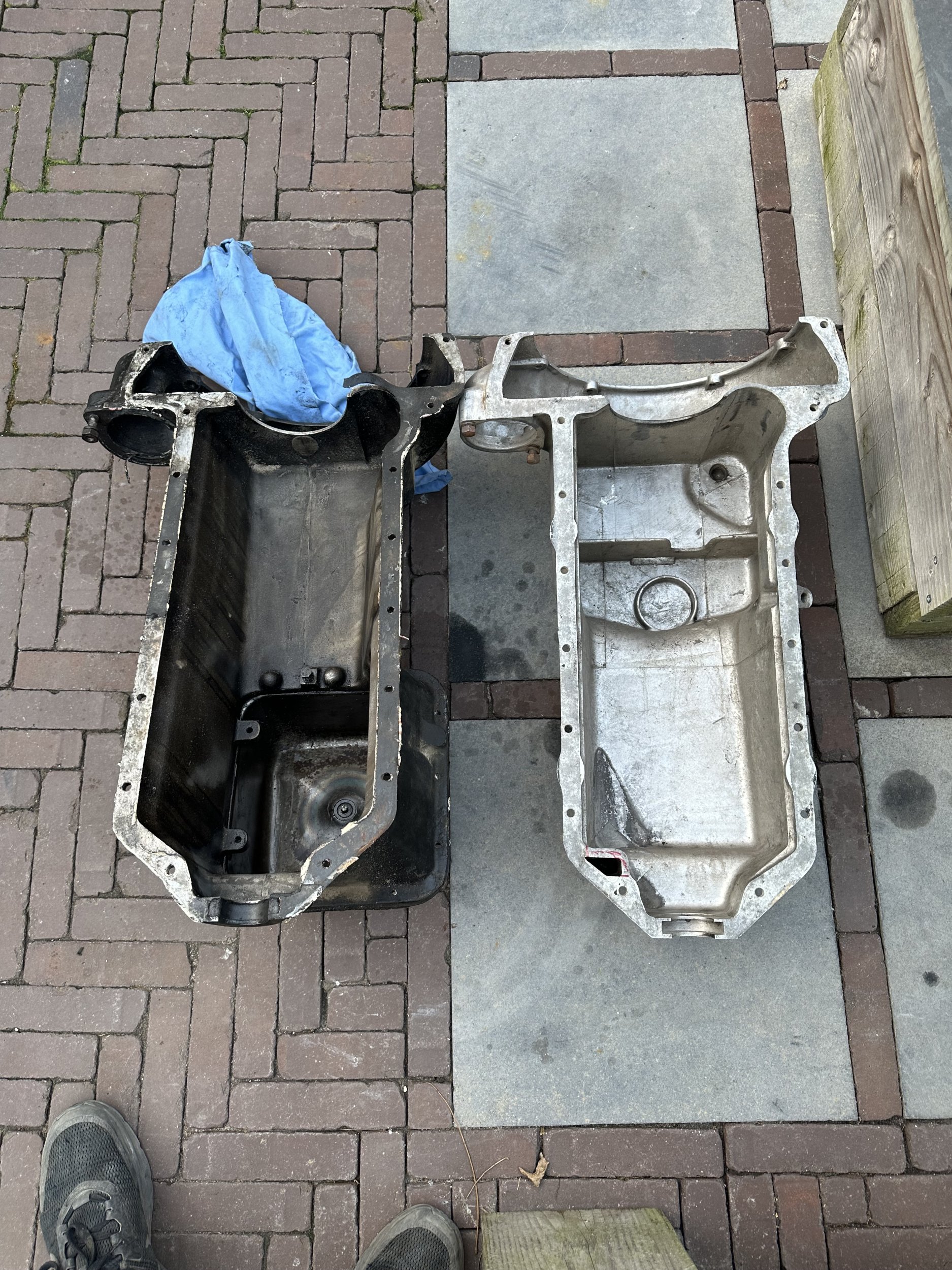

  10. dutchrod
    Joined: Feb 5, 2009
    Posts: 505
    dutchrod
    Since my new shop is not build yet I started with the engine in my home shed.
    The French 255 has a front sump pan that is no use in a hot rod.
    I got my hand on a German pan that must be a bit modified.
    Left the French front sump and right the German pan with vent hole area that will be eliminated and welded shut.
    Also the lip on the right will be made wider like the original pan to prevent from leaking.

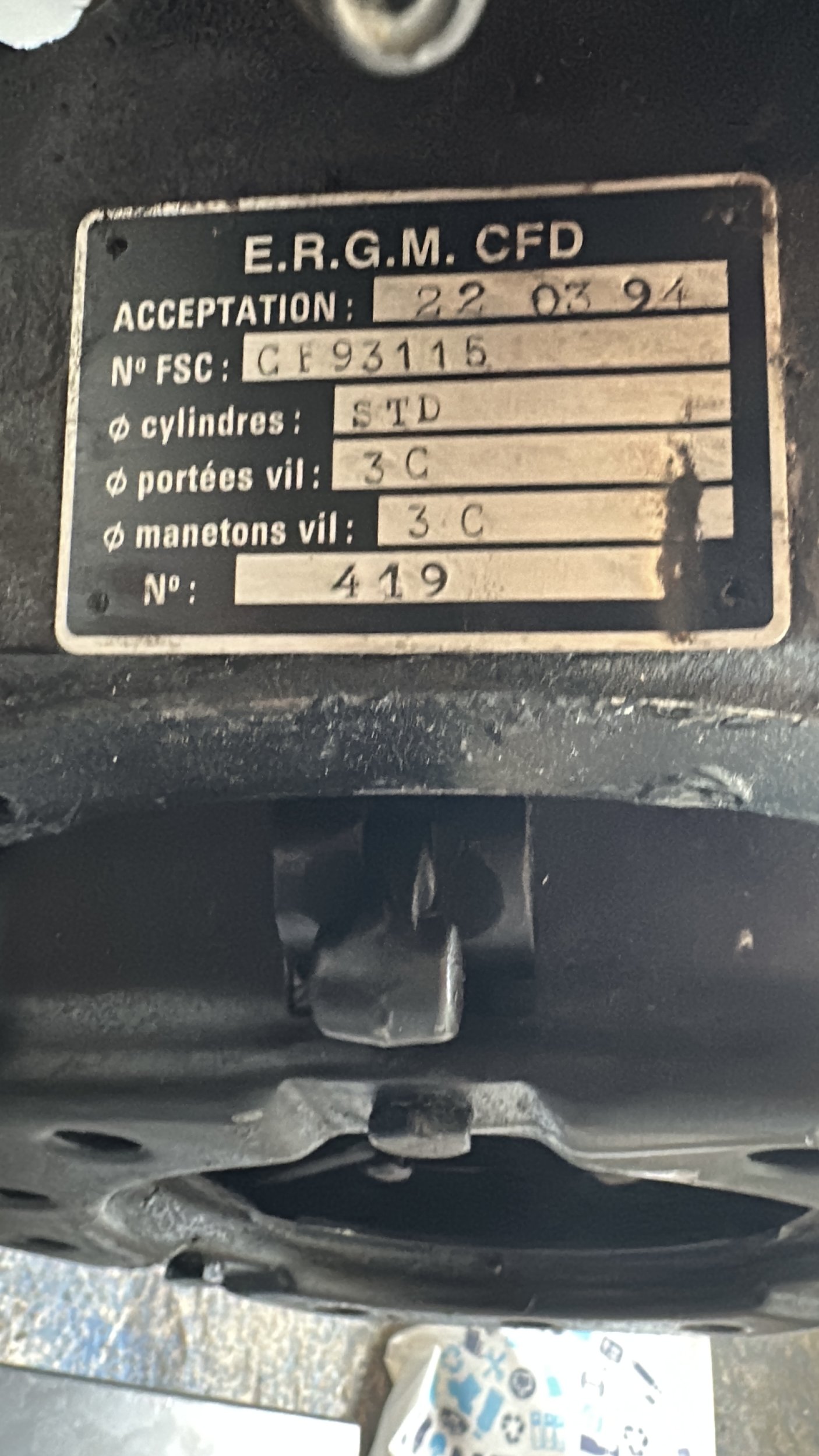

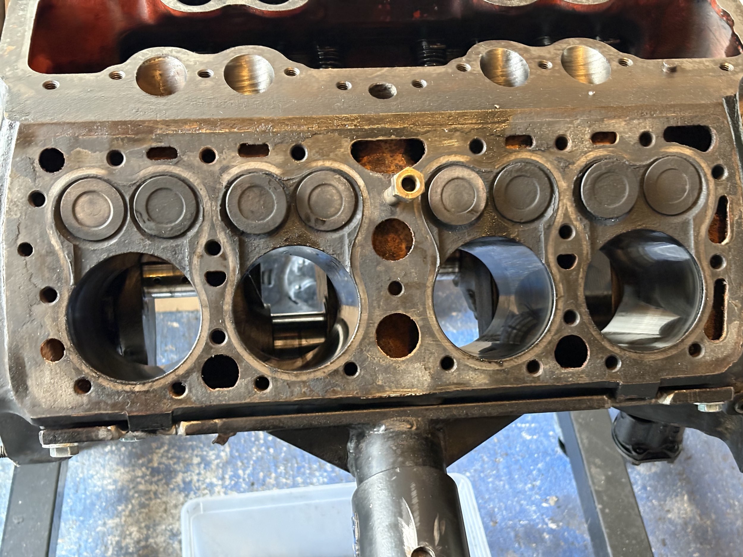

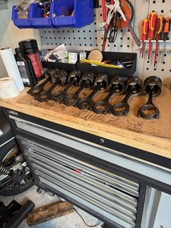

  12. dutchrod
    Joined: Feb 5, 2009
    Posts: 505
    dutchrod
    Time to take the pistons out , the tag says this engine has still standard bore size . F0530E05-9C28-4B2C-88D4-75E66F5C5545.jpg
    Cilinders looks pretty good and some cross hatch is still visible but the measuring will show what I really got.
    But gonna order new pistons anyway

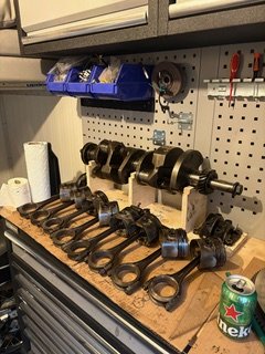

  13. dutchrod
    Joined: Feb 5, 2009
    Posts: 505
    dutchrod
    IMG_6745.jpeg IMG_6749.jpeg Crank looks ok , new crank bearings will be ordered after measuring crank.

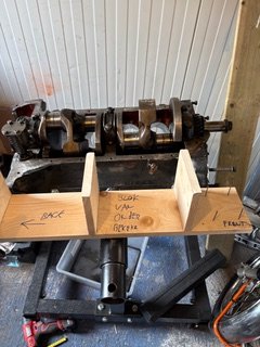

    I work temporally in my small home shed so gotta work with small a small place.
    Made some stands for the parts and started with removing the valves.
    Already find one worn valve guide and a few good ones.
    Tomorrow I will fight the stubborn valves and will see how the others are.
    I think I'm gonna replace all the valves and guides , better safe then sorry.
  15. Squablow
    Joined: Apr 26, 2005
    Posts: 18,541
    Squablow
    The cast aluminum oil pans are neat, late US engines had stamped steel pans, those must have been a Europe-only item.

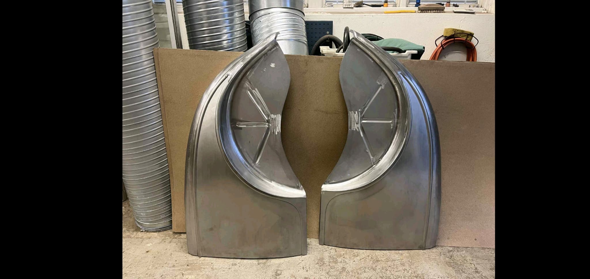

    Gonna pick up my quarters this week , these are hand build in Sweden.
    So slowly the parts of the coupe puzlle are arriving.
