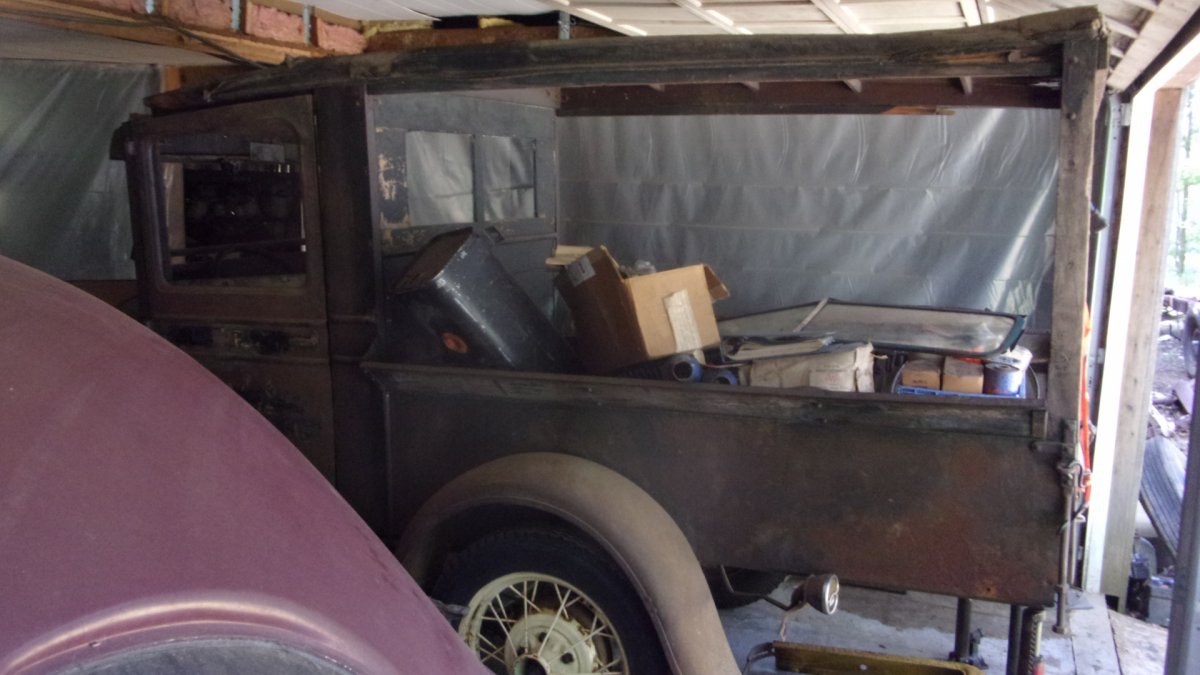

    I simply will never have the time to fix up the wood issues on my Model A, but I really wanted to keep it for some reason, but I cannot even trailer it to a farm show because the thing will start to fall apart more. I'd say I found a perfect reason to keep it. I like old cars and trucks, that's all. By the way, the word "feathers" is an old term carried up North/West from the original English colonial settlements near the Bay area of Massachusetts.. It means: Down filled bed quilts! I F'n love history too..She does too! See, "Amy is the perfect gal.."

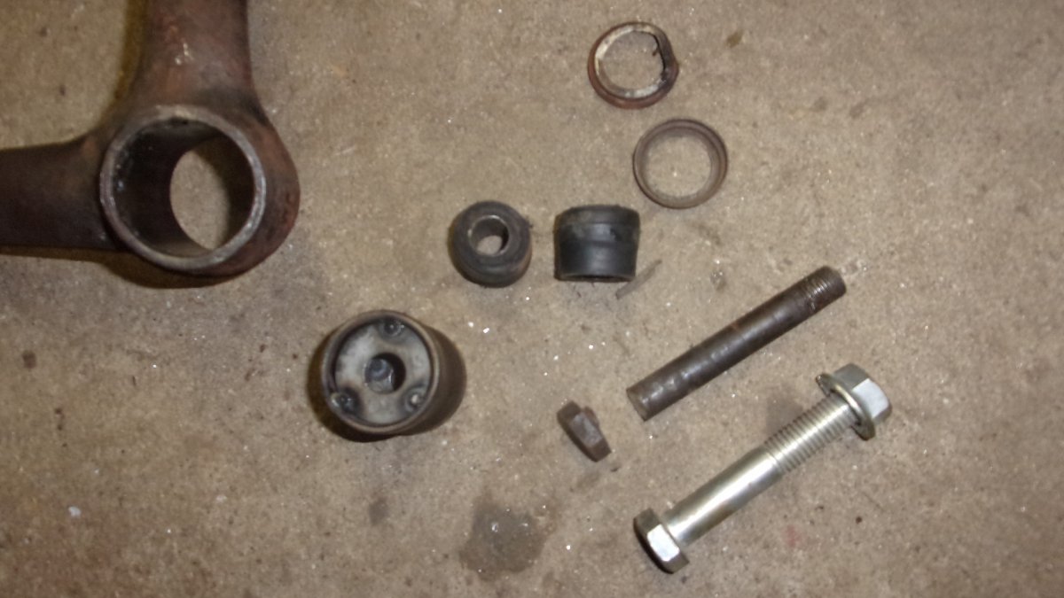

    I was ready to install the heads on the Cord late yesterday, but decided that I'd better fix the sreering at least good enough to quickly drive it up to the garden hose to start filling/draining/flushing the block without the radiator hooked up. The car simply is not steerable! I cannot believe the old guy could drive it without getting into a crash! Ask Jim, he tried to just steer it into the bay as I pushed it with a tractor.
    Anyways, the biggest slop and problem was the center steering pivot bearing. Jim looked under there a week ago and said "same as our LaSalles" as far as the bearing; I said No, the 34 LaS is a huge brass bushing and a large center pivot pin, not a wimpy 1/2" bolt. And I could see that the Cord pivot arm center was not big enough for the 34 LaS setup, so it must be the bearing like his 35-36 LaS and some other GMs use.

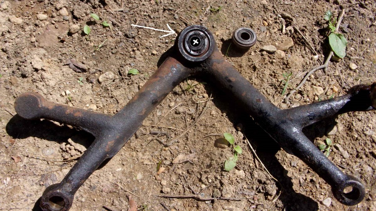

    Here is the K shaped steering pivot; it transfers the fore-aft movment of the typical side steer box & drag link, to change that direction, to move the tie rods in-out.
    ^^ looking at center of car under front of car. Yellow shows the K arm. White shows the long 1/2" bolt installed up side down. There is no way to take that bolt out unless the transmission is removed. They did the mickey mouse repair I will show next, when the trans was out! That bolt will not go up high enough, so I cut the very top of it off, pulled it out from the bottom.
    ^^ here is the K arm. The white X shows that the rubber shock bushings they tried to use, are now crushed and that hole is offset. There is another shock bushing pressed in from the other side..below pic:
    ^^^ Ok, the bearing is really like what is on a bicycle front fork for the fork pivot! Those have a ball bearing at top and bottom of the tube that is welded at the front of a bike frame. This setup uses a long bearing outer race that gets pressed into the K. I knocked it out, then tackweld two 1/2" flatwashers in each end of the old bearing outer race tube. Then I will use that new 1/2" bolt put in from the bottom, to at least be able to steer the car right now. The car Owner Ron is very skilled at chasing parts; he could not track down the correct number that Jim gave to us. Then I tried, but kept coming up with a flat bearing that is used on some trucks/etc as a throw-out bearing! Same number, but not same bearing. But one link to AACA said a guy commented on needing one for a Buick and was told that is an "old New Departure" number, and hard to find as NORS.
    I took the bearing housing out to get a good measurement of OD and length, in case we need it to find one that can work, or two shorter ones stacked?. Kenny called about something else, and I asked him; he said some old bearing place, maybe Springfield Mass or up in north CT? something like Nos----...something for a company name?
    ^^^ by the way, you see in the FIRST pic of the K, that one leg of the K is not drilled. That is then only drilled for Right Hand drive Cords!

  13. Frank, on the k arm it would probably be worth trying to find a pair of tapered bearings and races that would fit. installed opposite from each other so ALL the slop could be adjusted out of it.

    Well, they get points for creativity for trying to replace the bearing but the execution stinks. The bearing fits 36 Caddy Model 60, 35-36-38 LaSalle, Cord 35-36 Olds, some late 30's Buick and a few years of Hudson. I found one ( New Departure #900916) on E-bay a few years ago and finally got around to changing it this Summer when I got tired of sawin the wheel back and forth on the 36 LaSalle coming home from a show in Vernon one night.
    When I took it apart, I found that someone had taken two sealed bearings that had the correct O.D. and the correct I.D. and with a spacer in between, pressed them into the center link. It worked for many years as we have had the car for about 16 years and I'm sure the repair was made many years before that.
