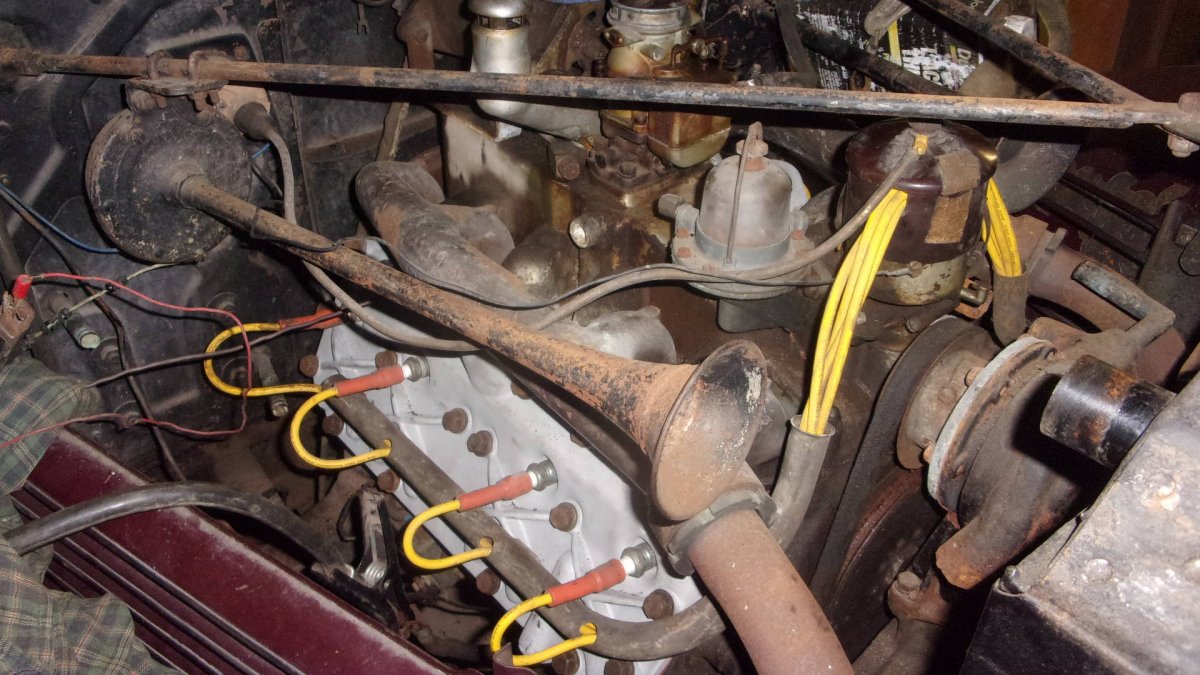

    Ok, Jim and I had the Cord running a few seconds only & stalled, just before Bob showed up by coincidence.. We were just restating as Bob came through the door. Anyways, it is starting good with a bit of gas as the carb linkage needs attention. But still skipping, and still that crazy crossfiring, kinda on just the right muffler...not sure as that muffler is loud. Other is OK, I think, but I am always on the right side of engine.
    We messed with a few things like checking blow-by at the oil filler, etc, but Jim insisted it has a couple plugs fouled. I did not think so, and he took them all out and they were OK. I have not done comp test as it is too soon IMO, but I may, in the AM, as I ran it again late today by myself. It started REAL quick then, but saw a huge change from when they were here...smoking decently/moderately out the filler vent holes! But NO tailpipe smoke?? IDK, this is a very odd one for sure! We still have not plugged lower water hose fittings up to run the block & heads full of water, so run time is SO short! (to diagnose things)
    Ok, Jim, I did run through the firing order, even though those wires were definatley on the engine when last driven 3 decades ago...BUT, I peeled one wire end back at the, cap and it is a carbon wire set. I want solid wire, but where do I get enough?? (these days, and LOCAL) I swear it is crossfiring through the wires, but I just don't dare say that for sure, as this one is acting so odd.
    ^^^^^Blue Arrow shows where I skinned off the insulation to verify for sure. Other circle shows how the wires get crushed into a br*** spike in each rounded seat for each wire. There is a bakelite round cover that clamps down on all the wiring.
    Book I got from Kenny just as a gift, after I showed it was buried in stuff piled on a oldie we got running to drive out of the building. He said "I wanted you to have it as it shows a lot of specs for the Cord."(and, MY Nash!) Here is something cool.... Check the firing order....and how they made it so easy to follow or do a on car trace!! They break it into 1L 2L up to 4L, then repeat 1 thru 4 but with a R. (I hope you can read it on the "expand-pic" feature)
    catch the order yet???? This motor hits all FOUR on one bank, one at a time, FIRST, then goes all FOUR , one at a time on the other bank...does not hop back and forth between banks!
    Needs>>>>More think time on my porch, and find some solid wire...Fun day, w/great friends...bye

    WOW......never have seen a V8 with a firing order like that. Not sure I comprehend how that works, but apparently it does. Do you suppose it has a 'flat plane' crankshaft?

    Ray, yes I was already wondering what the crank looks like ...BUT I sure hope I won't have to look at it! LOL, I have enough to do. Boy, strange indeed! I am quite tired (getting MUCH better though), so I had to read it a few times to make sure I was understanding it the correct way!
    I have been emailing/back/forth with Ron the owner, ...he somehow comes up with the same suggestions lately, like just now, he says "flush the block with bucket of water several times, so you can hook up the radiator", (if you cannot drive to the garden hose)
    But Jim is an idiot...he keeps emailing me tonight TOO.. read below:
    HIM:> "Not a big fan of those carbon thread, or what ever they are, plug wires. Could be that spark is jumpin in the cap or shorting in the wire loom? We'll figure it out eventually. We smart!"
    Then ME just minutes ago> "we will figure it out"
    What's dis WE chit? You comin' over fer another date, honey??/ Ask the wife, like I said on Day ONE, she'll have to adjust!
    >>> ok, so I go to copy those emails just now.... and Ron just fired back:

    is it possible the "firing" order is being "switched" in the cap? i remember running across an early cap that the electrodes inside the cap did not correspond with the plug wire side. i think they even sell modern caps that keep the wires from crossing over.

    I agree with Ray,,, I sure will check it with an ohmmeter as "first thing"... It just seems so much like a crossed pair! It refuses to "clear out"!... I was a punkazz kid when a Kid from Maine came down in his 67 GTO to visit a cousin,,, Man, I did not know a thing then, maybe 17 years old...but it sounded SO wrong with the gl***packs...I checked the firing order for some unknown reason...two wires crossed, never a back fire or a skip, it was two wires that just made it sound wrong!

    Frank, I don't think an ohmeter will help you out, usually the insulation breaks down, then the spark jumps the gap to the other wires, heck I've seen it with cheap, new wires, on SBC's.
    I'd suggest pulling the wires from the tubes , go ahead and leave them next to each other, fire it off in the dark, and see if you're getting a light show off the wires.

    What I meant was to see if the wire attaching point on top of the cap, is actually the same position as the contact under the cap...that is what Ted 33 was saying. I do recall a cap like what he said, AND there was a streetrod cap made for Chevy, so it had the wires on right side of cap, go to the right, and vice-versa, for the "clean look".
    I will check that continuity for sure, and if it is OK, I will run some sort of solid wires tomorrow...Heck I even ran a four cylinder on mechanics wire once!...just to sort that barn find out. I'll call one of the Auto Parts places here in town; I am not goofin on y'all, but there is a young woman who helps me find parts without "year'make'model" and just might be able to get me a roll of solid plug wire! Really good at her job! no, I never got her name,,,but I did give her a nice compliment!

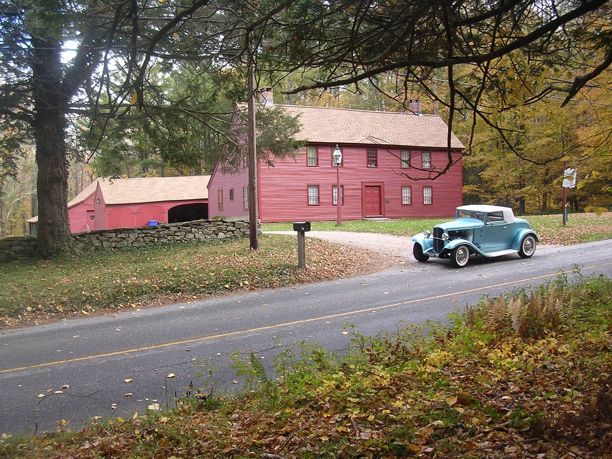

    Sheesh, I was just looking through my pics for a pretty one....last moment I spot this one taken just TODAY! Jim had just gotten here and wanted to look outside by the shop, at my 35 parts Cowl for a part for a friend... I heard that special Locomotive horn coming...2 locos heading south towards the shoreline...the one I said sounds just like the old Montealer...I ran back further to grab a pic, but thought I never got a steady pic... I said "I wish Amy was here, because she likes listening to trains"
    Not an award winner picture, but here you go:
    River just beyond the tracks over a bank...

    Yea, Back on the Cord! Was it Budget36 says to get the wires out of the looms yesterday? Well, that sounds better than chasing to Kenny's for solid wire because I need my dang trailer unloaded first, to grab the Dodge 4x4 or Whippet to combine tasking...
    ^^^ what a pain, as these silicone wires are "grippy" in those tubes, and tight fiton the last one they must have had to pull hard on that wire to get through? You cannot stretch those fiber wires, it can cause a break/burn inside the insulation.!! So, I'm kinda wasting time here, but just hoping for a hint of it getting better today..
    Ready to fire it up, but got my Halon out for only one reason. I should have done that from first attempt, there was no excuse for that dumb decision! ...Ok, Yesterday, 3 guys on the car at once, all too busy to watch what is going on, Jim says my 1 gallon gravity can is "too low". I knew he added more, but as I quit last night, taking hot 6v & 12v jumpers off the car & twin batteries, I went to move that can down low in case the carb needle started leaking overnight. DAM Jim??? Filled it UP?? Buddy, we only need a pint during each super short run time due to how hot the heads get so quickly! If some freak event happened with a FULL gallon, right over those top mounted exhaust manifolds, and some frayed and burned horn wires...it could go SO bad, SO quick!! I dumped most of it last night, back into the 5 gallon container in the work area, far from the car.
    Ok, It fired quick, I know I heard some slight backfiring kinda...hard to explain the sounds from where I need to stand to do the jumpings..
    Let it run as long as I dared, sounding SO much better, but LOUD...It was stable at a maybe 1000rpm speed, so I made it back 5 feet behind the car to hear any oddities, skips?? ****, this thing sounds so bad***! Later I knew why, yes, one muffler I then saw was blown right off years ago...but it is that crazy firing order guys!! Think about it, 4 hits on one pipe, then 4 on the other...of freakin' course it will sound like no other car I have ever heard!!
    After I shut it down, thinking...I decide to get a creeper to see the mufflers and why they are both loud?? Sheesh I saw one muffler was blown away, but at same time, the right exhaust pipe is nearly completely crushed flat!
    ok, under there seeing stuff I never saw before... wasn't there some late 60s rock & roll song, "seeing things"....then..".I don't wanna see no mo' " LOL..
    A HUGE master cylinder, pic won't do justice for sizing it.
    ...and W in the the F is THAT??? some paper thin, long*** metal grid thing BETWEEN the exhaust, maybe 4 feet long...three strips of 1.5" wide, huh??? ............. DUH!, it is the Radio "Array" in radio speak! The antenna!! Cannot get a good pic as this car is SO low..
    Car needs water NOW, cannot go further without water, AND cut that crushed pipe section out, scab in a straight piece, find a muffler or a pair at "Kenny's bargain ba*****t sale" LMFAO!
    having a blast, this car is so crazy!!!
